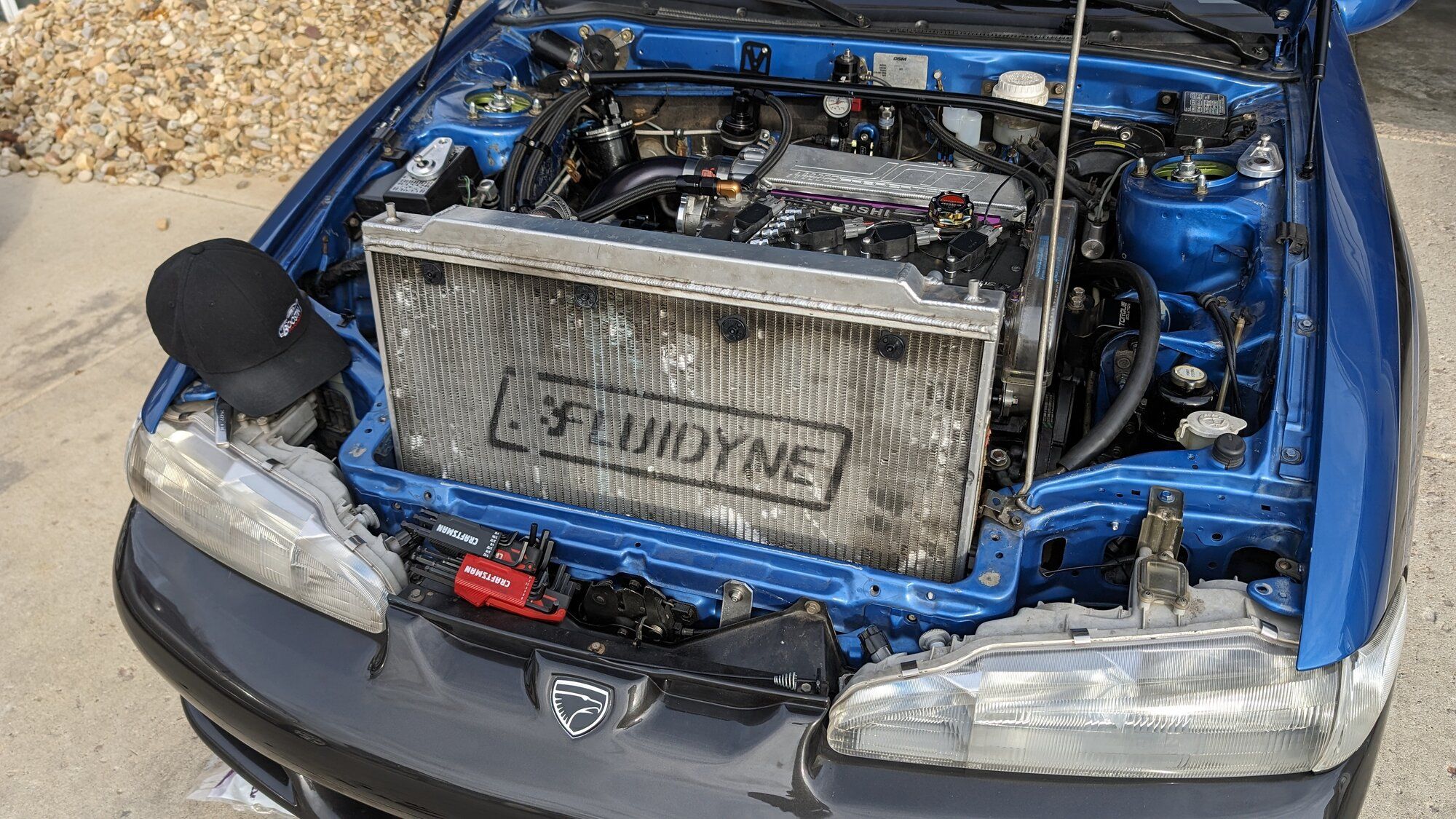

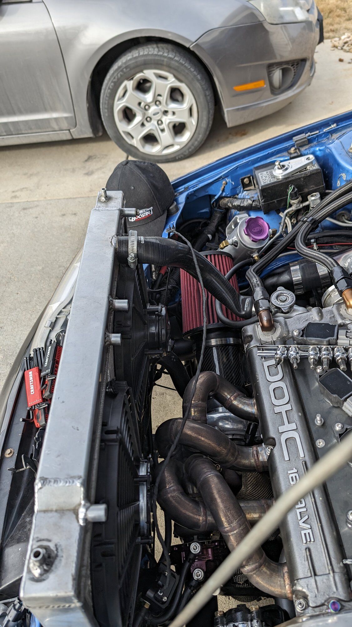

Swapped out my driver side radiator fan yesterday without draining the coolant. Which was neat. Just pulled the entire radiator basically out but with the radiator hoses still connected. Probably a dumb move but oh well. Swapped in a new slim 12" SPAL fan.
I did order a radiator shroud off eBay so we'll see if that fits at all or not Too.

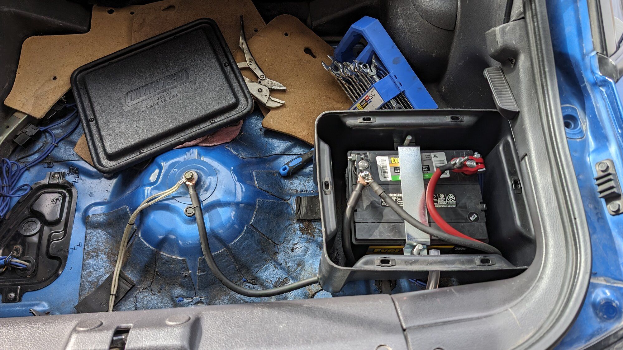

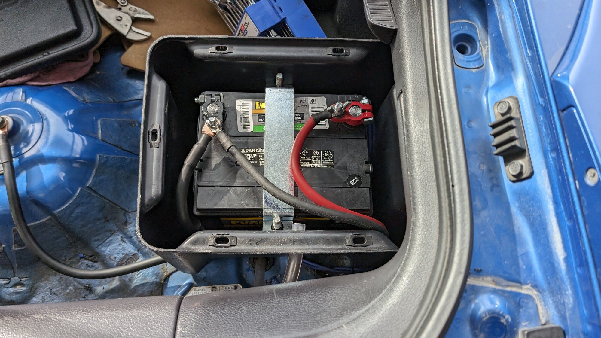

Finally got around to tightening down my battery tie down inside the battery box and remade my ground to the trunk.

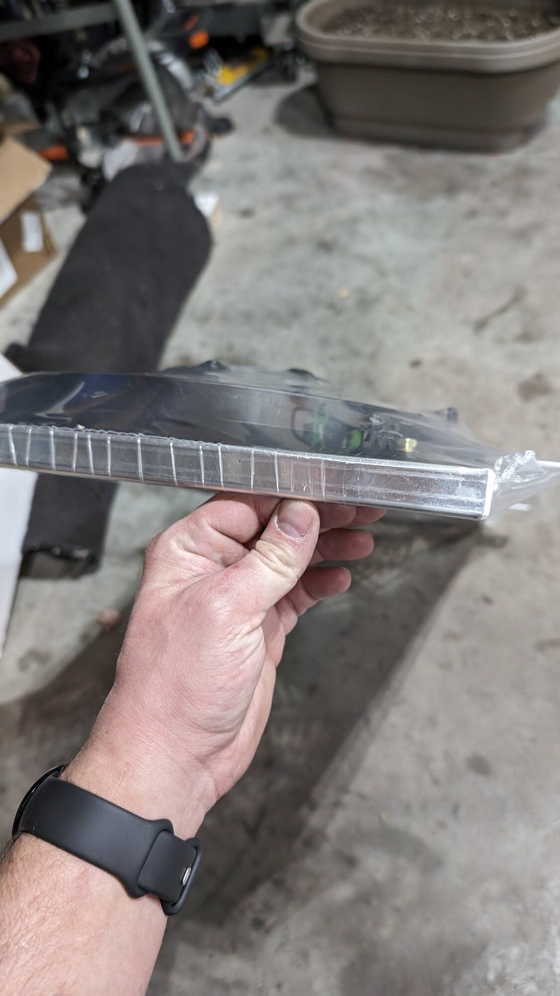

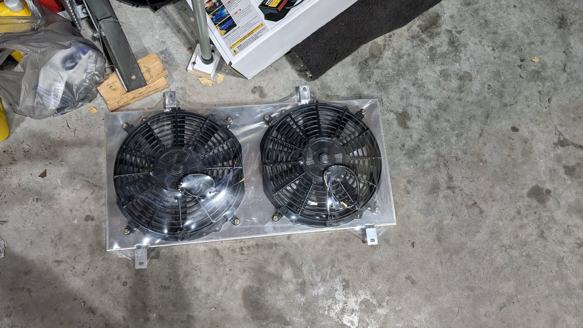

Radiator fan shroud came in yesterday. A quick little mockup, I'm not sure it's gonna fit. Mounting tabs aren't really in the same spots I don't think.
Its only 3/4" thick, I didn't expect it to come with fans (I'm Not going to use them). Sometime I'll drain the coolant and pull the radiator off and test fit it.
This unit was just over $100 on eBay.

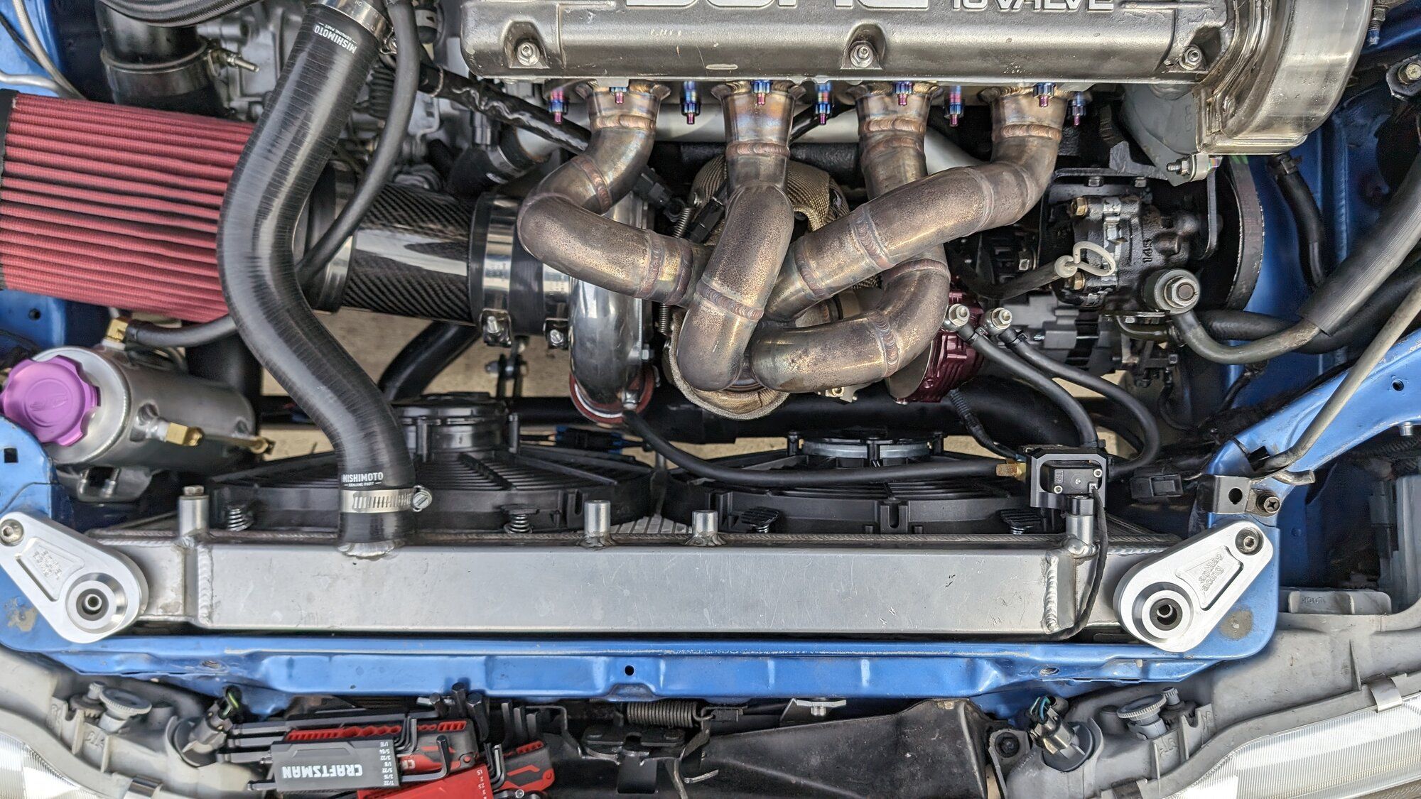

I think this summer I'm going to work on getting a shroud made from backside of intercooler to radiator to help with cooling as well.

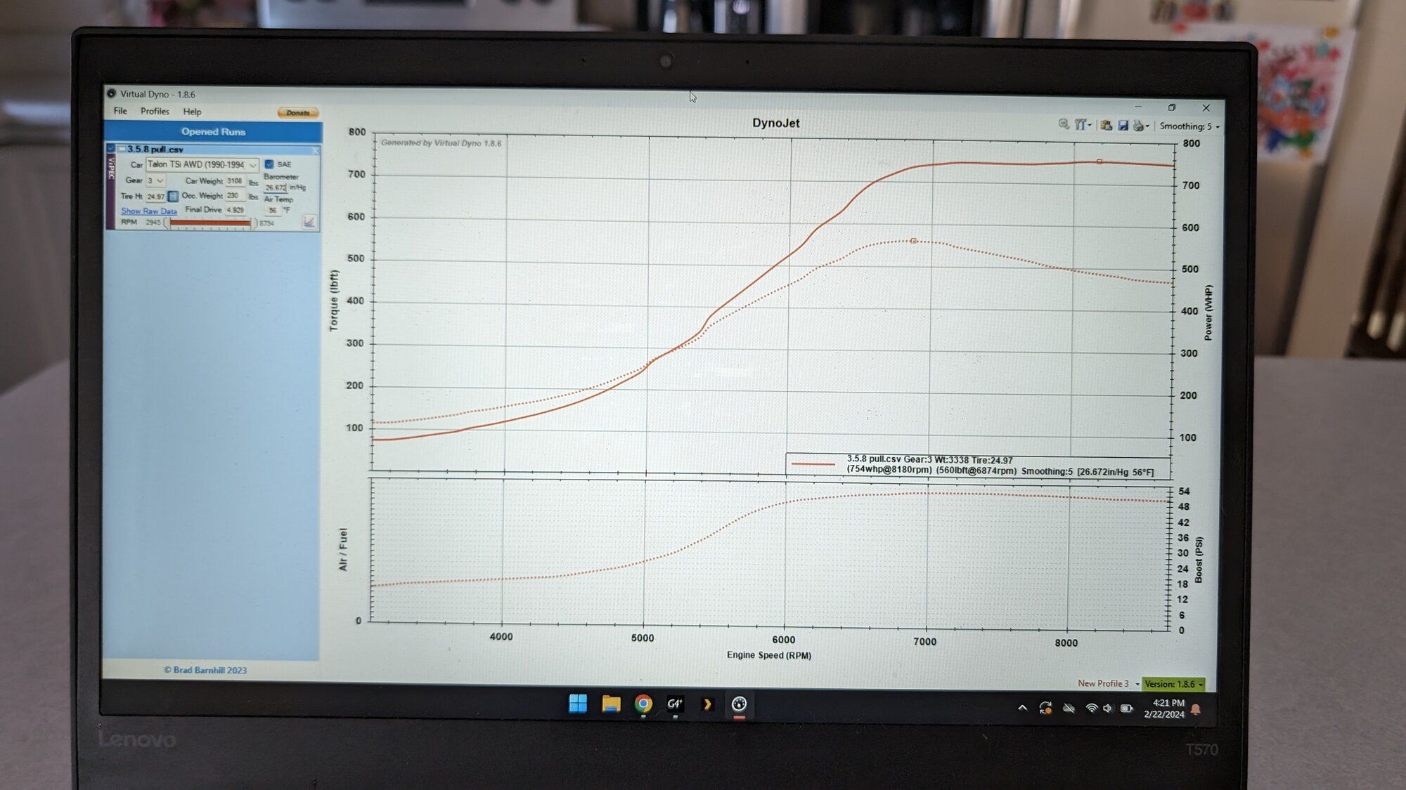

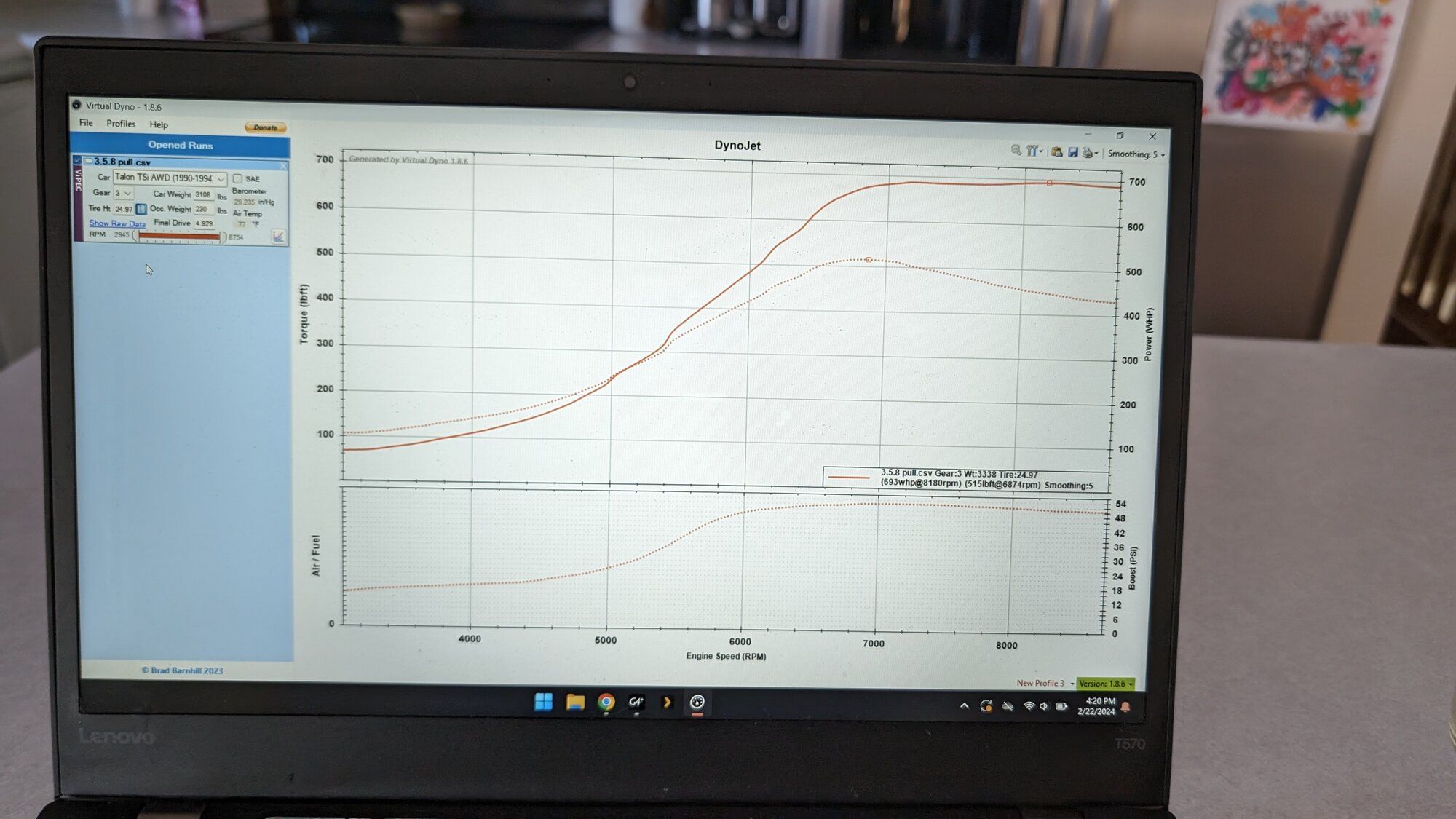

Zach added more aggressive boost curve AND 3° almost everywhere. So we're on like 39lbs and 13° I think?
Uncorrected:
Corrected:
I can’t get over the spool up on that 67mm, looks like it hits around 5500rpm which is similar to my 6266, that’s pretty impressive, numbers look good too:D what’s the ethanol content in your tank?
When I looked this morning, 66%?
I'm more impressed with the 500 wheel at 6k LOL

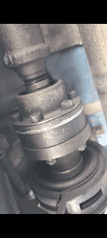

Well today I think I've found the surprising first limit of my newly found power.

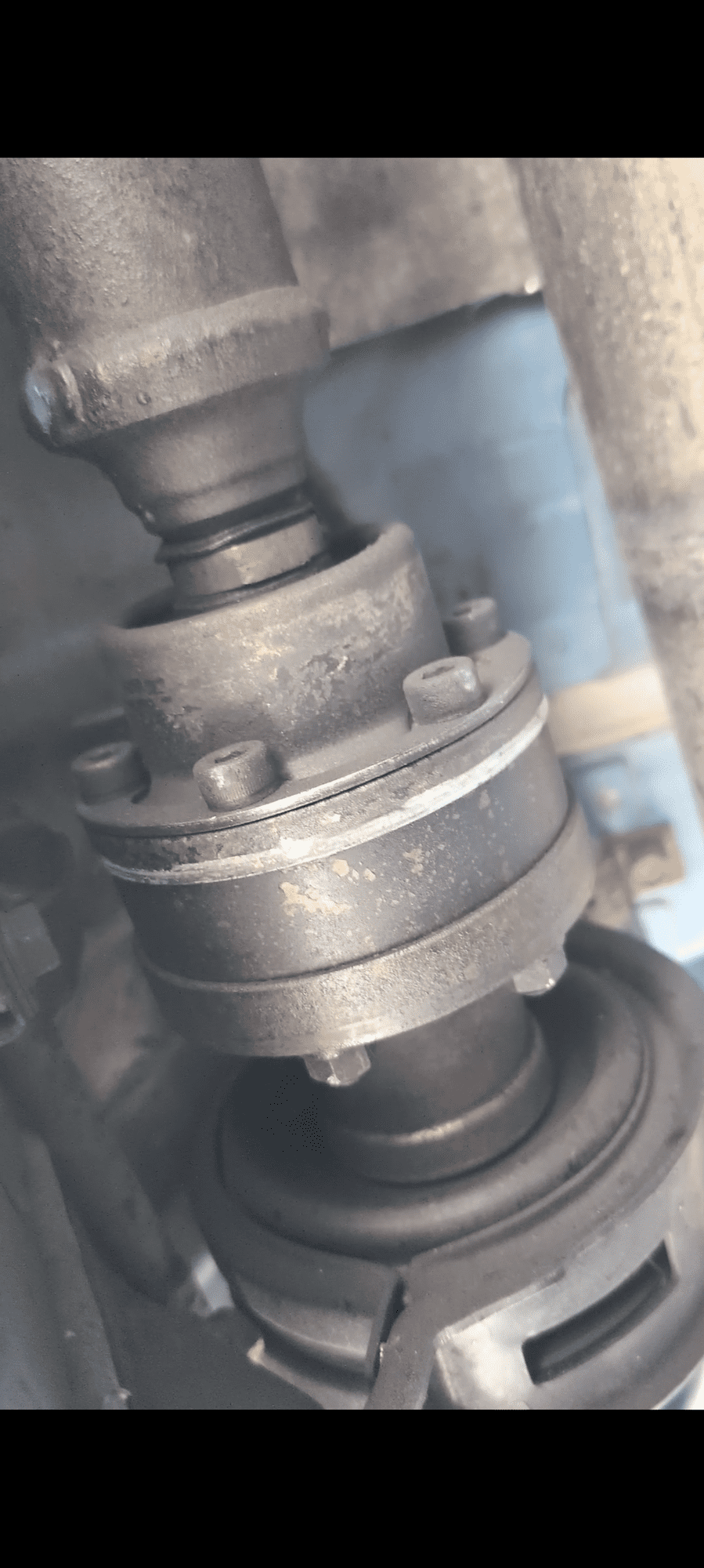

Seems like my carrier bearings for the driveshaft are going out. Under hard acceleration, I think it smacks the underside of the car LOL of course this is all speculation since I can't look under the car AND go fast at the same time.
I looked under the car and one of the joints looks like it's hitting SOMETHING under the car. But I can't confirm for sure. I did order up some JXB carrier bearing upgrades and I'll get those installed to see if that fixes it.
