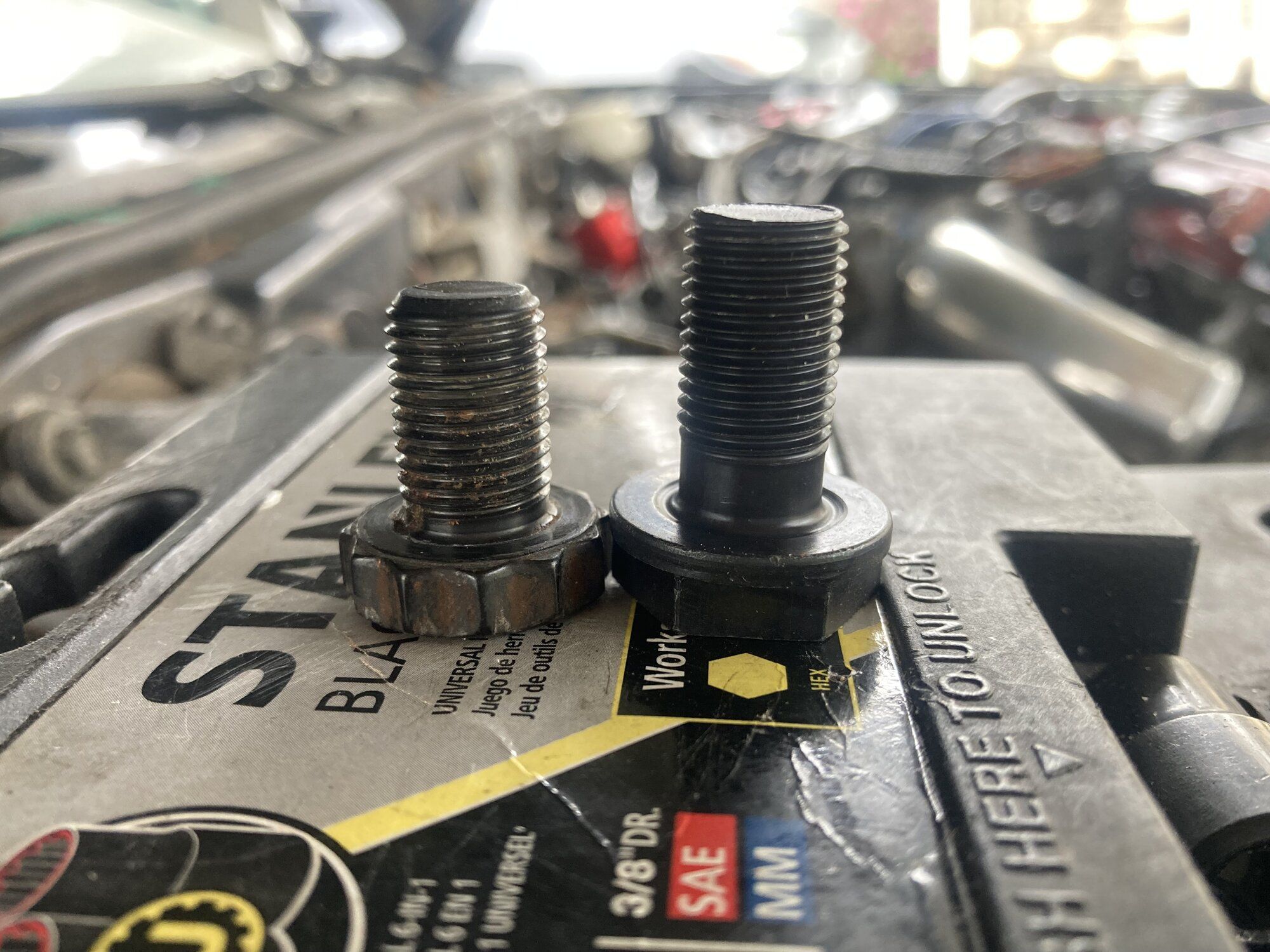

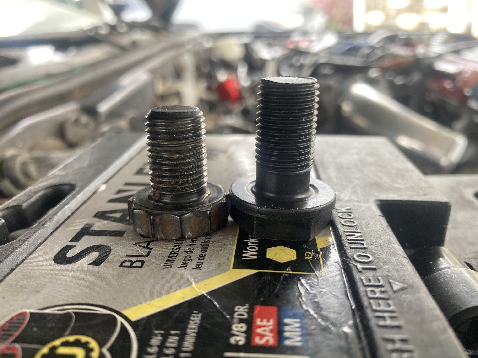

Quick comparison pic for ya of my arps and an OEM flywheel bolt. ARP is left and OEM is right.

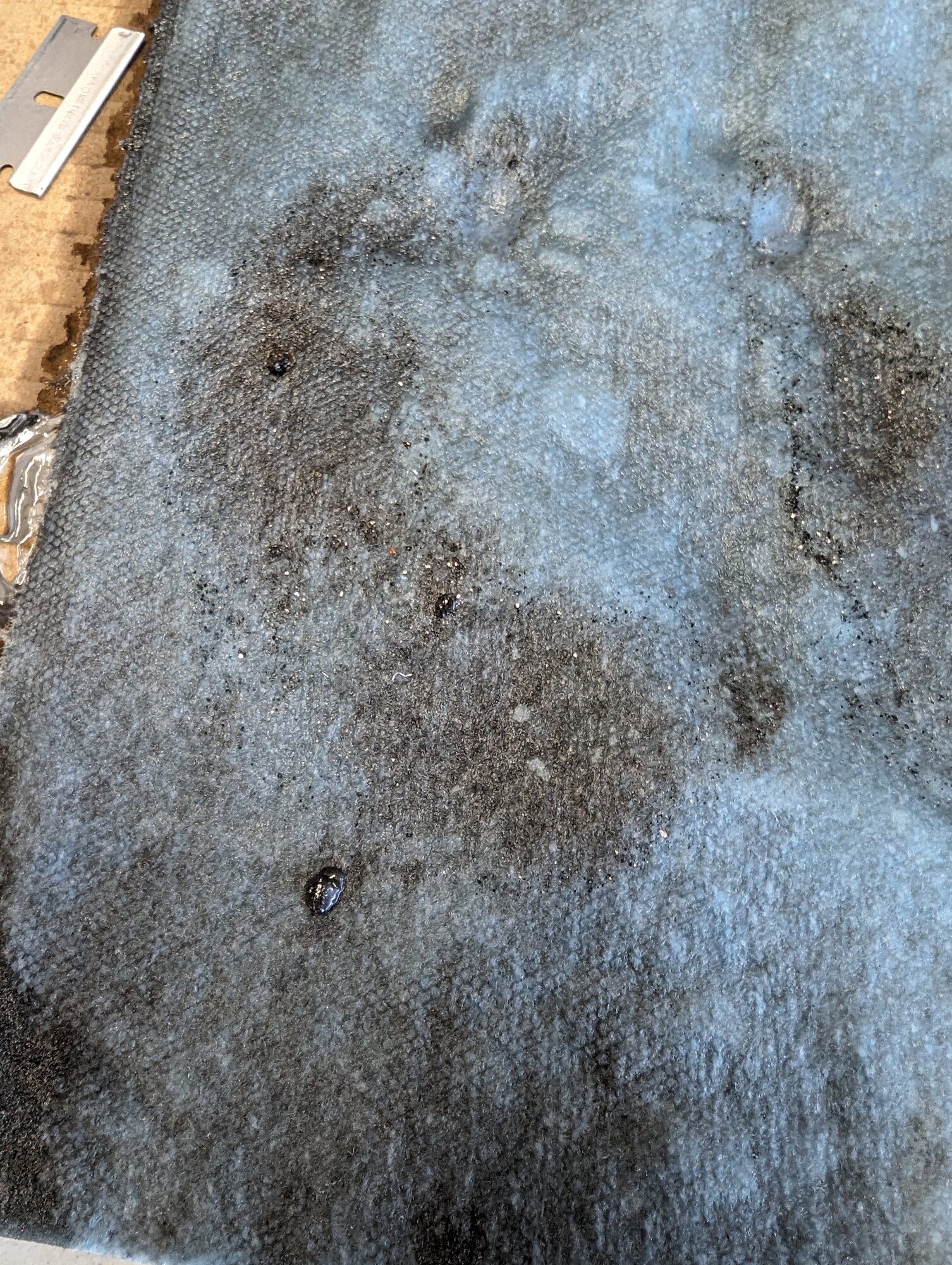

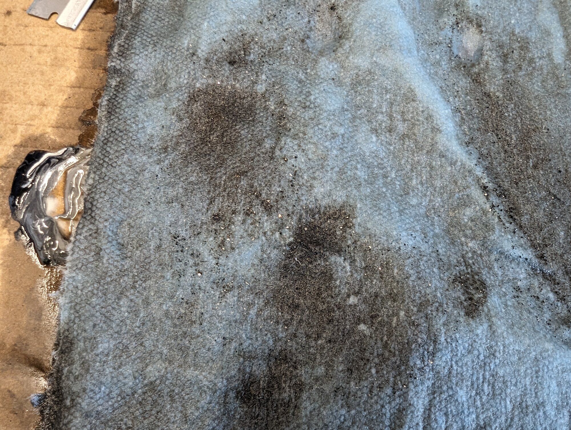

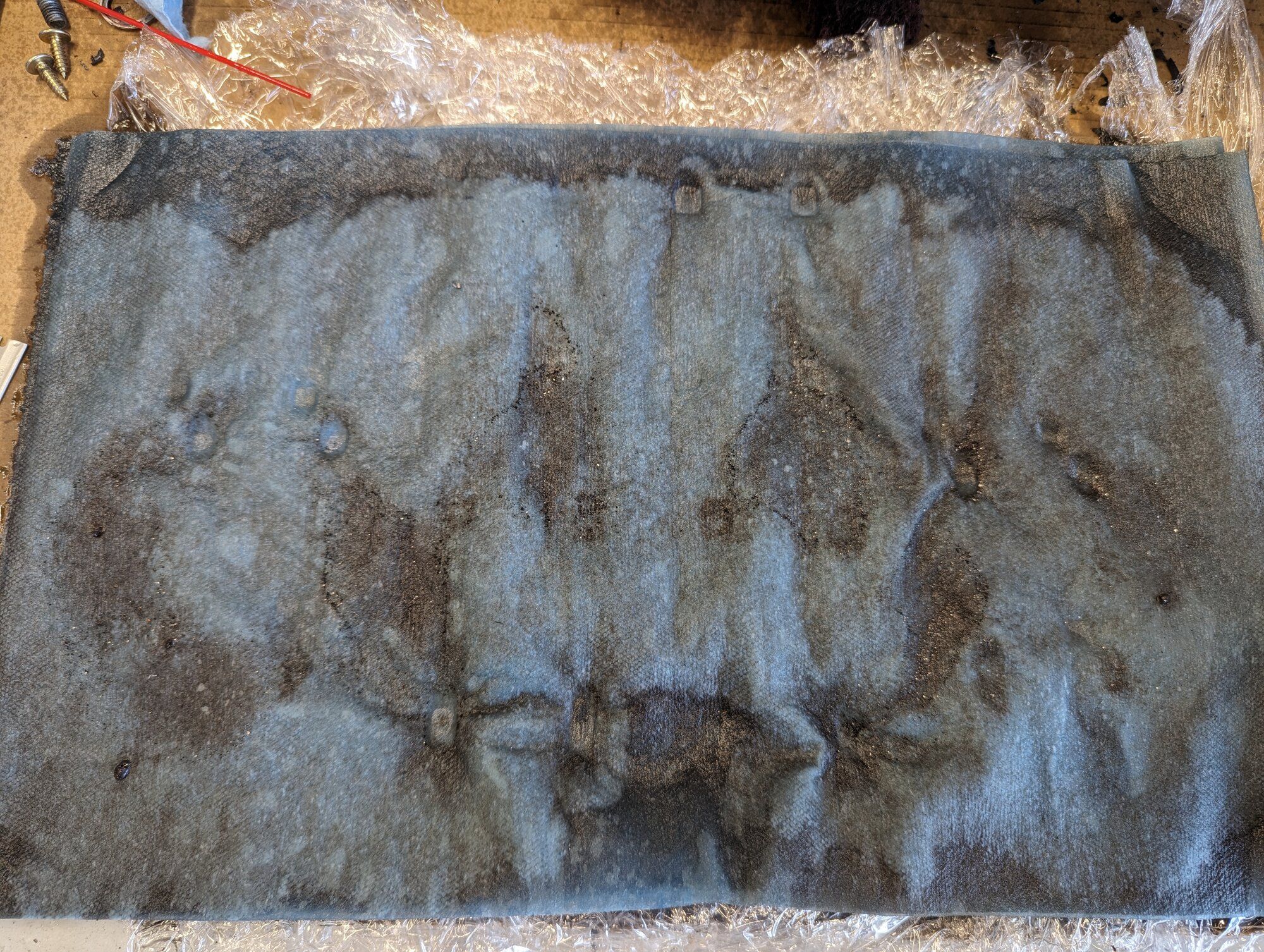

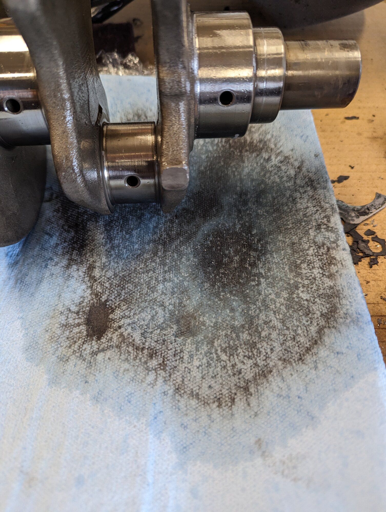

Next up, clean the ever living shit out of the crank inside.. have a dozen cans of brake cleaner (non chlorinated is all we can get).
Edit:
Yikes.
Clean behind your balls, everyone.
Also, wear eye protection. Got a tiny little droplet of brake cleaner in the eye and even after a good flush it's annoying as f..

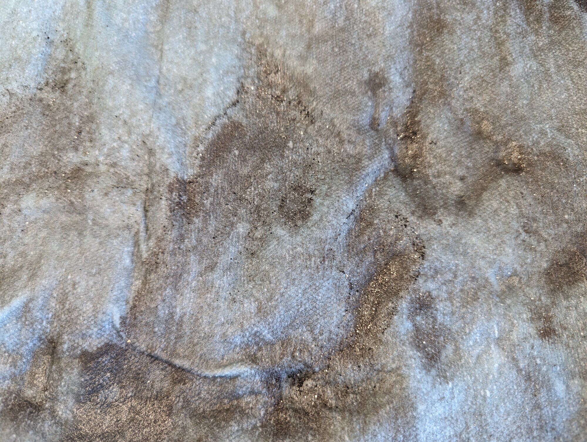

A bit more than one can so far.
I think the big chunks are moly from the head install a couple years back, but lots of debris.

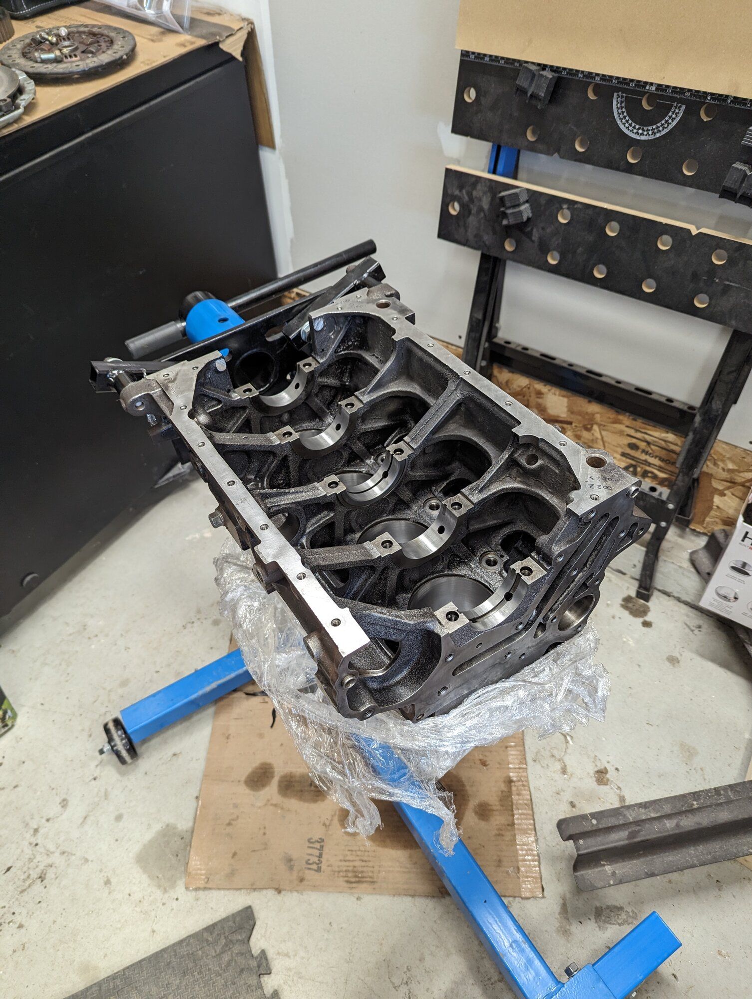

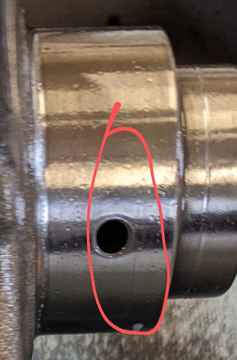

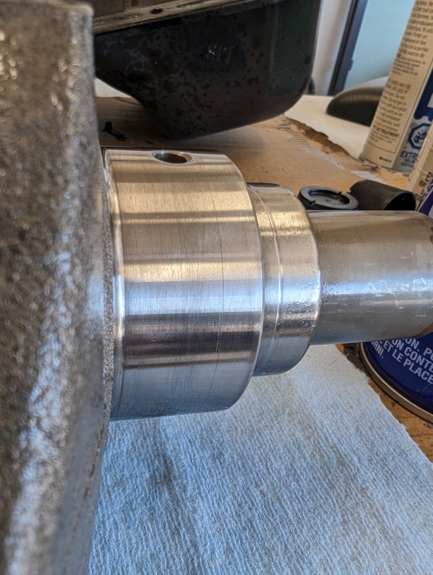

So this one journal, #1 main, has a radial scratch that can juuust catch a fingernail. It's the only one.
I'm not cutting the crank and it seems wasteful to junk it.
Not sure when it showed up.. possible during balancing, unlikely during the polish
I think I'll just send it. The rest of the surfaces are nice and clean.
My reasoning? The upper bearing shells have a much, much bigger groove in them. As long as there's no burrs outwards, I'm sure it's fine.

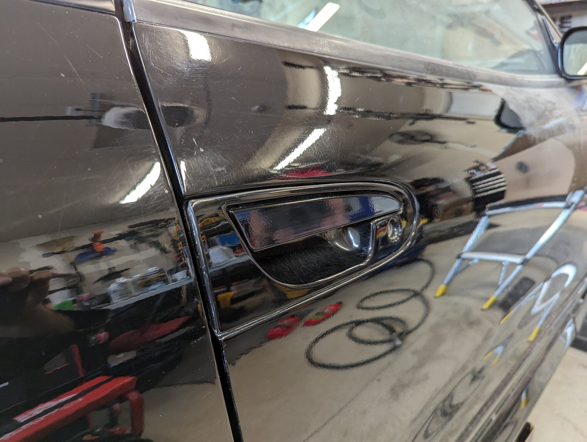

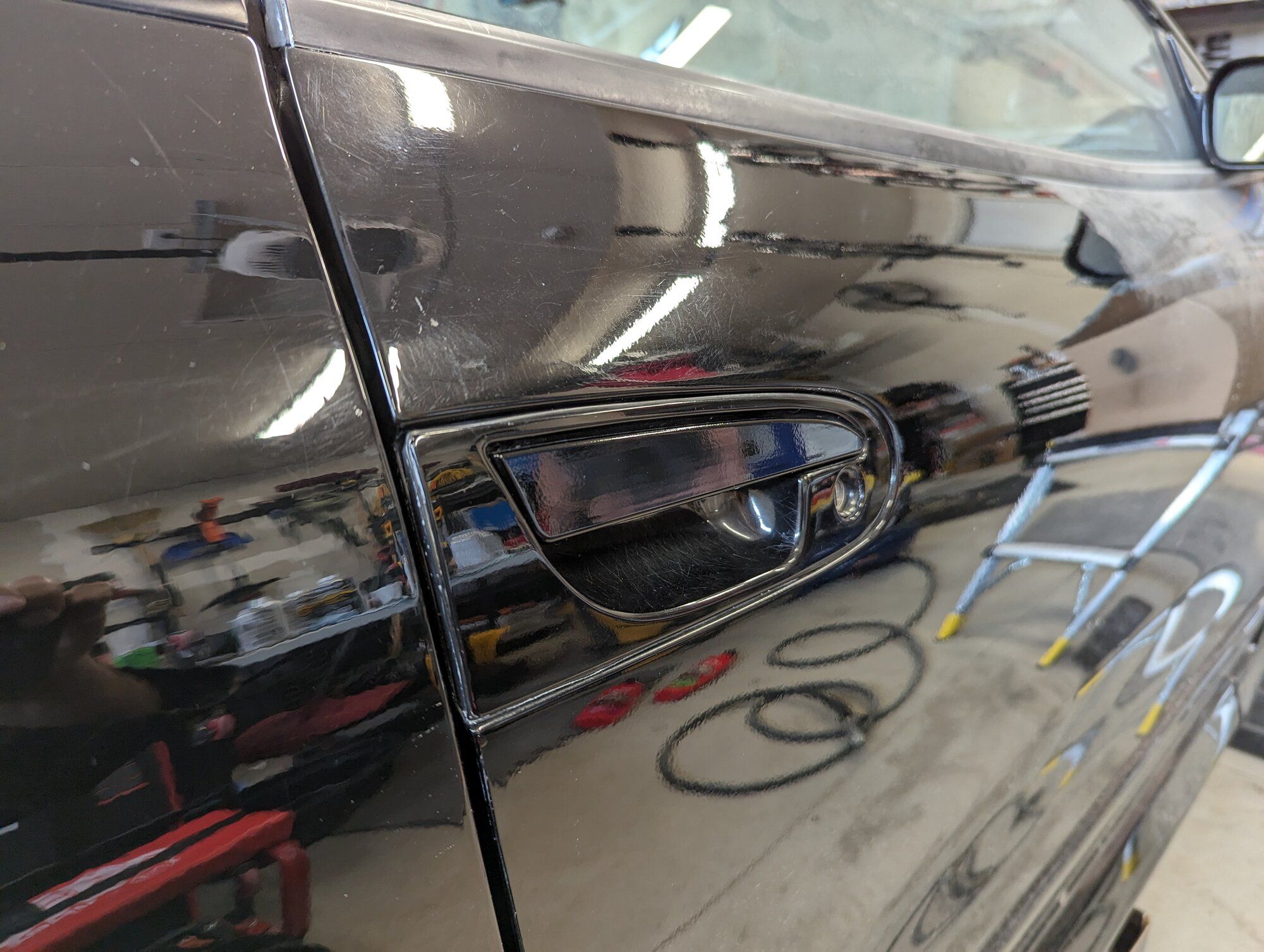

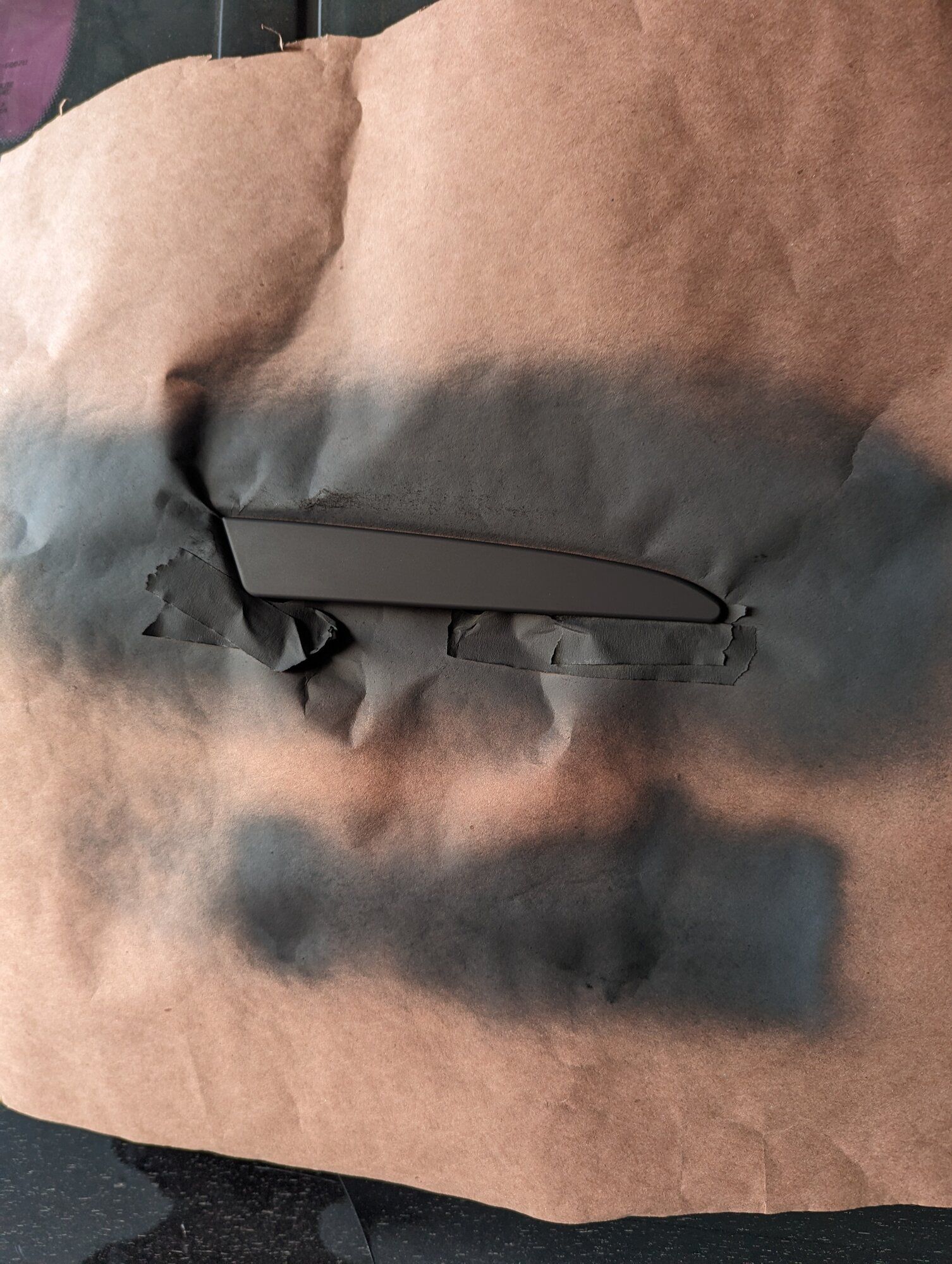

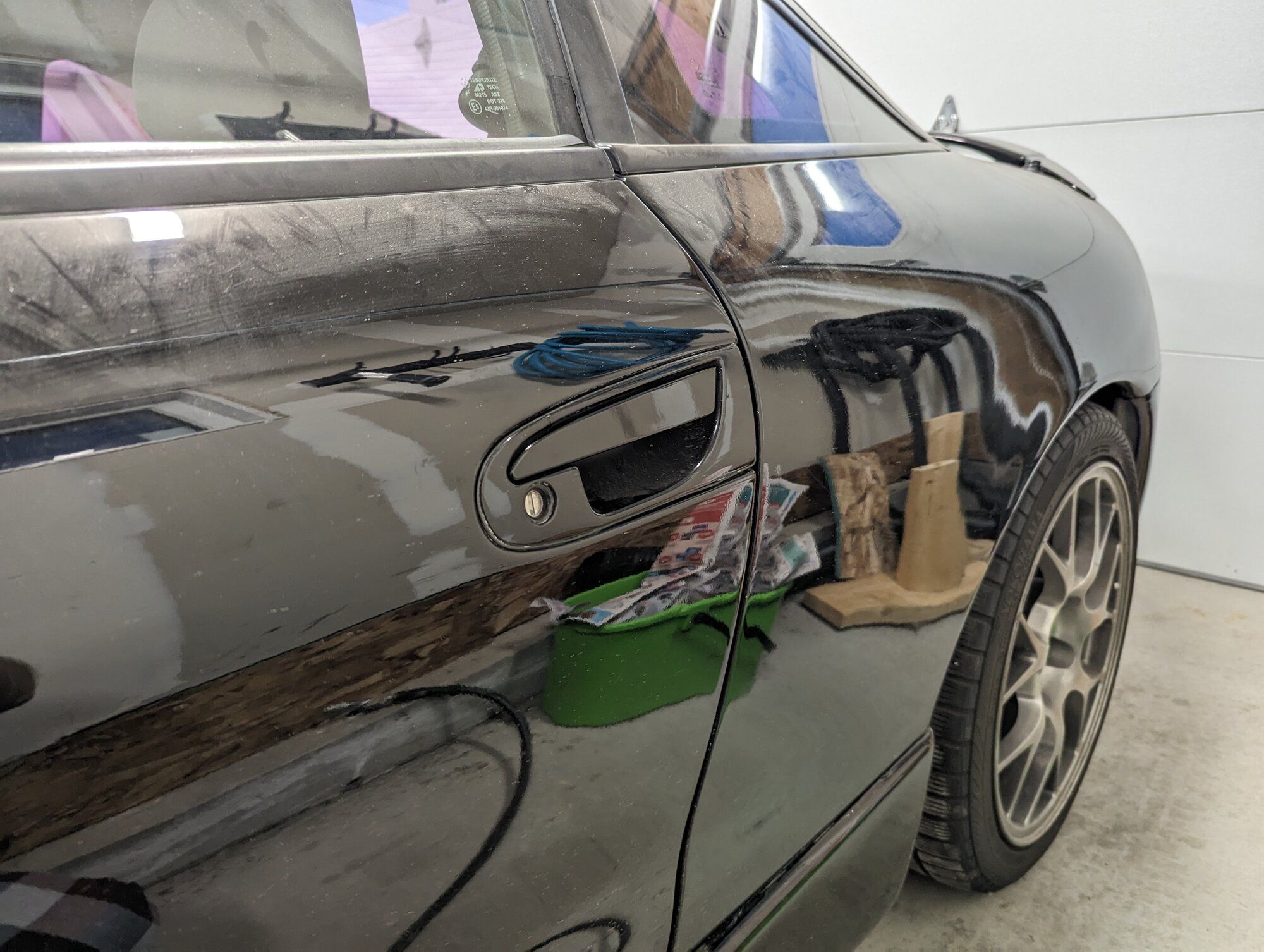

Finally addressing my aluminum door handles which somehow went orange over the years.
And cleaned and painted a thing

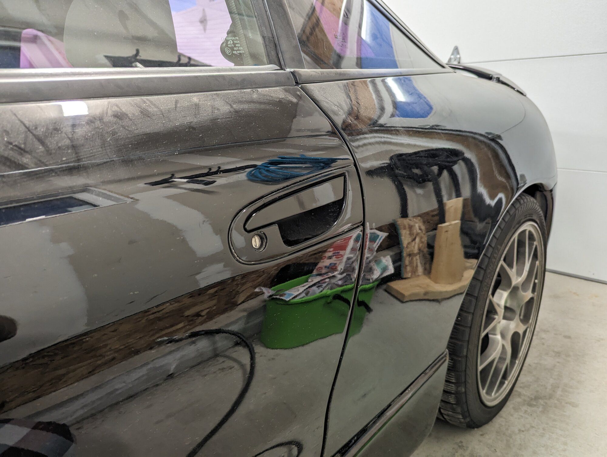

Turned out not too bad. My memory is fuzzy but I think it's 3 colour 4 clear on passenger side, and 4/4 on drivers. Been wanting to do this for a while but actually driving the car always took precedence..
Looks great... i did mine a couple of years ago, but now have to take the door apart again because someone at the tire shop tried to put the key in and the cylinder slid out of the holder and into the door. 😕

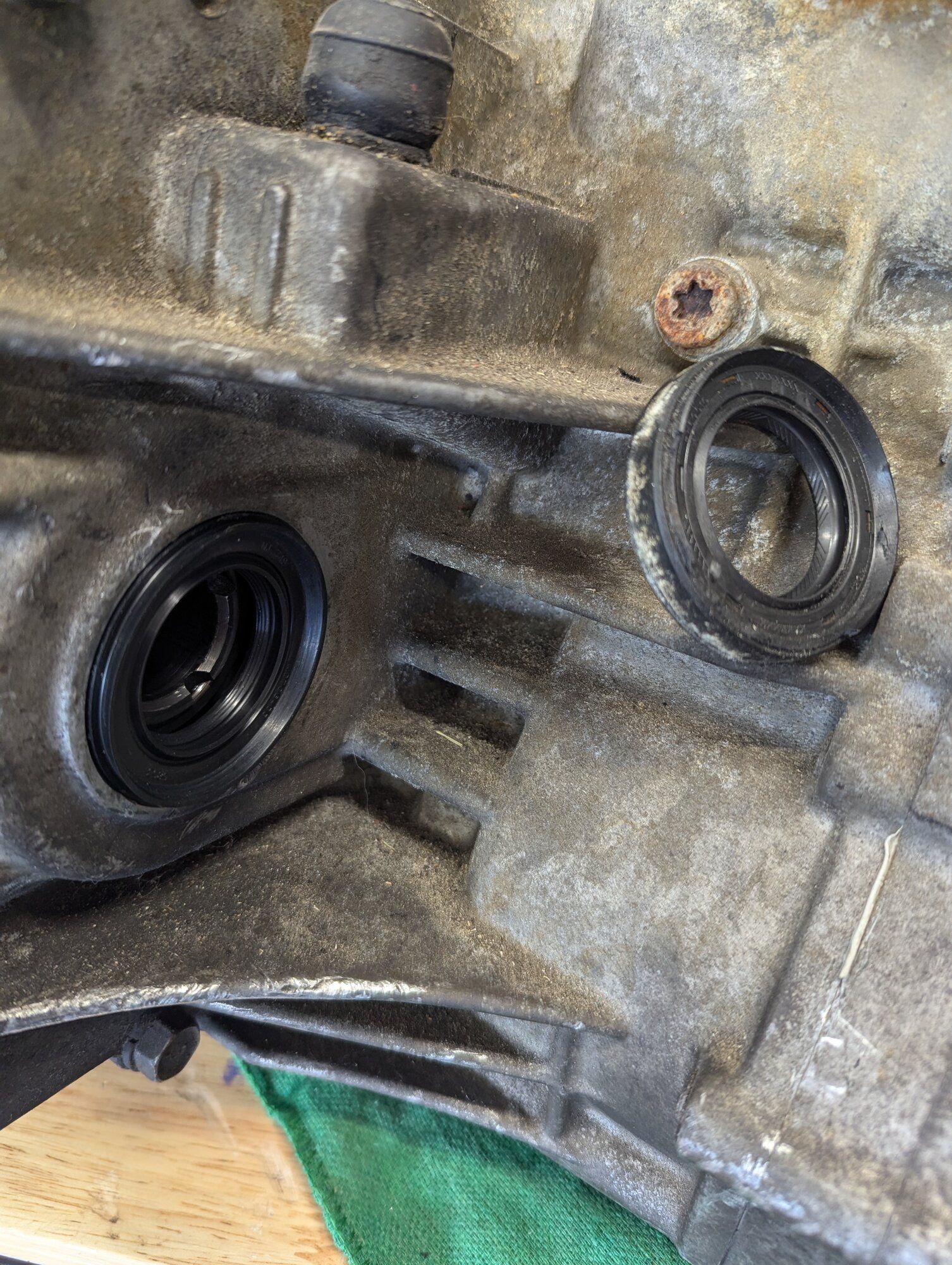

Replaced:
- passenger side trans seal as the old one was pretty knackered. Drivers side looks good.
- pivot ball.. one of the POs shimmed it with a nylon washer. Ball has some wear but nothing crazy. replacing anyway but keeping the old
- cleaned and resealed trans breather bulb
