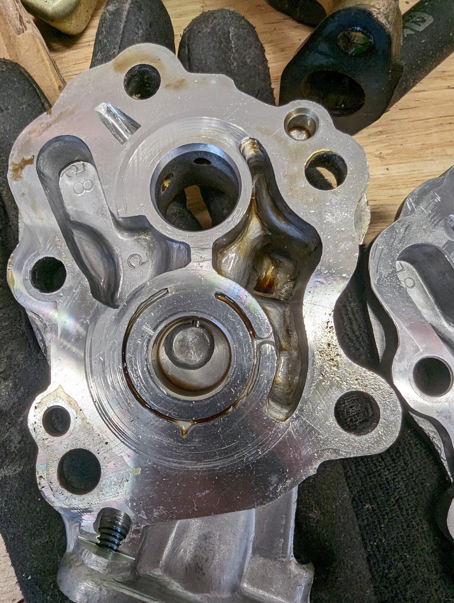

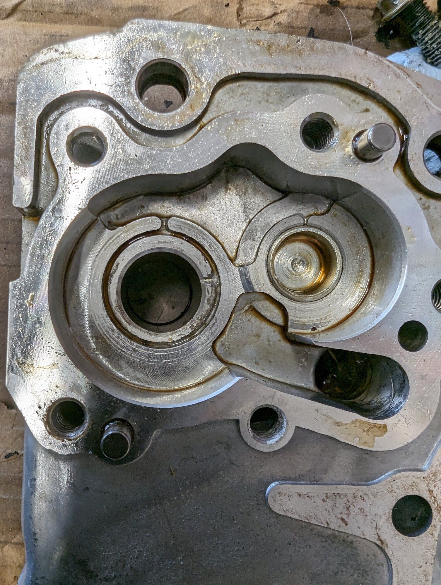

I figure the pump I pulled off my most recent motor (that I didn't build) may have been OEM because the oil passages look deep and lovely
The pump I took off my motor I built back in 2012 was a Melling, I think. Helical gears and passages were much more narrow.
I have a brand new ACL, also helical obviously, that his very similar to the Melling or whatever it was, but ever so slightly closer to the first one.
Given all this, I would most preferably want to re-run the one from this motor that I can only assume given the quality of the machining is OEM. There's a bit of a ridge on the bottom of the drive shaft's bore surface though which corresponds with the shaft's outer piling groove edge.

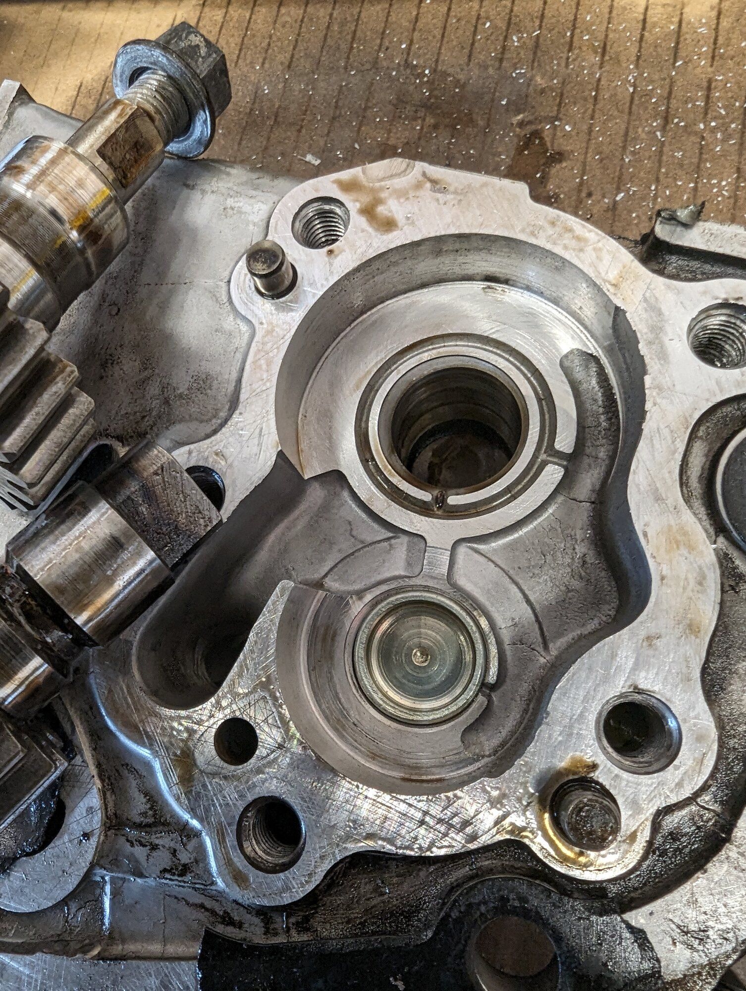

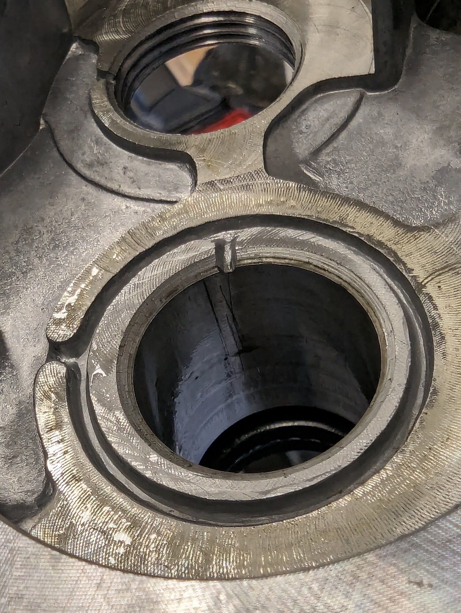

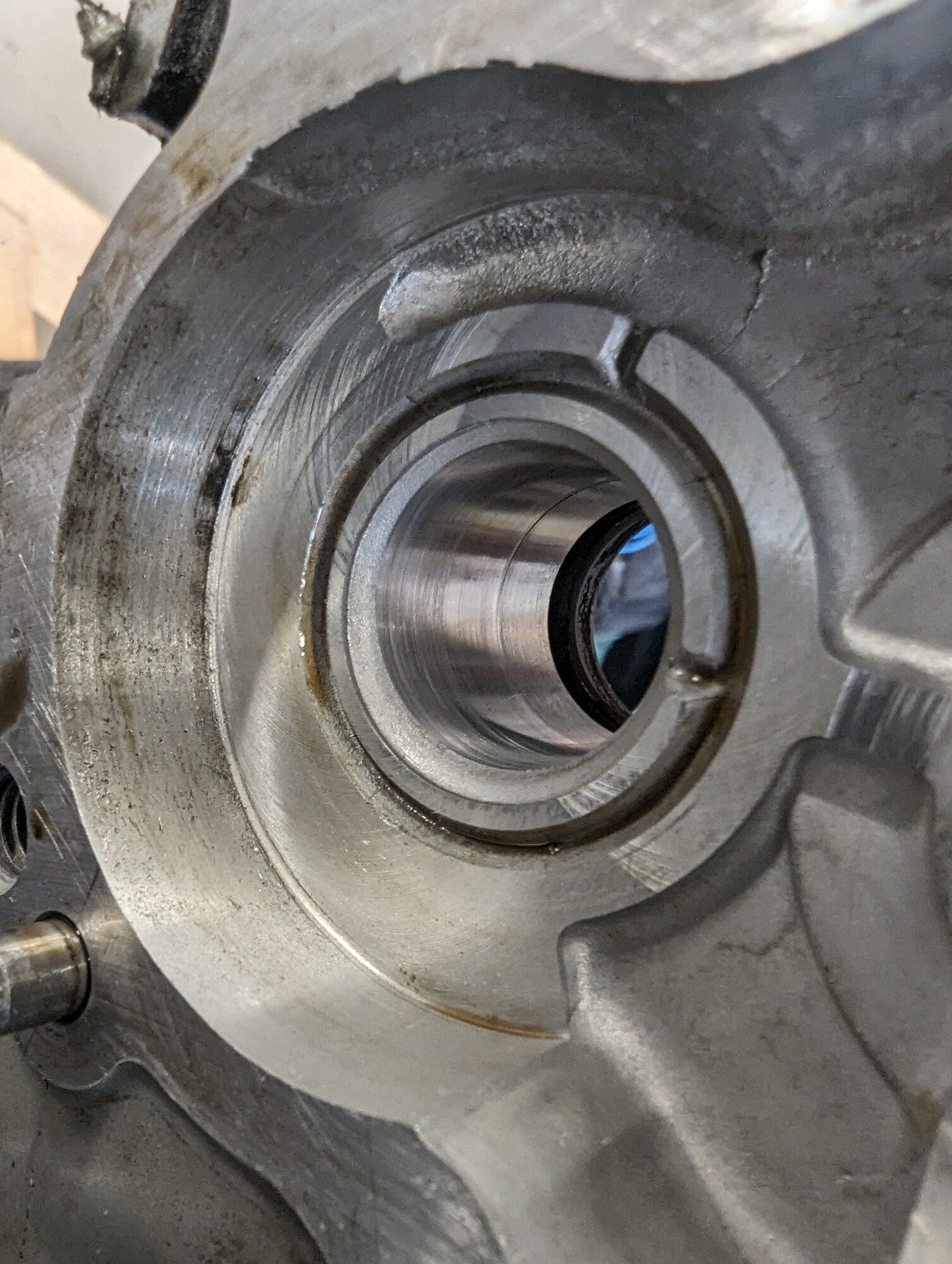

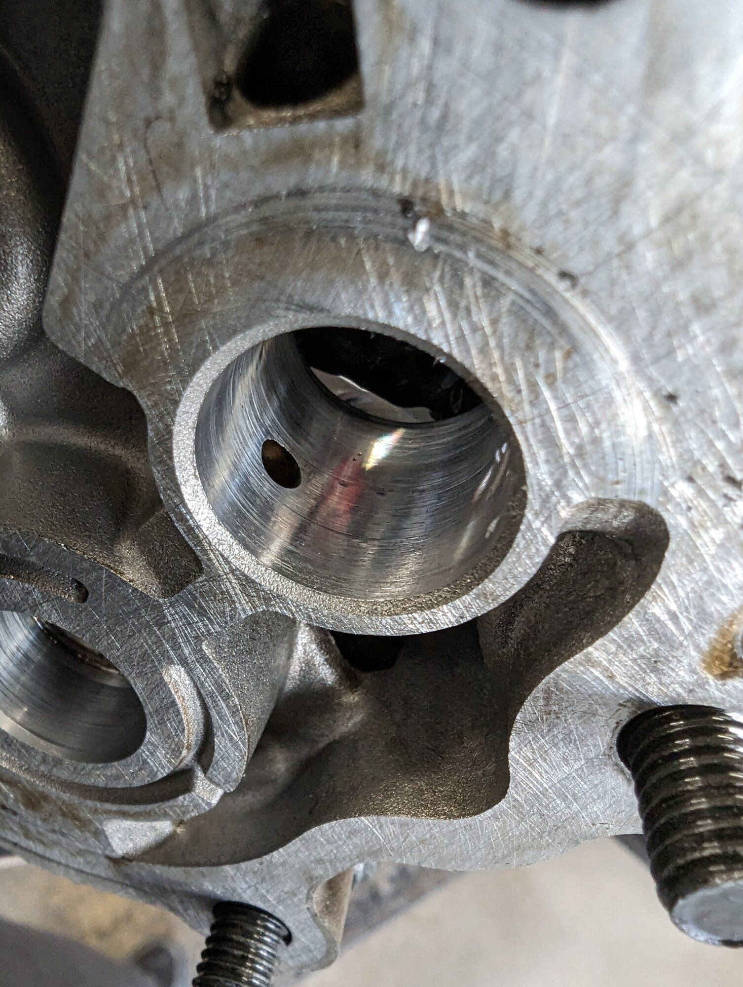

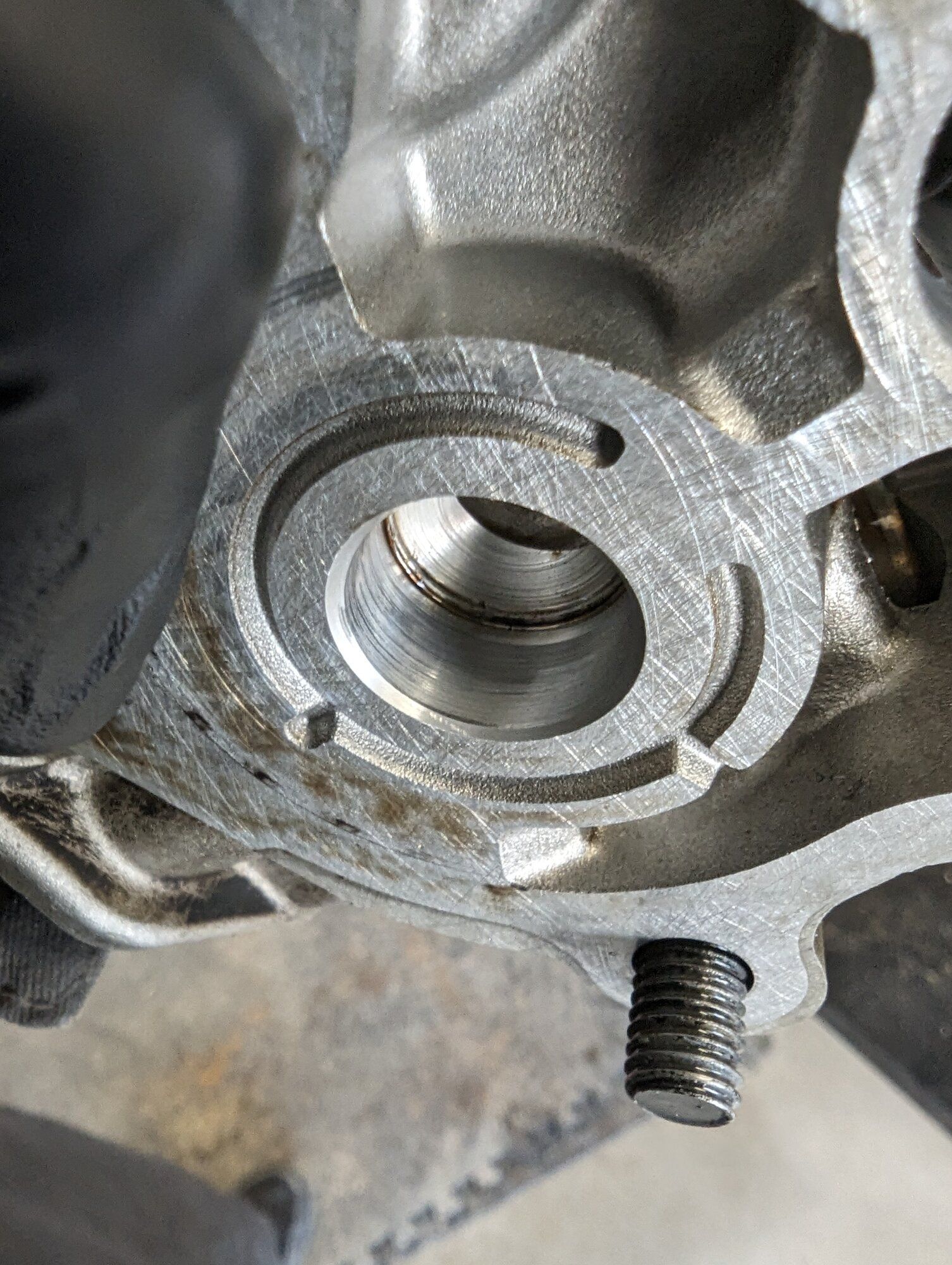

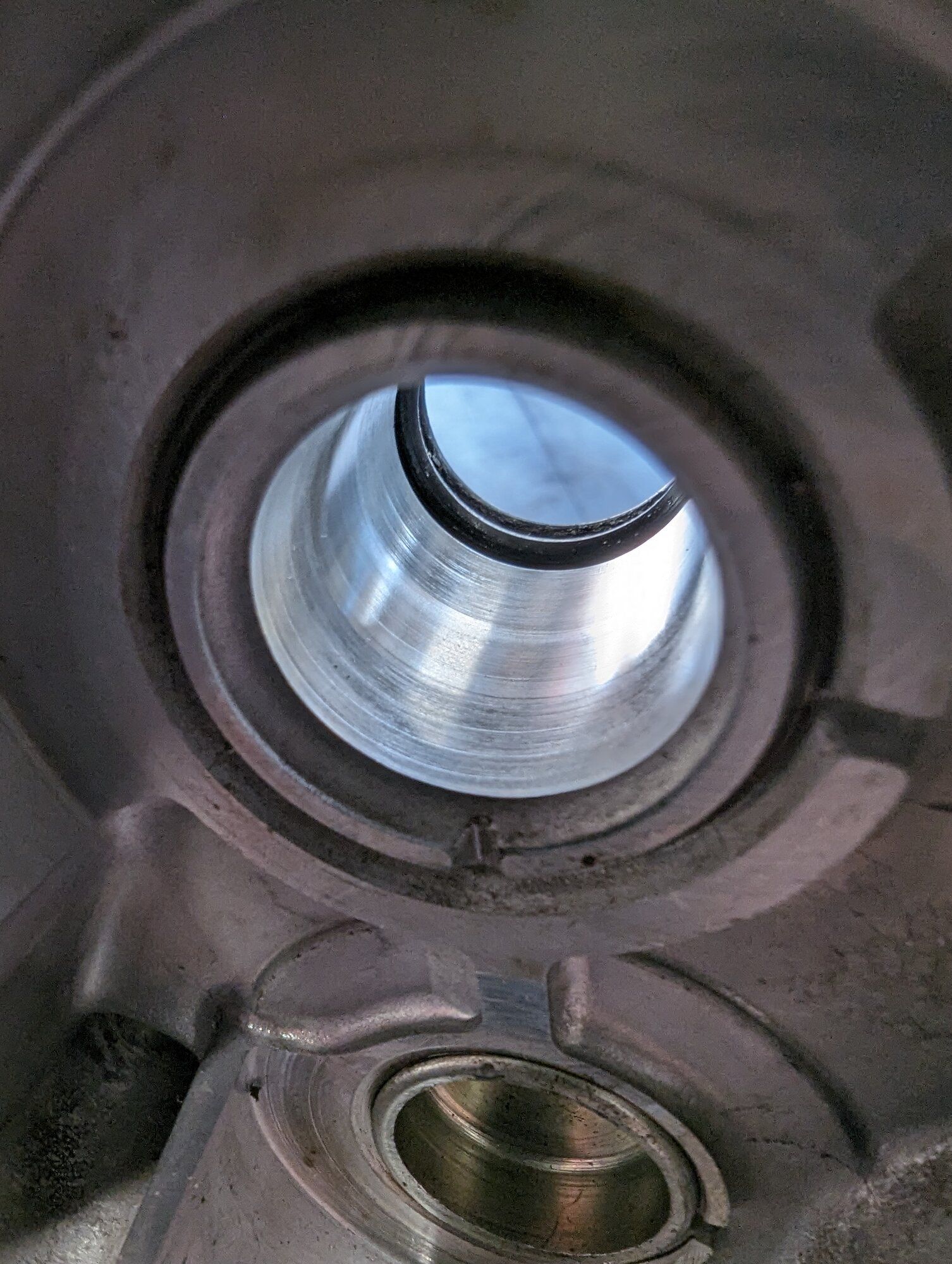

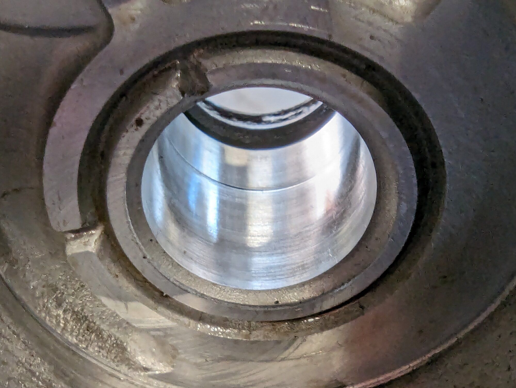

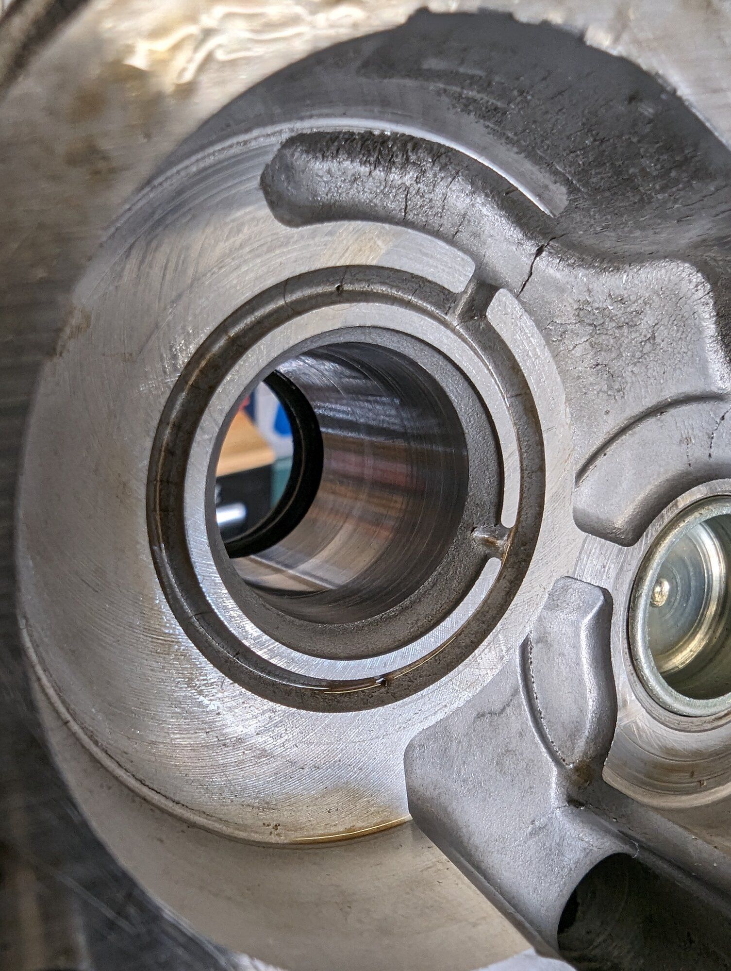

It's not a score inward, it's a ridge outward.
I don't see how an overtightened belt would make that happen, given its on the bottom and there's no damage to the bore anywhere else. It's totally smooth
Bottom:
Top:

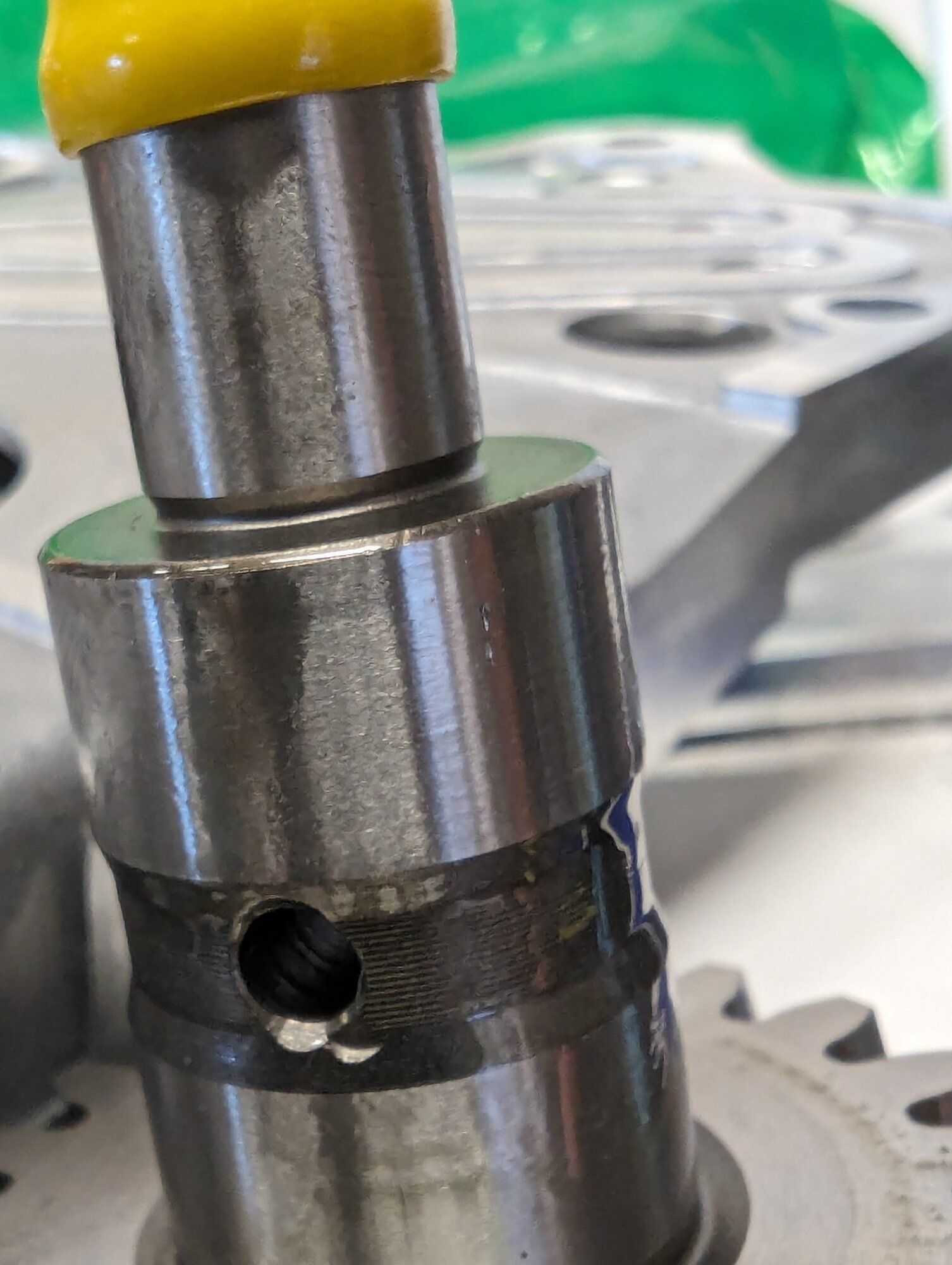

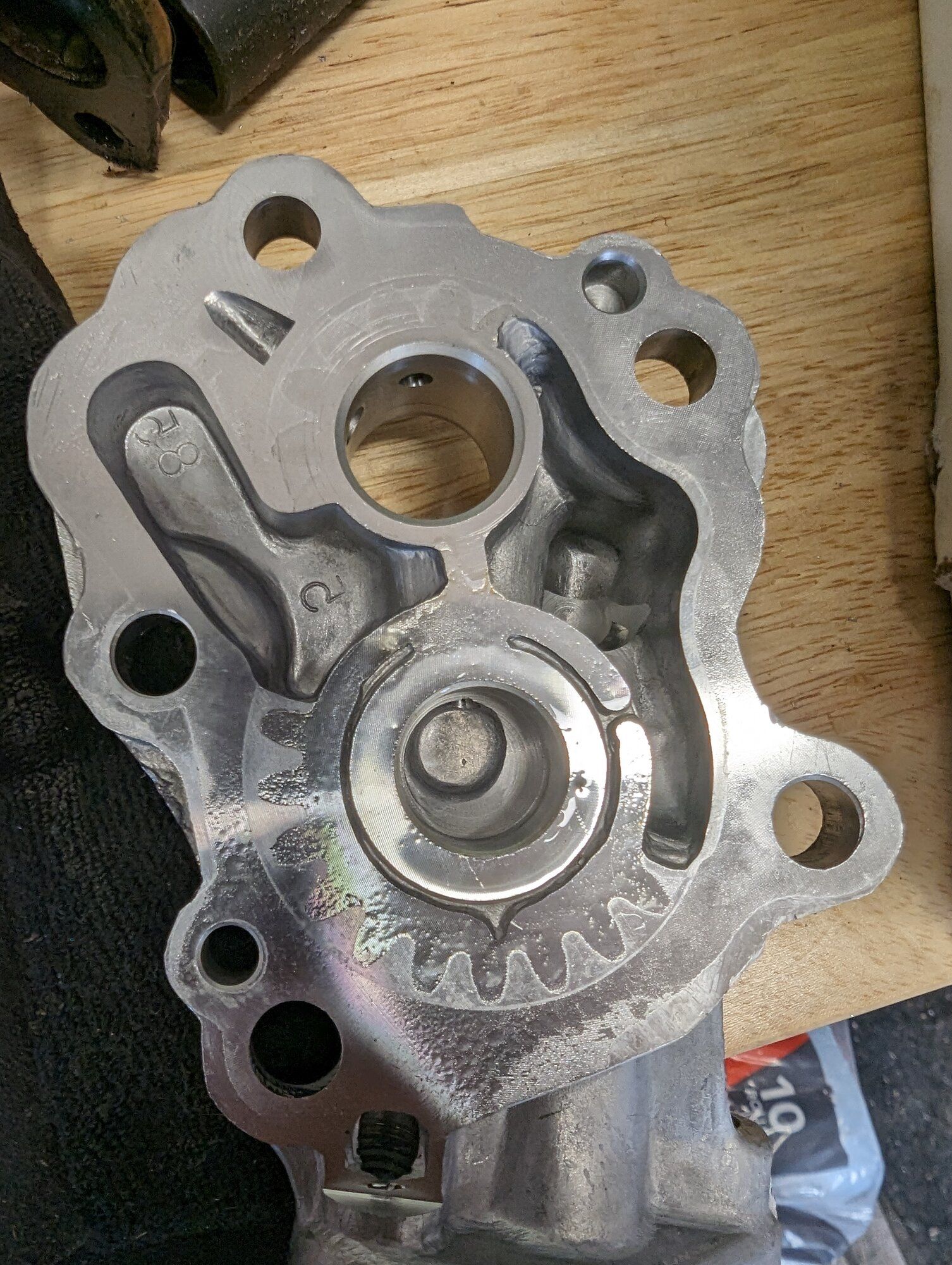

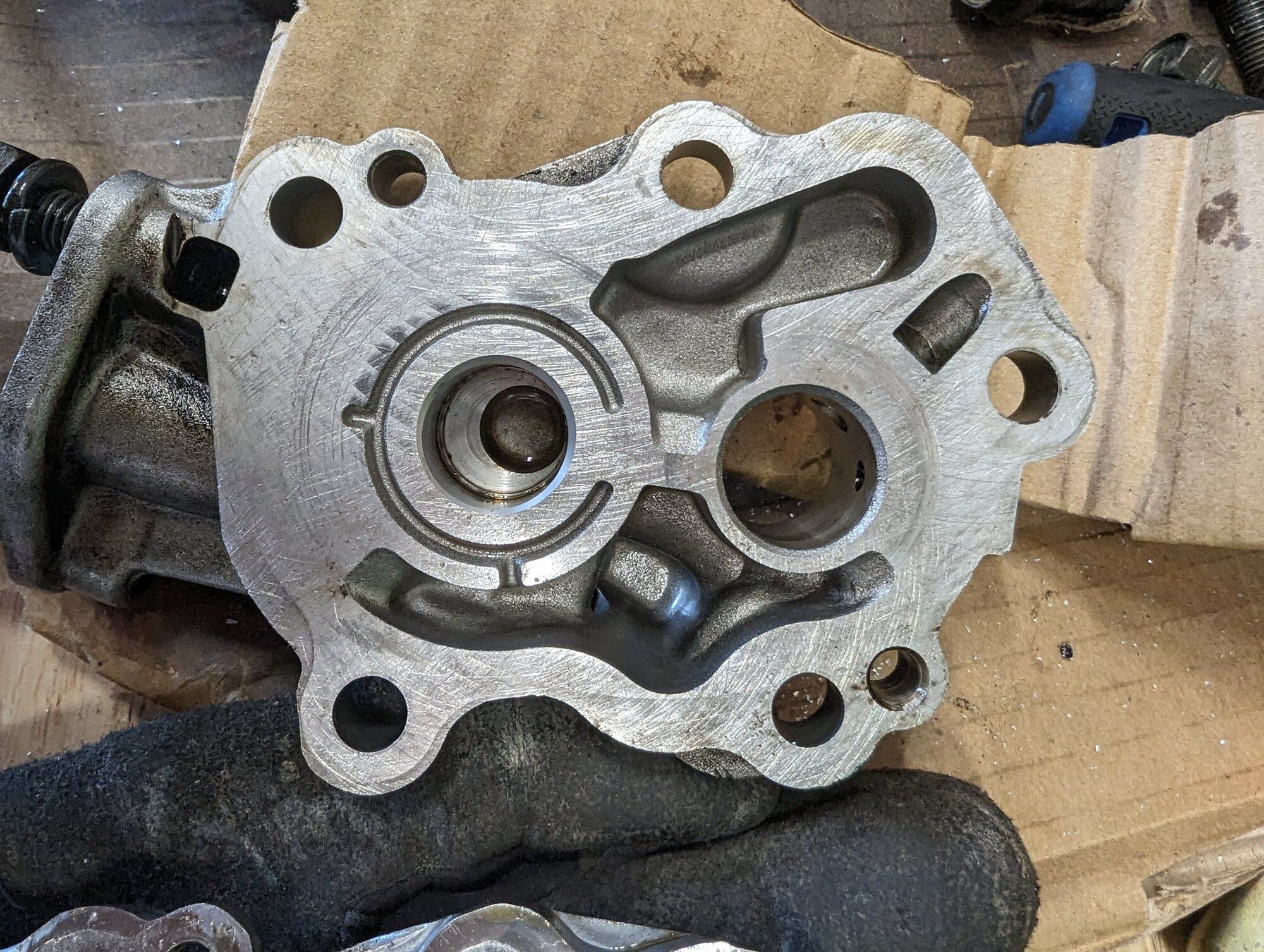

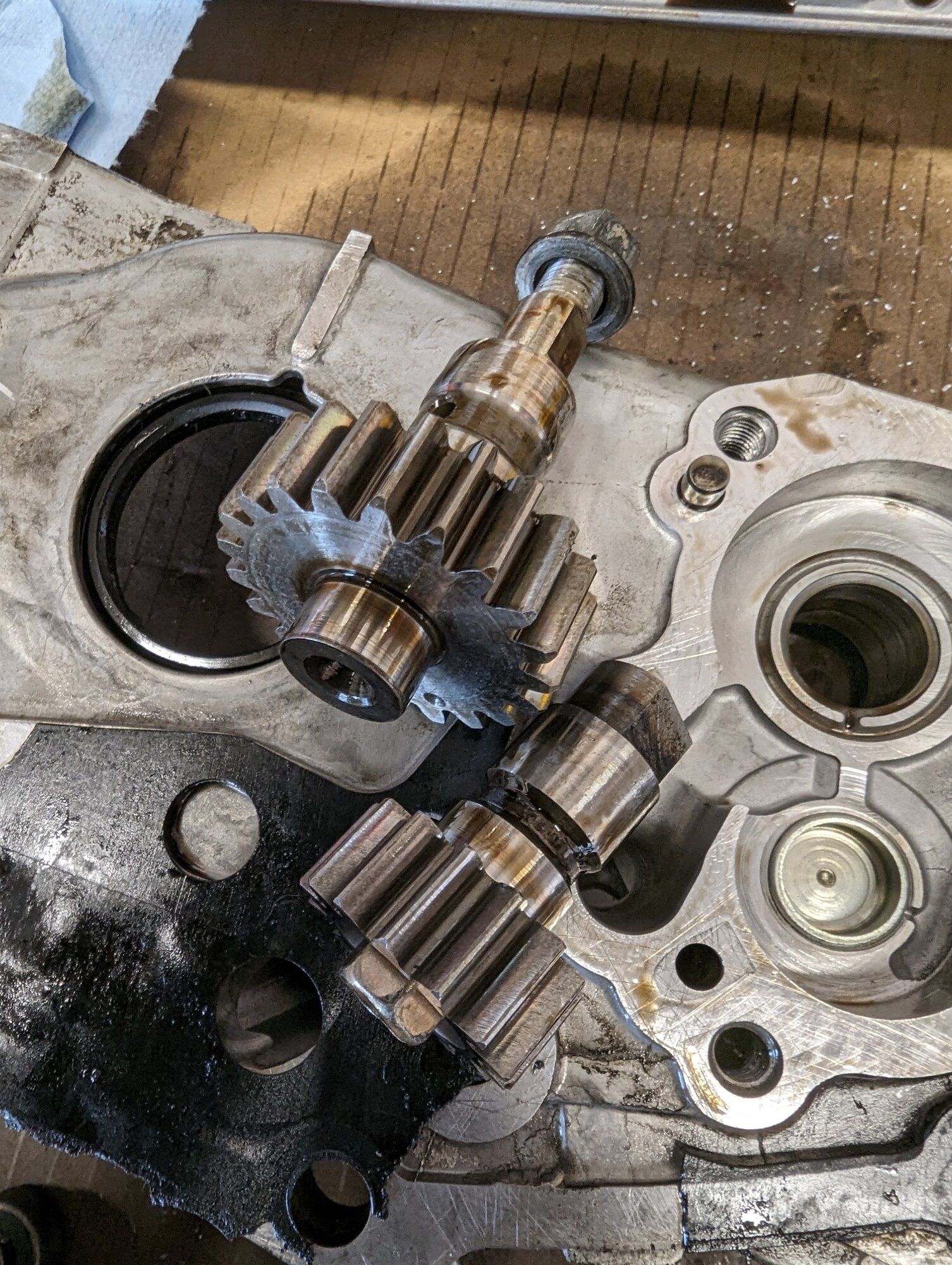

And in typical ACL fashion, quality control is shit
Something knicked the shaft, then they installed it, and it scratched the inner bore. Also, WTF, did they miss the mark drilling the oiling hole in the shaft the first time?
Also, the drive gear shaft is damn tight on the bore. It doesn't even feel or look like there's oil clearance. The other pumps have a slight side to side but nothing crazy, the ACL doesn't budge. How is oil, especially cold oil, even supposed to lubricate that entire surface...
I wonder if the bore isn't correct for the shaft diameter.

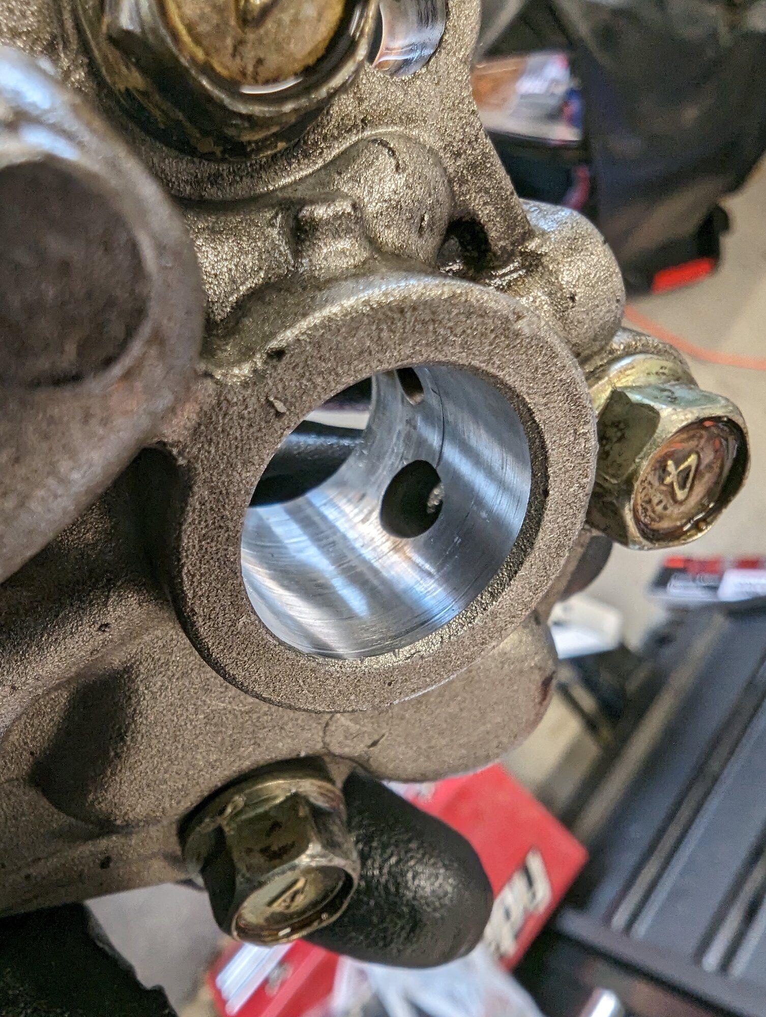

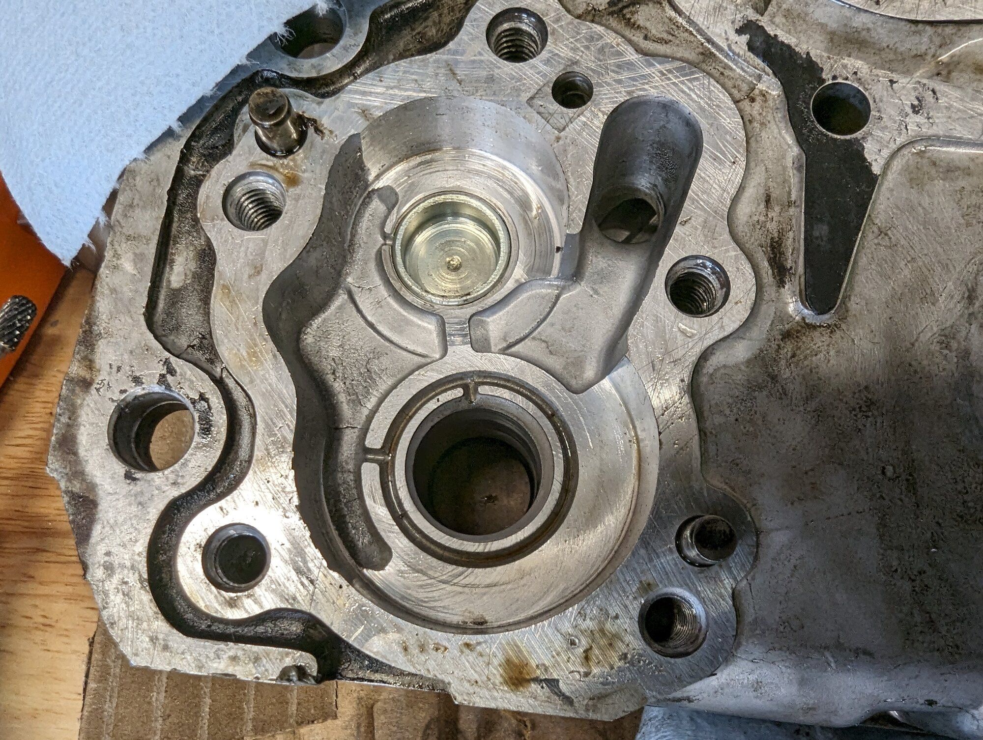

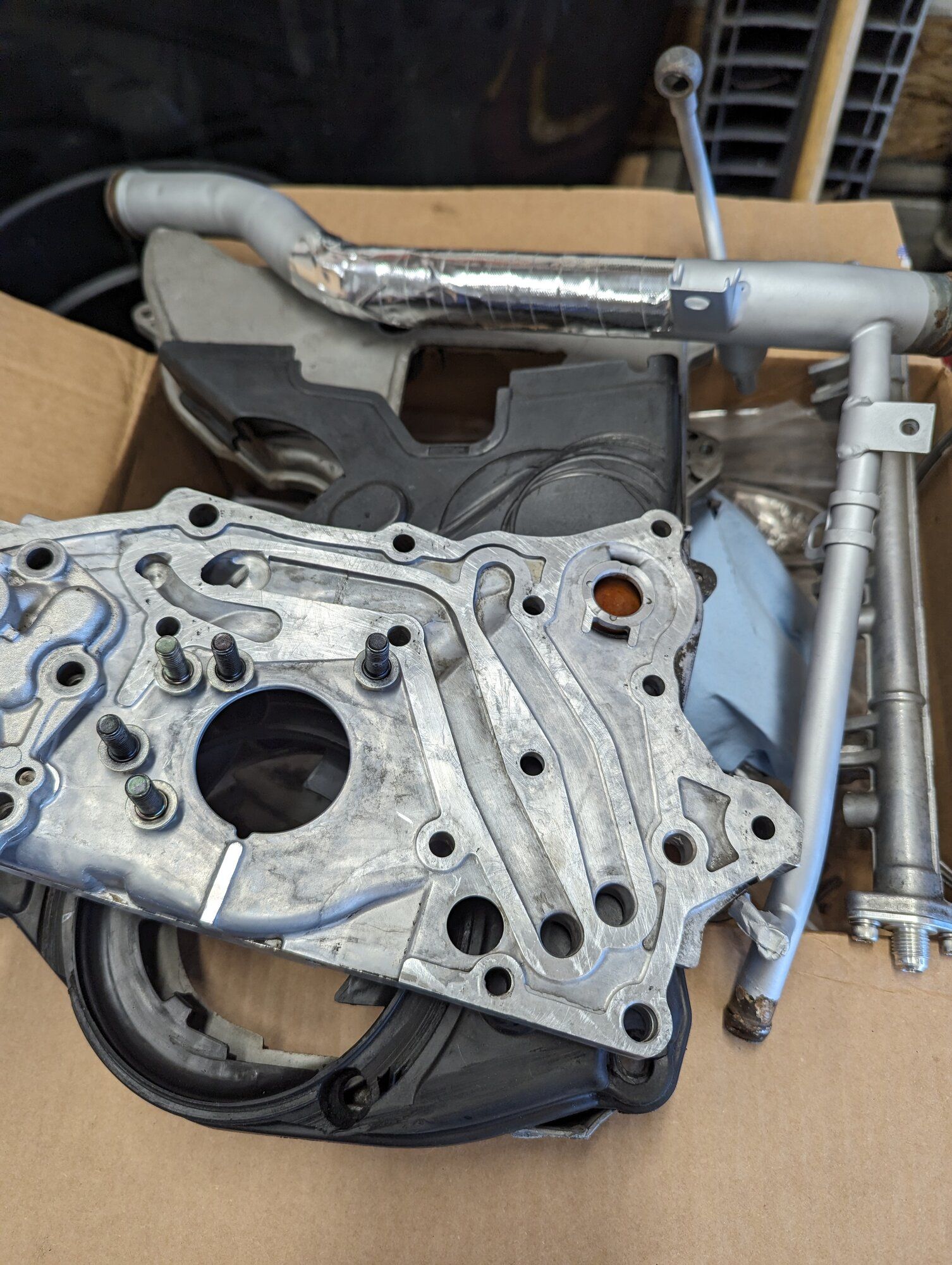

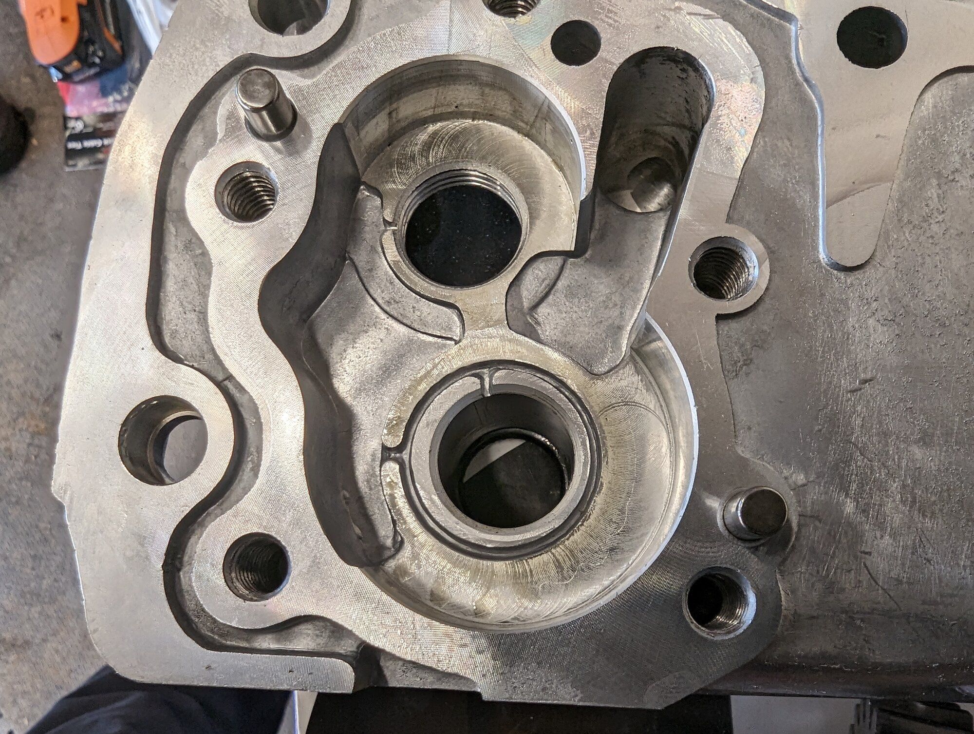

Decided that even though there's deepish gouge in one half of the front case's driven gear bore surface, I still feel better about that one than the one off my other motor or the new ACL. The oiling passages of both of those for the gear surfaces are so small compared to what I figure is this oem case and pump. Pictures are above which explain what I'm on about.

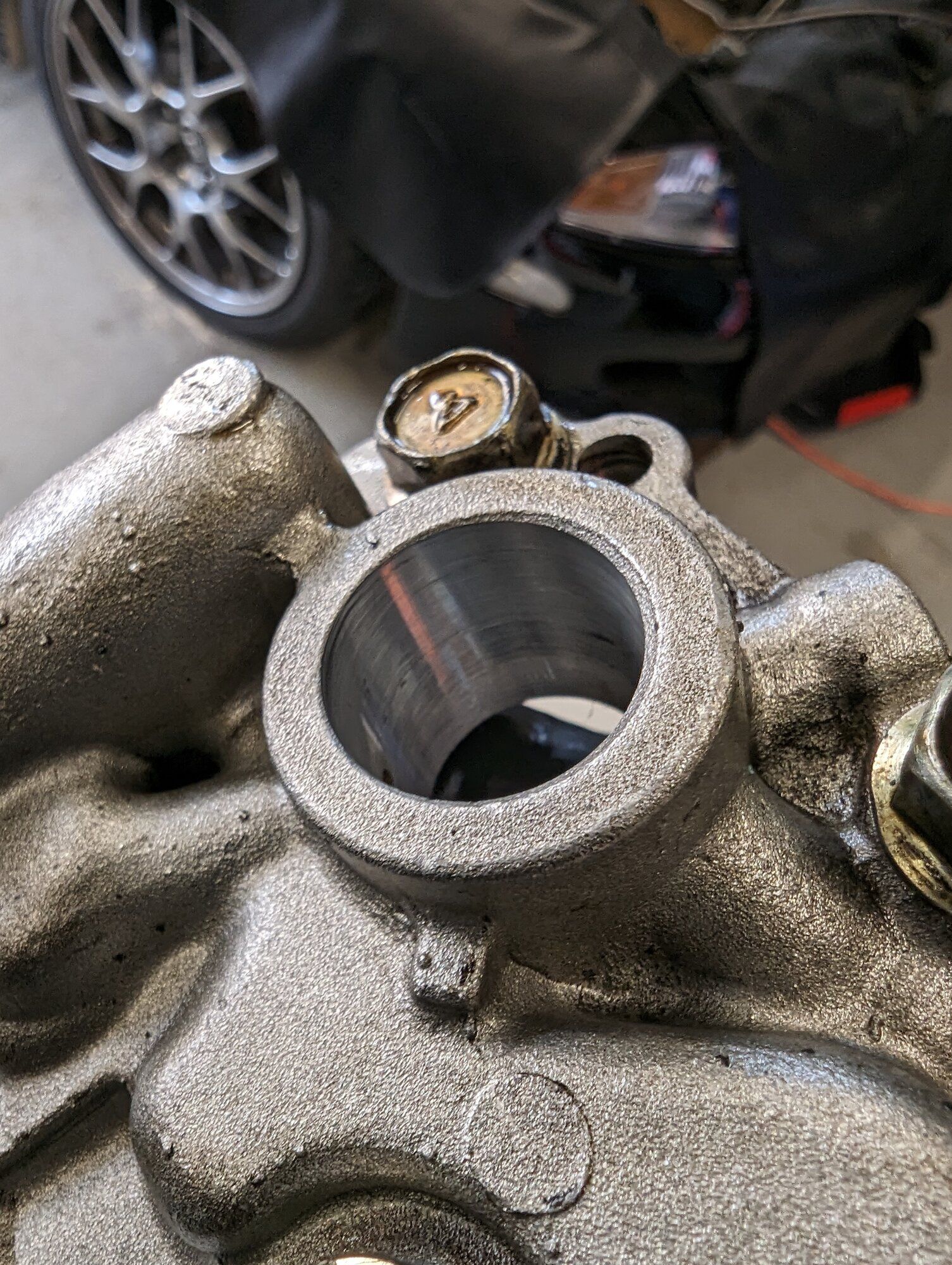

Cleaned and gave the water pipe a clean and gave it a shot of high heat silver, then wrapped the area nearest the turbine housing with some heat reflective tape. Did not paint the area where it's wrapped.

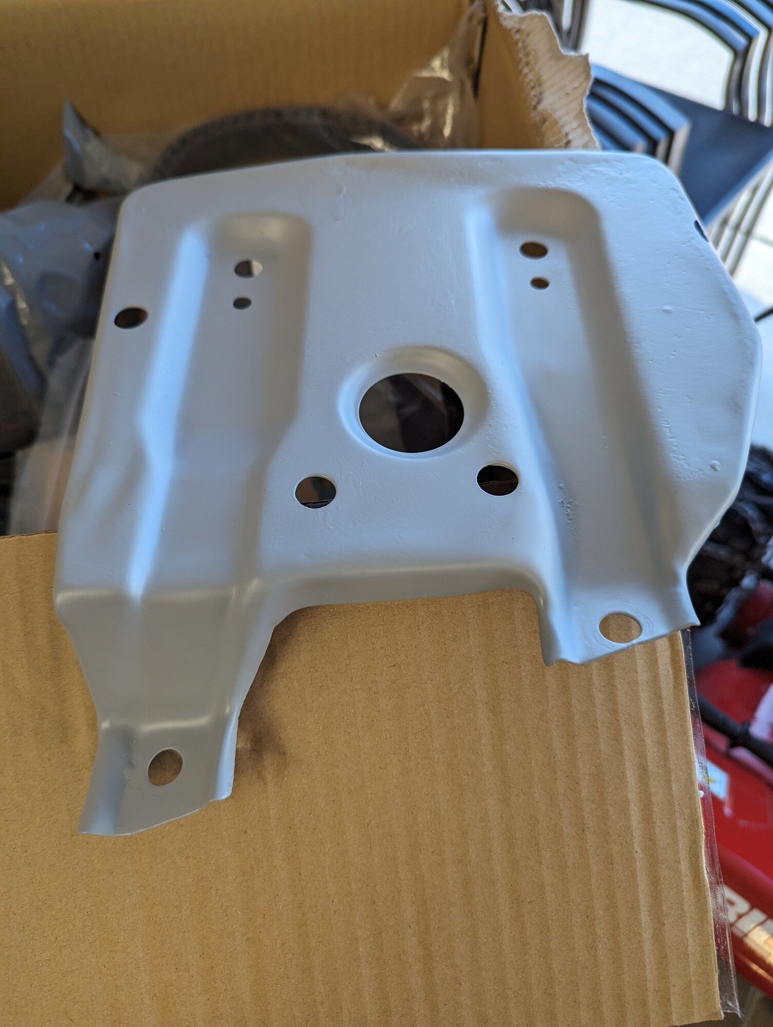

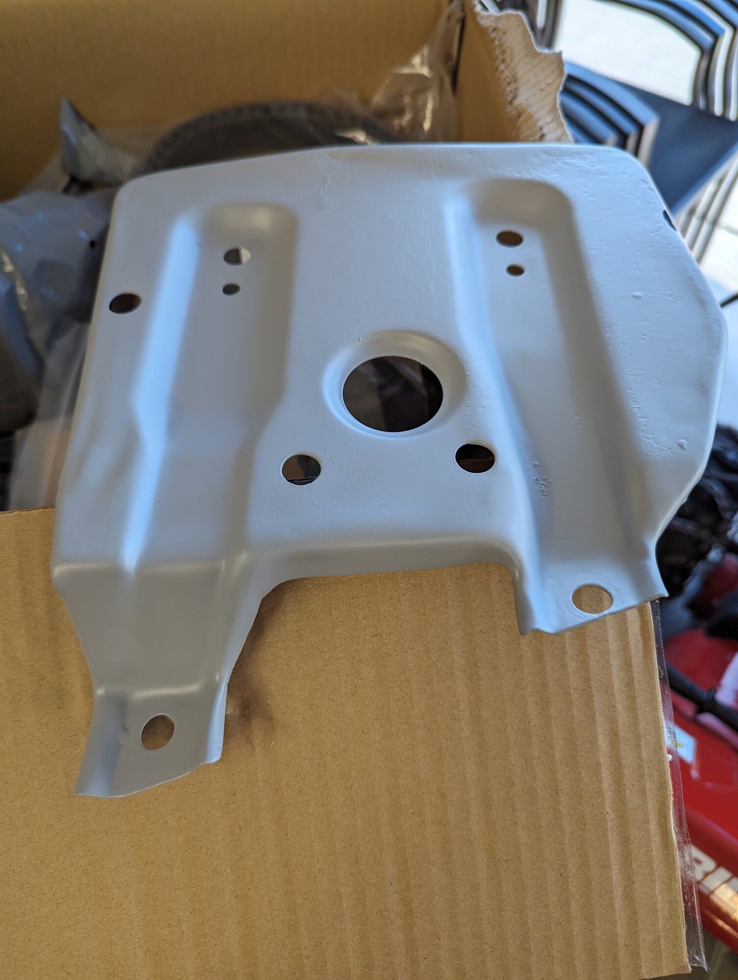

Cleaned up the rust and primed battery tray. Painting tomorrow

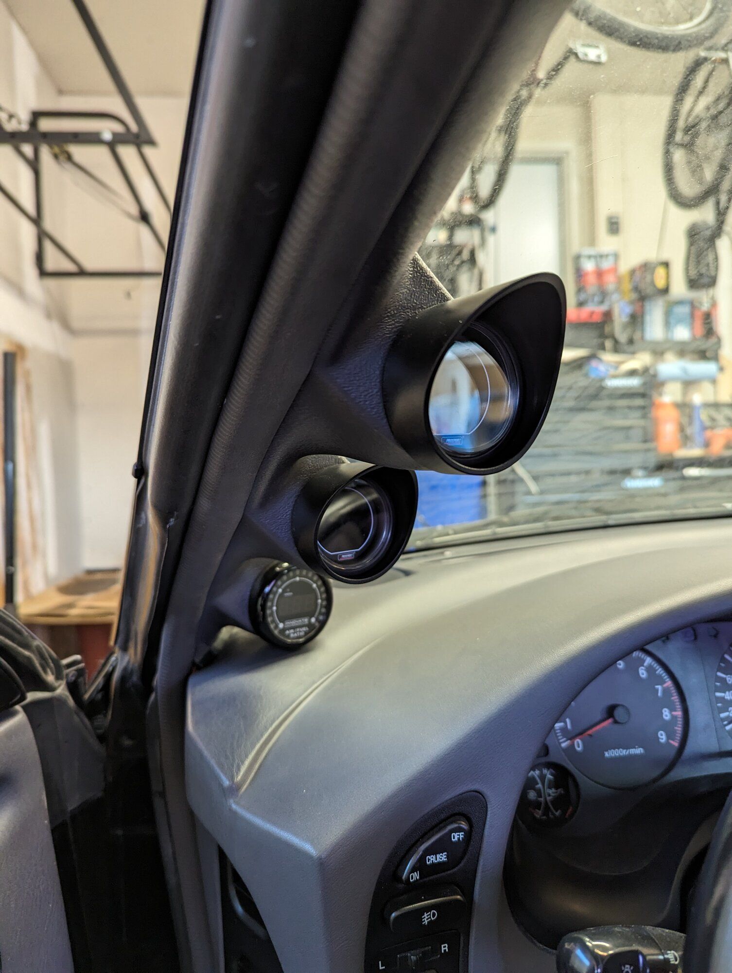

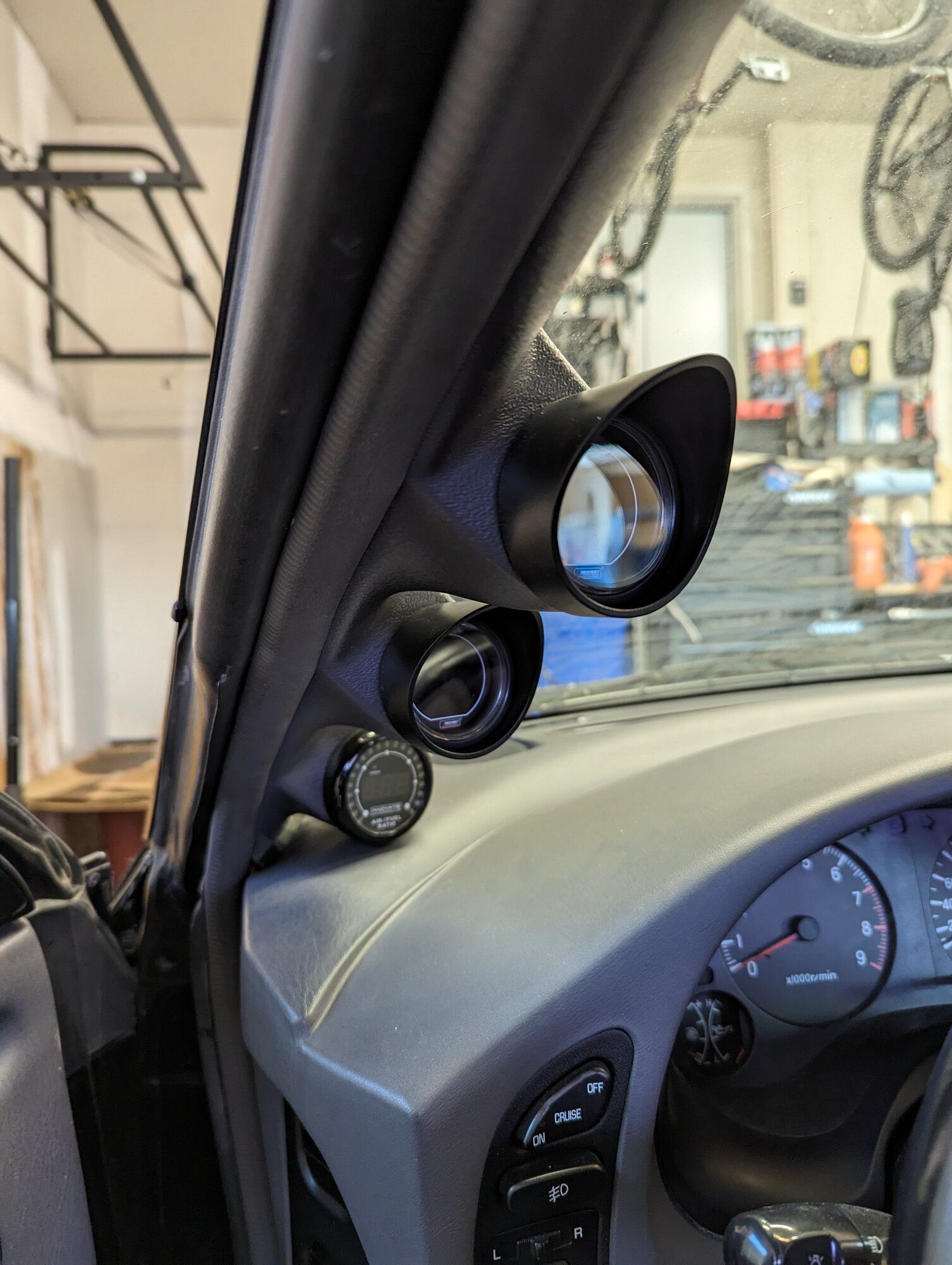

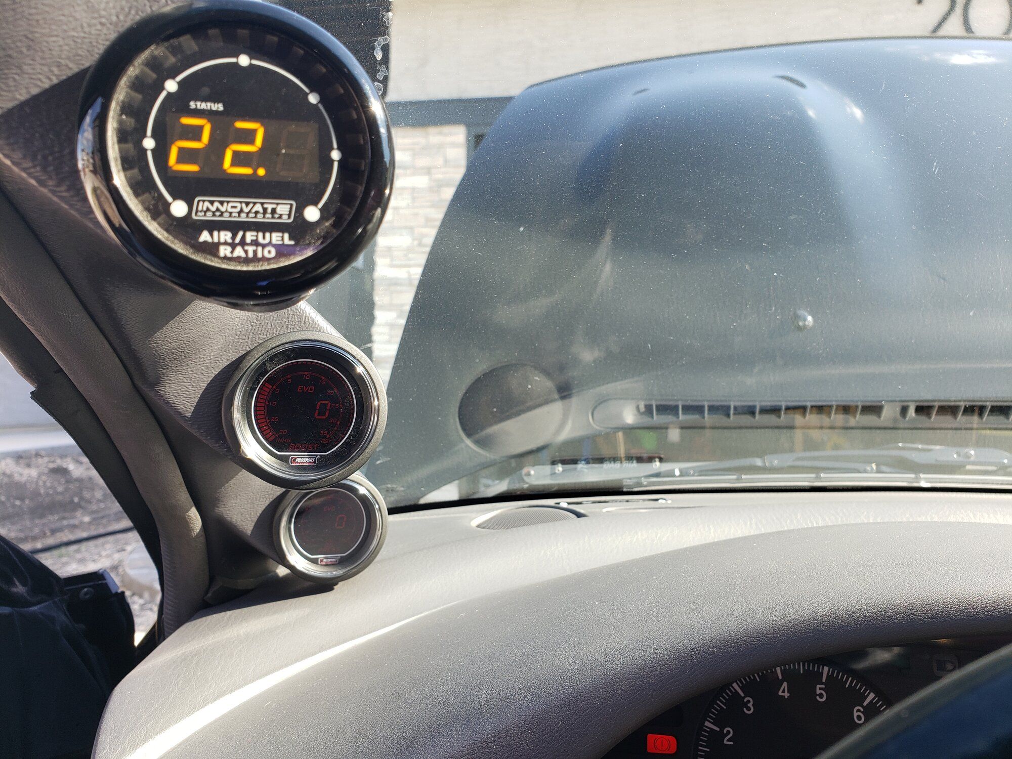

Finally added the hoods to the prosport Evo gauges. I don't know how much it will end up helping to find daylight washout but we will see.

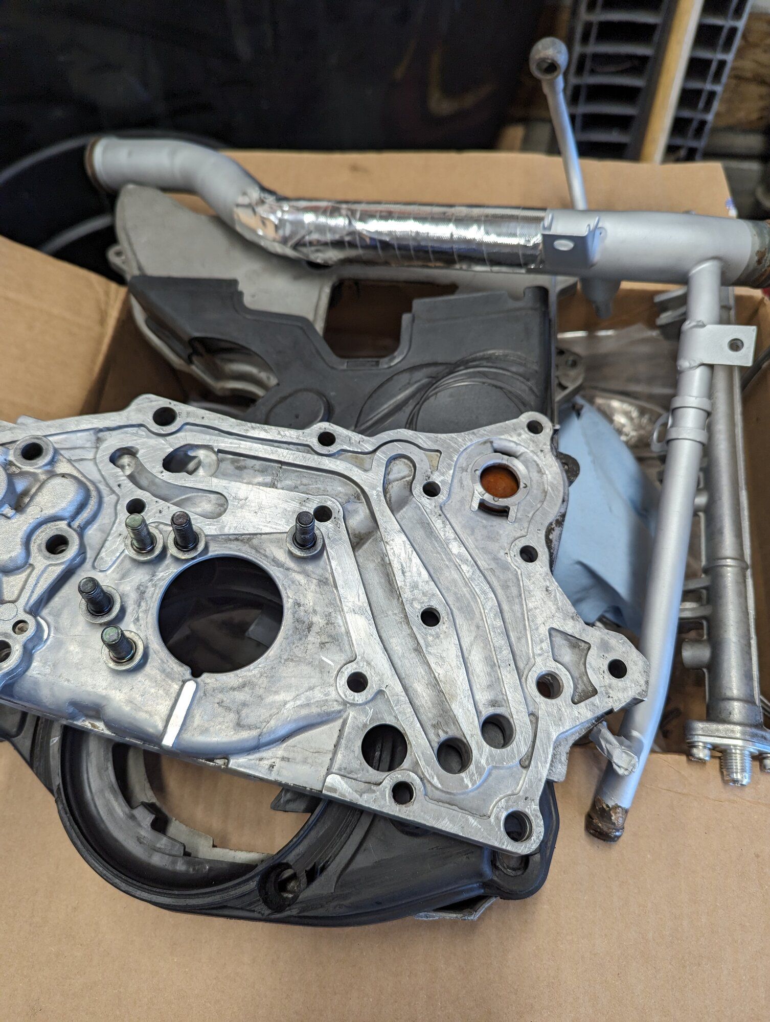

Spent another afternoon mostly cleaning but also some fun bits.

Here's the washout I mean. It's gross. I sent this to prosport and basically they didn't give a shit or offer anything helpful. But it's both gauges and their brightness dials are maxed out.
I'd love to find a good instrument cluster gauge holder rather than using a triple pillar, but it's what I gots. I don't now how well the glowshift one fits and it's nearly $100 to find out.. so this year is just getting it back running.
Can make it more perfect next year.

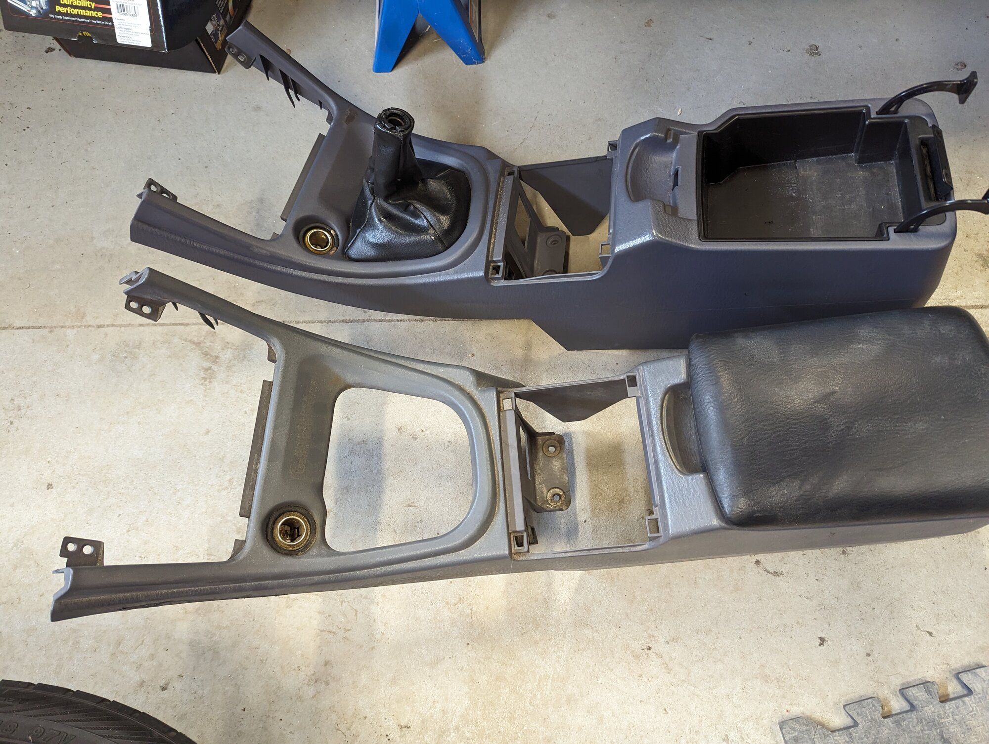

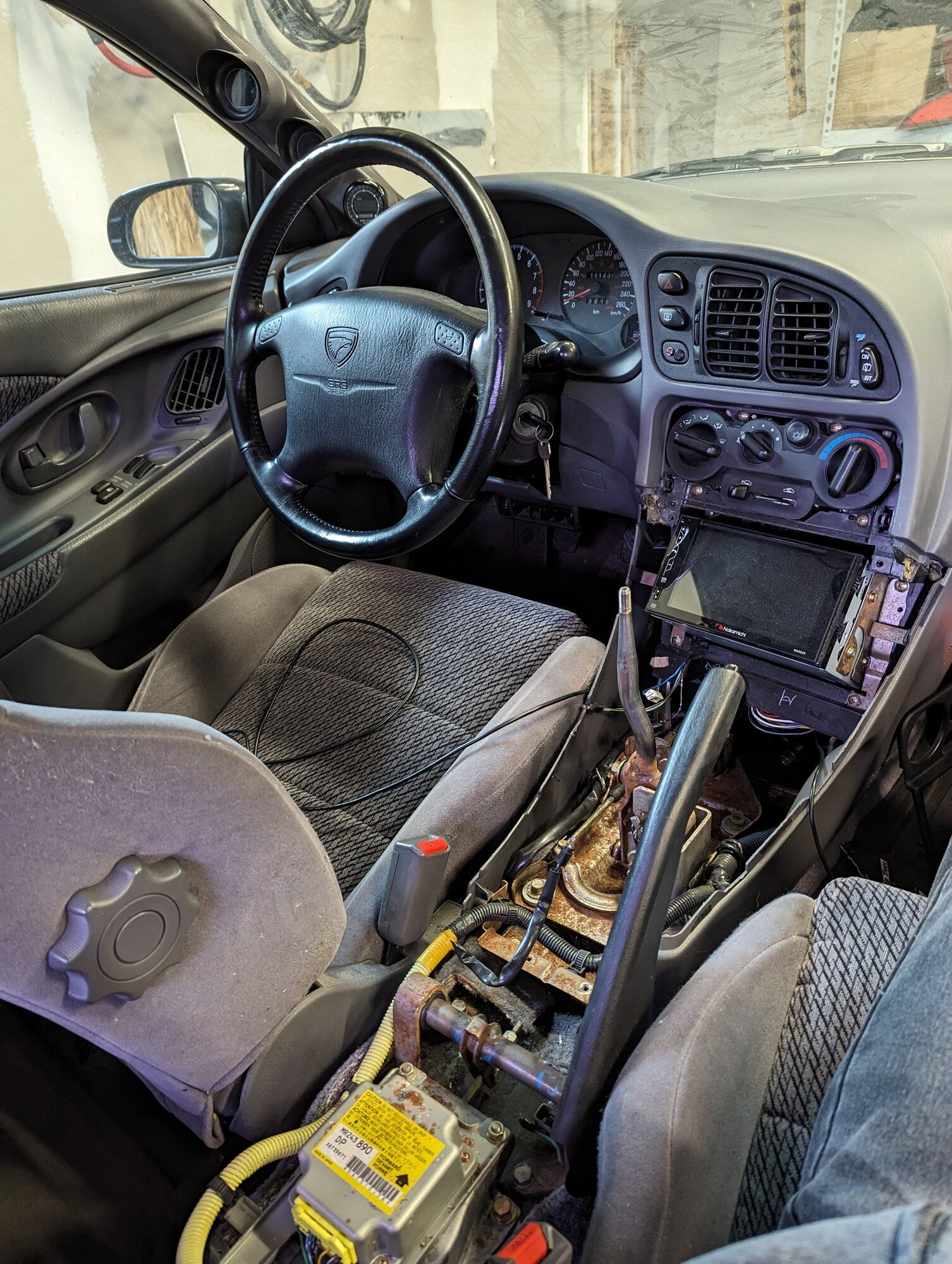

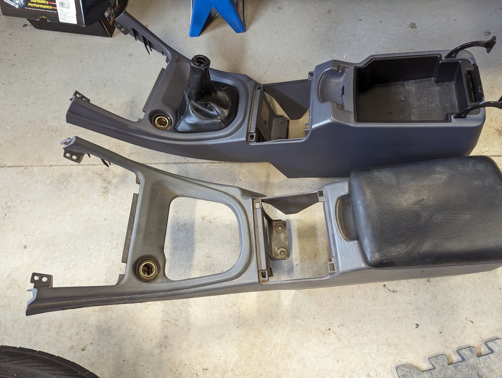

Removed center console to replace with the proper grey one.
Can see just what kind of colour difference
Needs a good cleaning and some crack repair. Bonus? JBweld is the exact same shade of grey.
Fills cracks nicely.
It's the small things isn't it? Love it.
Absolutely, was a nice surprise. So I parted the crack best I could but wasn't afraid of smearing the jb into the crack and on the surface, then just wiped off the surface. Leftover residue, if any, is the same shade so cleanup is .. well, practically nothing.
Going to use this as an opportunity to put some thin double sided foam just to dampen plastic-plastic vibrations. Will it help? Maybe not, but I'll think it does, and that's enough for me.

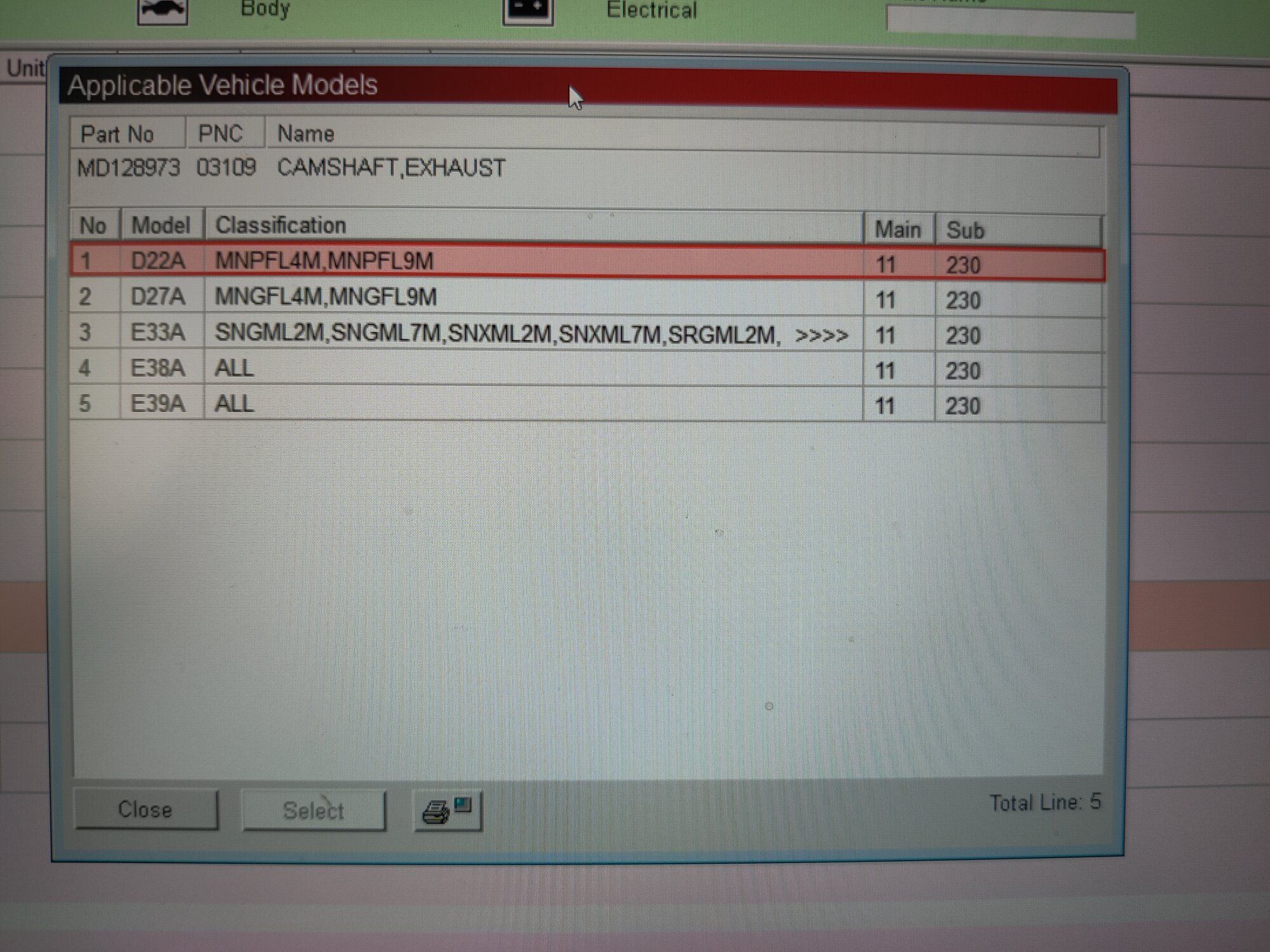

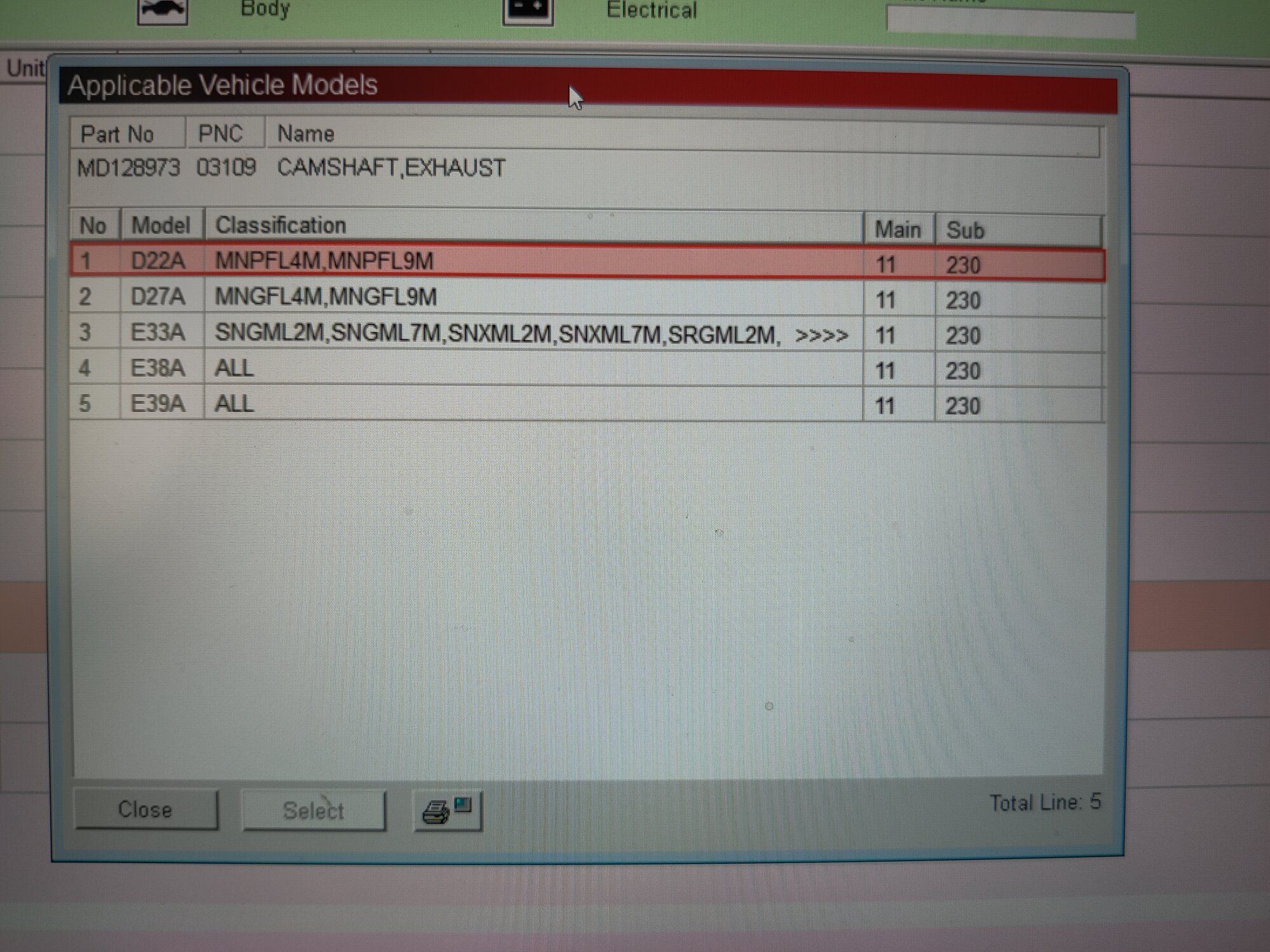

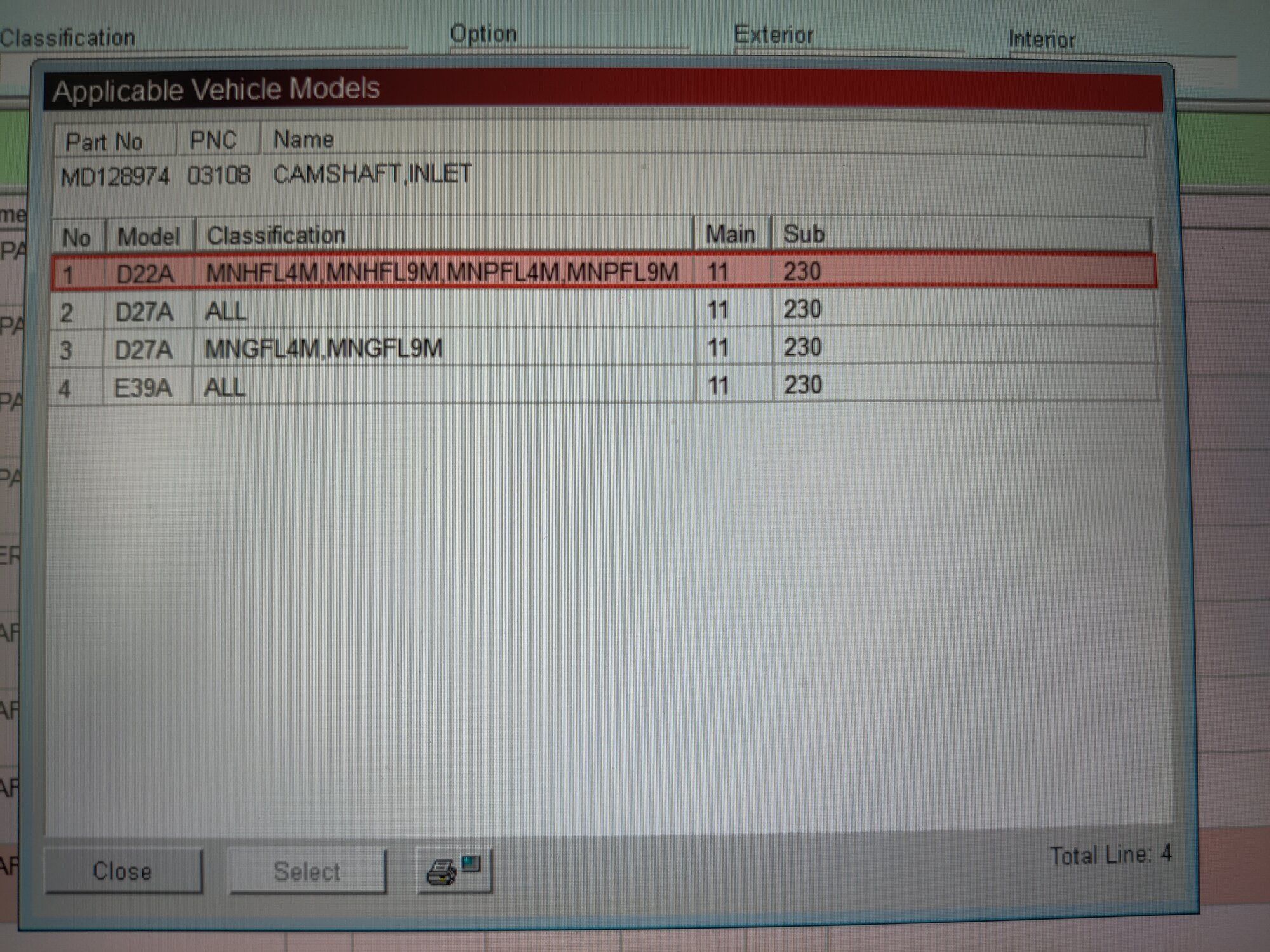

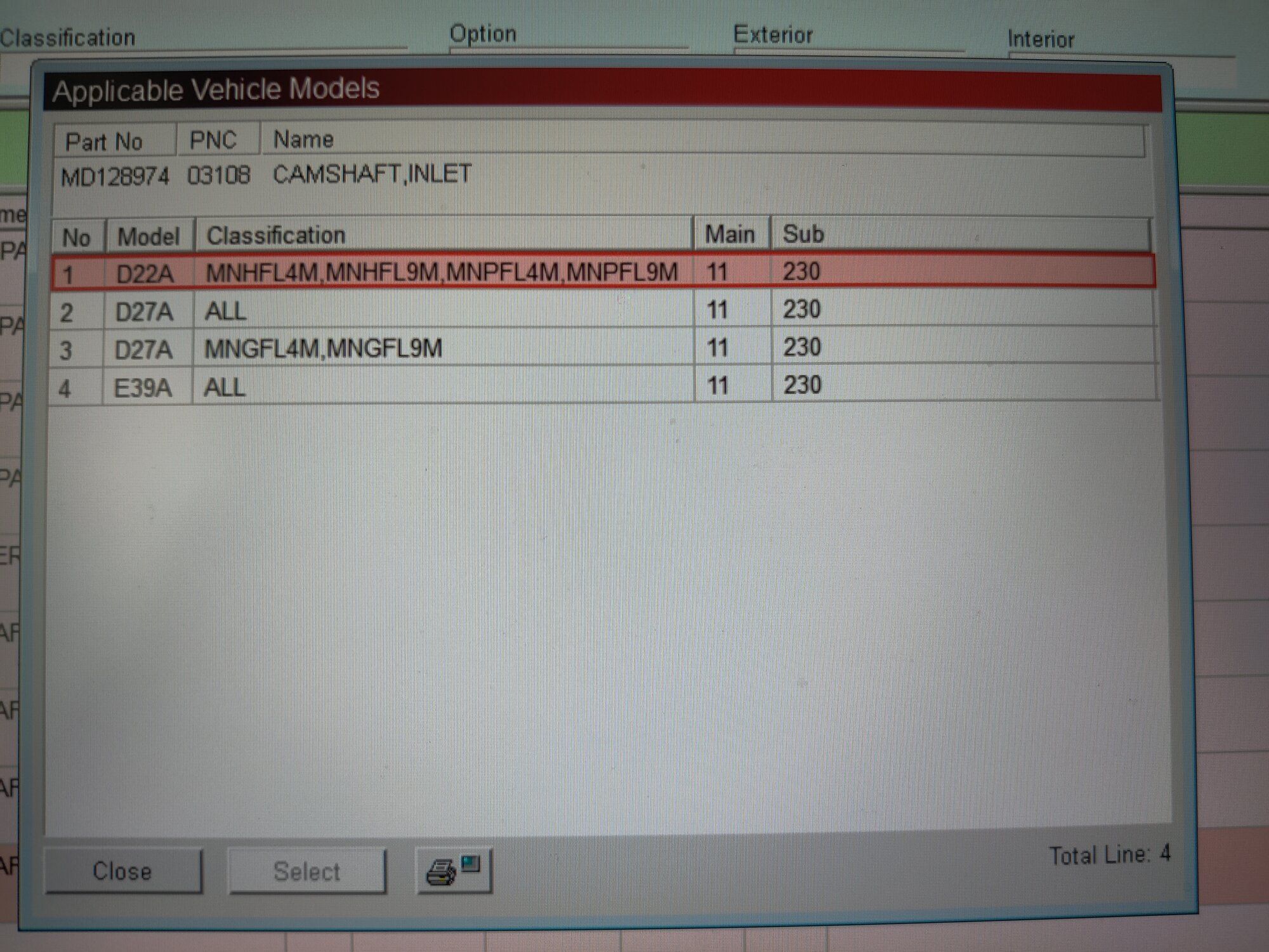

Will do. Looks like 1g and vr4 camshafts have the same part number. I remember back in the day hearing about people using 1g cams in a 2g for a small gain but don't know how true that is.
View attachment 730422View attachment 730423
Does that cover the Evo GVR4 that had the higher output ? I wonder if that was just the 16g or a combo of turbo and cam. Little information is available publically about that particular beastie, and some contradictory.

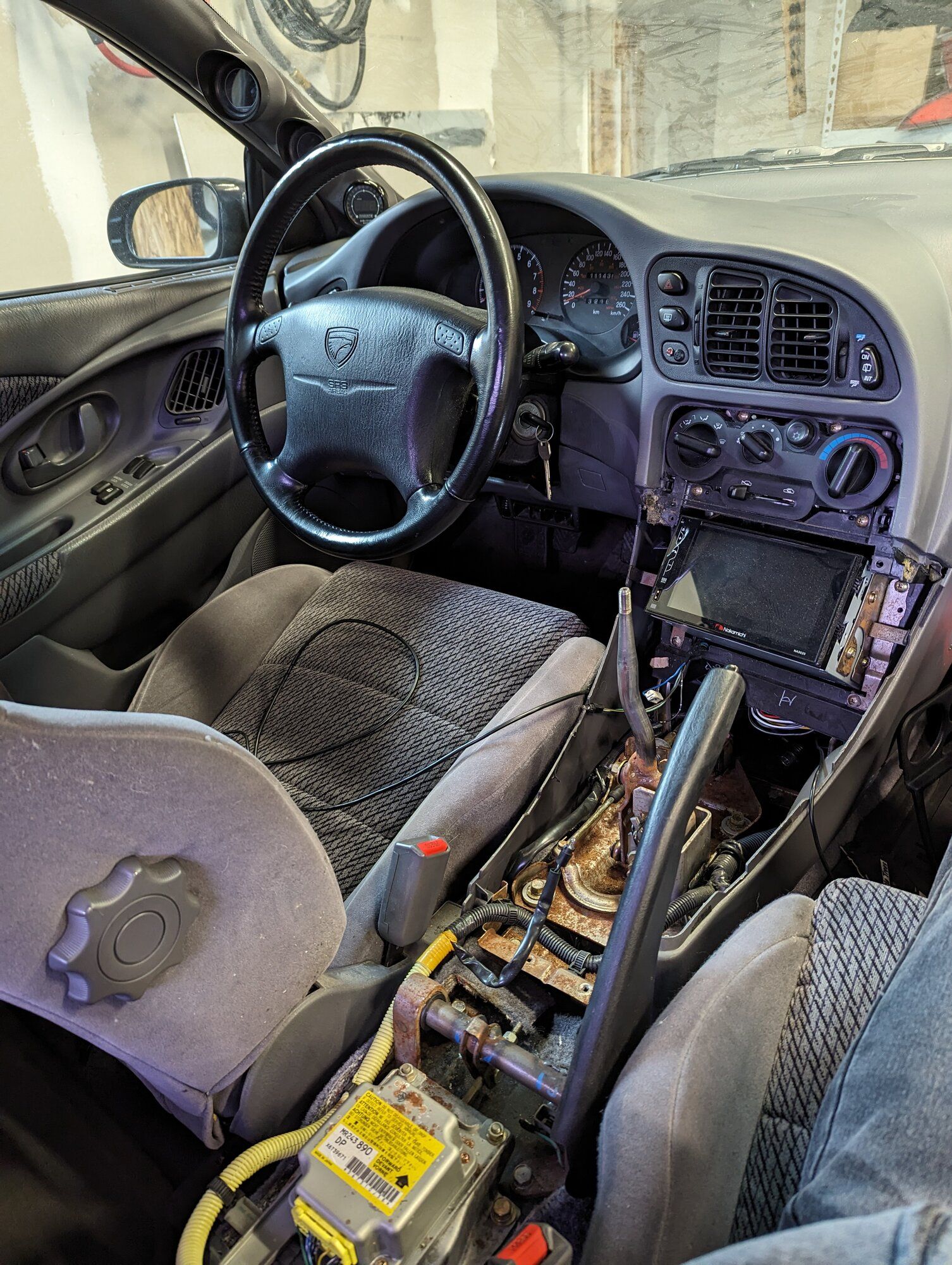

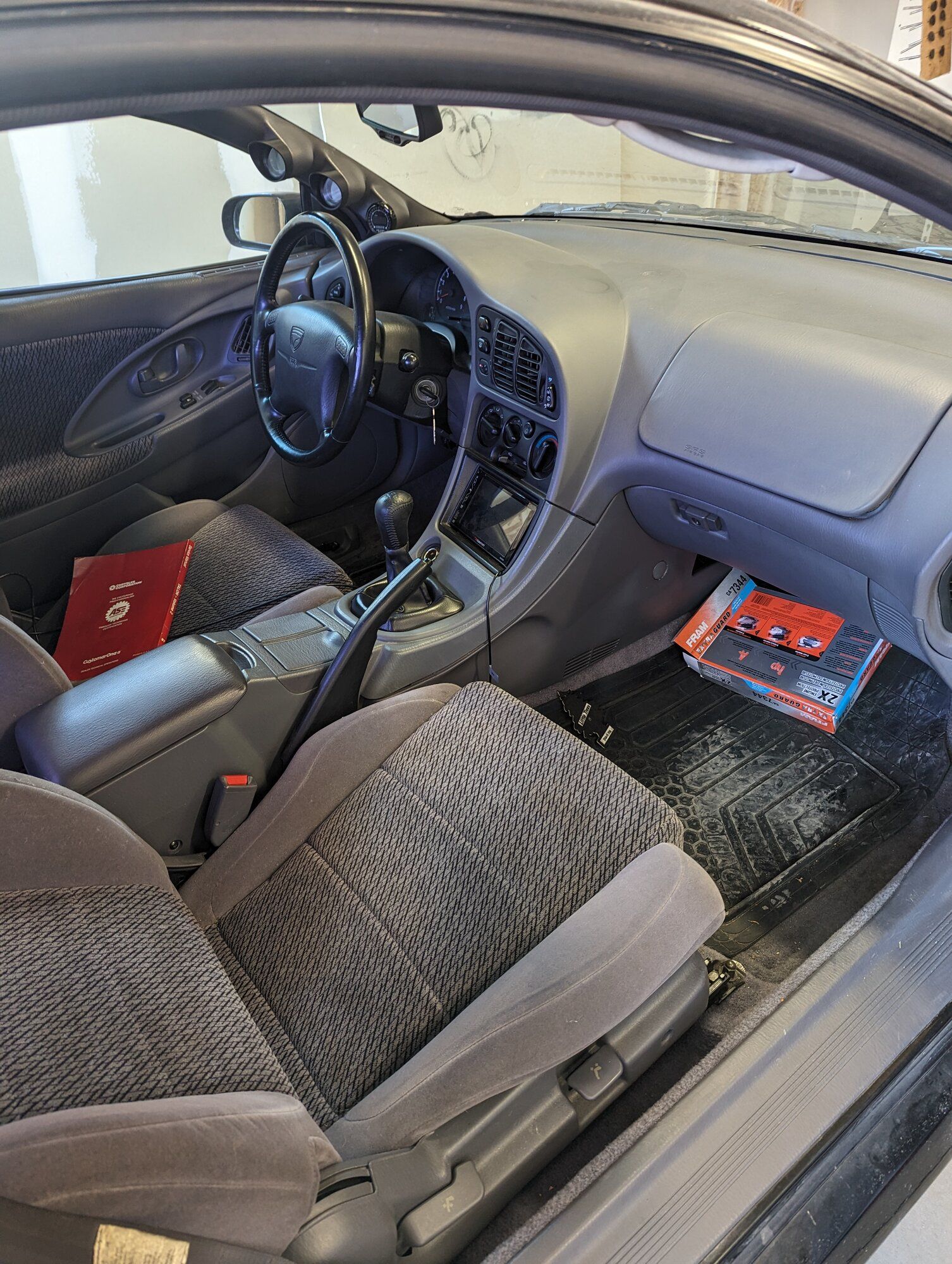

Cleaned up the replacement center console and installed it.
Gave the battery tray a shot of gloss black hi temp.

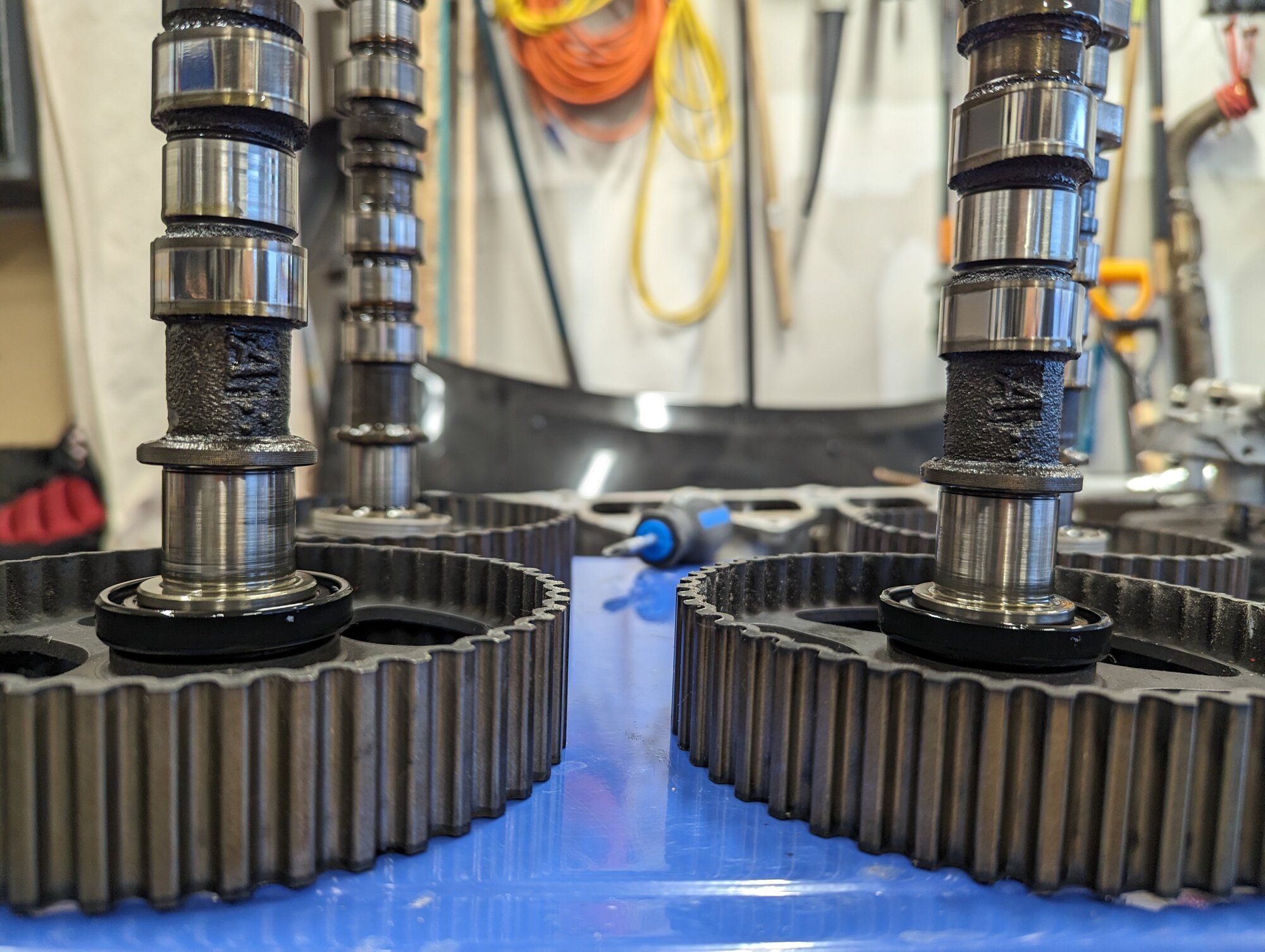

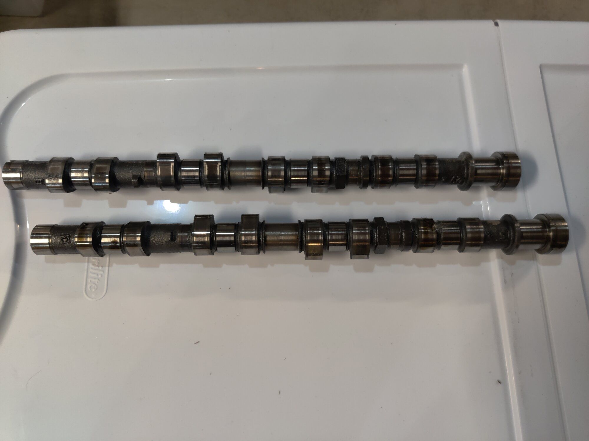

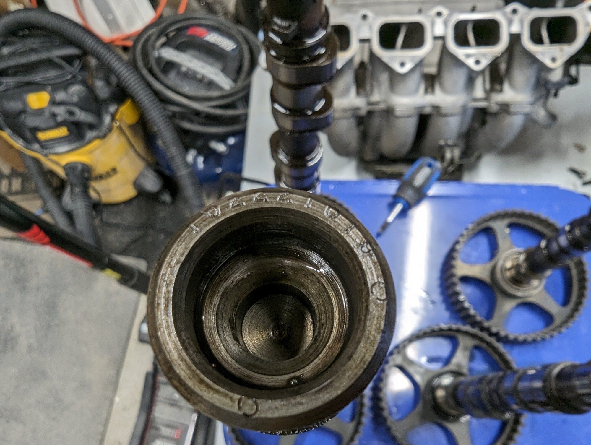

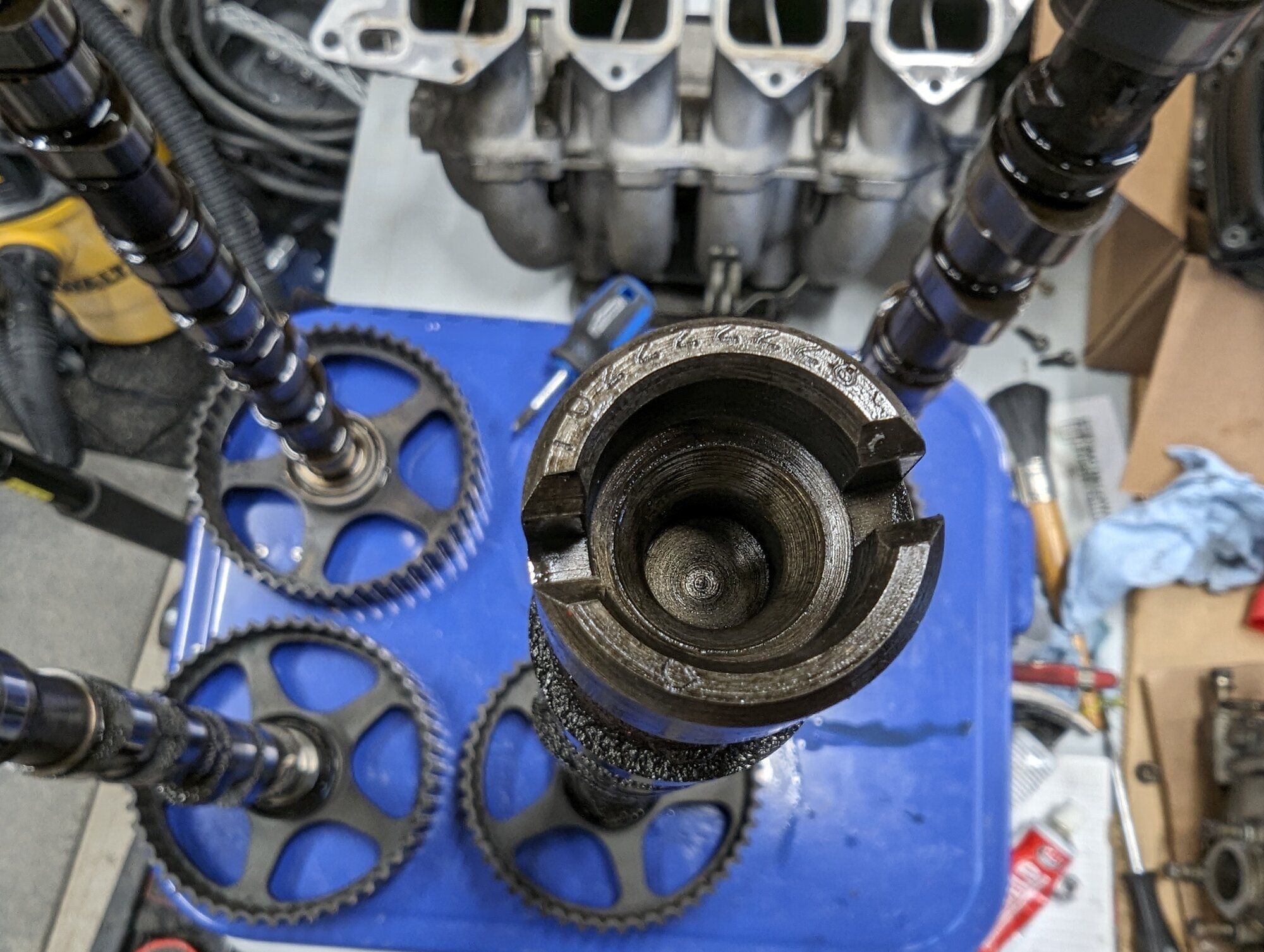

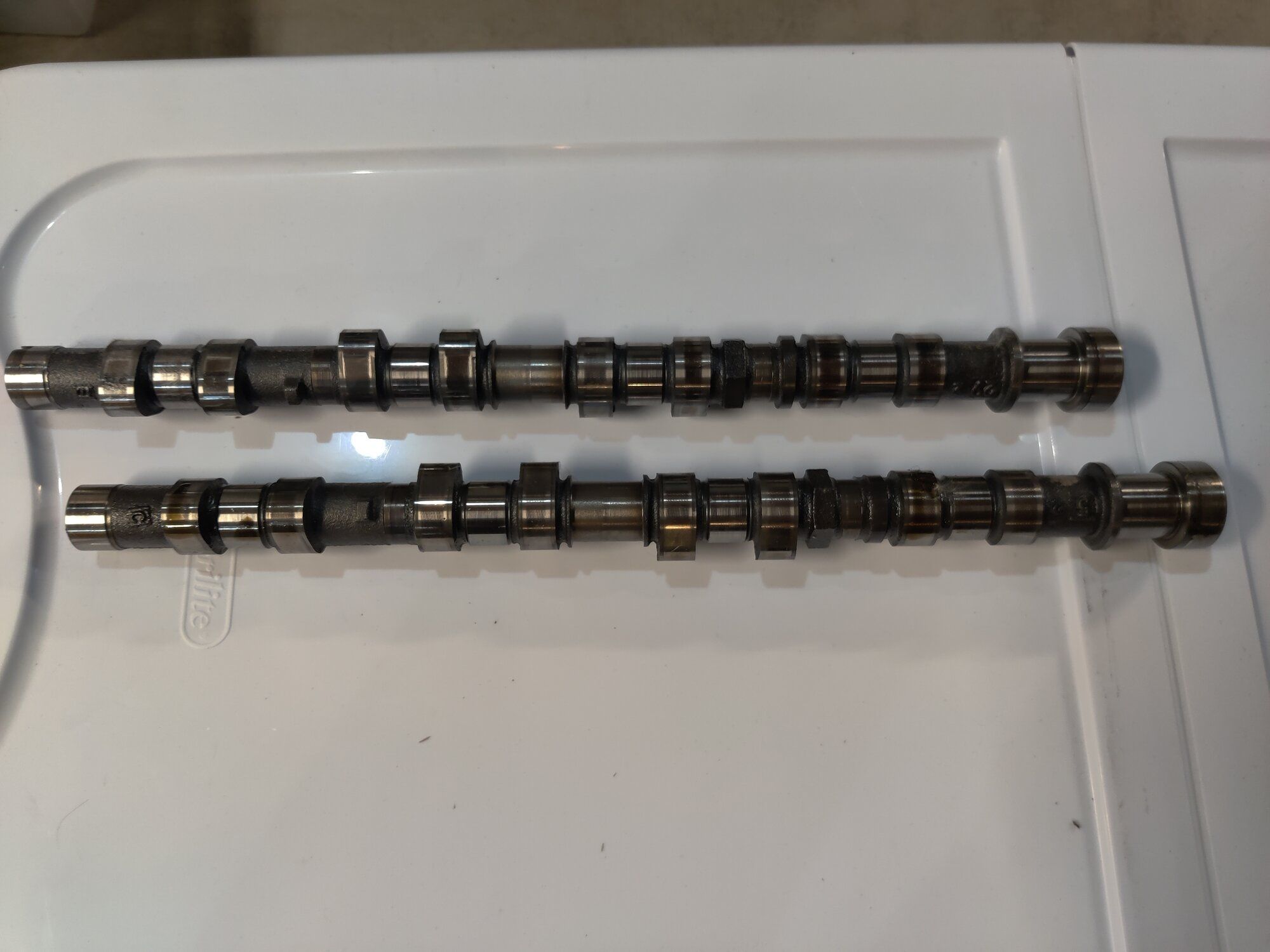

Pulled the cams out of the 1g style head that this motor came with.
Disappointed to only find the original HLAs. Was hoping to have some revised spares
The cam journals and lobes as well as the rockers are in much better condition than my old pair. Probably because of 1/3rd the mileage, given how JDM motors usually come here pretty low
My old cams are smooth body which, according to the cam ID thread, are possibly kia/Hyundai.
Intake cam has C stamped on the CAS end for exhaust, D for intake.
These cams are rougher and have the A stamp, but if that's not to be used to ID, they have numbers on the end (CAS side):
Exhaust: 102221019
Intake: 102222228
Old smooth ones:
Intake
Base circle: 1.184
Toe: 1.396
Cam lift: 0.212
Net lift: 0.360
Exhaust:
Base circle: 1.183
Toe: 1.398
Cam lift: 0.215
Net lift: 0.366
"New" rough 'A' cast;
Intake
Base circle: 1.180
Toe: 1.395
Cam lift: 0.215
Net lift: 0.366
Exhaust:
Base circle: 1.183
Toe: 1.400
Cam lift: 0.217
Net lift: 0.369
Now the thread
https://www.dsmtuners.com/threads/camshaft-identification-information.435135/ gives one measurement for each stock can but I've measured and measured again and they definitely are different for mine.
It appears I get a couple more thousandths lift between the ones going out and the ones going in. Yay.
Still want to replace them with some better ones but patiently biding my time
Just need to protect these from getting knocked over. They're pretty minty.
Journals on the head are also completely clean to so I know they're not bent
