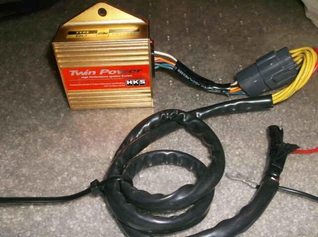

This came installed with the car, which I removed when I got the car, just because I didn't want to try and tune with something that might be defective.
Wondering if I should put it back on.. it's an older HKS Twin Power ignition box. I probably should have taken pictures before I removed it because I have no idea where I can find an install manual for our coils

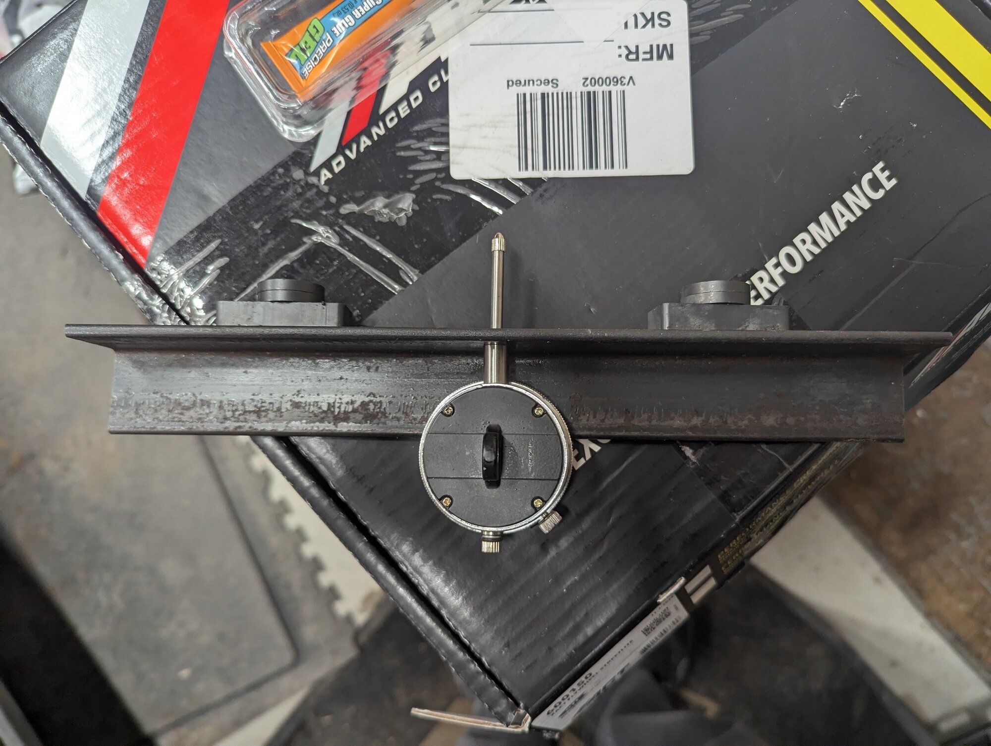

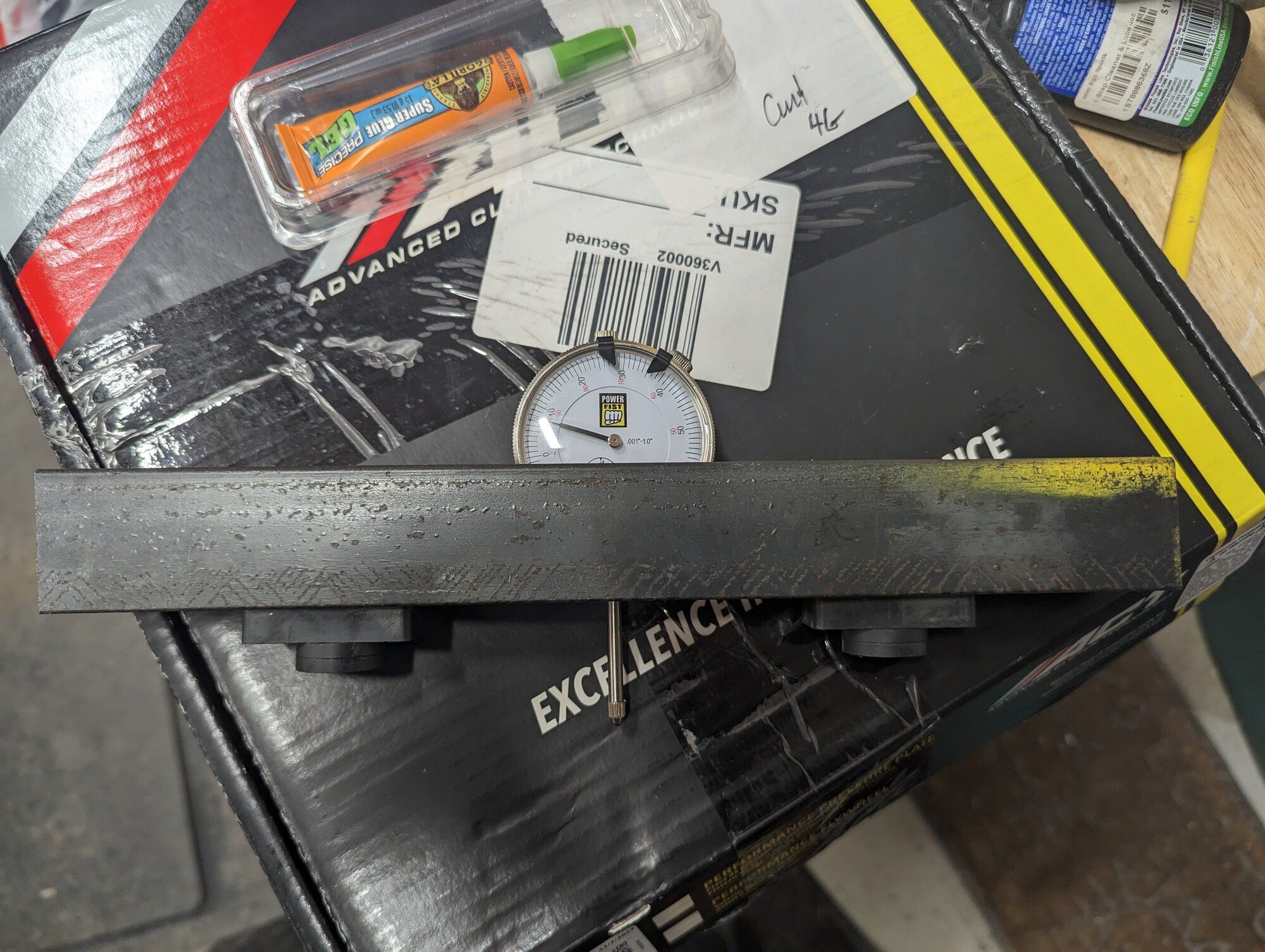

Nice. New ACT Streetlite measured out .608-.609 on both outside and inside. I only had one .609 so I think some debris got caught under because I measured from the other side of the post and it was .608 again.
Post-measurements zeroed back out when on step so I know the dial indicator didn't shift.
For anyone wondering what my setup was, it was a 12" section of 1.5"X1/8 steel angle, with a hole drilled in the center just large enough to jam the dial indicator body nose into. A couple of super glued magnet discs on each side (not glued to the steel, just to each other) allowed me to center-ish the indicator in its range since it's only 0-1".
Magnets go on the outer steps of each "set" of three and zero on the middle step. Then carefully allow the indicator to fall onto the friction surface and count rotations and final settle.
If everything is straight you should be able to measure across the entire diameter as well.
I figure if I was doing something wrong here I wouldn't be getting repeatable results regardless of where I measured and definitely not right in the spec range.
This is basically RREs posted method just with angle instead of square.

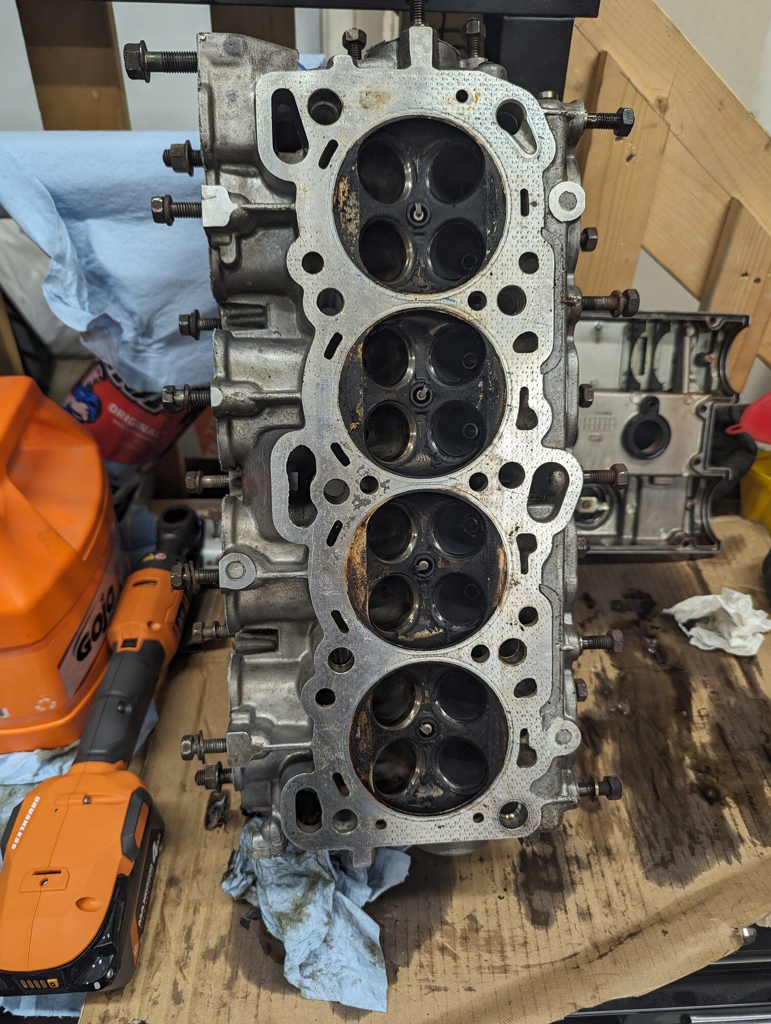

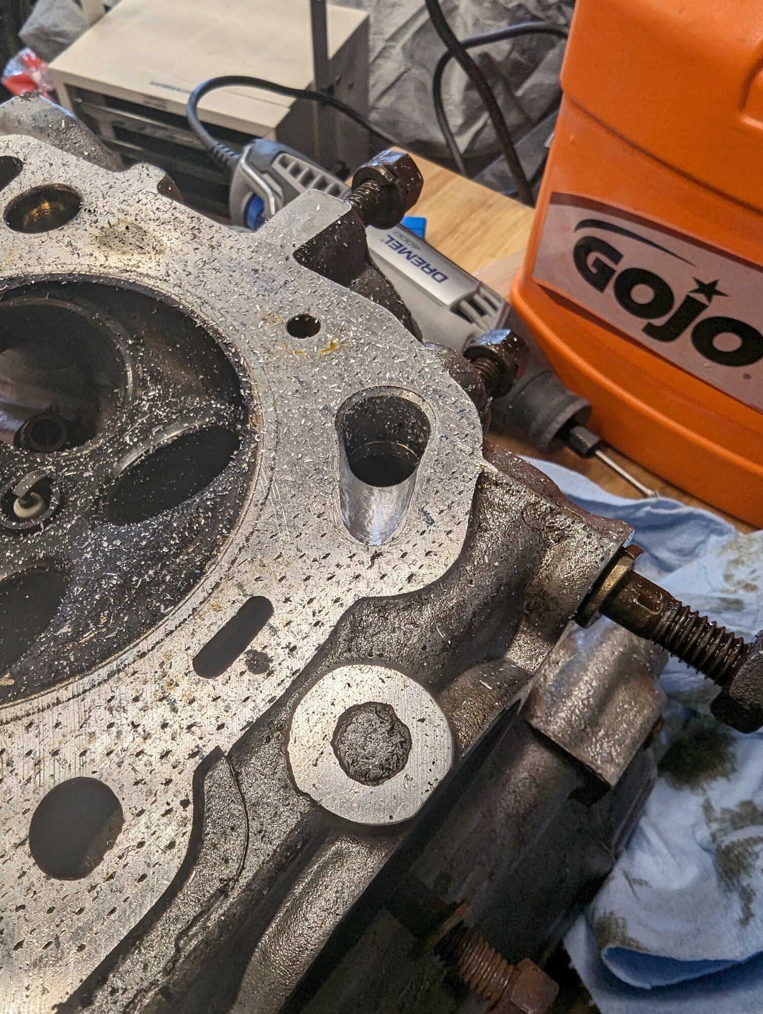

Disassembled head, ready for a good bath and a tiny deck surface cleanup. Can definitely see where the block surface wasn't flat.. that's why they took 0.006 off it.

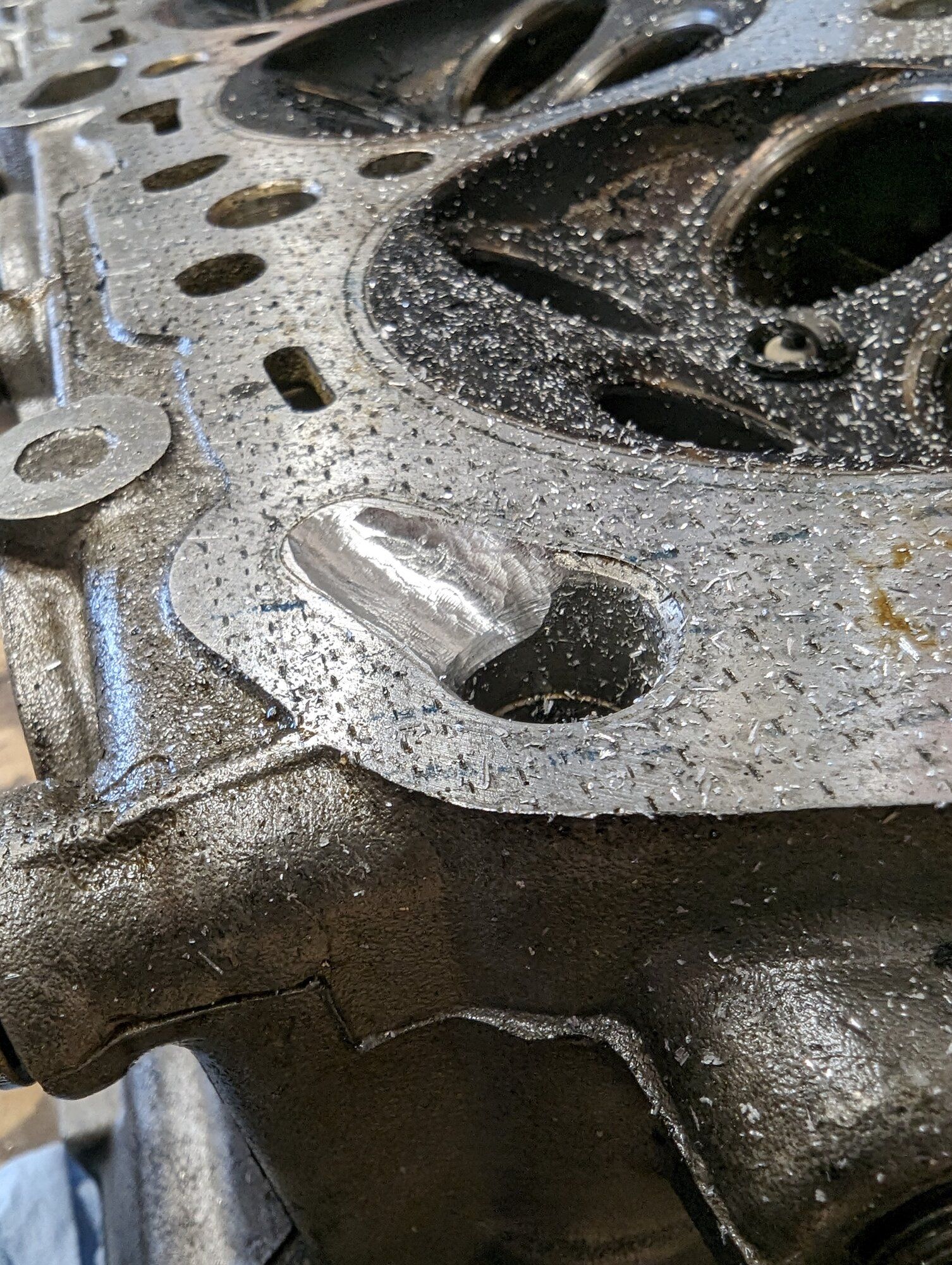

First off, I think I will open up that head oil port a bit more.
Nice work. Are you dealing with Competition or Piston Ring? I just dropped off my Neon cylinder heads at PR today - they did my block & crank work, and they've done family projects for decades. In case you're considering selling the ol B16G, I'm not against taking it back in the future either, just in case I go full resto.
You're back eh? Noice!
Comp did my head work a few years back, cut my seats with a bent pilot and didn't check afterwards even though I asked them before if they check their work with every valve and was assured they did. They sourced a new pilot and redid them which did the job but ever since I've been weary. . It just reminded me too much of Heads Up!

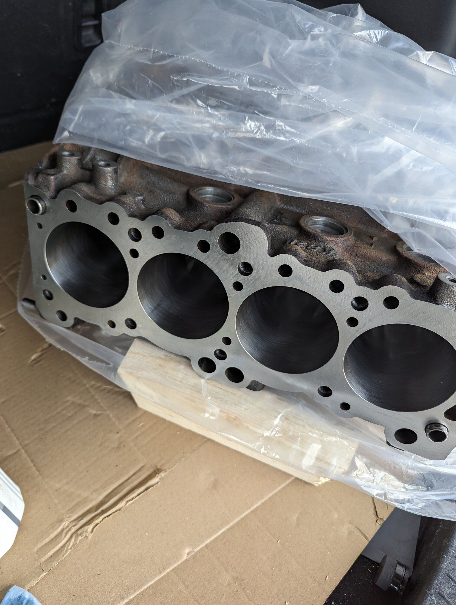

So I took it to PR. They've done headwork for me in the past and a friend works on the service side. They bored, decked, girdle-align honed the block, and opened up the big end of my eagle H beams a half thou since it was measuring .0015-.0018 clearance.
Overall it took four months, some of that because I didn't have all the parts, mainly the girdle.
The head I will take to PR as well most likely again

Enlarged and chamfered the head oil port a bit more. First time was pretty light

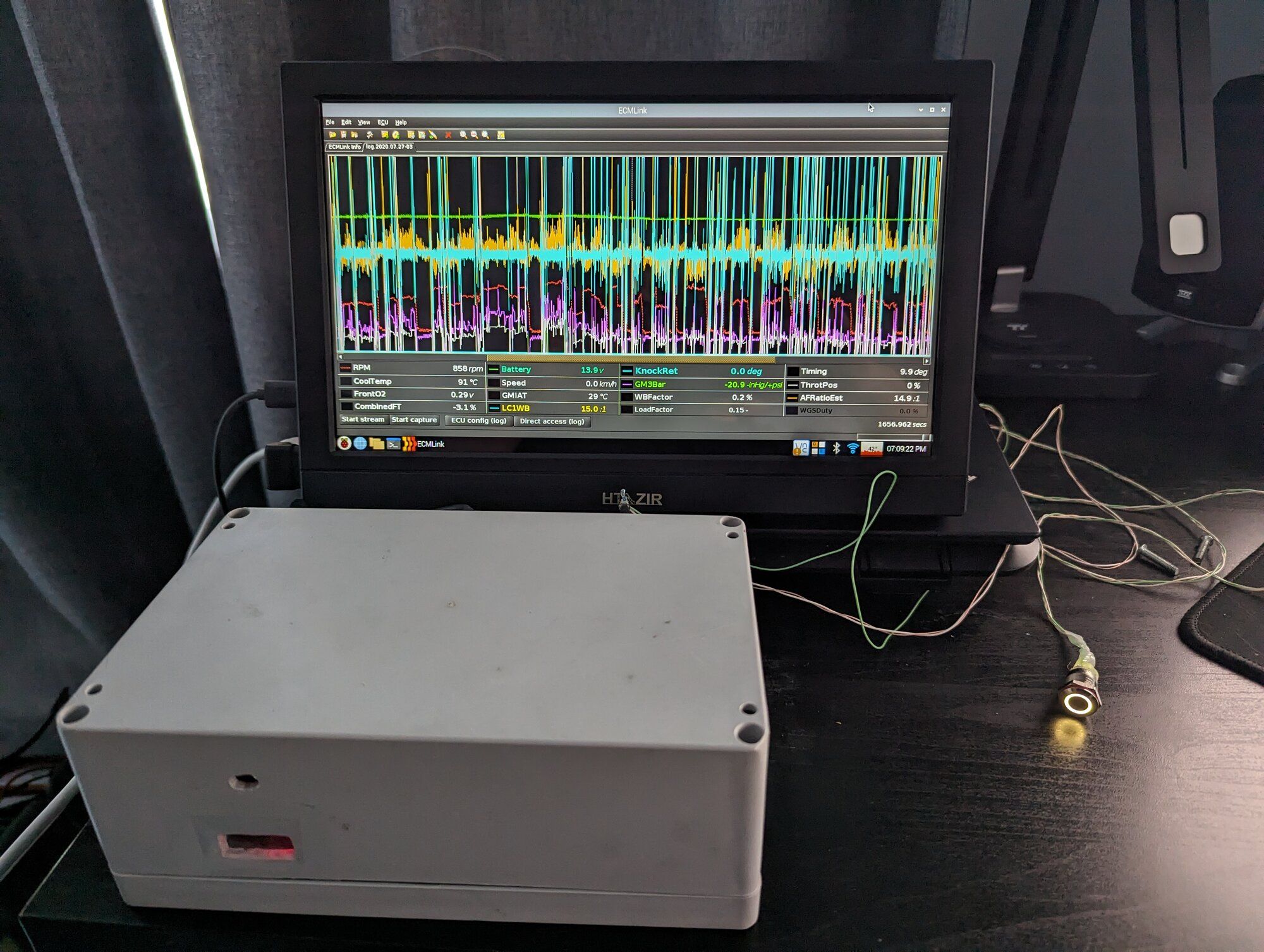

What a PITA it was to get this thing working with rpi, and in the end, I didn't actually change anything
I don't know why it suddenly decided to just
... Work.
The box is where the rpi, relay, adjustable buck converter, and lil' attiny85 which I use to control startup/shutdown and the led ringed button there.
Wondering if I should upgrade to the Pi 5 to get better bootup and maybe logging latency, but I really don't want to go through the work of getting ecmlink to work on the new one. I had enough fun tweaking that java I/O shit already years ago.
