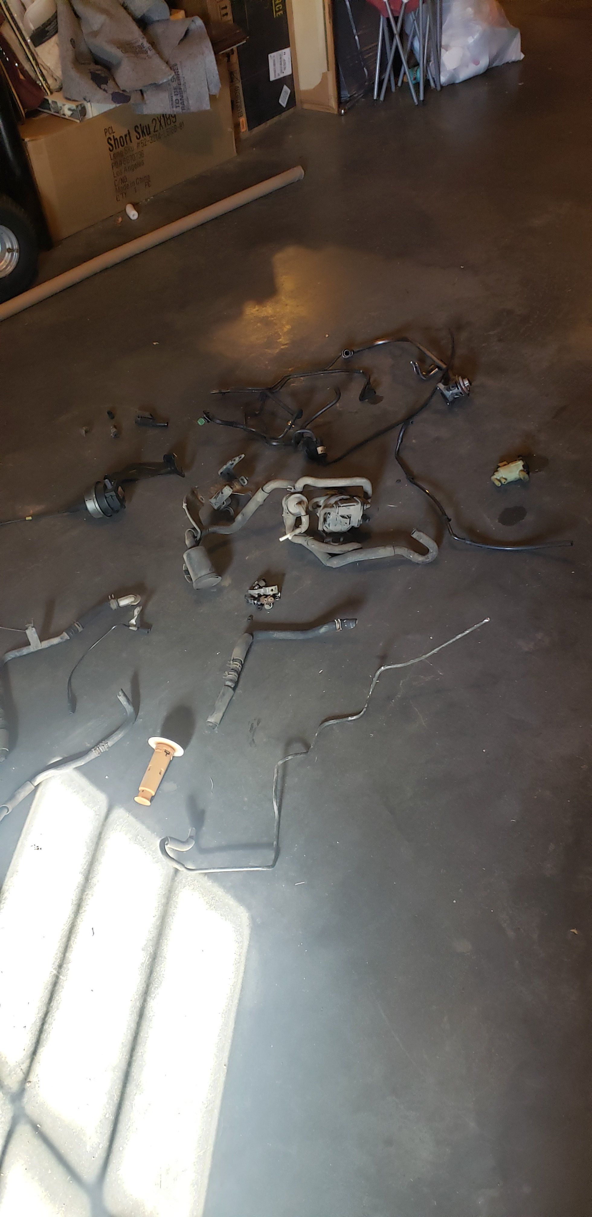

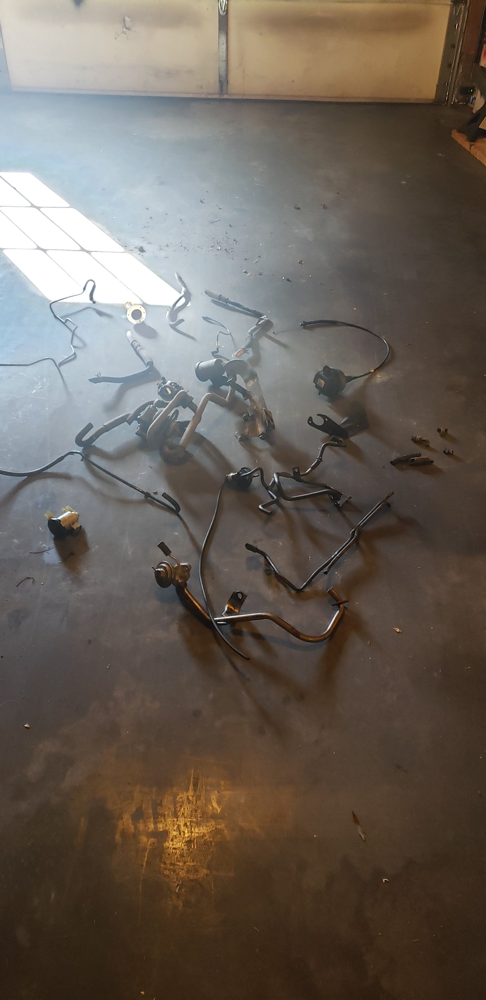

Wow... this is a lot of emissions crap. If I had to guess I'd say that this is 20 pounds worth... i used some sheet metal to cut and drill an evap blockoff plate that I put on the port on top of the gas tank to keep it from leaking. And just simply capped off the little port at the throttle body. Take a look at all this trash.

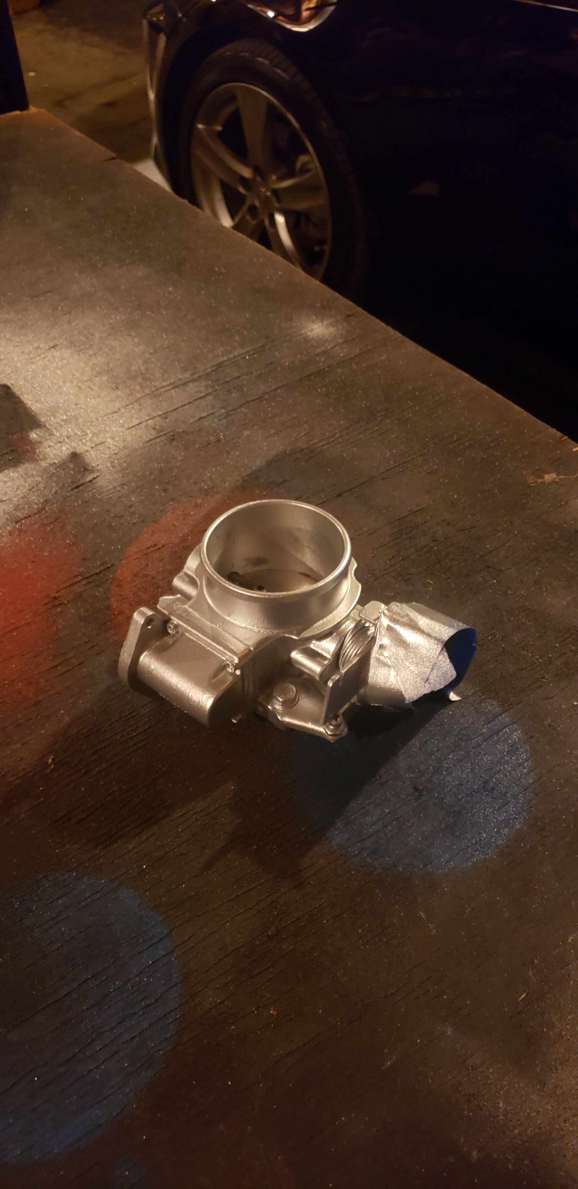

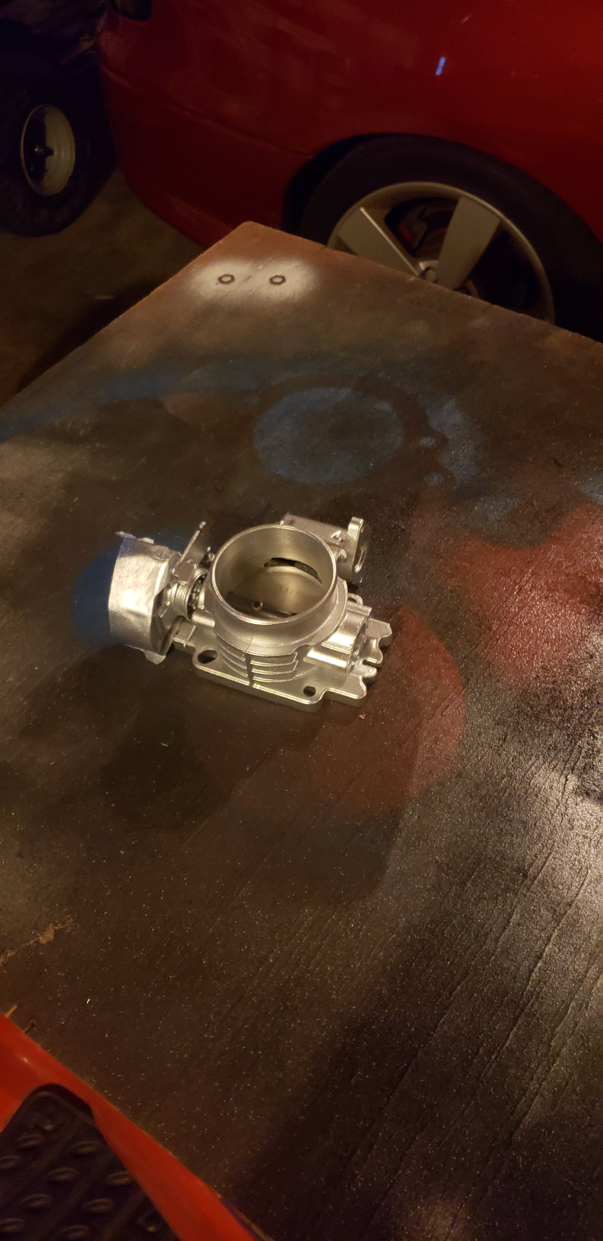

A couple days ago I got a great deal on a 60mm throttle body. It should be in tomorrow. Now I just have to arrange the manifold porting.
I'm having an interesting time trying to port the plenum. I broke a bit, and damn the mess I have clean up. And then I have to figure out what to use for bolts to hold on the TB. The stock bolts are way too long, and if I use spacers they will interfere with the intake piping. I tried a shorter bolt but the head sits so close to the TB that I can't even get a socket on it... Updates coming soon.

When I was running a Jeep throttle body I picked up Allen head bolts from a hardware store and they worked out perfectly. M8 1.25 pitch x 25mm is the size I used. In case you haven’t seen these how-tos yet, here are the links to the two 2gnt posts about the Jeep TB on a 420a.

I bought one that was already modified. All I have to do is the porting of the IM and the installing. Thank you for the links though.

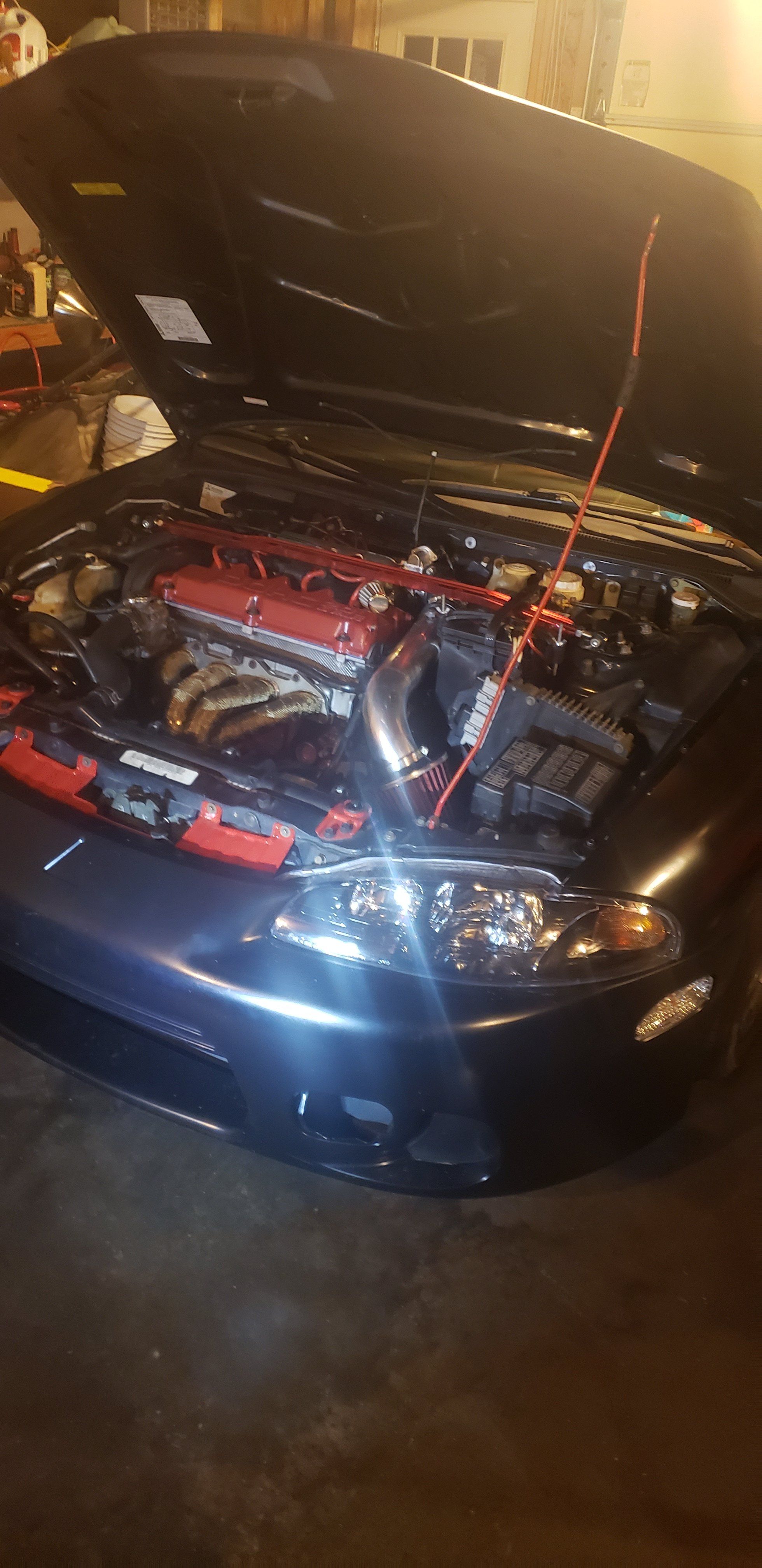

I had to piece together a custom cold air intake because the stock piping would not fit on the larger throttle body. And of course, I had to put a micro filter for the VC breather. I finished up the porting on the IM and got everything installed.

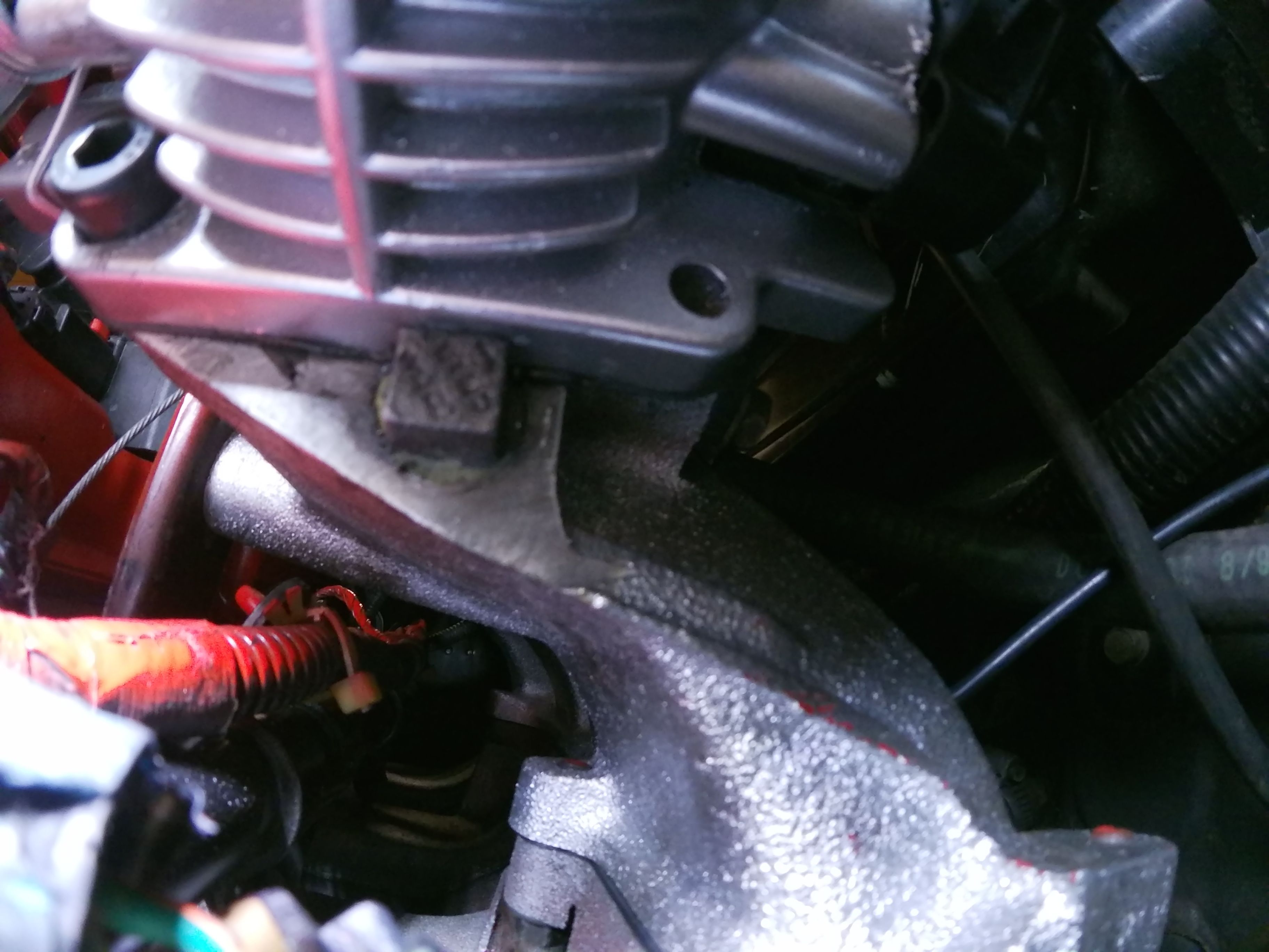

I couldn't get that stupid rubber cap to stop leaking vacuum. So I decided to spend a little money and tap the hole out to a 3/8 and put a pipe plug in it. It doesn't leak anymore!
