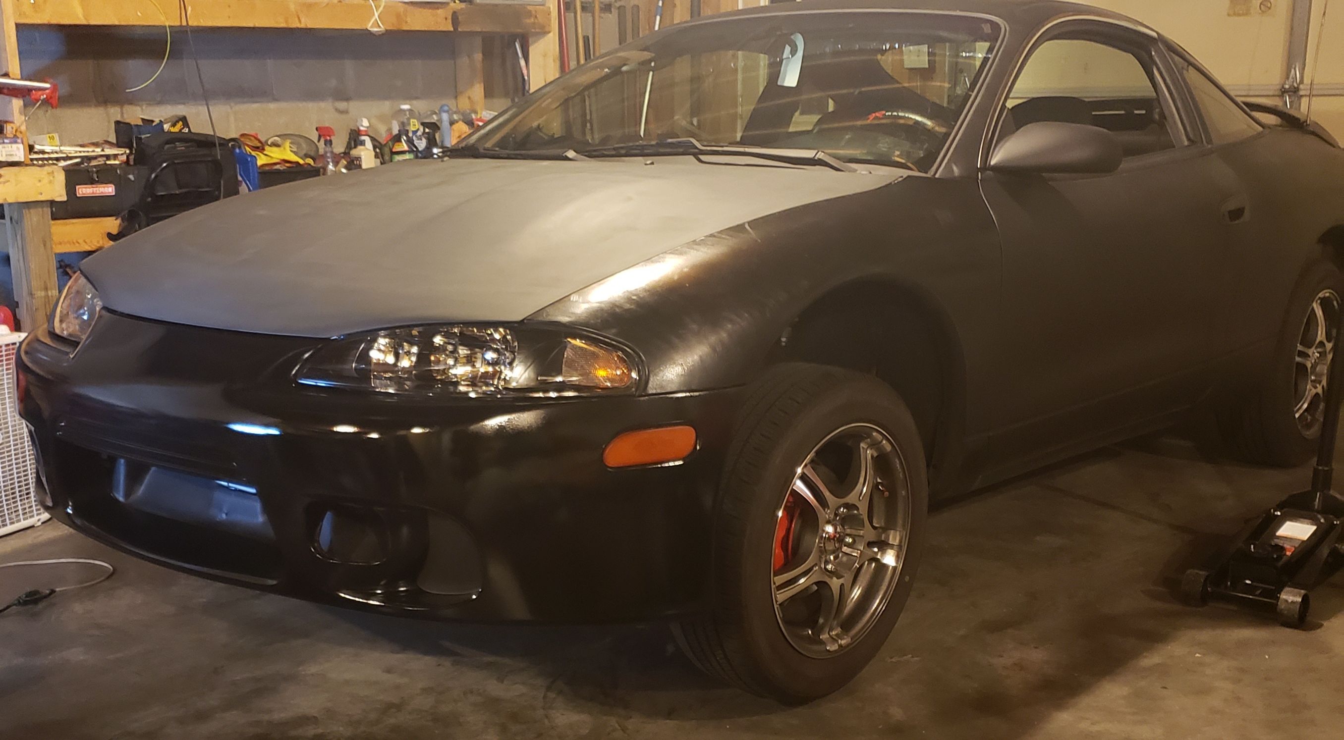

Now, it was time to temporarily address the body. I had a combination of stock paint, and what looked to be some spray can primer that was sprayed over the peeling clear coat areas... It also had quite a few dents and scratches. It was ugly to say the least. So I spent less than $100 at Lowe's and Harbor Freight on budget materials and painted it in my garage. I chose flat black :toobad:. I knew it wasn't going to be permanent, so I decided to experiment a little. I really just did not want to drive around with it looking so bad, and I knew I would be driving it a bit, as I do with new projects.
Now... I had to get rid of those stock wheels and tires. 14 inch wheels are not for me, especially not on a spirited vehicle. To get things going, I ordered some 16 inch KONIG graphite wheels. Not only are 16 inch tires easier to source, but more performance options are available. But there was one more thing I had to do before replacing the wheels. When I bought the car, it only had 4 lug nuts on each hub. I thought it was only because the previous owner removed some locking nuts. But upon inspection, the rear lug studs were beat to hell, so a nut couldn't catch a thread.

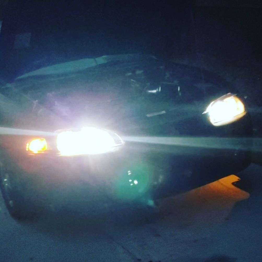

And now, to tidy up the exterior, I had to replace those faded headlights. Simple enough.

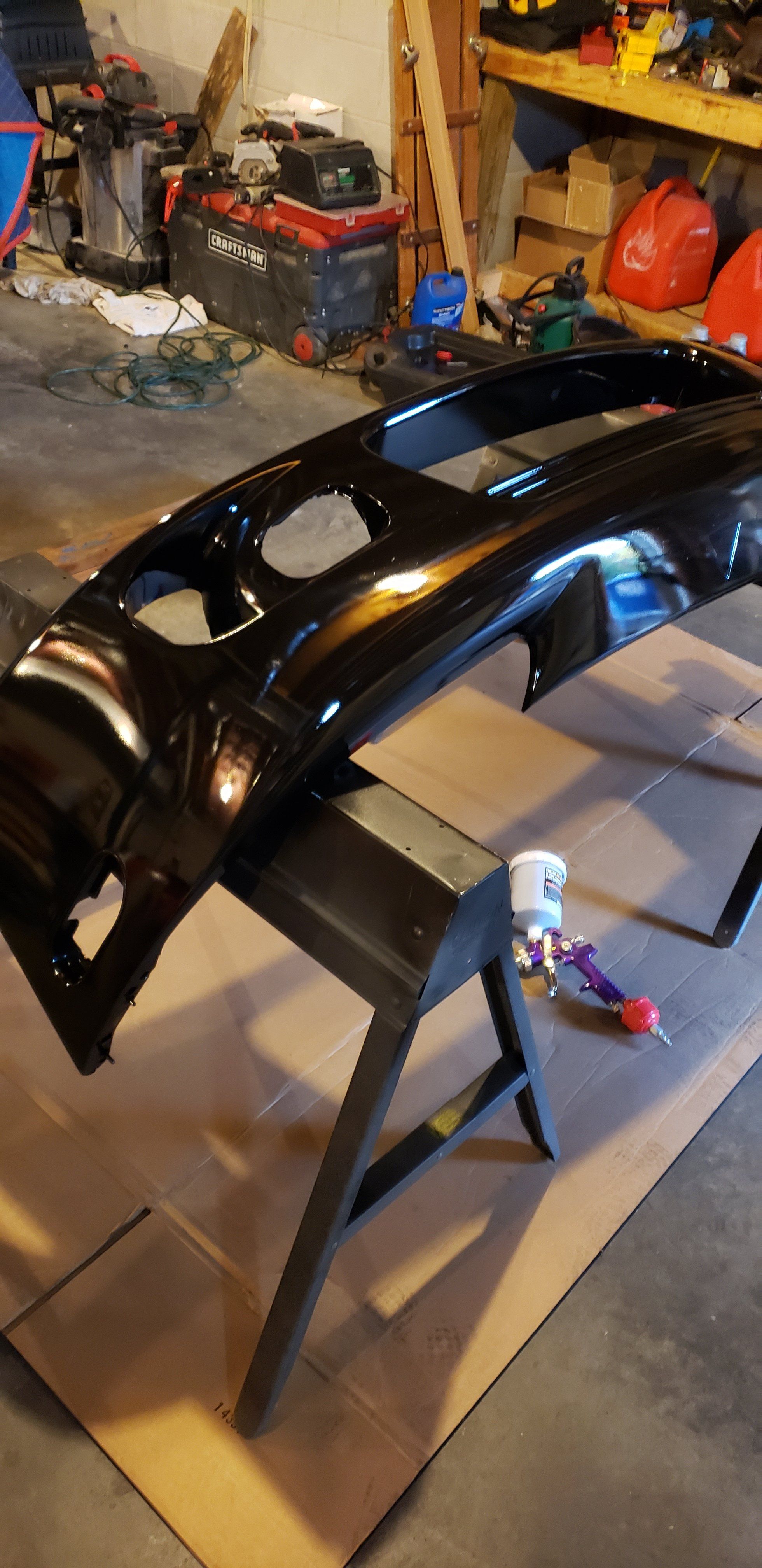

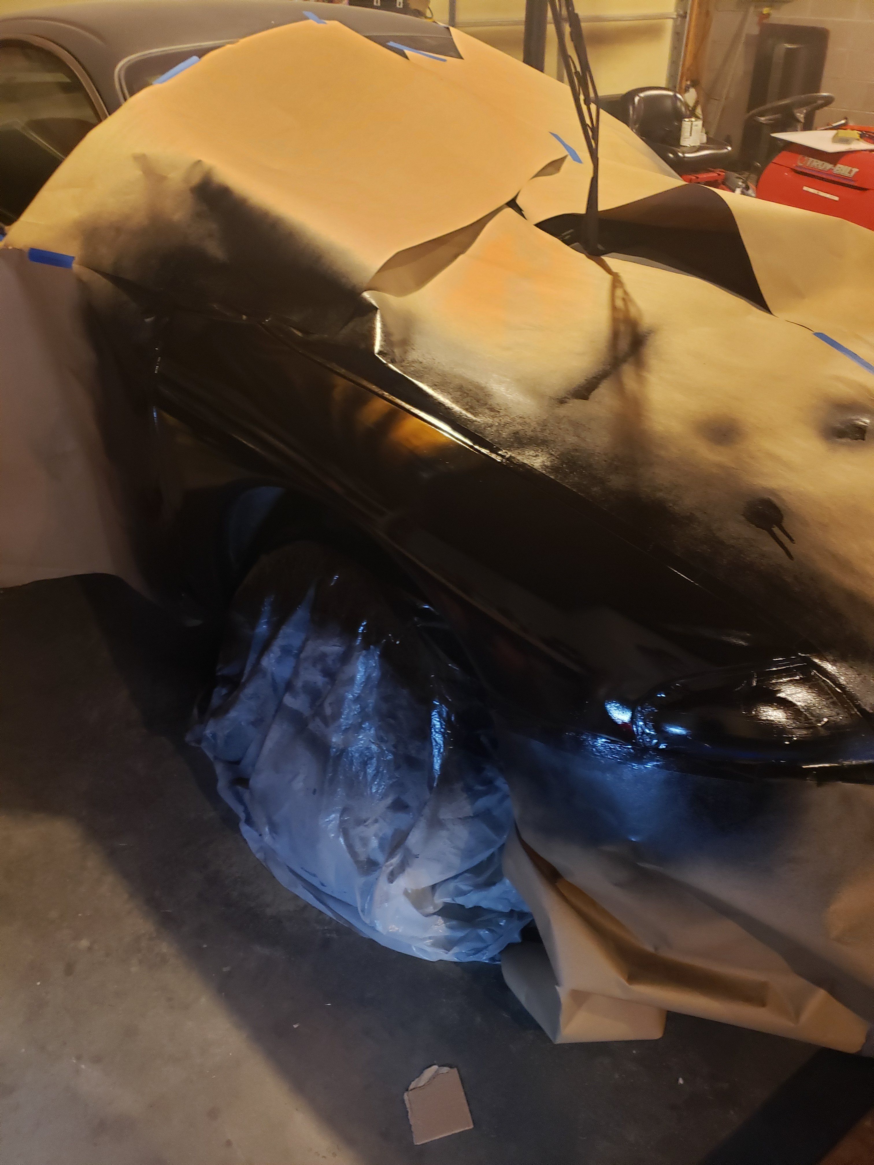

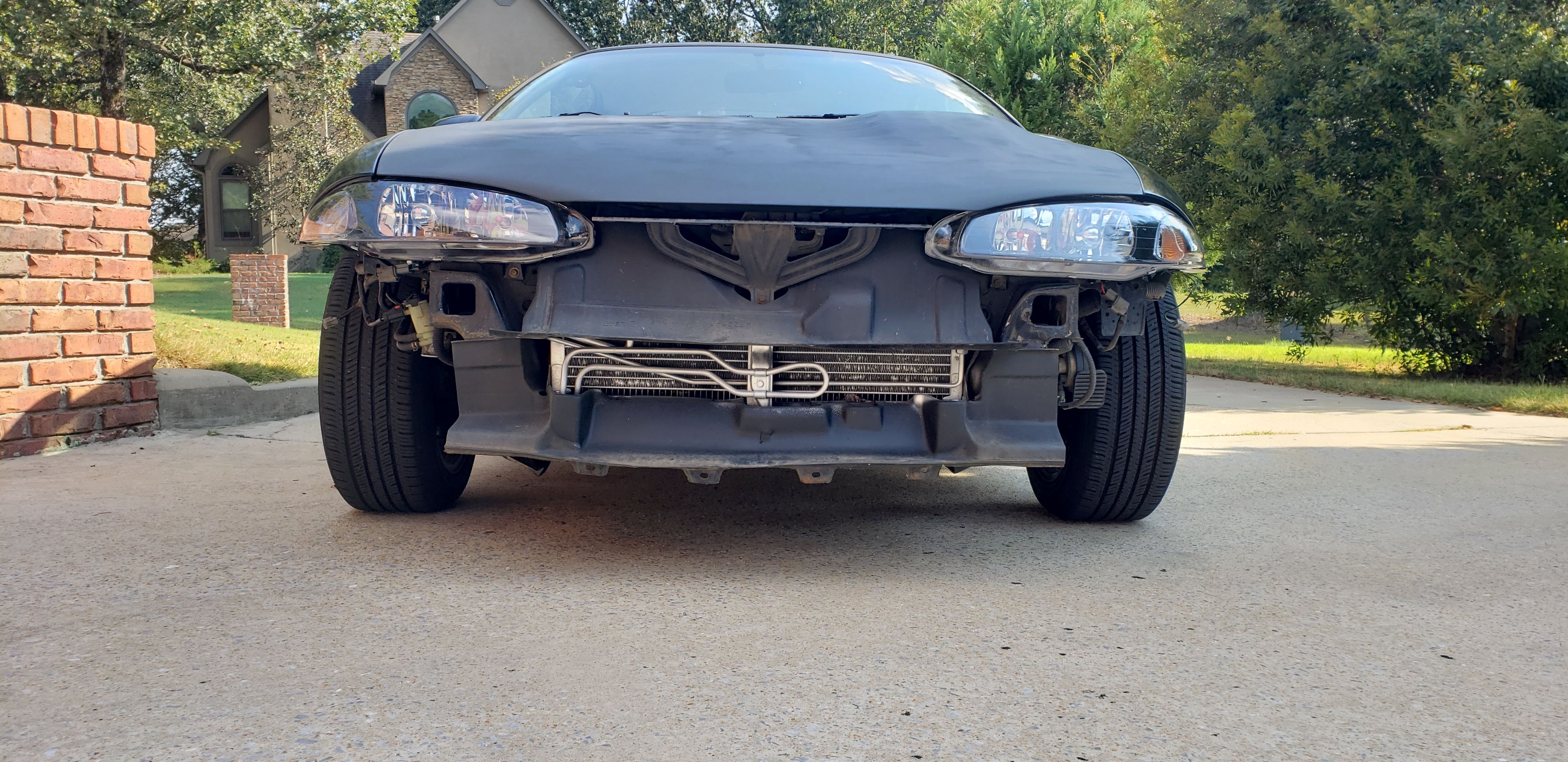

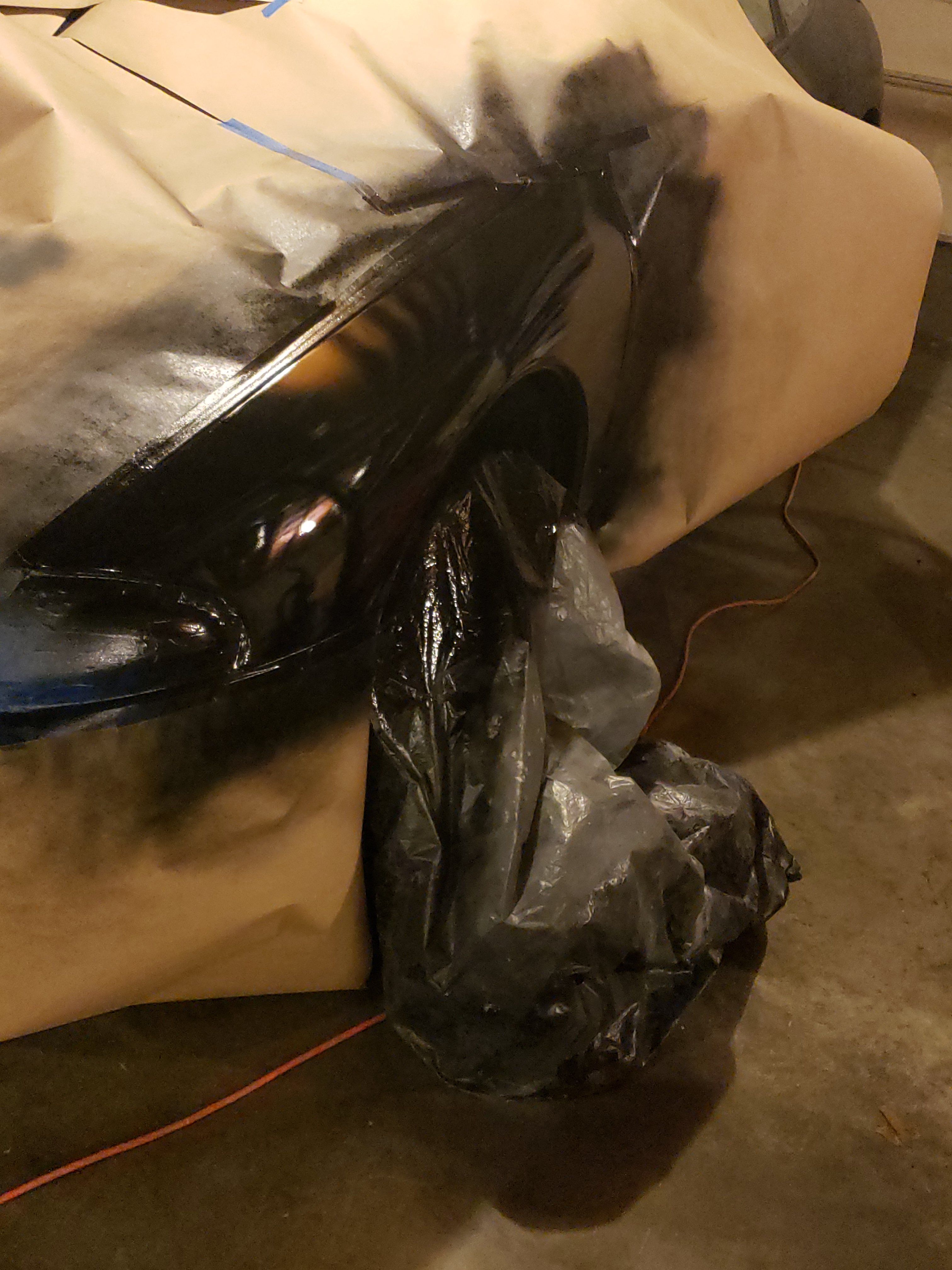

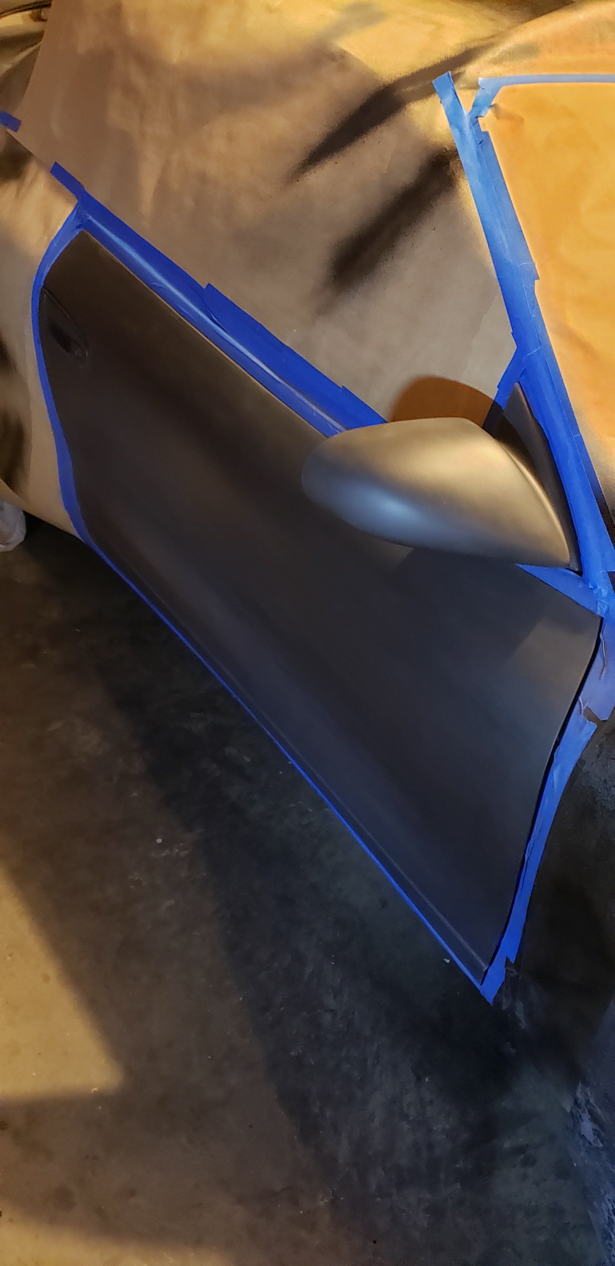

I've spent the last few days getting my "paint booth" all set up. And the last couple of nights painting and clearing my new bumper. Last night was a late night, I spent a long while getting the new bumper put on, and also aligning all the front end panels. I think I've got the front body lines straight, now time to paint the rest. :)

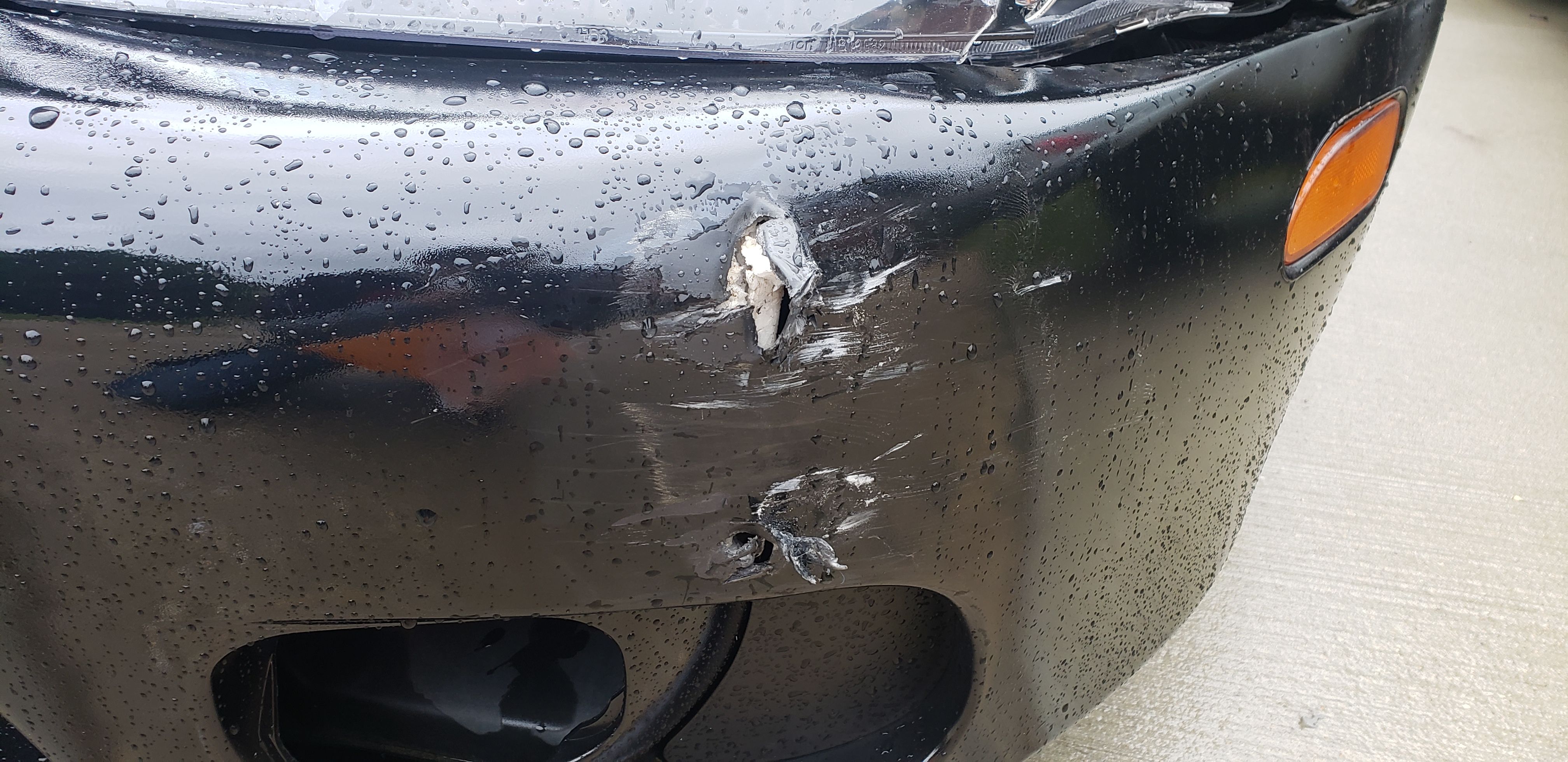

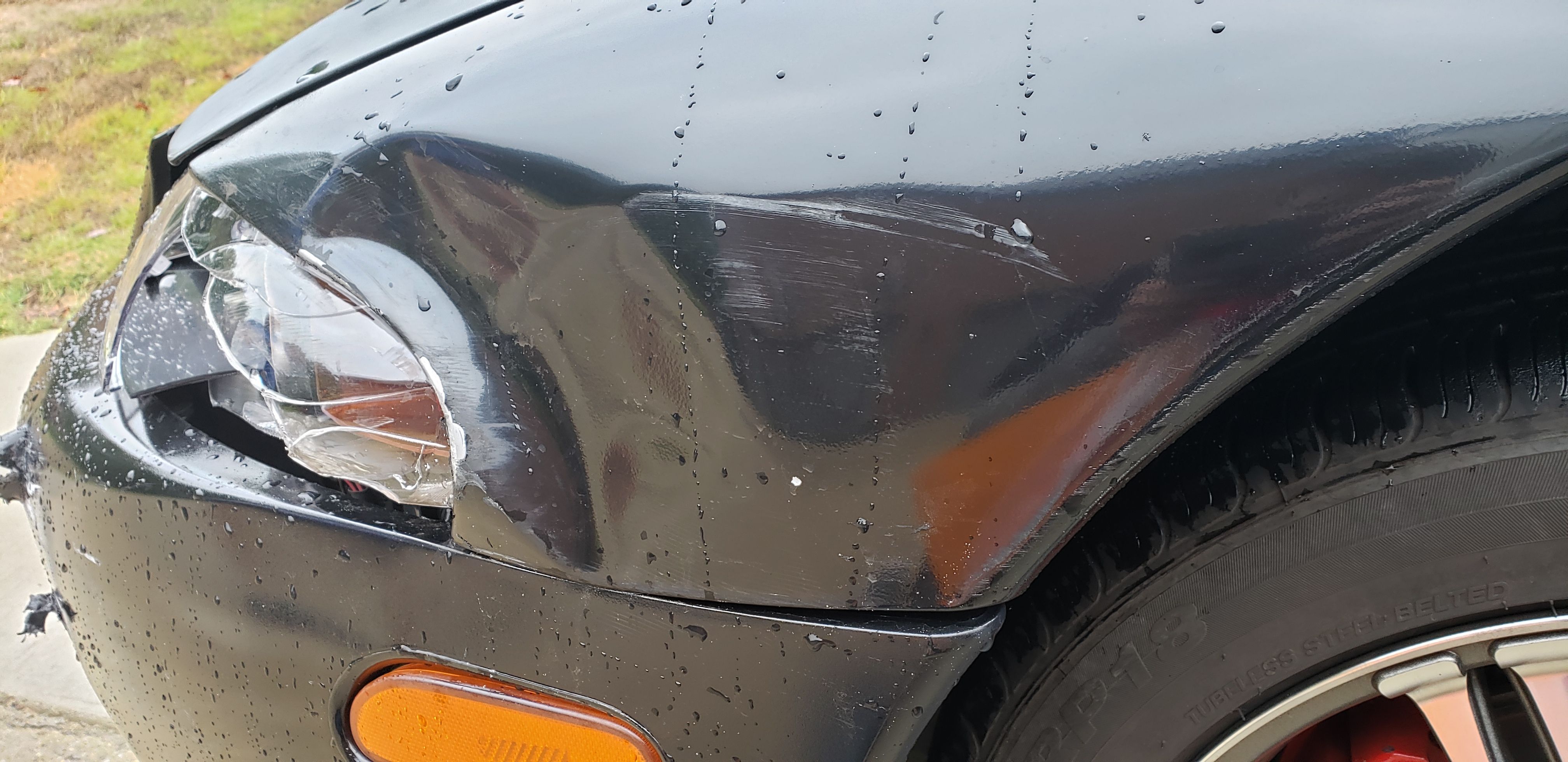

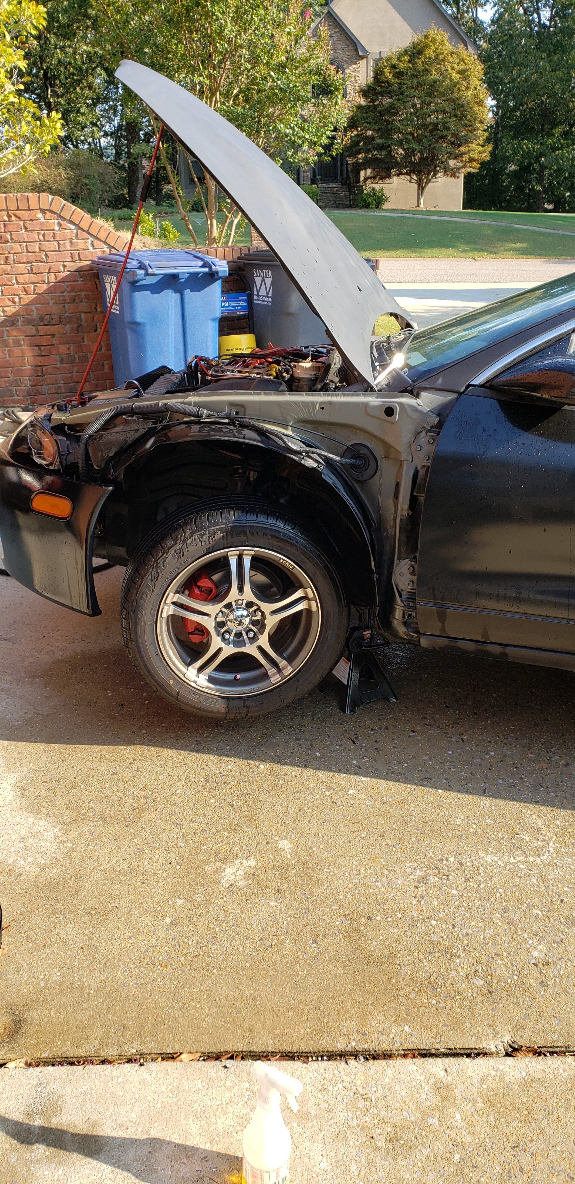

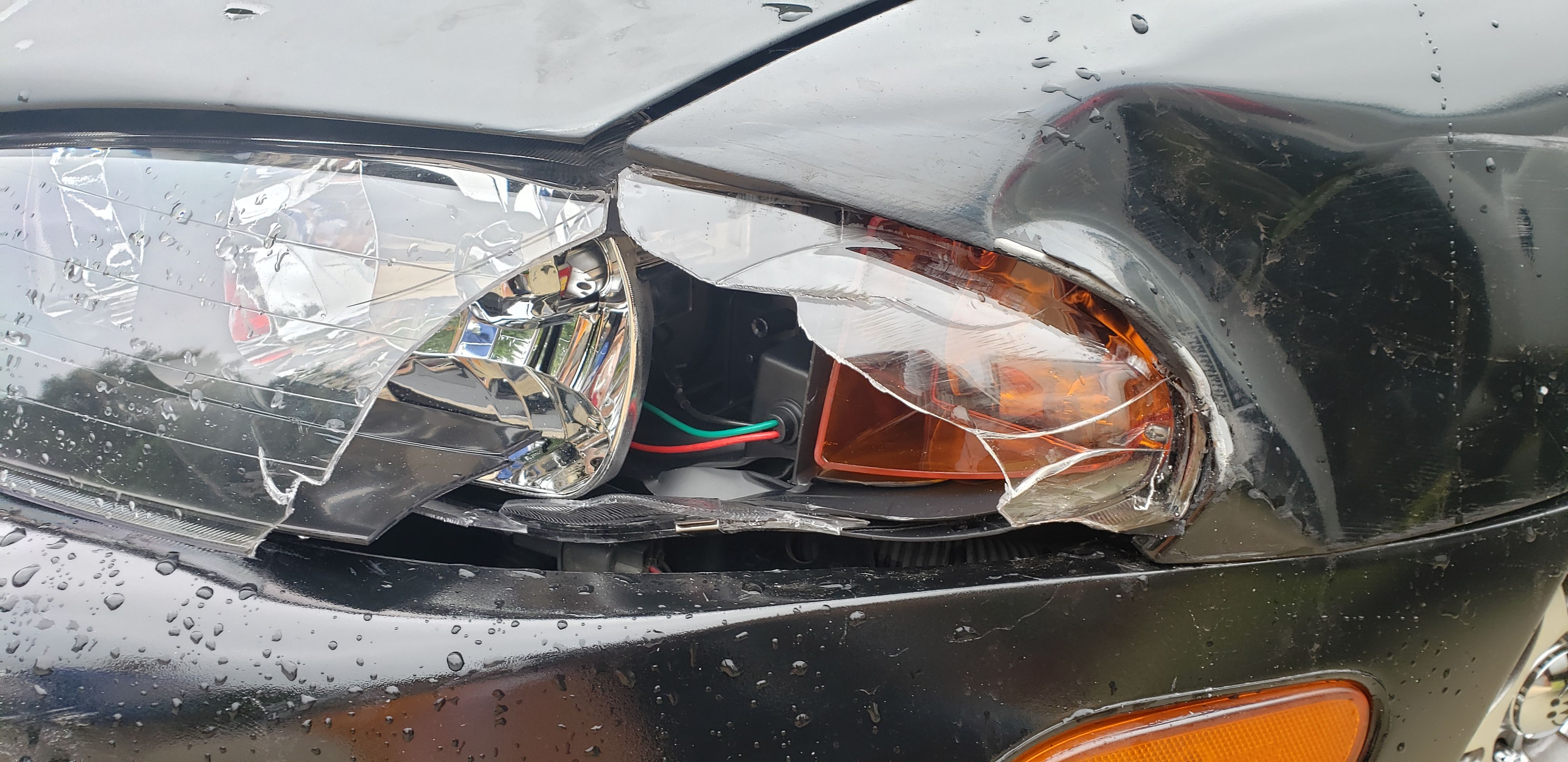

There has been quite a bit of rain here lately. Monsoons compared to what we usually see out here. I took a turn too quickly and hydro-planed across an intersection, crashing into the wheel of a Jeep. Ouch. Luckily I am well, and so is the car... well mostly. Great way to ruin my efforts of the front end. Back to square one up here!

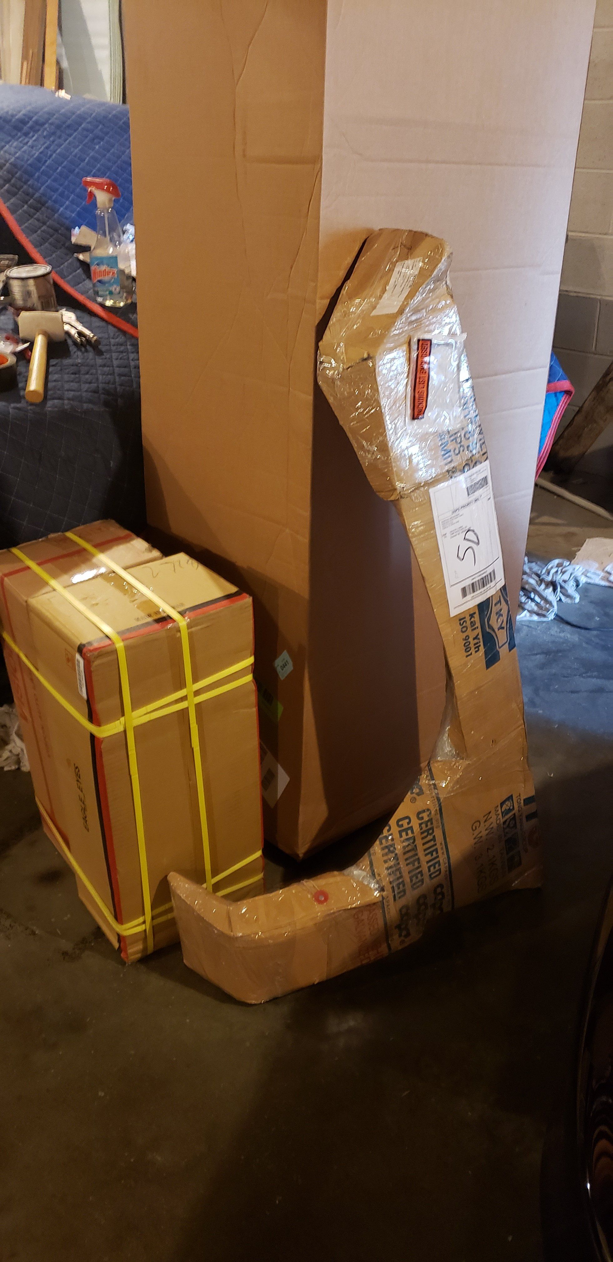

Just ordered the new fender. All of the parts I need are on the way! Once they arrive I can get back to painting. Maybe I can have the whole car done before winter?

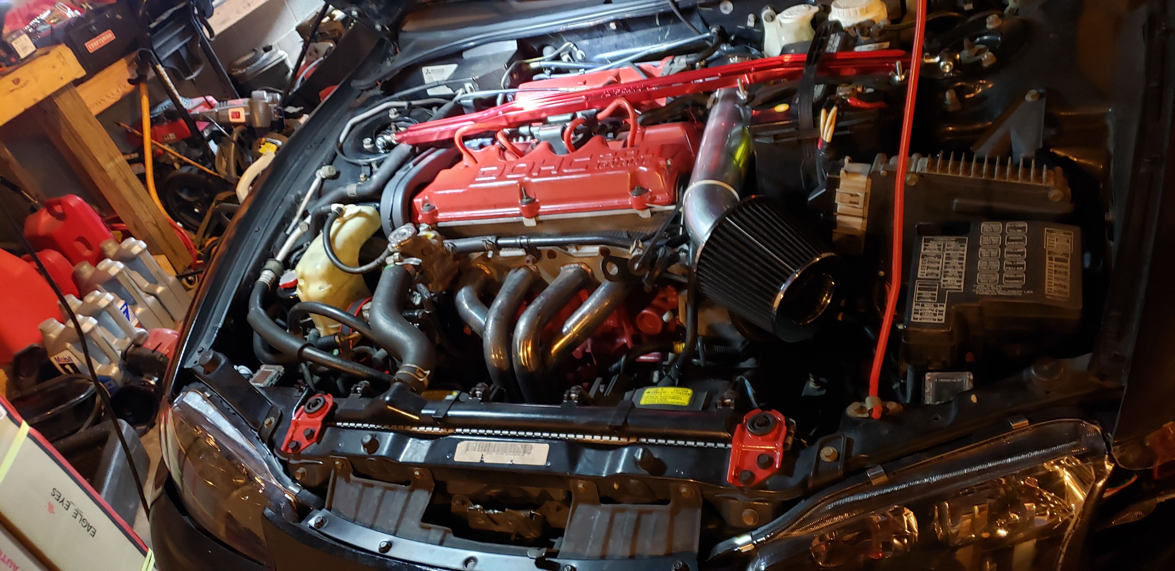

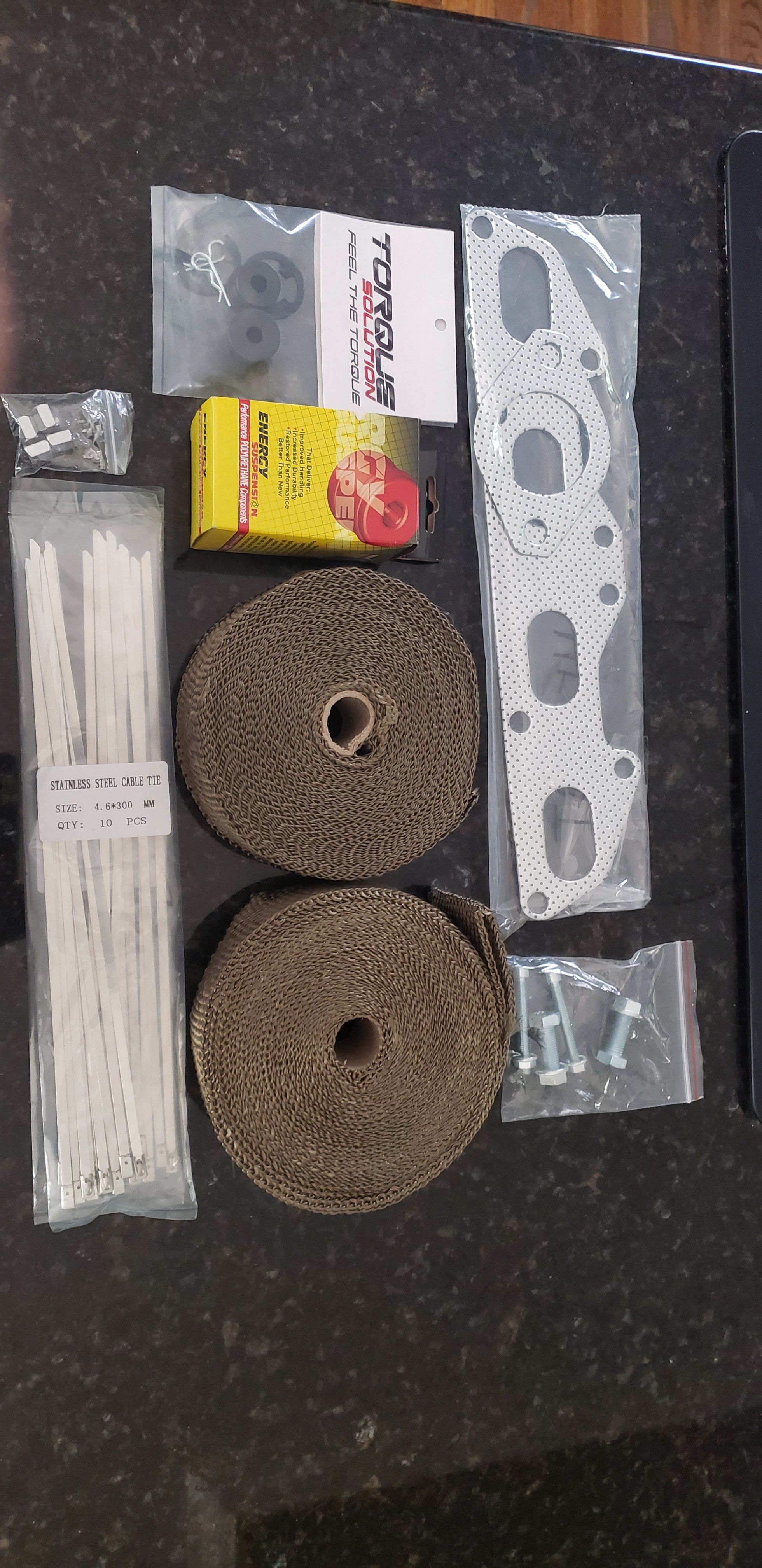

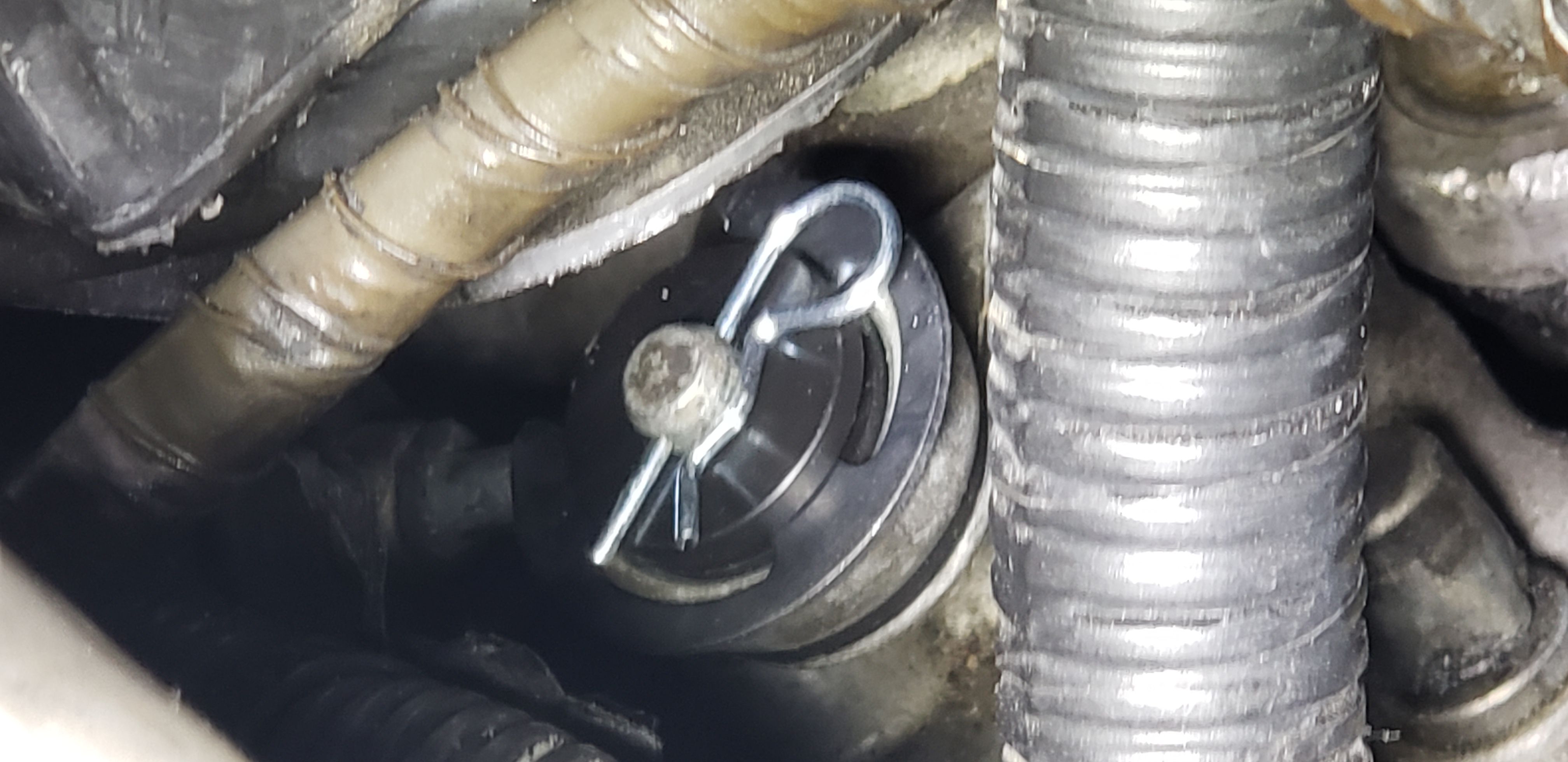

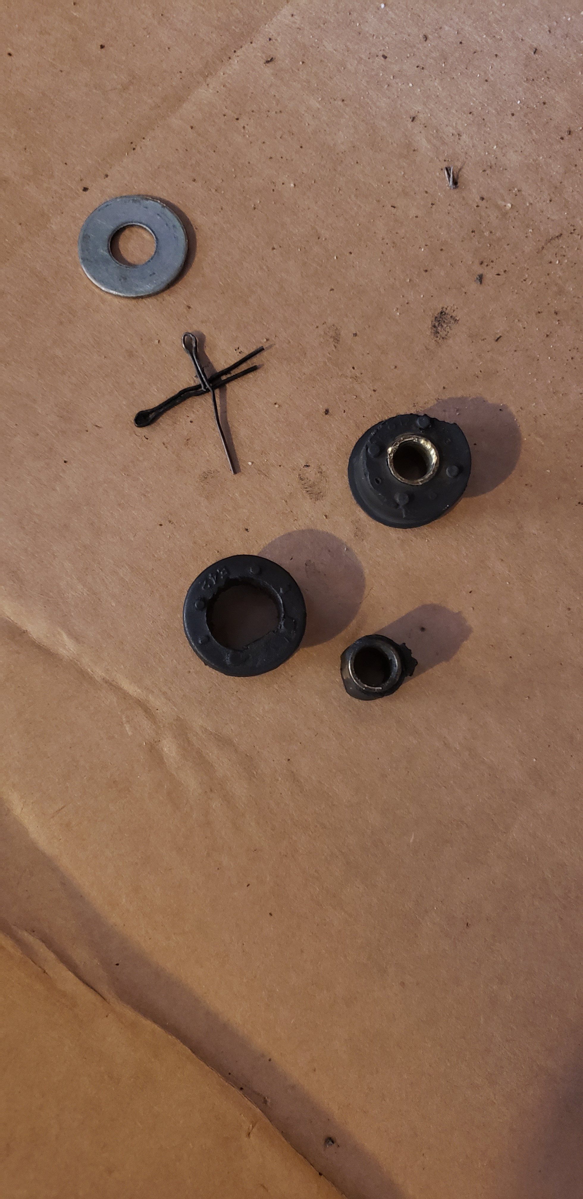

Today one of my shifter bushings fell apart and popped loose. 1st and 2nd gear were unable to engage by the shifter, so I had to drive home using only 3rd and 4th gear. I could smell the clutch burning by the time I arrived home. I ordered some Torque Solutions shifter bushings. They are much stiffer than stock and last significantly longer (plastic vs rubber). I also ordered some fiberglass heat wrap. Planning on wrapping my headers and downpipe to keep the intake temps lower and make it easier to work on the engine after running.

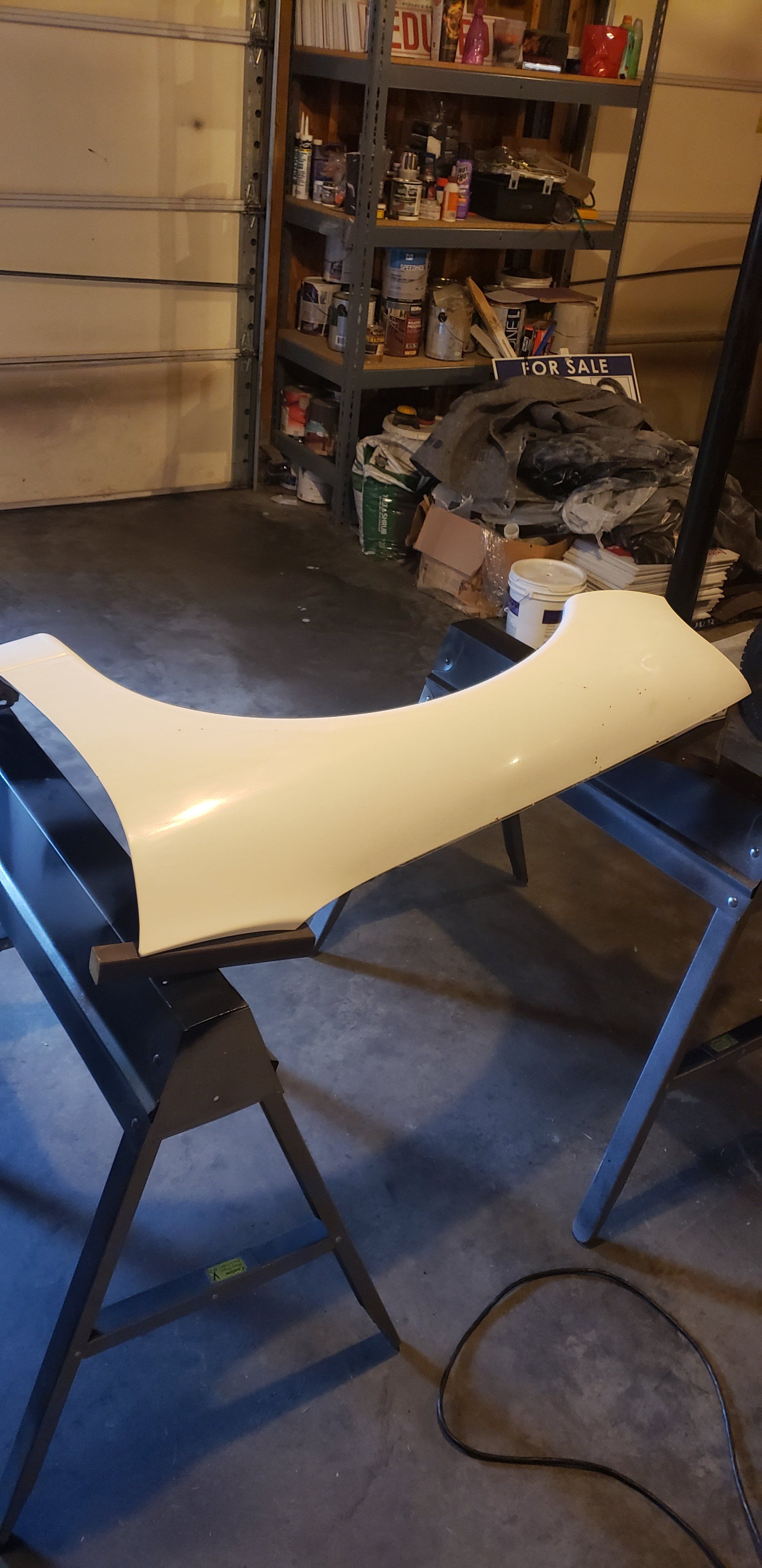

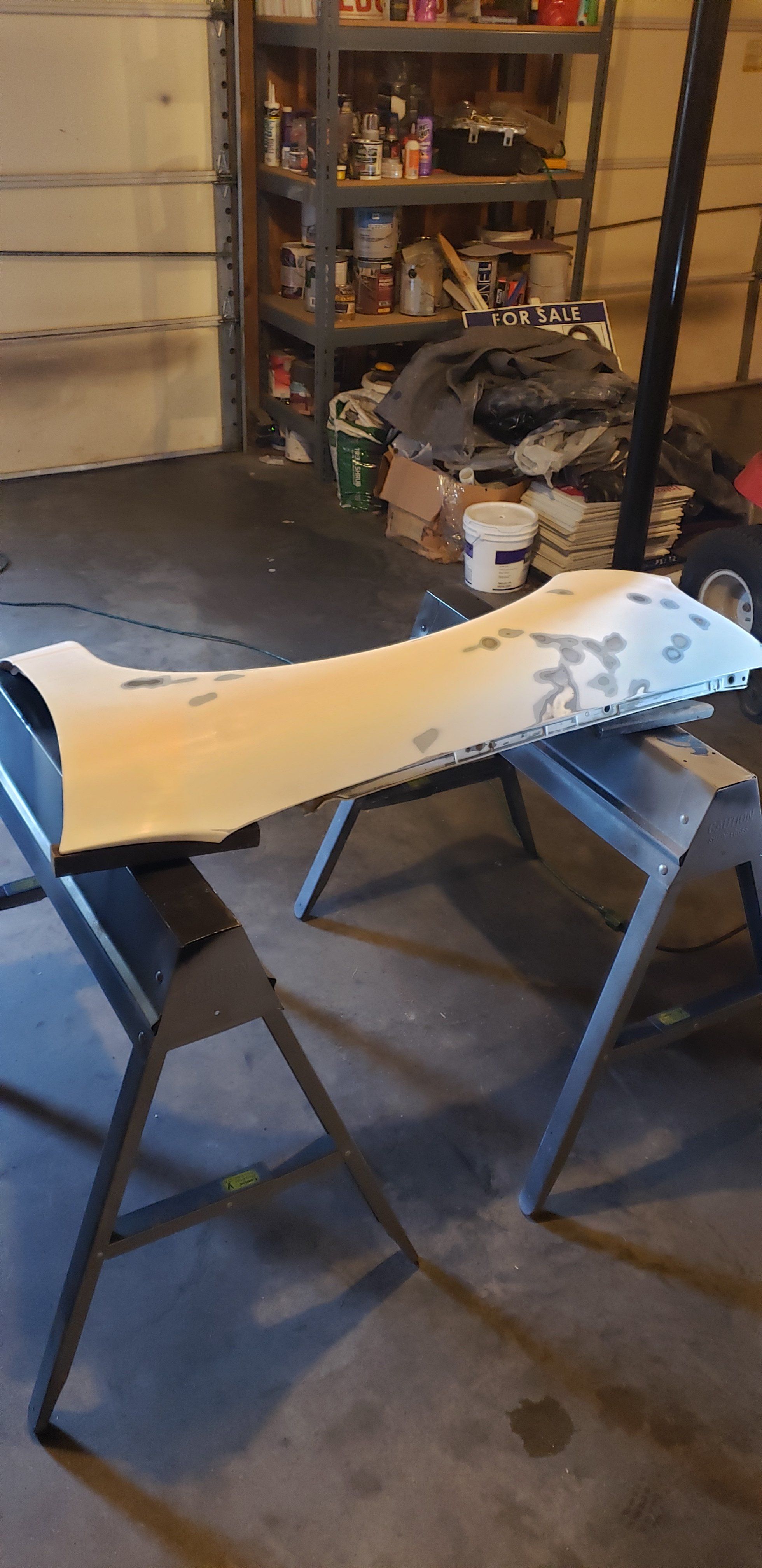

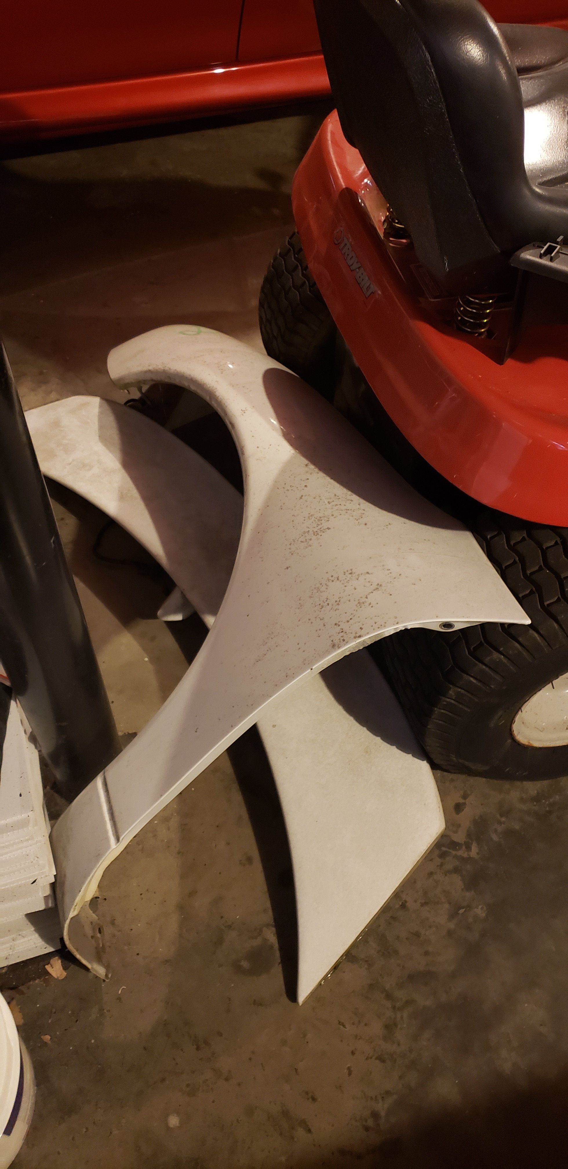

As of today I have all of the parts I need to repair the accident. One of the fenders I ordered from Chicago Autobody Parts (which I overpayed for), and the other one I went and picked up from Pull-A-Part just in case I ever need it for future DSM's. While I was at the yard, I also picked up a new spoiler since the one I ordered from Ebay a few months ago is complete trash. Never buy those cheap chinese products on Ebay. Soon I can prep and paint these pieces so that I can install them.

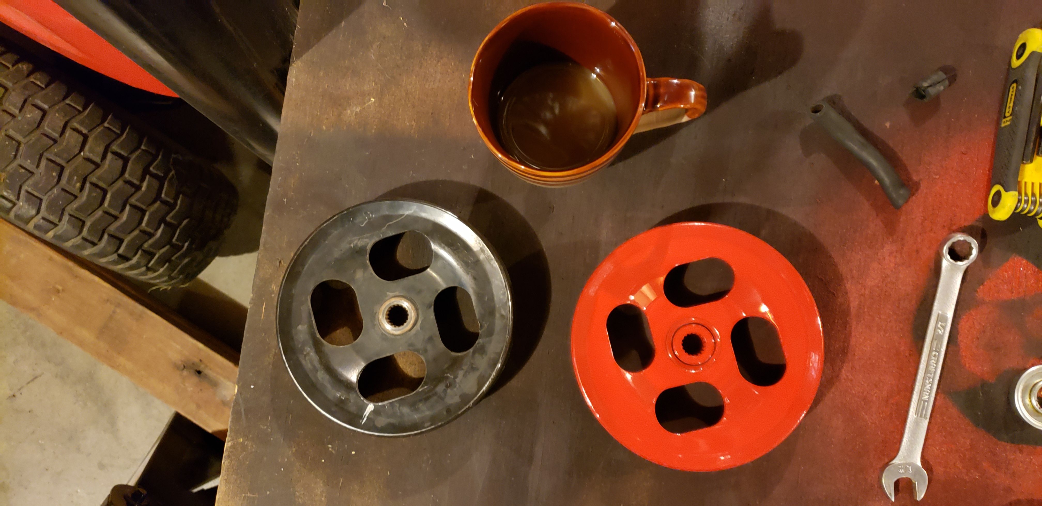

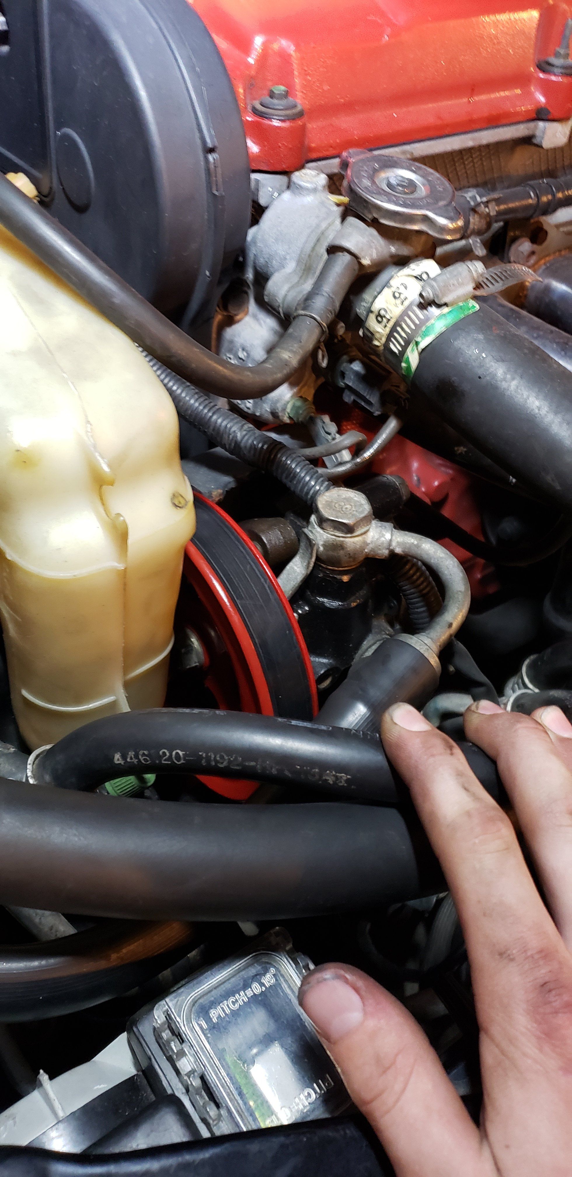

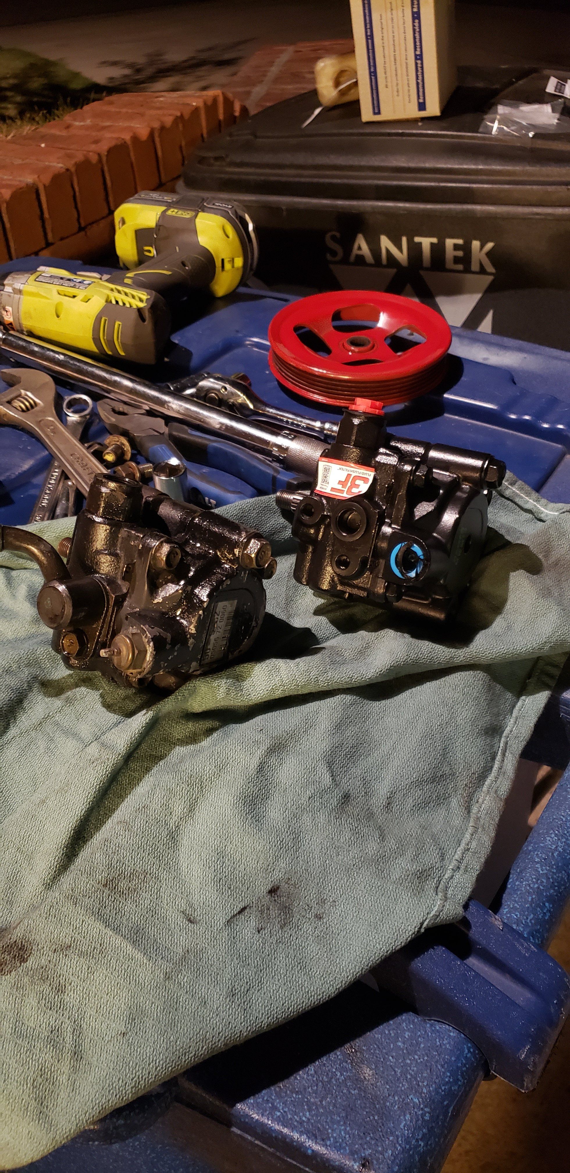

Today I installed my new powersteering pulley. The old one was warped, so I think this will give me a much smoother idle and acceleration.

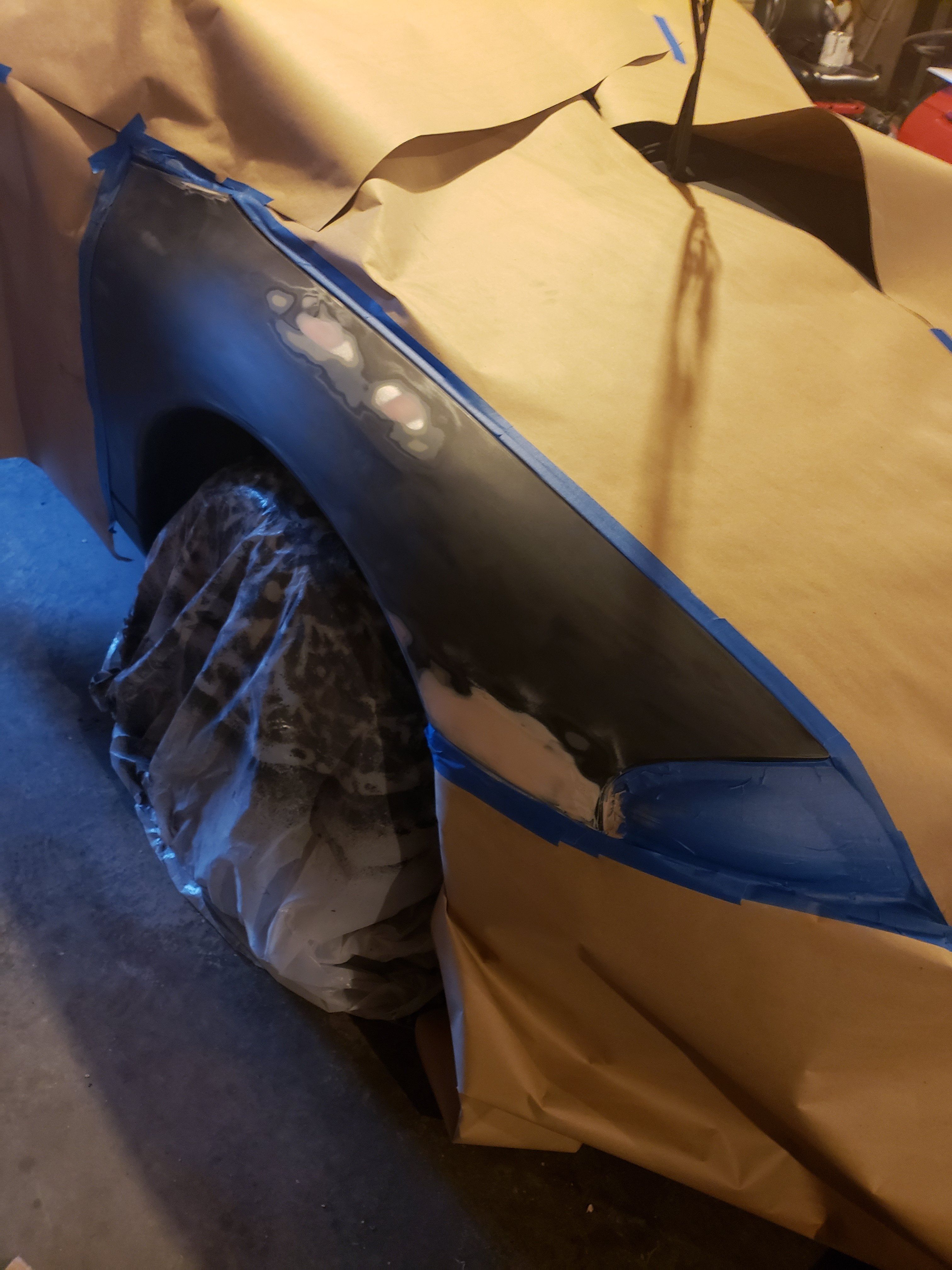

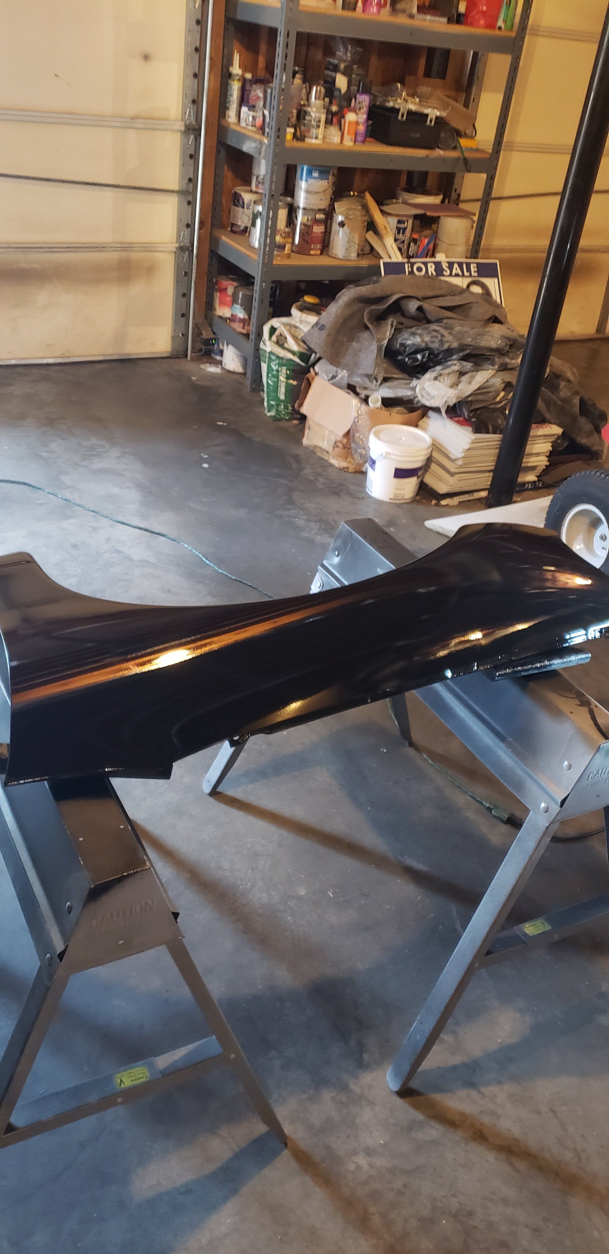

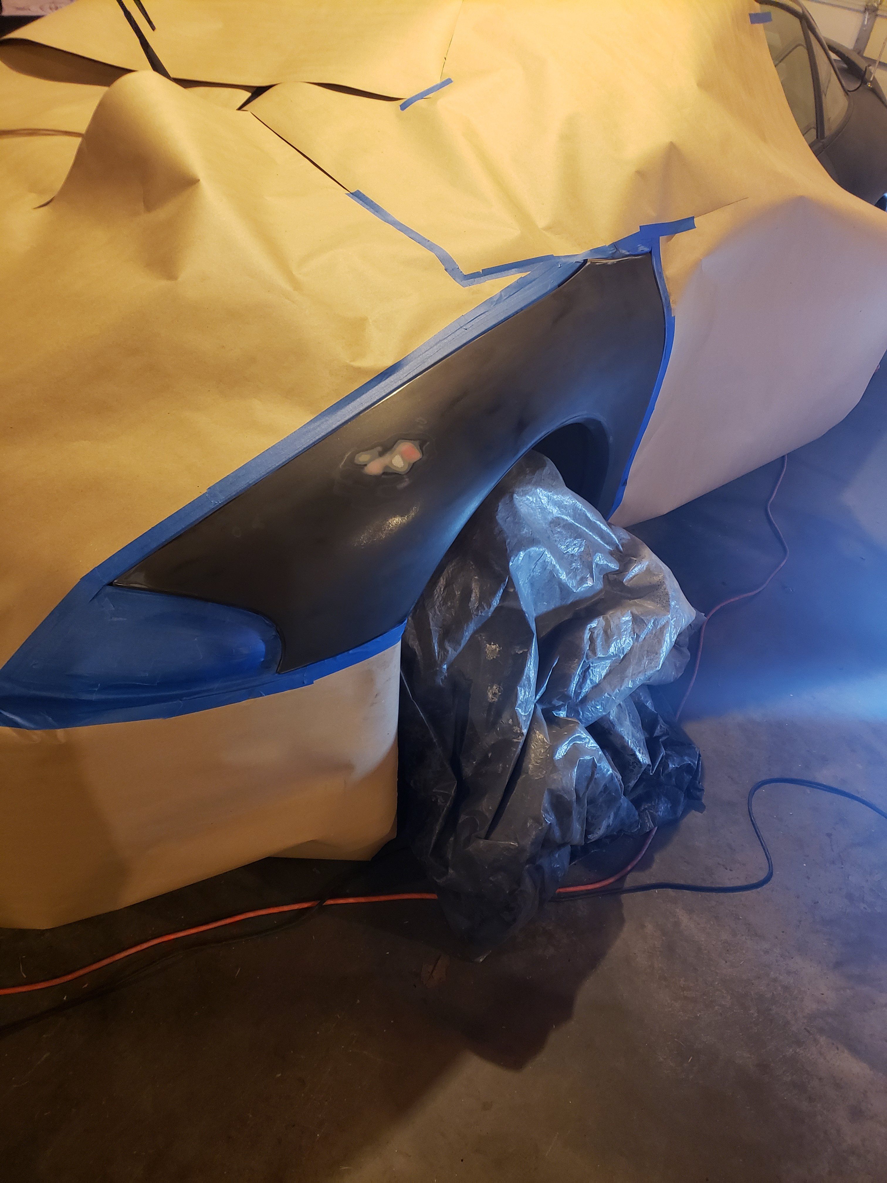

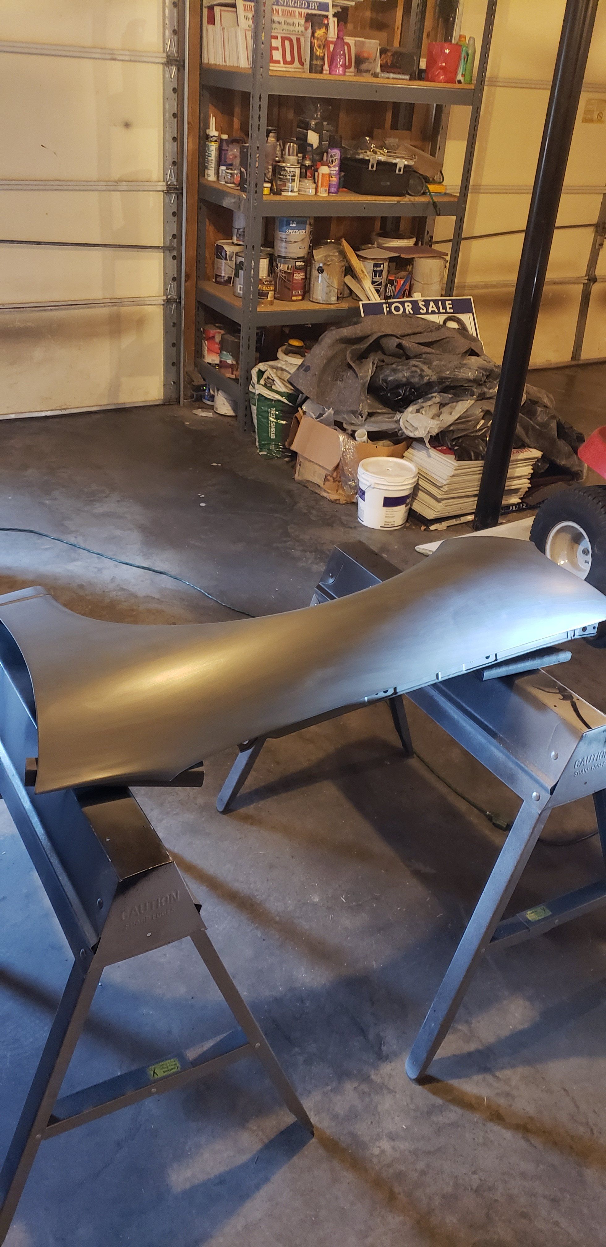

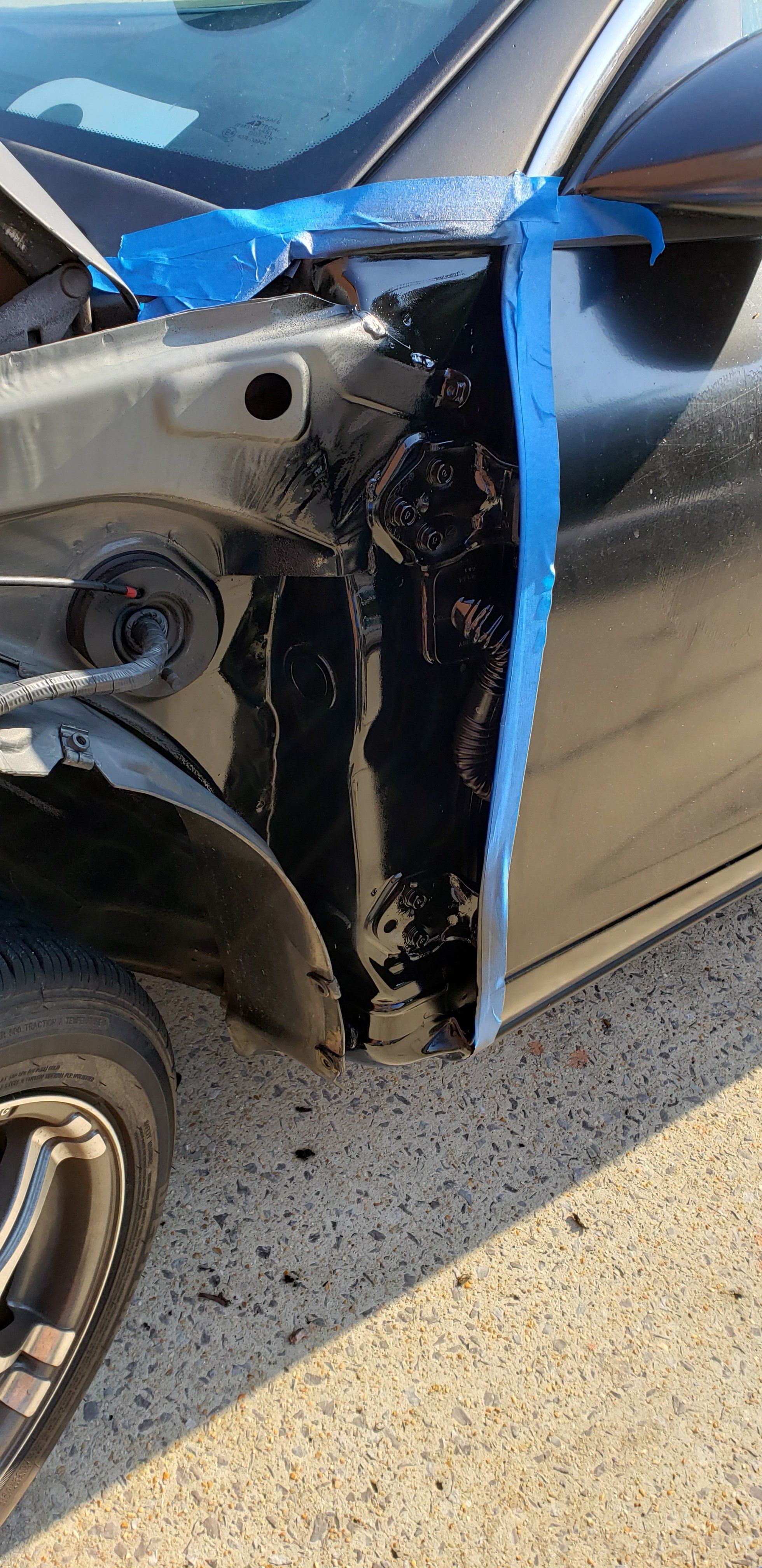

Painted fender today. Tomorrow I will install it along with the new headlights. Whenever I get more time I will have to paint and install the new bumper as well. Accident is almost undone!

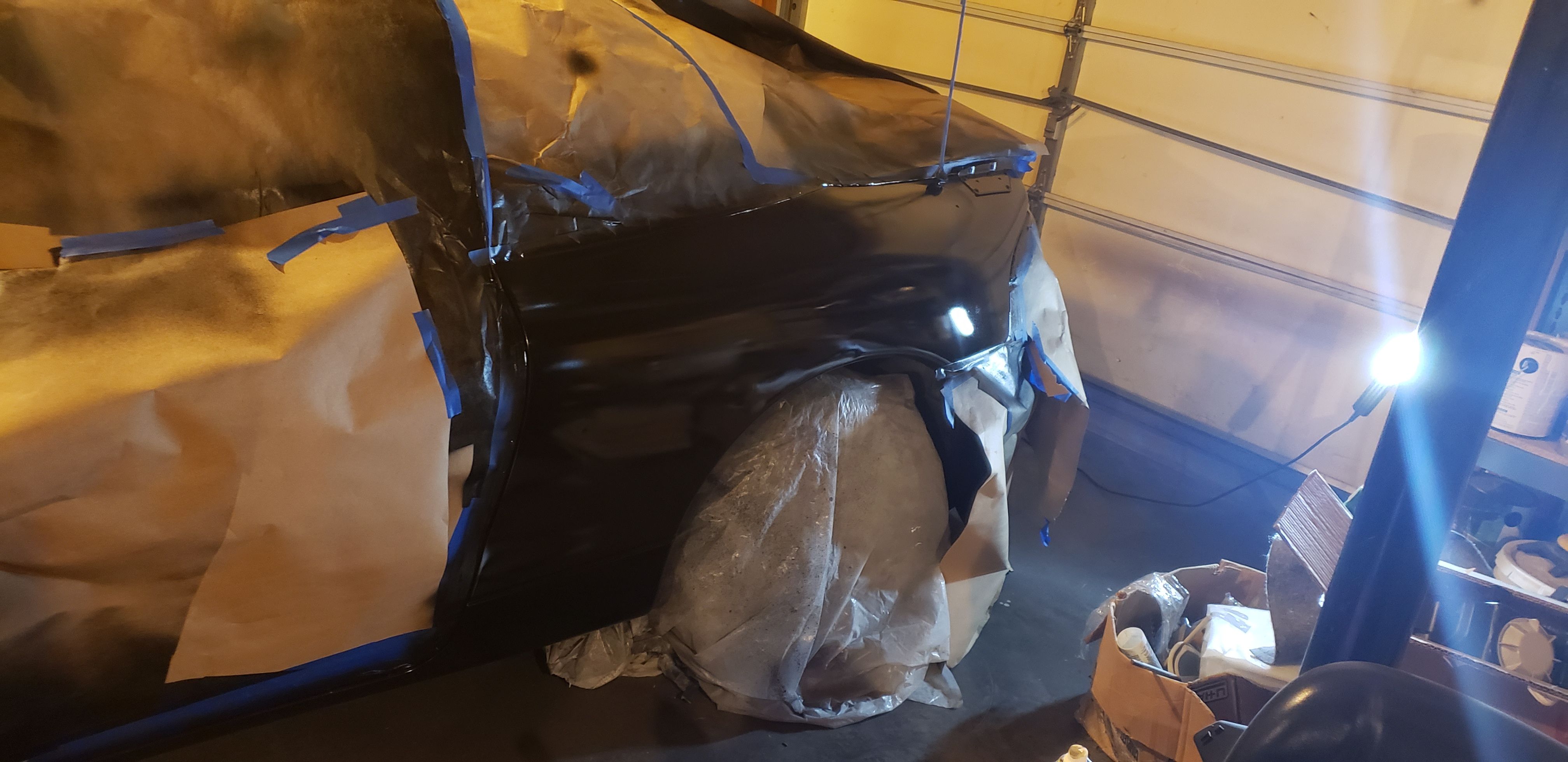

Last night I replaced the damaged fender and headlight. I decided to leave the bumper off, as it would be senseless to reinstall just to take it off again in a few days.

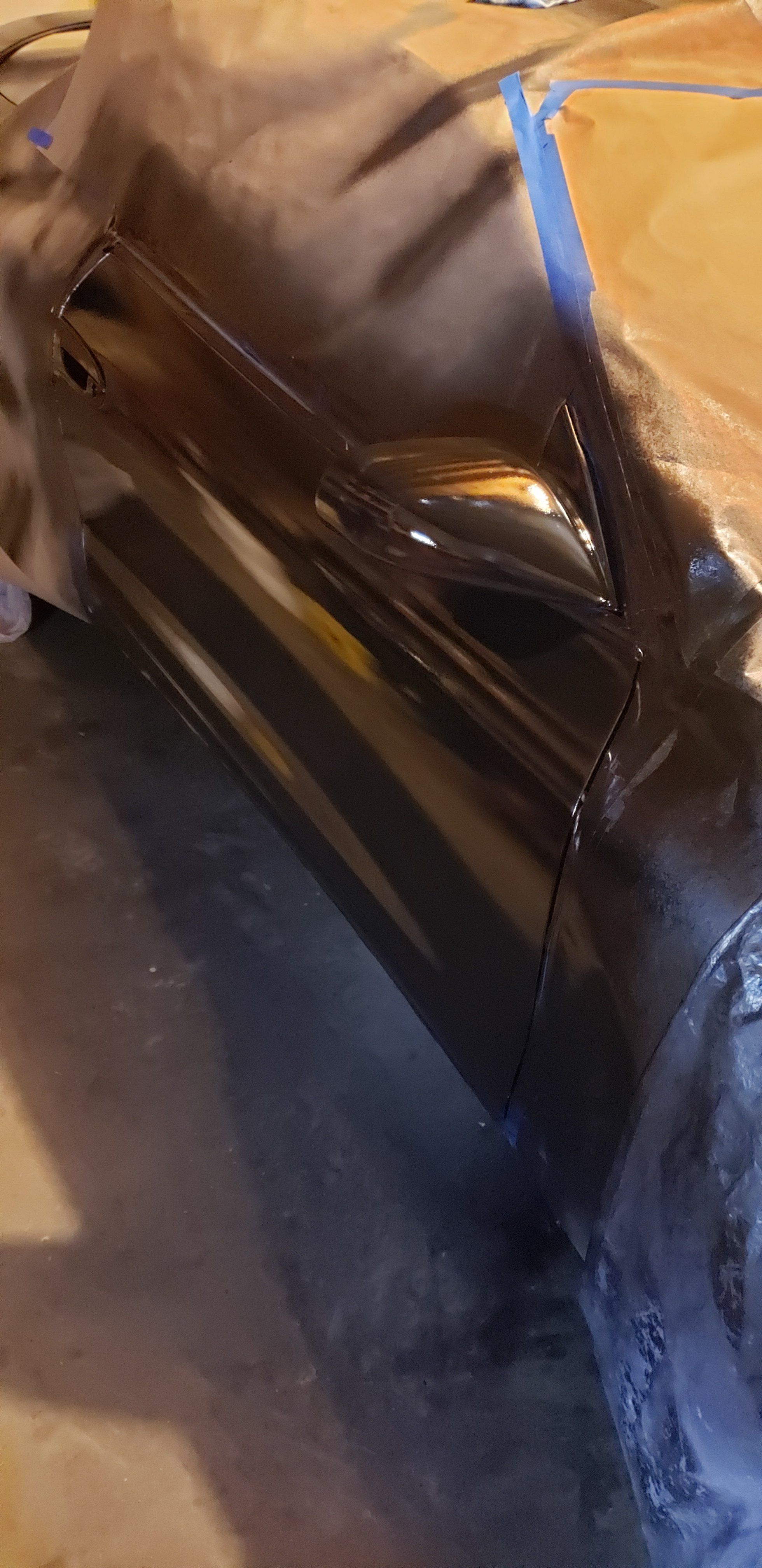

There was an unpainted spot behind that fender that wouldn't match very well. So I had to paint it. It's one of those details that nobody ever sees but it makes me feel better.

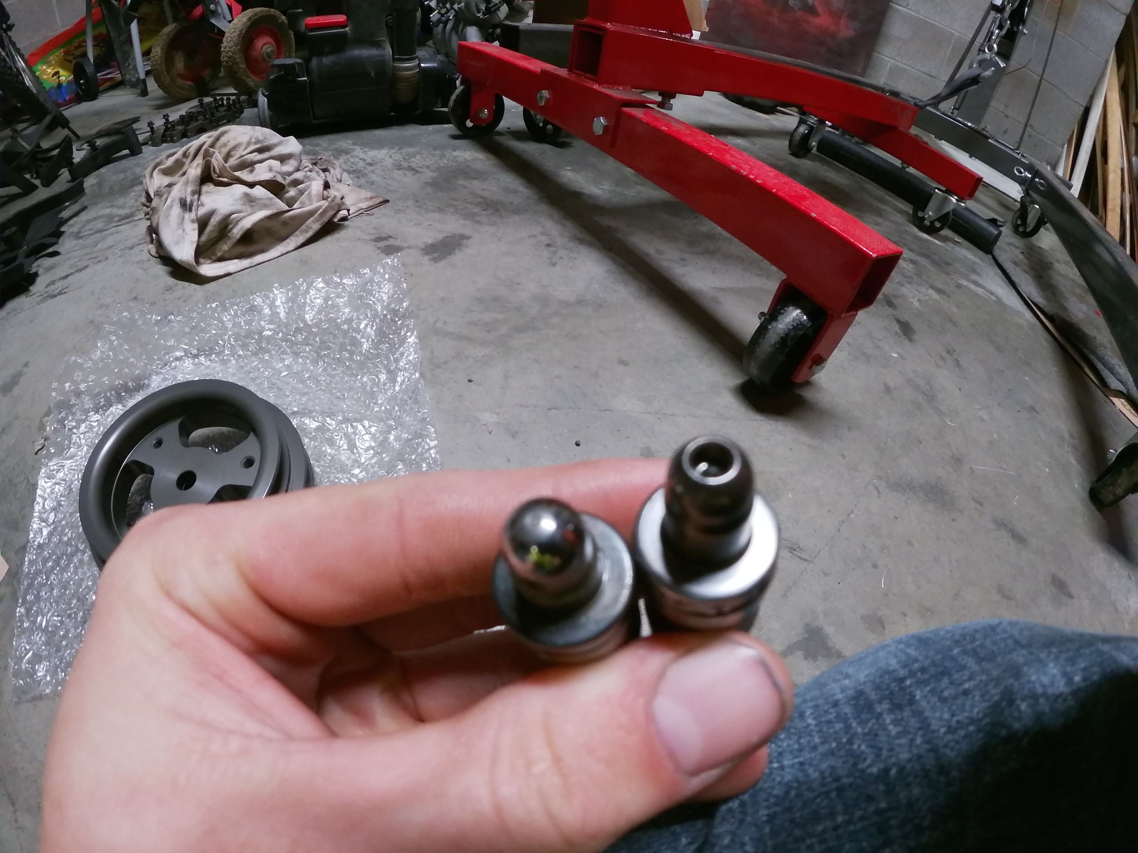

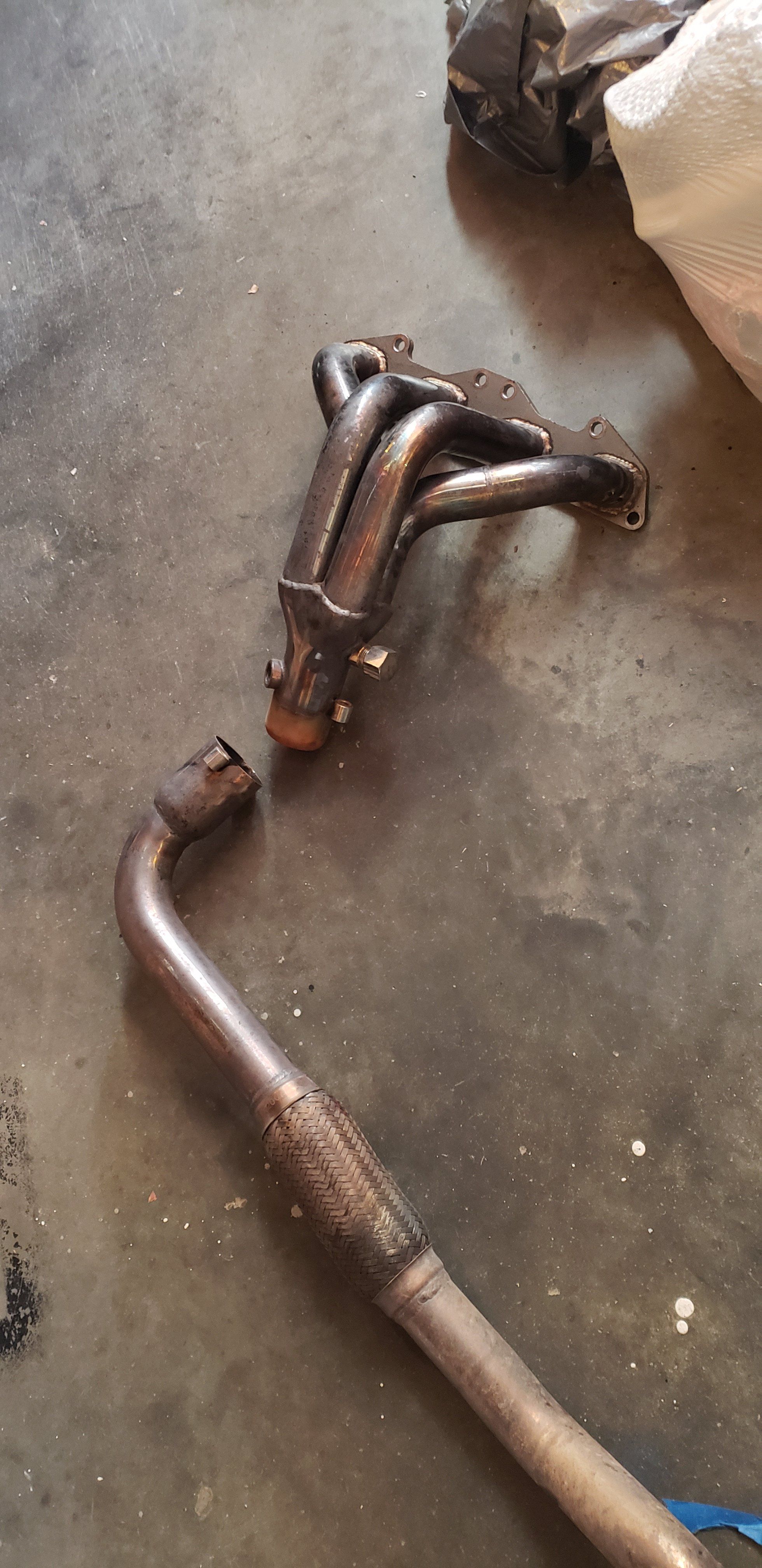

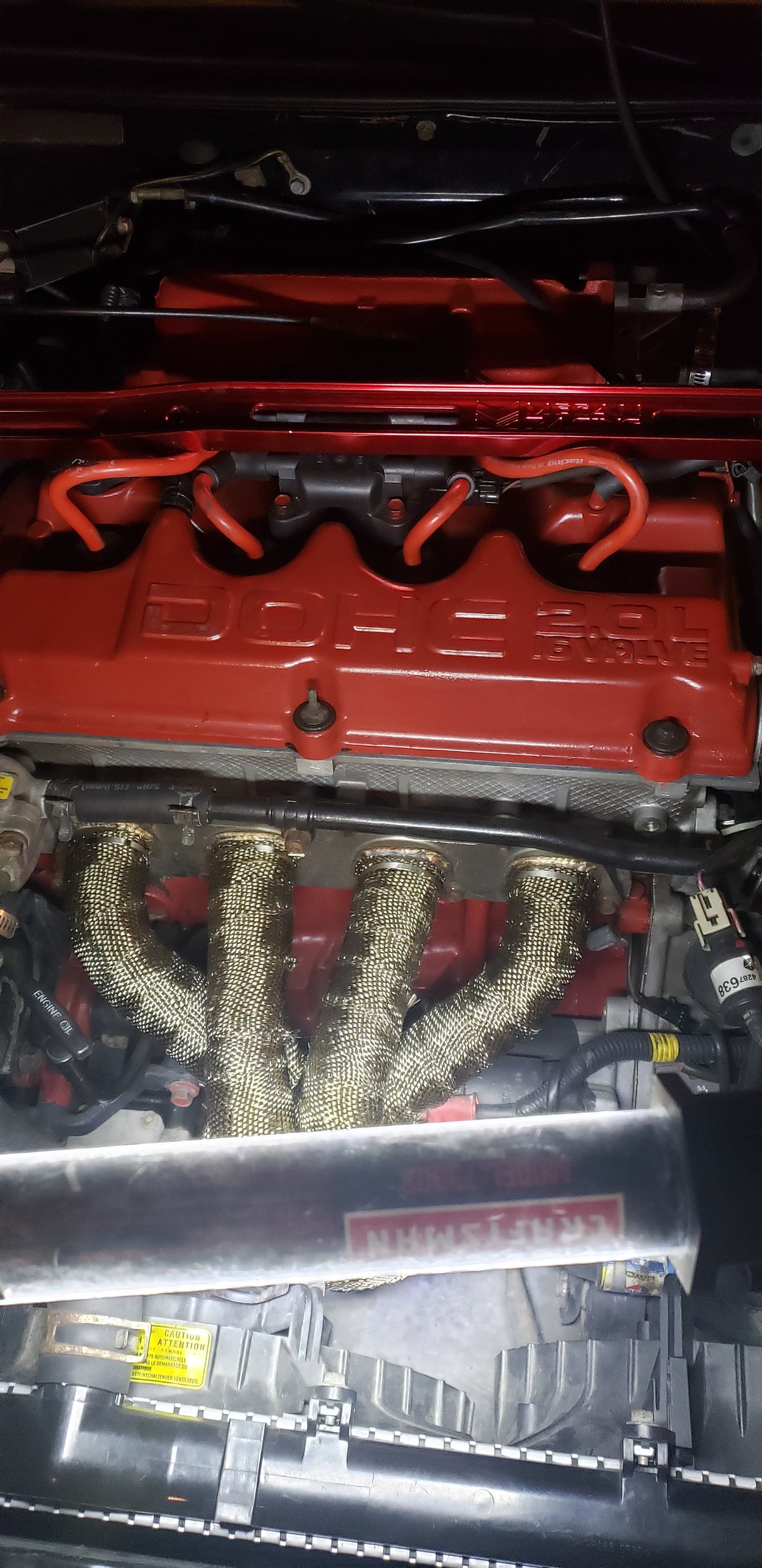

Torque Solutions shifter cable bushings have arrived. I also acquired some Energy Suspension polyurethane bushings for the shifter base. It should be tight soon... also 2 rolls of heat wrap and stainless wire ties. I will note that I am not a fan of the composite exhaust gaskets, but MLS are few and far for this application.

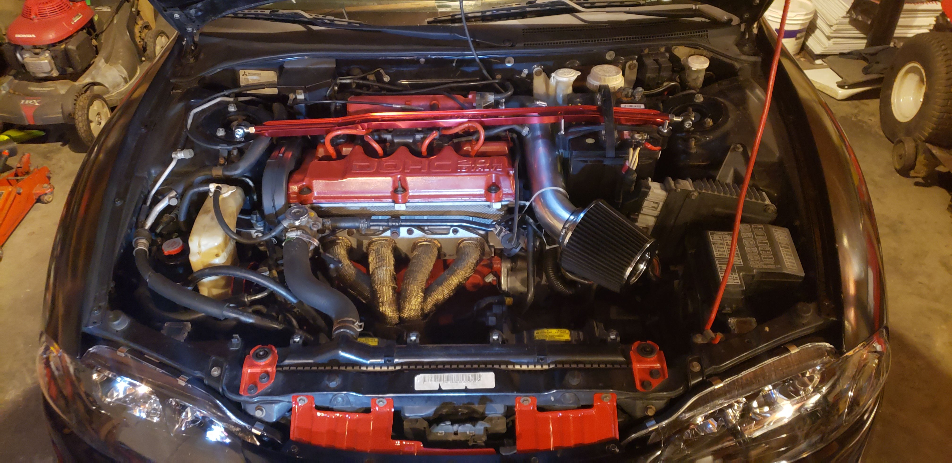

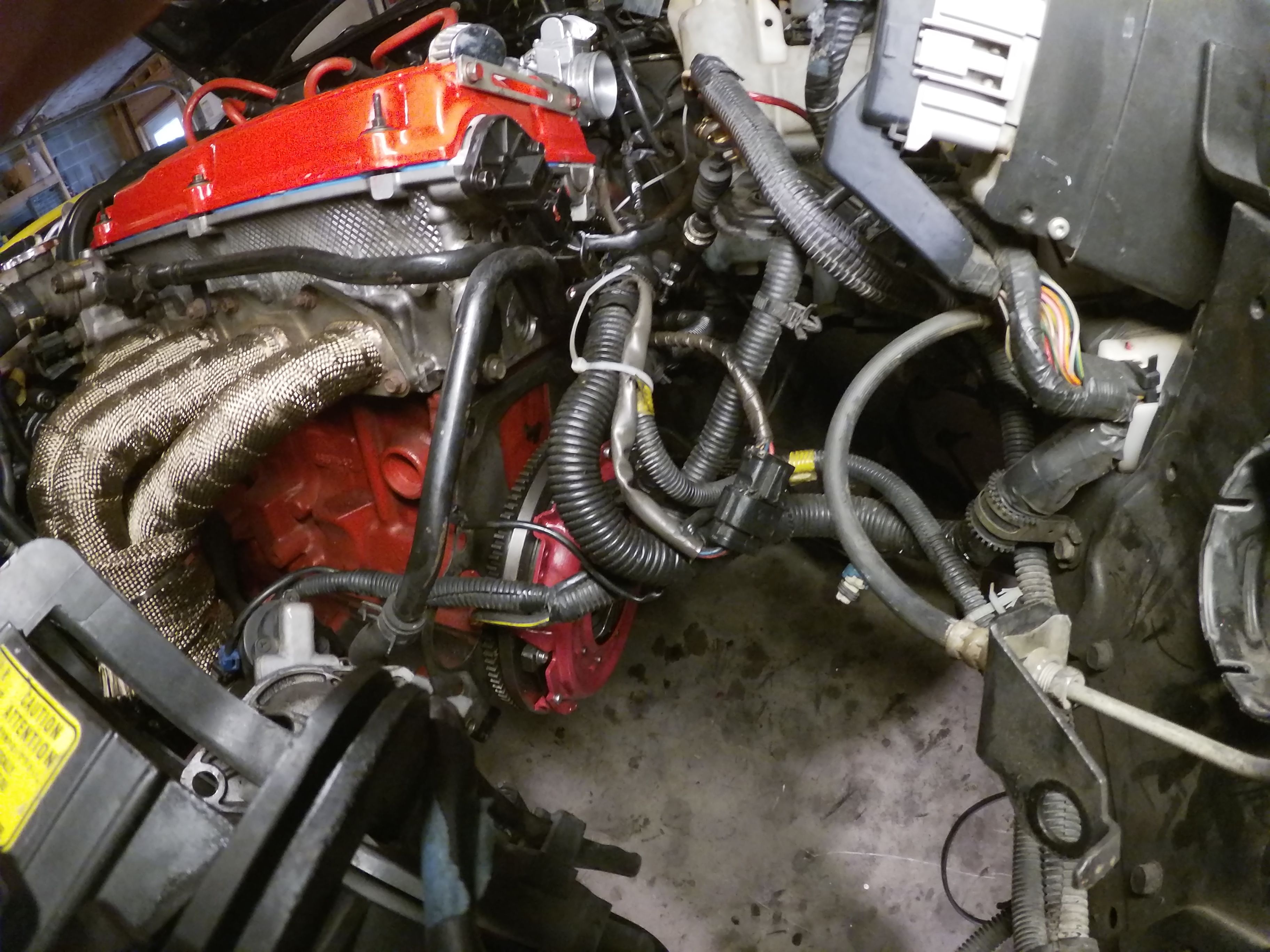

On Saturday I was able to wrap the headers and the downpipe along with changing the gaskets. I don't recall what grade of stainless this headers claims to be, but I'd say definitely not a T304 in reality.
And I also replaced my shifter bushings. A very much needed upgrade. LOL

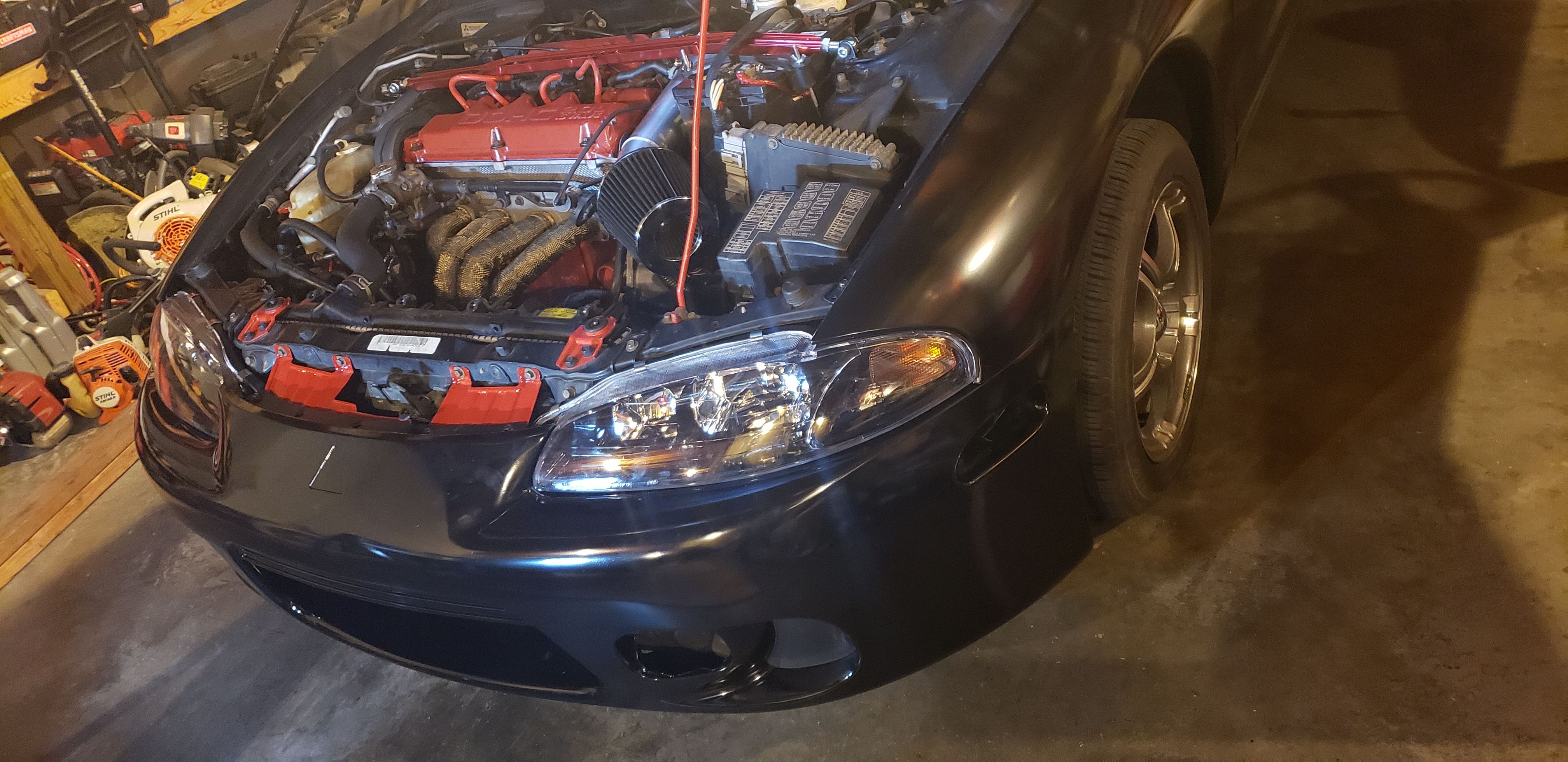

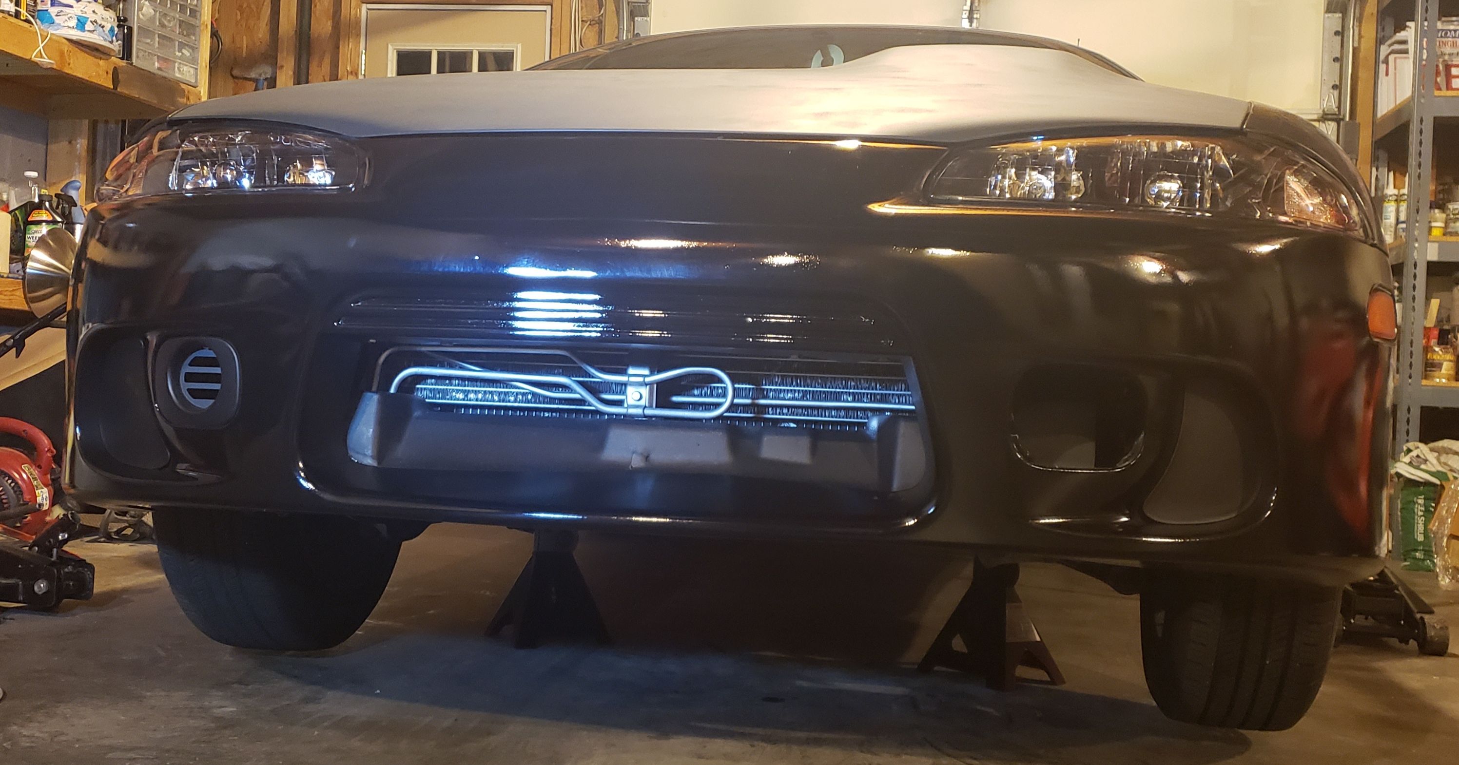

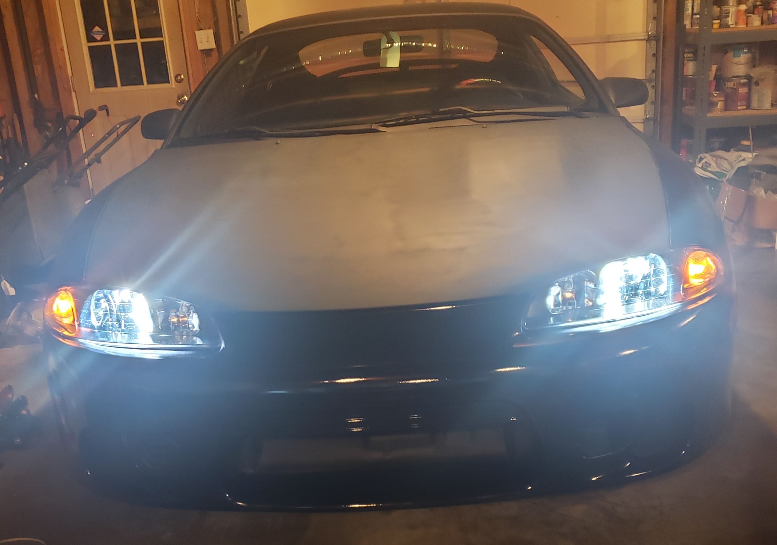

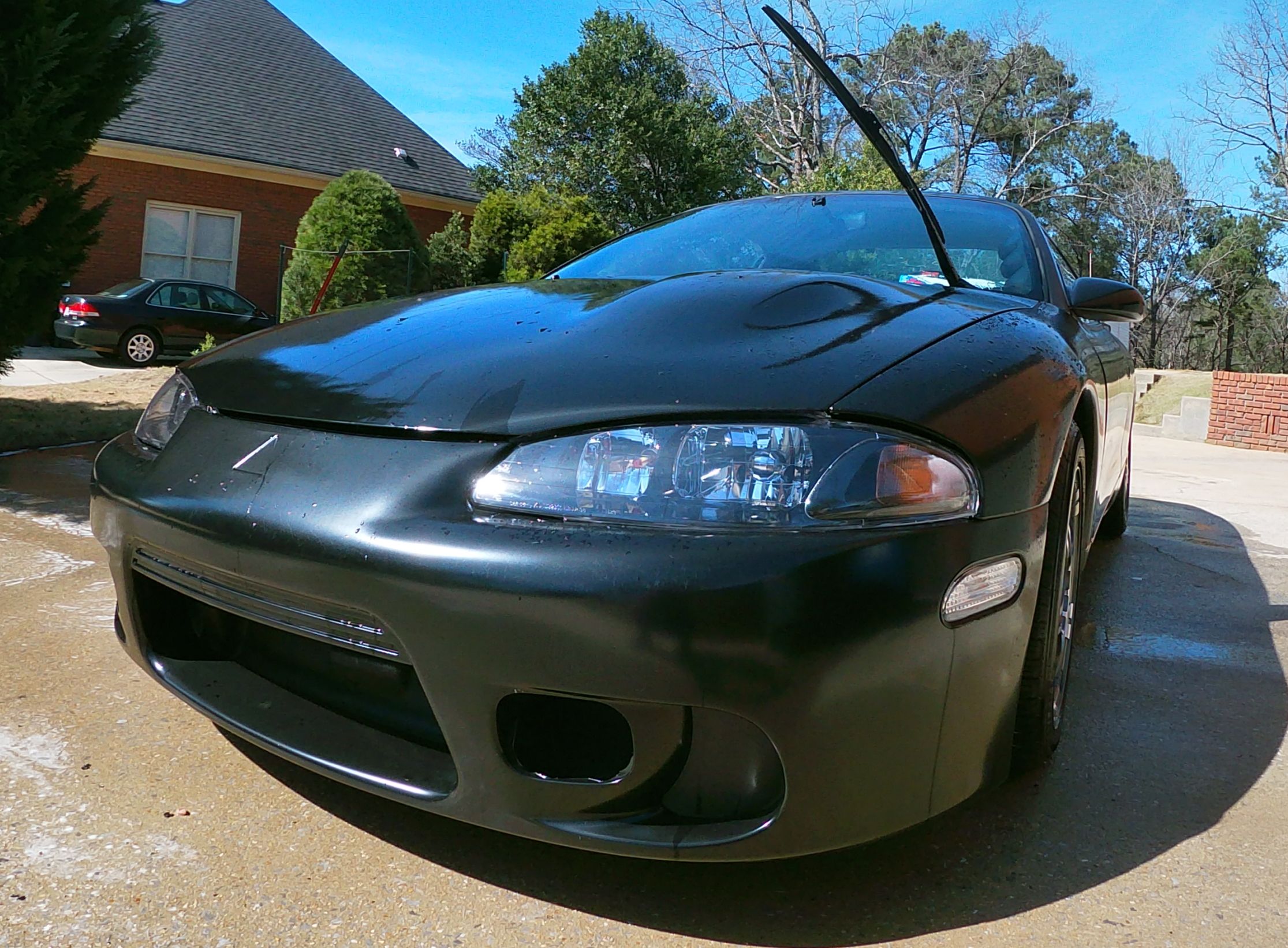

The accident is finally undone! In fact, the car is in better shape than it was before (besides that crash support). I did a little more customizing while I had the bumper off.
As you can see I sprayed some more of the red I had left over LOL. Damn she looks good!

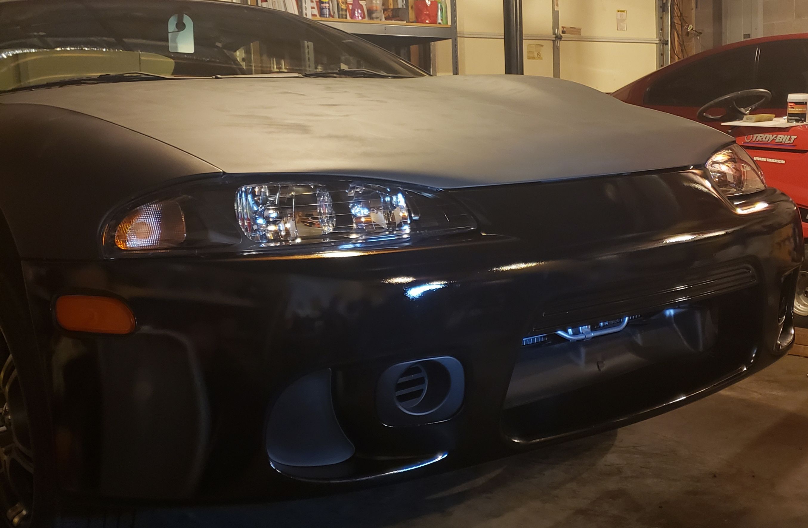

Today I ordered some white/clear custom side marker lights. I don't like the look of those old orange ones. This should just be a quick plug n play, especially since I left the old ones off.

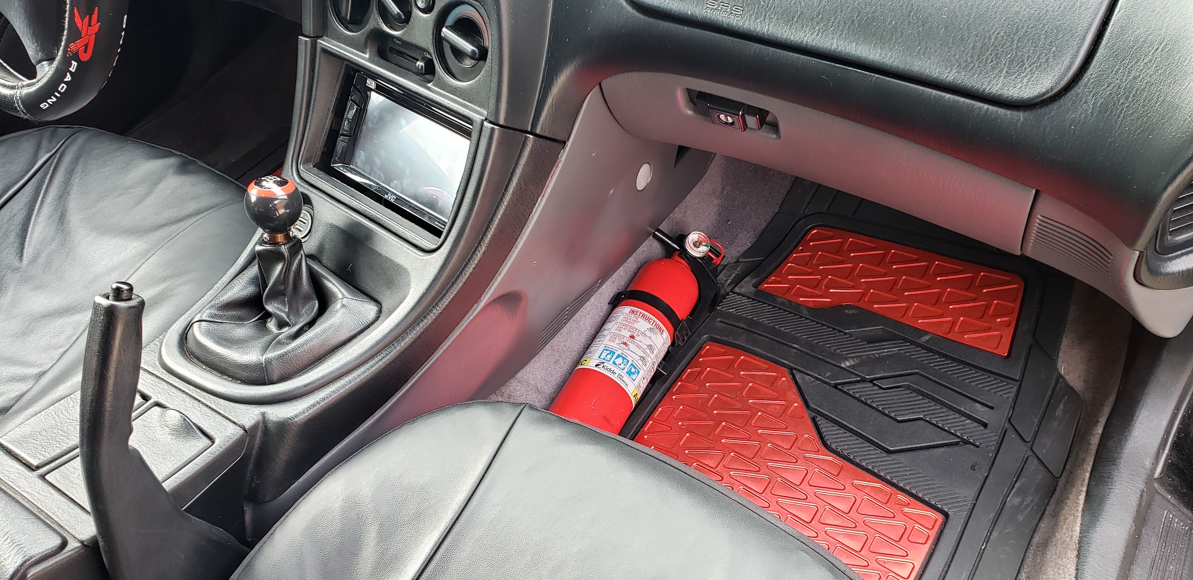

Just mounted a fire extinguisher inside the car. I plan on taking it to all the events I can, and going to the strip ocasionally too. I've got to have a fire extinguisher for these things, just in case. Not that I'll have a carburetor fire or anything, but I'm deep enough in the investment that I'd prefer it doesn't cook on the side of a highway.
