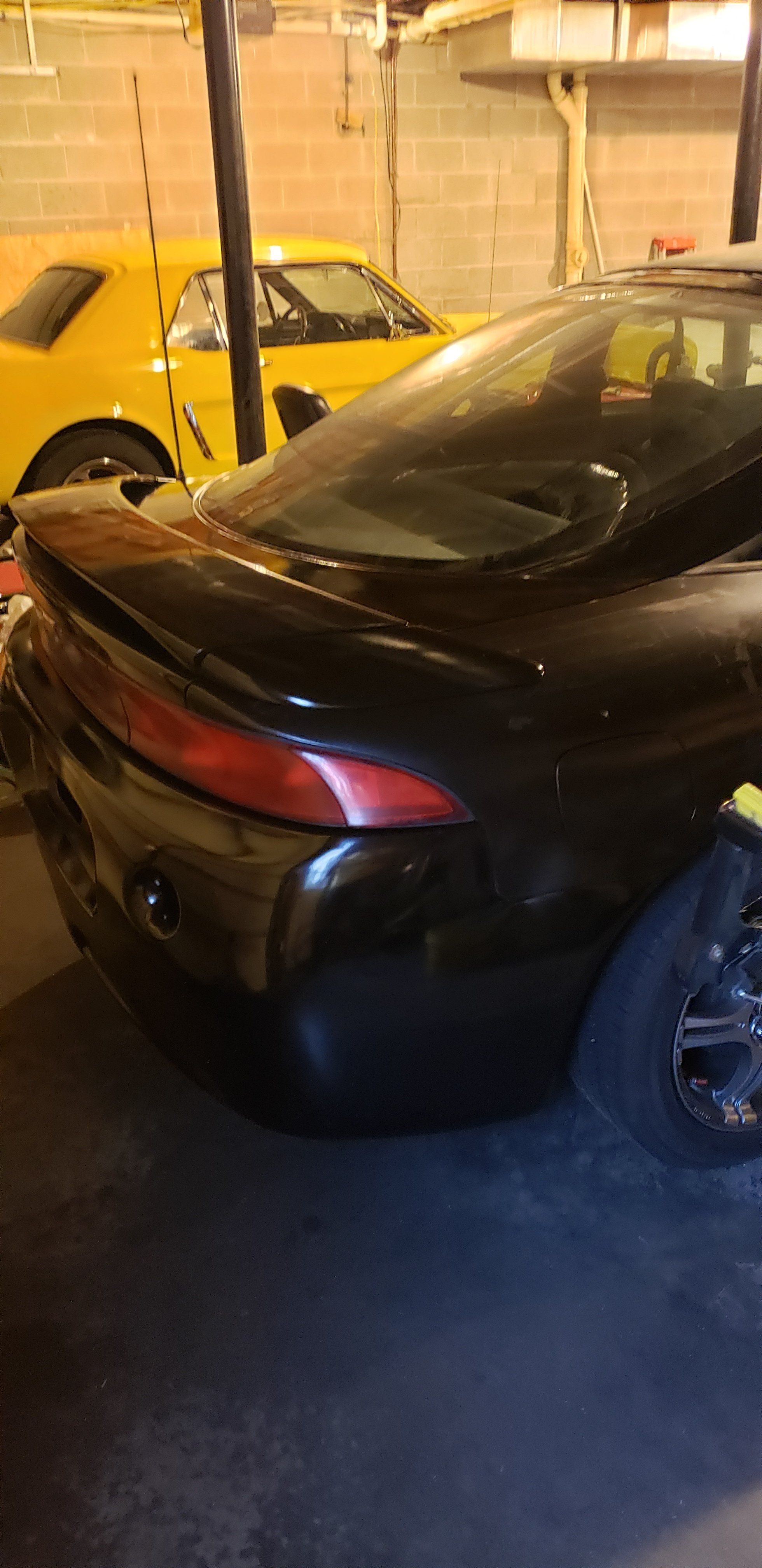

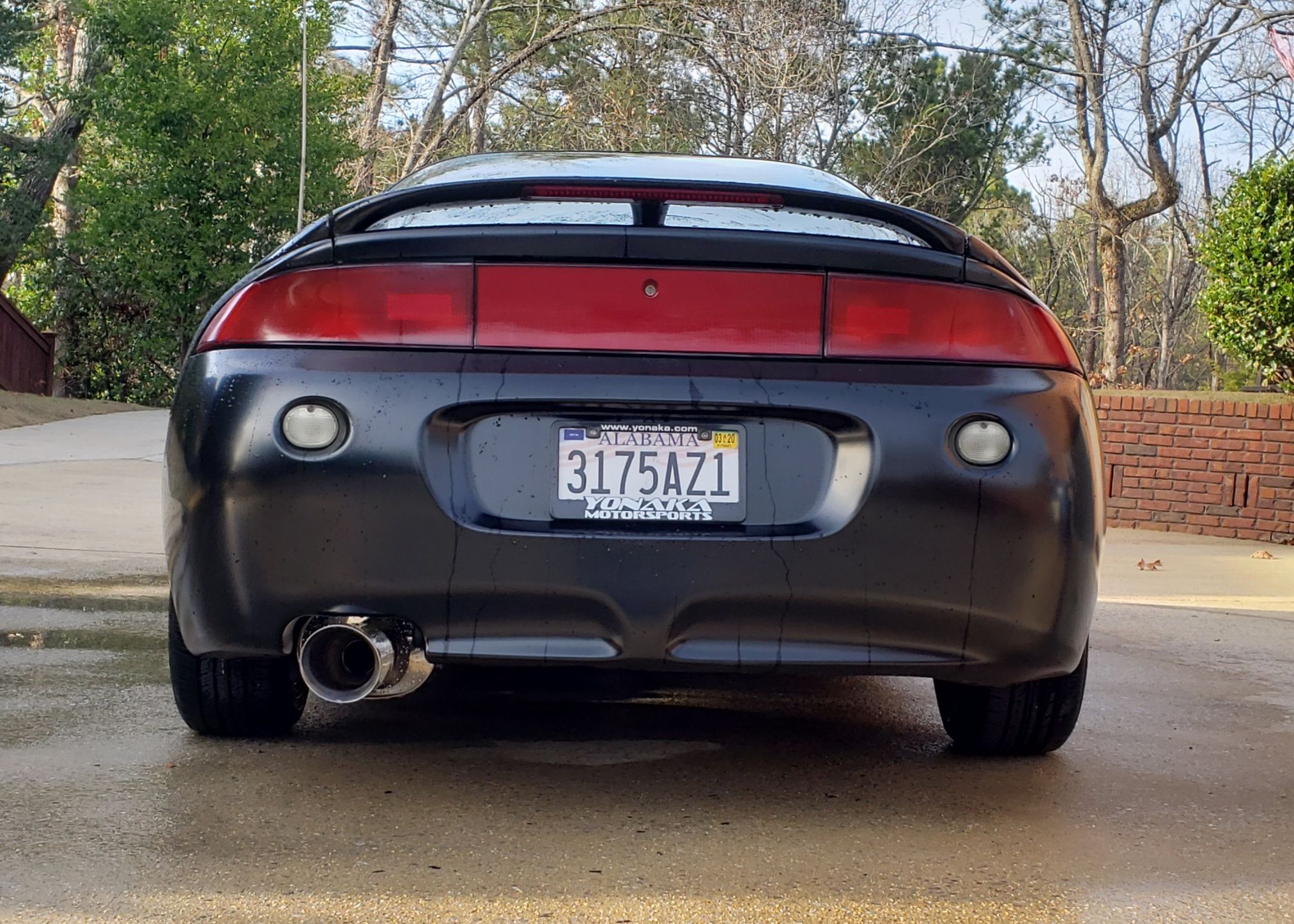

Rear bumper painted, spoiler installed.

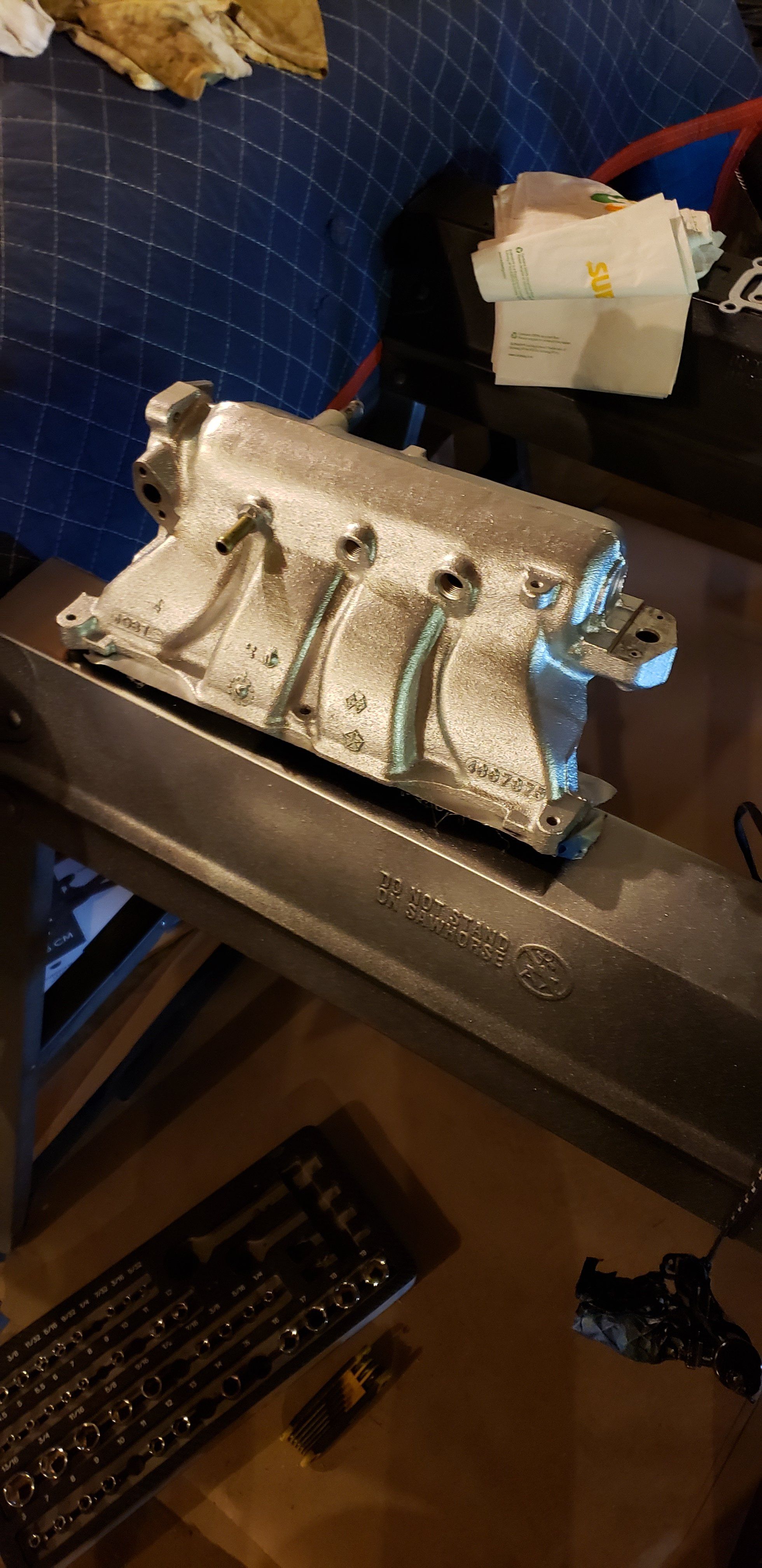

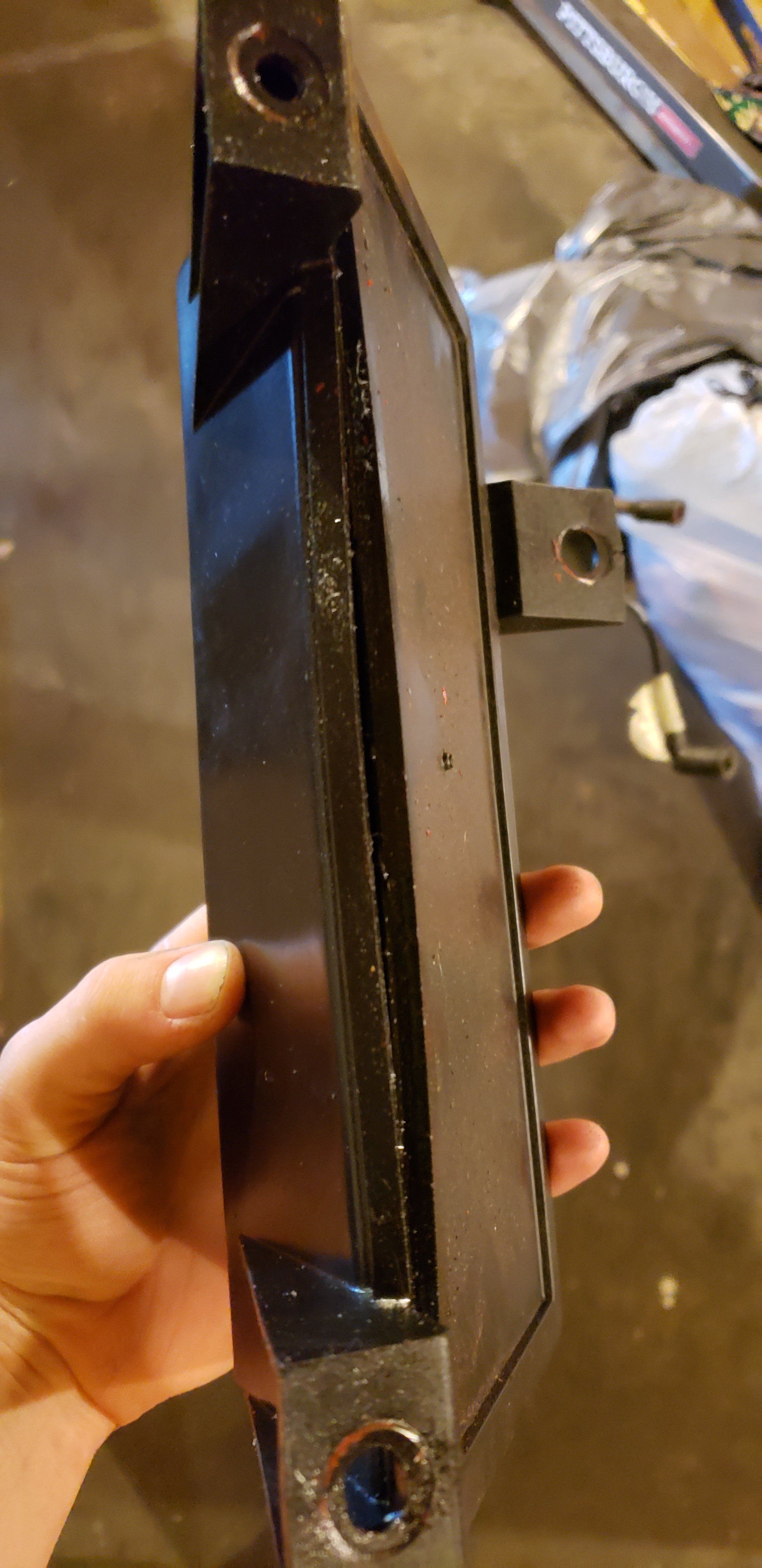

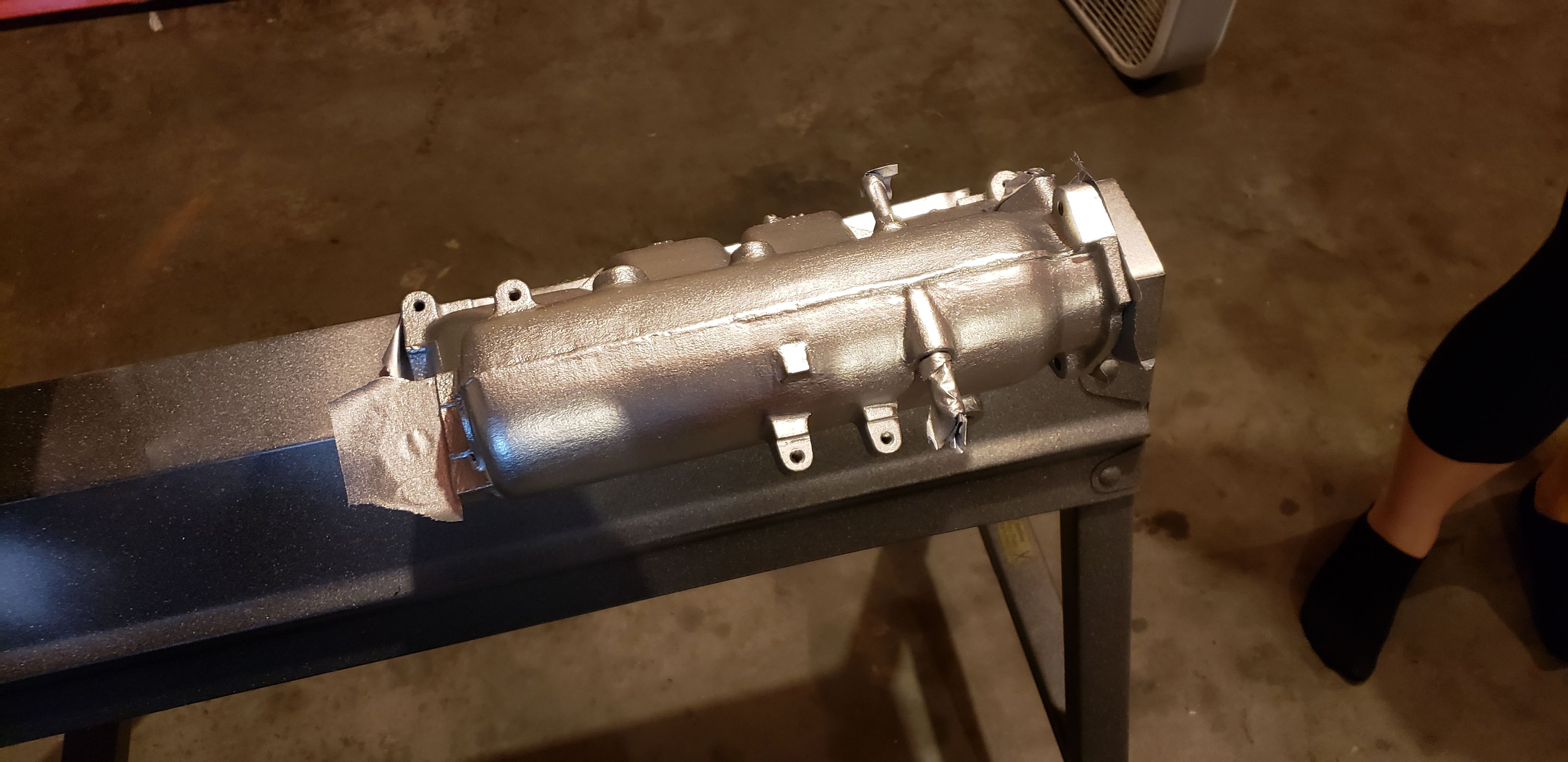

P, P&P manifold. (painted, ported and polished)

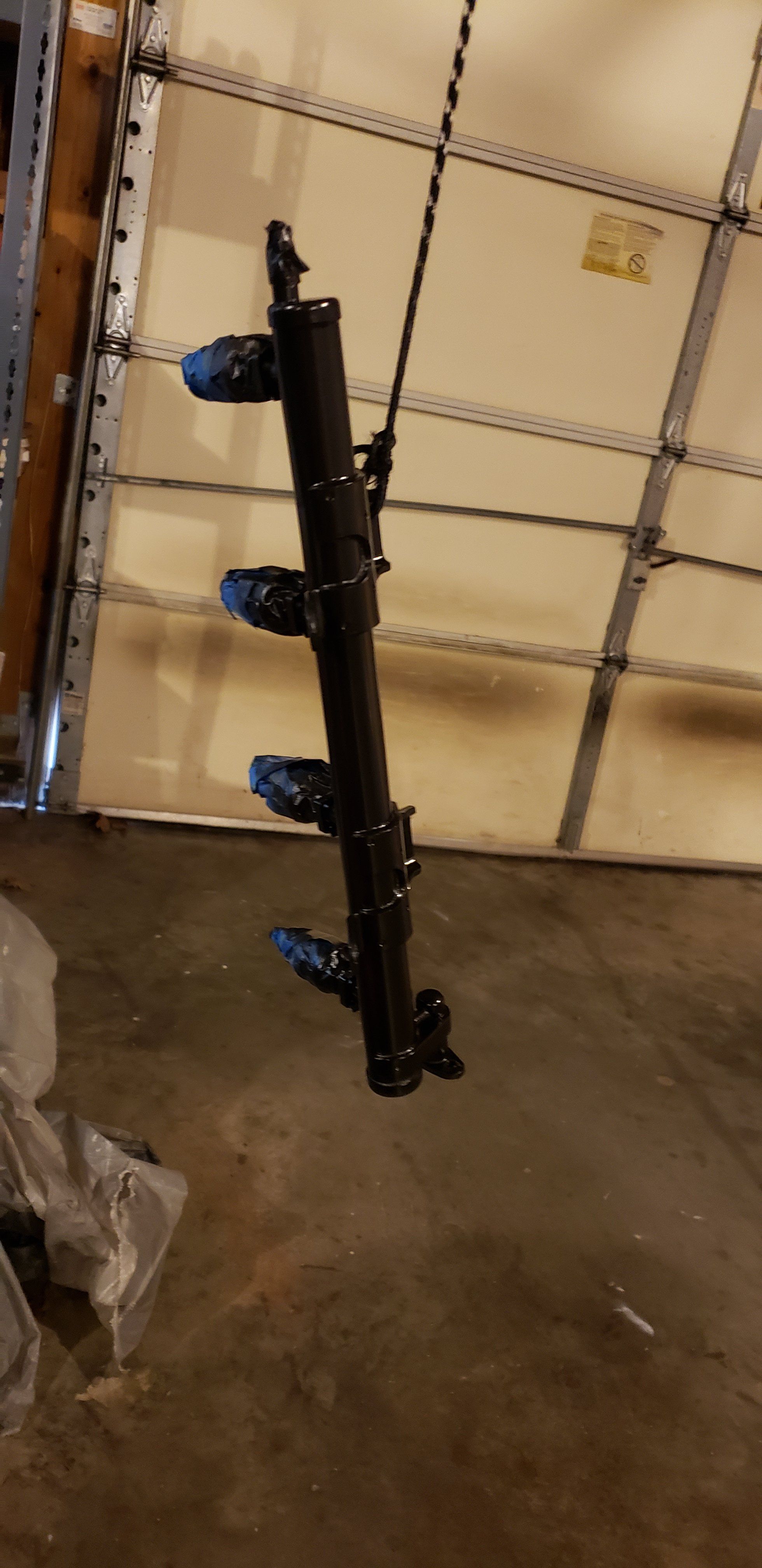

My newly painted fuel rail.
Here's a better shot of the paint on the manifold. I was worried trying to grind away the upper seam would cause an issue, but the rest turned out great.

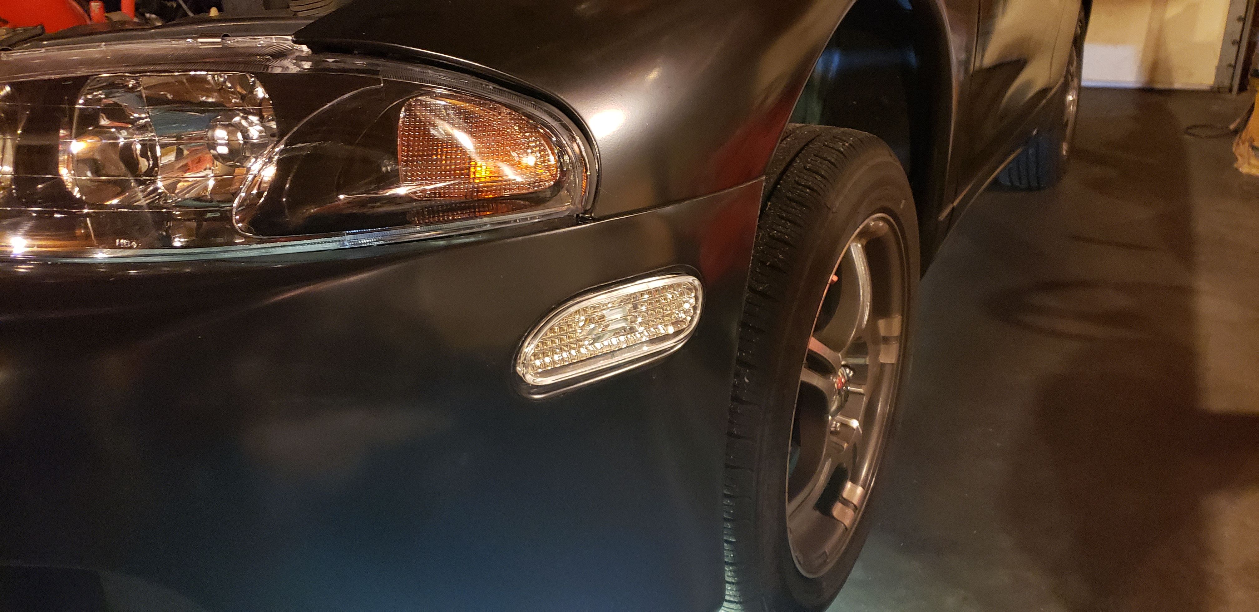

Also I finally installed the custom side marker lights.

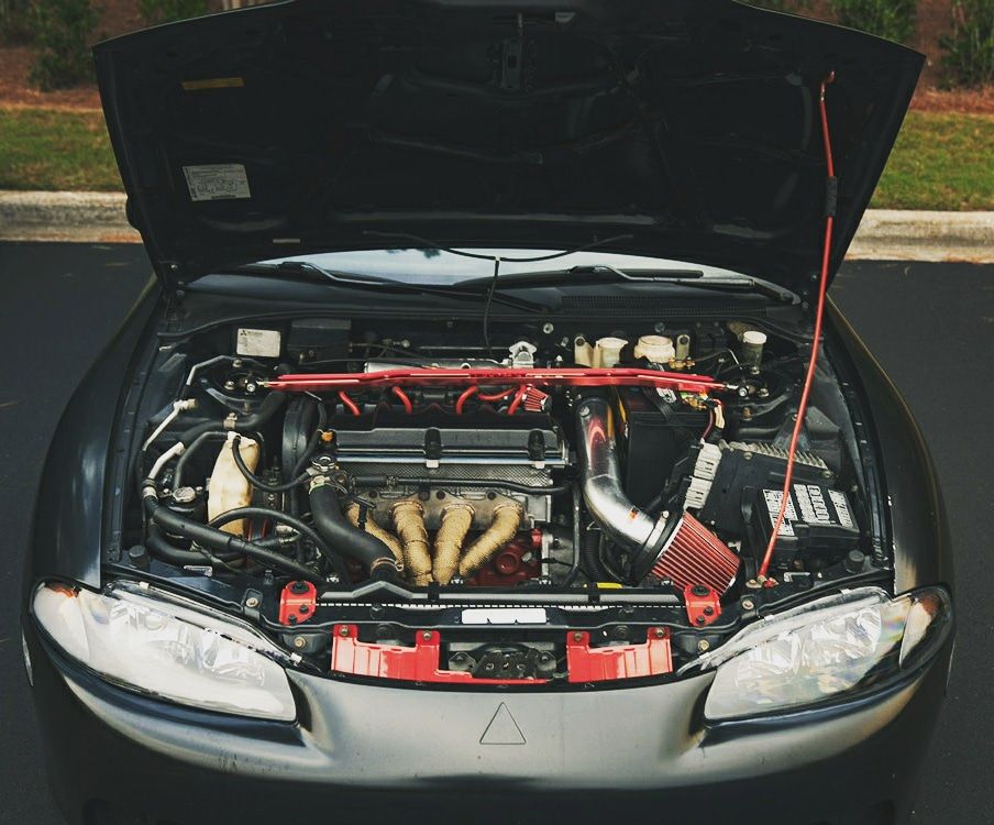

Finally got the lights hooked up, wheel well covers installed, engine bay assembled and cleaned up, swept the shop floor etc etc. The car is looking nice, I can't wait to continue with it.
I started it up in the driveway, and immediately the engine settled down to the 750 rpm idle like its supposed to. No more idle surging. I took it on a little cruise. I decided to take it on the interstate this evening to see how much better it feels. It actually had me excited. Runs so much smoother now. Throttle response is awesome. No more sputtering. I really enjoyed myself and the car this evening. It works like a charm. It's not terribly faster, but it is smooth and fun to drive regardless.

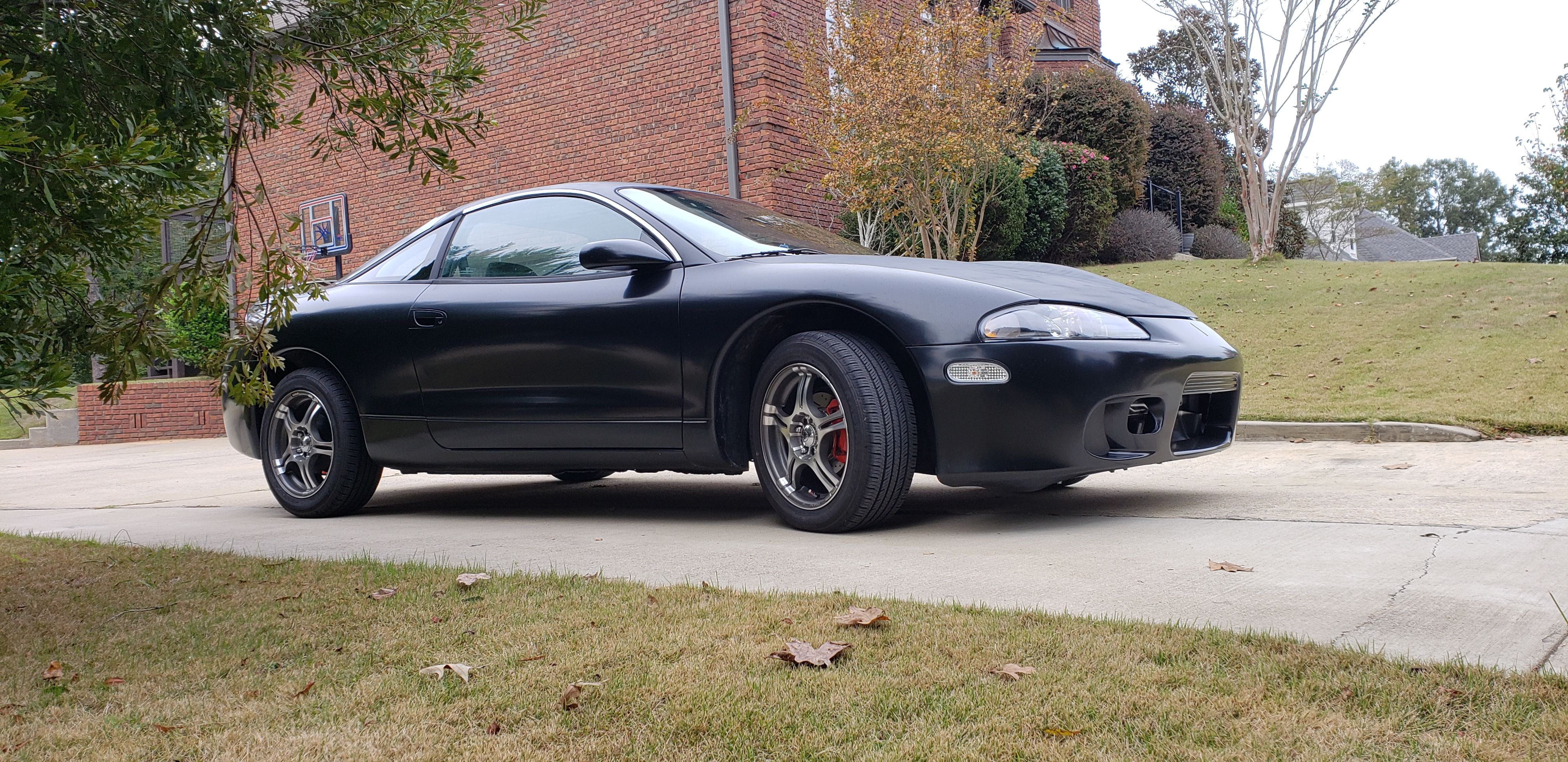

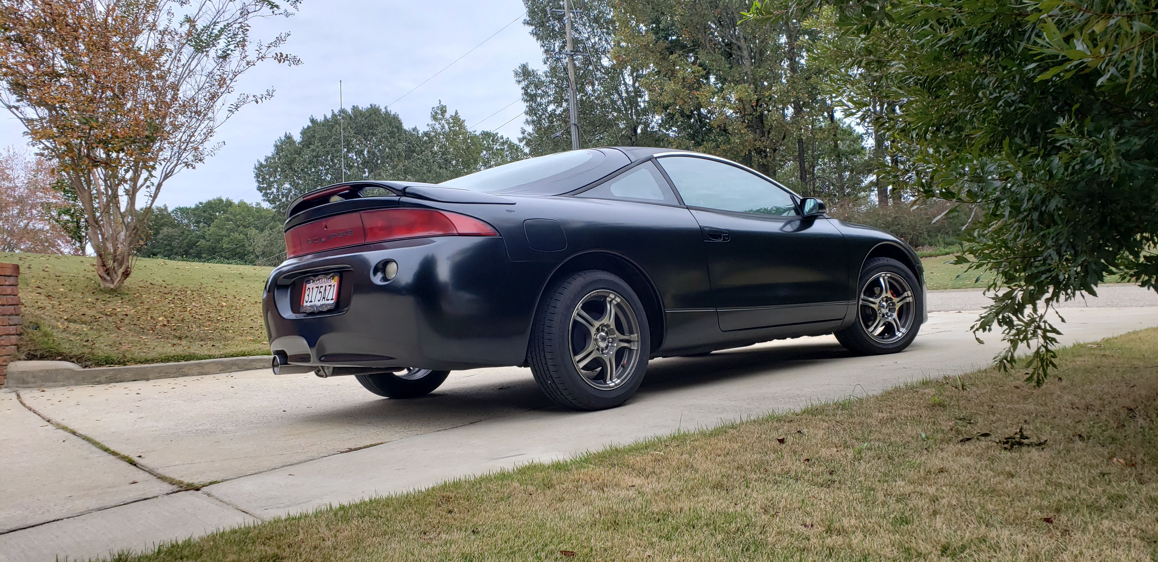

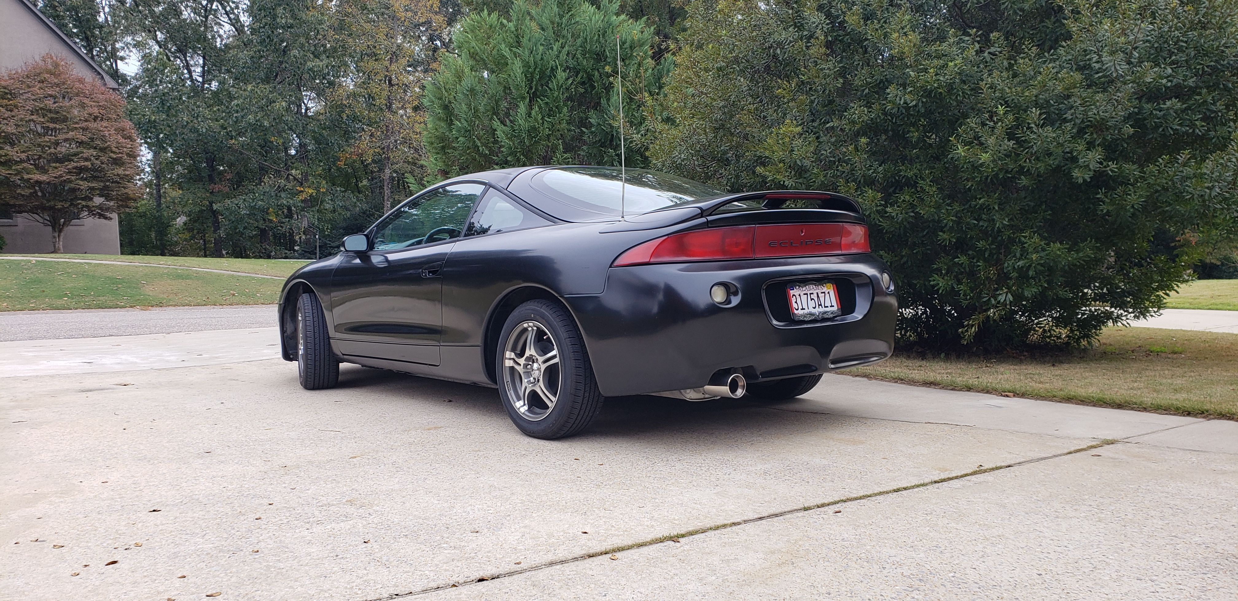

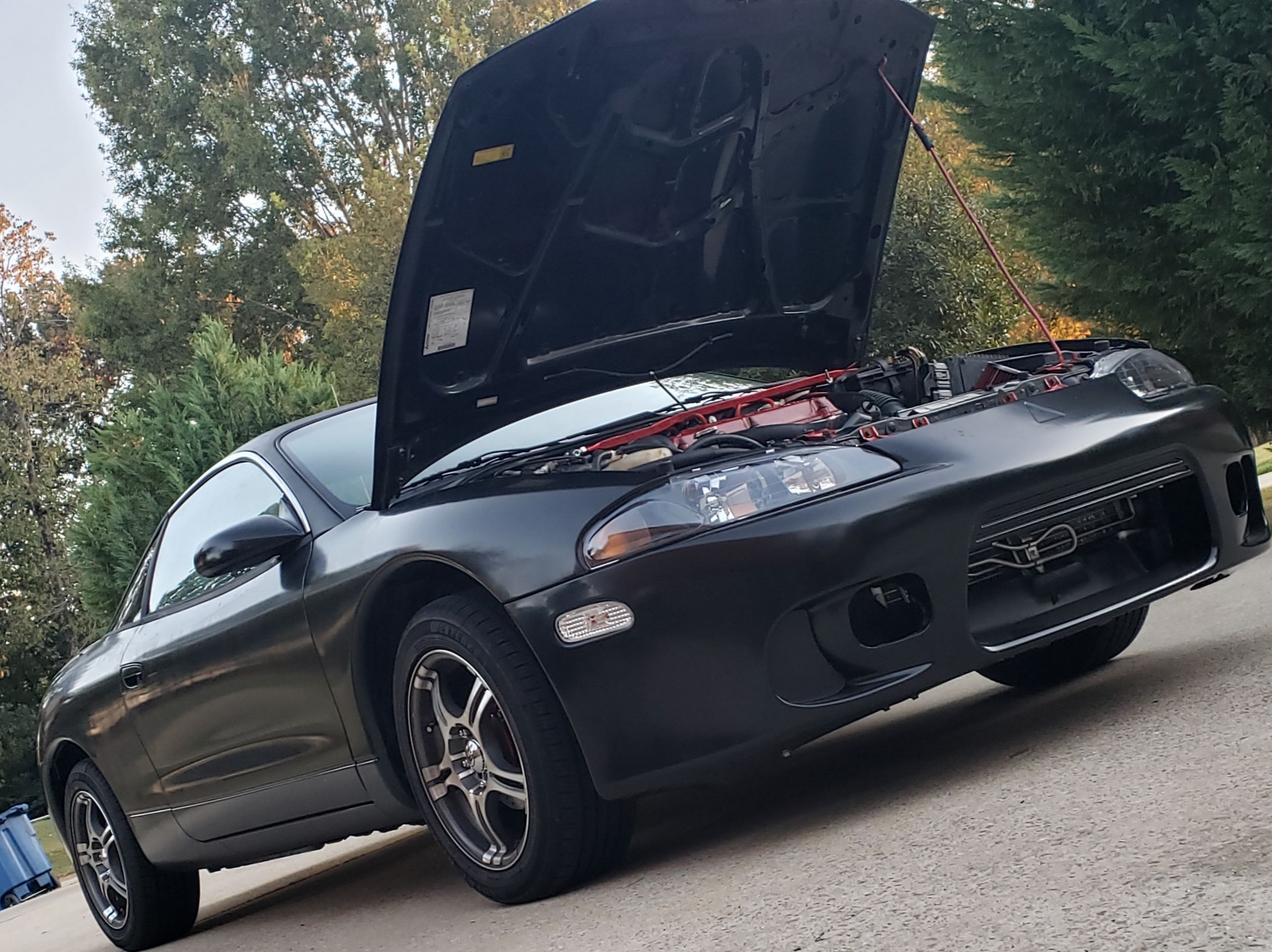

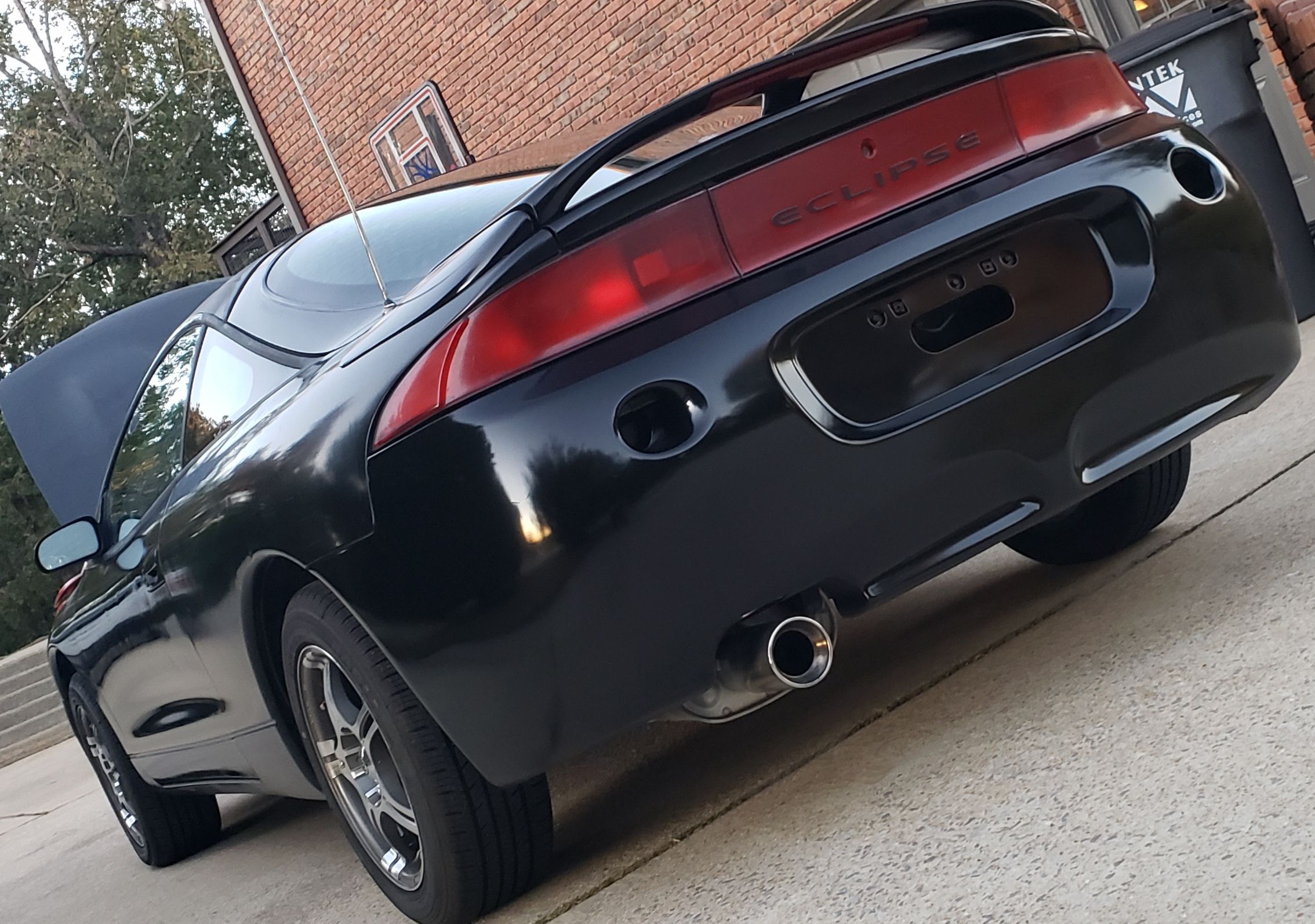

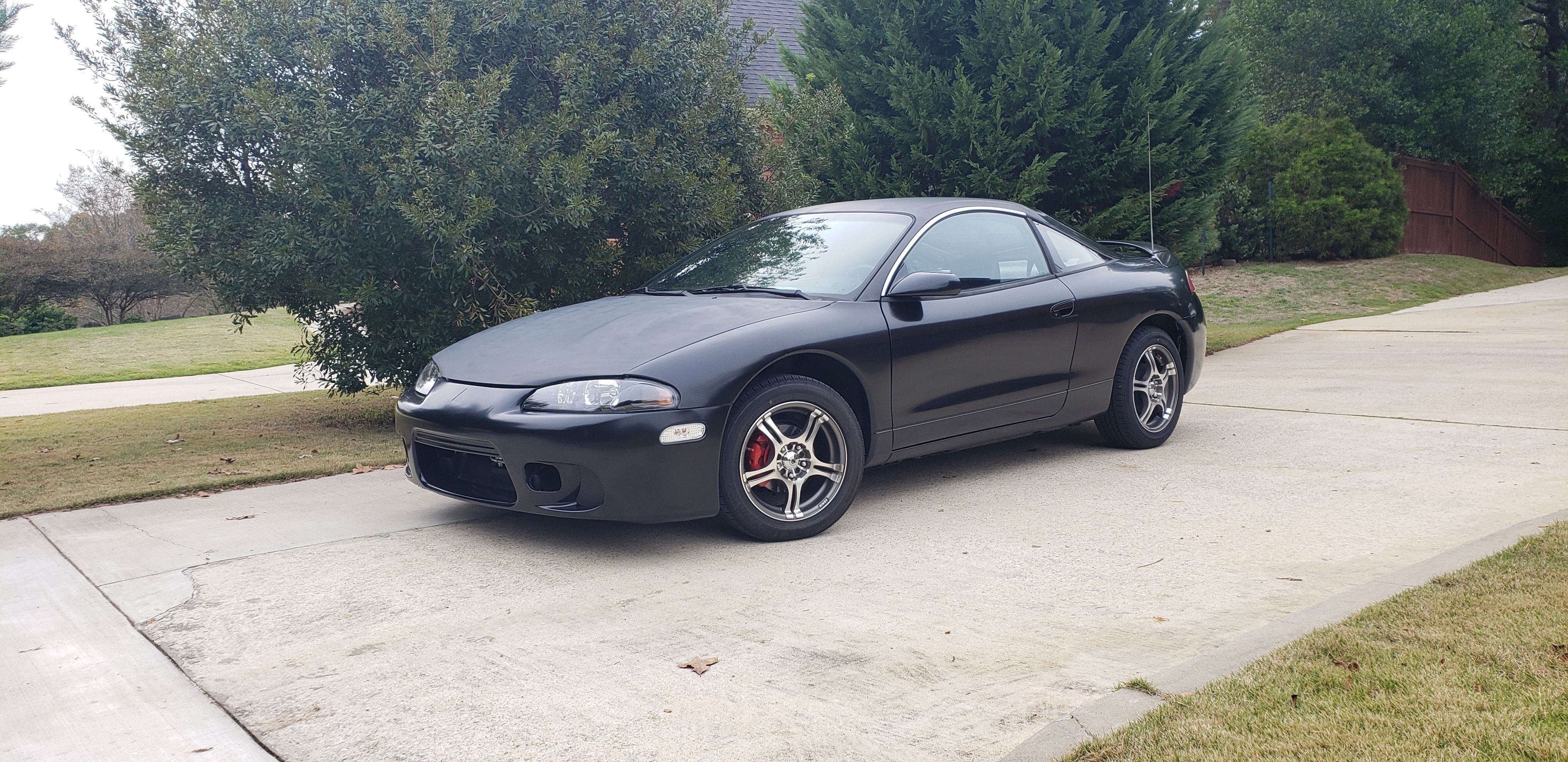

Exterior progress pictures. Still a few loose ends to tie up. Definitely time for cut & buff. You'll notice the exhaust tip is not stock. That ugly part was cut off and a stainless bit added. This, just until I buy an actual exhaust system.
