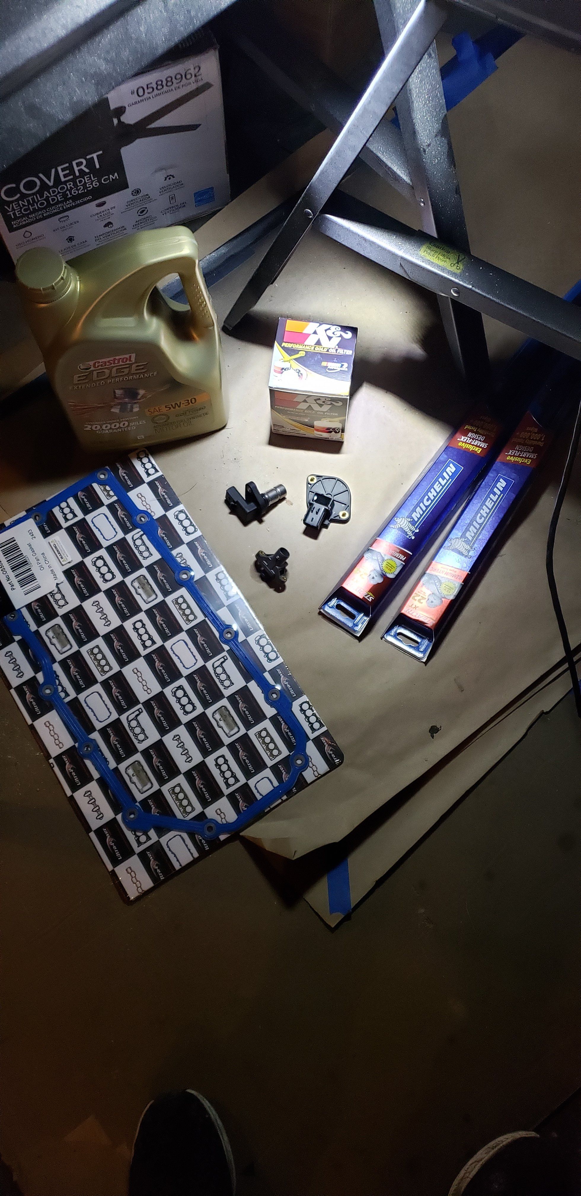

At this point I have a few parts and materials laying around waiting to be used. I might get some work done tonight and tomorrow night.
Parts include:
- camshaft position sensor
- crank angle sensor
- MAP sensor
- manifold air charge temperature sensor (IAT)
- Castrol Edge Gold engine oil
- K&N Gold oil filter
- fuel system treatment
- new cone air filter

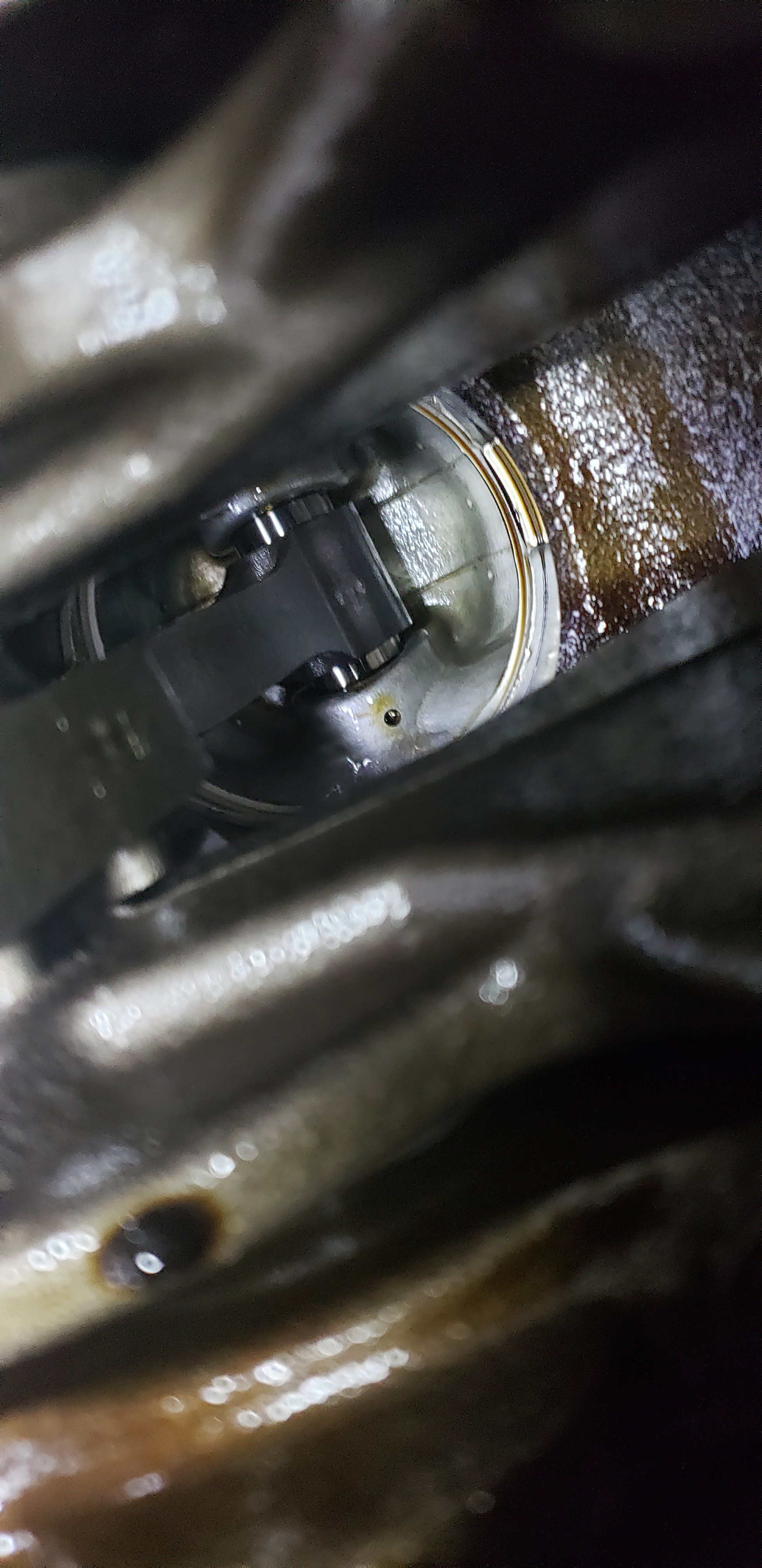

So tonight I replaced the oil pan gasket, MAP sensor, CAS, and camshaft position sensor. The oil pan leaked before, but now it is sealed properly. Some new oil and a new oil filter to top it off.
When I had the oil pan off I happily noticed that my pistons and rods are visually clean.

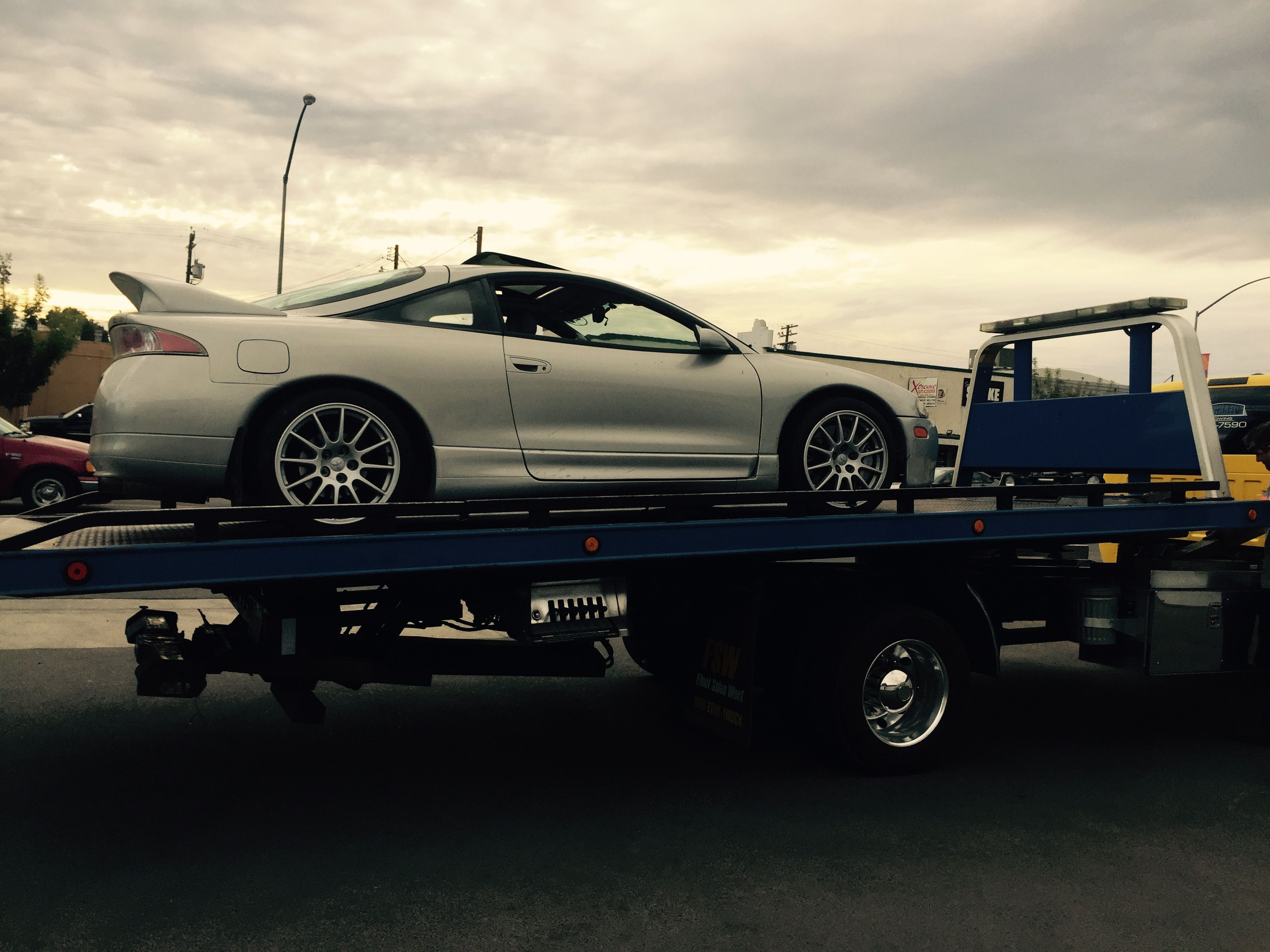

I do remember when I first got my DSM and spend a lot of money on EBAY PARTS ☹️, It broke so many times and I was always working on it (I enjoyed a lot), once I fix it I take it for a spin and come back on a tow truck.
This pic is one of the many times I came back home for the second time in the same day on a tow truck after fixing it.
I loved those moments.

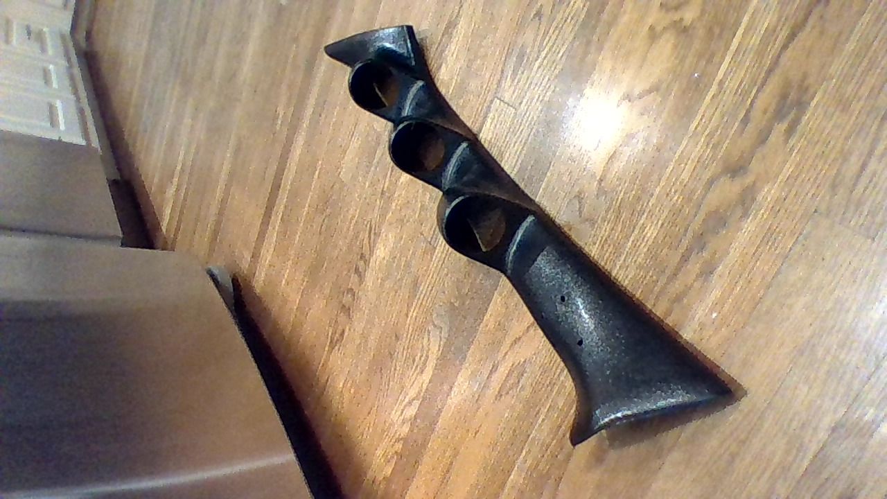

I'm still awaiting tracking info for the cluster, I have a feeling it will be at least a week before I have my hands on it... But that's ok, I can use this time to find some gauges.
I'm trying to decide whether or not to drop my trans yet. I think I'll wait until it's a necessity, like when it breaks as I'm driving LOL. As much as I'd like to spend a bunch of money and put many hours of work into it, I think it's best to wait. When I do it though I want to go with a stage 1 or 2 clutch kit so it can handle the slight amount of power I'll be adding. While I'm at it I'll go with all new synchronizers as well.
The 3 gauge cluster should be here tomorrow. Bosch has some 52mm gauges on sale so I think I'm going with those.
