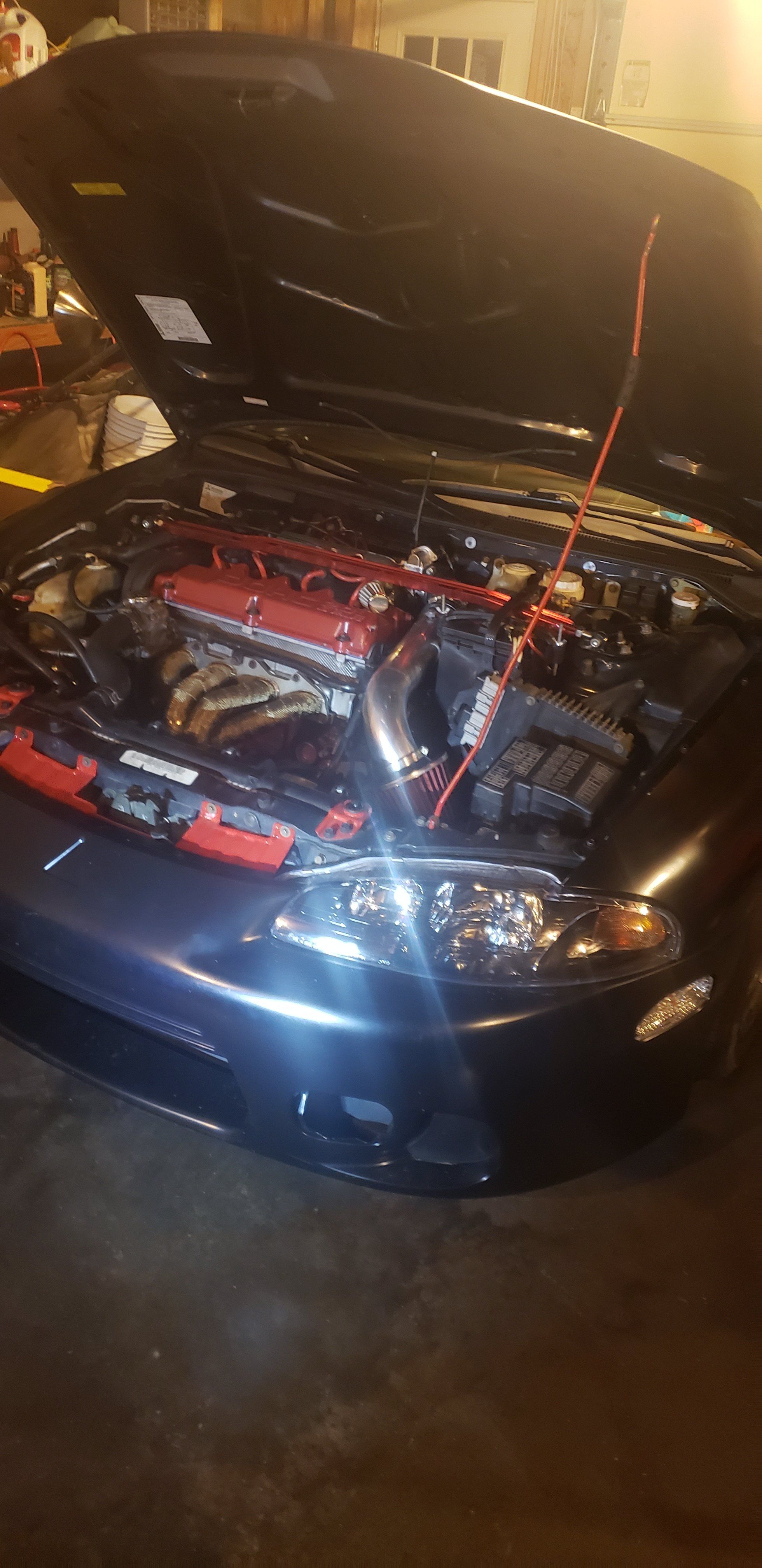

What brand is it? Or at least where did you get it from?
Came with the car. The filter is AEM, 2.5inch inner diameter cone shape filter. No clue what the tube is, has no markings

The reason I ask is because I bought one of the cheap ones from Ebay and the filter didn't fit on the pipe too well. And also the system was angled so that it rubbed on the hood everytime I drove it, which eventually scraped some paint off of my hood. I now have a little bare metal spot. I tried to adjust it to angle more downward, but the pcv system hose wouldn't stretch any more.
I ended up cutting the stock piping up and building my own custom CAI.

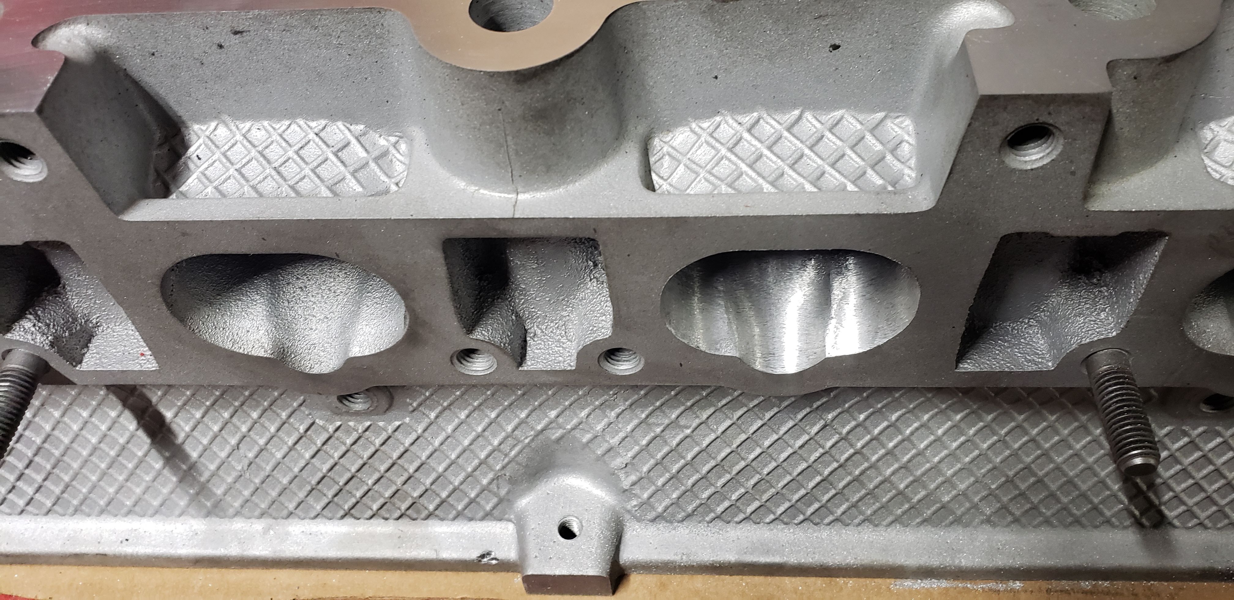

Very first thing I did is sprayed the inside of the manifold with brake cleaner, that shit was nasty. Then I took my Dremel and ported out the intake runners a little bit, removing extra grit, and opening the ports all the way up to a gasket match, hoping for some better airflow. Then I sanded the outside of it to make it completely smooth and laid that beautiful metallic paint on it. I proceeded to do the same thing with the lower manifold near flange, Dremel porting/polishing. No paint for this pasrt because I ran out of time, but it almost cannot be seen from the bay anyway. I'm sure I'll have it removed at a later time for the spray.
