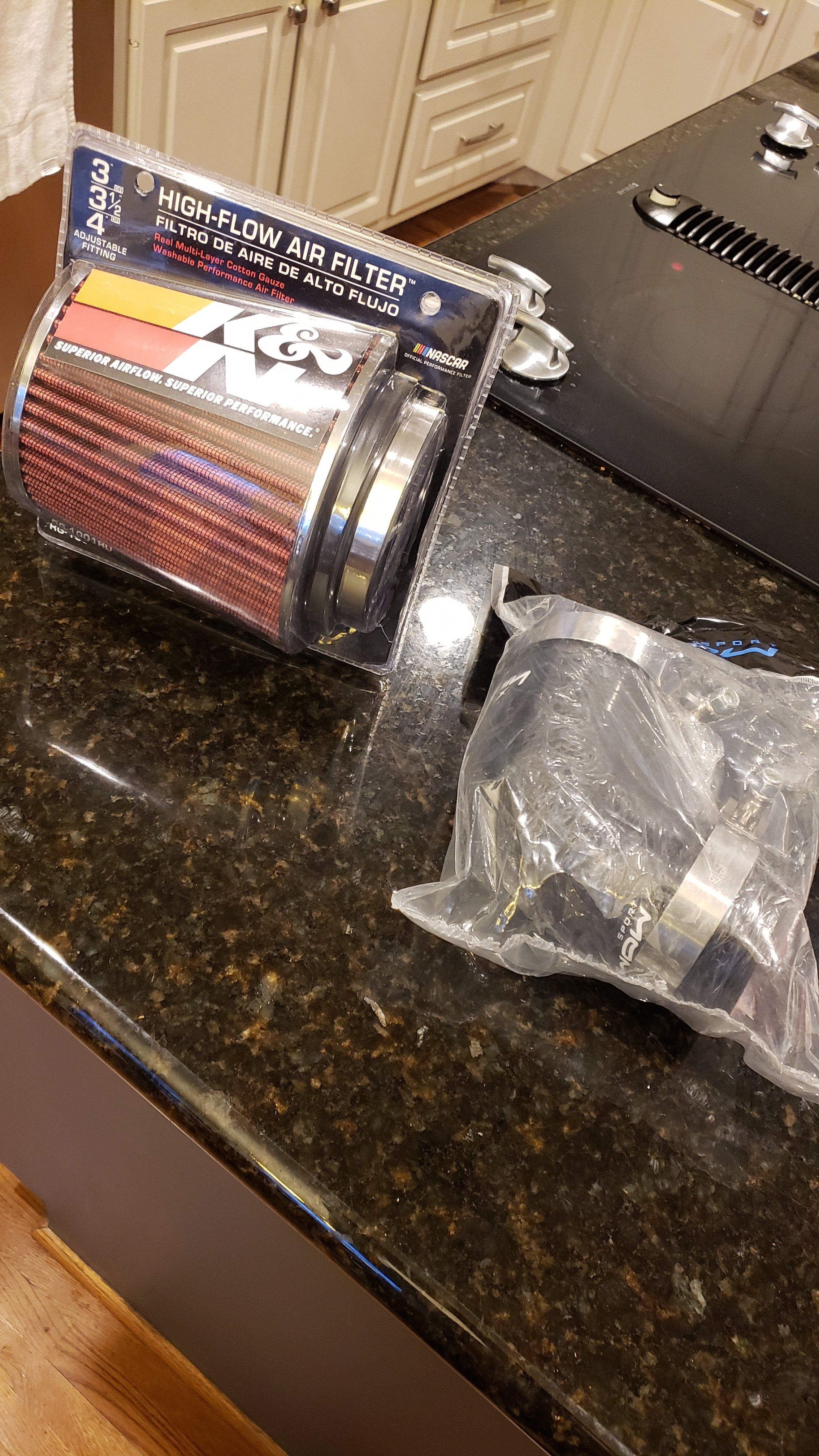

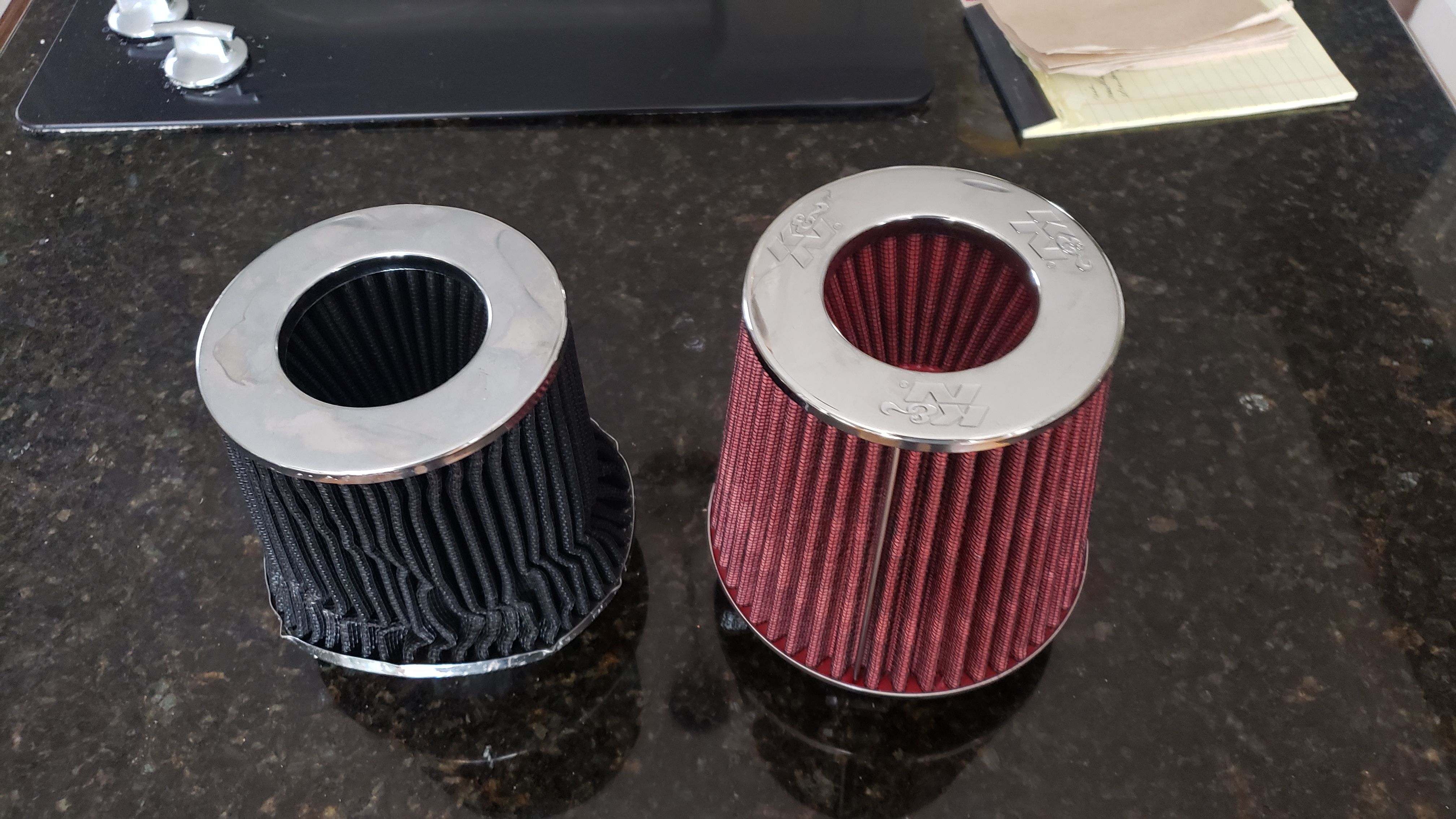

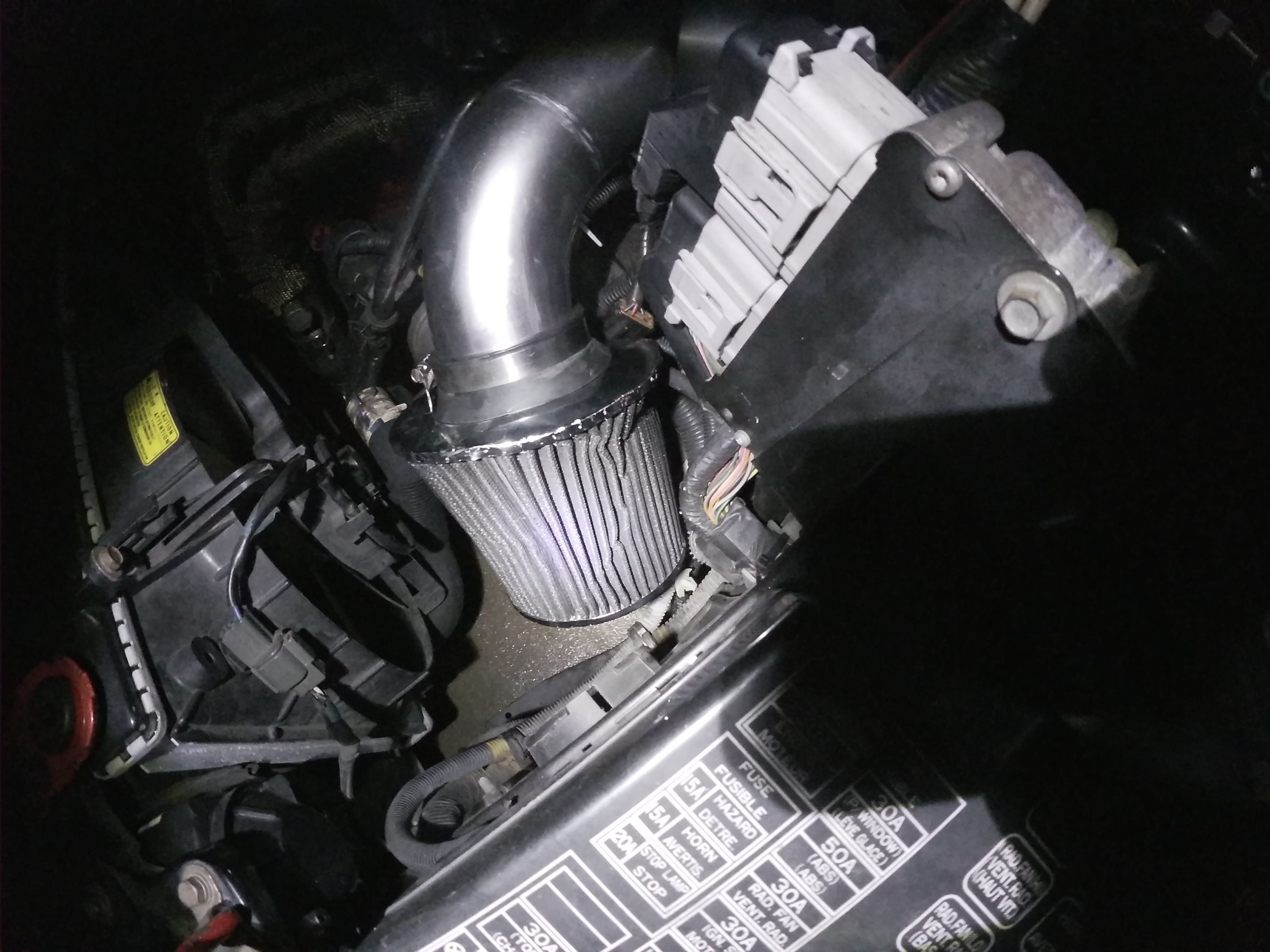

Something happened with the air filter, maybe I didn't tighten it up enough, or maybe it just vibrated loose. It fell off and I ran it over. Luckily it happened in the parking lot, so I was going like 5 mph when I ran over it. I picked it up, and it looked pitiful. But I knew I had to have an air filter. So I bent it back to shape the best I could, cutting my finger in the process. I was able to at least get it back to shape enough to slide it back on the piping. Then I clamped it on really tight. Hopefully it lasts until I can pick up another one. I'm glad I chose the one with metal reinforcement, otherwise I would've been without a filter. That thing really is tough. I ran over it twice, once going forward, and once backing up to see what I hit.
I had the same thing happen to one of my air filters shortly after I got my car. Mine however was not repairable. I think it got ran over by multiple cars.

- The air filter should be here tomorrow. It was supposed to be here yesterday, but they lost my shipment :ohdamn:

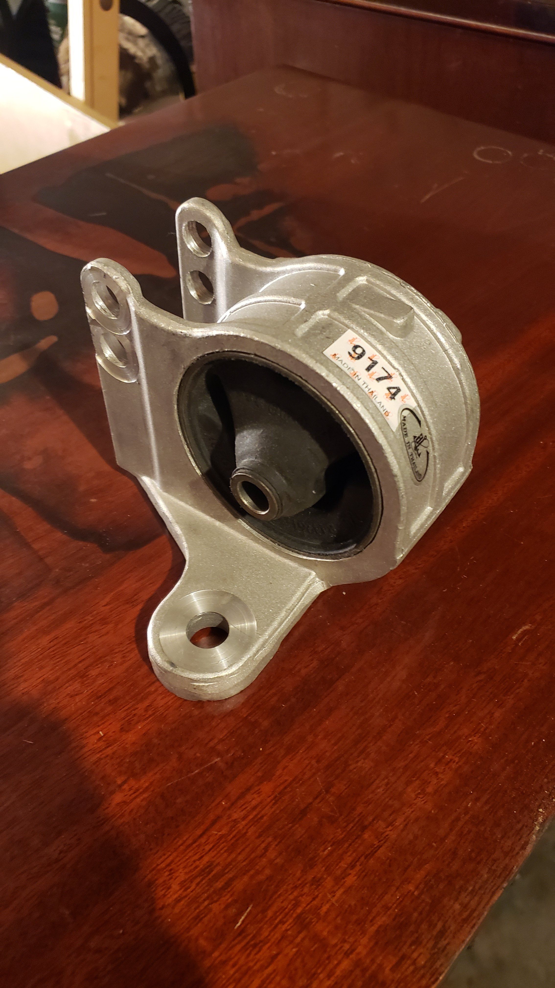

- I was able to source a transmission mount on Marketplace for only $25, and I'm supposed to pick it up tomorrow.

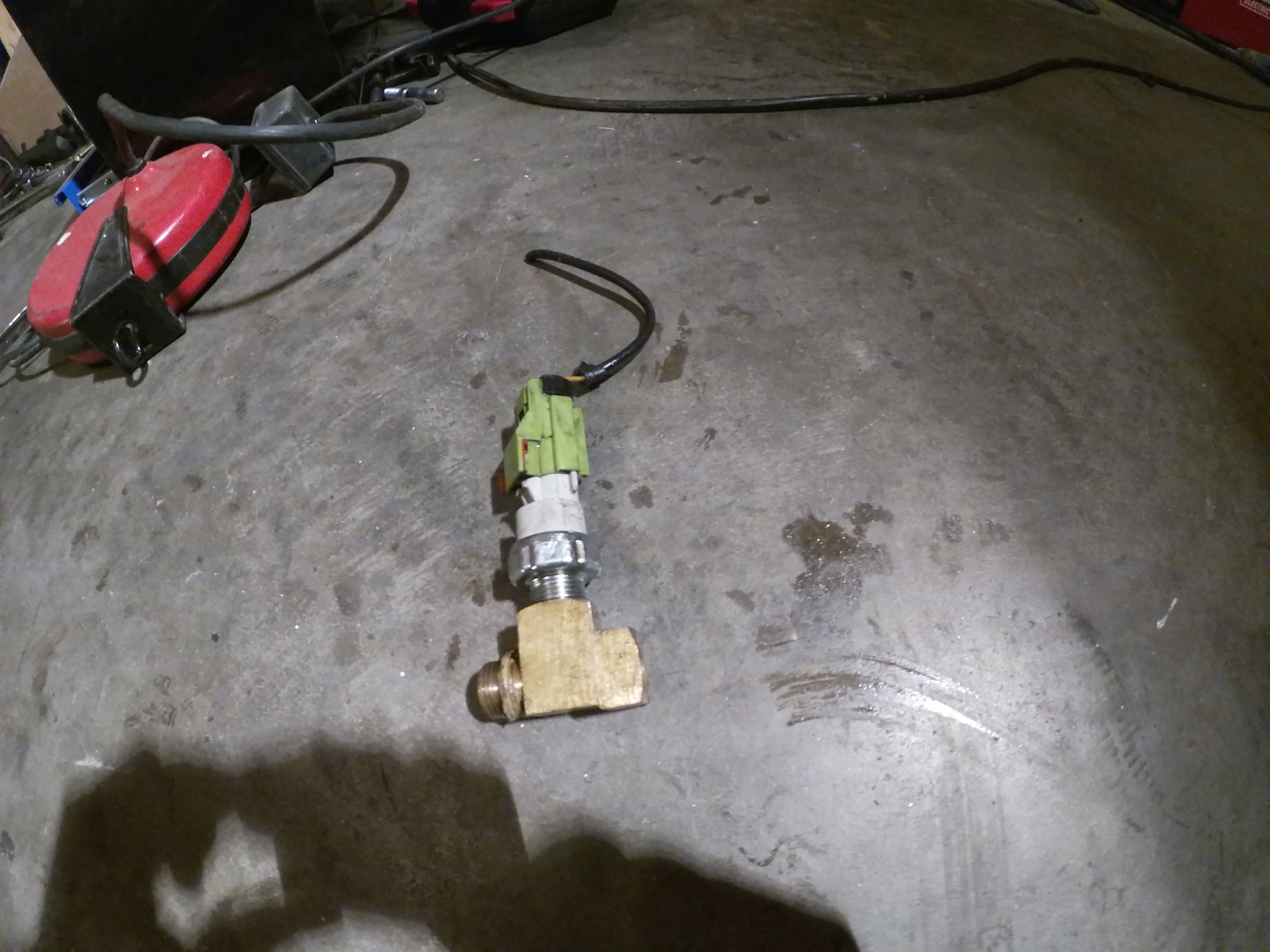

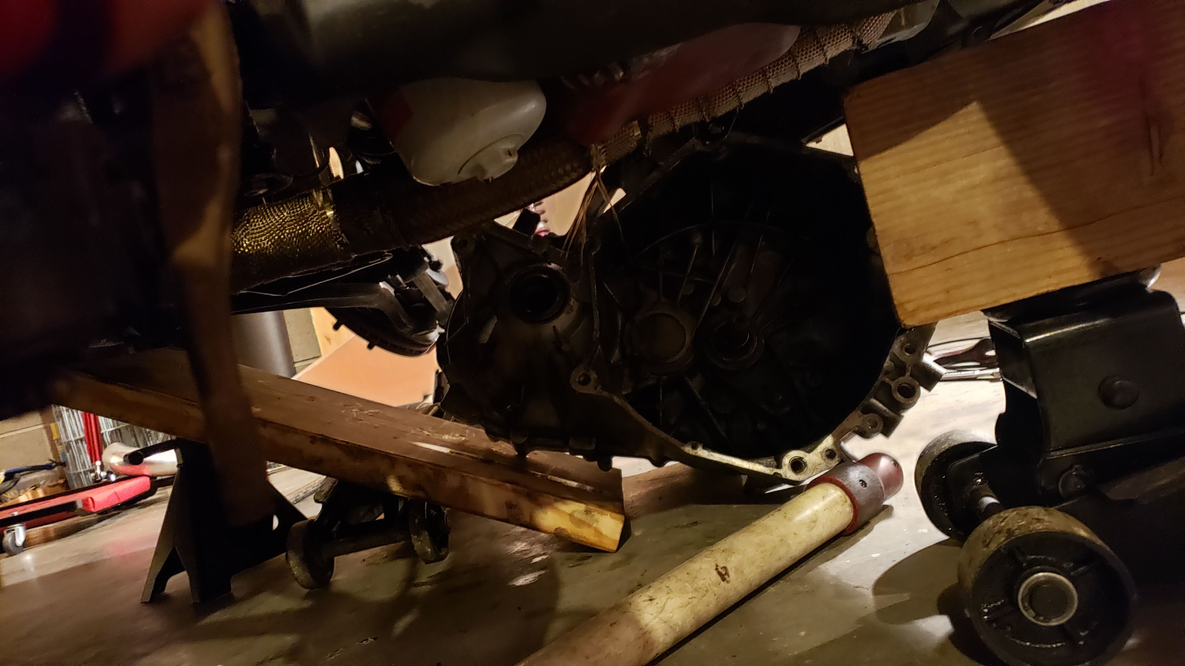

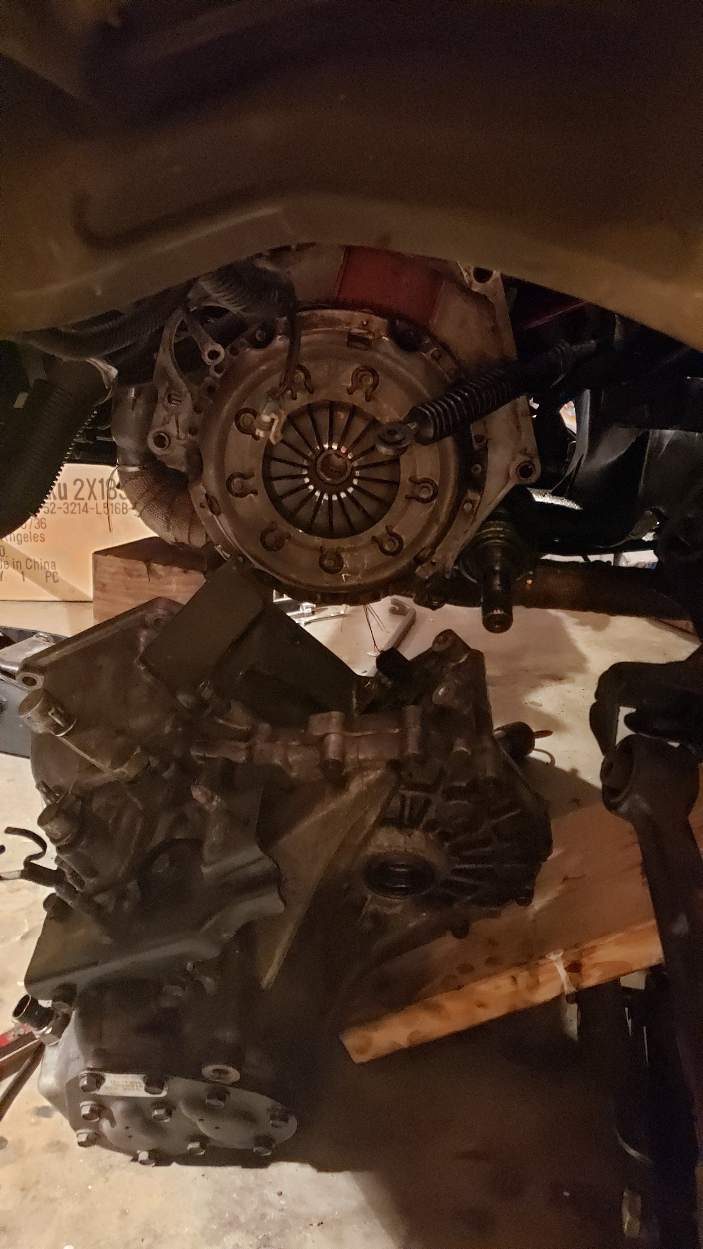

- As soon as I make room in the garage, the DSM teardown begins... Obviously the clutch, TOB, fluid and mount will be changed. But I've also got a large vacuum leak and a minor oil leak that needs digging into. I think the OPSU is leaking, so I'm going to delete that stupid t-fitting I put on there and just run the straight gauge. And the vacuum leak will require some diagnosis. I'm tired of those.

Today I bought the trans mount from the guy on Marketplace. Also my intake stuff came in. In other news my neighbor threw away his toolbox, and I claimed it.

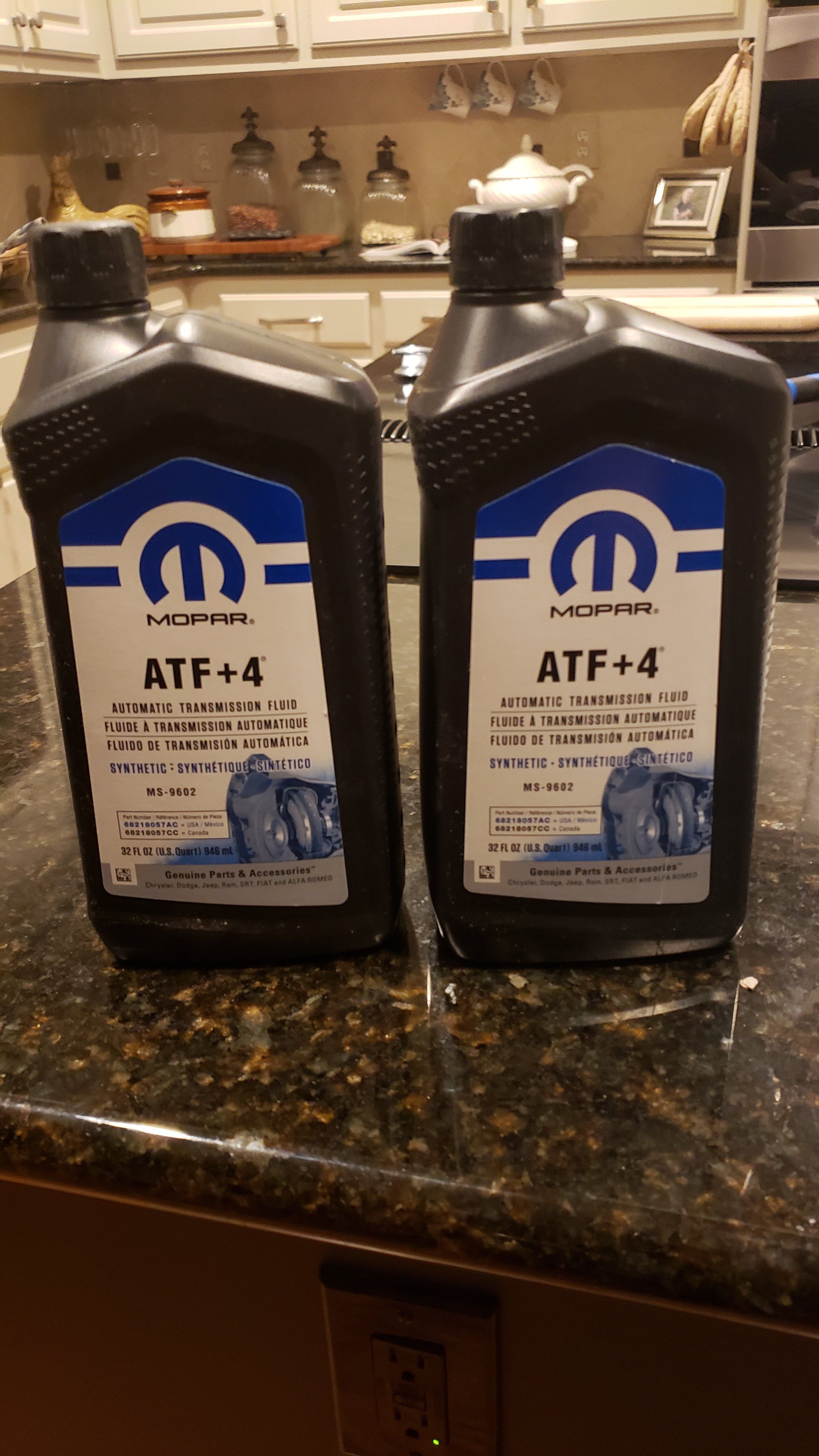

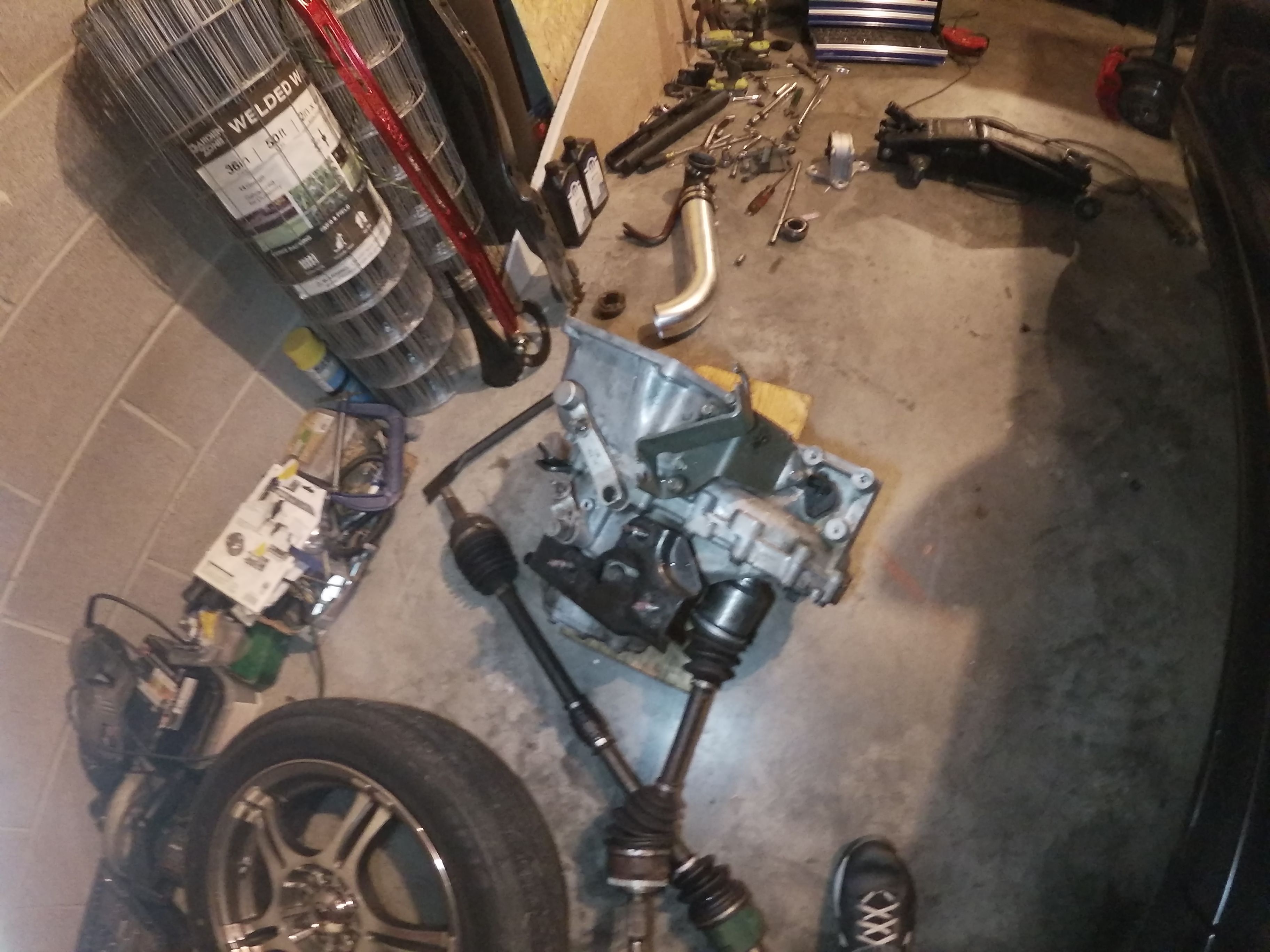

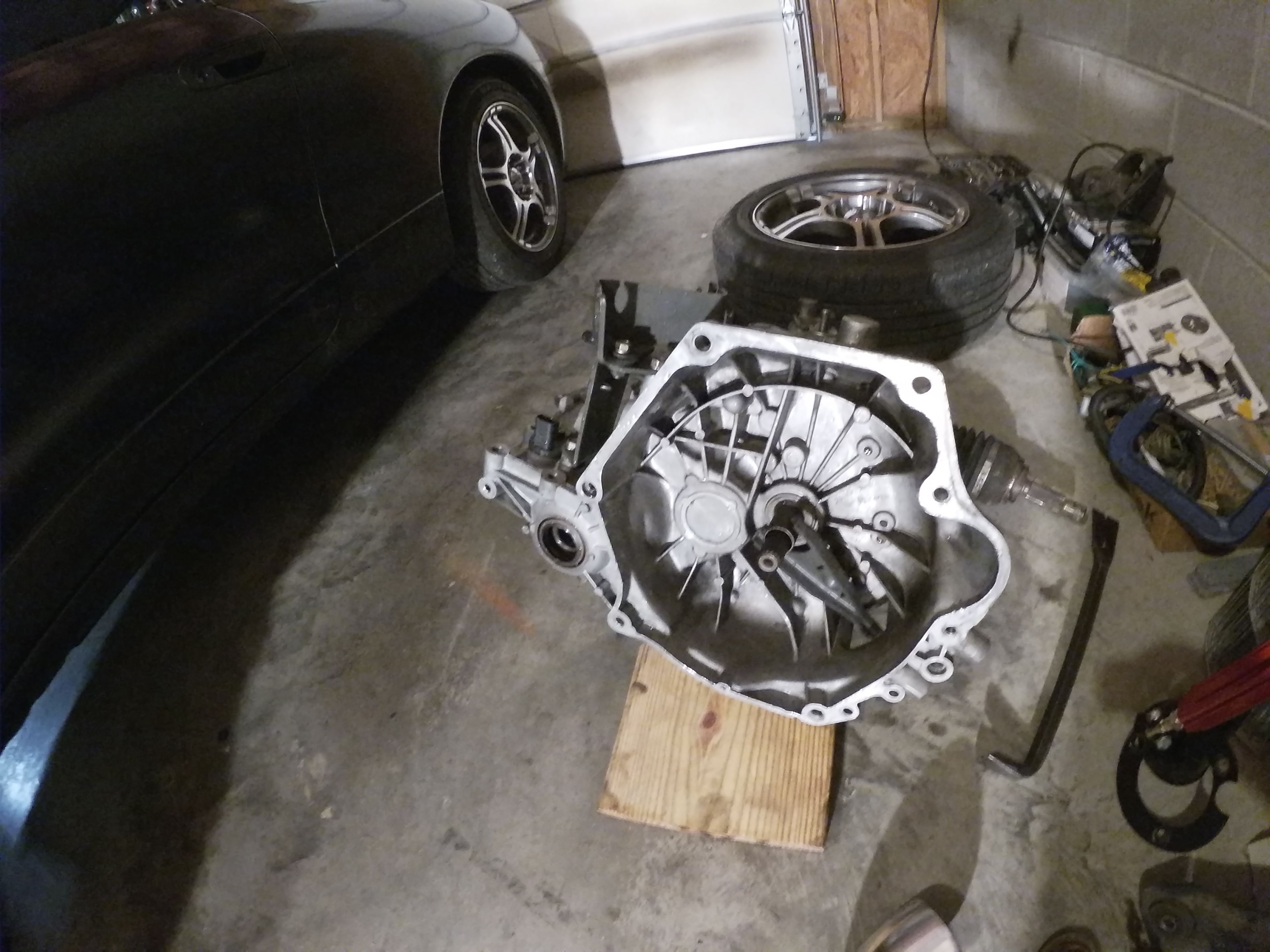

Some incompetent bastard filled the tranny with gear oil :ohdamn:. This would explain the slow depletion of the 1/2 synchro.
The dealer recommends that you use their NV-T350 specific fluid or some Amsoil Synchromesh, both of which are pretty pricey. I did a bit of research and found that Mopar ATF+4 works really well, so that's what I bought. It was $25 instead of the premium for others.
You're not supposed to run gear oil in the NV-T350 because the stock synchros are made of a compressed fiber material, and if your trans has been rebuilt they are made of a brass material. And the gear oil could cause damage to both ot those types of synchros.
There's no telling how long that damn gear oil has been in there. 2 and a half years at a minimum though. I'm trying to decide if I should go ahead and press it apart for a rebuild, or if I should see if the new clutch and fluid will help it any. But it's a pain in the ass to drop this trans so I think I'll go ahead and get it rebuilt.

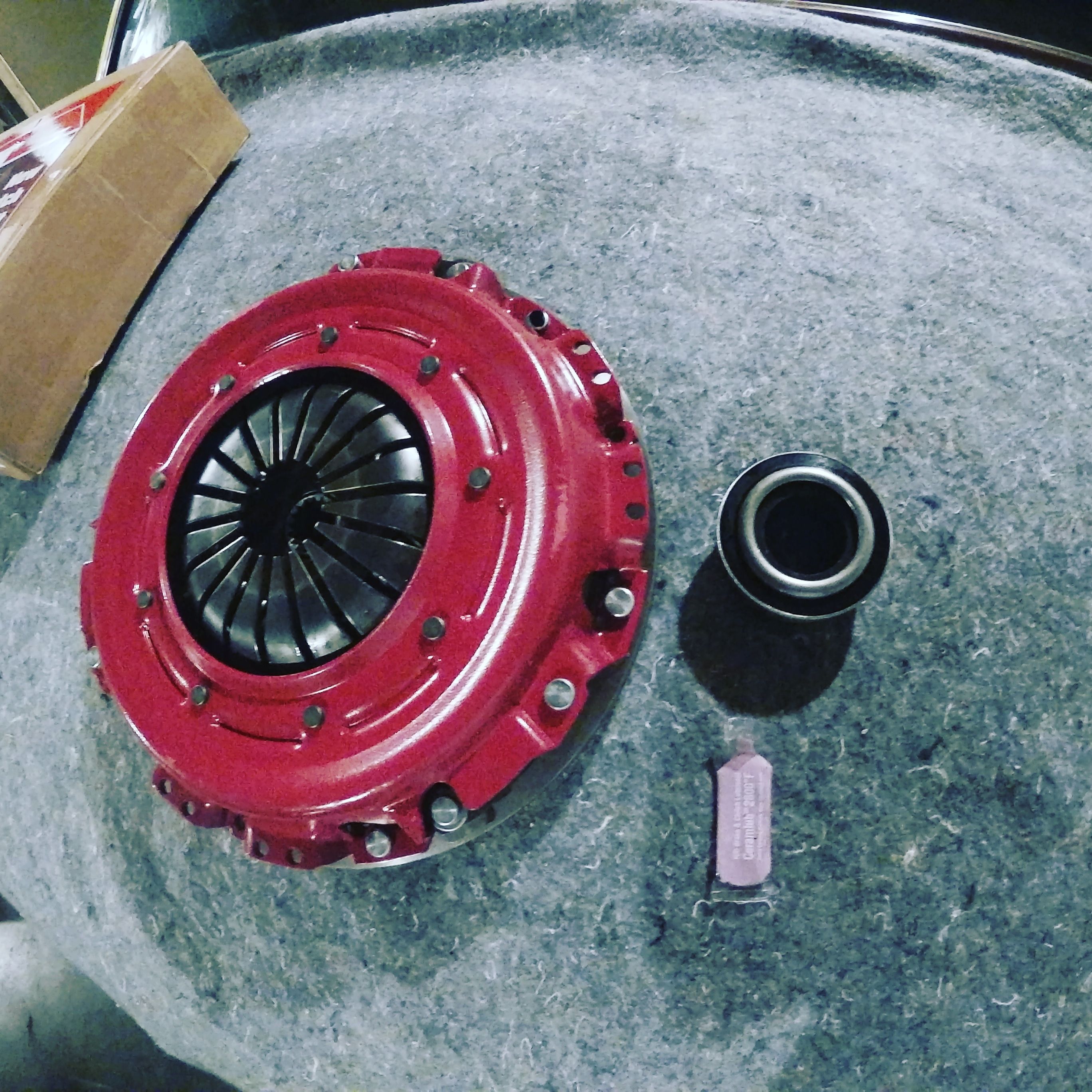

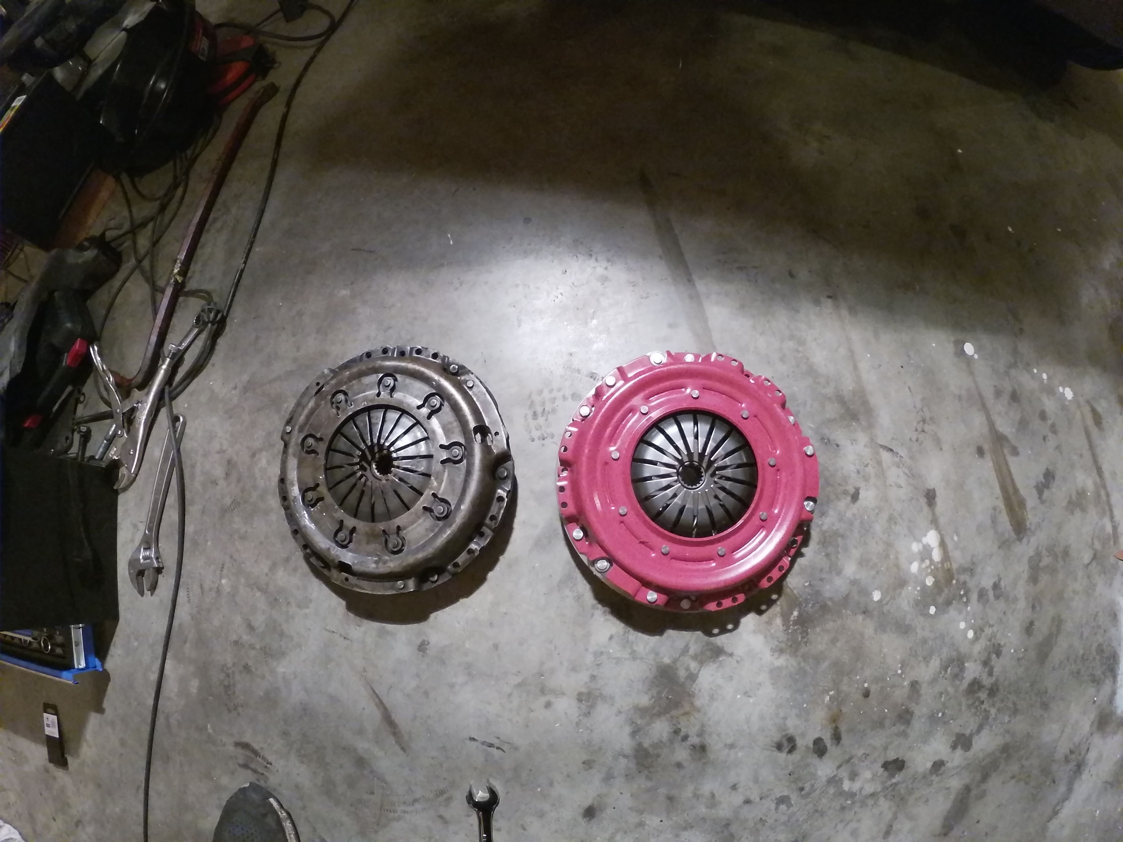

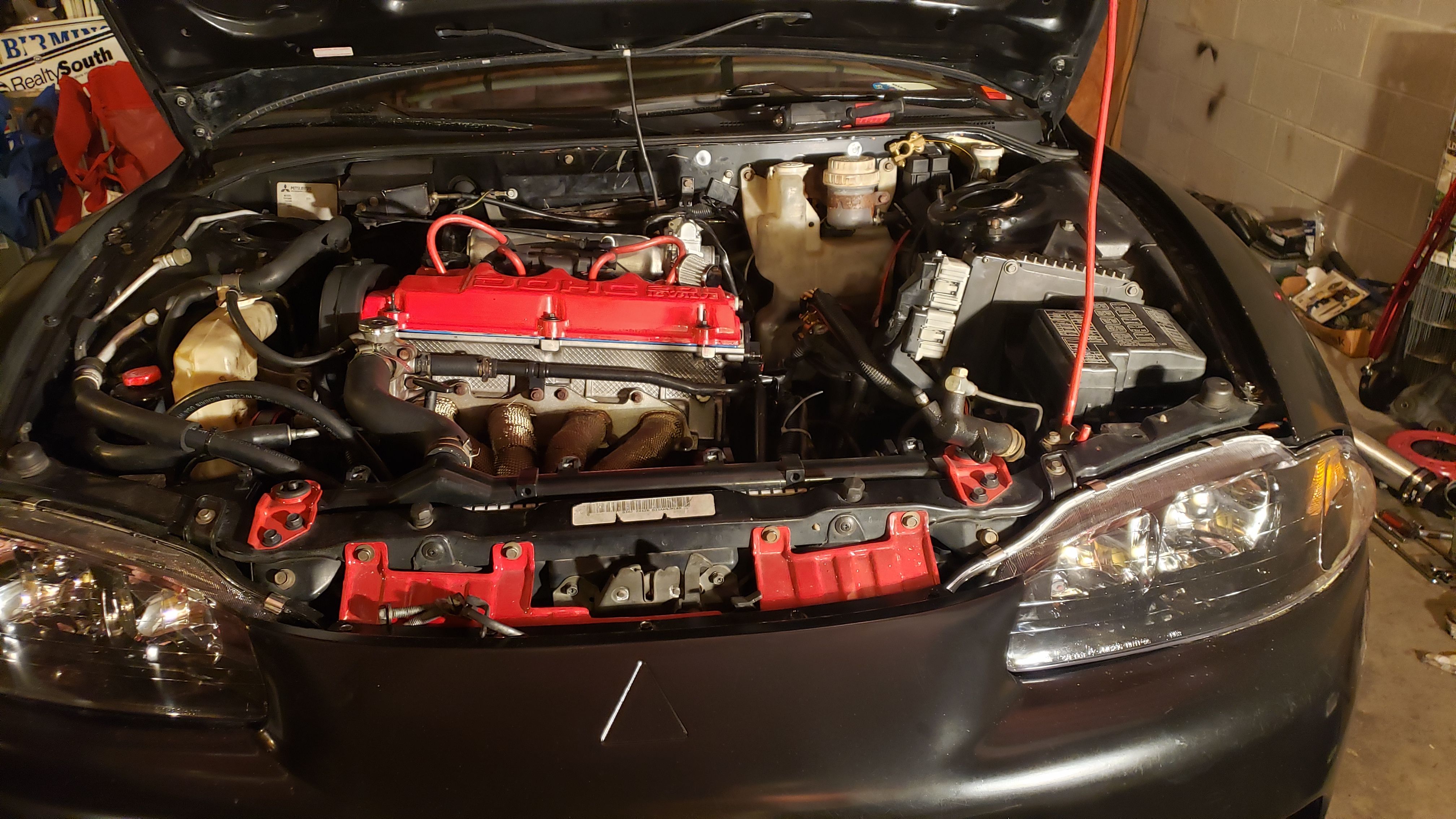

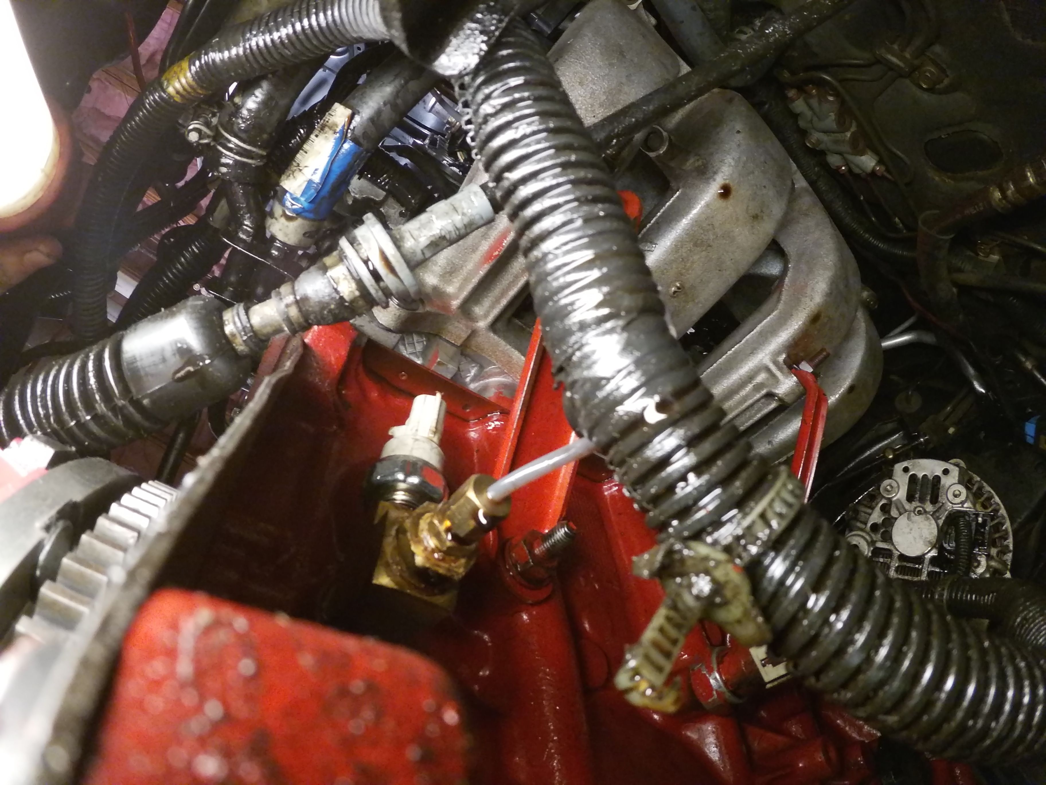

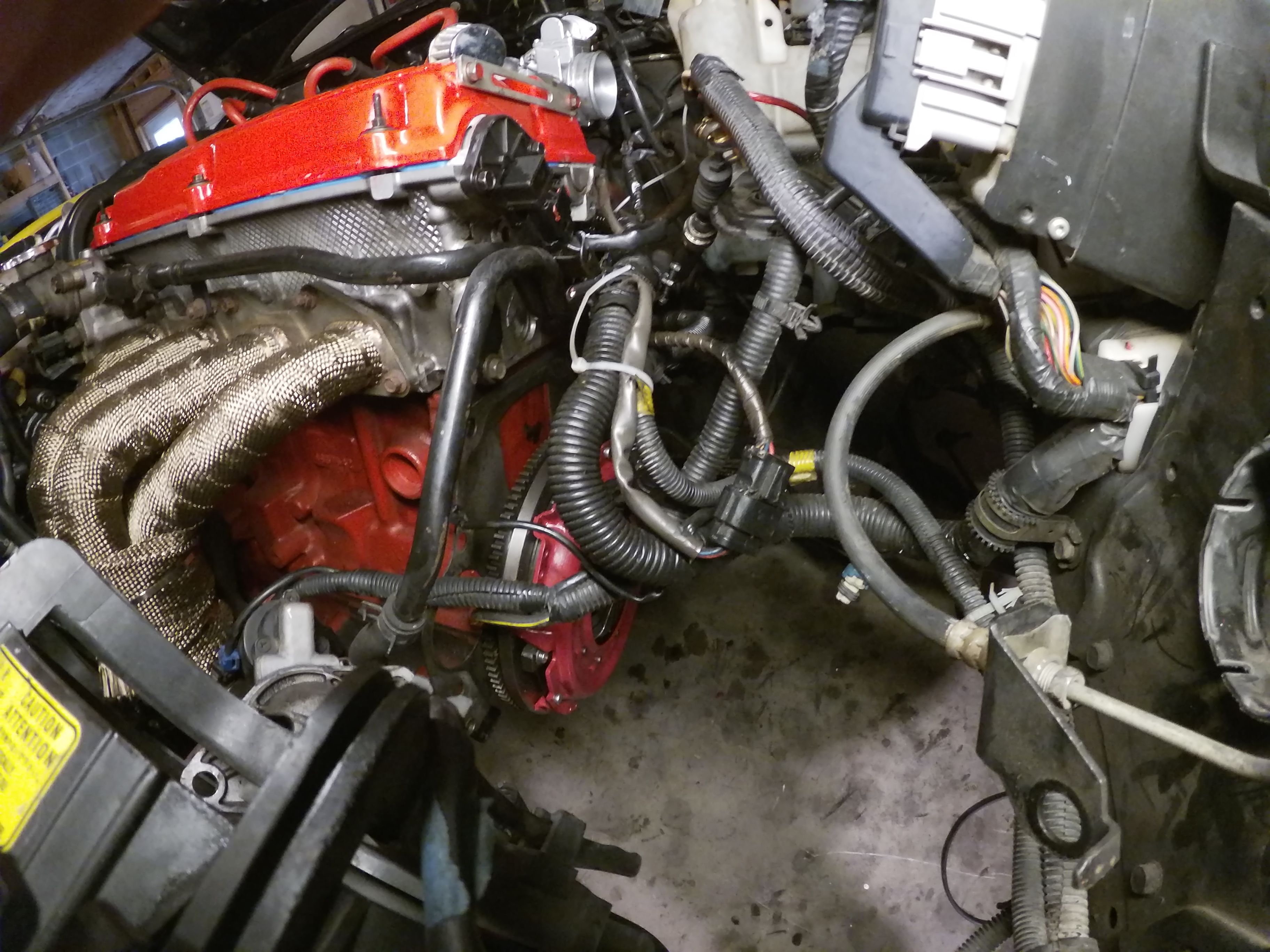

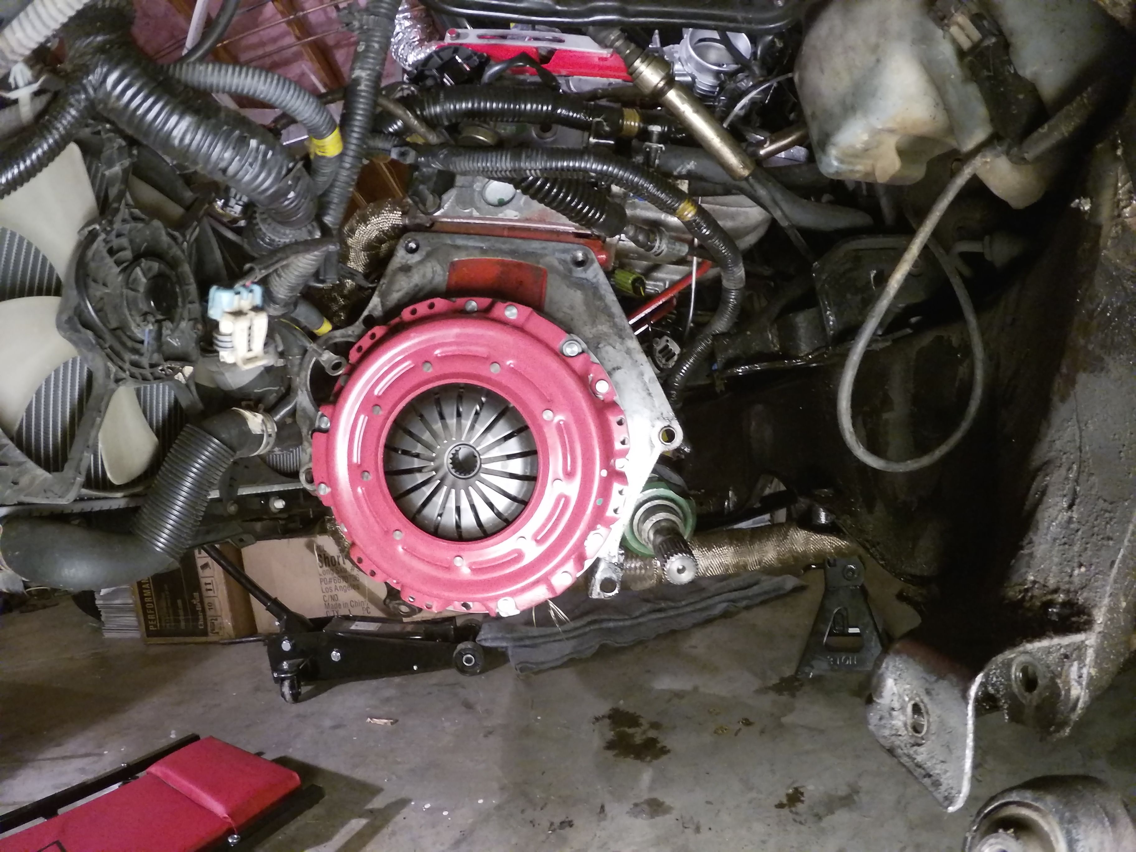

I got the new clutch installed. I also fixed my little oil dripping issues. I deleted the OPSU and the T-fitting I put in. Now I'm just running the oil pressure gauge straight out of the block.
I know I know, I really need to wire tuck and A/C delete... that's coming at some point in the future...
Yep the atf is sometimes the fluid meant for SOME manual transmissions. My IROC 5 Speed T5 takes very special fluid from GM and it takes more than 2 but less than 3 or something like that at $15 a qt. Dam.

Pretty Pressure Plate! :thumb:

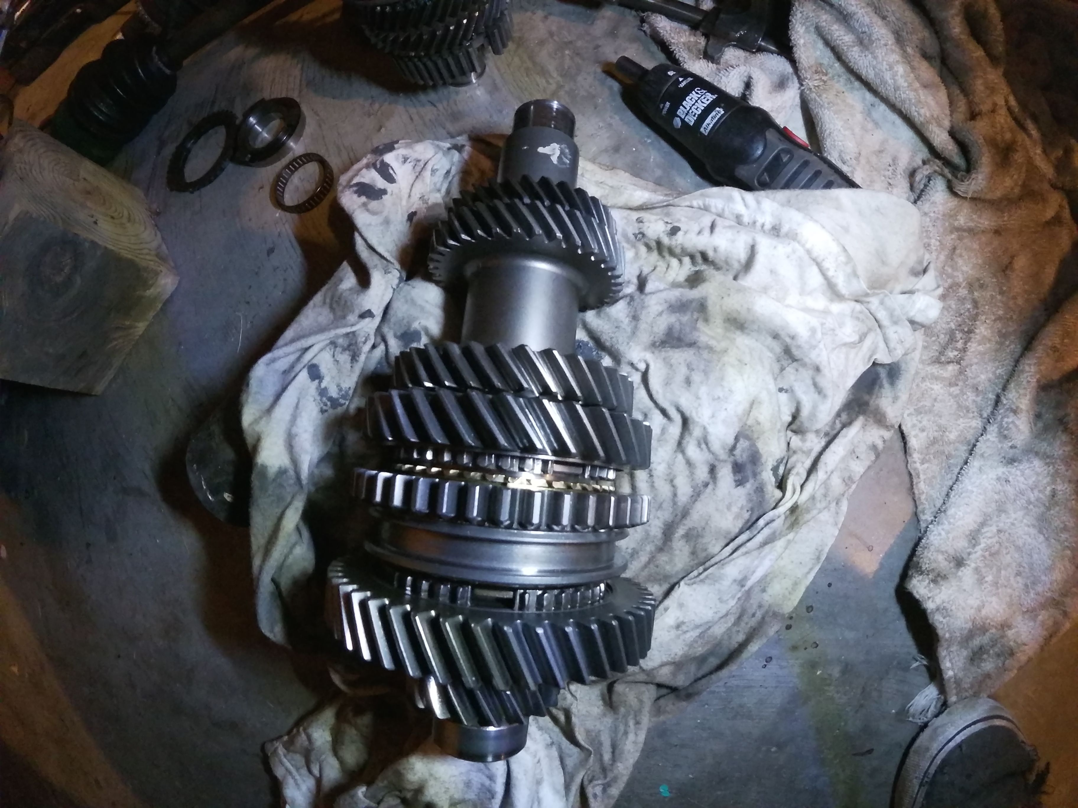

I'm rebuilding the trans... I'd hate to spend a few hours putting it all back together just to have some grinding gears. I'm hoping to only have to replace the 1/2 synchro. It's only $40.
And then, once everything is broken in, she should drive like a dream. :)
I just ordered a trans rebuild kit. Not the whole kit together, just a few separate parts. Like all the seals, bearings, and the 1/2 synchro. All the other gears didn't seem to grind so hopefully I can get away with only replacing one of the synchros. And maybe the new seals and bearing will stop the growling noise I've been hearing and stop the little dripping here and there.

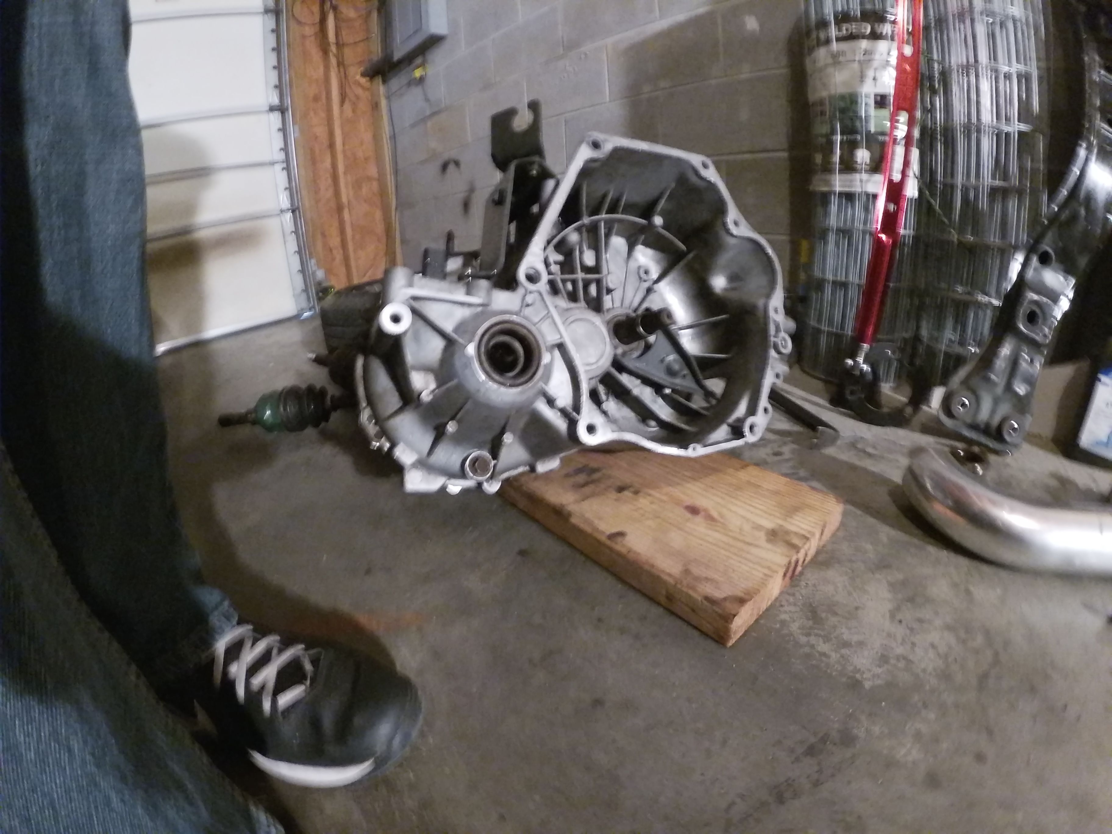

Also, this morning I put the pressure washer to use and got the tranny looking clean and shiny. I probably removed 10 pound of oil and grease from it.

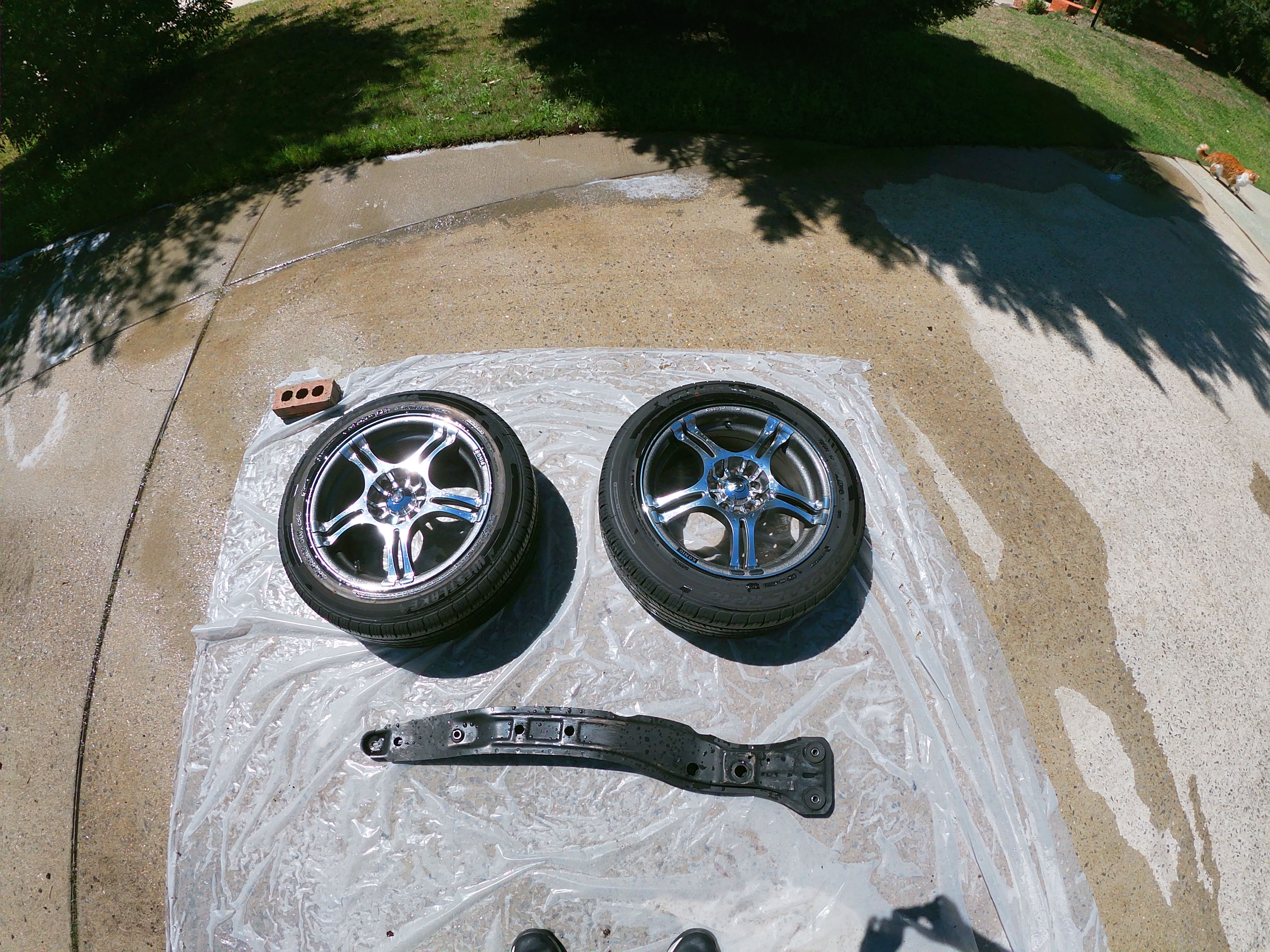

Some say idle hands are the devil's workshop, but my idle hands become my workshop. When I get bored I find every last little detail to do. So today I got the pressure washer back out and the scrub brush and went to town with my wheels and the cross-member. They cleaned up very nicely.

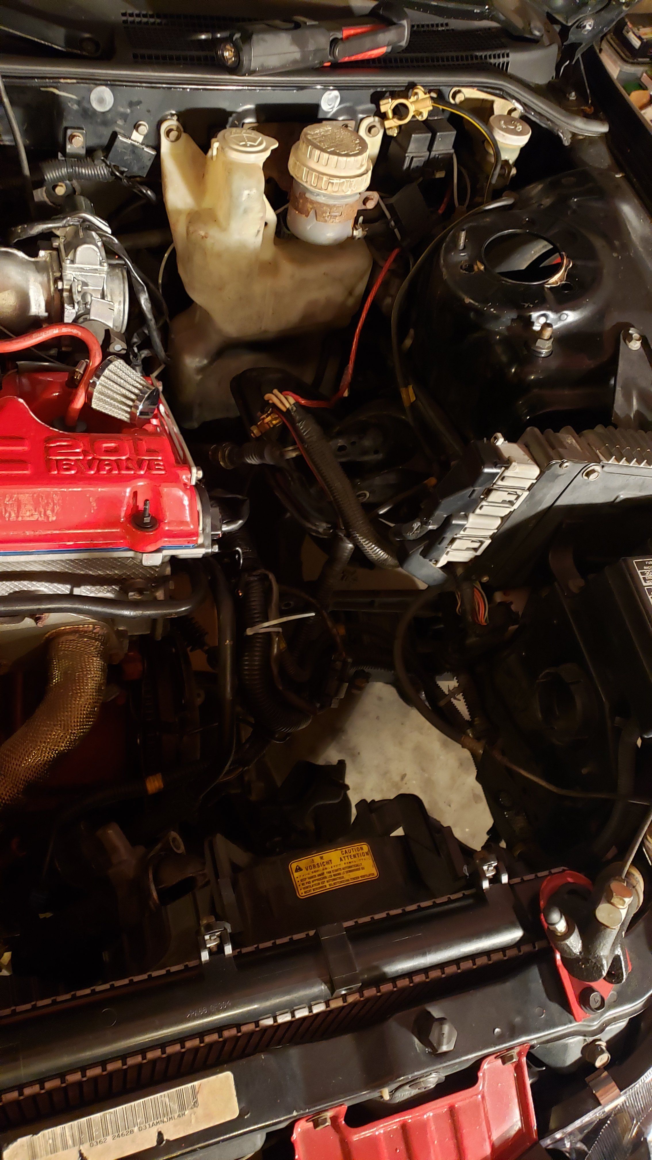

Will be doing something maybe slightly outrageous with my wheels as soon as I’m done with the current mess in the engine bay. Thinking of a wire tuck, and maybe eliminating a lot of the vacuum systems that are possibly unnecessary and cluttering the bay
