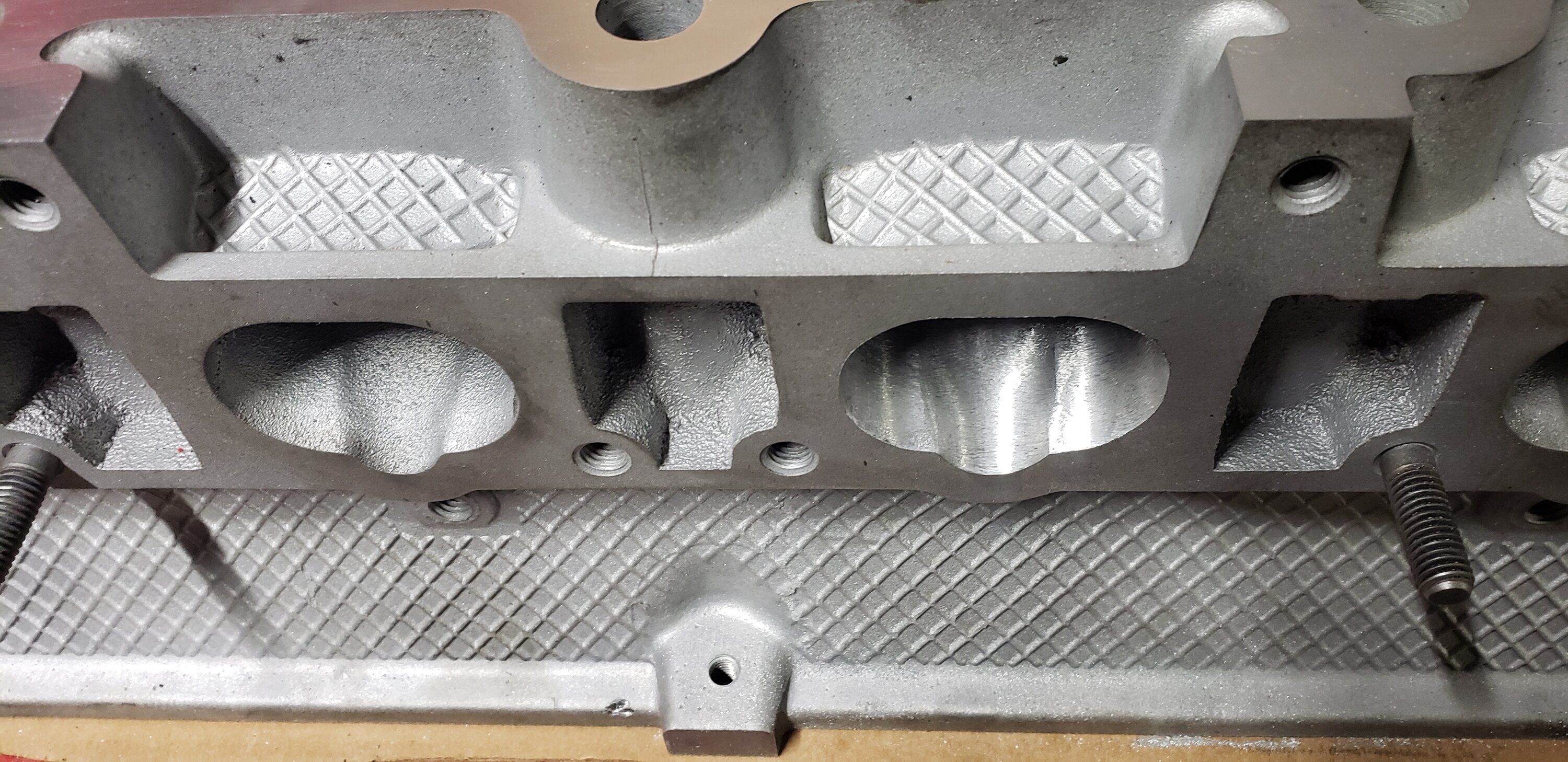

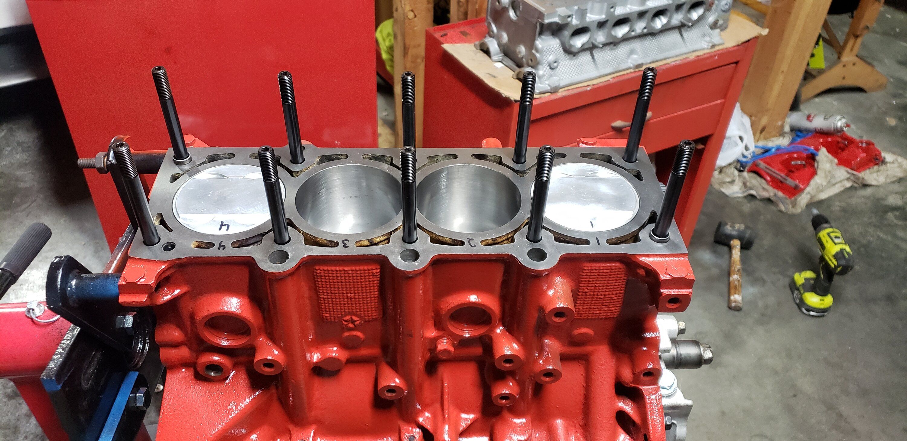

I decided to do some port work on the cylinder head. Trying to squeeze every last horsepower out of this engine. Also I made some progress on the engine. New water and oil pump is installed. Also got the piston rings properly gapped and the pistons dropped in. Oil pan and head should go on tomorrow.

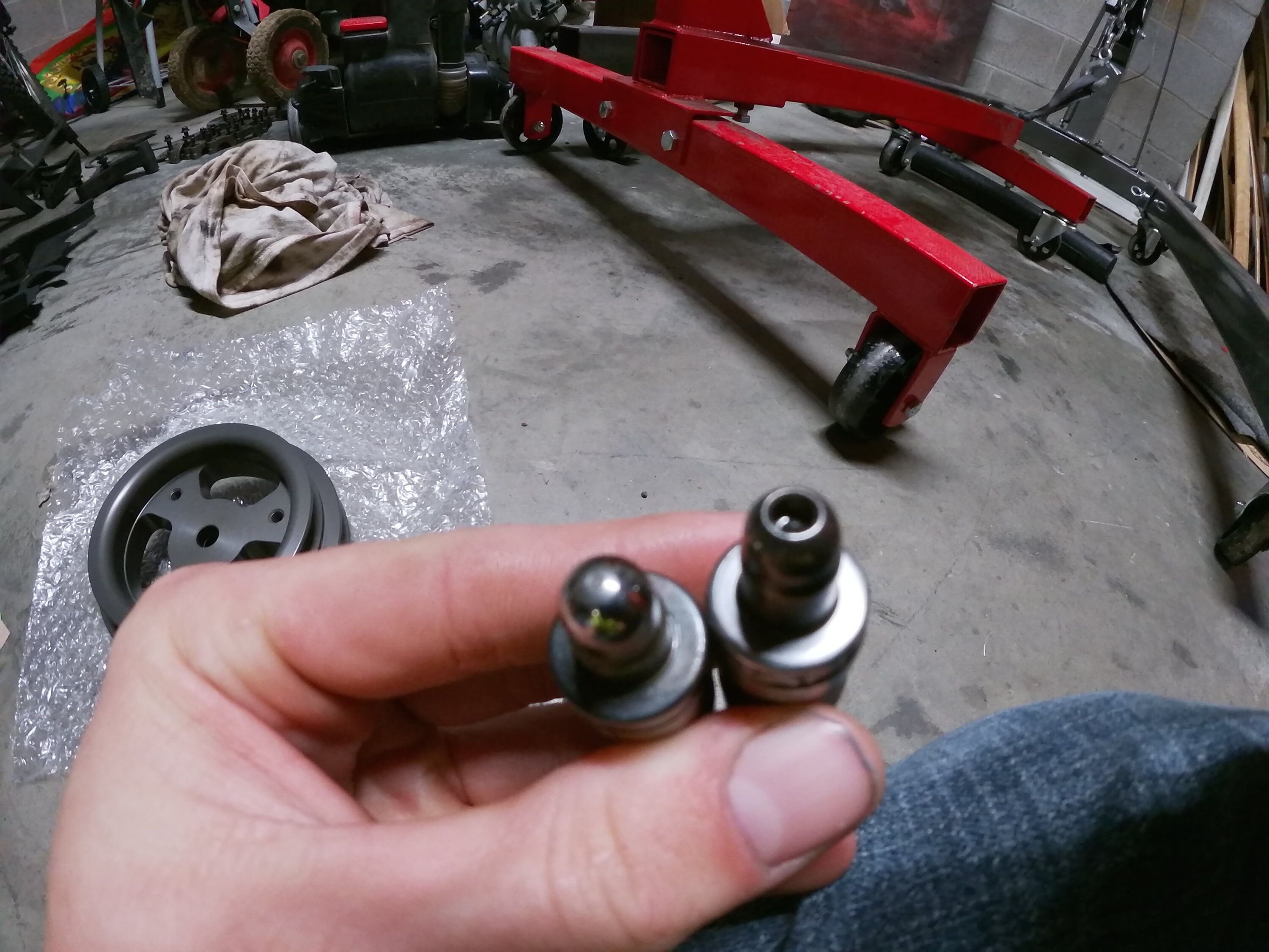

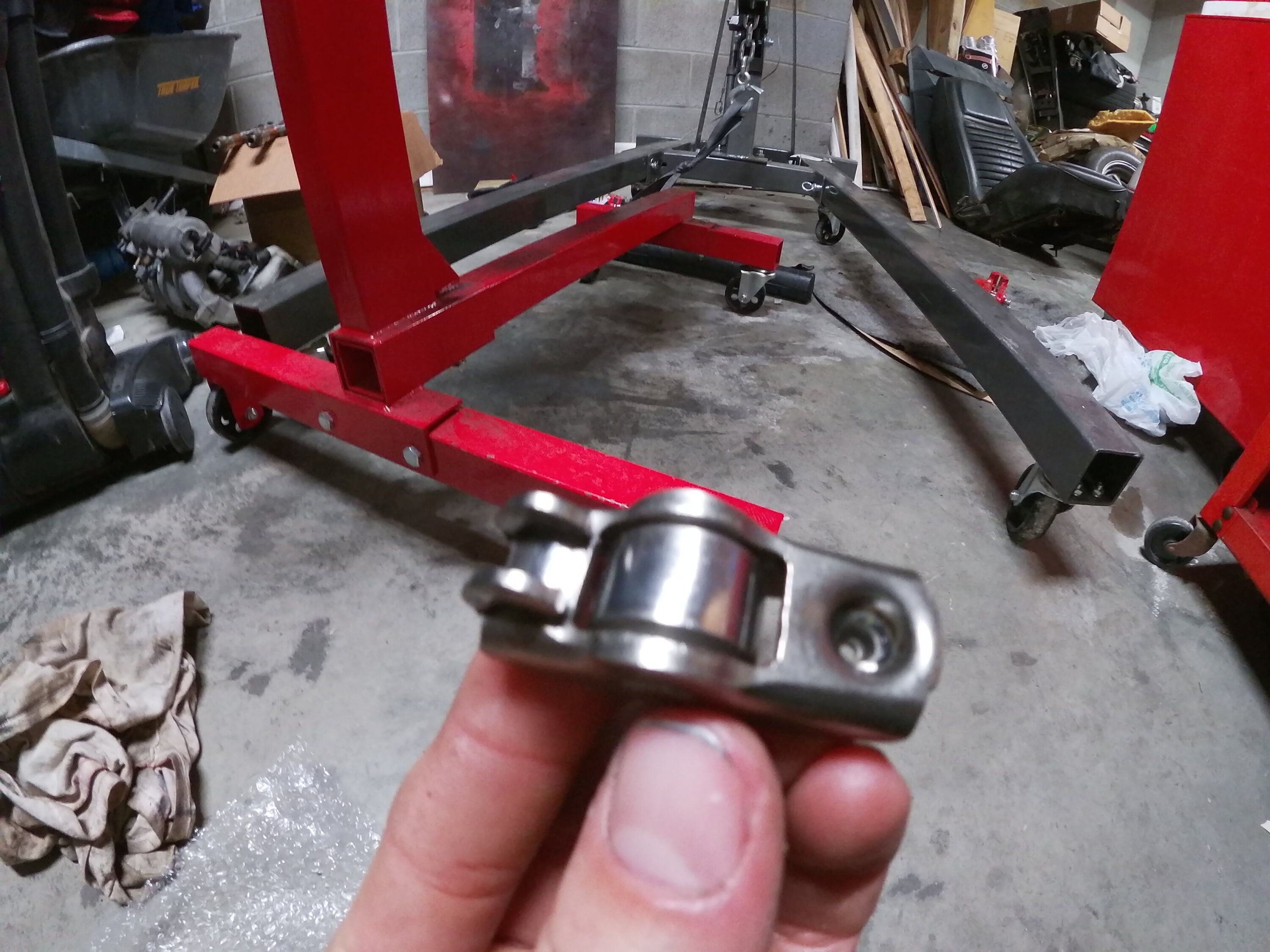

I'm ordering a set of PT Cruiser lifters. They have a much larger hole, so the top end will be lubricated much better. Just a matter of time before I rip the old engine out.

Make sure to "dress" the return oil holes in your block for optimum return of the oil in the top end. I don't know if you have thought of it, but on my Small Block Chevy motors, I try to smooth the casting area for good oil return and I also paint the lifter galley (it is slanted on a SBC) so the oil rolls right back into the pan as soon as possible. I have never had any paint flake or any issues internally as long as it is prepped just like a good paint job and using engine enamel. On the 420 I don't know if paint internally is needed but it is some of the stuff I do to other engines.

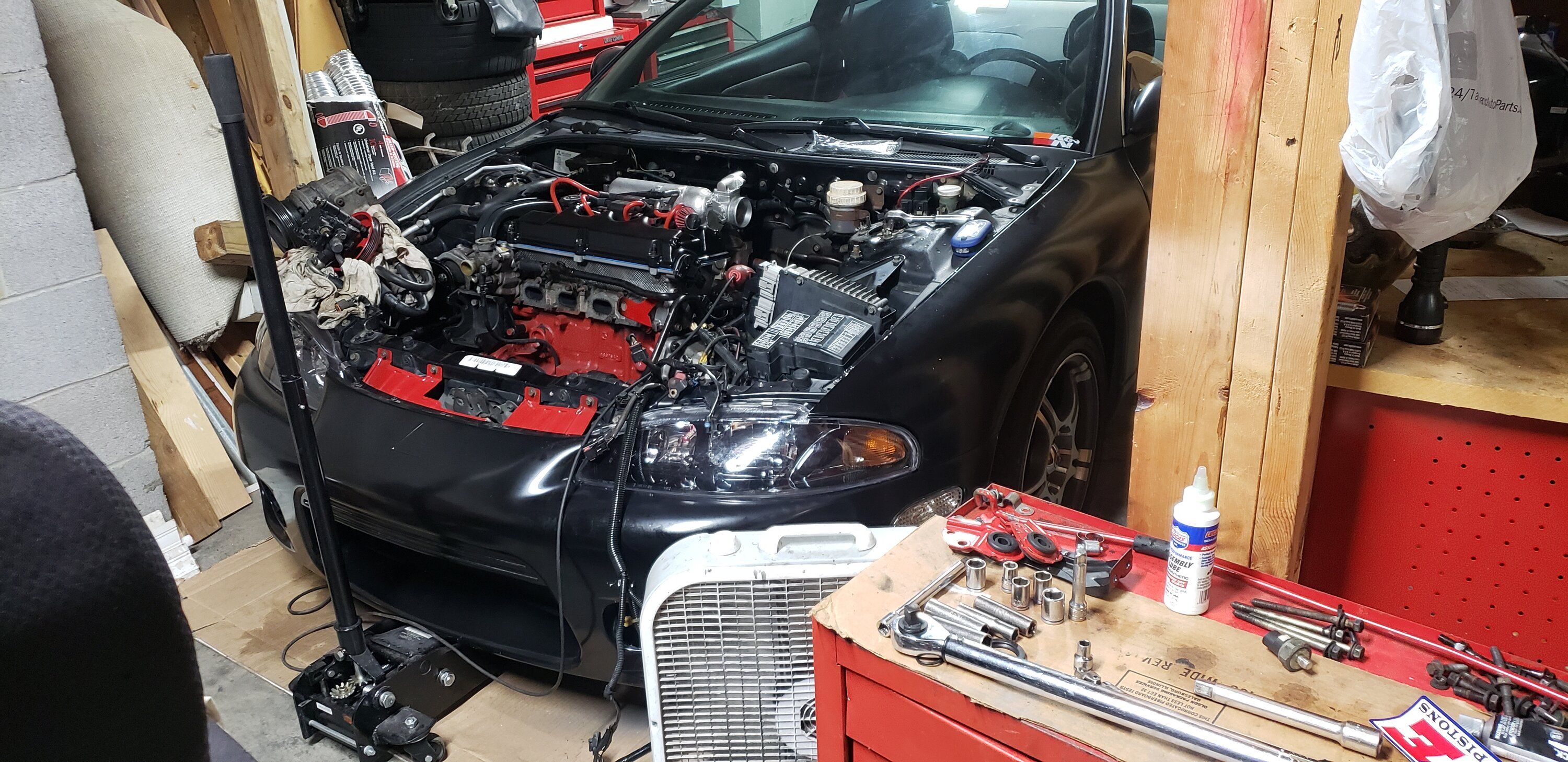

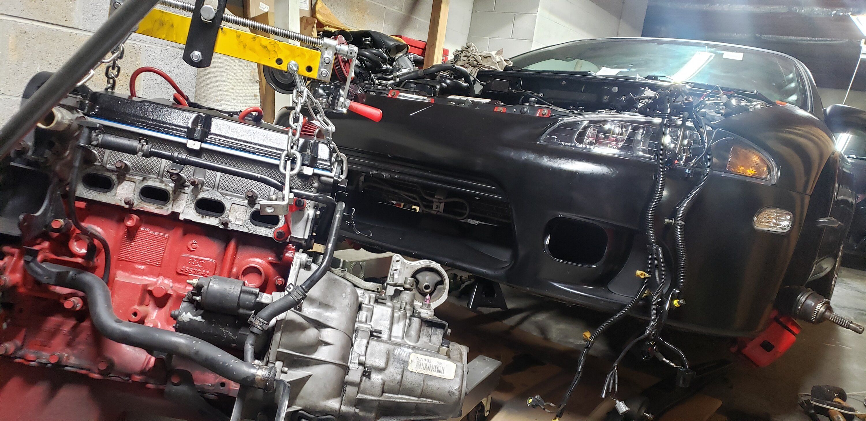

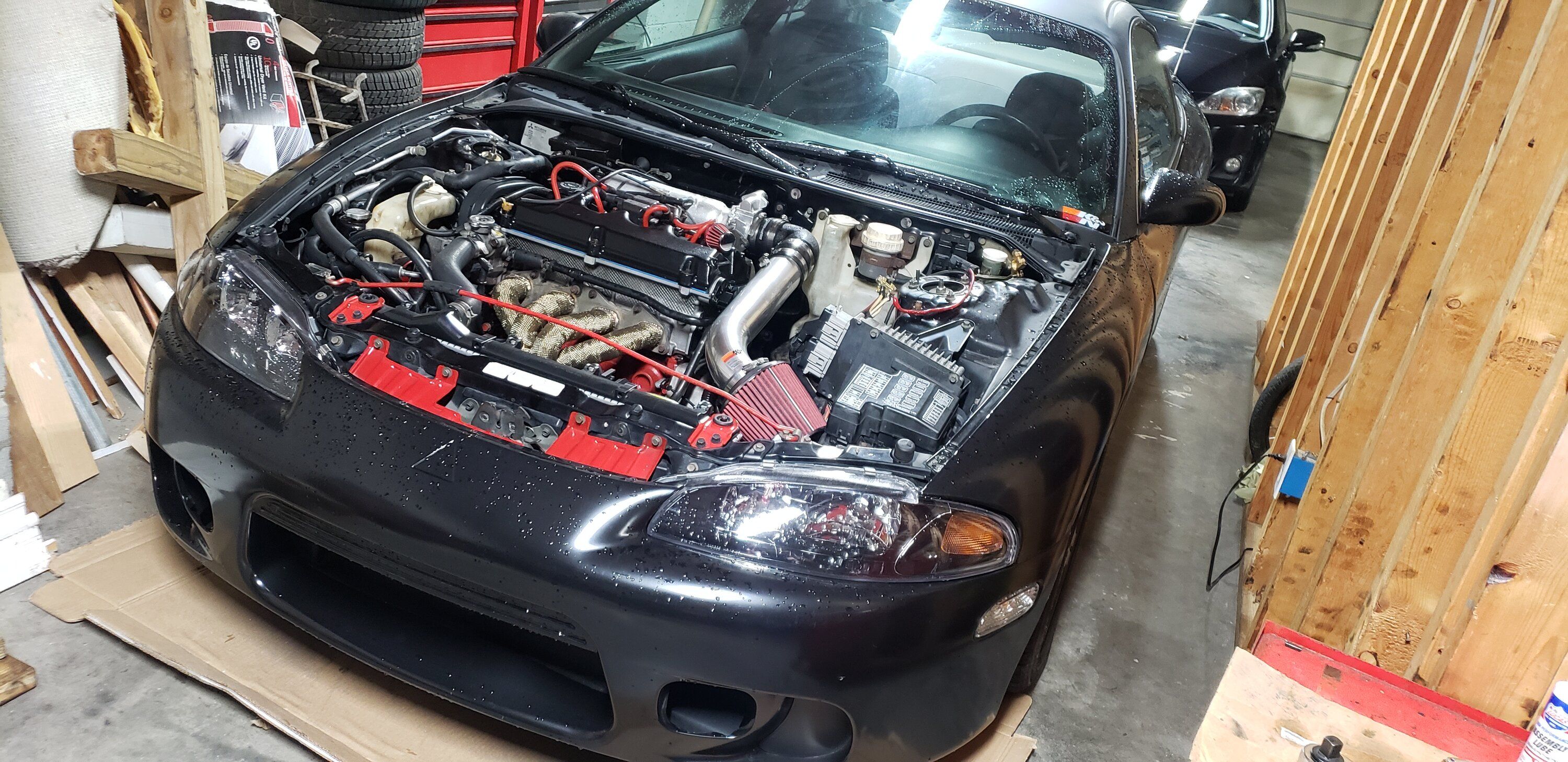

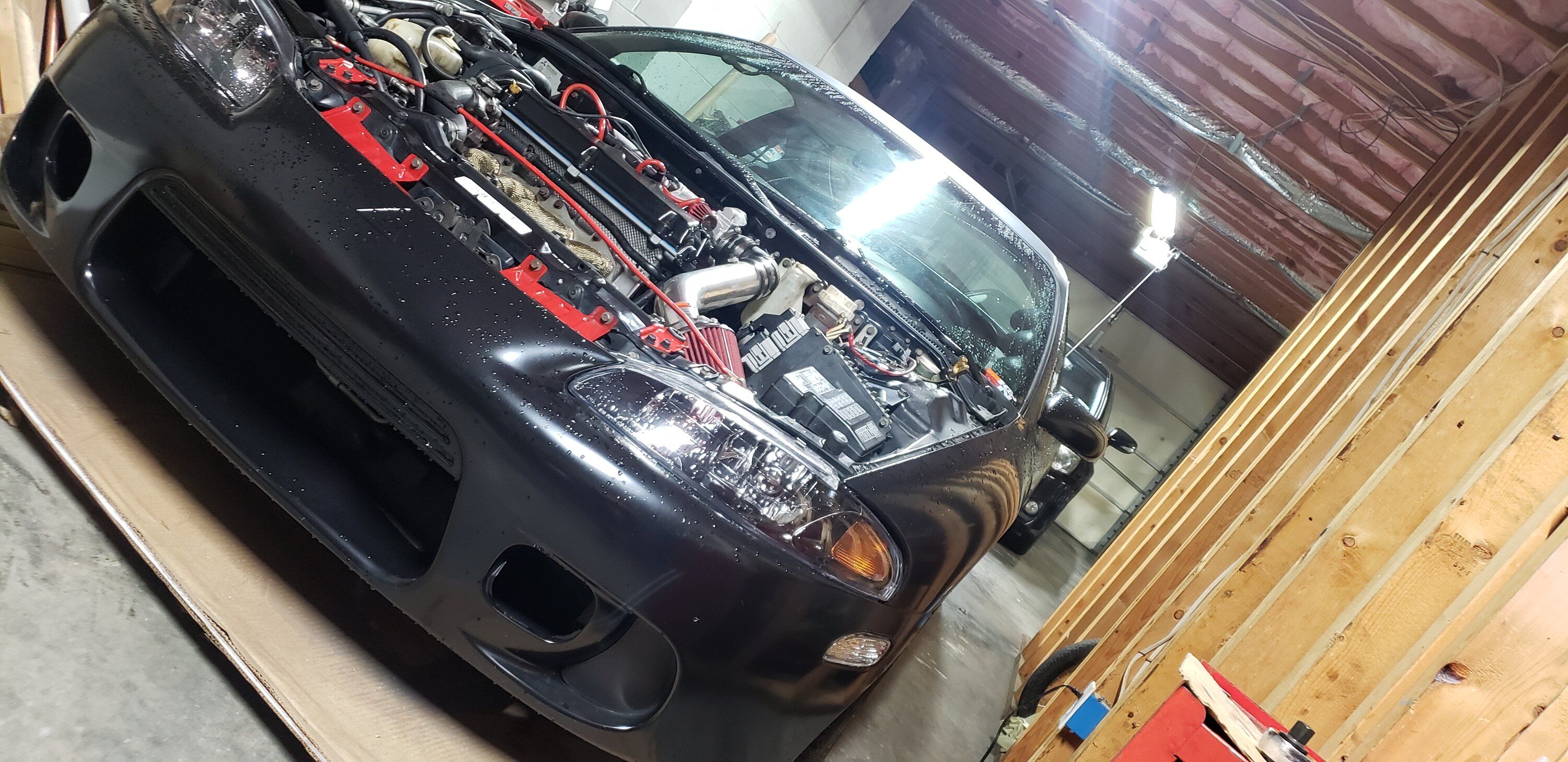

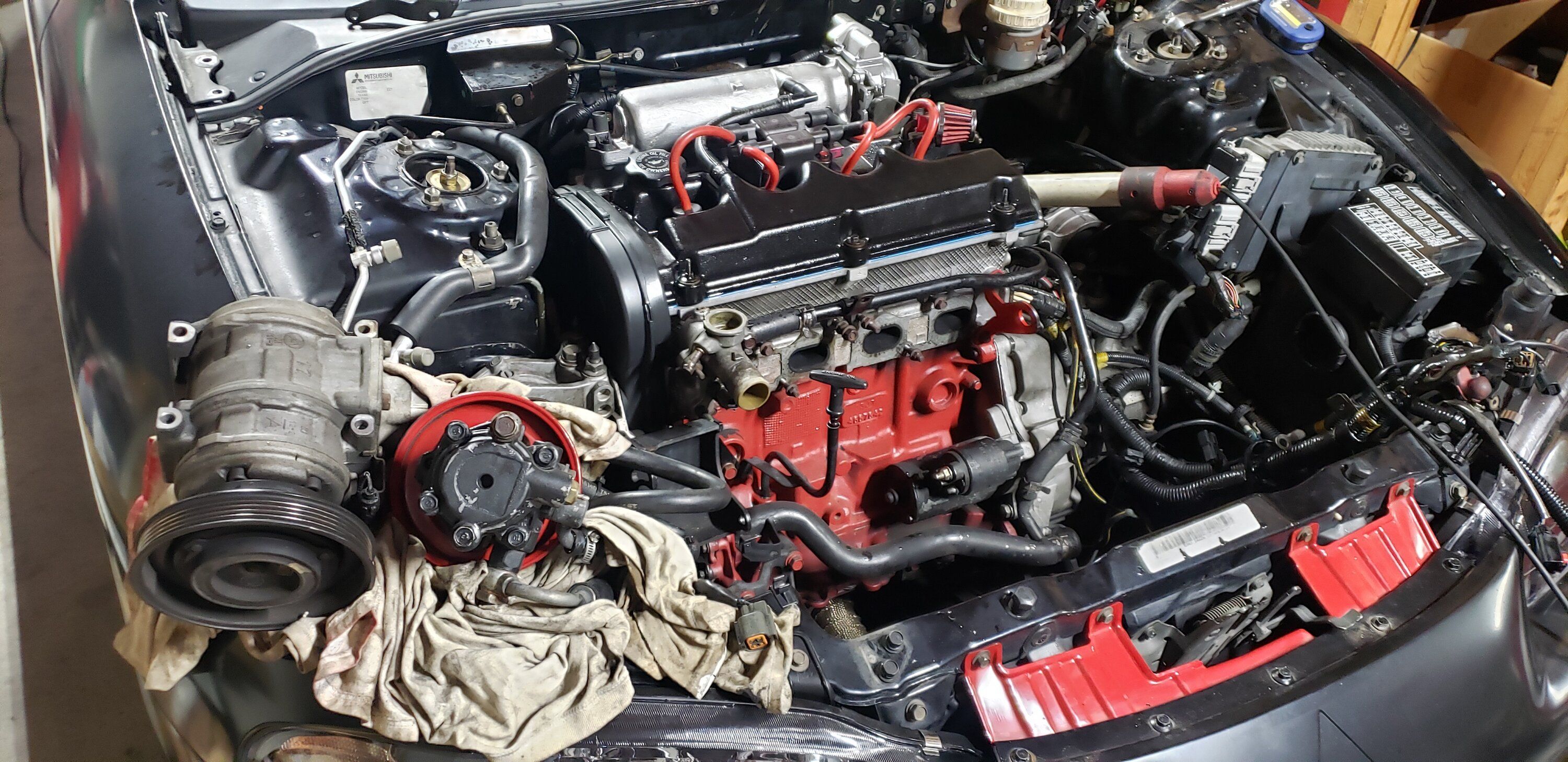

I made room in the garage and started tearing her down tonight. After pulling my heavy hood and heavy battery, my back told me it was time to quit. I need an easy day at work so I can spend 6 hours on the car and have the engine out.
EDIT: I've been asked about the cardboard sheet underneath the front of the car. It's good practice if you don't like scrubbing the floor from various fluid spills...

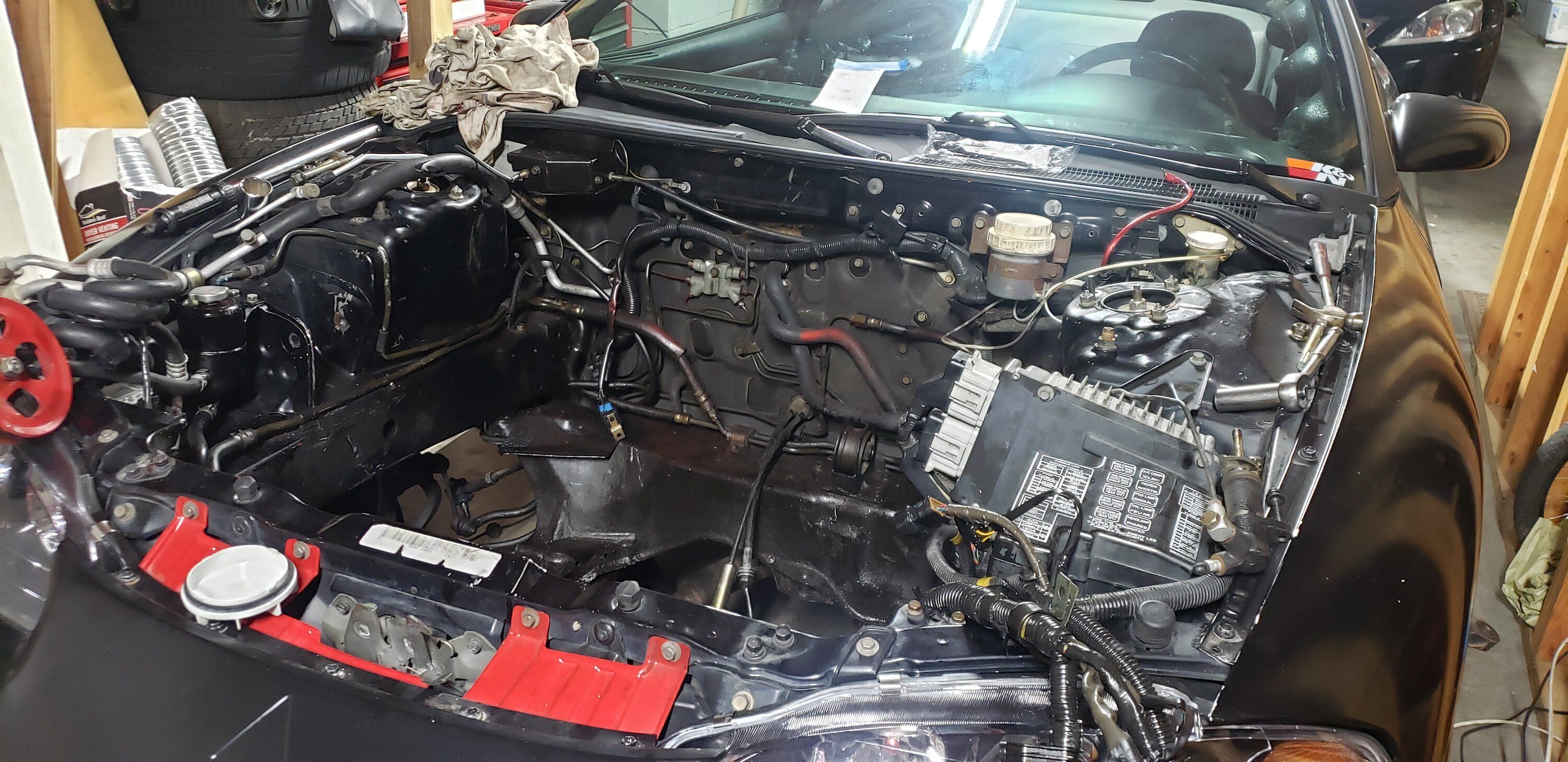

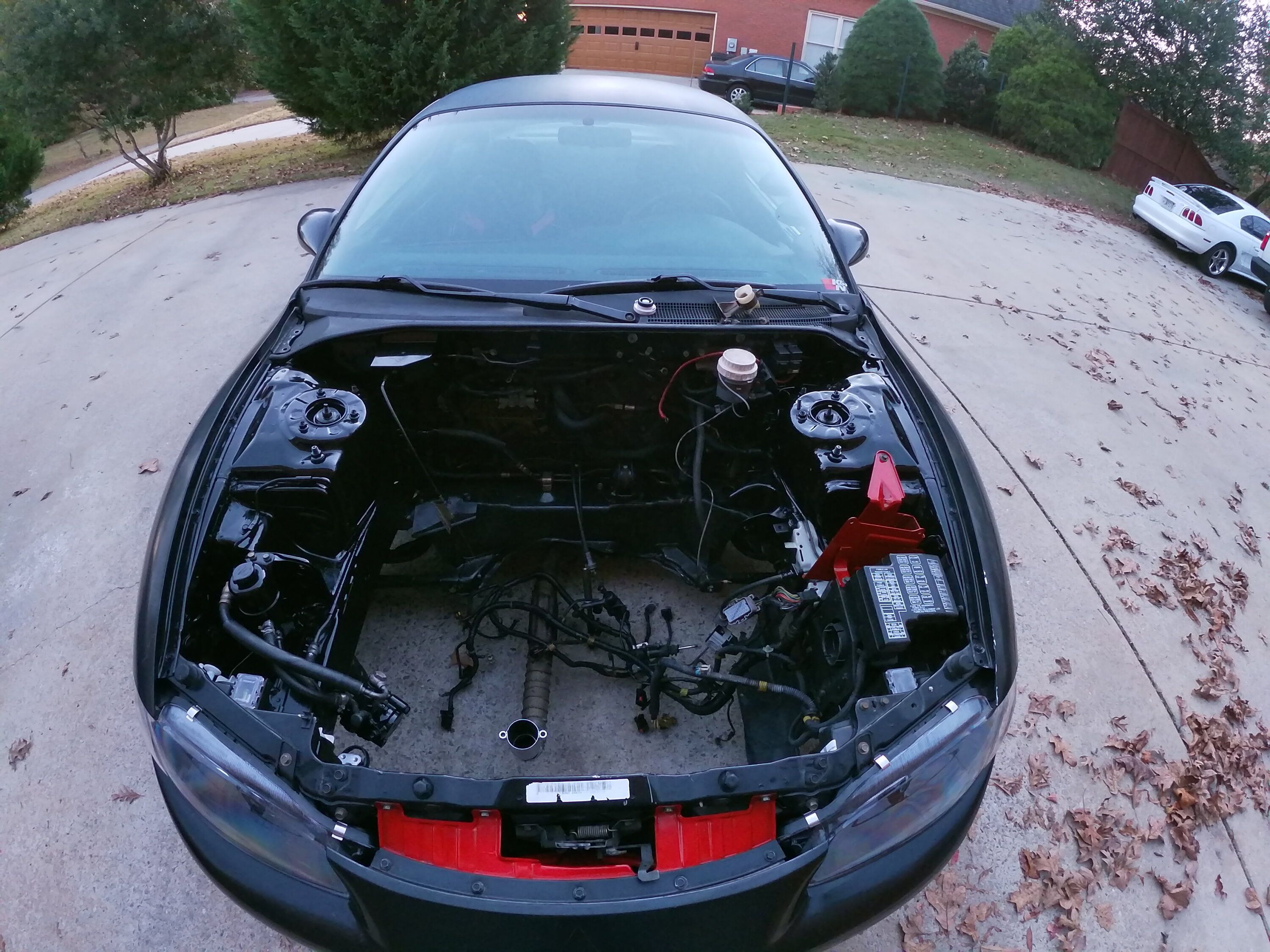

I removed a bunch of extra junk from the engine bay and cleaned it up a lot and saved weight. Got the engine bay and a few of the accesories painted. Look at how clean the strut towers came out!

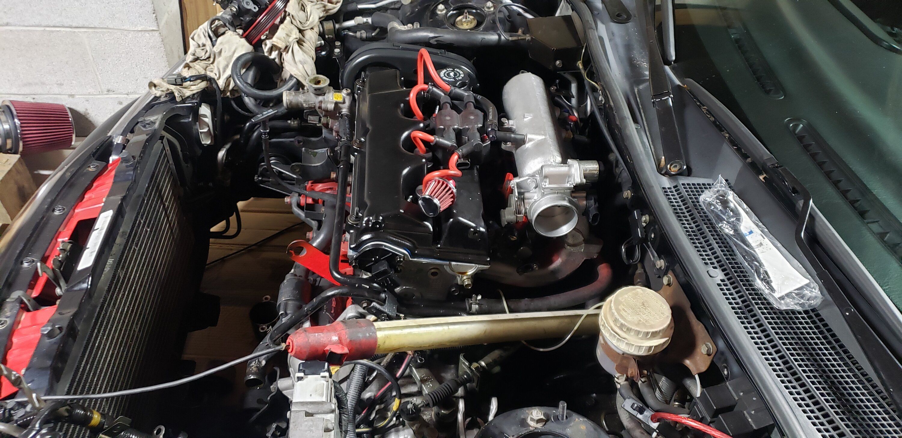

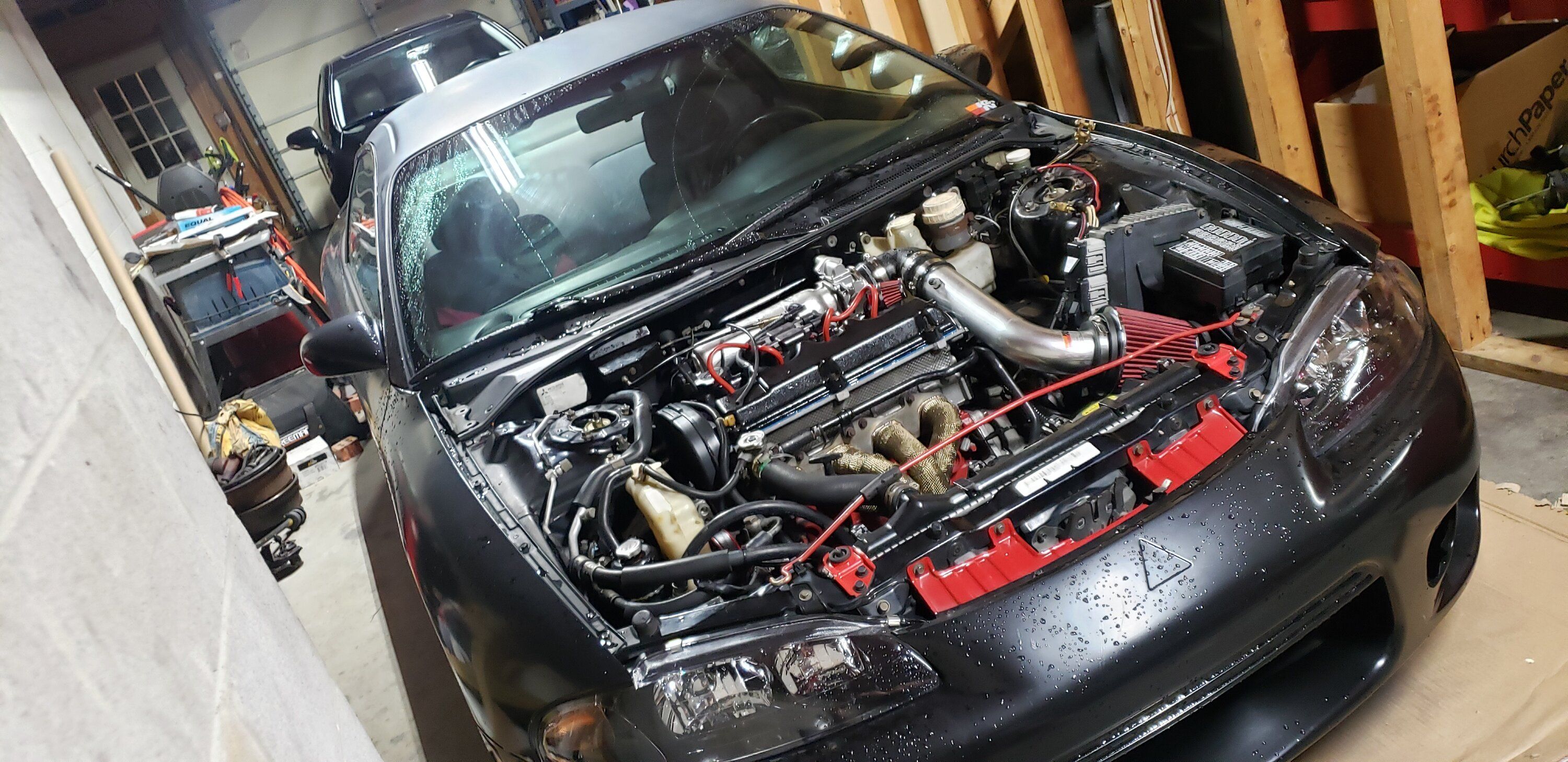

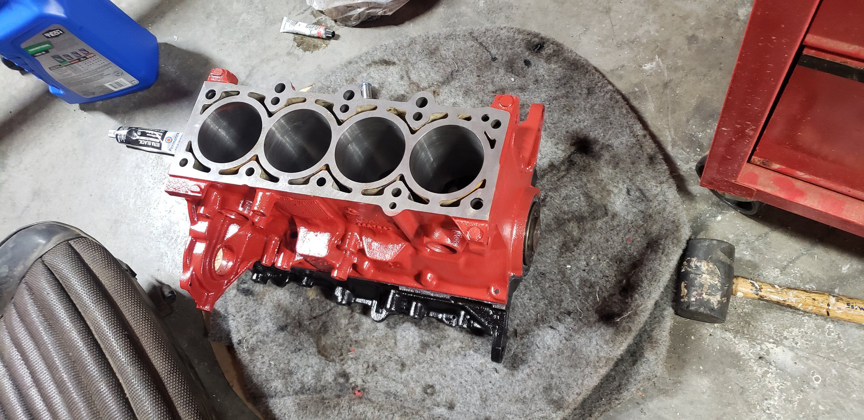

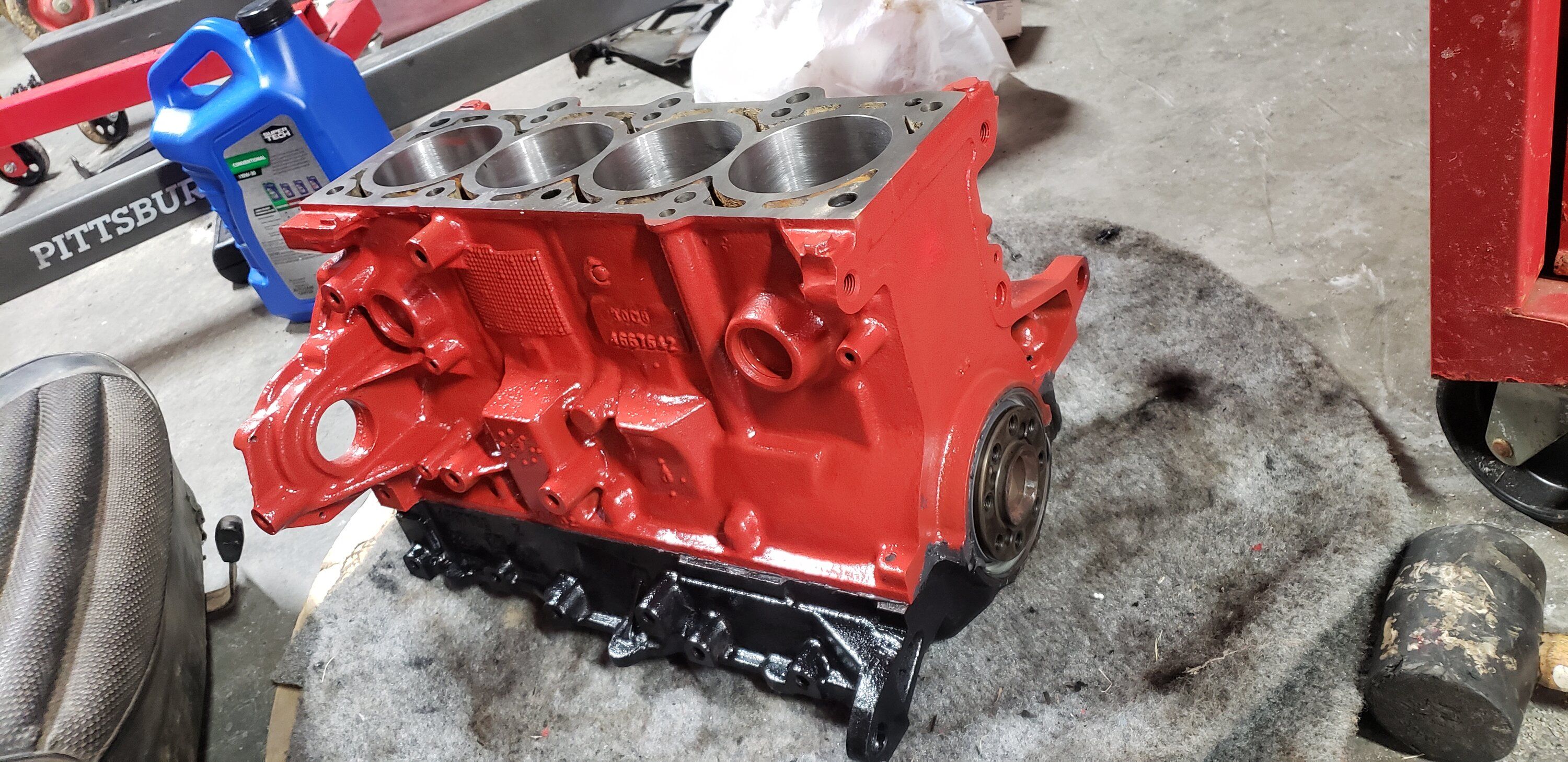

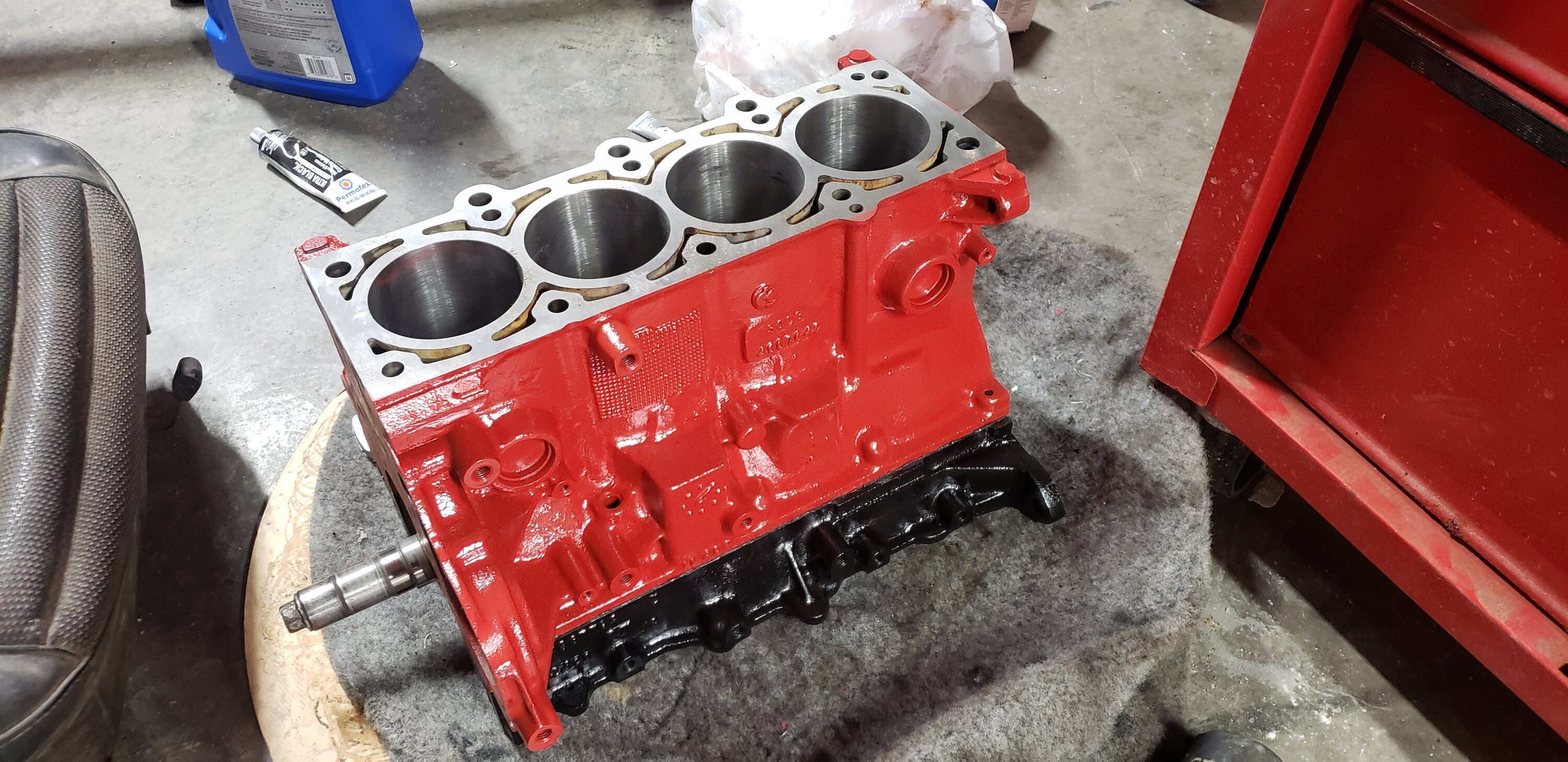

The engine is almost completely back together.
