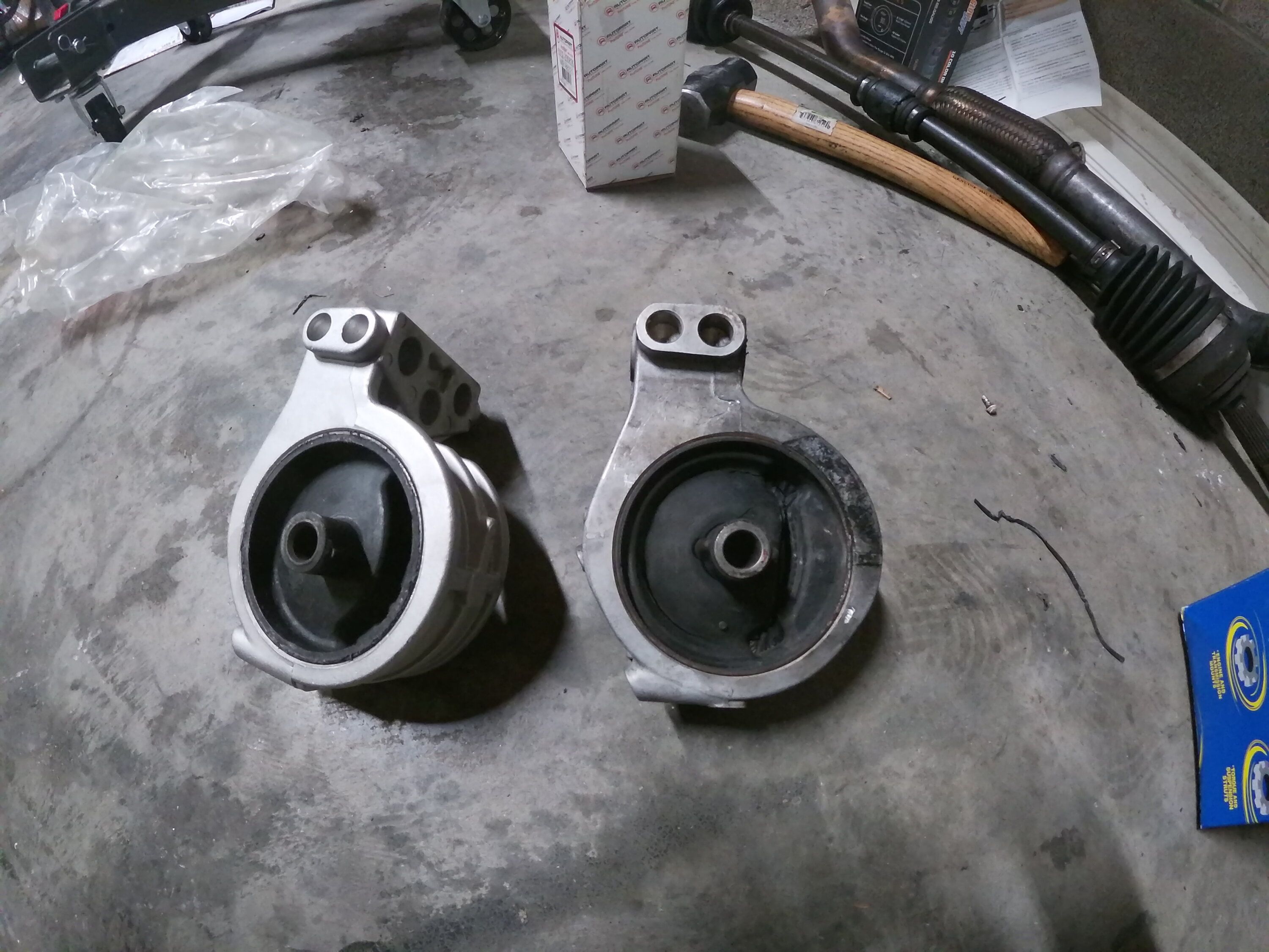

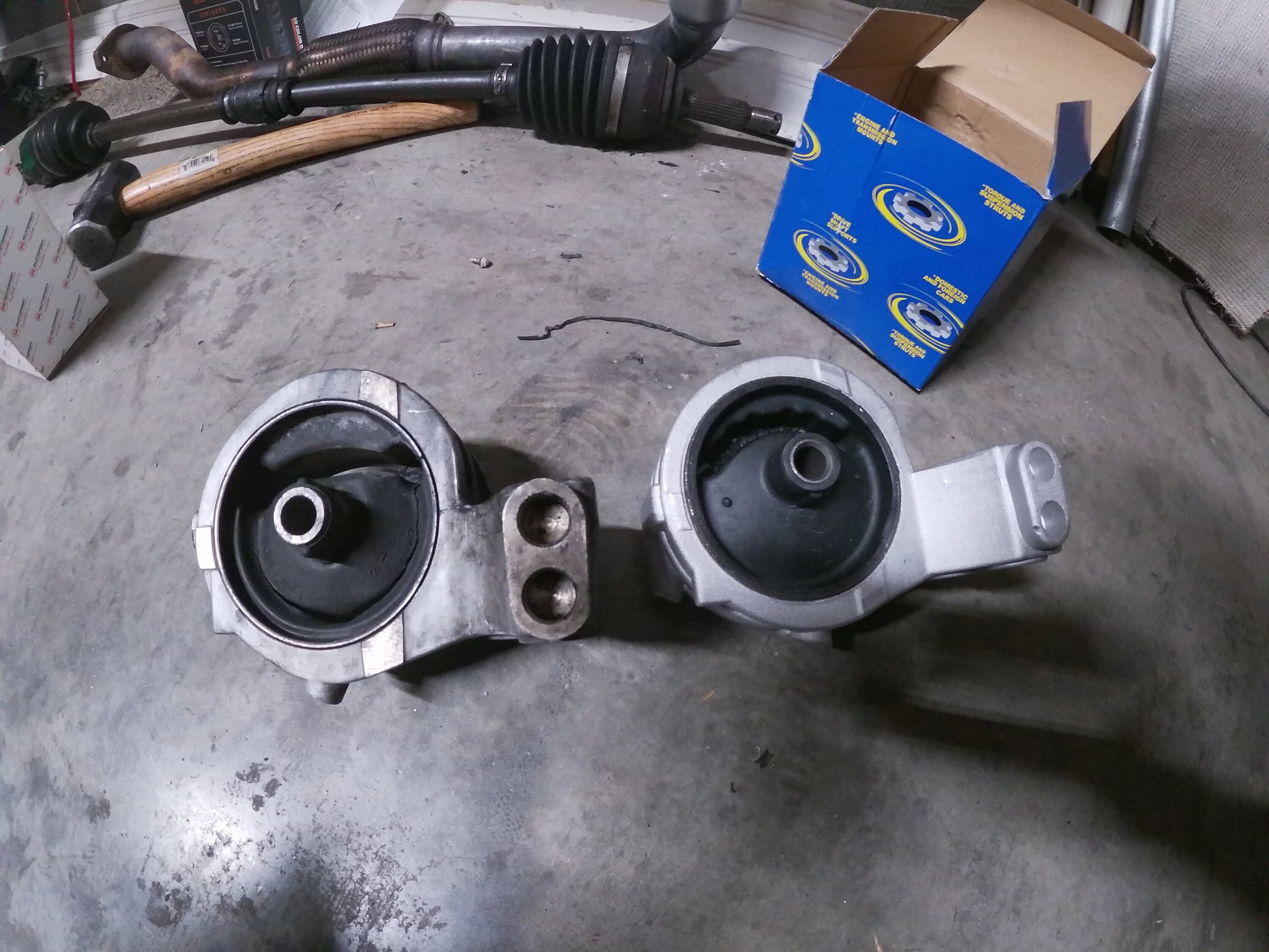

Got my upper engine mount replaced. The center was about to fall out of it. Also snapped a couple decent pics from the show this morning. Can't wait for it to be broken in.

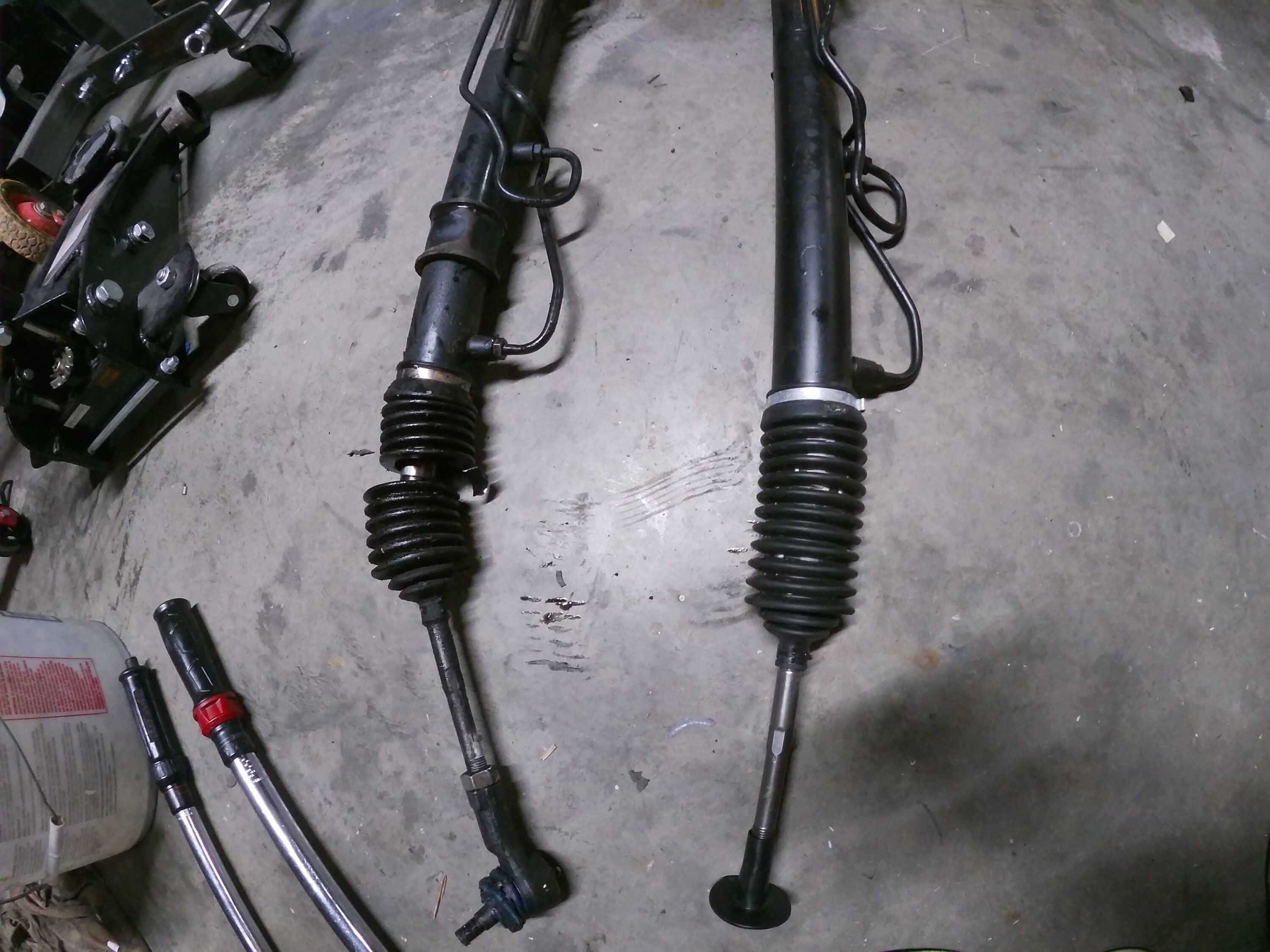

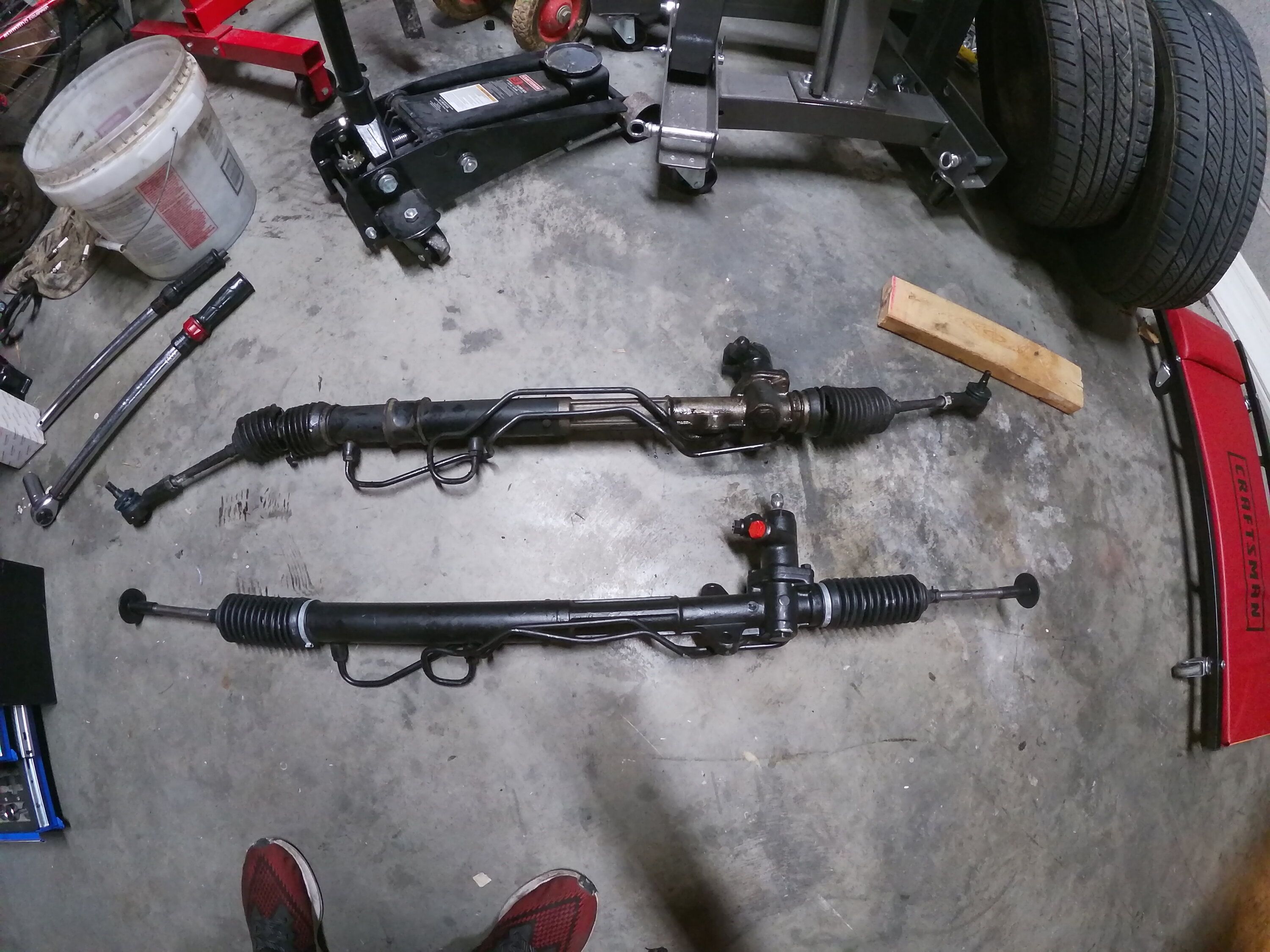

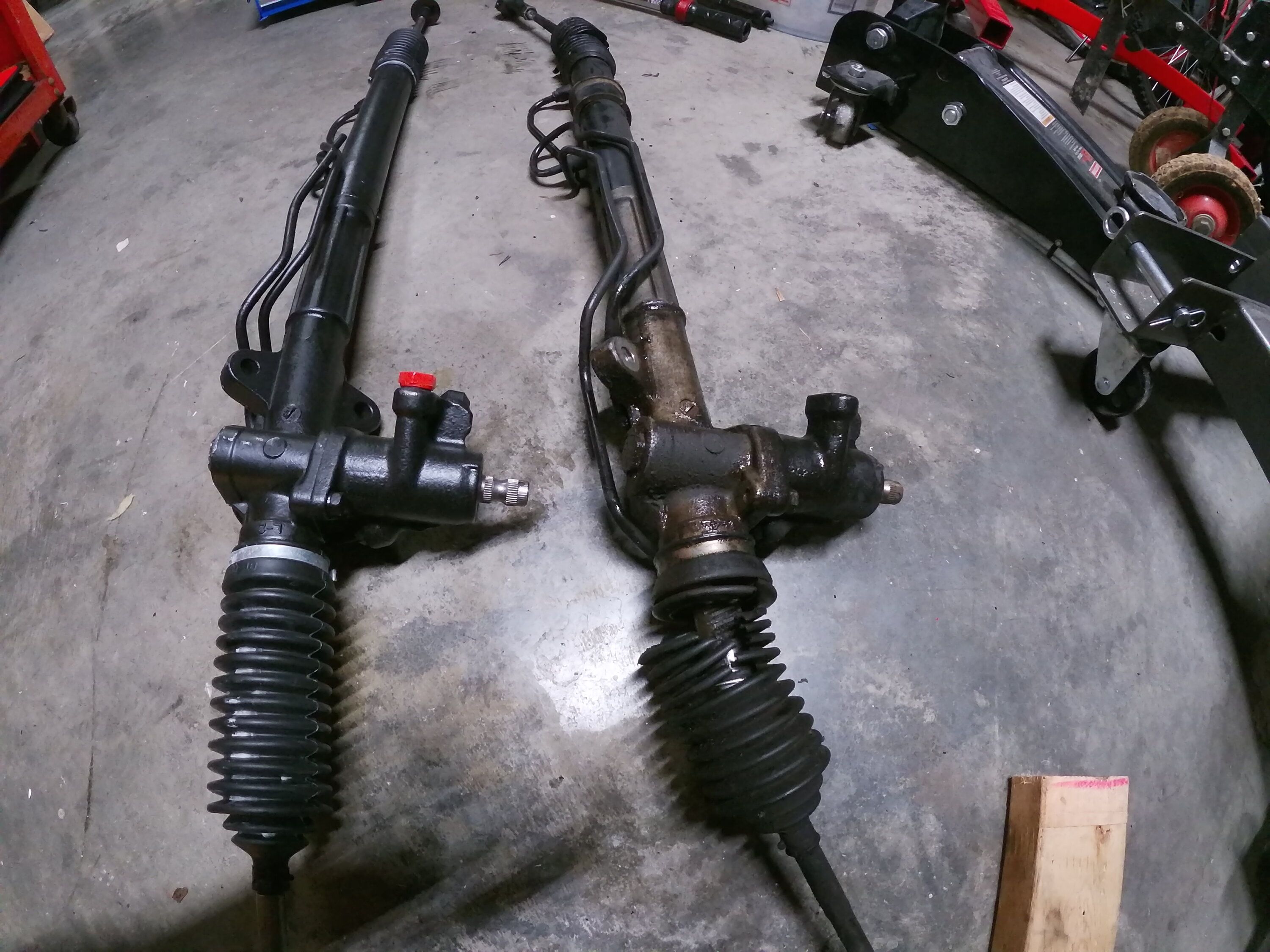

On another note, I ordered a new rack and pinion unit. I've had suspicions about it leaking for about a year and recently it popped and leaked all the fluid out on the floor.
I just feel like the car will never stop leaking. I can't remember a single day that I've driven the car in the past 3 years that it wasn't leaking something from somewhere. It always tricks me. I replace the leaking seal, and it's dry for a few minutes before another seal blows out. I try different types of oil, different types of sealant. I fix leaks one at a time until there's none left, then I make full circle.

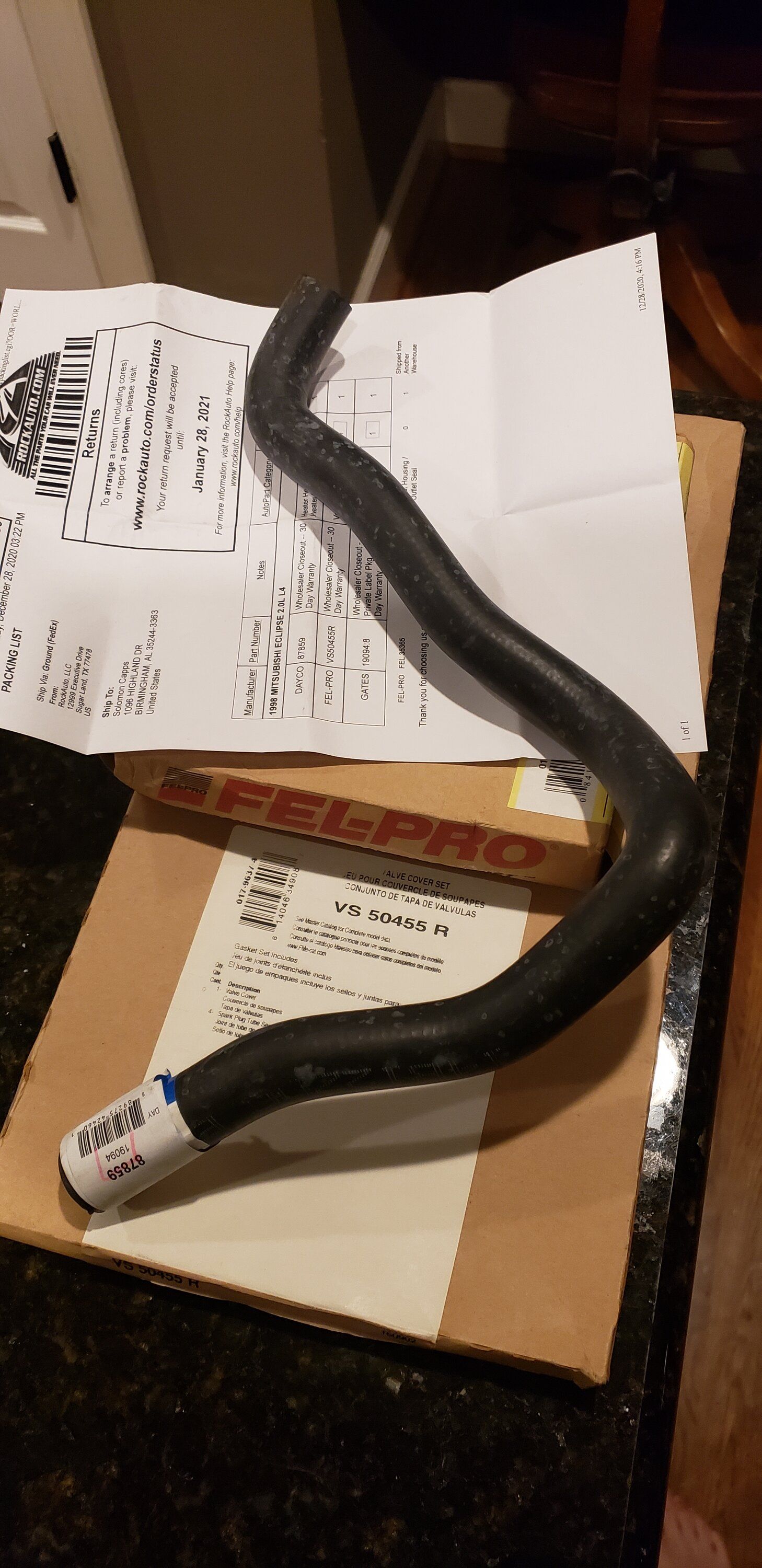

Sounds crazy to say that considering I basically have a new engine. But the valve cover gasket blew out again. So I've got to get that done before I can run.

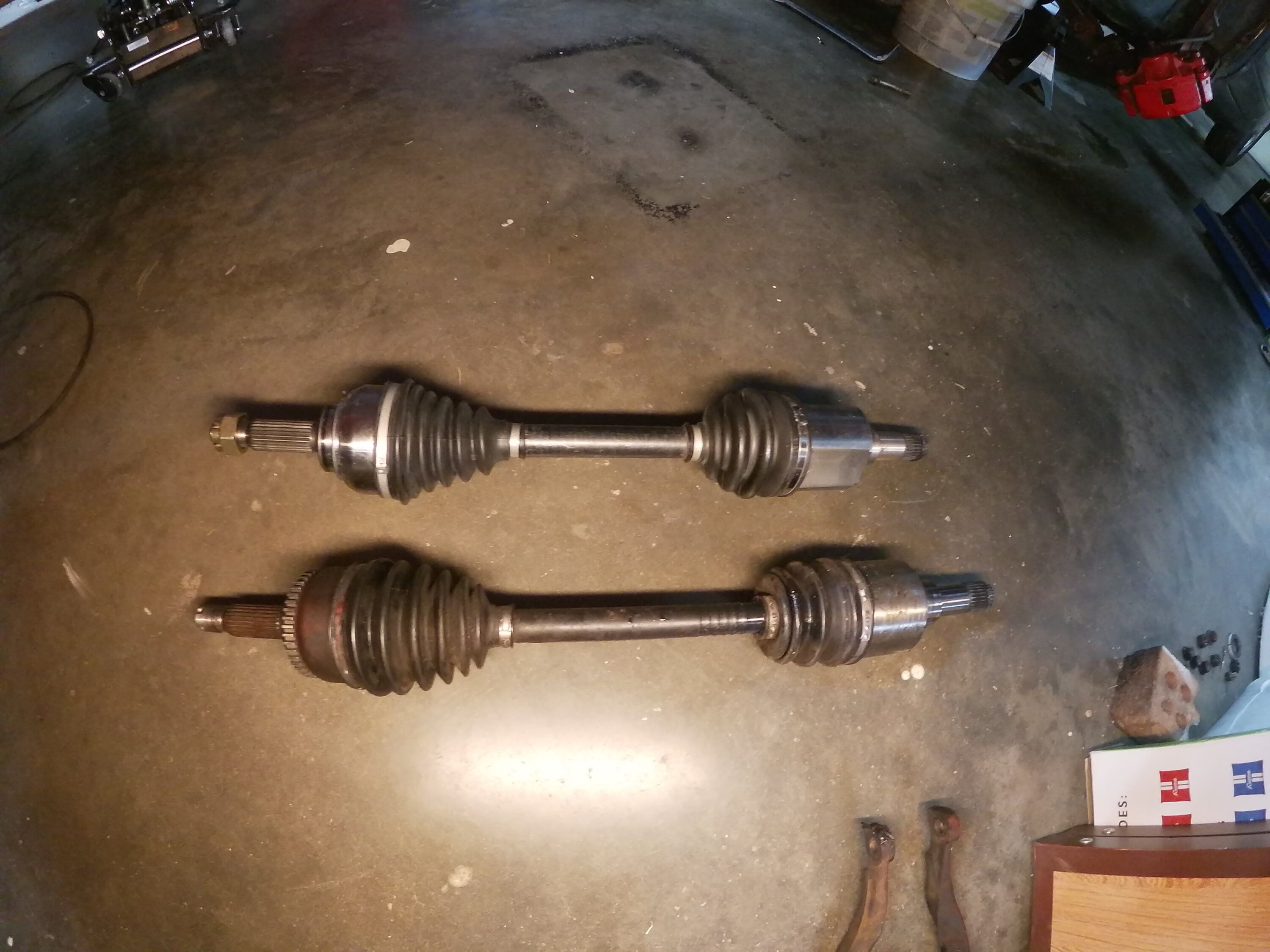

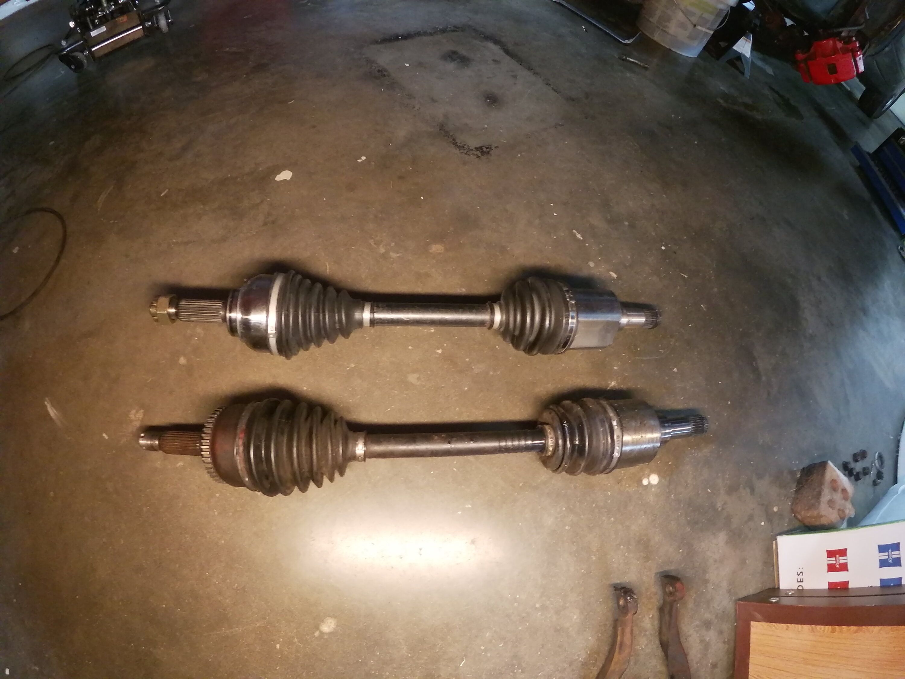

Got a new driver side axle installed. The stock one was really at the end of it's life. The car drives much smoother and quieter.
EDIT: You'll notice I removed the ABS gear from the new axle. Since it's a non-ABS car, I don't need the extra rotational weight, no matter how small.

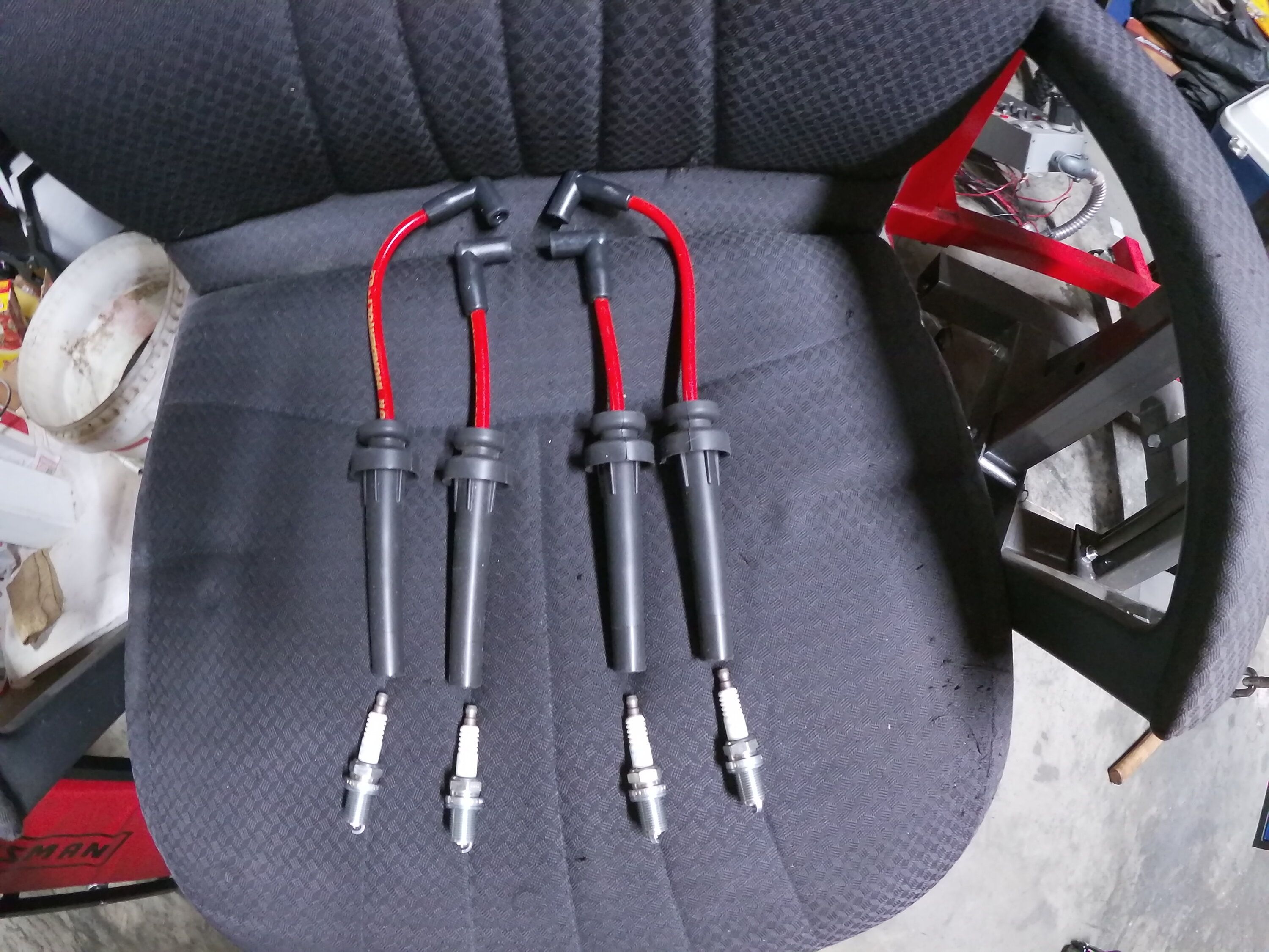

I got some new ignition parts.
So the stock plug wires make about 600 ohms of resistance. These new plug wires only make 25 ohms of resistance.
And I got some fresh NGK plugs, and gapped them at 0.047". I'm going to give that a shot and hopefully I see gains without a misfire.
