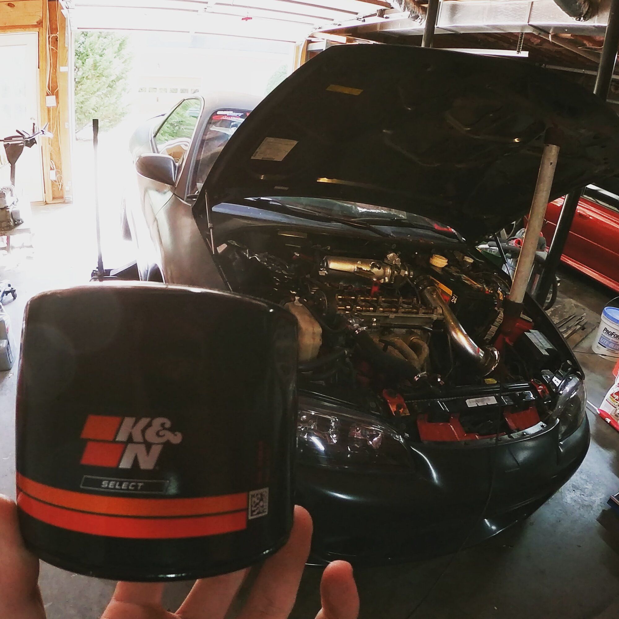

Time for the seasonal valve cover gasket & oil change. This time I was very meticulous and used an OEM gasket. So hopefully it will seal up and I won't be changing it next season.

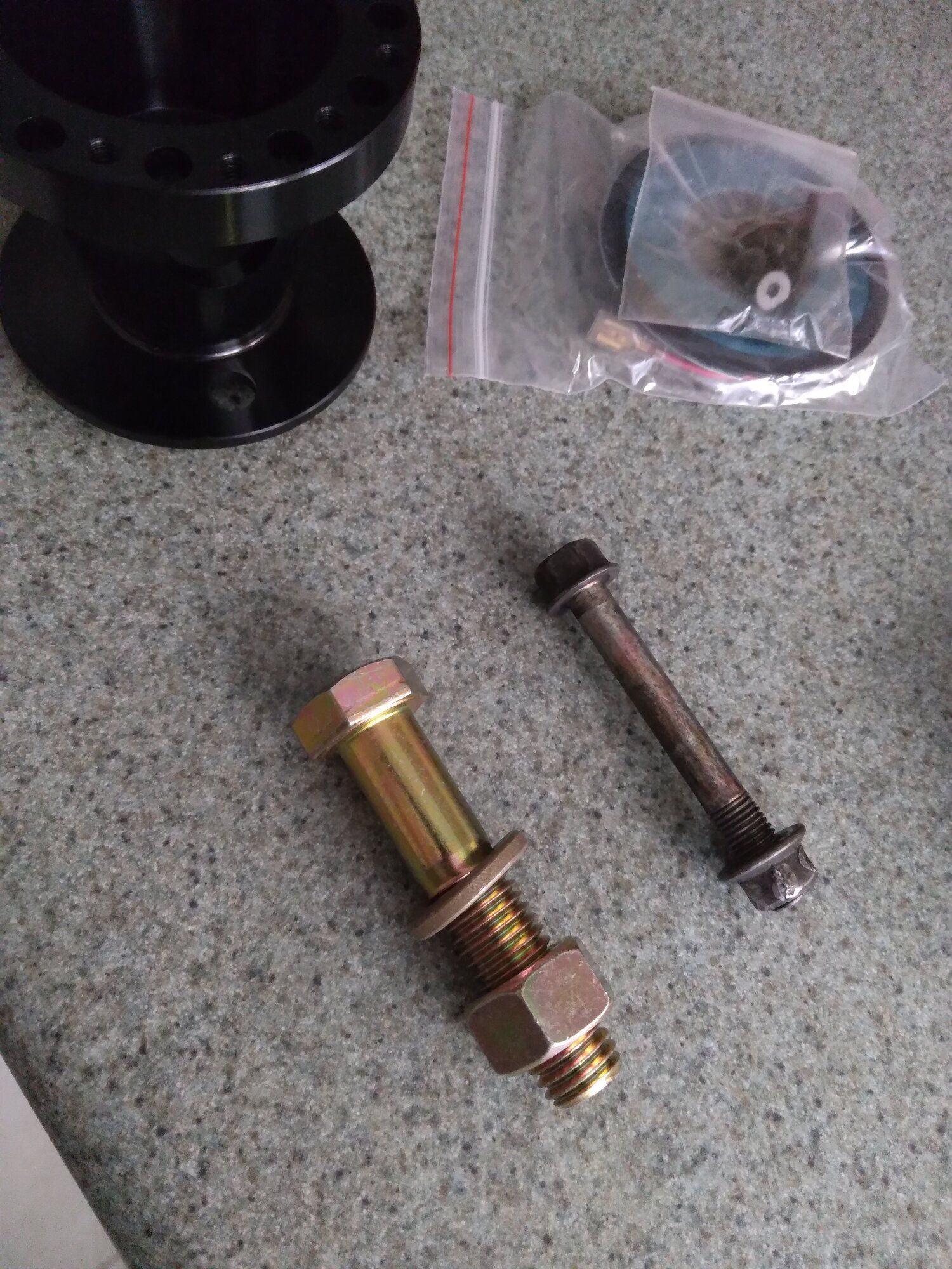

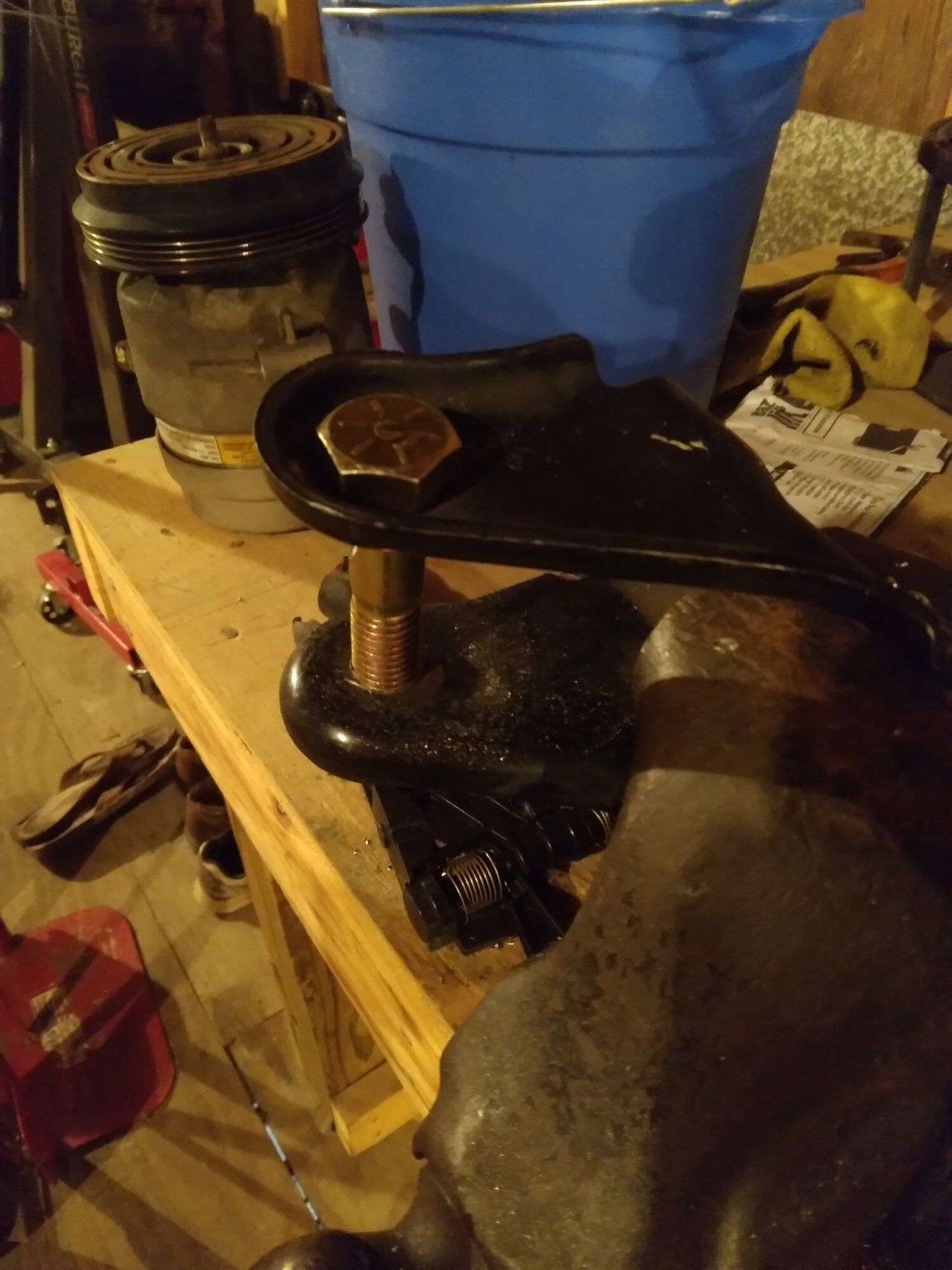

I'm doing the lower engine mount bolt upgrade like they recommend on 2GNT. I can definitely see how this will help.
Do you snap bolts or something? That why its an upgrade.
Interesting. I thought all front bolts were 10mm as i took mine off and im sure its 10mm also? 420a chassis i have for mocking up.
I would of just sleeved the mount had a hole like for like and used a 12.9 grade bolt for strength, this way its less drilling and more equal but instead of opening the outer mount so big your closing the bush hole up.
It looks like you could sleeve it like THIS, but I don't know if it is the same as the mount that I adapted.

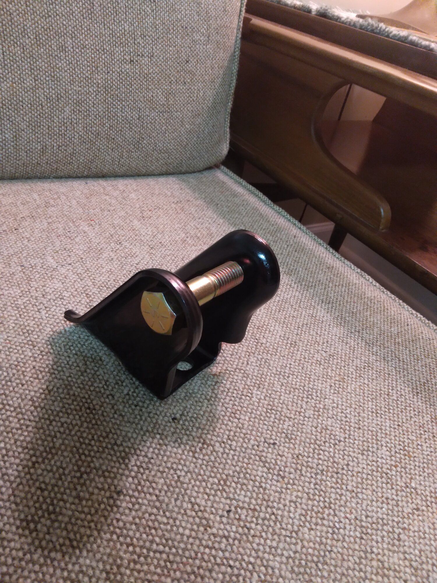

I tried putting a sleeve in there but I couldn't find one the right size. I'd much rather have that beefy bolt in there anyway because that small stock one is already pretty beat up.
I got the mount bracket holes drilled out today. I also sprayed it with some glossy black.

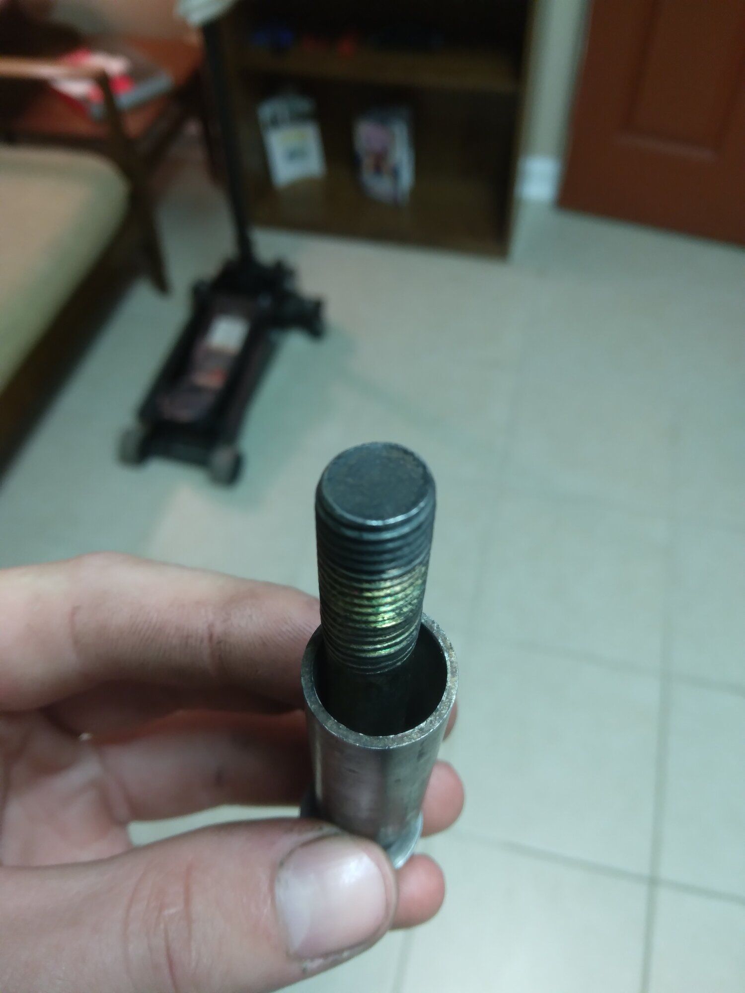

Here's the sleeve I was running. It helped a lot, but as you can see there was still too much play.

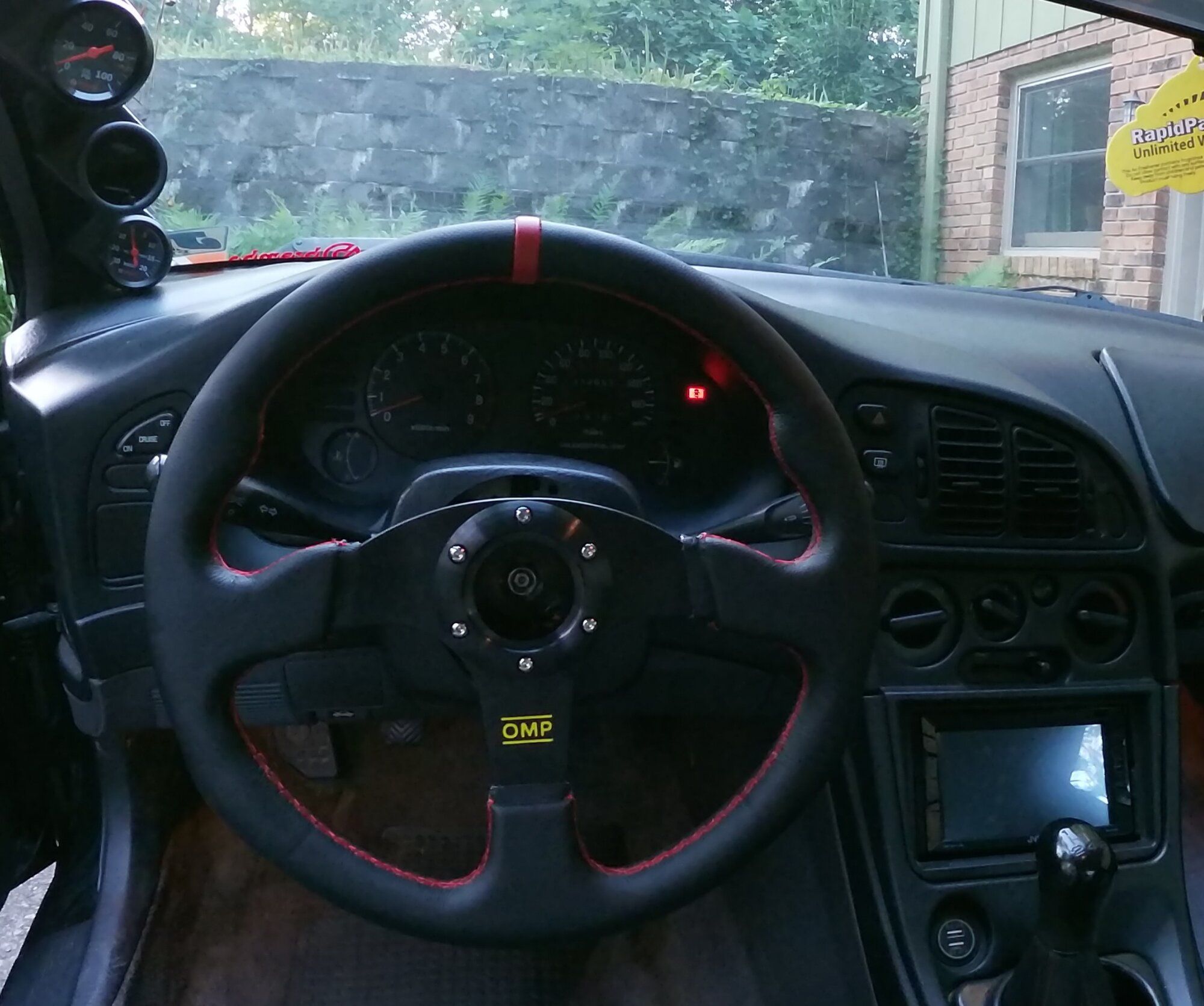

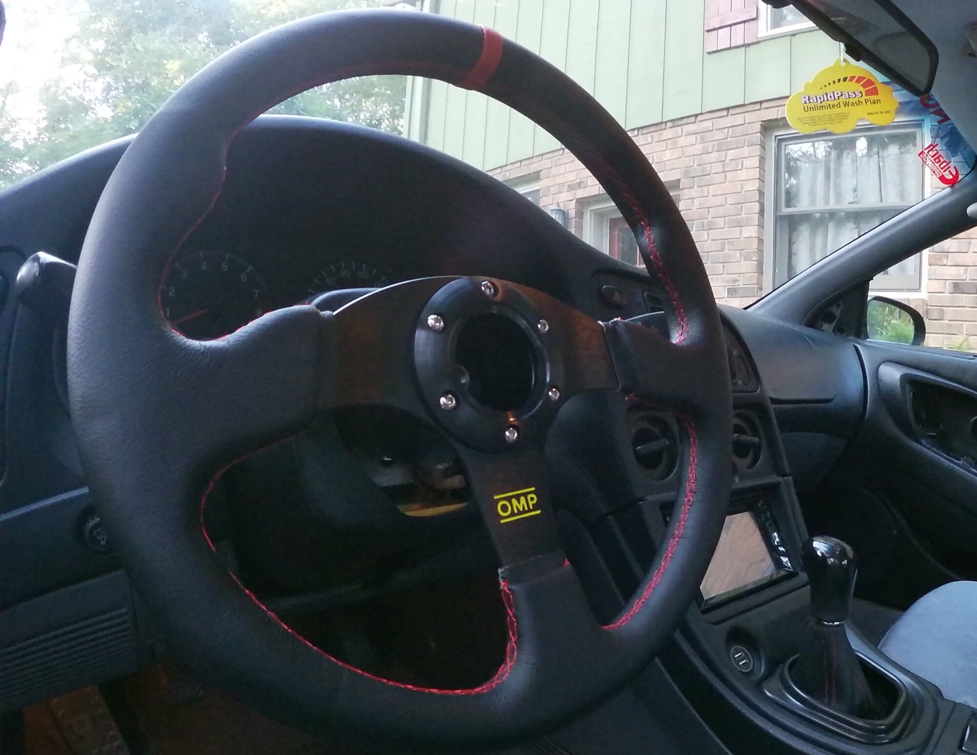

New steering wheel installed. I still need to get the horn button correctly wired up and then I'll clean everything up and get it properly torqued down.
I was feeling a little iffy about using this brand, so I got the 320S aluminum, which is one of their more expensive ones. It feels pretty sturdy.

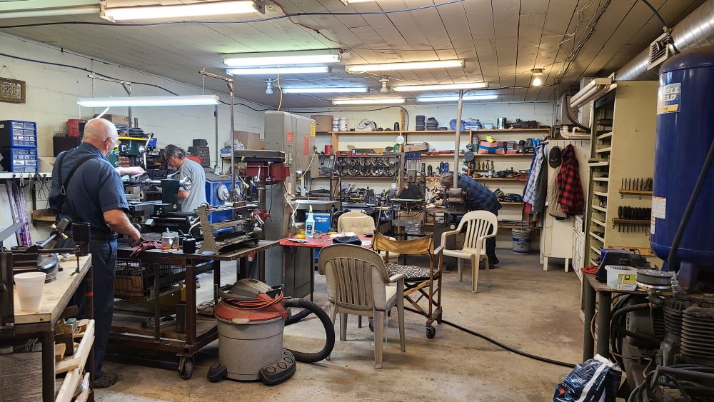

I love the red stripe at the top of the wheel .. Never know when you might get air born eh . Just a suggestion .. why don`t you take that bolt to a machine shop and have a sleeve made with the correct I/D and O/D ..OR maybe you could make another sleeve to fit inside that one to take up the gap .. . Fortunate for me .. a have a buddy right around the corner that has a machine shop right in his back yard.
Fred at his Lathe ...Guy at the sanding wheel ..Billy is a welder....

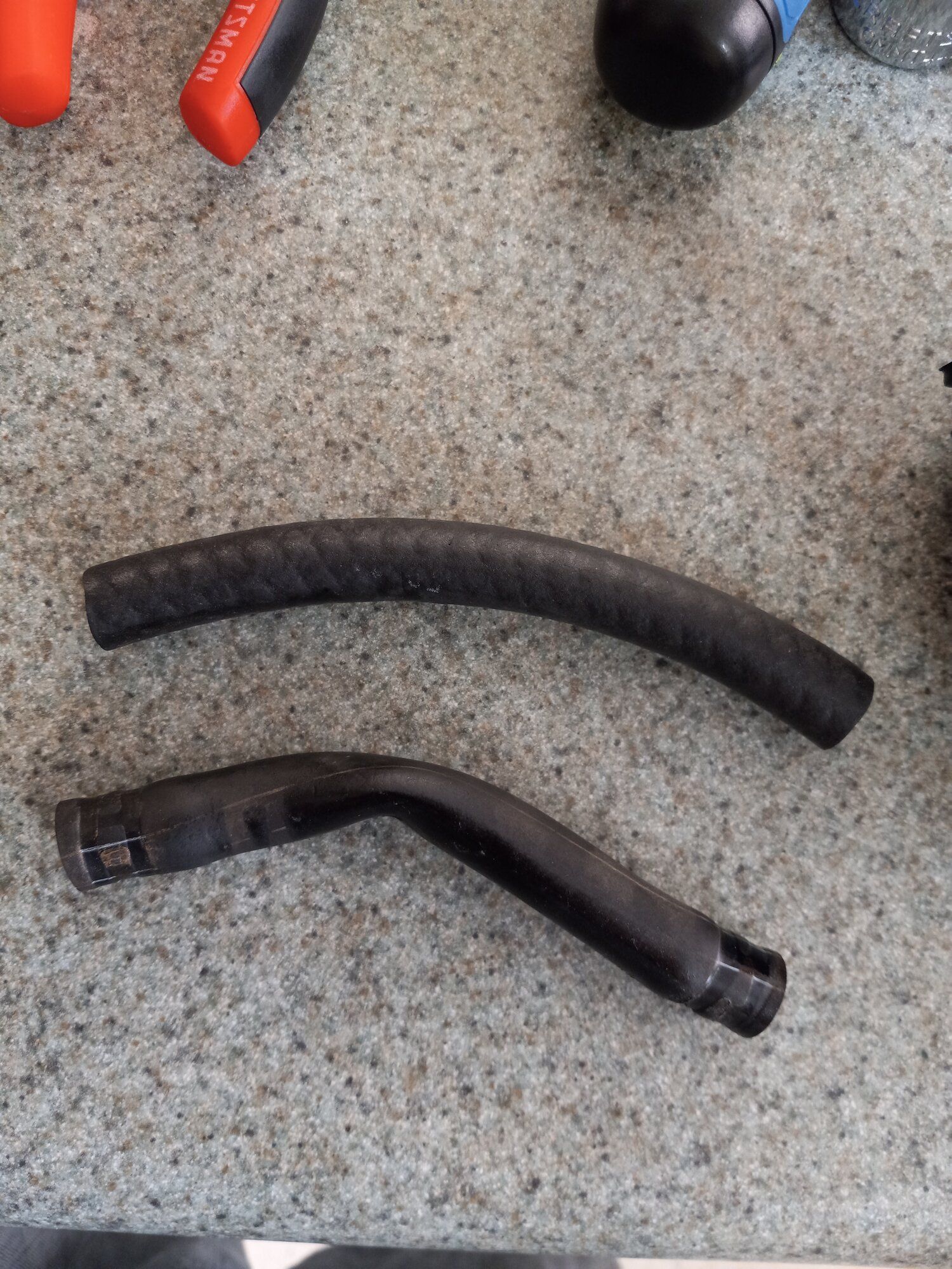

I had to buy a new hose going from the clutch reservoir to the master cylinder. It was perma-kinked. I should have much smoother clutch operation now.

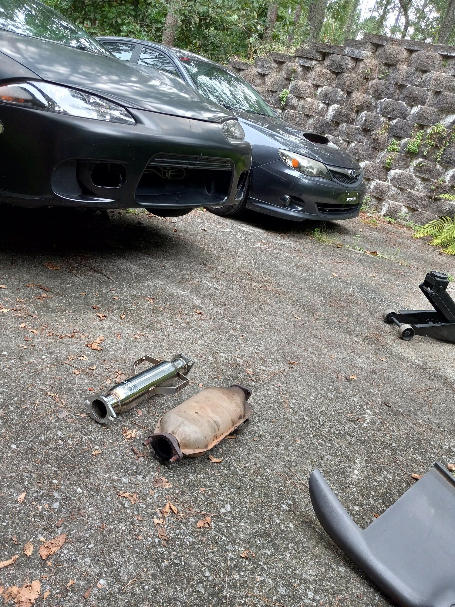

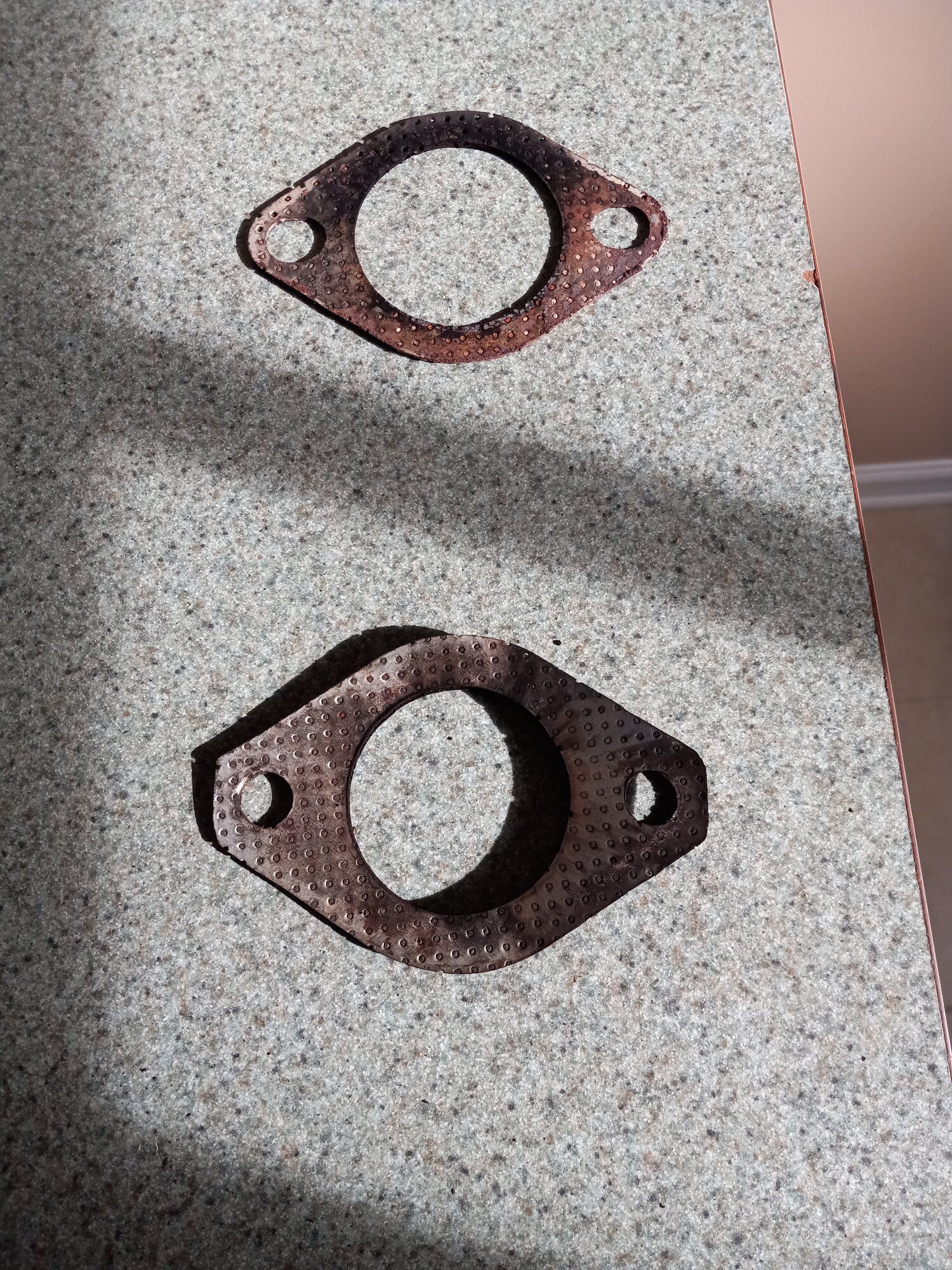

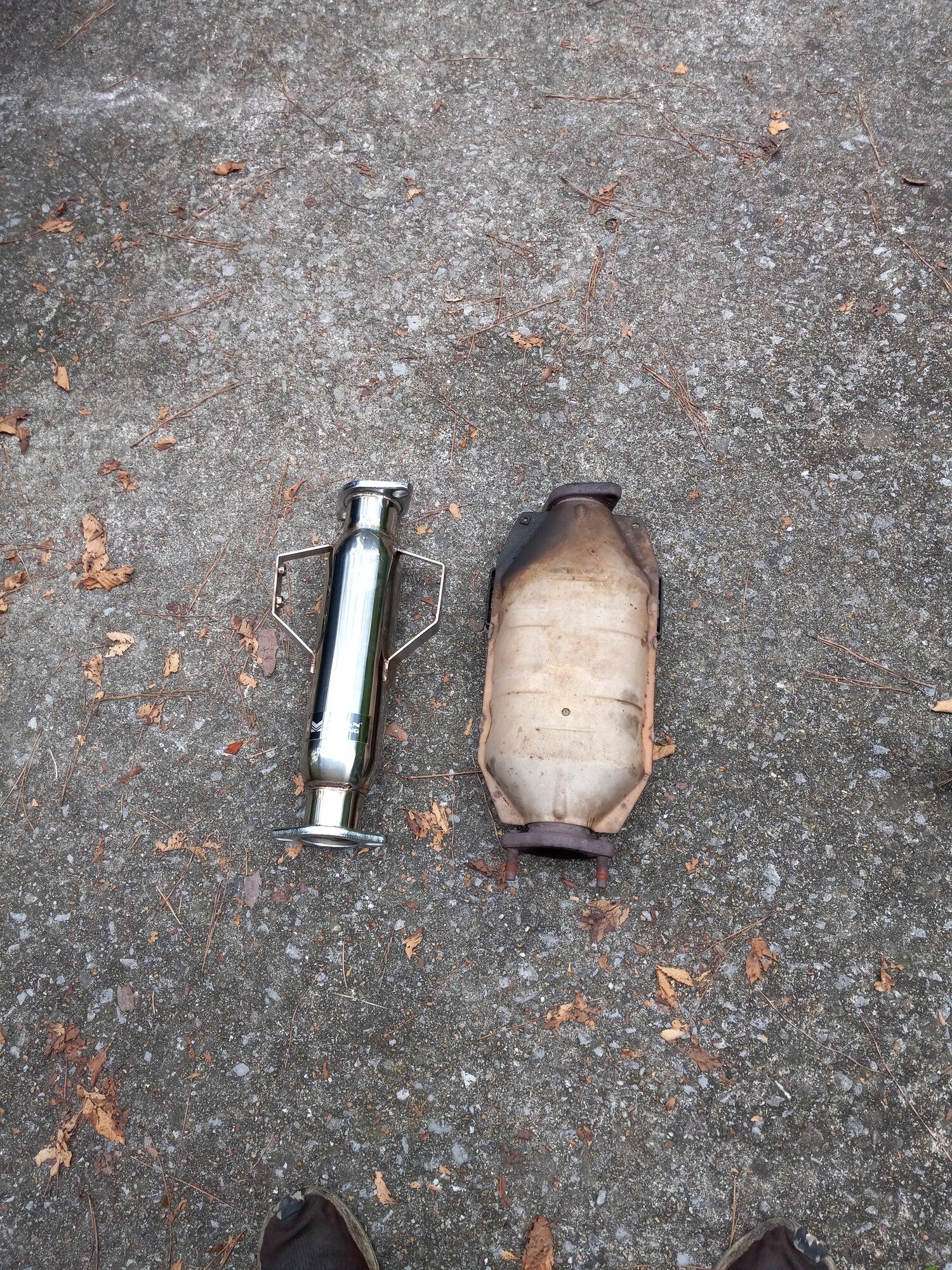

Just wanted to update with the pictures from when I swapped over to a test pipe. I installed my aftermarket rev limiter before I installed the test pipe, and as you can see it damaged the exhaust gaskets and possibly the catalytic convertor. Good thing I bought a name brand test pipe that came with gaskets and hardware.
And just an interesting detail to add. The stock cat weighed in at 13lbs. Test pipe weighed in at 5lbs. Savings of 8lbs.
