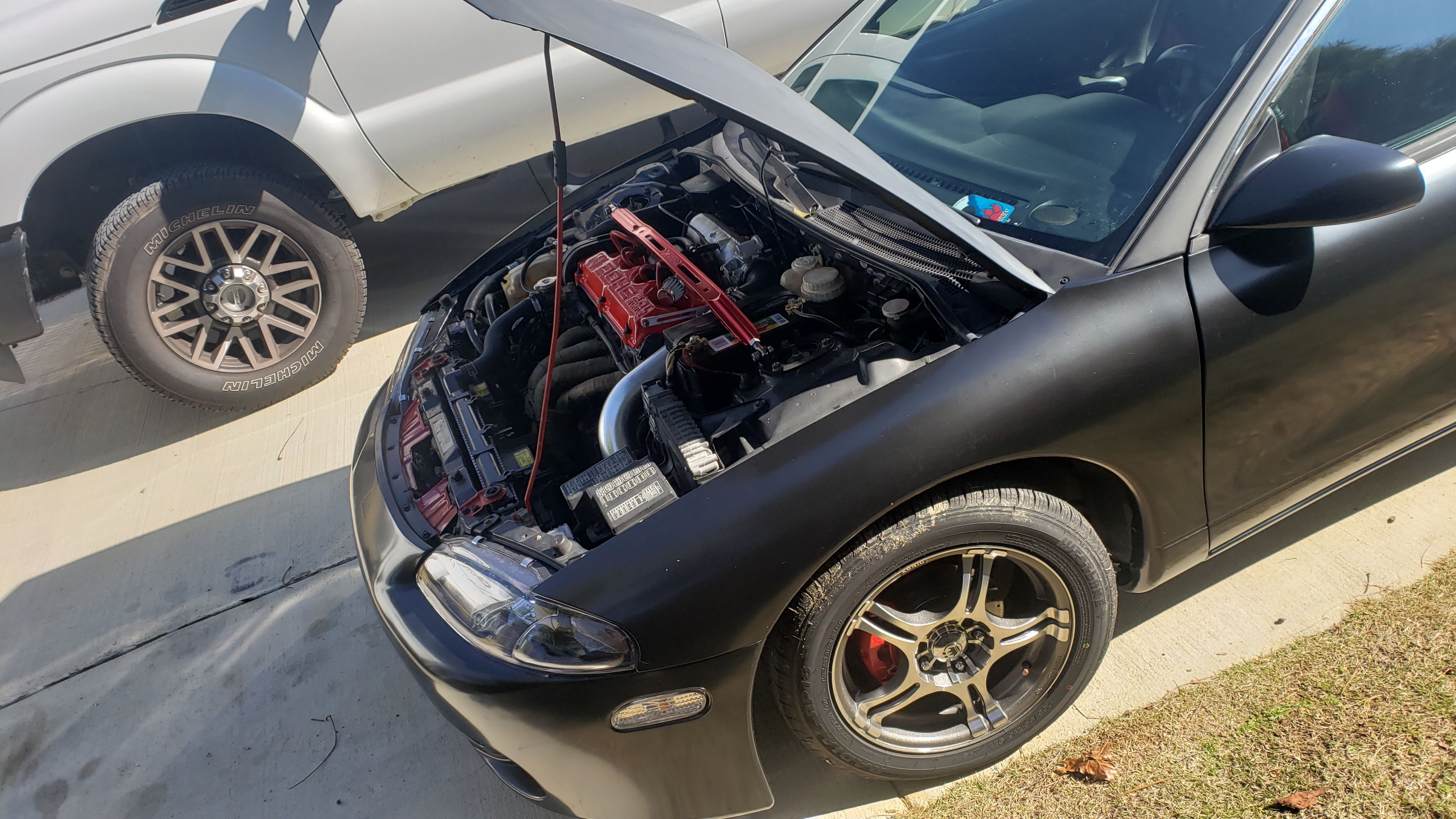

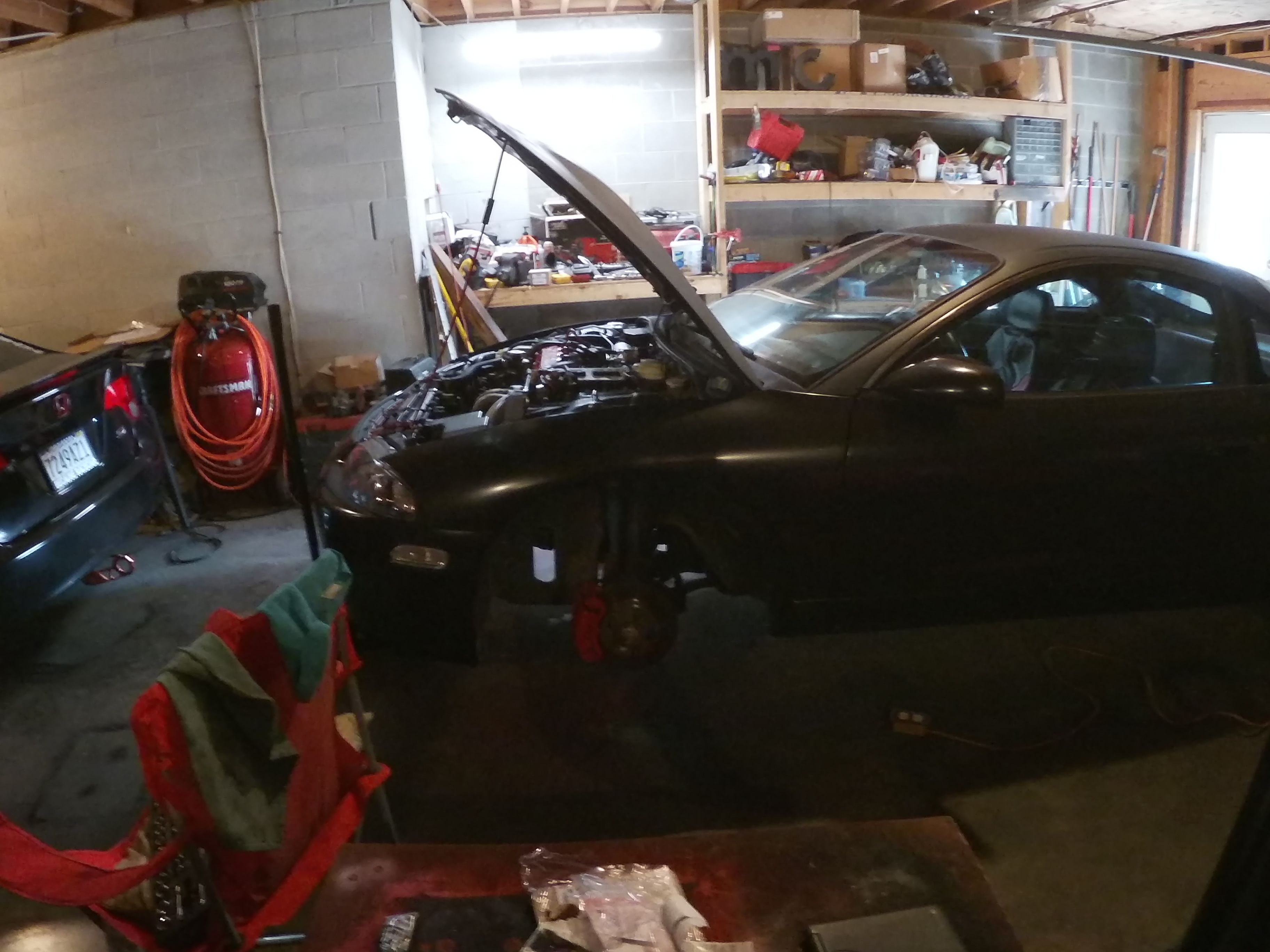

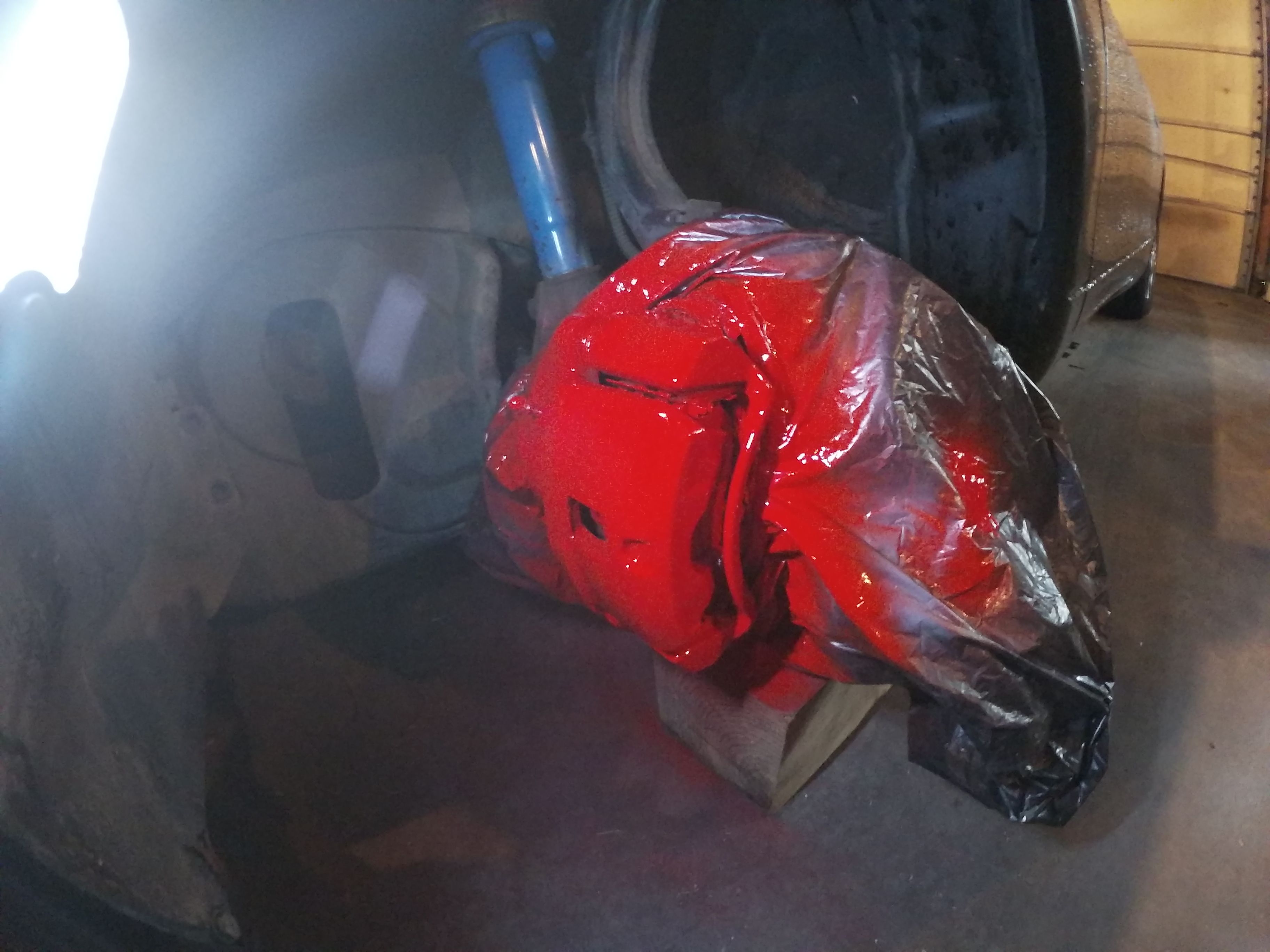

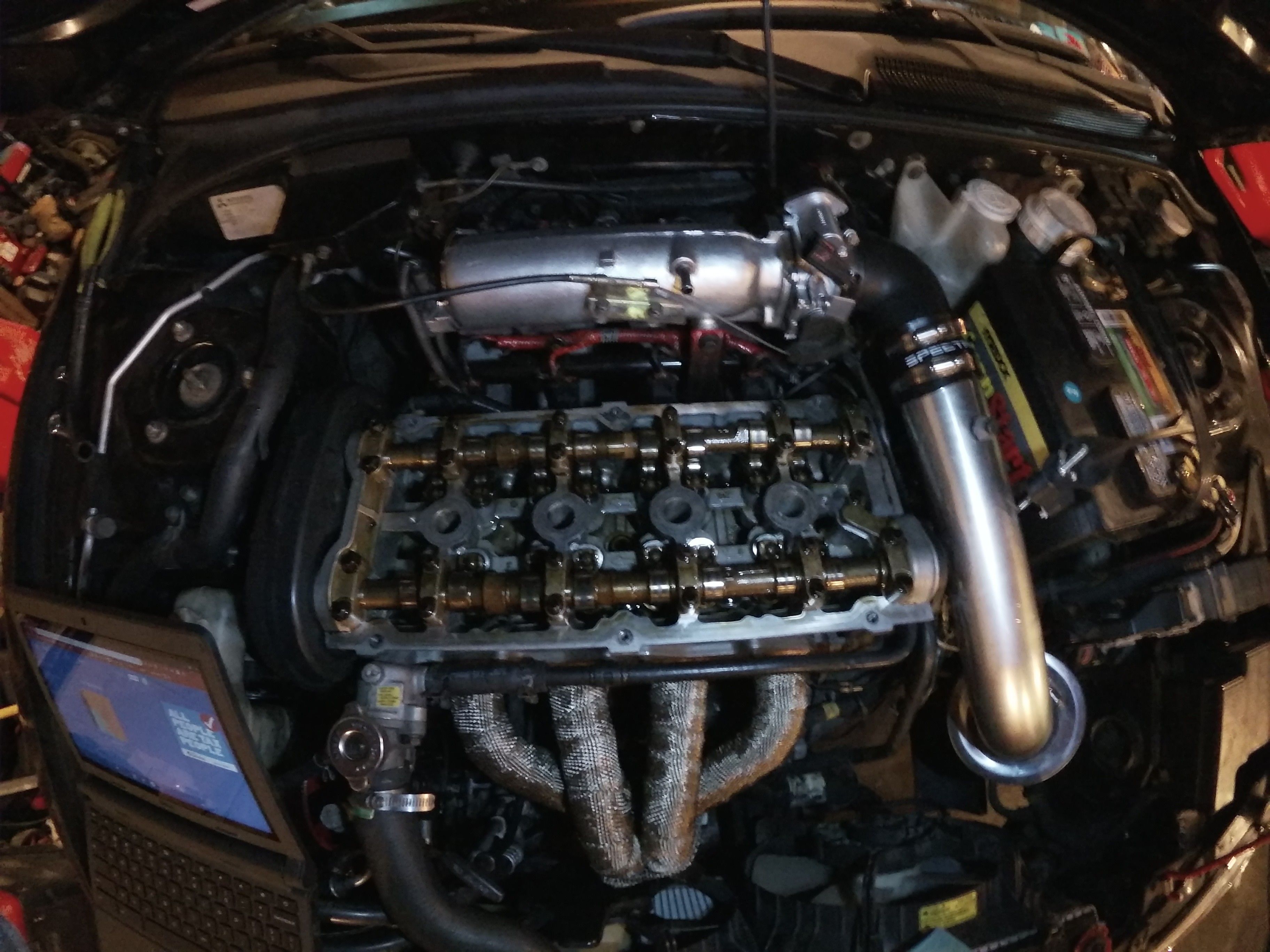

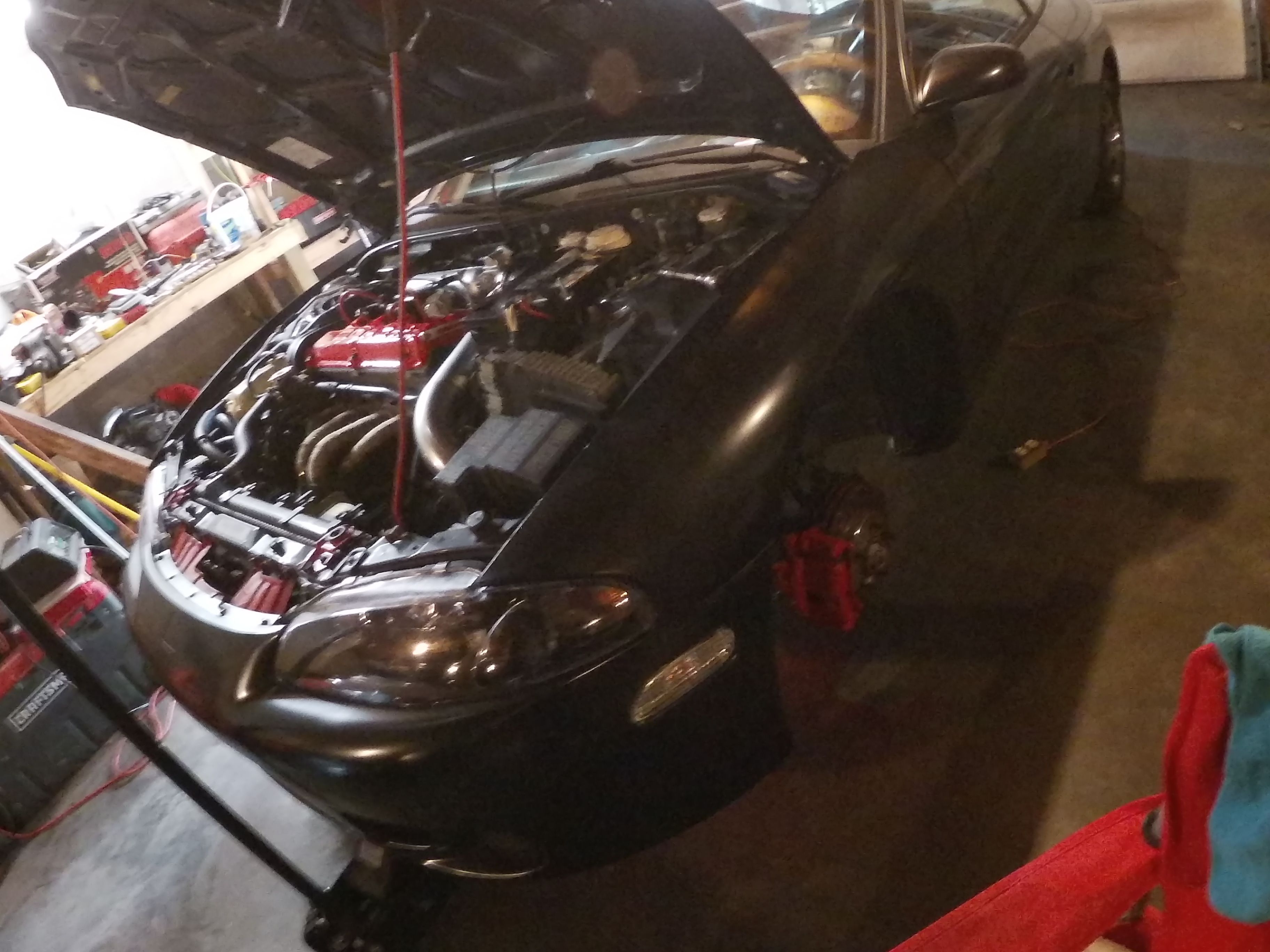

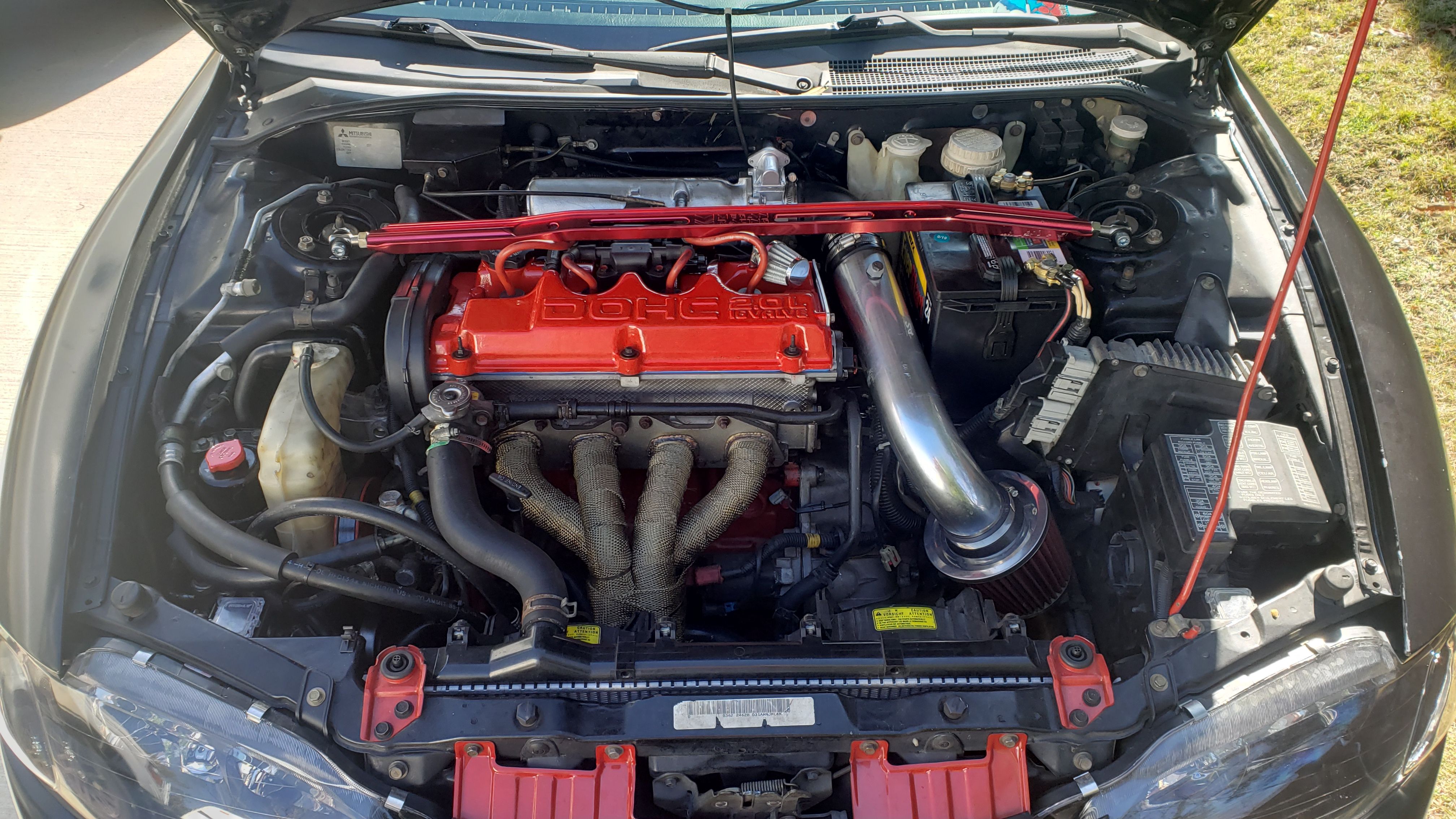

I am respraying the calipers and the valve cover, and using clear coat this time since I didn't last time and it's peeling. Also getting a new valve cover gasket, as I noticed a small leakdown AGAIN... I guess I should follow the process this time.

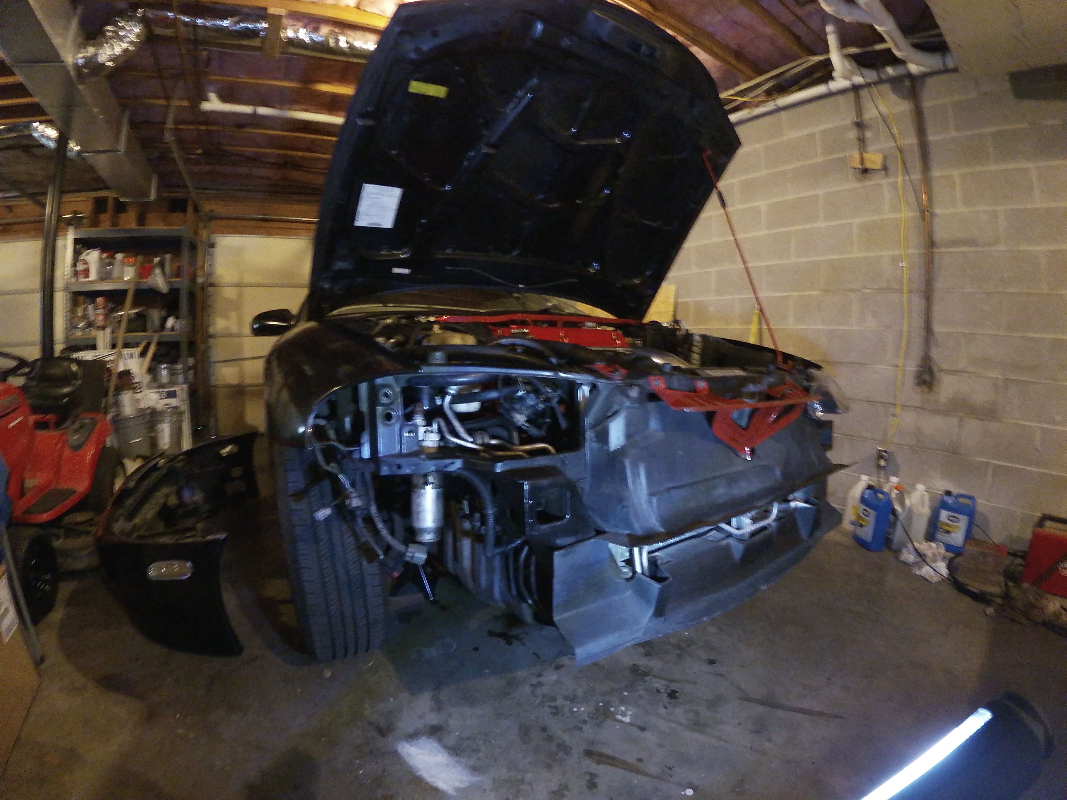

Also thinking of getting the AC lines vacuumed so that I can do a full delete. I think that should really clean up the engine bay and free up some weight/power.

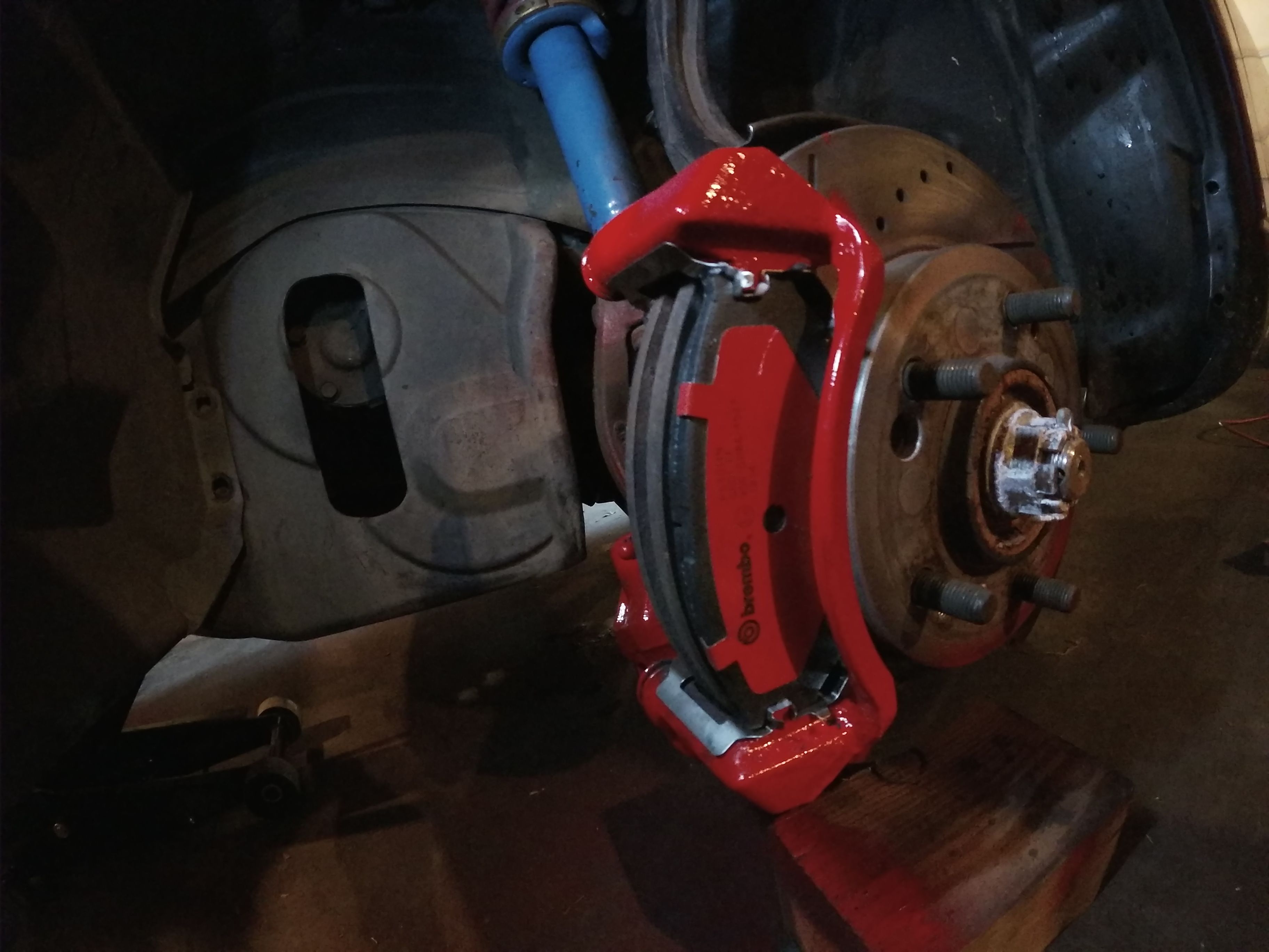

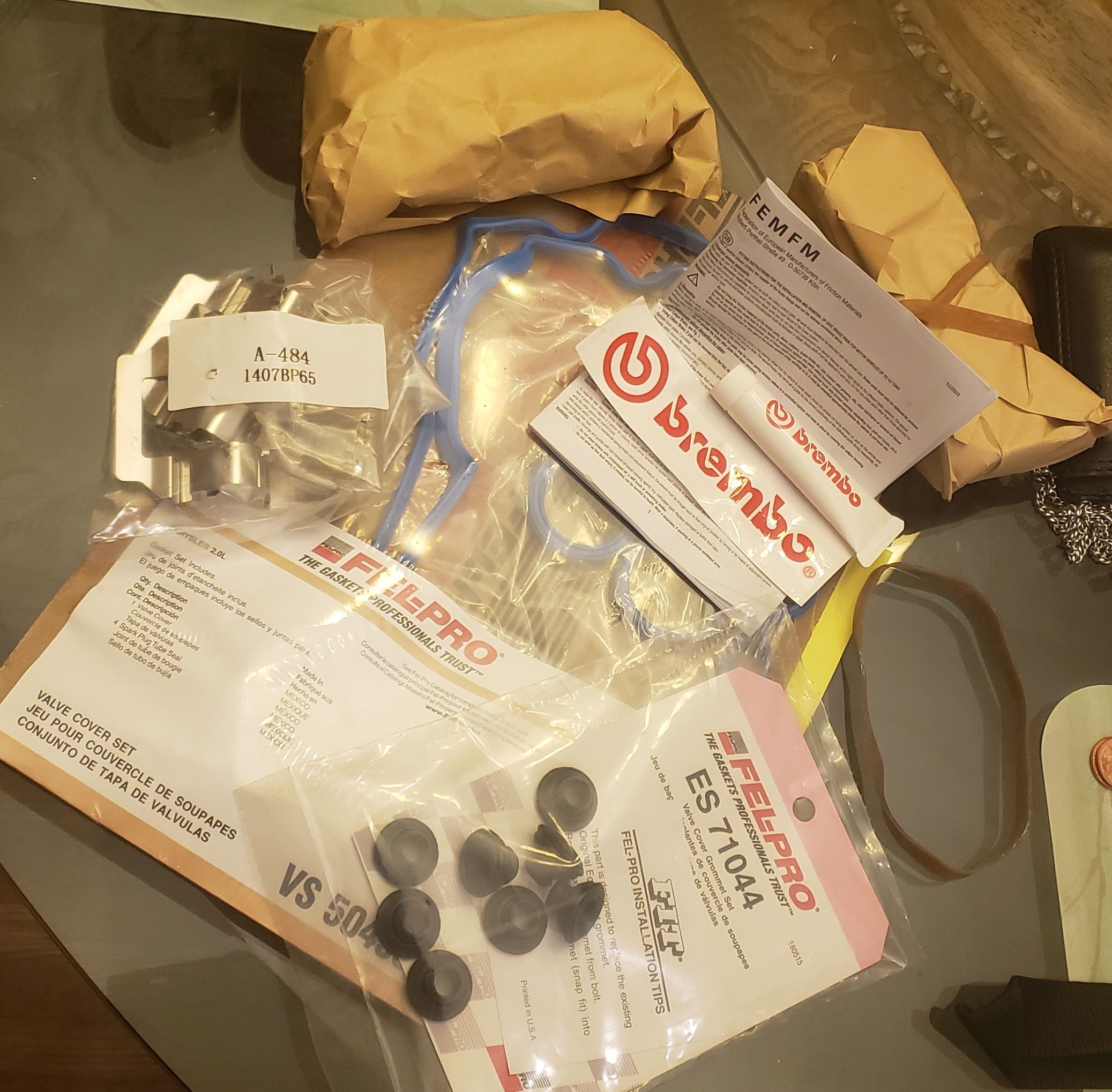

Brembo brake kit, Fel-pro VC gaskets and grommets. Going to fix a leak and increase the stopping power.
Calipers are done and drying for clear. Valve cover is drying so I can polish the letters, then clear it too.
Things would be much much easier if I had a sandblaster, but for now I'm stuck with my wire wheels and sandpaper LOL.

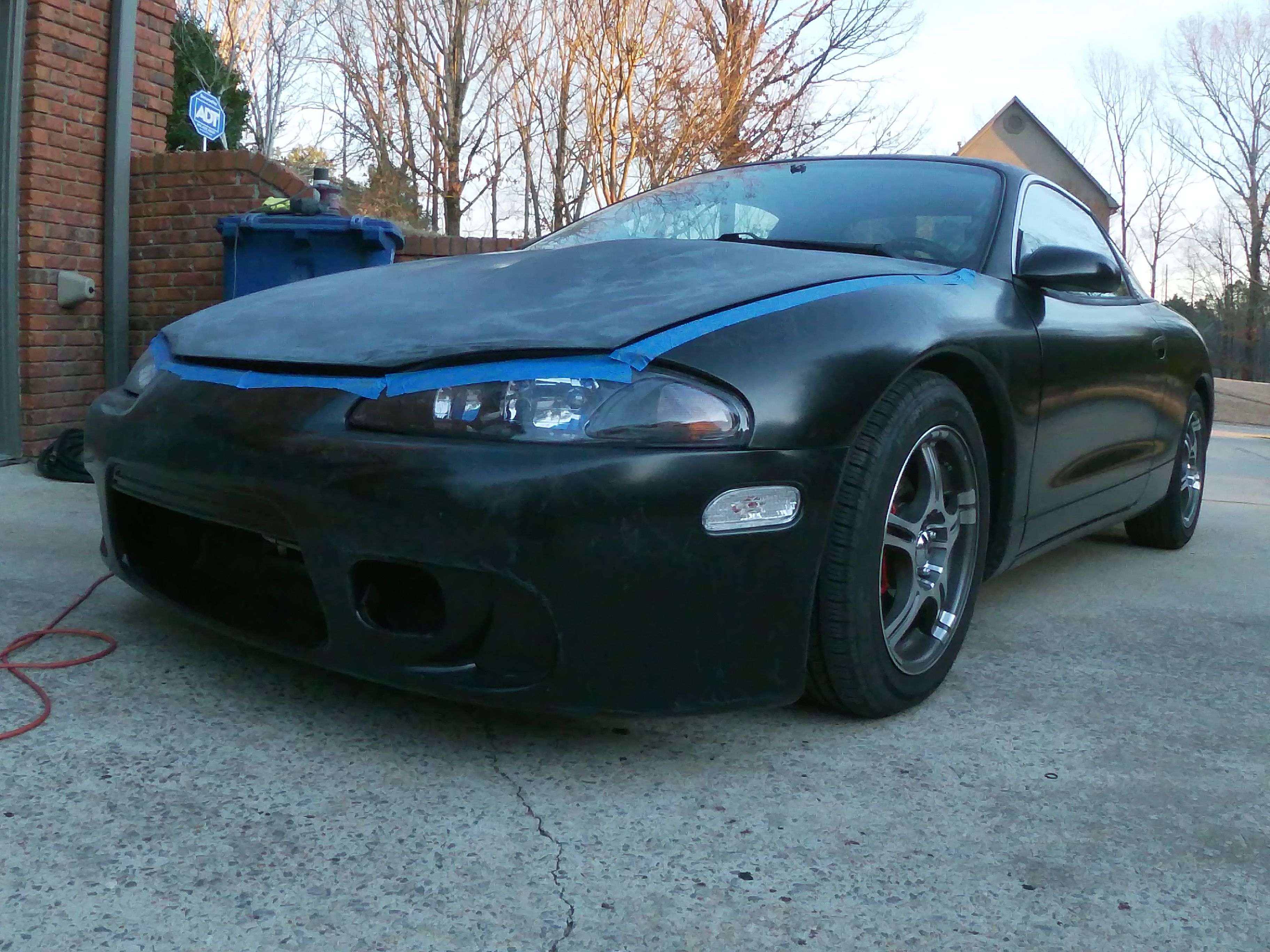

I picked up some more paint for the hood. Although it's winter, we've been having perfect painting weather here lately. The temp has been fluctuating between 30 and 70 degrees. If I can find another one of those 70 degree days that are dry I'll try to wrap up the sanding and painting.

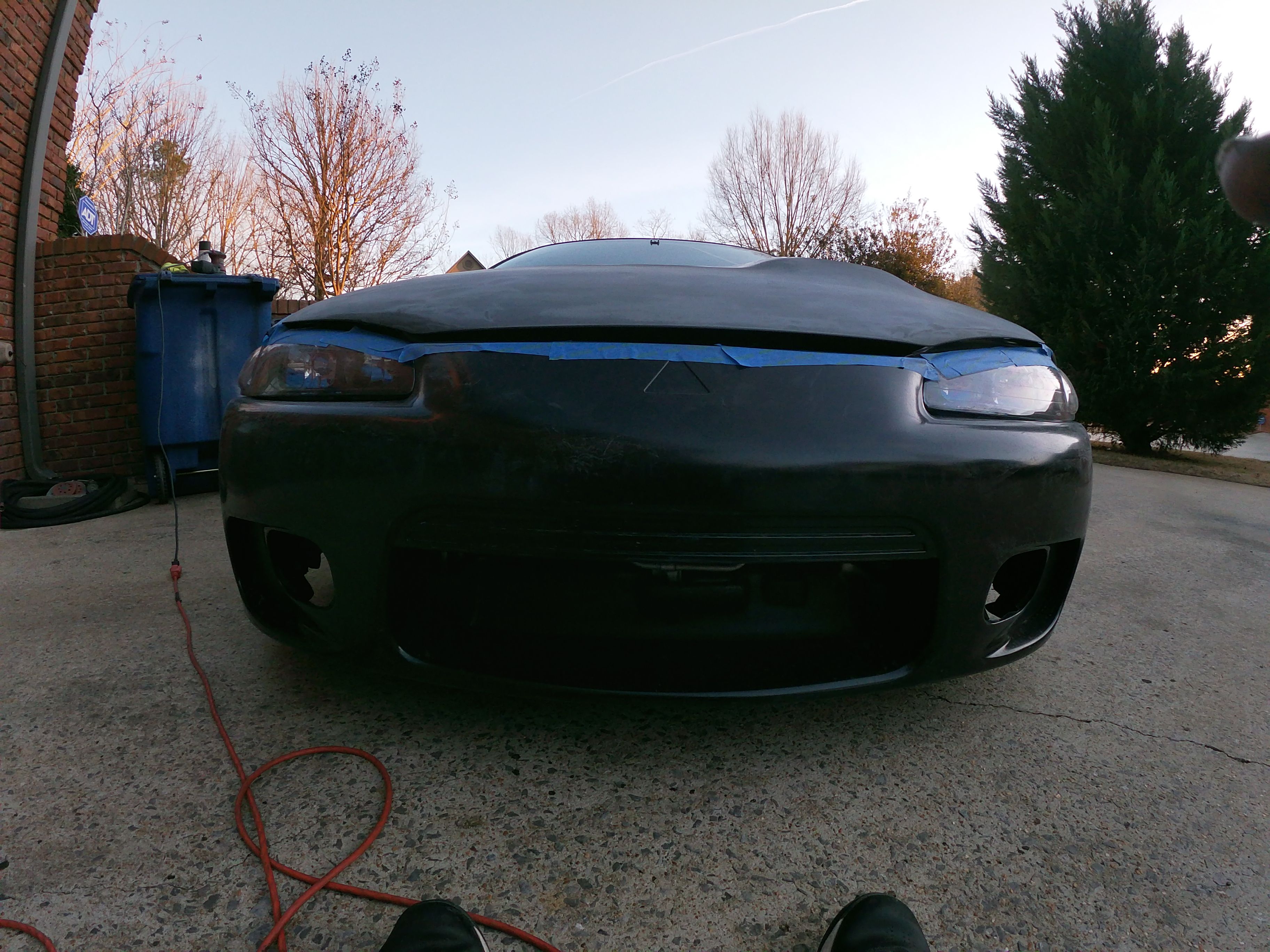

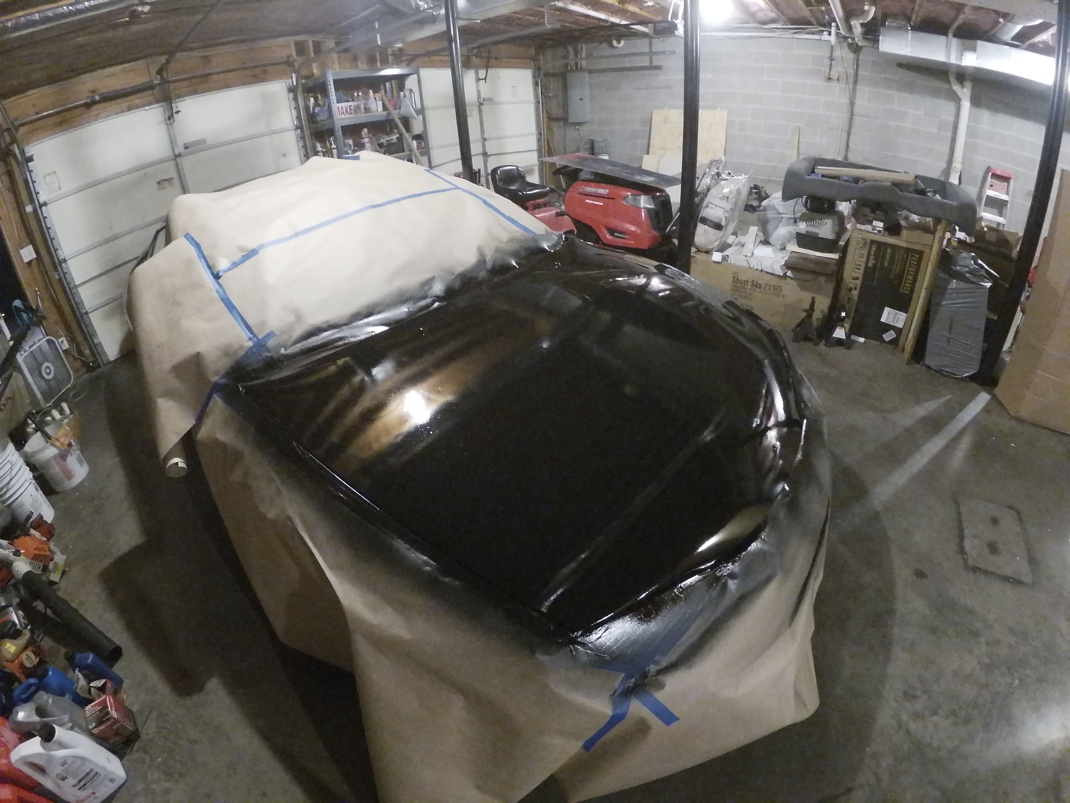

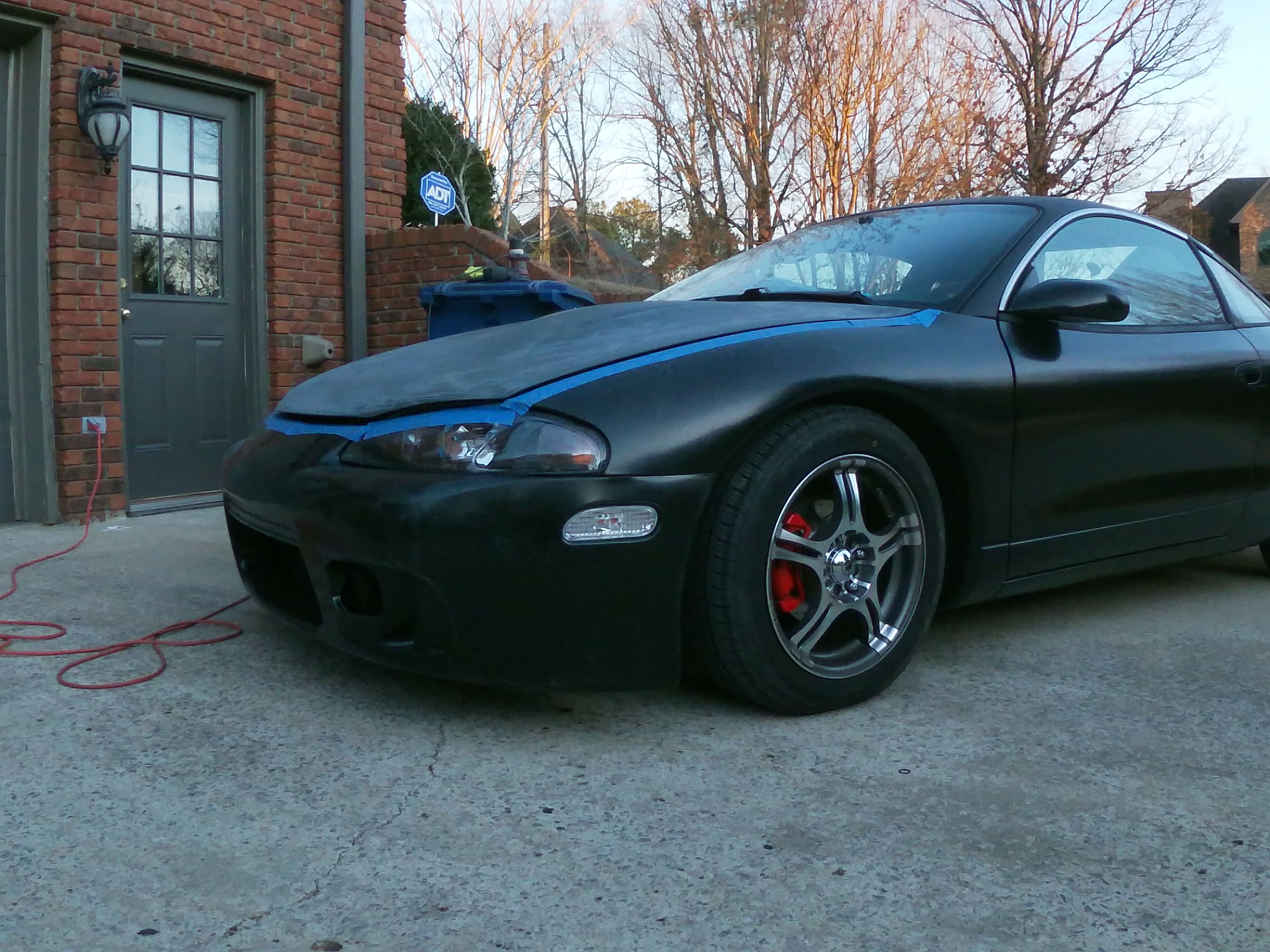

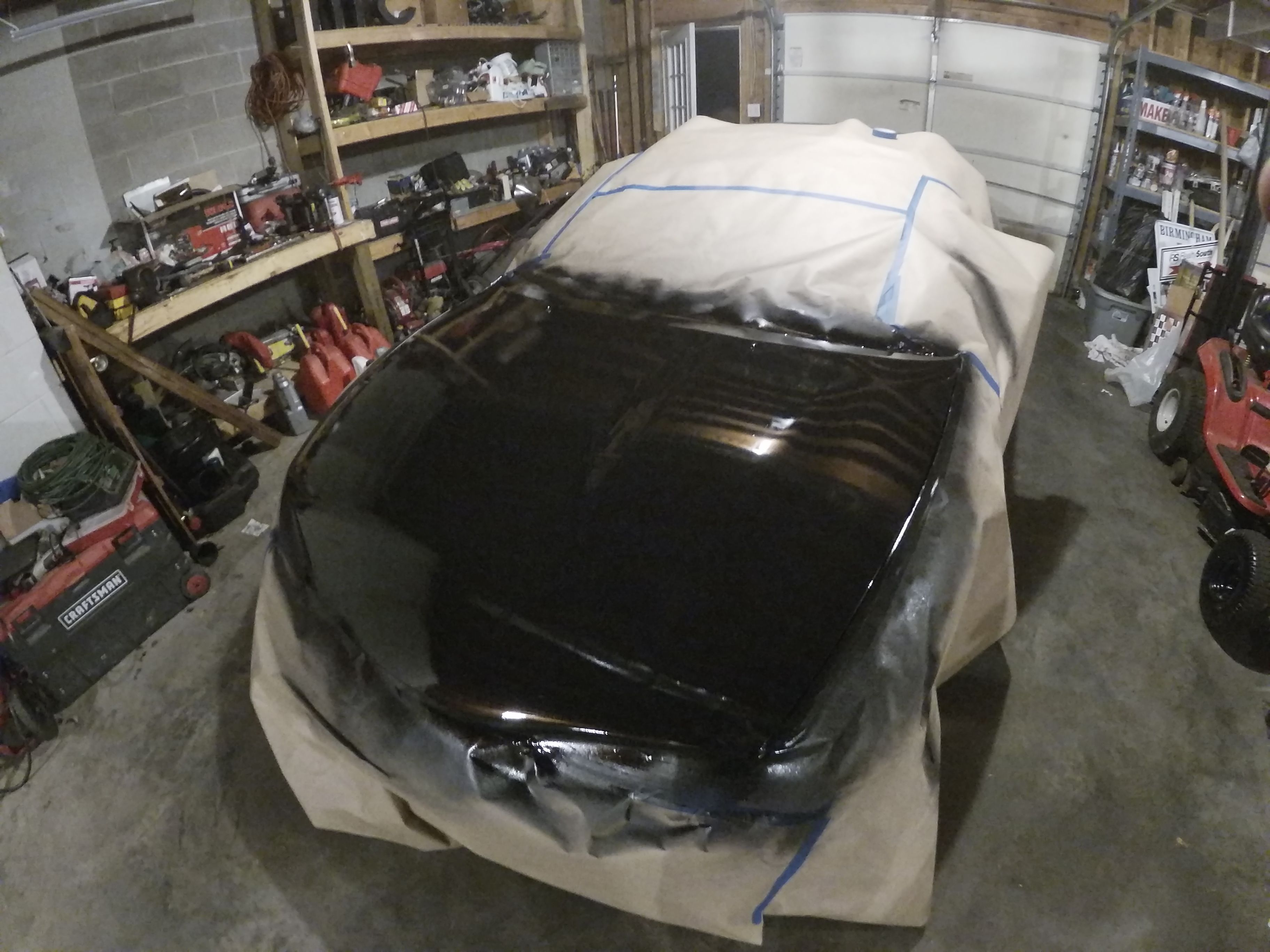

It was nearly 70 degrees today, so I got the hood painted. Typed simply, but not done simply.

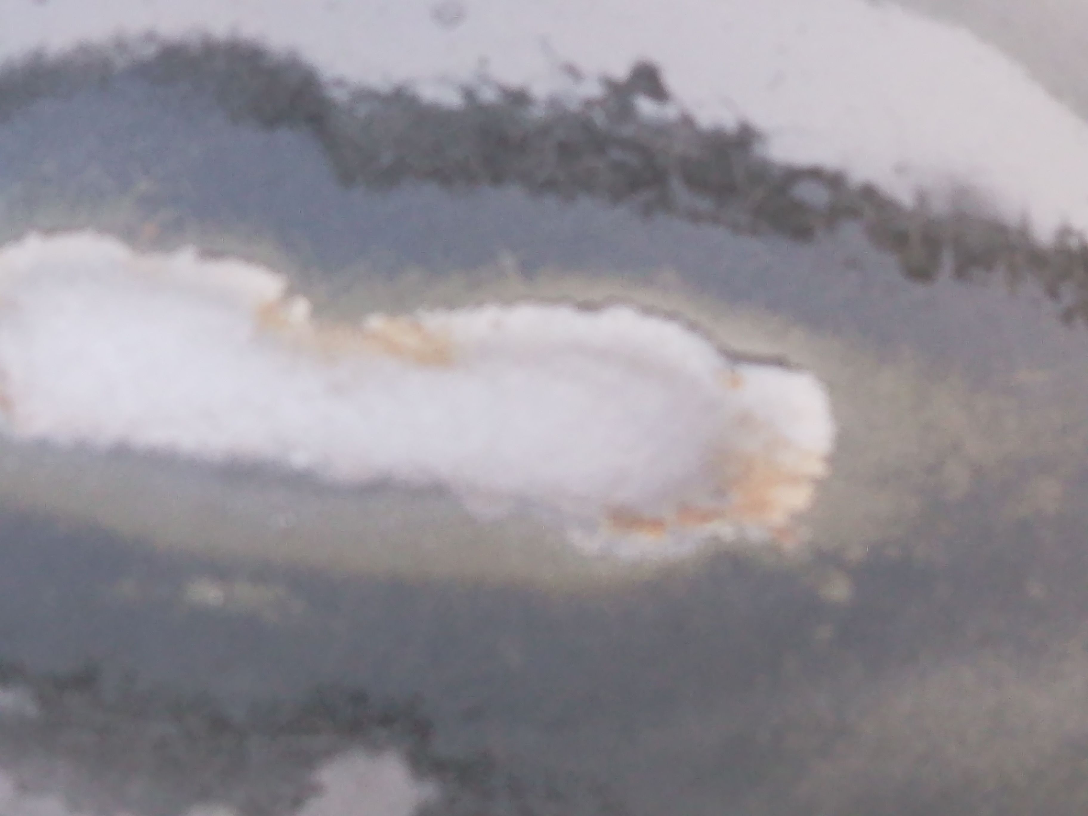

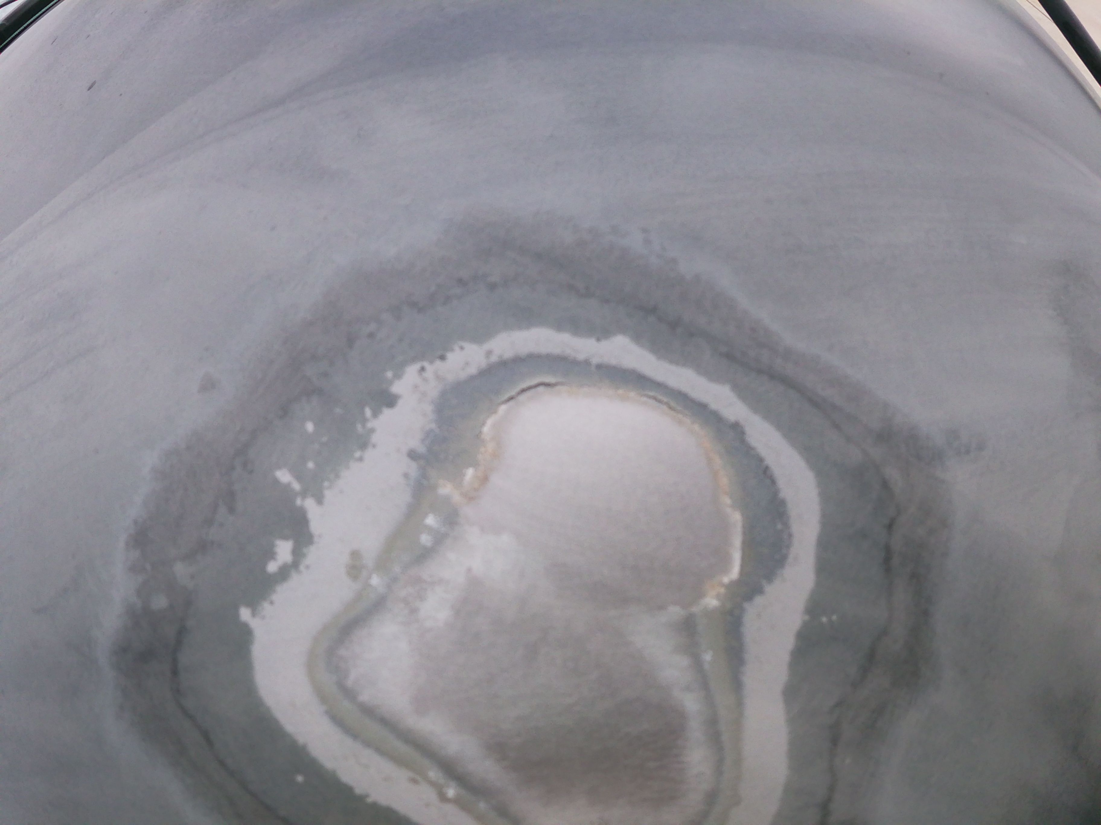

So.... I'm guessing that either my car has a factory defective paint job OR moisture has somehow made its way under the factory primer on 30% of the hood. I started sanding the bubbled up spots, and as soon as I did it just chipped right off to bare metal. And this "bare metal" was actually a rust coated metal. I was like wtf LOL. I had to sand a decent amount of the hood down to bare metal and keep sanding to get all the rust off. I got in a couple hours of sanding, at least. I also had to spray primer and wet sand that once it cured. So hopefully I'm done sanding this car forever! Here's some pics of that freaking rust. I'm still a little confused on how this happened, but I'm not stressing, it's over now. Sorry if the pics are are a little blurry, but 4k mode doesn't really work when there's sanding dust all over the place LOL.

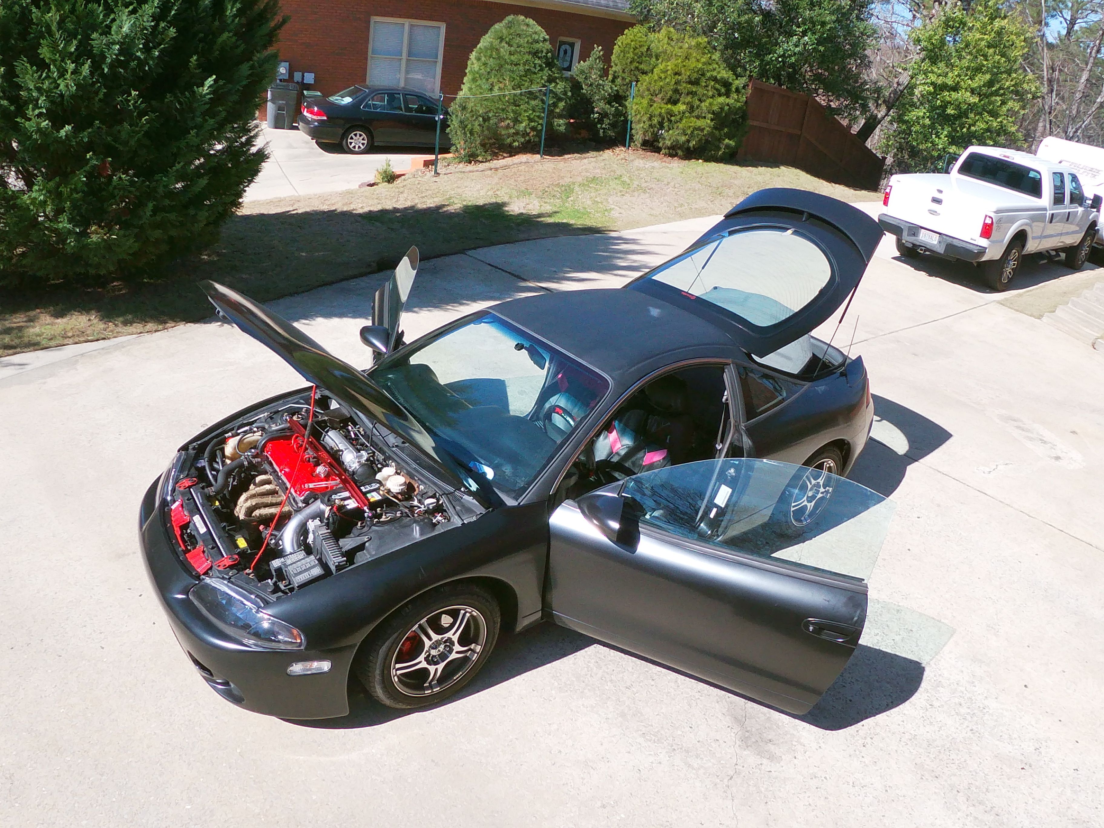

Now, that it was all prepped an ready to go... The child inside me said "take a photoshoot" ROFL.
And now that I have loaded you up with information and pictures, here is the final result. It's not as great as I had hoped for, but it works well enough for a track car.

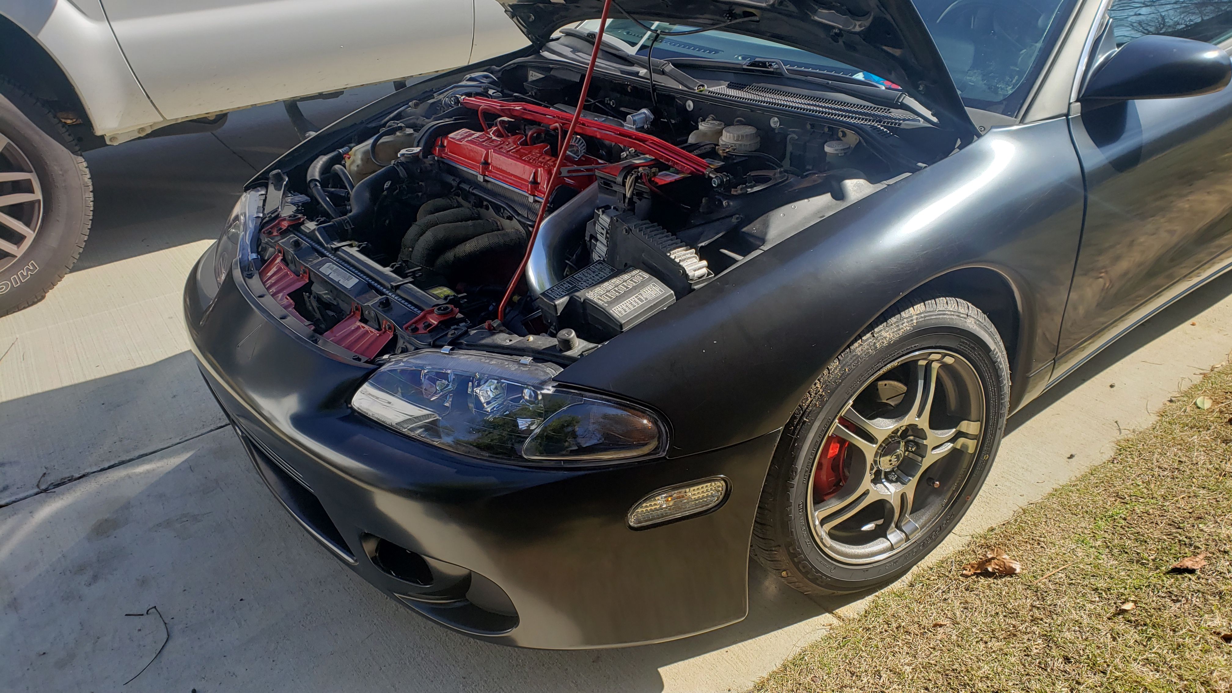

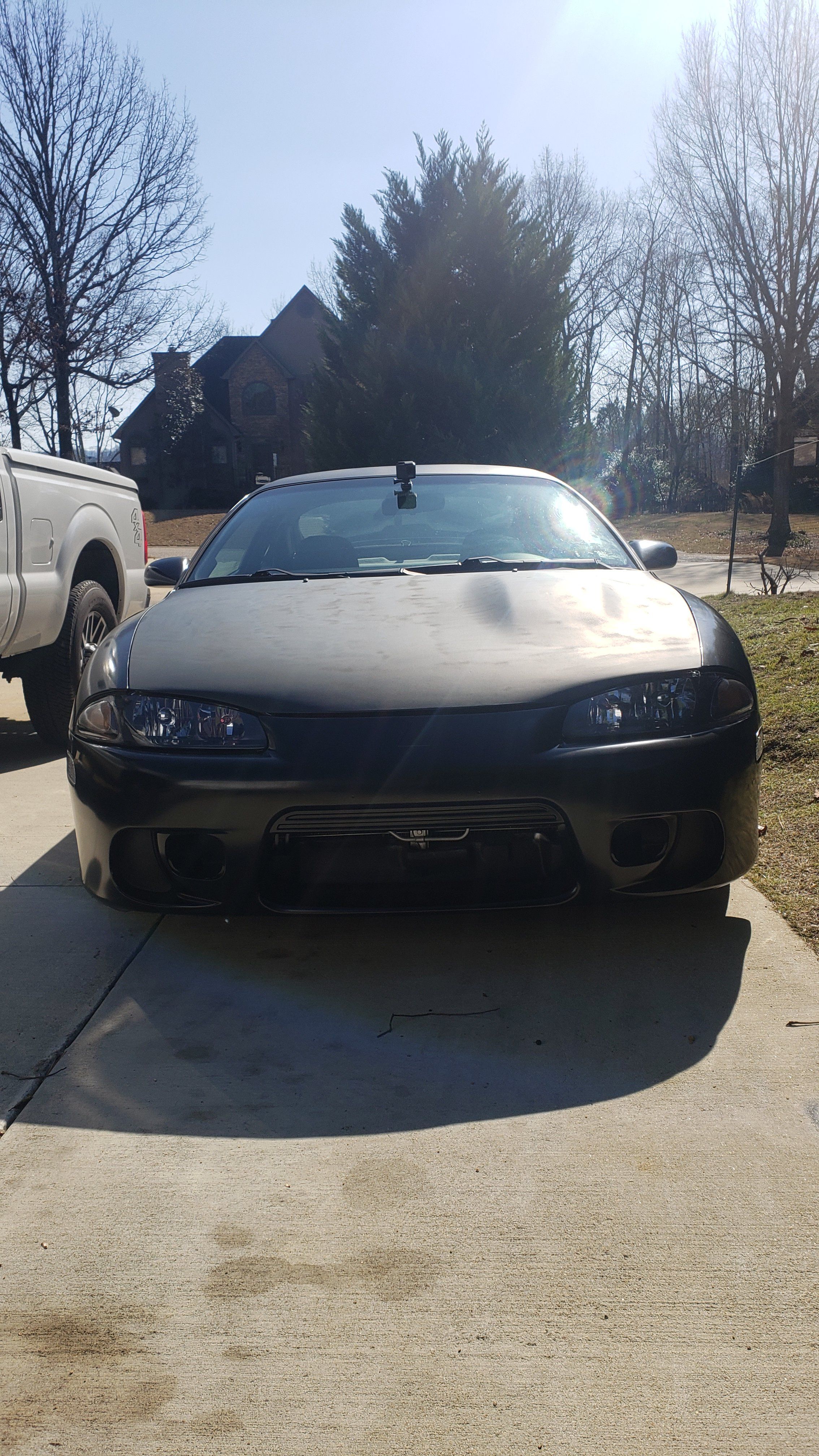

Although I've been taking a hiatus from the forums, I definitely haven't taken a break from the good ole DSM.

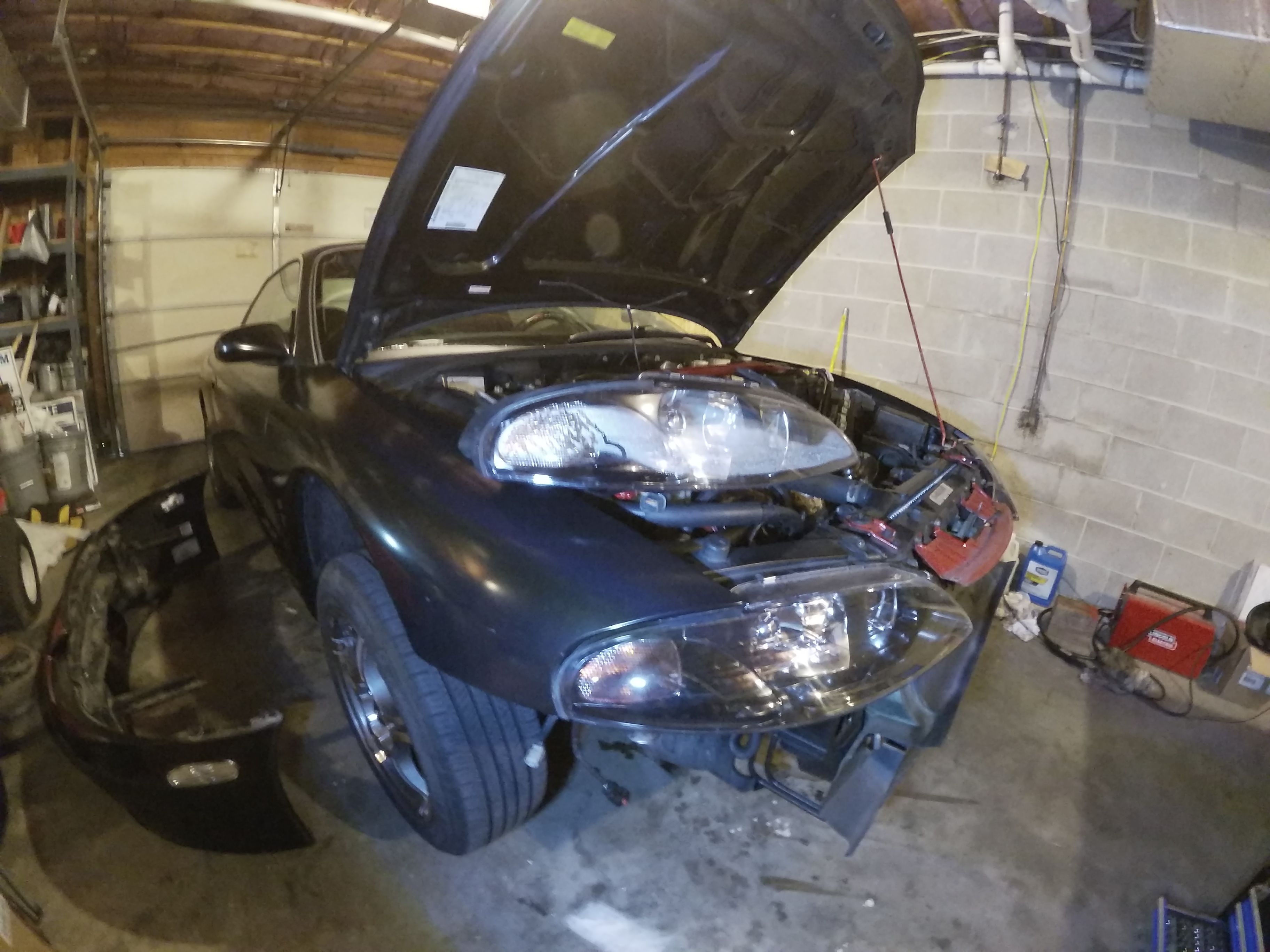

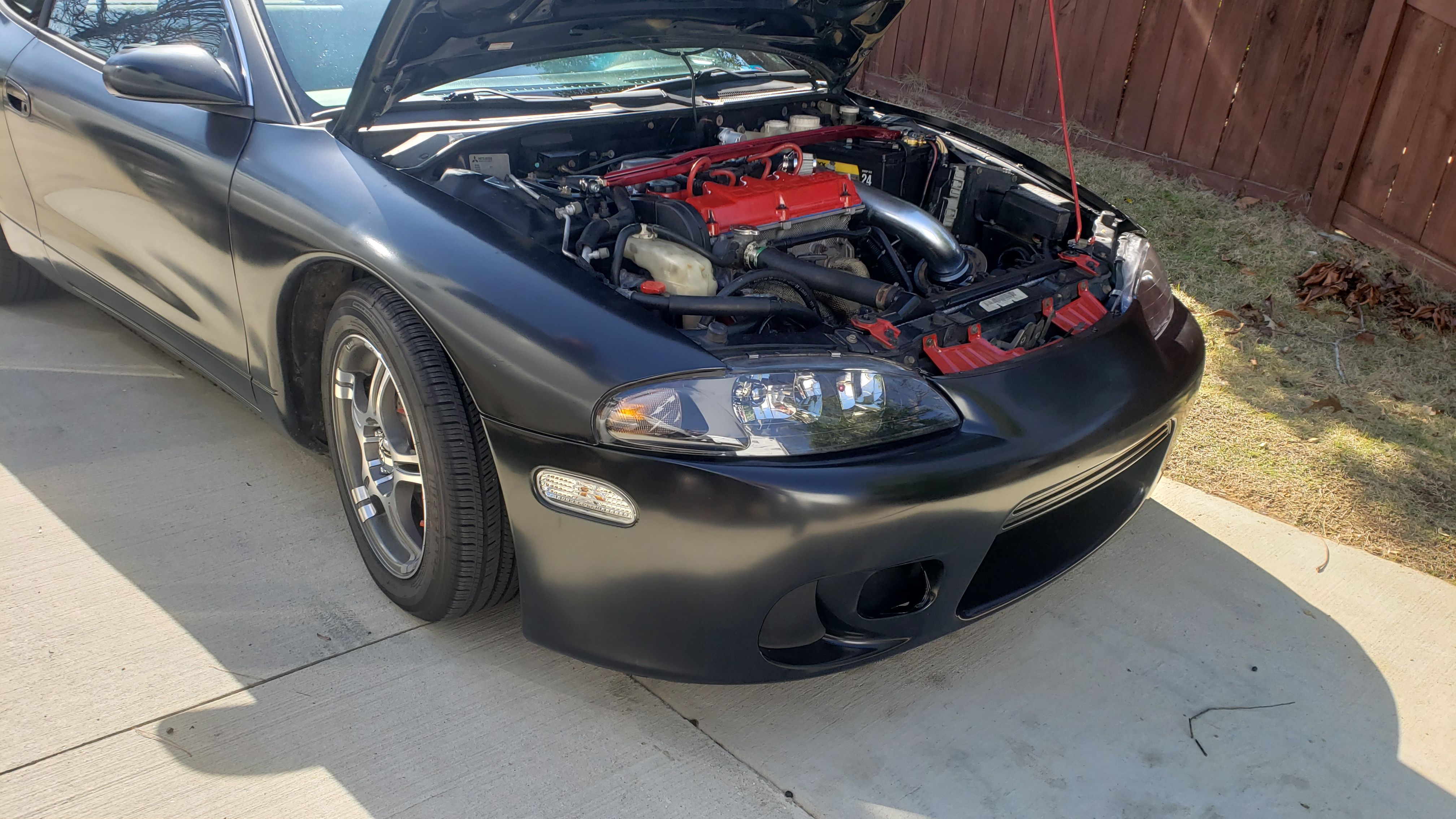

So, that cheapo Ebay headlight wasn't sealed good. It kept letting water in. That had to go.
Also I detailed it. For about 3 hours.

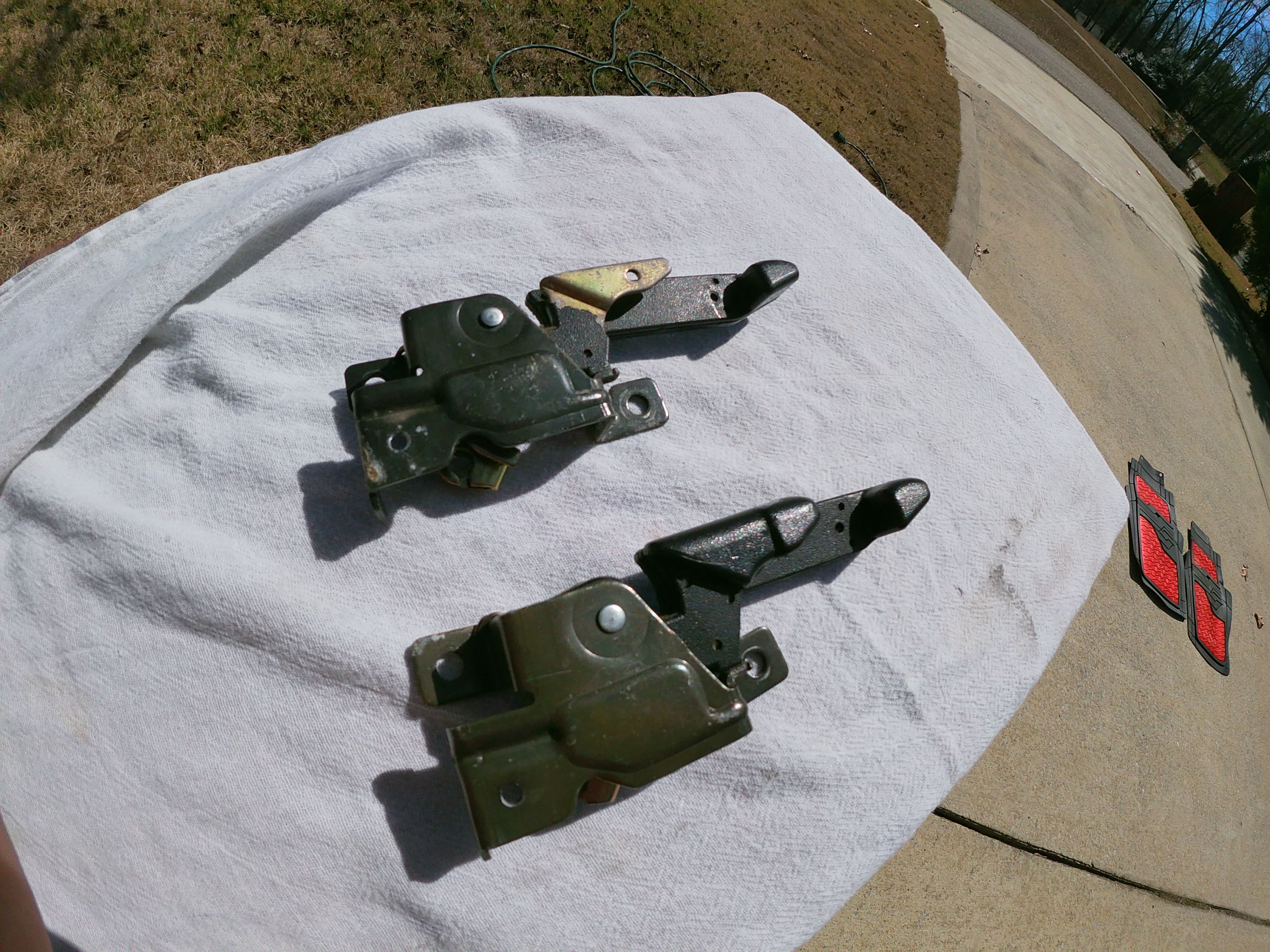

And here's something I've been meaning to do since last year LOL. I picked up this new lever at the yard since mine was broken. Took me forever to get it on, and only took 5 minutes.
I have to replace that same lever. Lol. Car looks great! Where did you end up buying your headlights if you don't mind me asking?
Why didn't you just go back to oem lights? Plenty of people parting out cars these days
It's hard to find a stock set in good condition. And even if I found them the shipping would drive the cost higher than a new set.
I tried wet sanding and polishing my old set but they slowly faded again. The ones I have now look great and fit well. So I'm satisfied.
