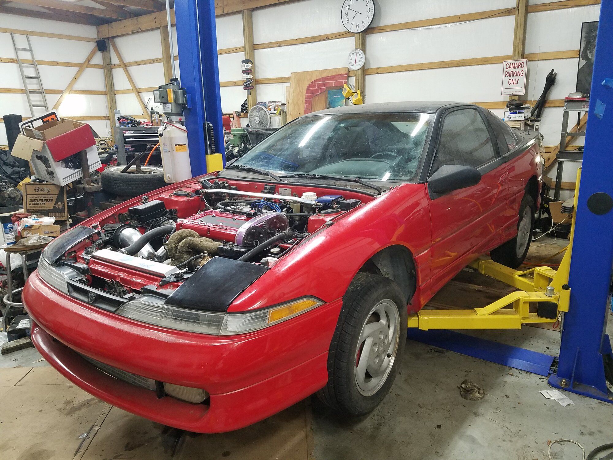

1990 Eagle Talon TSI trying to save her life from the previous owner and its alot of work but a nice base car. My youngest son, who also races this car has nicknamed her "The Red Baron".

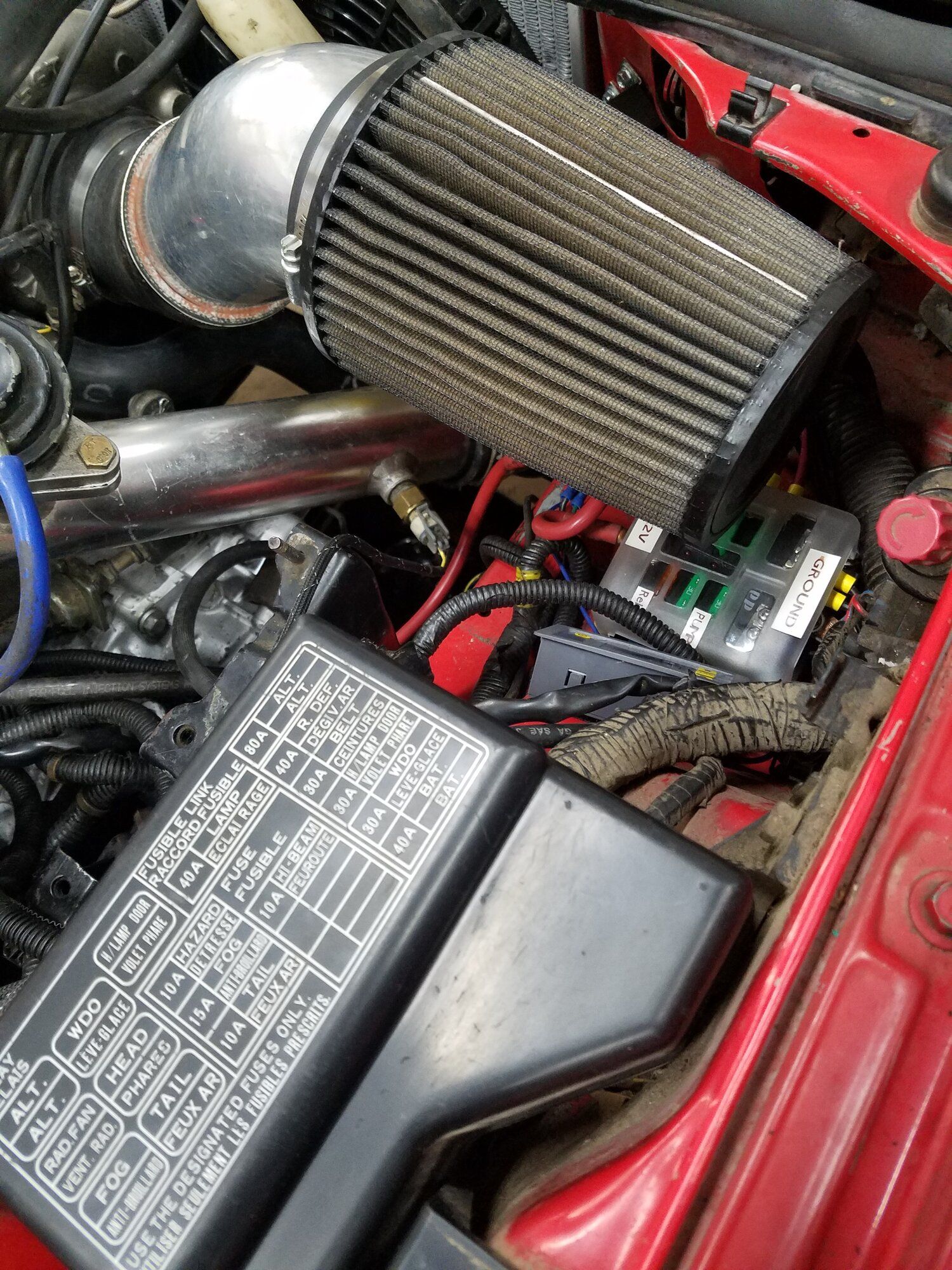

Regular 1g 1990 coil. It ALWAYS just laid around in the engine bay so I decided it was way past time to mount it. A 1990 coil has an extra "tacho" module on it but I was able to mount it UP using one of the stock tabs and a boss on the manifold. A normal EvoIII coil bracket faces the coil sideways. I have seen some coils mounted in the up position but I don't like the wires going up into the hood.

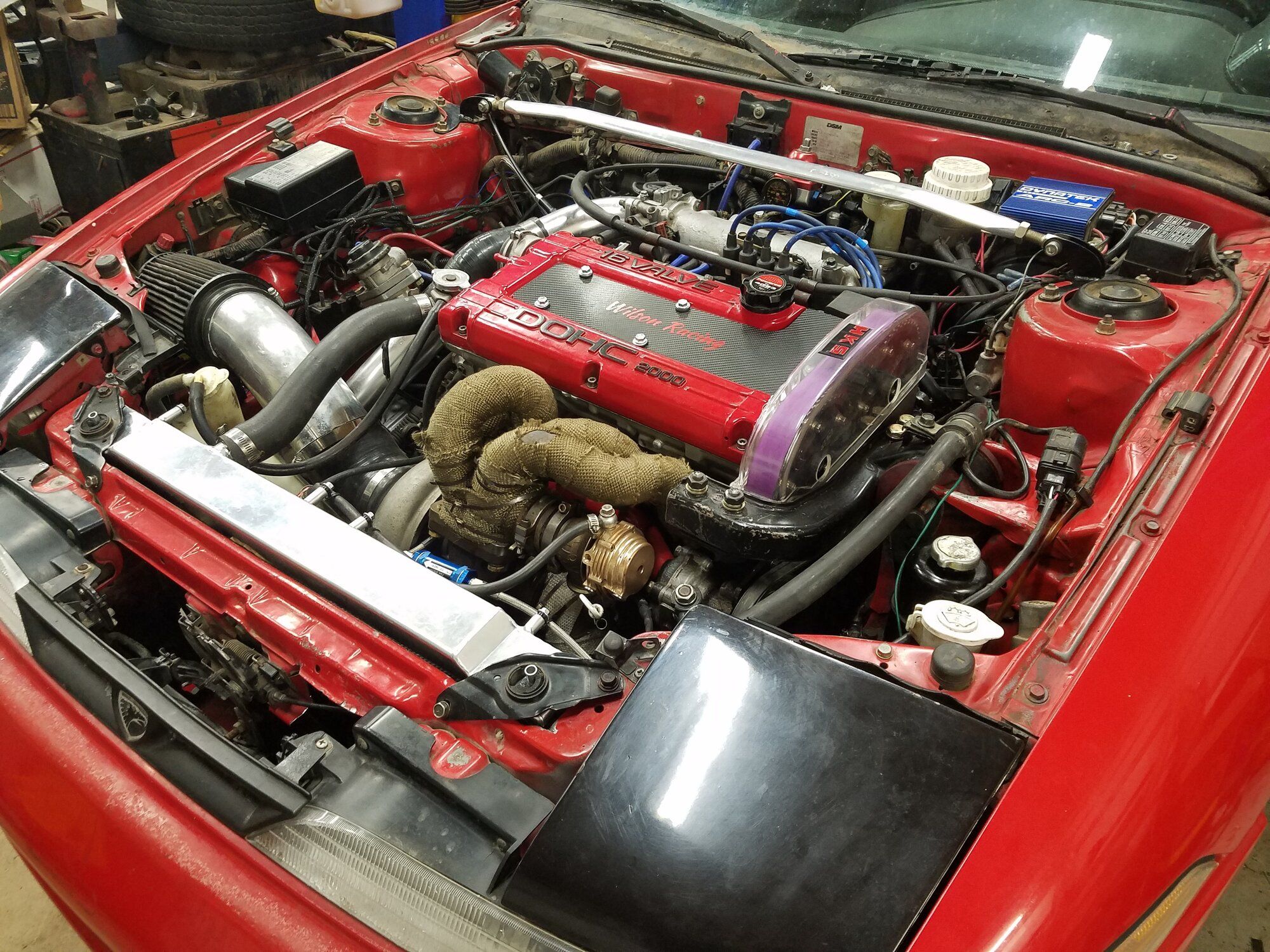

Well the car DOES START!!!
I tried for about 10 minutes to prime the engine. I even used a oiler to push oil down the turbo feed and into the pump to help.....still no pressure. My son said "well we could start it and see if it picks up" so I agreed, reluctantly, but by God it fired and made pressure so YA!!!!
It is running on cylinders 1 and 3. 2 and 4 are dead so I will be checking plugs and wires. I did put a few squirts of oil in each cylinder so maybe just fouled plugs but when is a DSM issue ever that easy to fix???

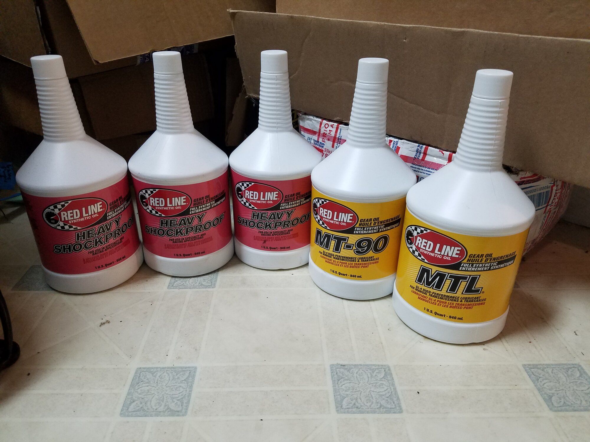

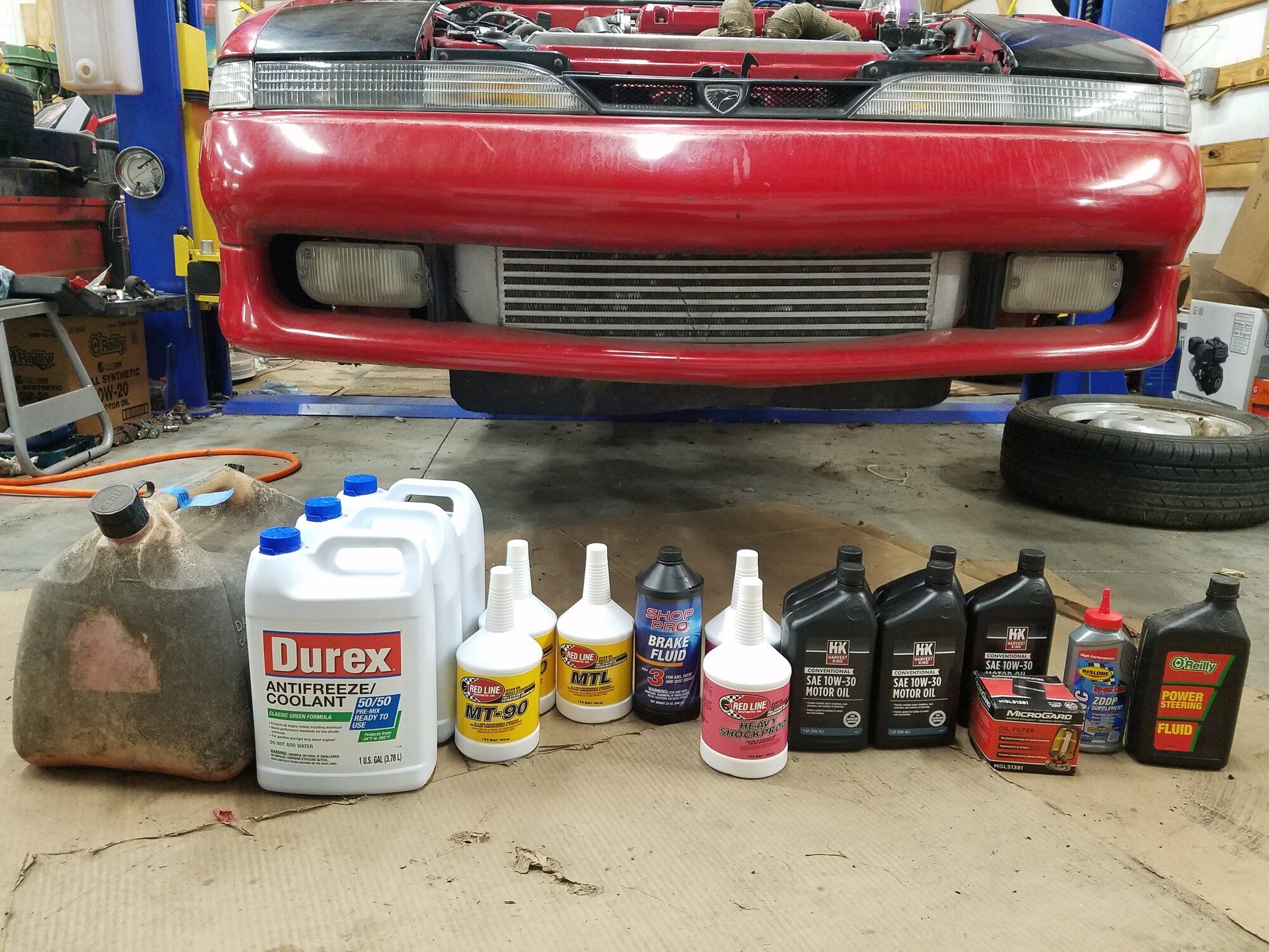

I took pictures of all of the fluids we put in yesterday so here is a shot :)
That took a good hour and a half.
She wasn't dry but I put in a different transfer case and it was along with the trans that I tried to fix and hope it is. Motor was dry too. Only thing left with fluid was the rear dif. It still had Redline HD Shock but I replaced all of it.
Clutch Master and Brake Master all got fresh fluid along with the Power Steering system, which we put new orings on also. :thumb:

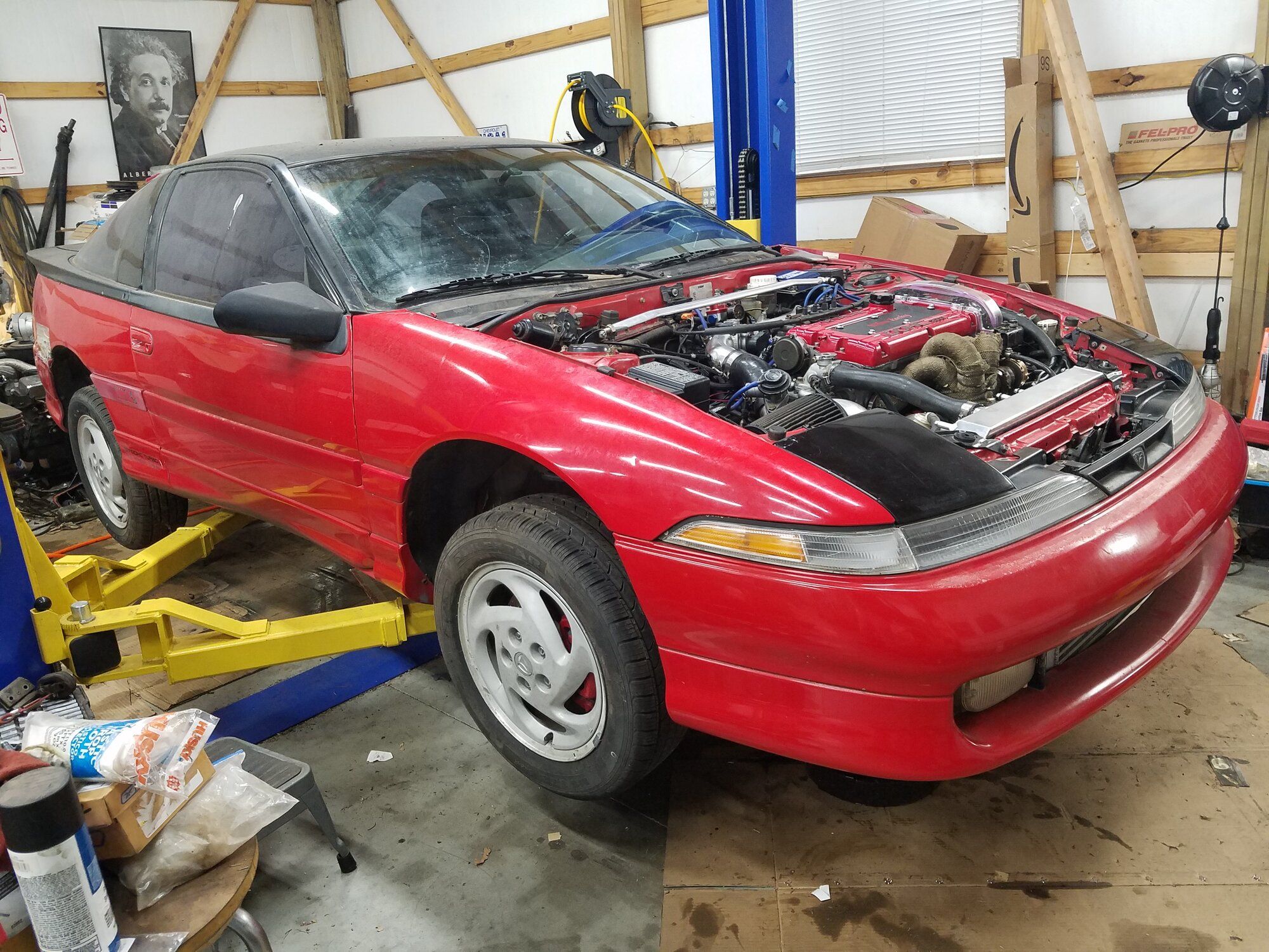

The belts are tight, the wheels are on and the twin disk has been tested while it was on the lift w/o wheels. Noisy but works!

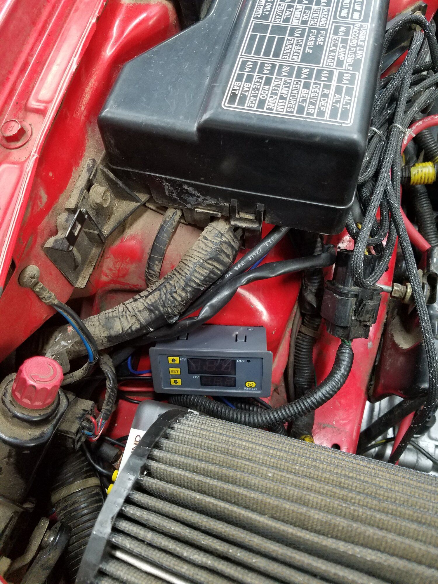

Fan timer mounted and wired up. Wheels on. Belts tight. Fluids good. Clutch check went fine.

What's the fan timer do?
I have another video coming to show it Vegas. It does like Sean said, I hit the key and it delays the fans coming on immediately when I am trying to start the car. Works especially good when your car is HOT and you pull over to let her cool down then the very 1st things that come on when you go to restart it is those dual, 20 amp VAMPIRES, sucking the amps out of the battery.
I'll get the demo posted up soon. :thumb:
I just interrupt the ground to the temp sensor and hold it for 15 seconds before it activates the fan relays, if they are demanded on by the temp sensor. If the temp sensor doesn't say to start the fans then nothing out of the normal happens. :)

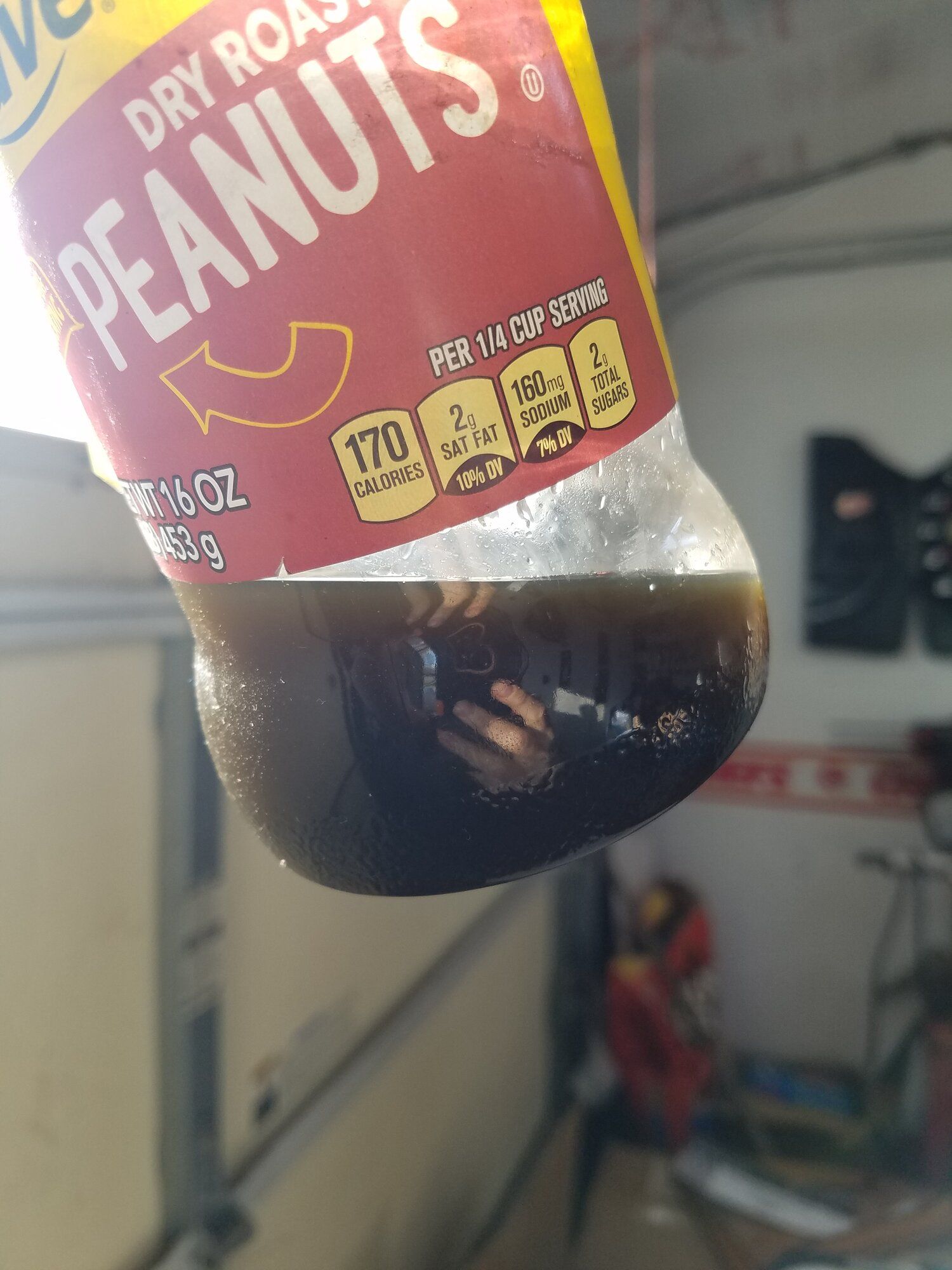

The clutch was noisy when I tested to see if I could put it into gear, but only sounded like twin disks floating while disengaged. I was able to spin all 4 hubs while it was on the lift so I made sure while my foot was on the floor, that I could get the trans into all forward gears and I was able to do that. I only let the clutch out in first to turn those rusty rotors a few spins. I put it back into neutral and things were "normal" (no odd sounds anyway). I have never ran a twin disk clutch but I think they are either engaged or not. You will all be surprised WHY I was testing the clutch. It wasn't really THAT I was testing, it was the clutch HYDRAULICS. The old slave had pushed its plunger out of the bore and fluid was everywhere when I noticed it after moving the car from the yard to the shop. My helper may have accidentally touched the clutch pedal when we move her. Anyway, I only cleaned out the 30 year old fluid from the slave and master (it was BLACK) and washed out the bore of the slave with brake parts cleaner, tipped the cylinder UP and filled it full of new fluid, reinserted the plunger after I lubed and cleaned its seal and pushed it down into the bore. I cracked the bleeder to get the plunger back in and down into the bore and thought "I wonder if it will work again..???" Well....it does. We got a bit of air out of the system but it functions good enough to work that 3200# twin so I say it is just fine (mind you I have all new components for the clutch hydraulics in stock but there wasn't anything wrong with the old one when the car went down). That is why I tested the clutch ;).

Ps: Here is a picture of the nasty clutch fluid. It looks like Coca Cola! OMG
