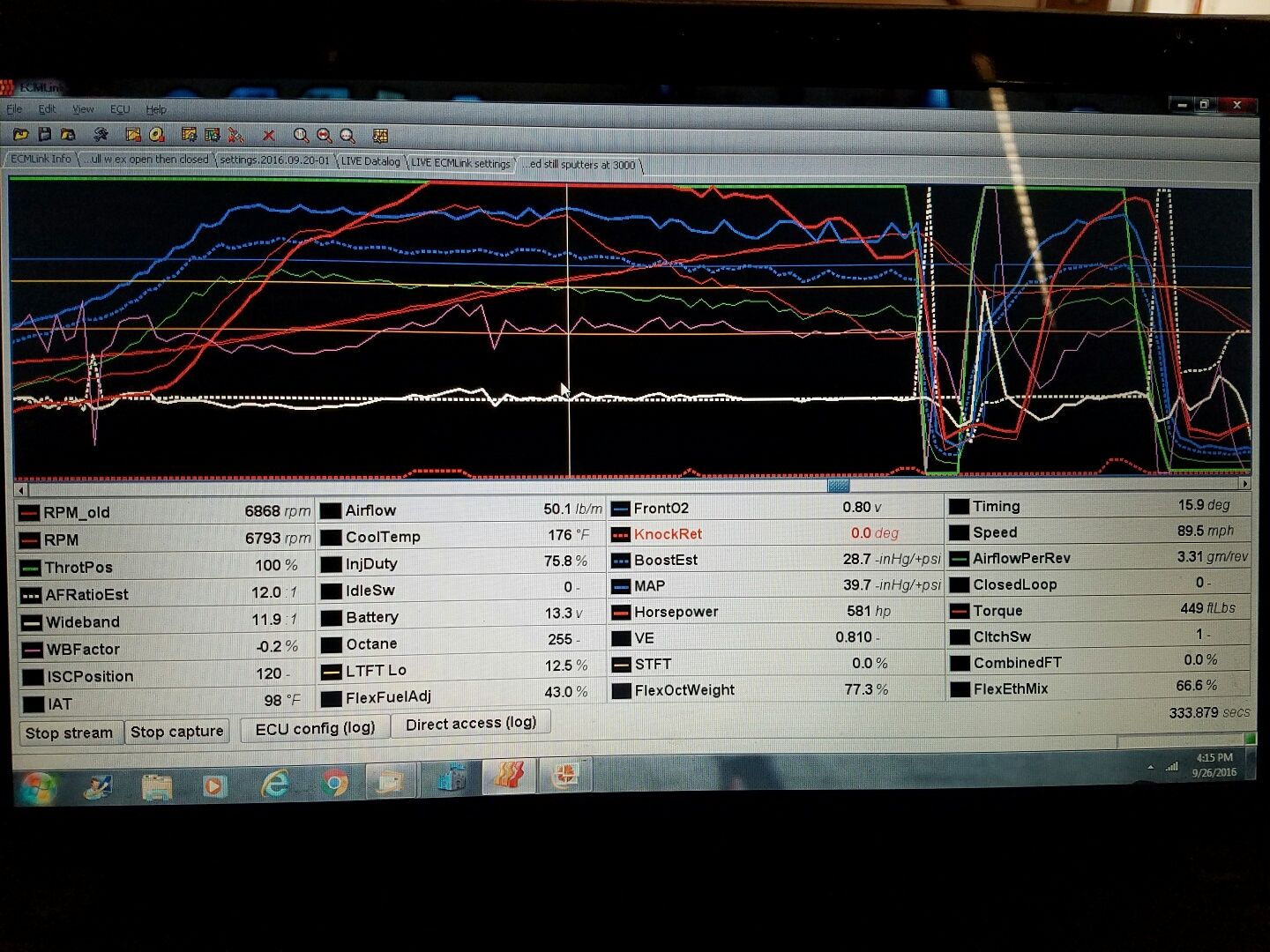

The 61.7% ethanol in your log - is there still some gasoline in there from the goo recovery, or is that just what your winter E85 is right now?
Different car from the ethanol goo. This is just our winter and maybe summer blend. It was a dry tank to begin with and I have put 11 gallons of straight E from the pump in her. You will find some tuners claim not any knock difference after 50% or so. I would like to have higher E content, but what I can get is working. :thumb:
Yeah English Racing told me they can usually tune all-in on 60%. So that I'm ok with, I was mostly just curious to know if you were finding variable amounts of E in your E85 there. Thanks for the info!
I only have ONE STATION to get my ethanol at so I have to use them. I pass by that place twice a day for work luckily for me. It's a 20 mile drive if I take my car. I'd rather have E85 for sure.
I would agree with that. Once you hit 60% or so, you're gonna max out the setup. I prefer to keep it at about e60 for that reason and to help keep the goo down.

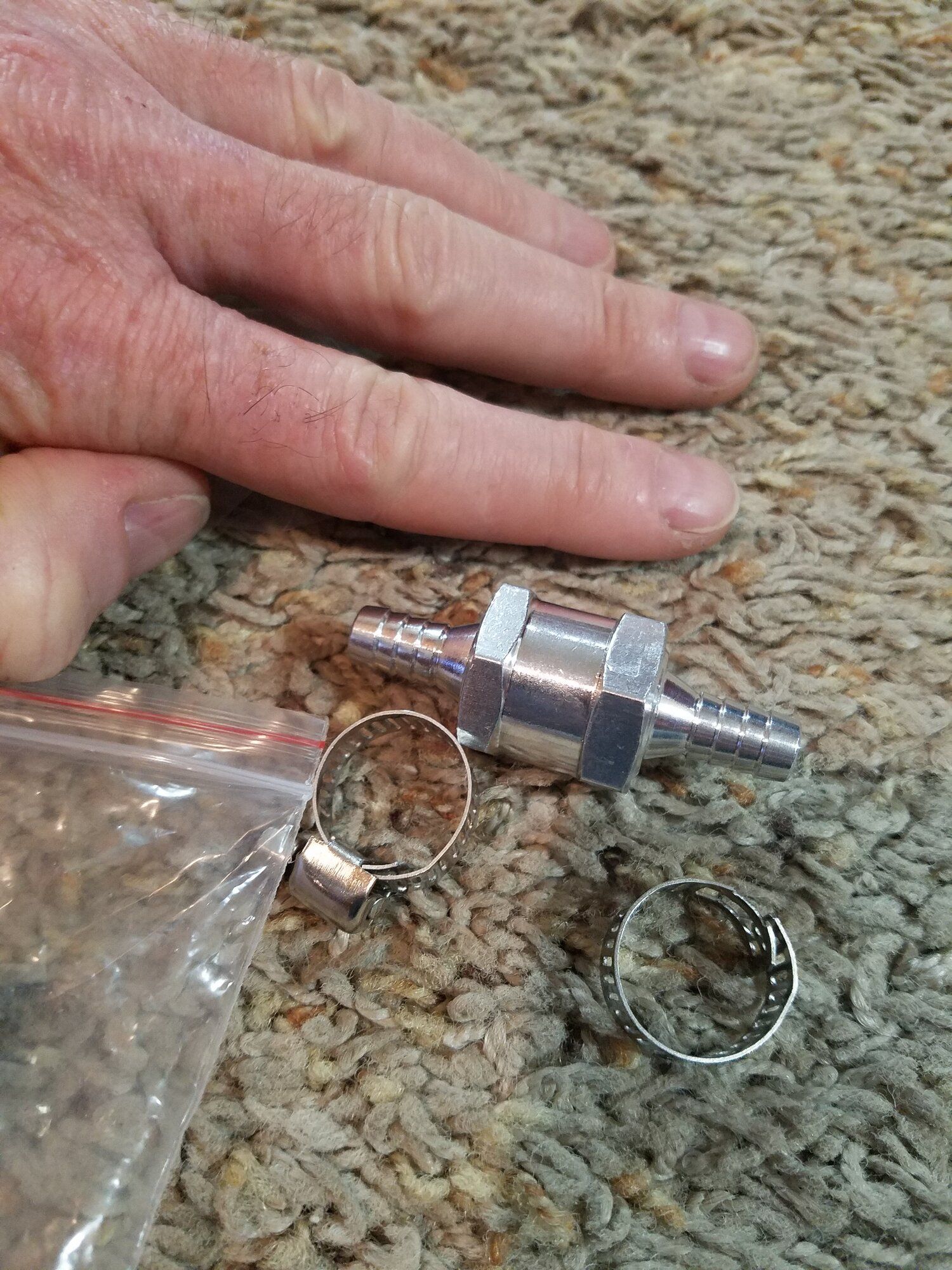

Marty, are you still running the factory PCV valve? Thinking about deleting mine due to it putting oil in the intake. Before I put any driving miles on my new motor I re installed the PCV because the crankcase fumes were pretty bad and I was worried about the oil drain on the turbo, now that my rings are good and seated I wouldn’t think I’d have any issues:idontknow:
Put a check valve inline with your pcv.. it works magic
I AM still running factory stupid PCV setup and I don't have a check valve in the line yet but have a bag full of them. I'm still ironing out the whole thing Jeremy. I am running a check valve in the PB booster line. I WILL be putting the check valve back in th pcv system, I just didn't have one handy when I did the first fire up to be honest and had forgot about it. It helps blow by TREMENDOUSLY.
Are you seeing any oil burning or losing any still?
I’m definitely not burning any, and the level stays the same on my dipstick, maybe I’ll just throw in an additional check valve like previously mentioned:thumb: One interesting thing to note is my RealStreet catch can stays DRY, and my valve cover has no baffles, but I’m not complaining, I’m not losing any oil and the underside/oil pan on my car is the cleanest and most leak free the cars ever been:D
I went to metal after first bringing up the check valve subject because I had 2 plastic ones fail. Metal are bigger too and hard to get in tight places. The PB booster line is EASY:)
Ive never had issues with plastic after the pcv... it is basically like having 2 pvc valves... but in the future both will go to catch can
I bet I just got a few (all in the same order) that were splitting at the middle seam. I guess I was blowing them apart ROFL
