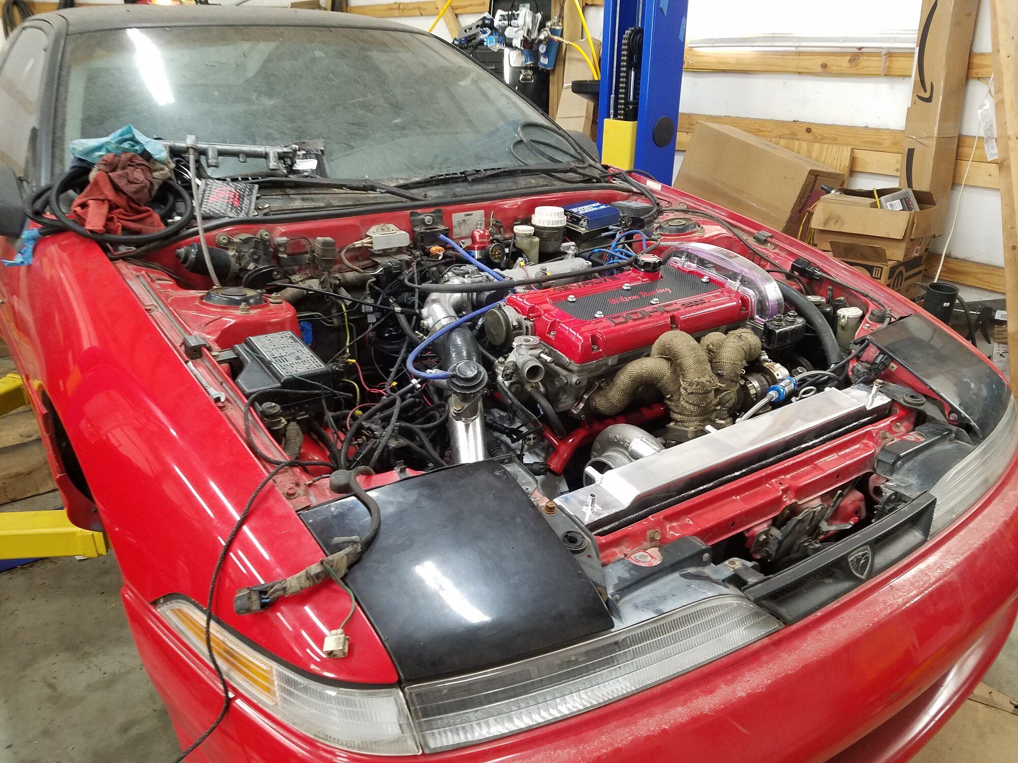

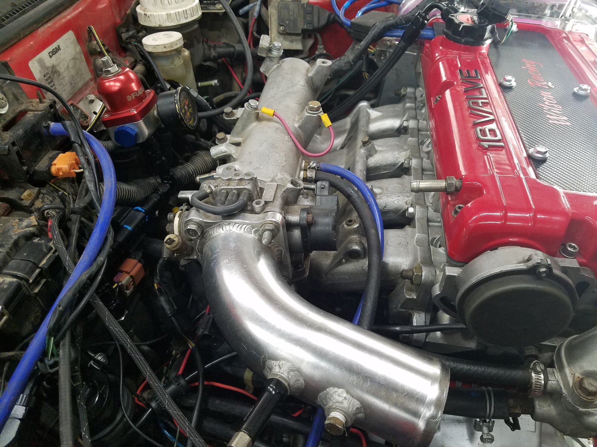

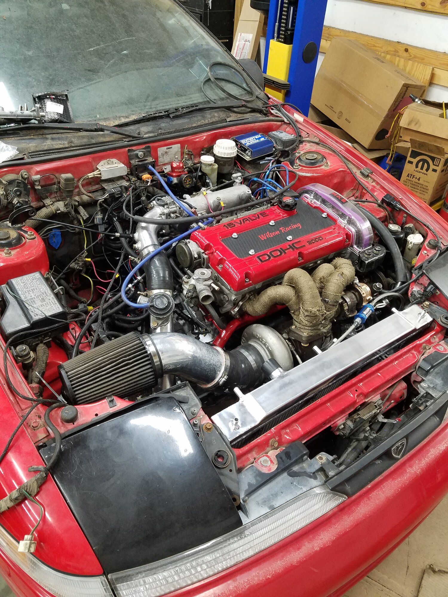

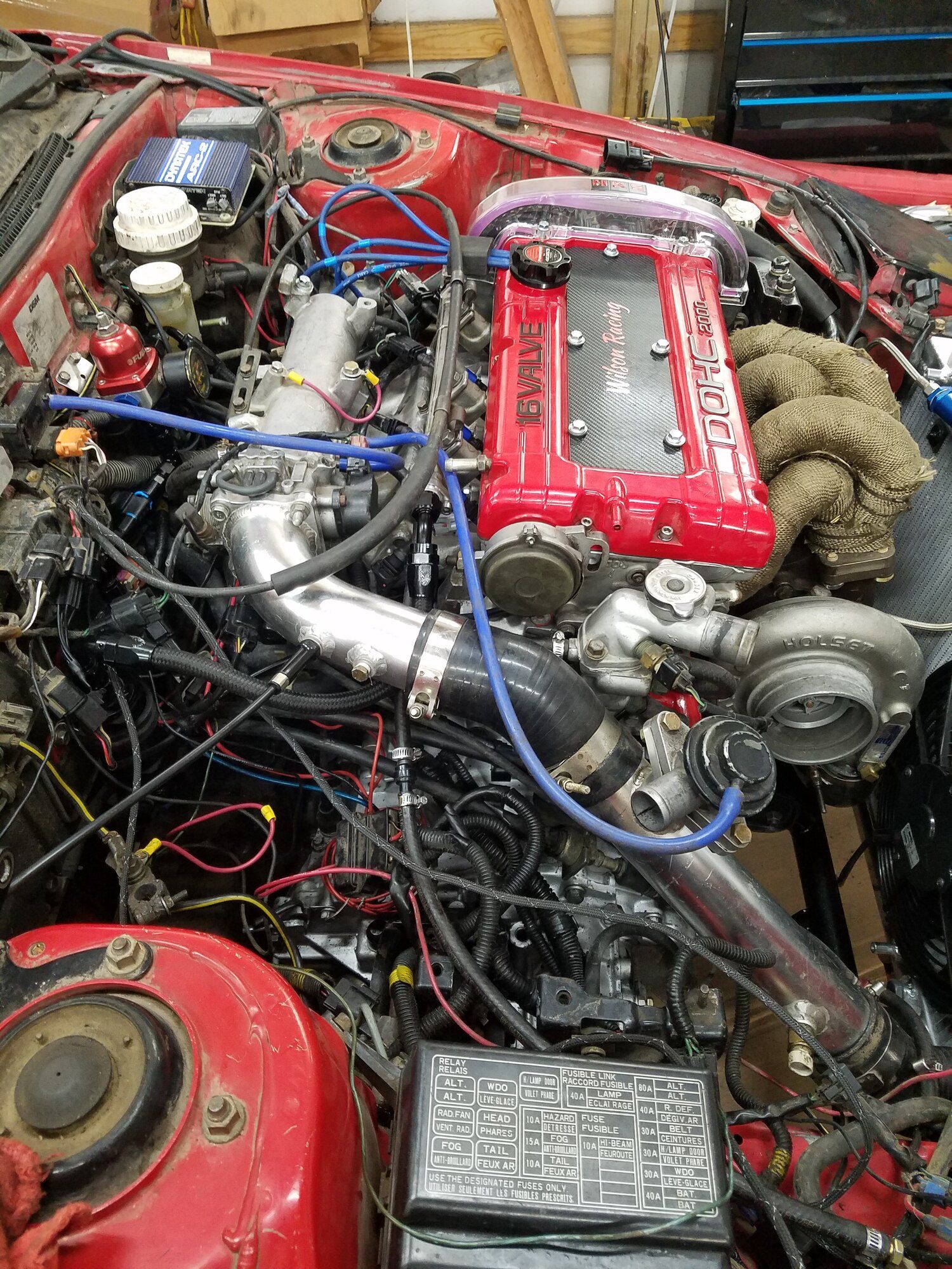

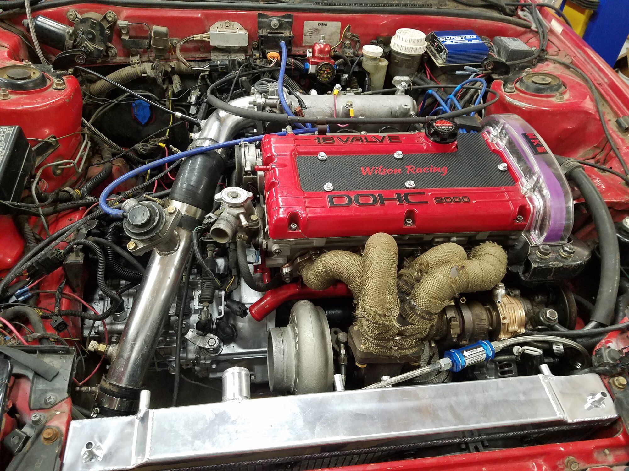

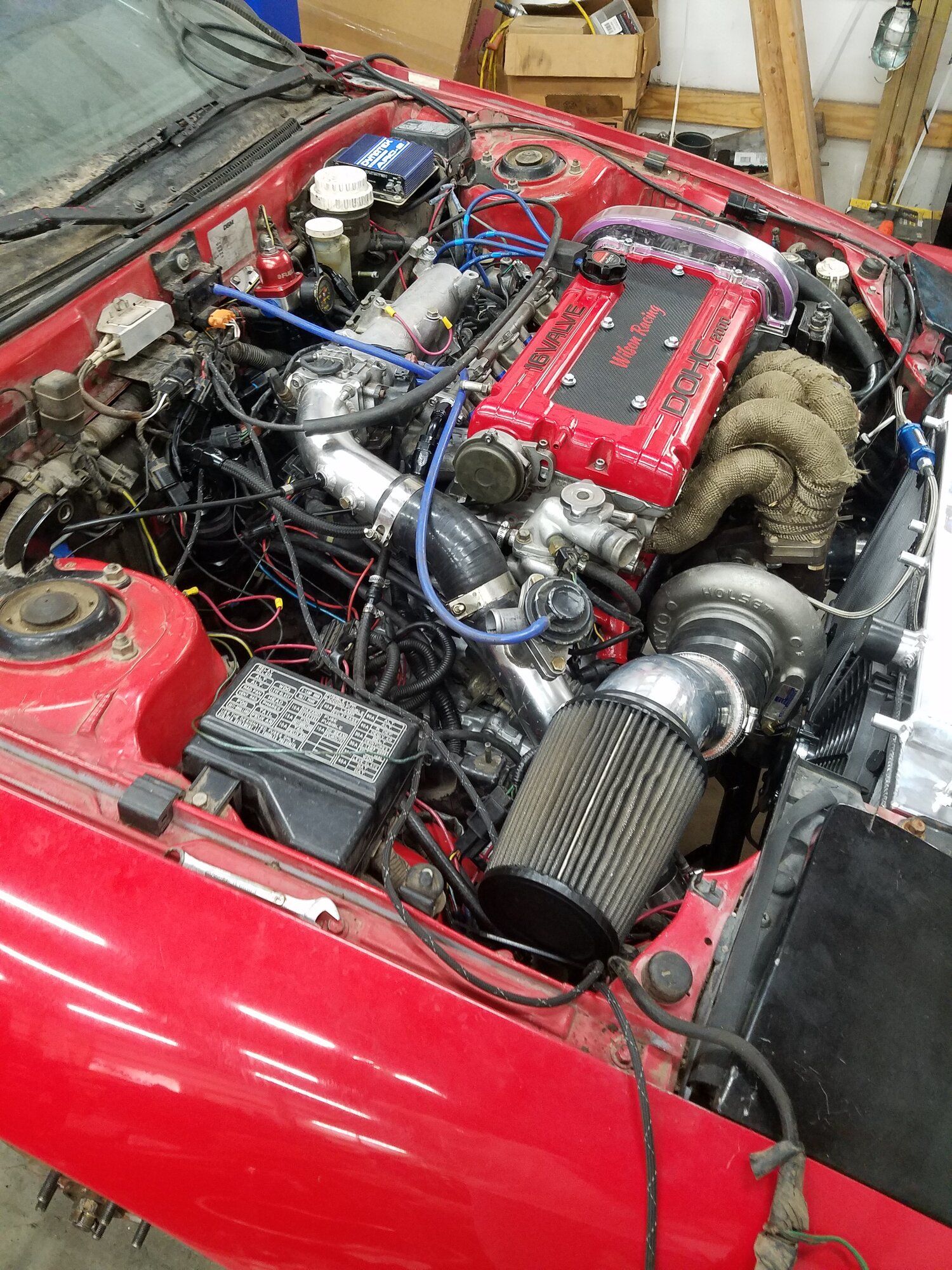

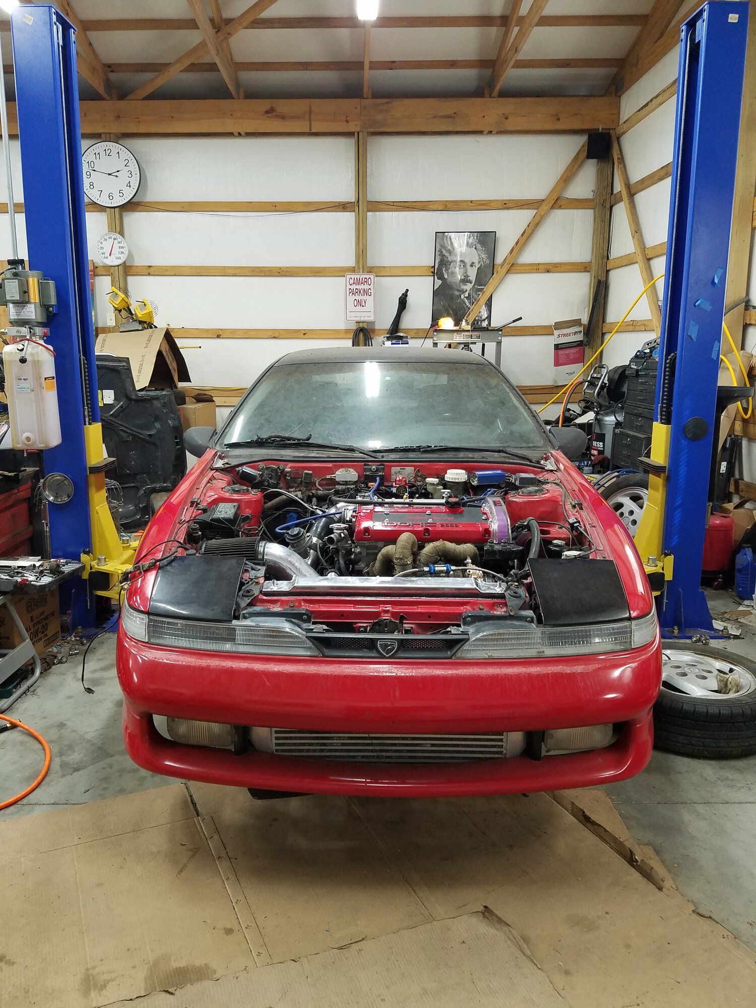

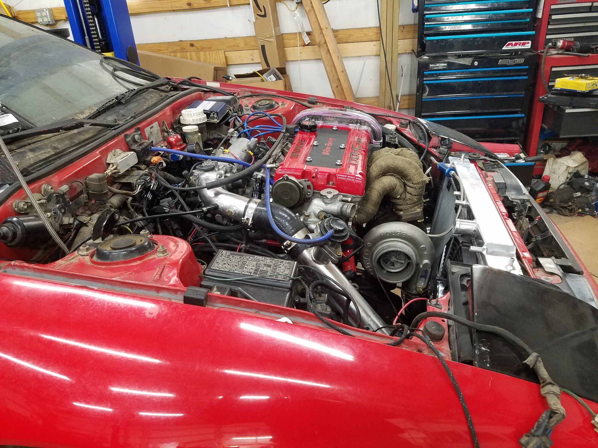

1990 Eagle Talon TSI trying to save her life from the previous owner and its alot of work but a nice base car. My youngest son, who also races this car has nicknamed her "The Red Baron".
Alright doubters, neh sayers and bitches.....the car is back together!!!
I currently hold in my hand the celabratory BEER that I dam sure deserve!!!:thumb:

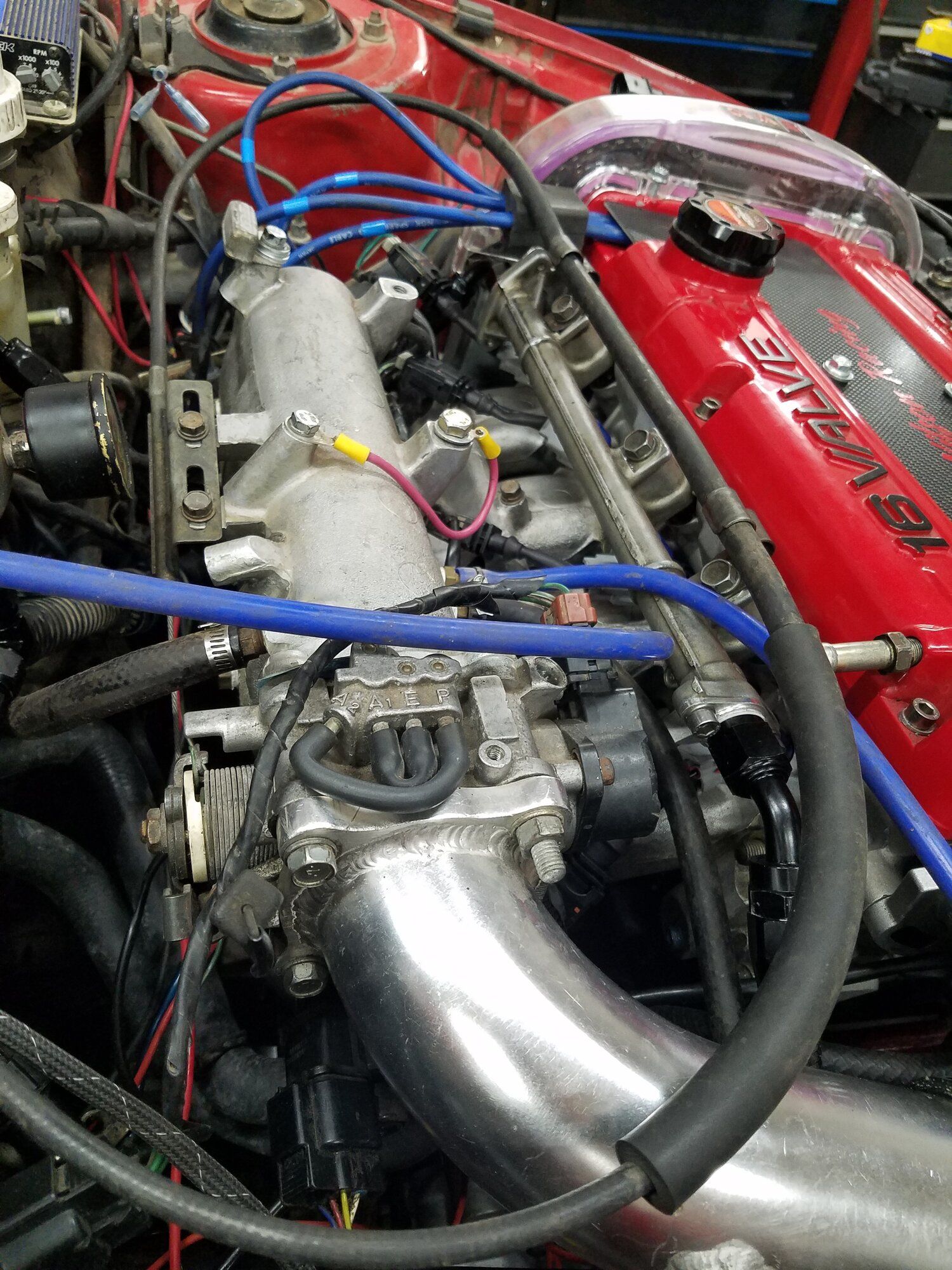

Check out what I got done today..... or rather, let me know what I FORGOT cause other than wiring and checking all hoses, belts, lines, fluids and wire connections, this car MECHANICALLY IS DONE!.
YAY!!!!;):thumb::cool:
I'm not sure what to do with the 3 left over parts....we used to say just put them in the gas tank and they would find their way but IDT those 3 will fit :hmm:
While I may dam near be 60, when I get a hair up my ass, I get some shit DONE!!!
I hope my followers enjoy my work and that it gives THEM ambition too!

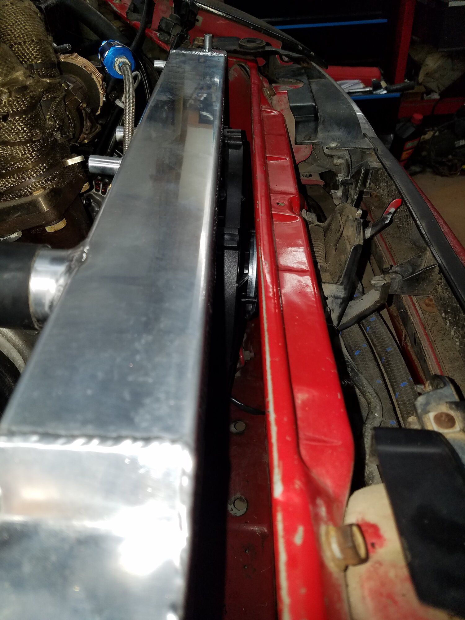

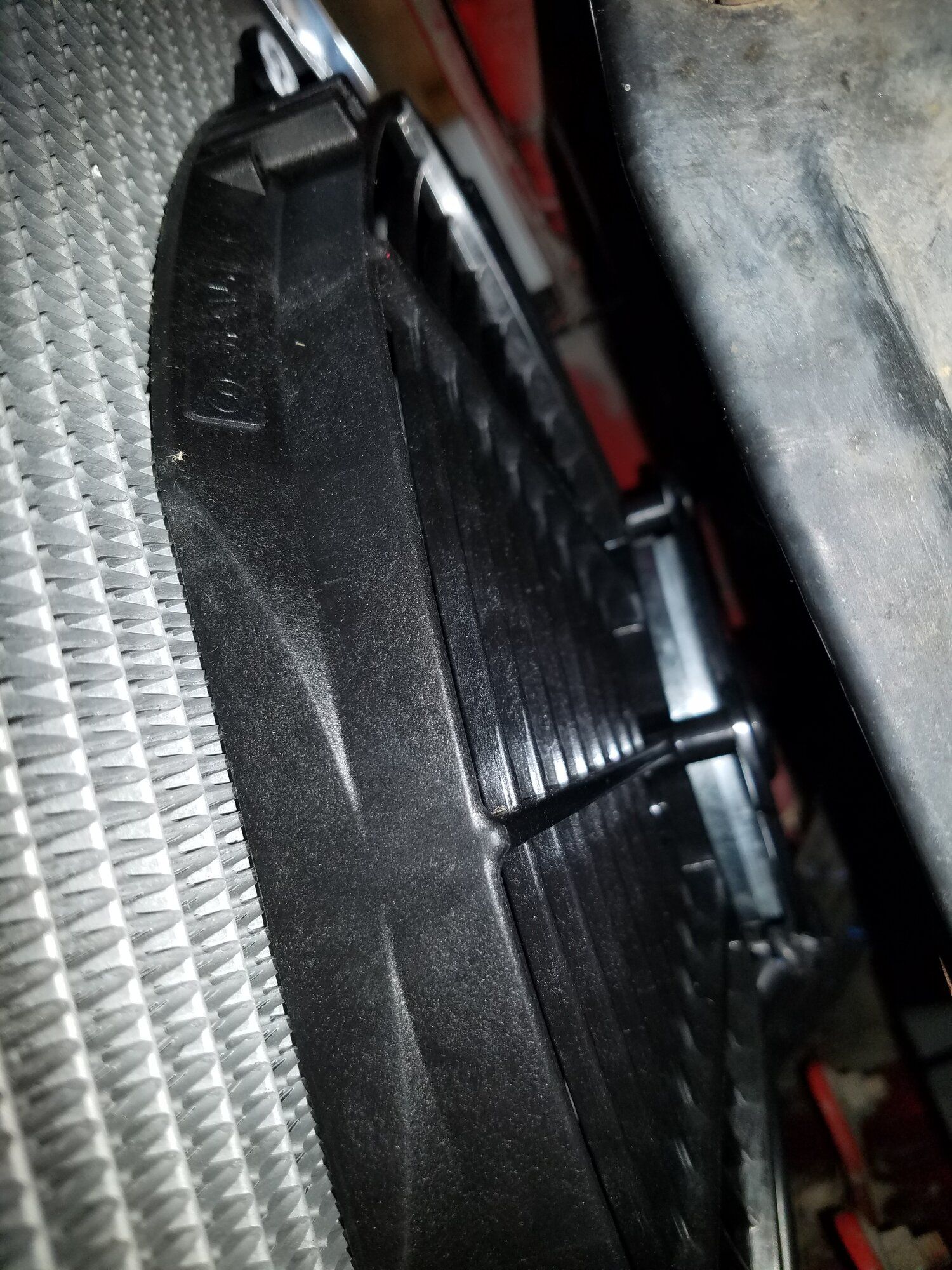

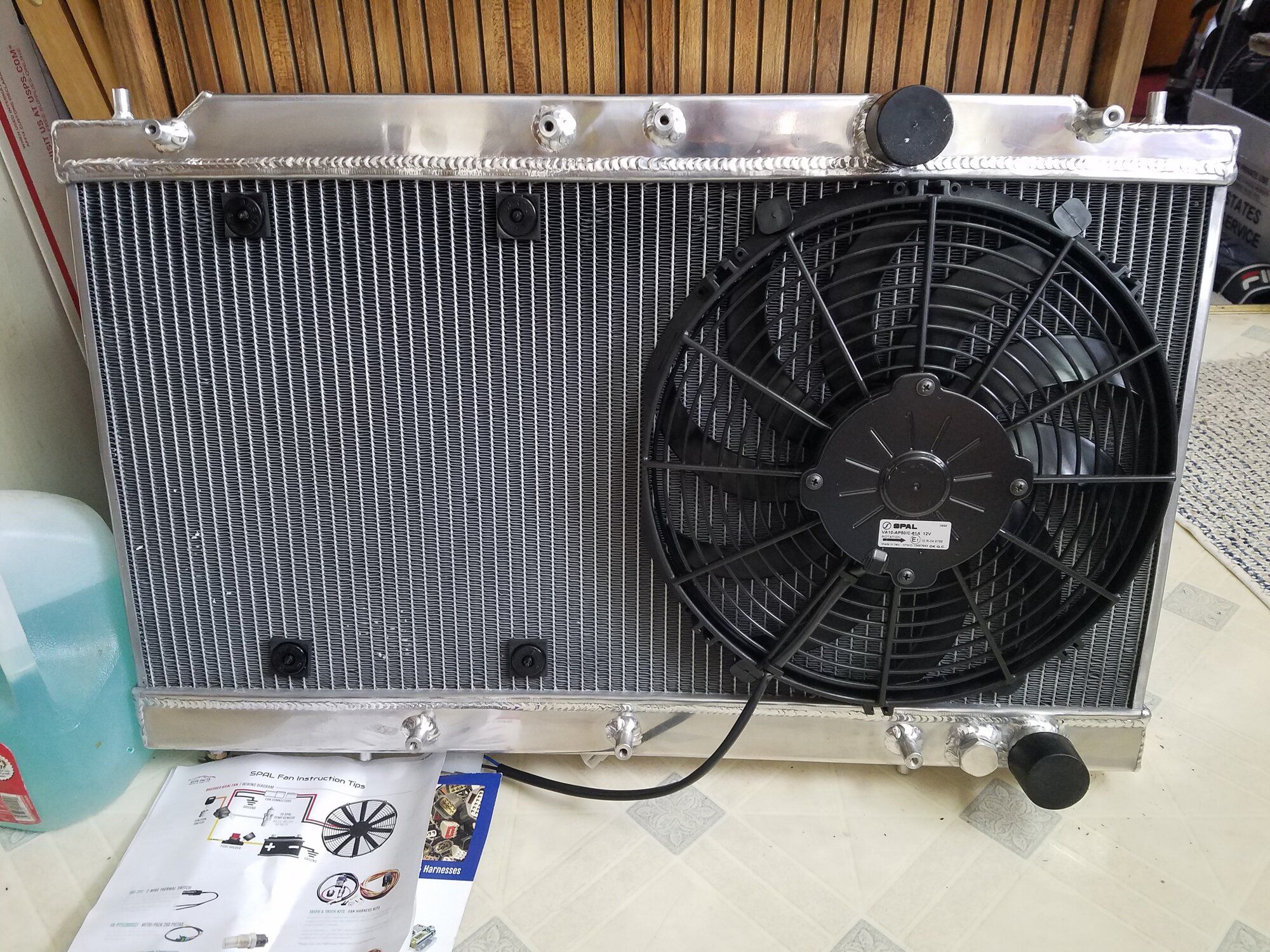

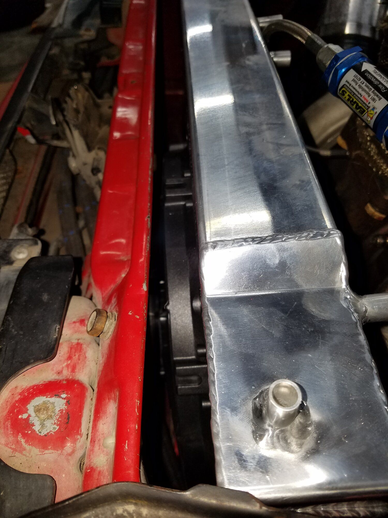

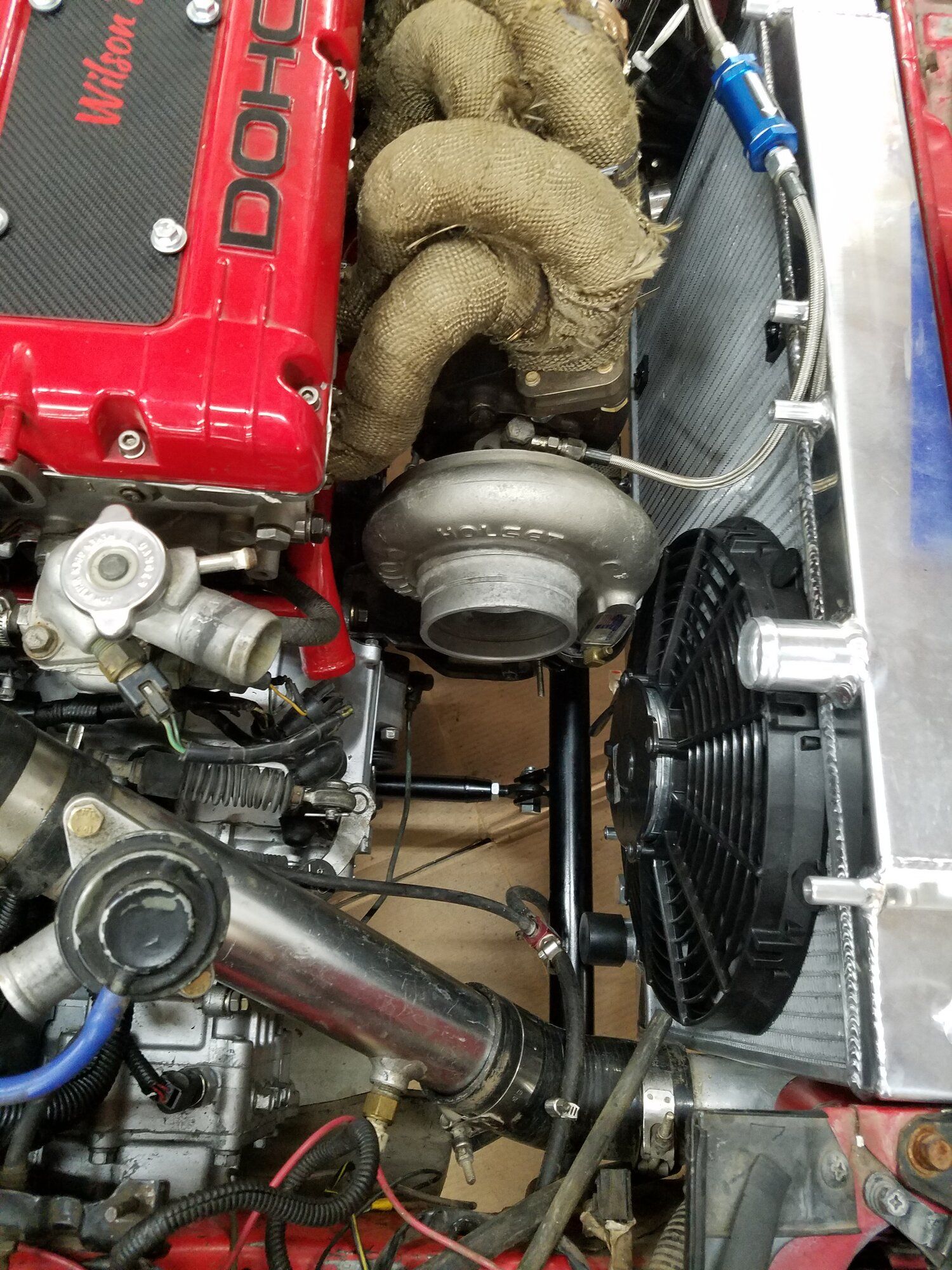

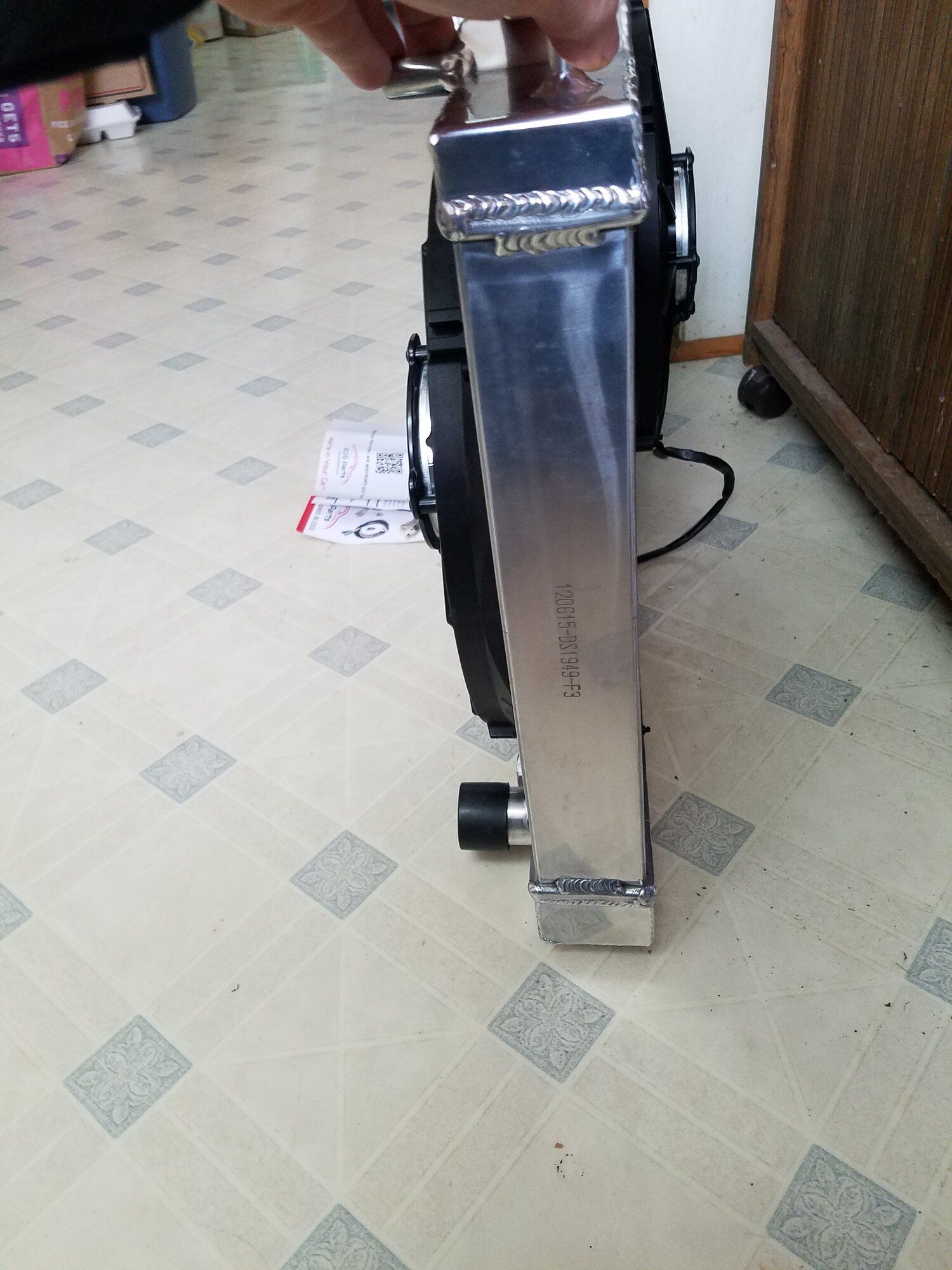

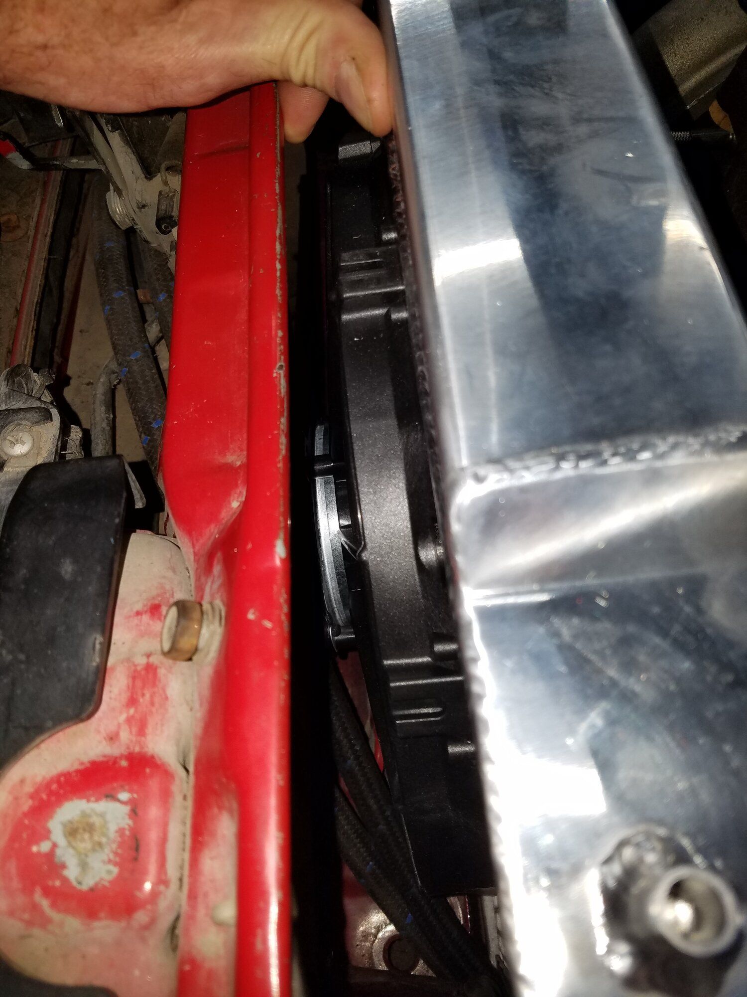

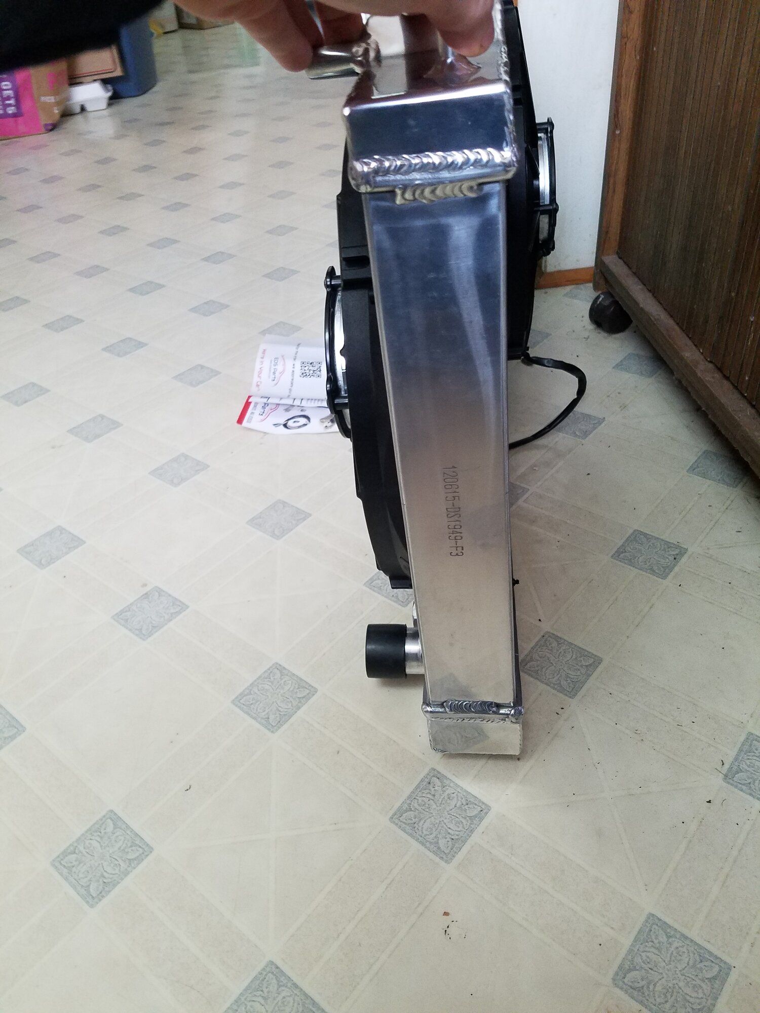

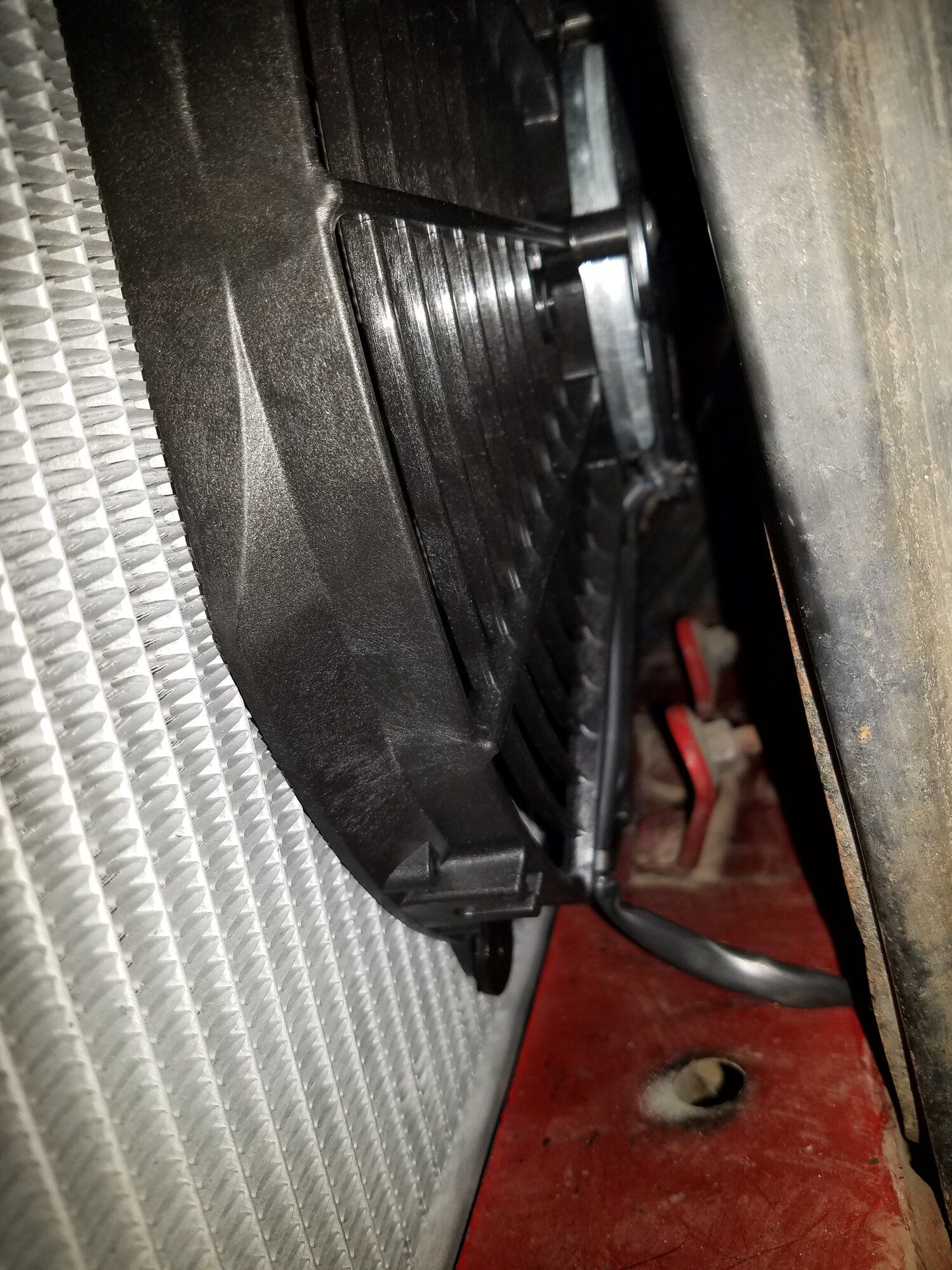

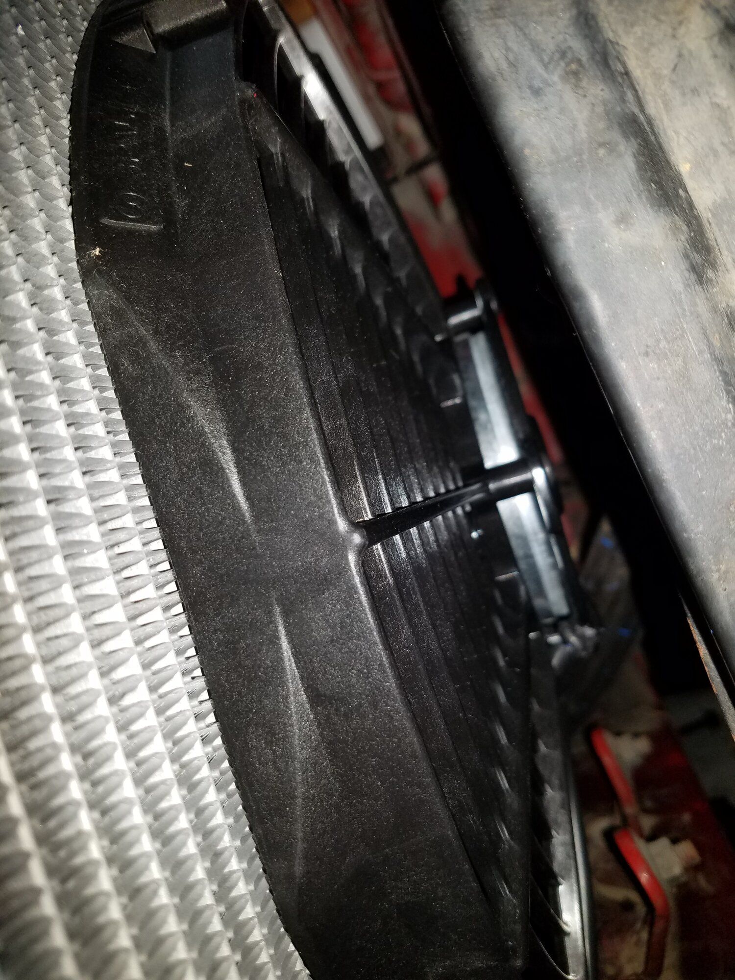

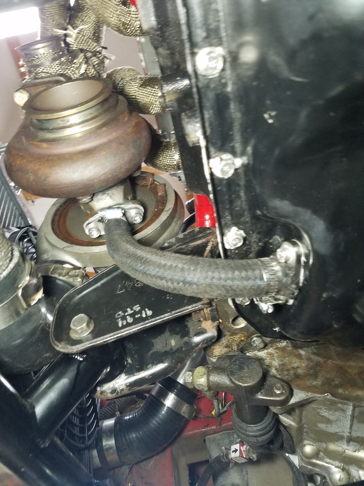

That tubular front end you have on it, seems like that gives you more room for a full 12" pusher fan on the front of the radiator.
But I don't see a pic for that. I see the Spal poking out the top just a little. But how does it look at the bottom from the front?
Do you have a shot of it with the Spal on?
I don't think I do but it is identically opposite of the puller, fits in under the radiator support. I'll see if I can slip my phone into the front and get a picture.

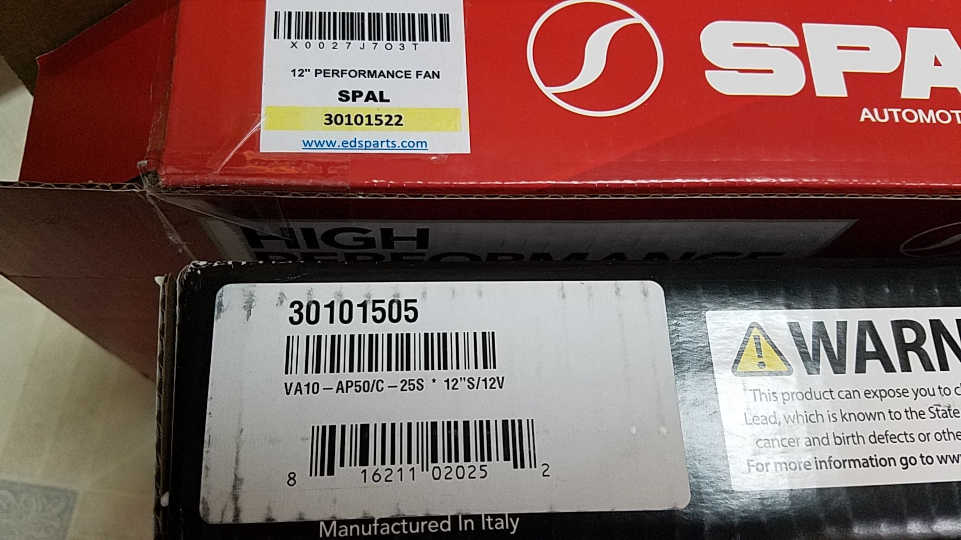

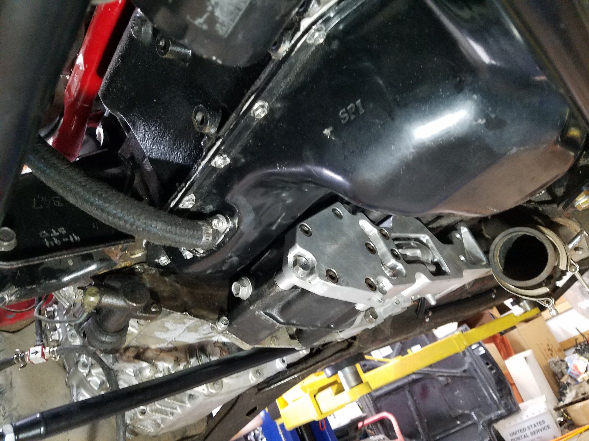

It really does sit exactly like the puller. No factory oil cooler in the way, I relocated my cooler (B & M) to the passenger wheel well. I'll see later today if I can get a picture that is better than these. I'm running a 12" curved blade 1337 cfm puller and a 12" straight blade 1228 cfm pusher.
I will add that bigger gauge wire will help these fans spin. After rewiring the sons Camaro Spal fans with dual relays, they were noticeably faster!
For what it's worth I had mine like this before I put my tubular in And it fit just fine
As did mine. The tube front end sits about 3" or so away from the back of the radiator.
I did the best I could. I had my phone upside down in the 1st 3 pictures of the front fan. It fits right in very nice.
Ok thanks you guys. I had an 11" Perma Cool in there that seemed like a tight fit when I took it out. And I remember that Vegas said he had to "trim some ribs" on his 12" Spal pushers that he had in front (that's in post #472 in his build thread) although maybe that was just the one on the passenger side? So I figured it's something to check into.

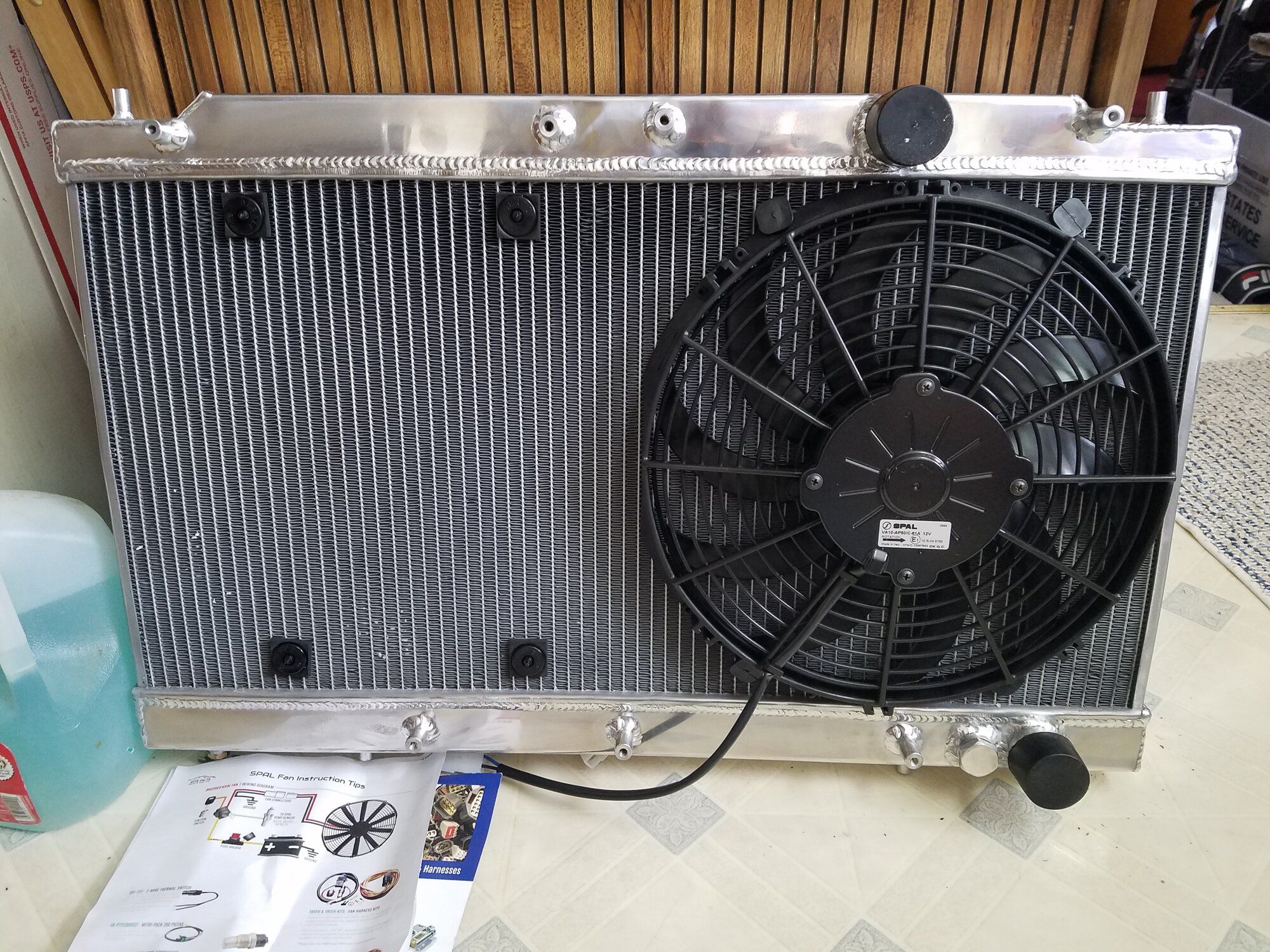

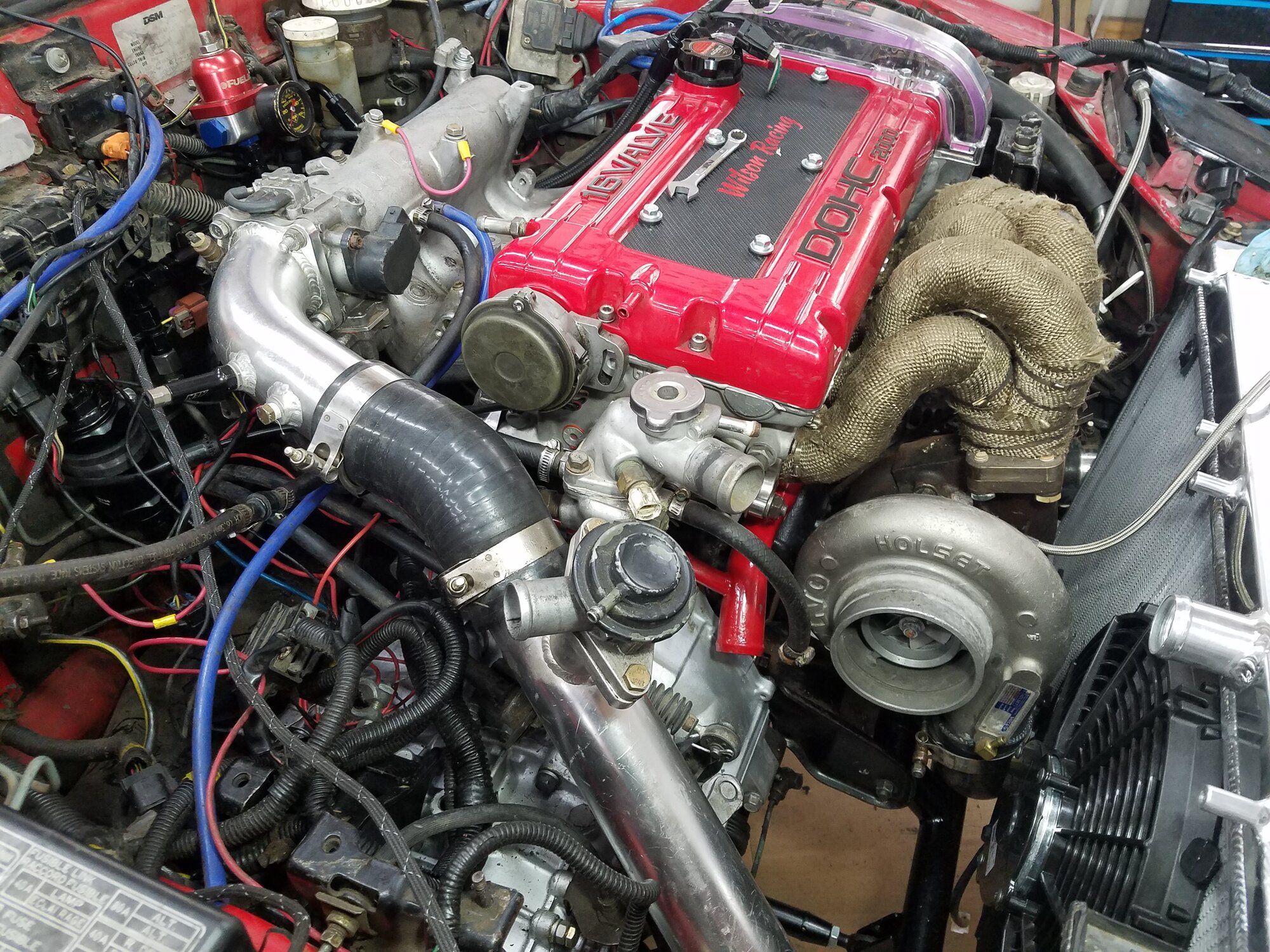

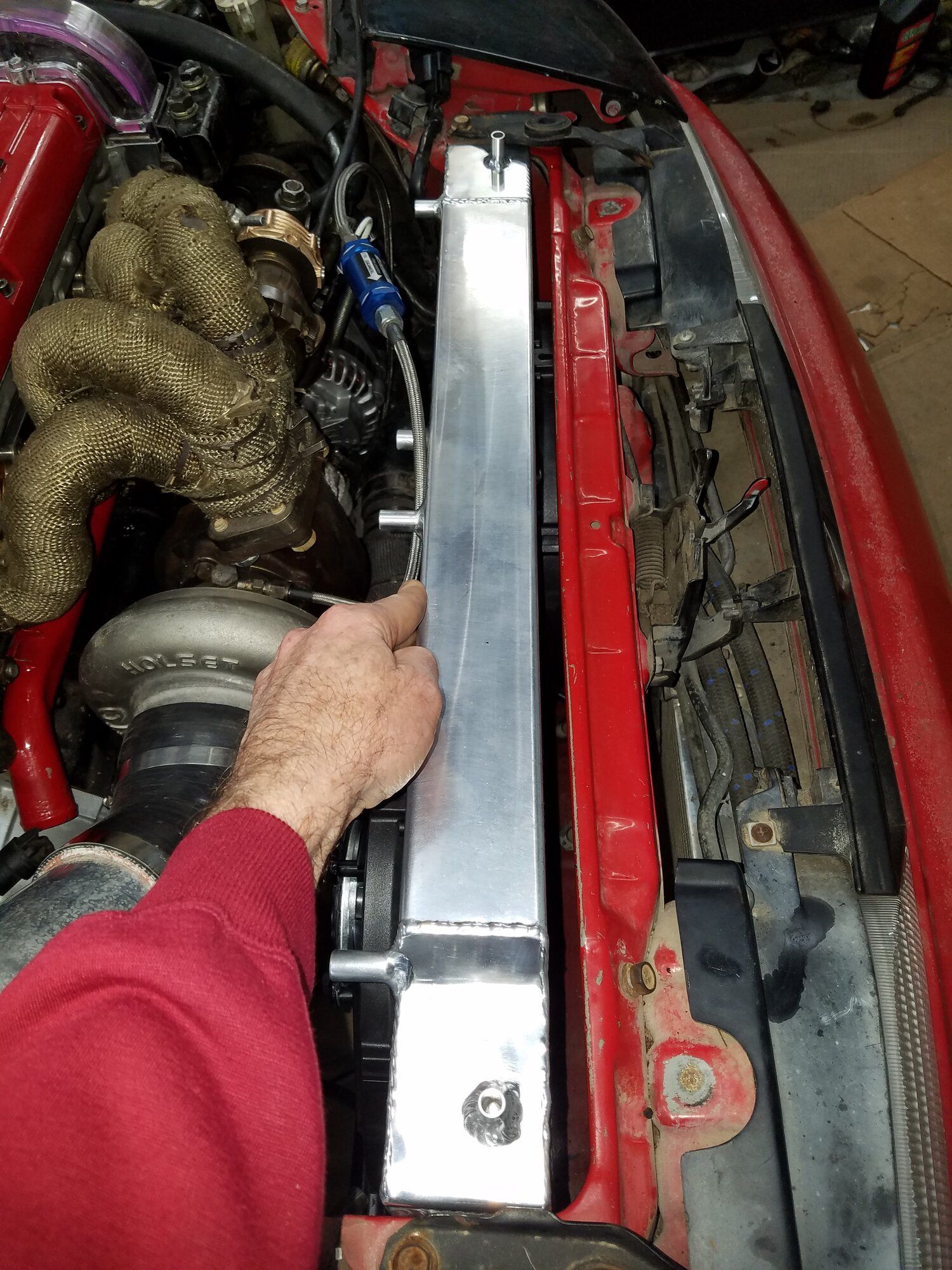

Marty in your latest pics you don't have the top frame to radiator brackets on the radiator. Is that radiator a little taller than stock?

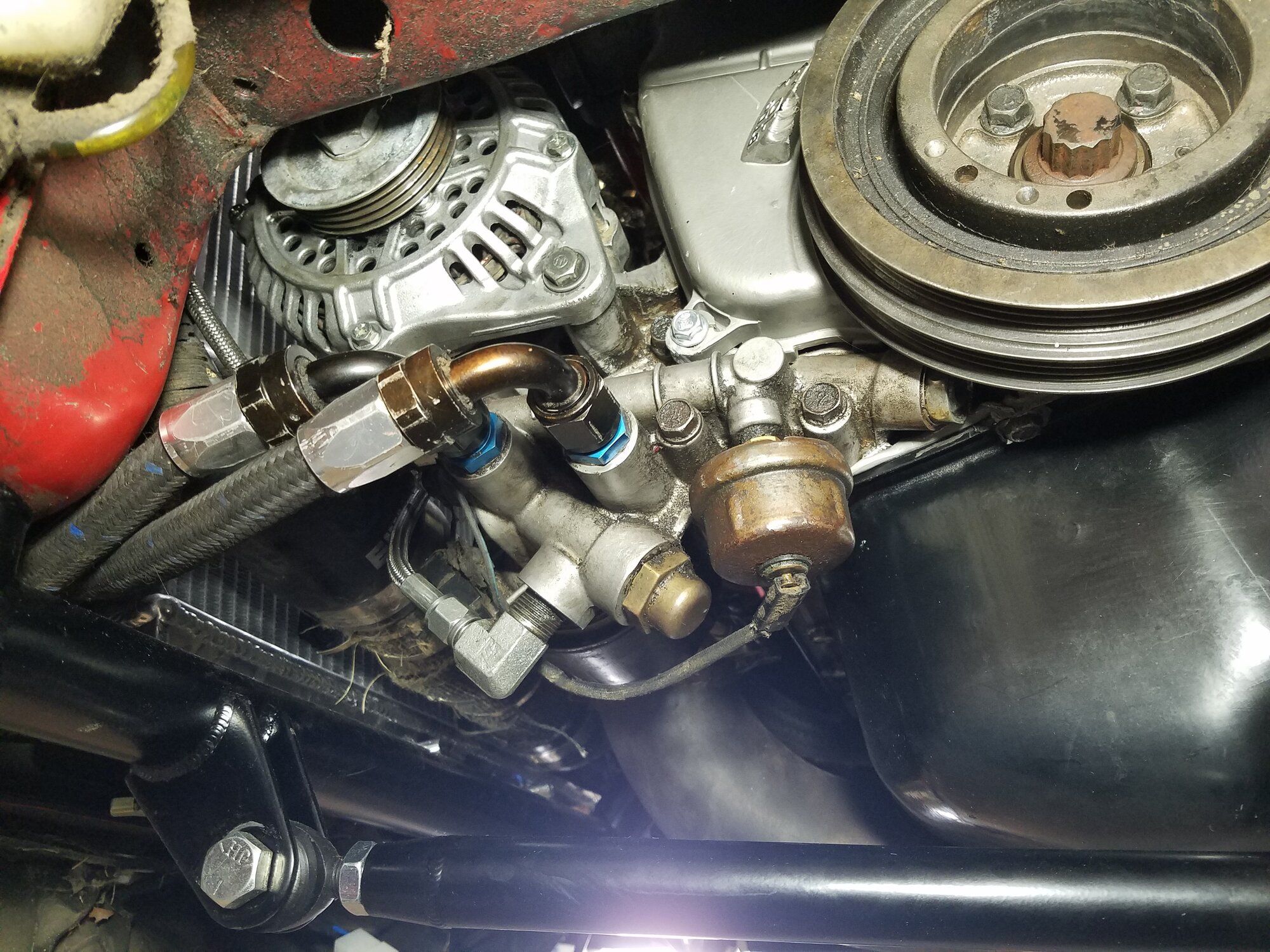

Nope, I just hadn't bolted them down yet as I was trying to remember where I ran my oil cooler lines, so I left it loose so I could tilt it back and french the hoses by the edge and onto the fittings on the OFH.
The radiator is a duplicate of a MitsumotoX, just not as expensive. Those brackets fit just like a stock radiator does. :) Good question for clarity.
Nope, I just hadn't bolted them down yet as I was trying to remember where I ran my oil cooler lines. Those brackets fit just like a stock radiator does.

Given that they are 3-row, and my Koyo I think is only a 2-row, a Champion rad would probably be an upgrade to the Koyo I have now. Probably they are a little thicker, but I have room for a thicker rad on the passenger side, and I would have room on the driver side too if I get rid of that 9" fan that is there now (which is something I want to do anyway).

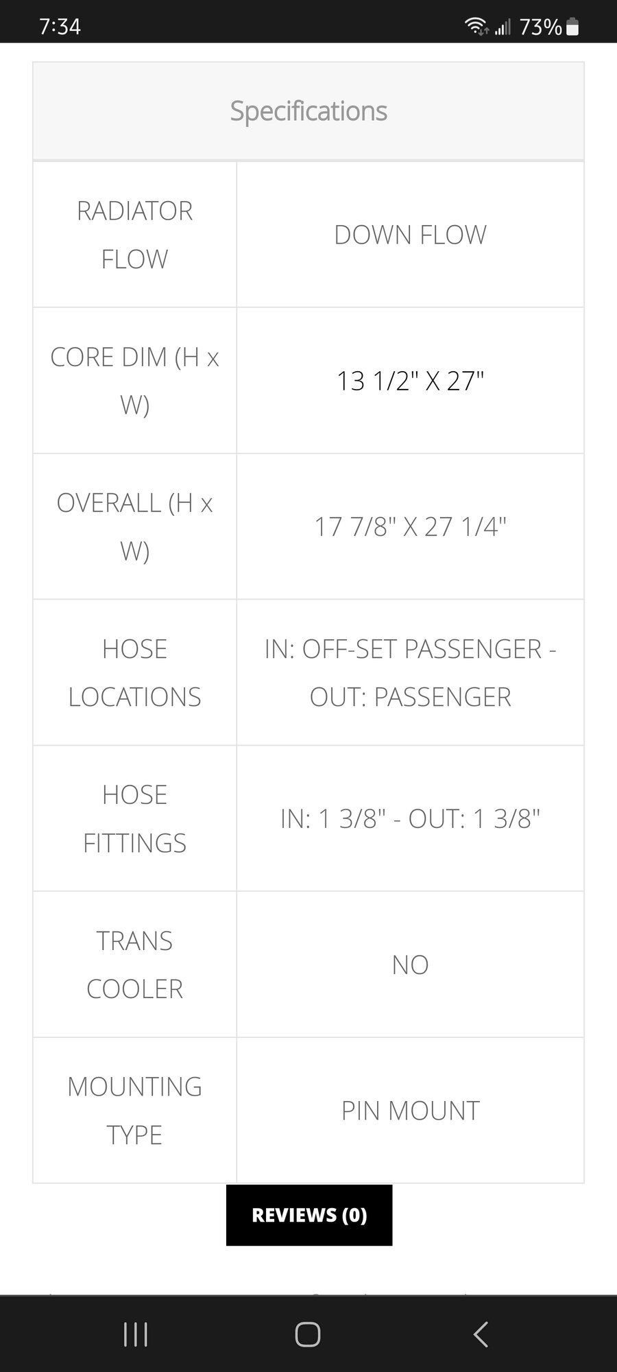

If you have an extra minute sometime LOL could you measure how thick the top tank is on your Champion rad? I don't see a dimension for that on their web page. My Koyo rad top tank is 1 and 5/8 inches thick, from the front face to the back face of the tank. Difference in top tank thickness would probably tell us how much thicker the core thickness is, pretty close.

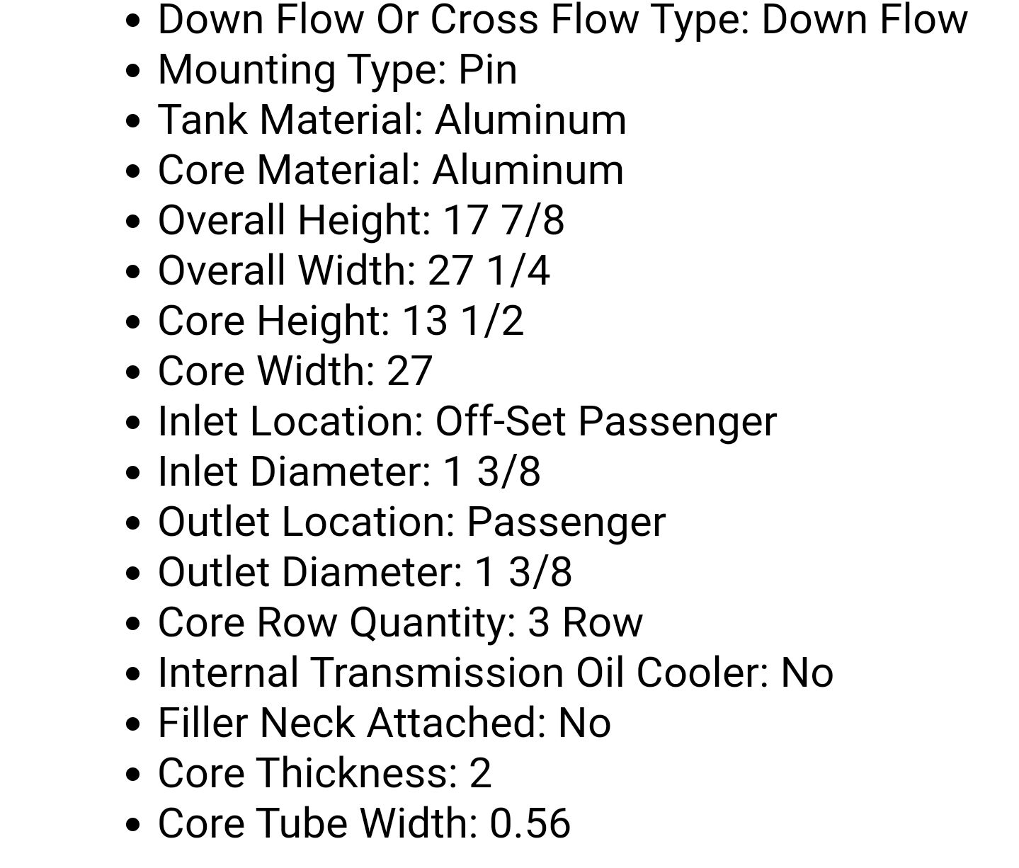

Dug some stuff up for you. You can convert to inches if you like but 36mm koyo is 1.417" vs the 2" champion... everything else is basically the same.
Picture with inches listed is champion, metric is koyo... would make sense that each row is close to .6 inches giving you the size difference... add probanly better cooling.
Yeah 0.6" thicker for adding one more row sounds about right.

I will try to show a couple LITTLE mods I did so the radiator and hold downs fit good without it rubbing on anything, as the tank is just a bit wider. (I will measure my MitsumotoX also). The mods were just little things but I am just being cautious. More later today. :thumb:
