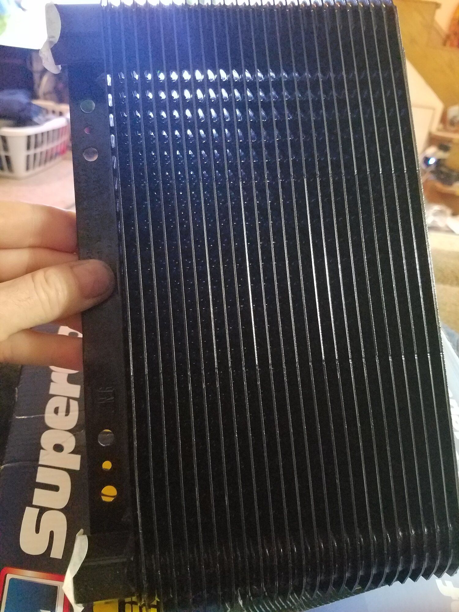

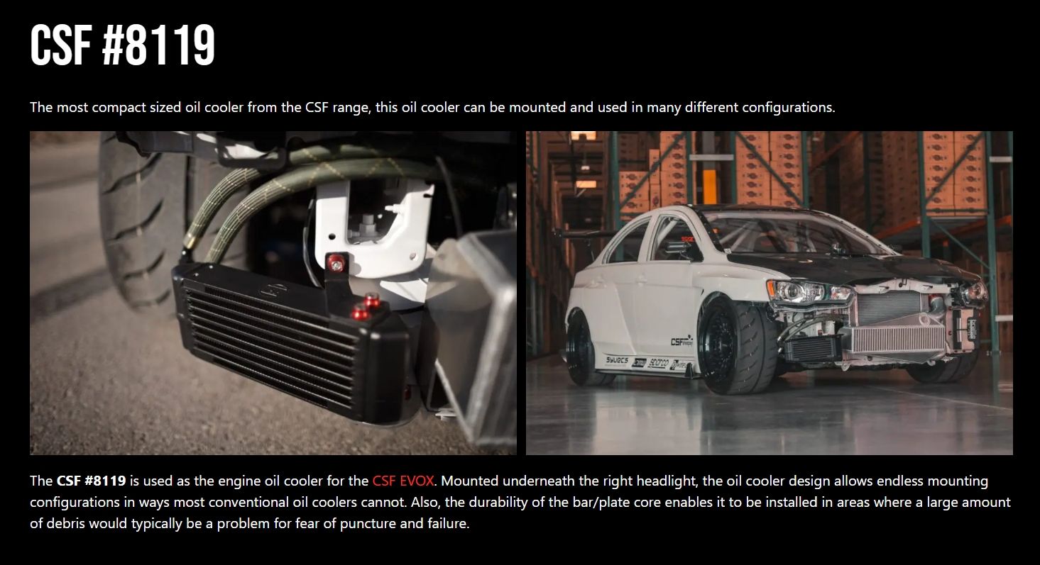

I am glad you asked! I noticed a damp area halfway down the cooler so I had to order a replacement 70273 B&M cooler.for piece of mind. NO LEAKS!
I could have mounted it facing forward but since it just wants to see cool air flowing thru/by it, I mounted this one at an angle and facing somewhat out towards the fender. I mounted it that way because I dont have a rock shield for the car and didn't want to throw a rock thru the cooler.
Aha very interesting!
Cuz the next thing I want to ask is if the stock fender liner does anything to protect the cooler from rocks getting thrown off the tire. Or do you run it without the stock fender liner?
A "rock shield" - would that be the stock fender liner or would it be an added part, like a rally type add-on?
I still have my stock fender liners but I haven't seen them on the car for so long I don't remember where they extend to. But just looking at them off the car, I don't think they would come down low enough in front to do much good.
Your B&M leak, do you think it was caused by rocks getting thrown off the tire? Or did the whole cooler run into something big, like the earth, when you made your run cross-country to get home after going off the road backwards ? 🤣
Thanks for the pics.
That was in the AUTO car......;)
After the discovery of the damp oil cooler, I am planning on fabbing a rock guard with some metal screening and put it in place of where the stock wheel well liner should be and also tuck it under the car also. It sounds easy, I will see if it will work and stay in place.

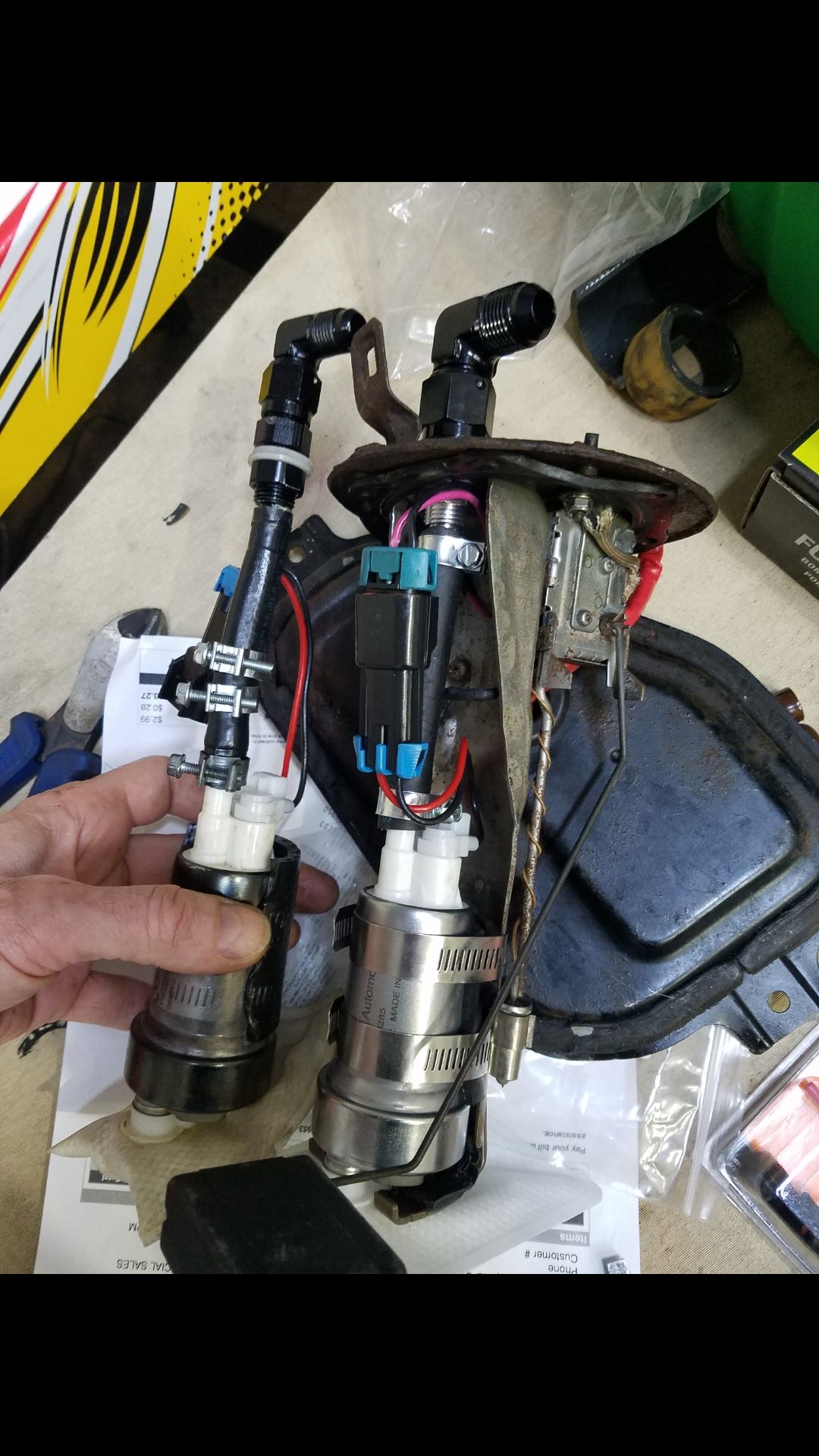

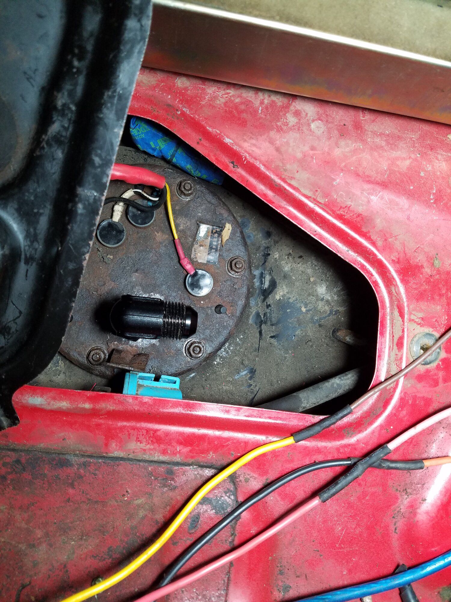

I checked my 8AN line placement for the new pickup and it is very close so I am happy. I'll get to the new 525 pump and 8AN bulkhead when the weather is crappy outside.

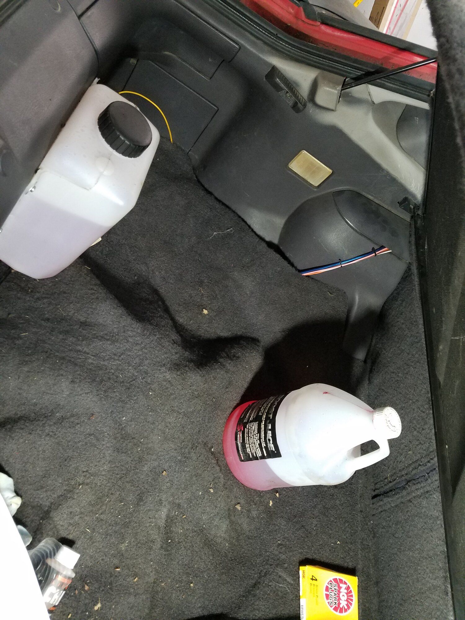

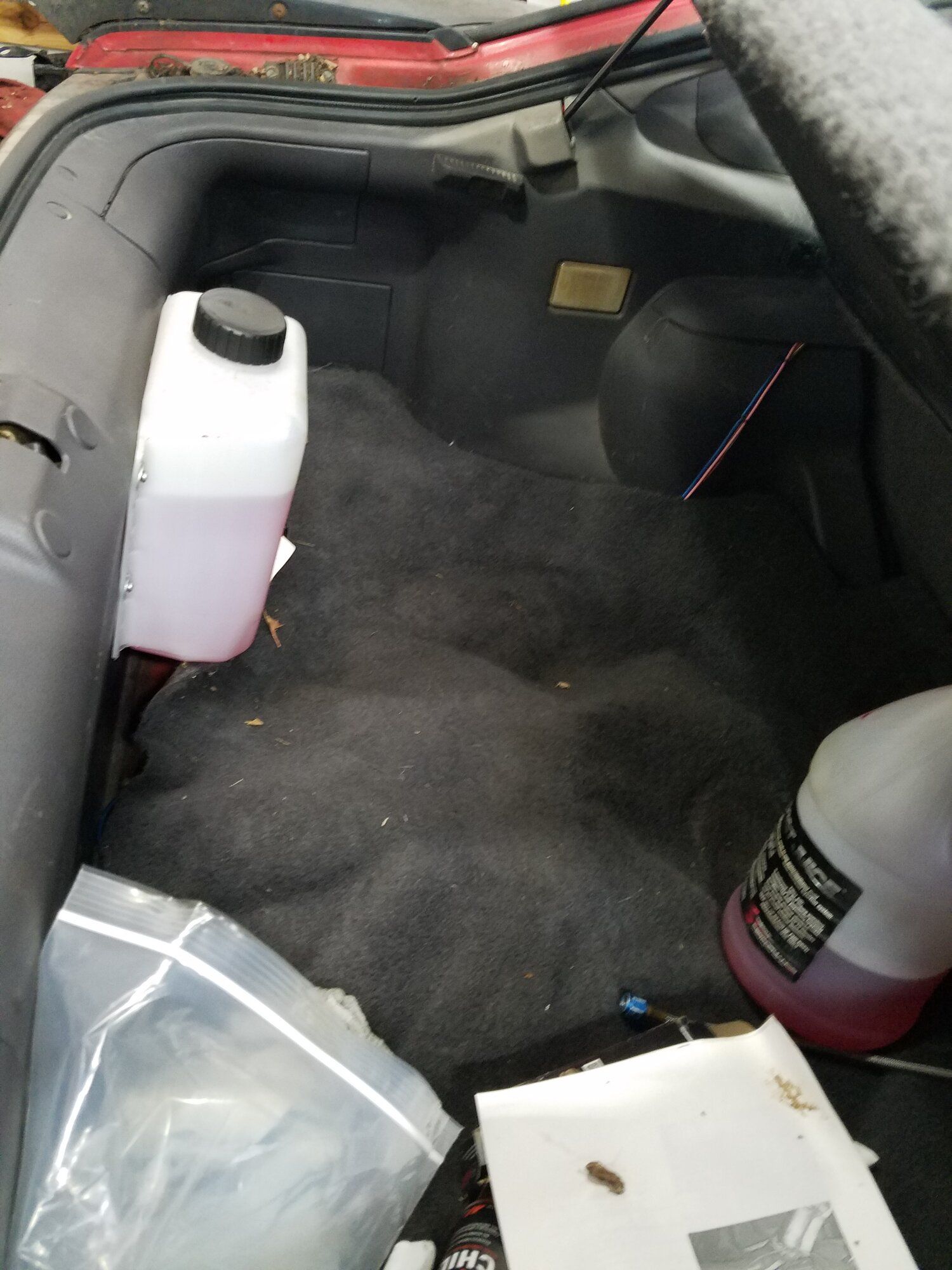

Surprise pictures of the trunk area included!
That's some ugly colored 6 yr old E80nothin in the tank but it is nice and CLEAN!
Hmmm. I don't expect problems but thank you. A debris screen should work and the B&M cooler is also a bar and plate design. The car sat for EVER so hard to tell why it is seeping but I won't ask why I will just change it out, maybe soapy water spray and some compressed air later to look for any holes. :thumb:

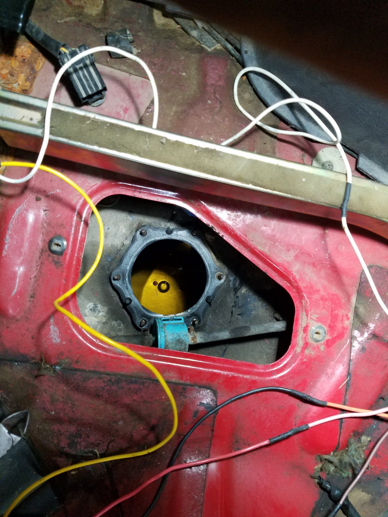

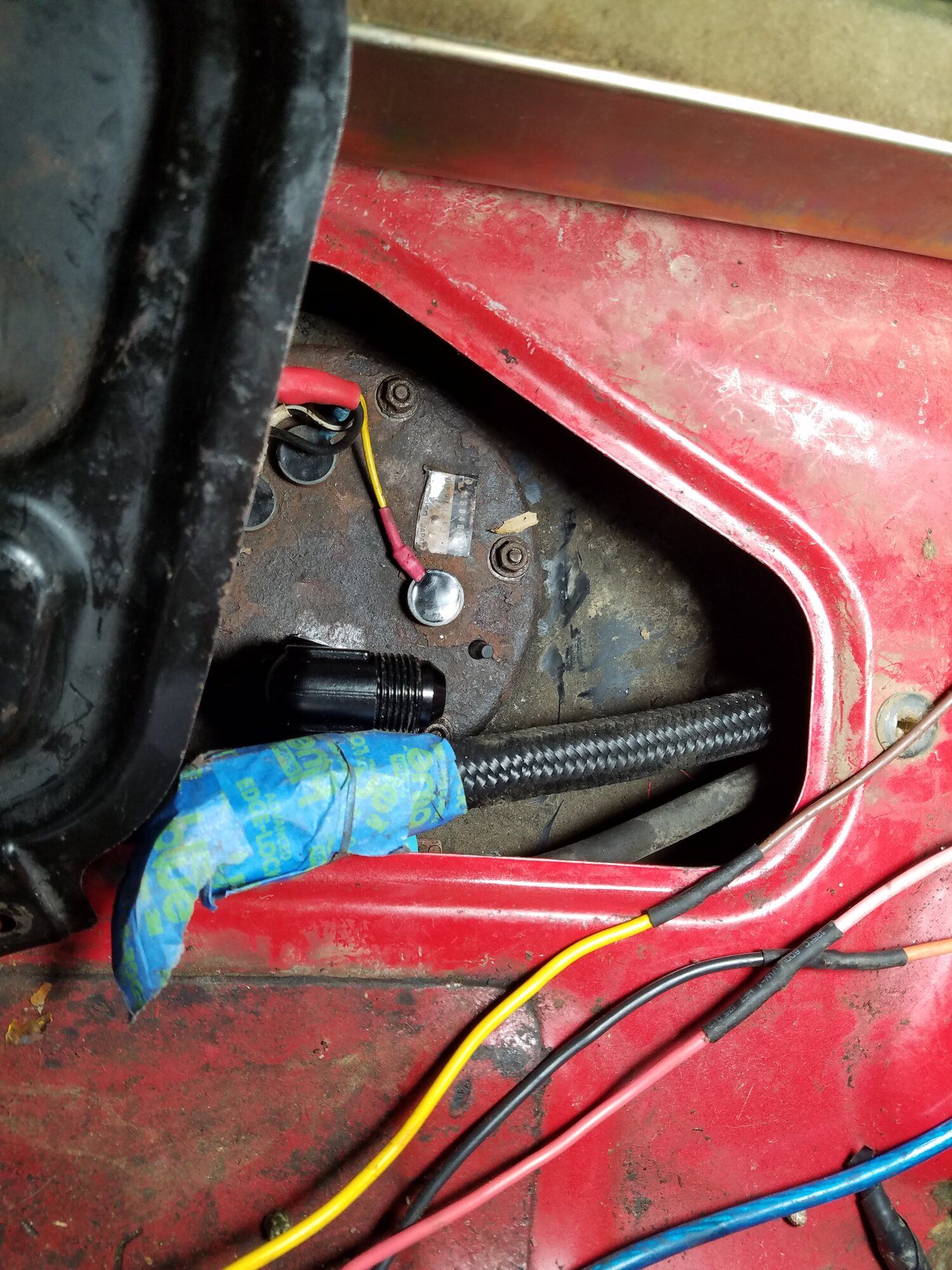

Crappy weather.....new fuel pump and 8AN feed. I try to plan around mother nature.

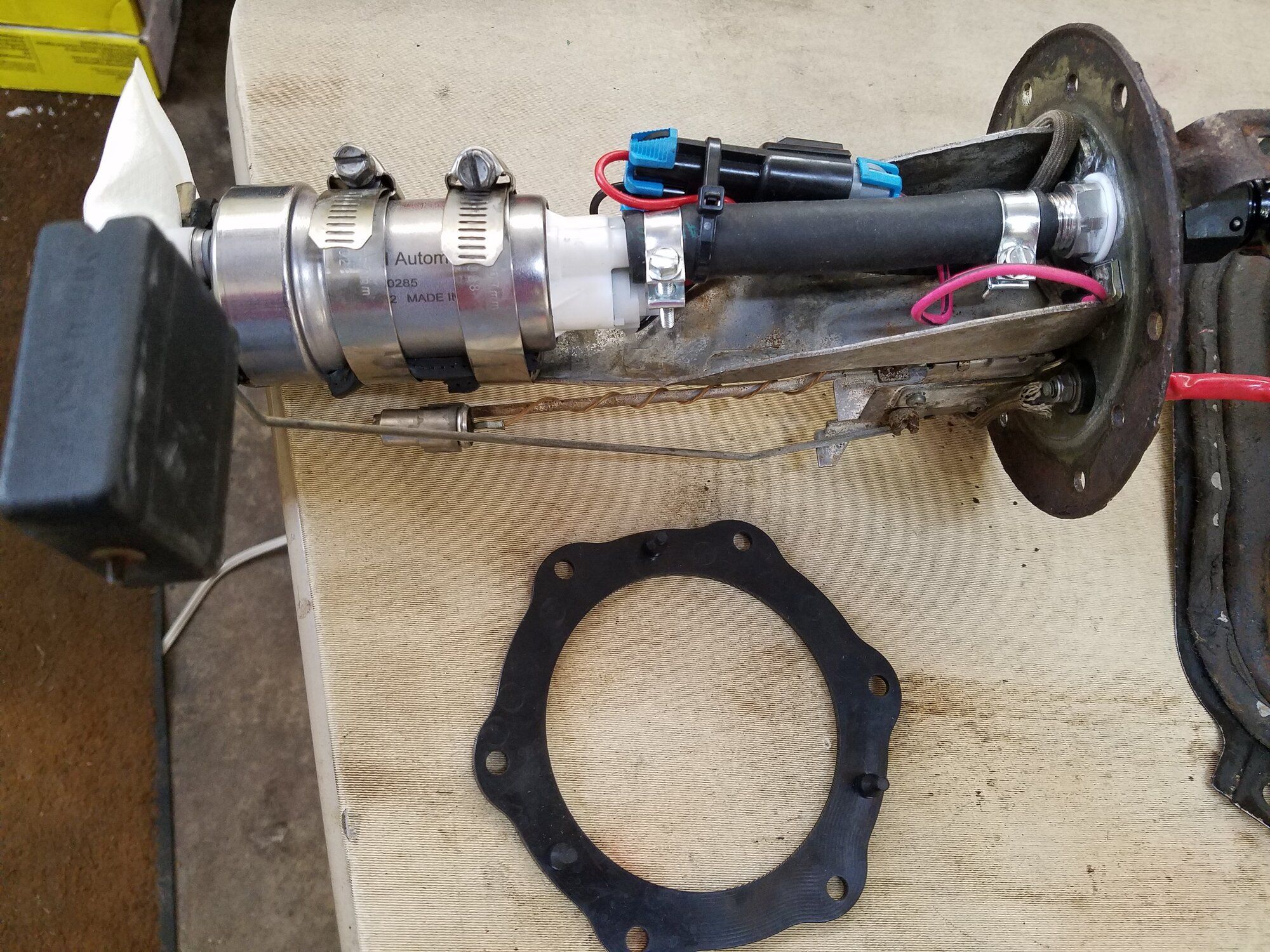

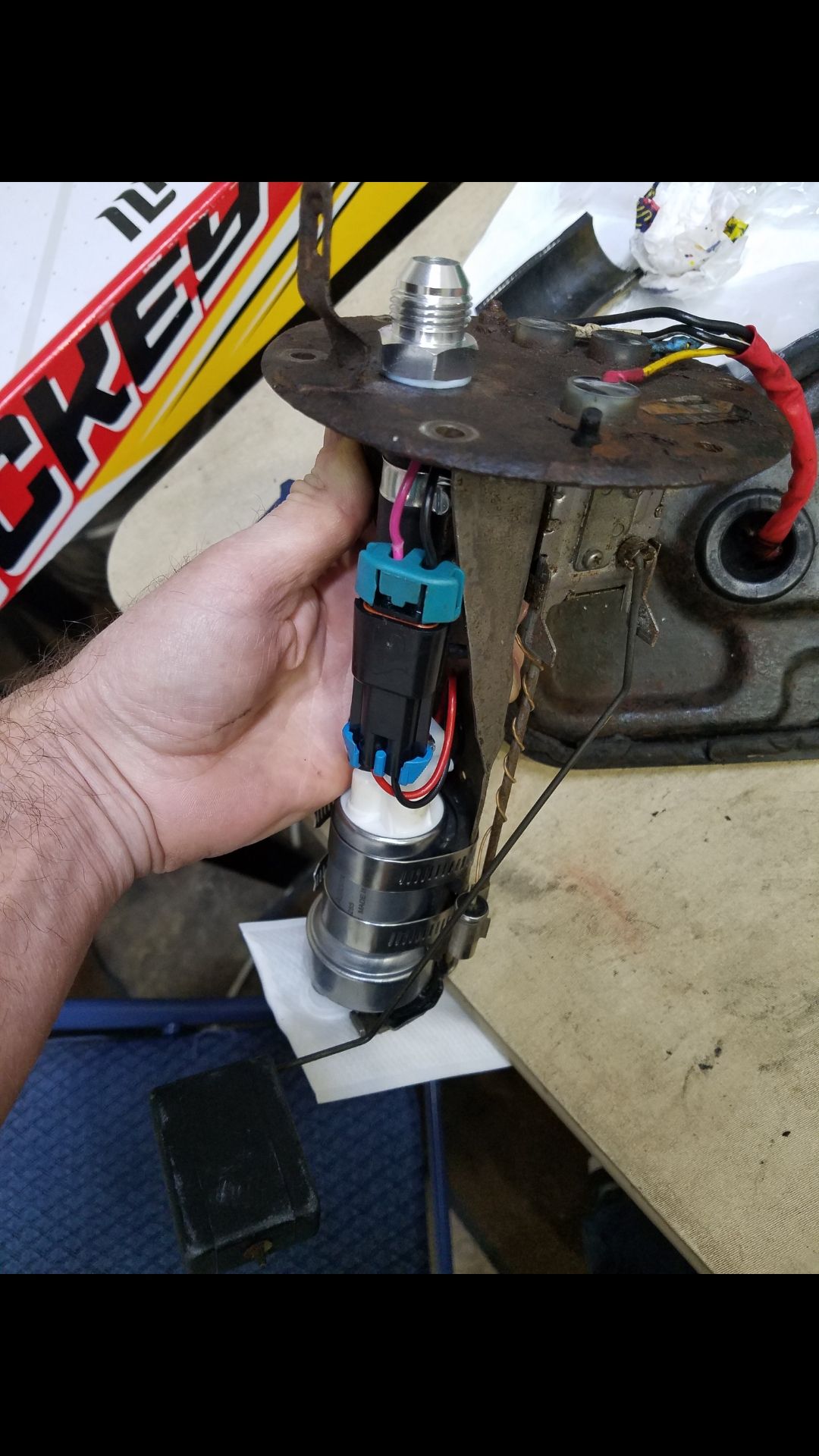

Brand NEW TI Industries 525 from ExtremePSI (thank you) and the bigger AN fitting. I may be installing the assembly tomorrow, it depends on the weather.

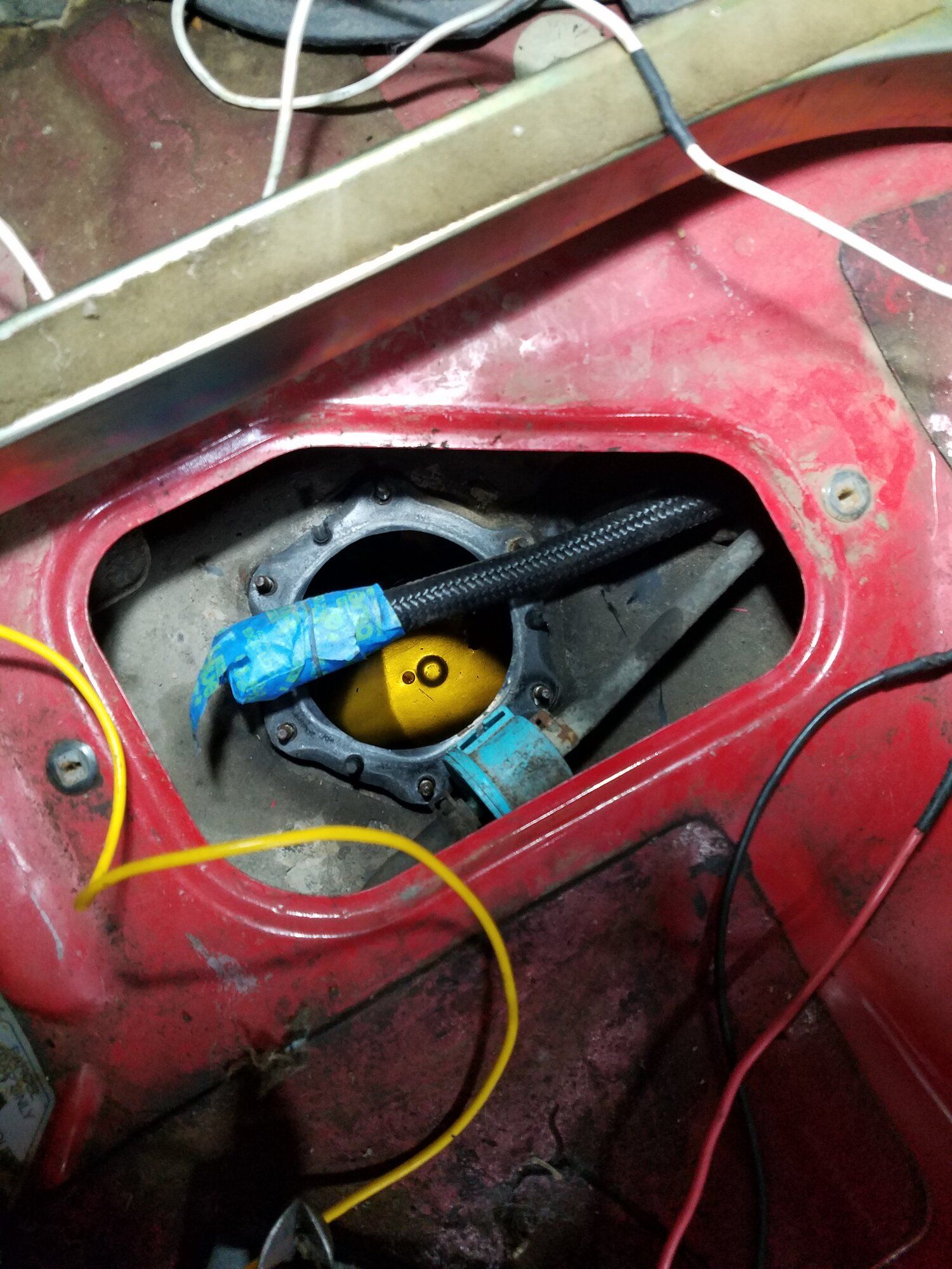

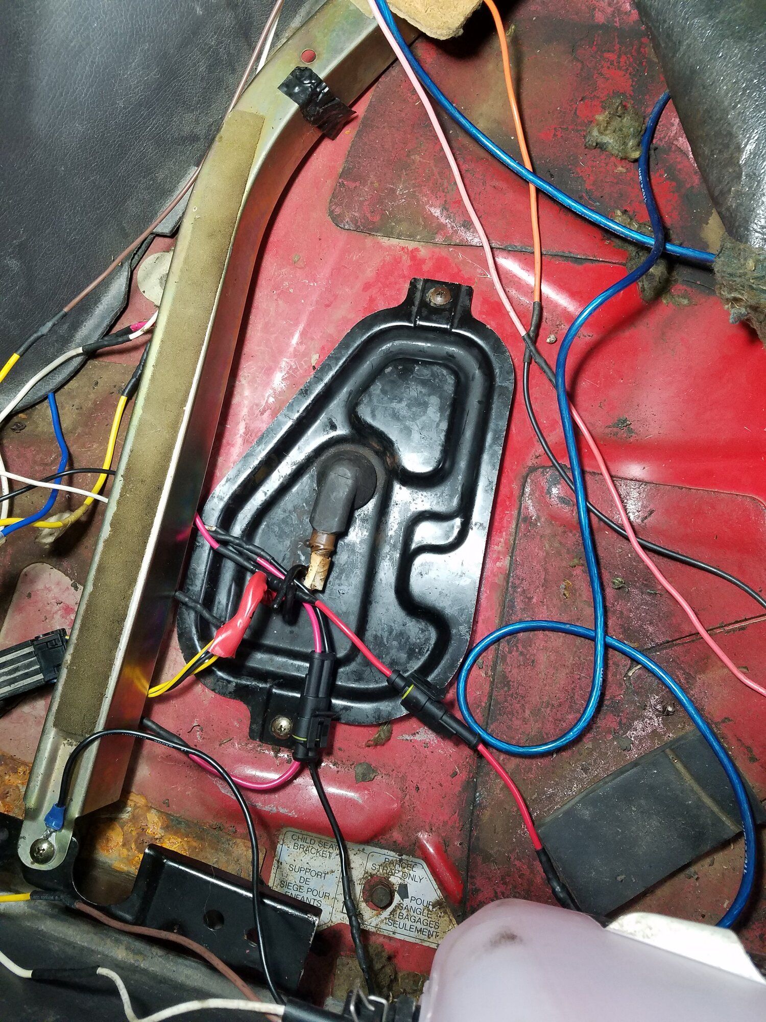

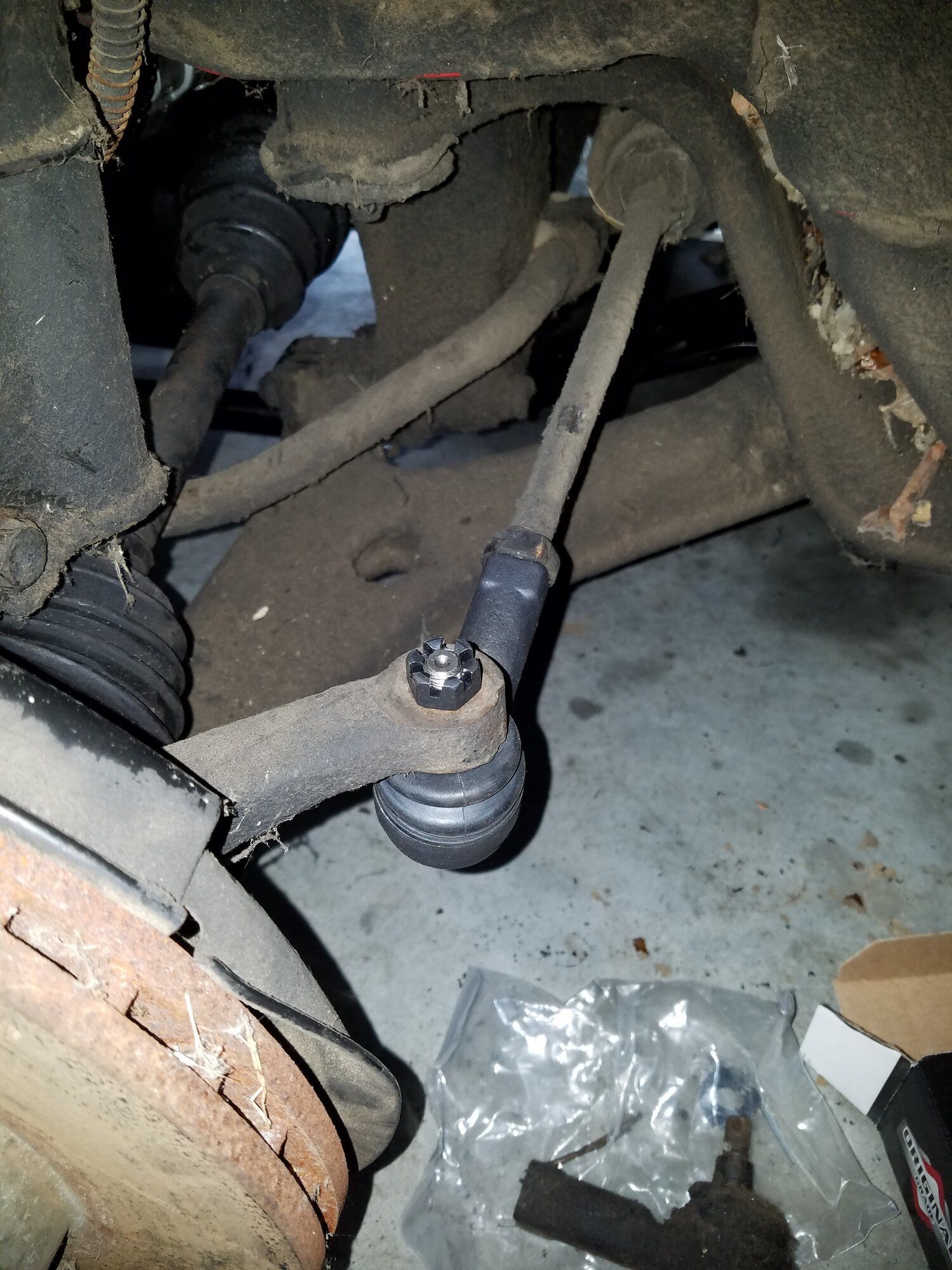

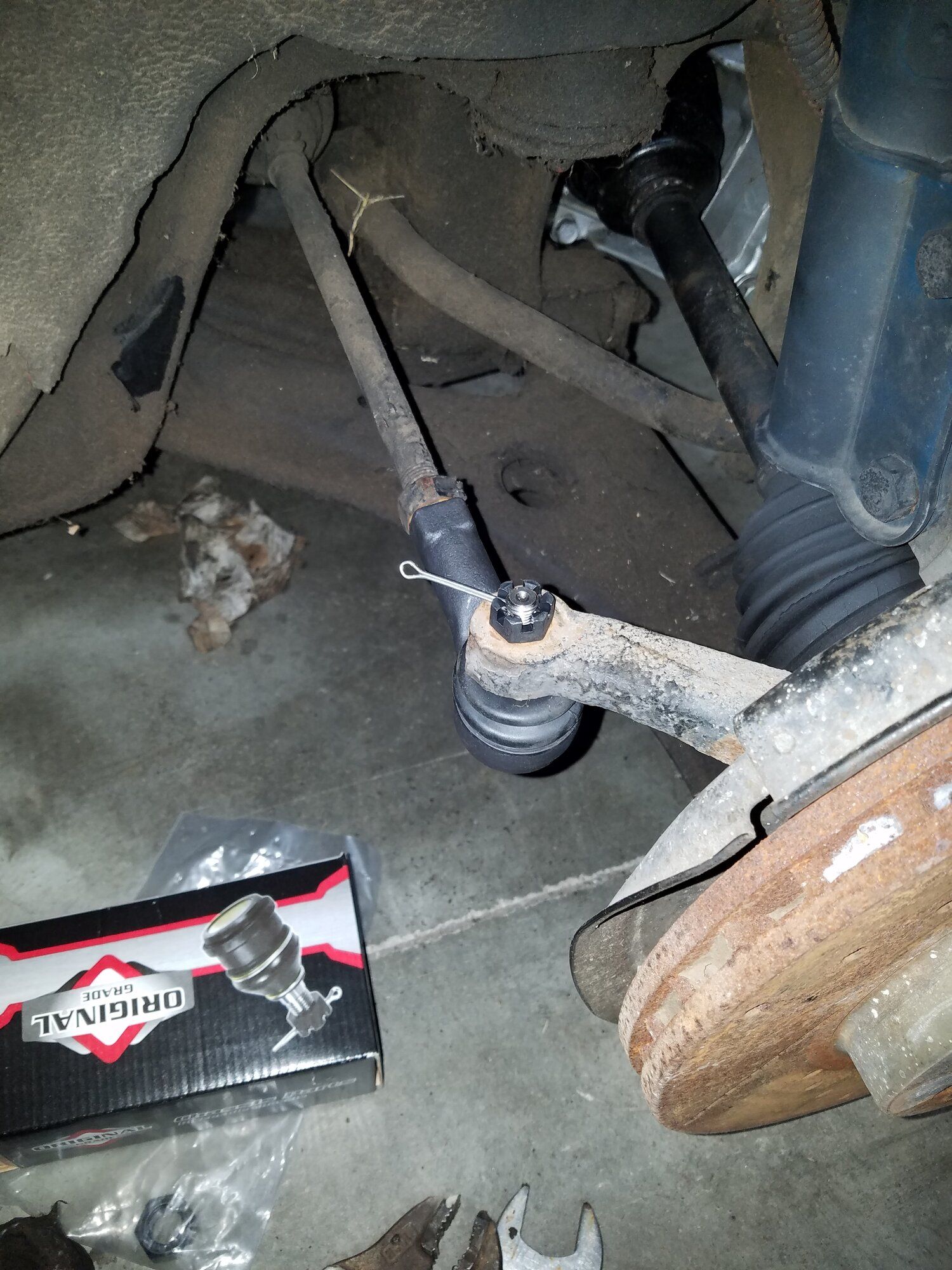

Fuel pump wired up and installed and 2 new tie rod ends on the Talon.

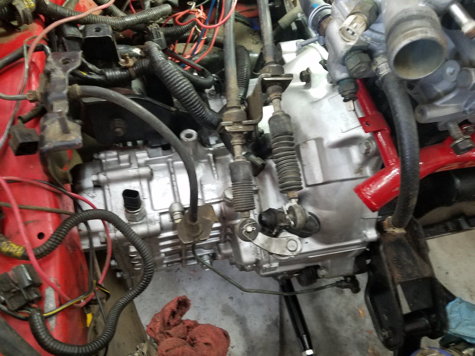

I pulled my FP to reposition the wiring and found a new tank gasket (I have more coming in) I had so that got done today, the 8AN line to the rail is buttoned up, tie rods greased and tight, passenger side trans mount mounted, shifter cables bolted on, brake lines checked for leaks, blown out slave reassembled and bled, twin disk checked for movement (yep it moves, yep its stiff), heater hoses tightened up.

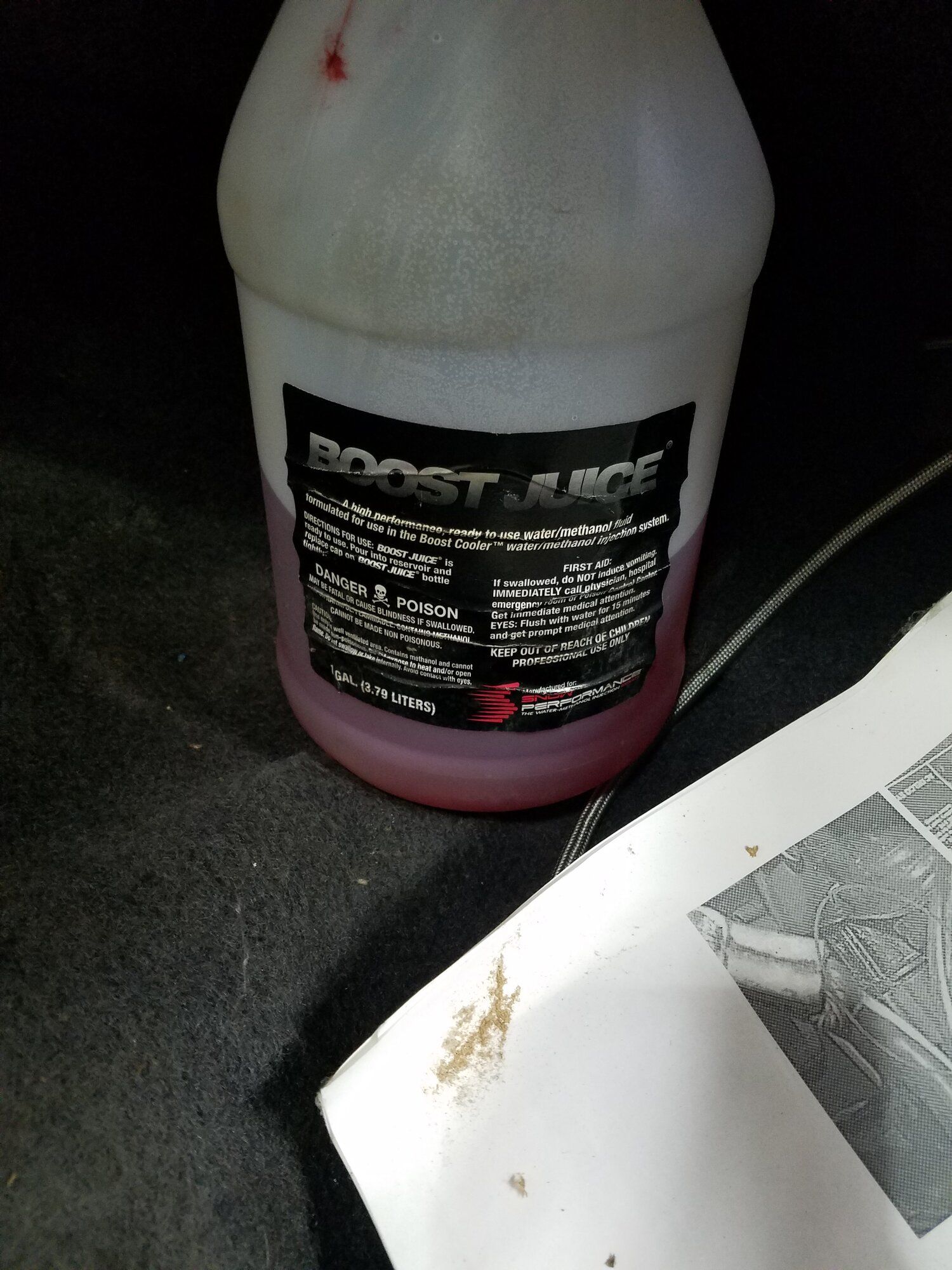

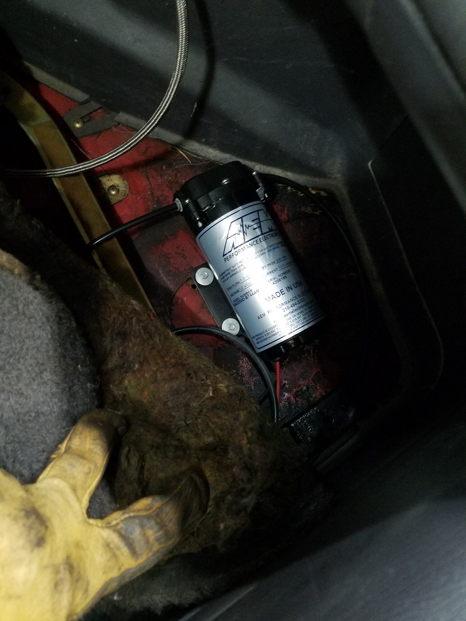

Mine is tucked in the drivers rear wheel well since the passenger side is hogged up by some huge, unusual Methanol pump....:idontknow:
It had been sooo long since I had been in that car that I had forgot that it had Water/Meth installed. I run E now! :cool:

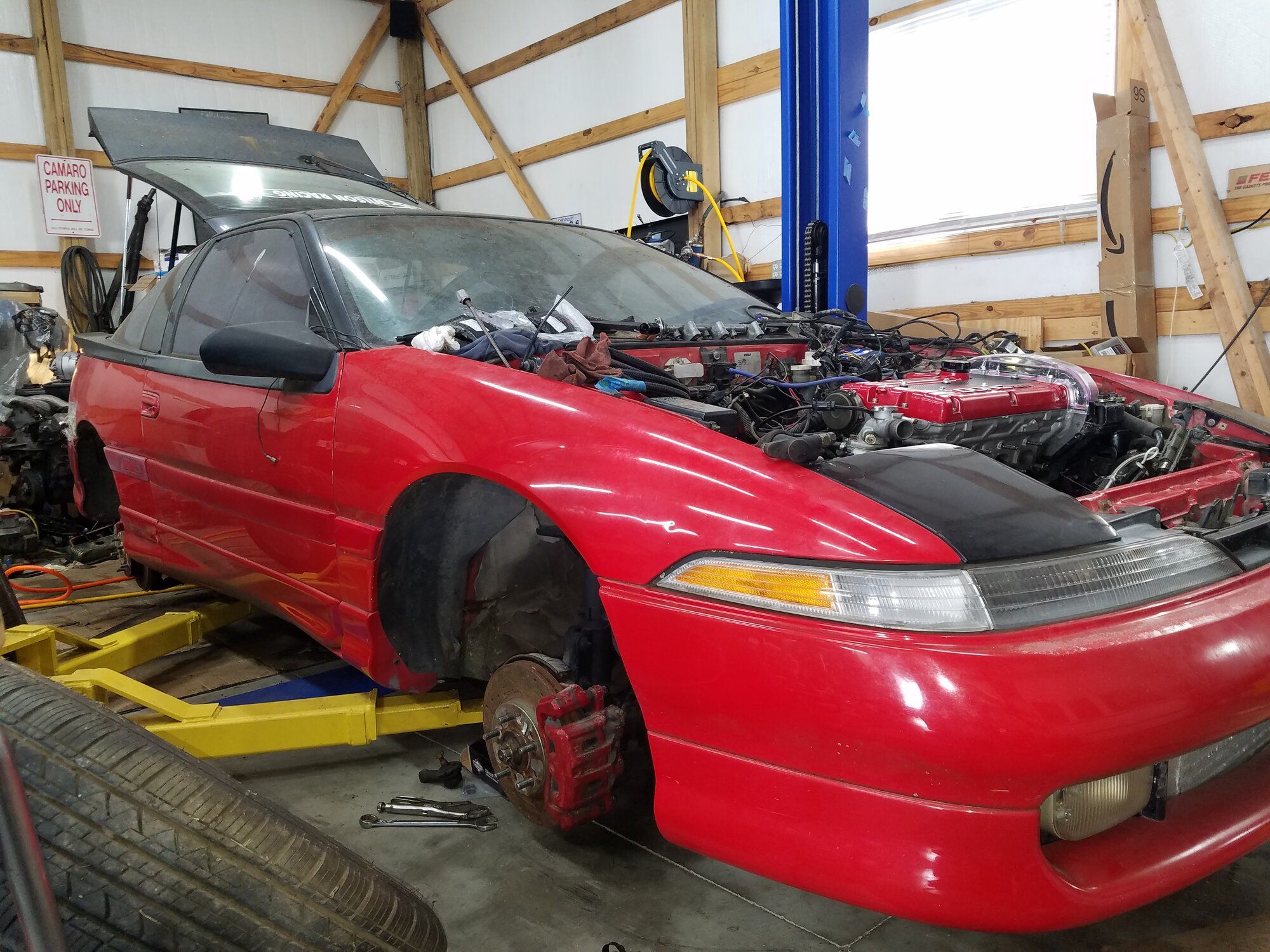

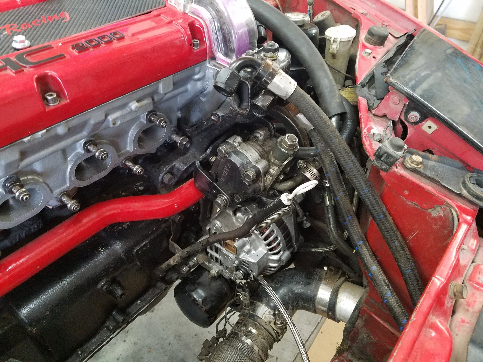

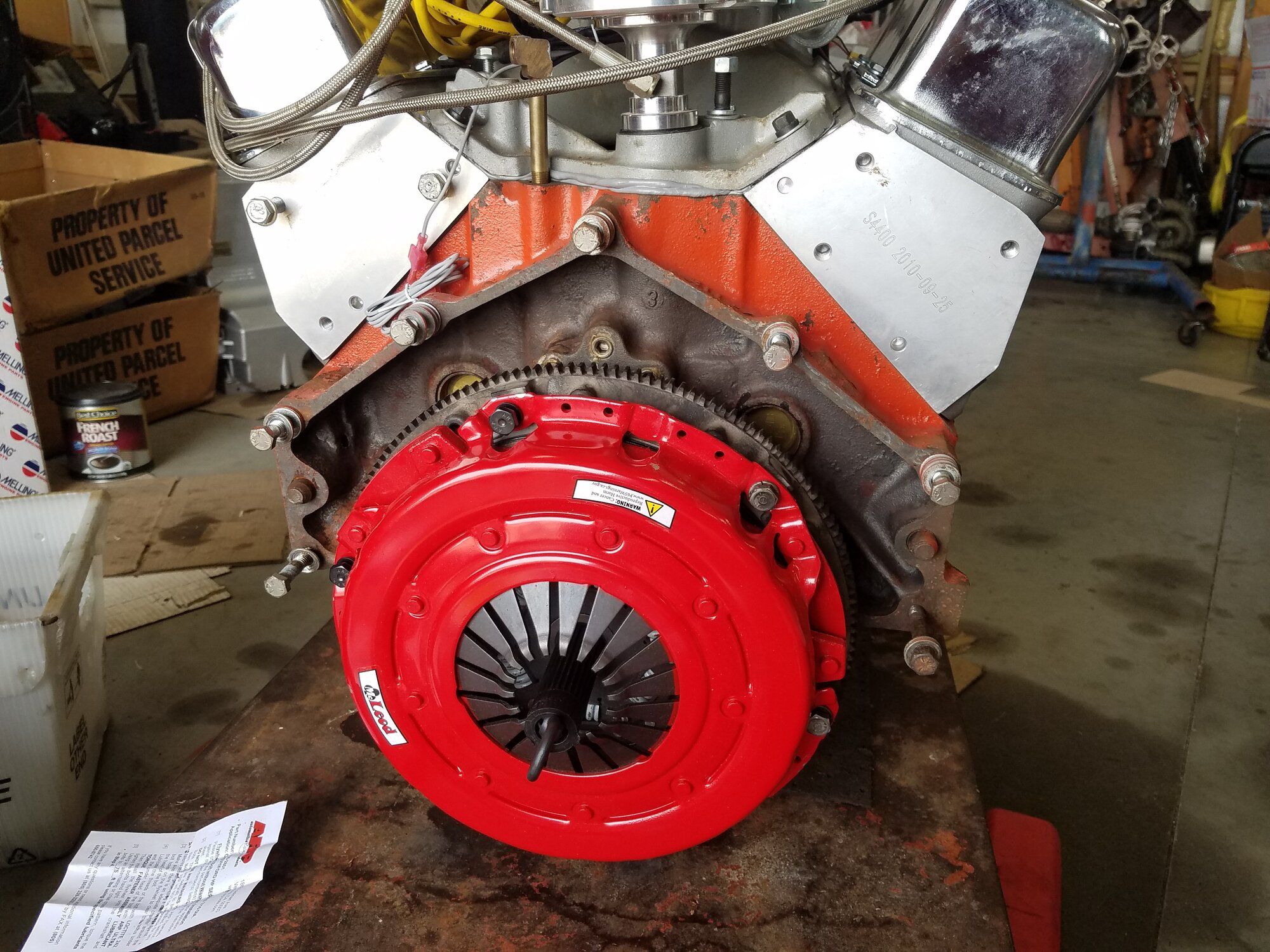

Well my "plans" for the day kinda went sideways. I got the PS pump and Alternator mounted (wrong side of motor, I know). Spent the best part of an HOUR searching for the ARP exhaust NUTS which about drove ME NUTS. Finally spotted them in a box set back behind other engines, so I put ALL the hardware/fasteners in place on the engine today.

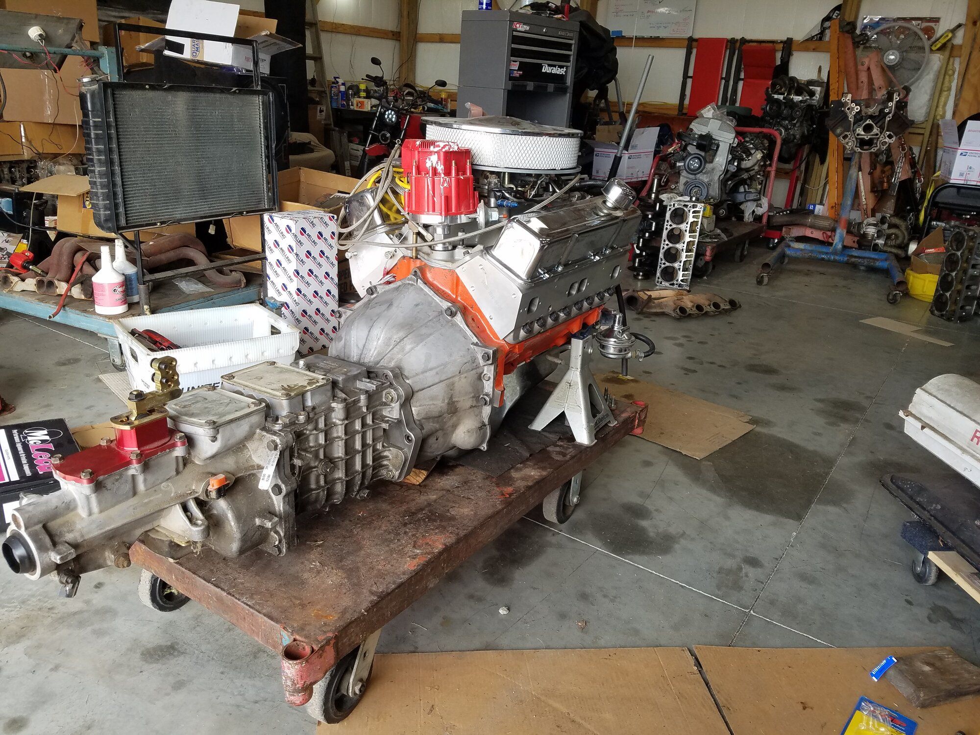

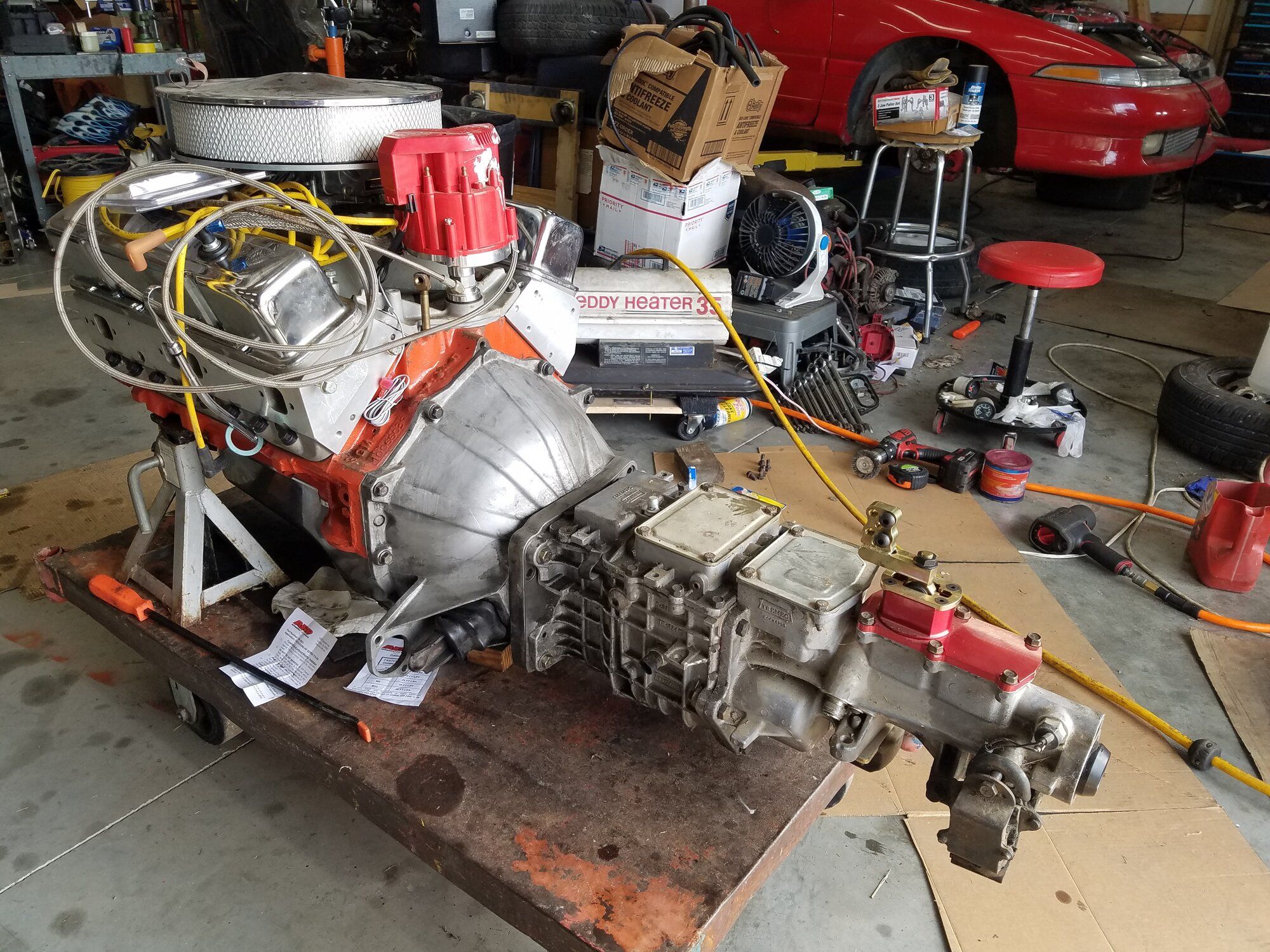

THEN, I helped my oldest son mate his Tremec TKO600RR transmission to my LT1 clone SBC that has all the "goodies" in it (Eagle, SpeedPro 11:1 bottom end).
He has a real nice McCloud clutch setup and all the adaptors for it to go into his 86 Z28. I don't have a car to use it in so he might as well run it. It ran real good with my 10:1 motor in it. This motor is much healthier.

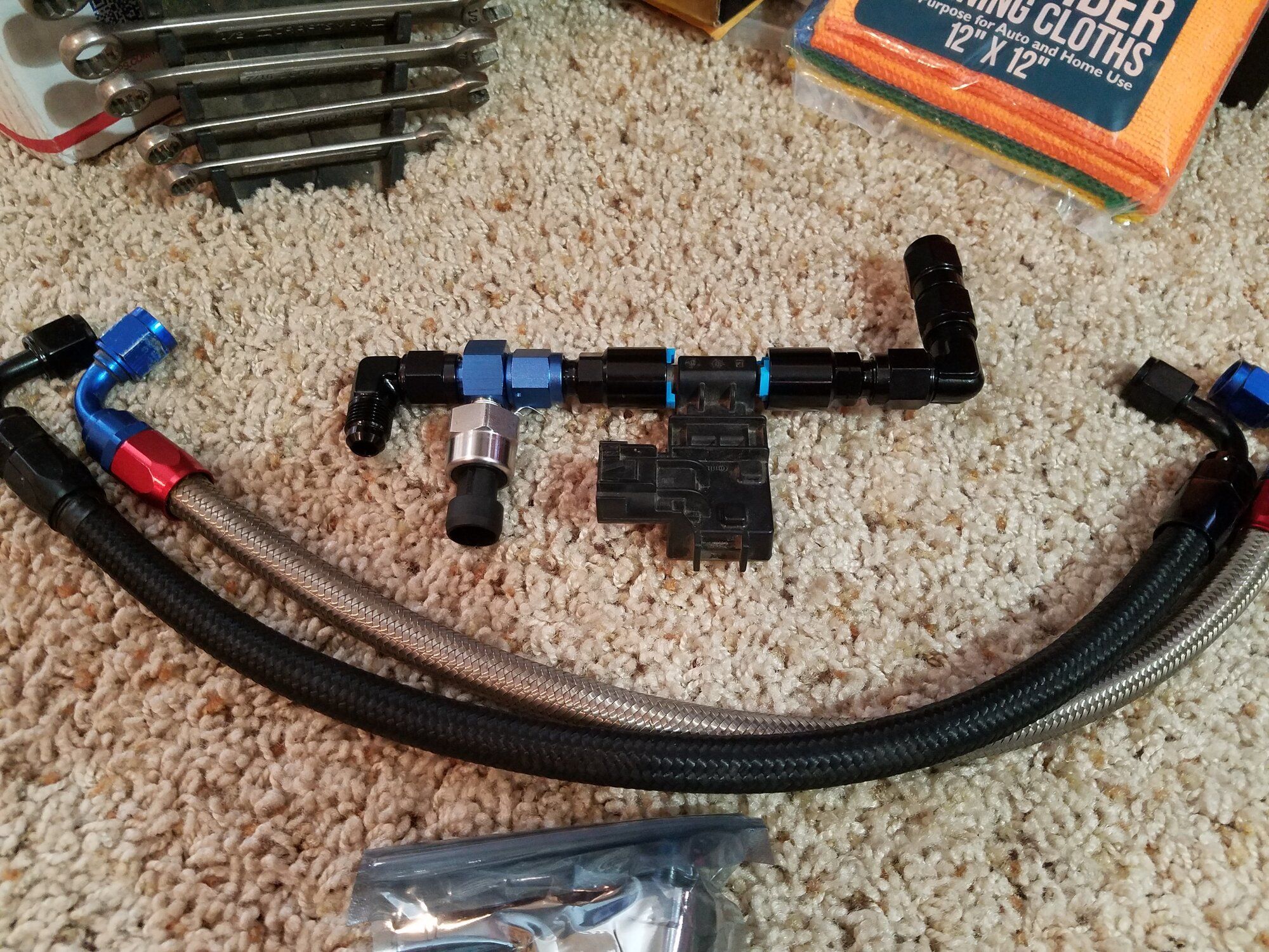

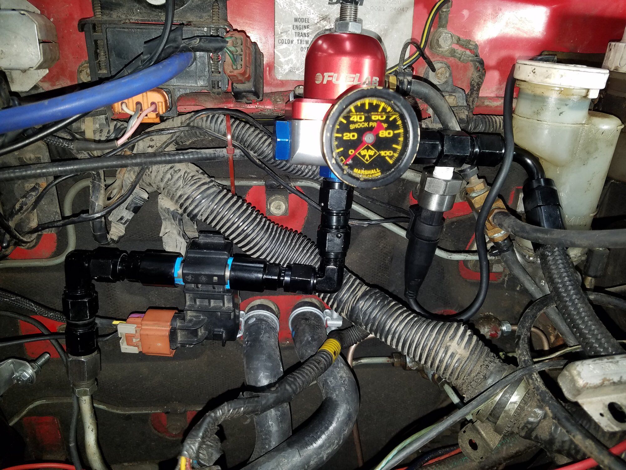

While it doesn't look like much (but about $100 of fittings), I swapped my old fuel feed line over to my complete hardline return line, no rubber components. The car has all new 8AN feed plus I had the conversion fittings that I had used on the original feed to go to my 6AN Fuel Filter (that is now 8AN also). Now I can start to assemble the intake side of the motor, I think.
Little by little (but still not cheap), I'm making PROGRESS so just hang In here with me, it won't be long. Hoping to have the old girl running in a month. 🤞
I have my Ethanol sensor and Fuel Pressure sensor all plumbed into the return side and feel good about it all.
Possibly tomorrow's project.
Shouldn't take long.

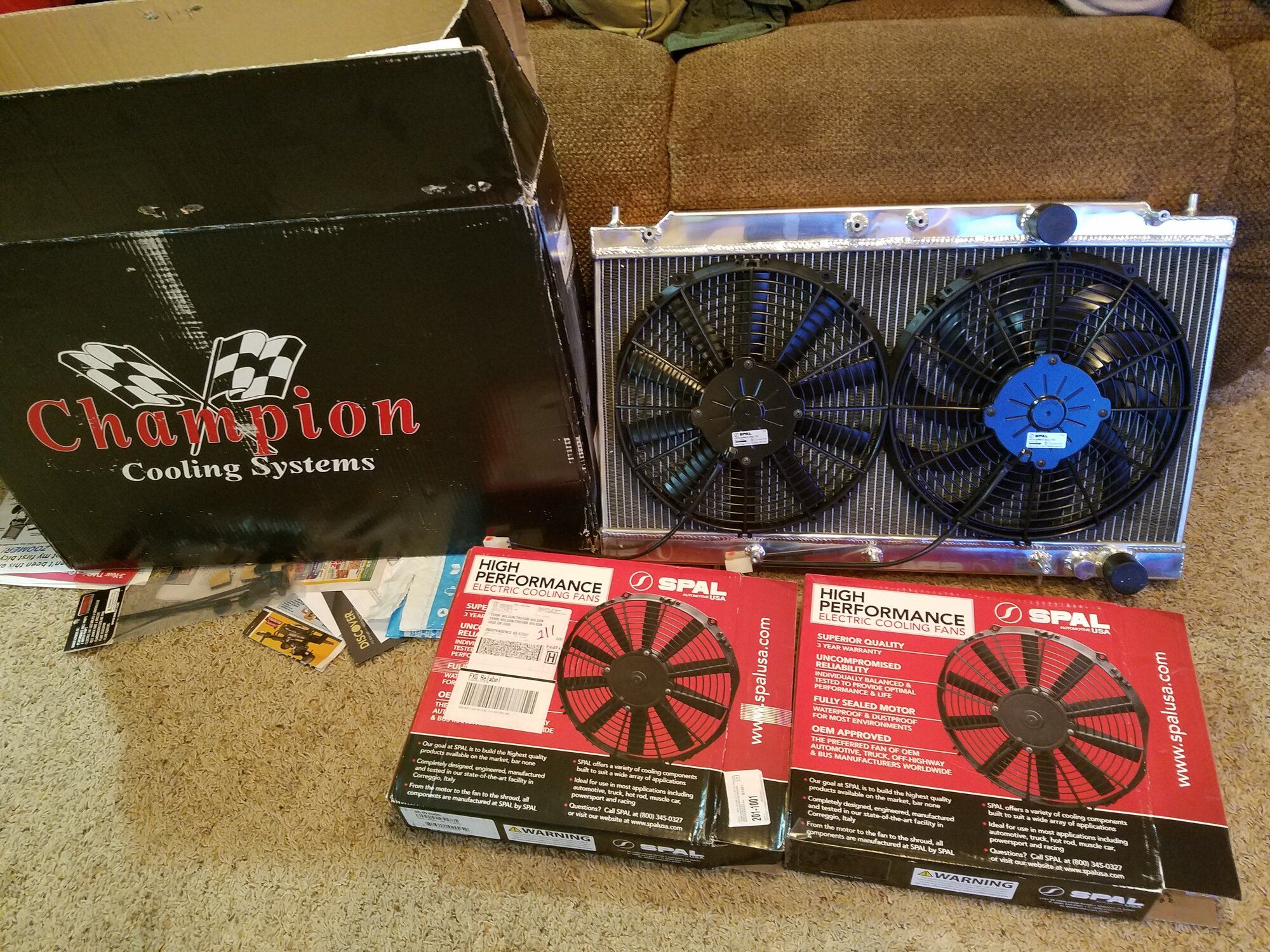

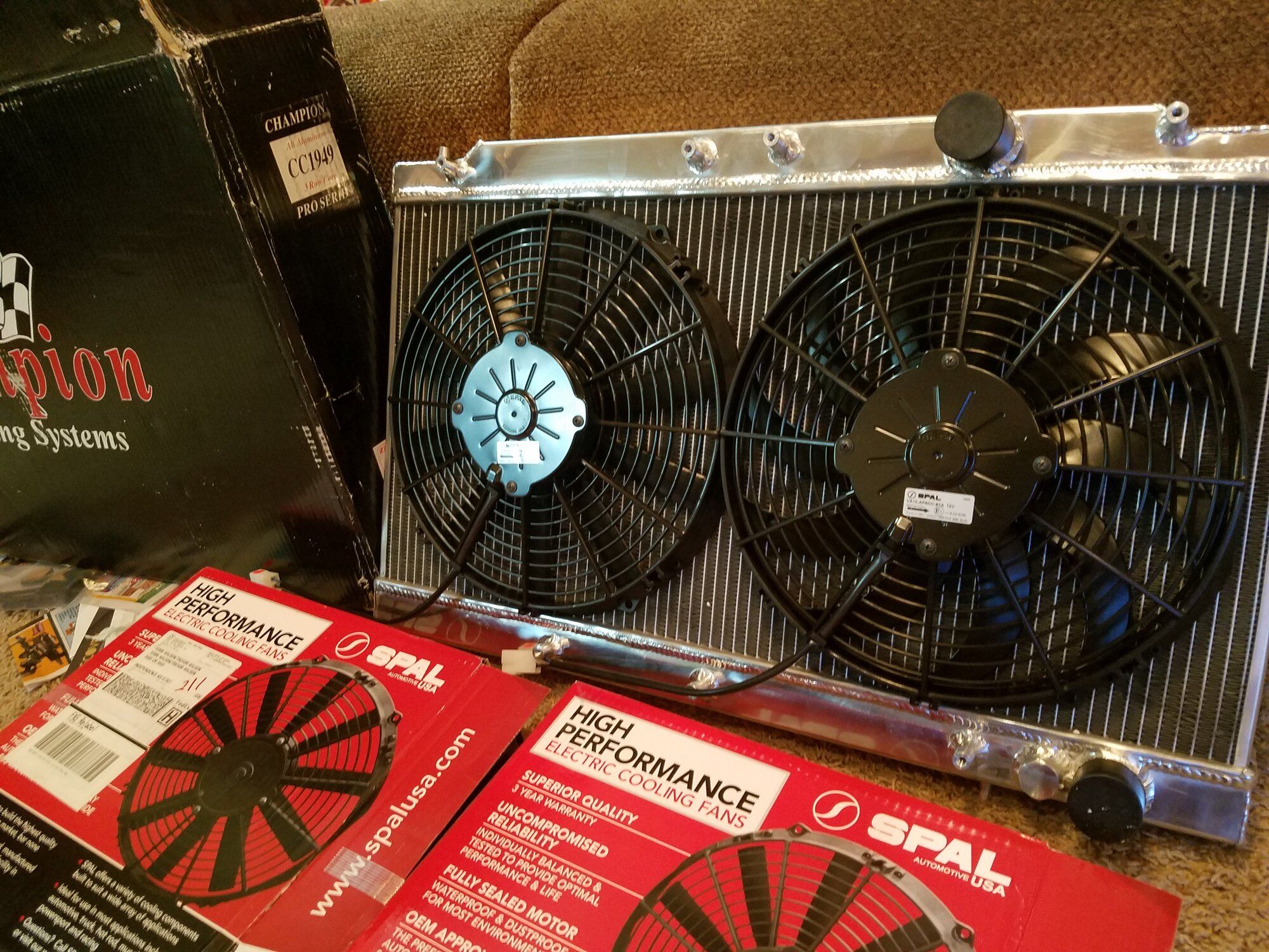

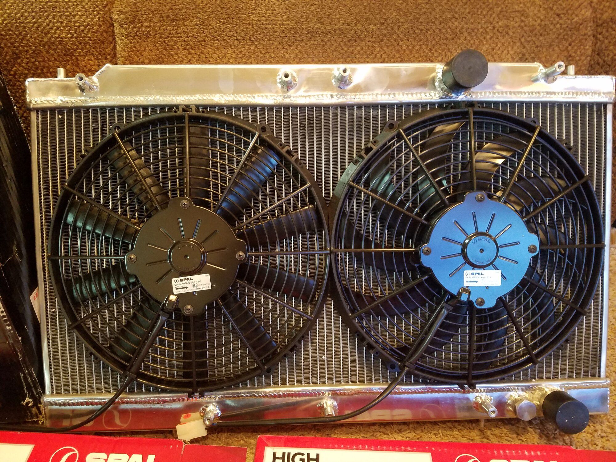

Champion CC1949 Radiator, 1 Spal Curved Blade Puller and 1 Spal Straight Blade Pusher.
A couple $'s there too.......
Still PROGRESS at least. :thumb:
This poor car got all of her goodies taken and put into the Blue 92 Auto car so NOW SHE GETS NEW STUFF!!!
The PUSHER goes on the other side, of course, but that didn't make a good PICTURE! :)

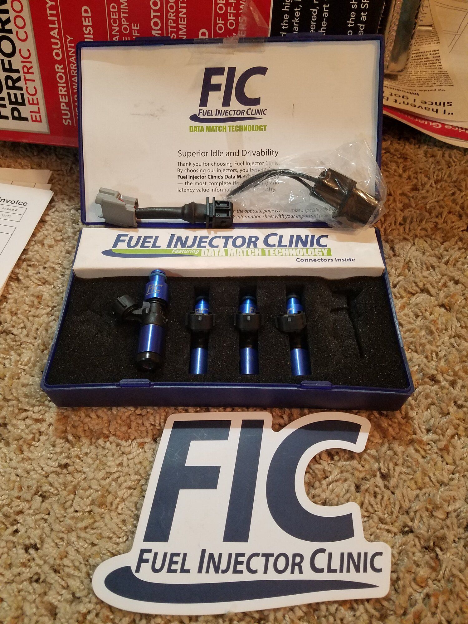

FIC 2150s since the Blue car stole those too :nono:ROFL
