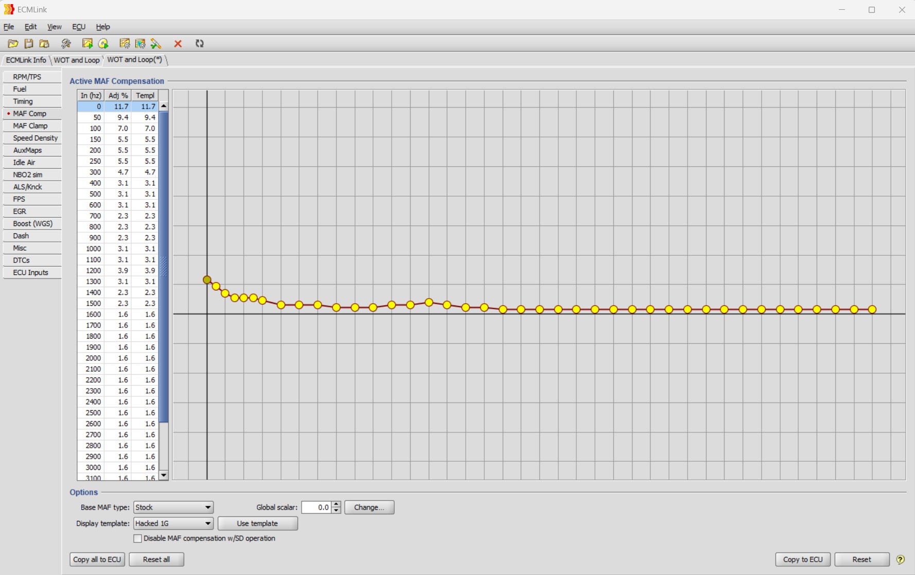

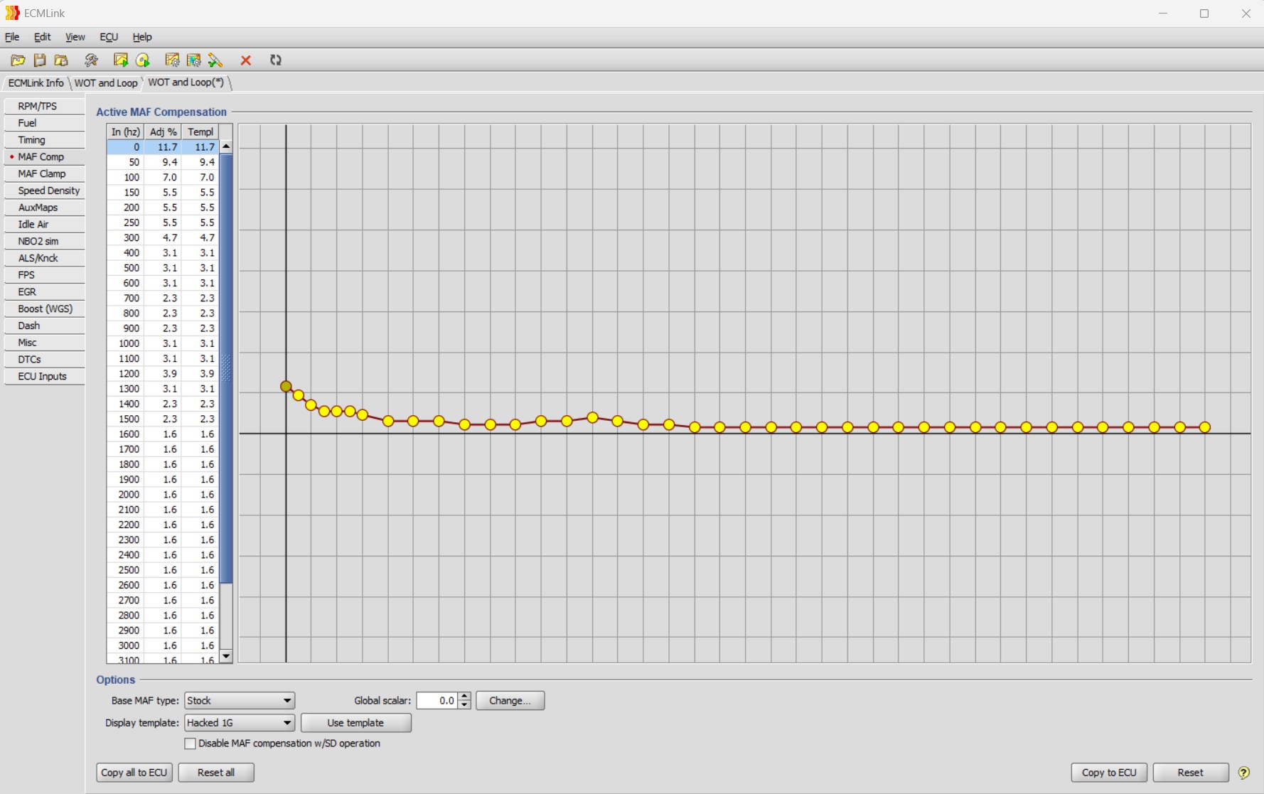

Well I really don't know, but probably for a next try, we should change the MAF Comp to be just exactly the same as the 1g Hacked MAF template. That will make it leaner actually, but maybe it will help. The closed loop fuel trims are big negative numbers which means that the underlying fuel settings are rich. At least in the closed loop regions they are rich.
To do that, go the the MAF Comp page.
Where it says “Display template” pick “Hacked 1g”

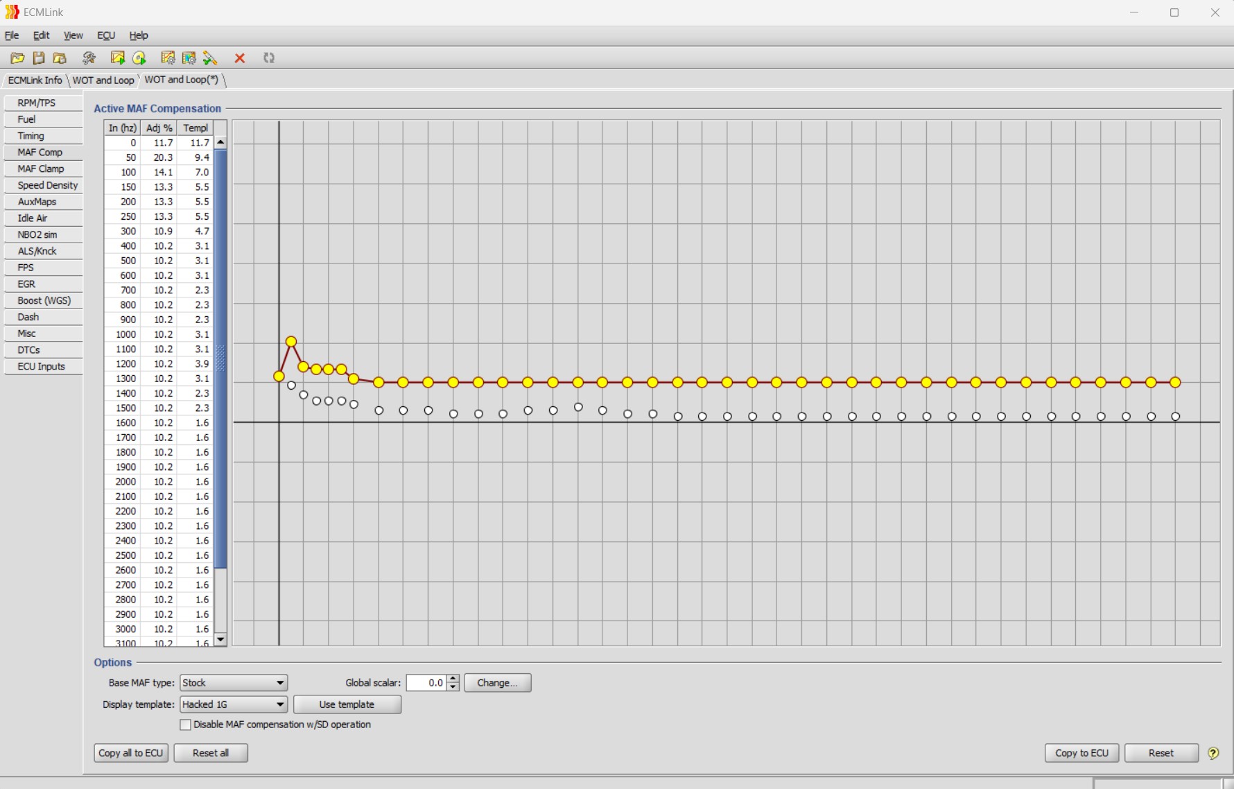

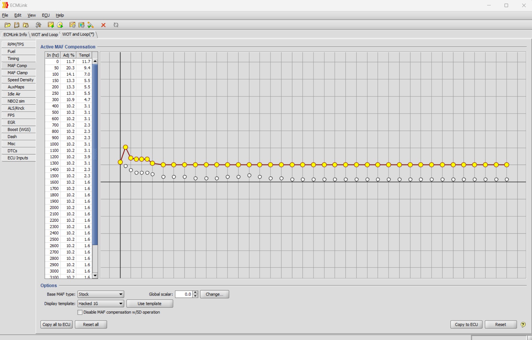

That should put a bunch of white blobs onto the map, exactly like in this shot:
Then pick “Use template”
That should move all the yellow blobs down so they are right on top of where the white blobs were. Just like in this screen shot. Then pick “Copy to ECU”.
If it gives you some wonky answer, don’t copy it to ecu. X out the page and bring the page up fresh. It should look exactly like this when you are done. You can even compare the numbers in the vertical chart. They should be the same:
This should make a difference in the way the car runs but it might still not be the droid you are looking for. But do the change, and then you could log another drive with some WOT pulls like the last log.

Okay just completed this and saved to ECU! I’ll go out now and make a log real fast
Okay Gary Here is a log of the WOT pulls not once did it break up all the way to 5k YAY!! But I'm also posting 2 video's with this, The one where I take you to the back of the car you can hear the break up I'm talking about at idle and when coming to a stop. Do not freak out LOL at the beginning of that video you hear the car vibrating its nothing motor related LOL! The second video goes along with the first pull in the log to show you boost gauge. i was only able to get those to as its hard to record and drive LOL.

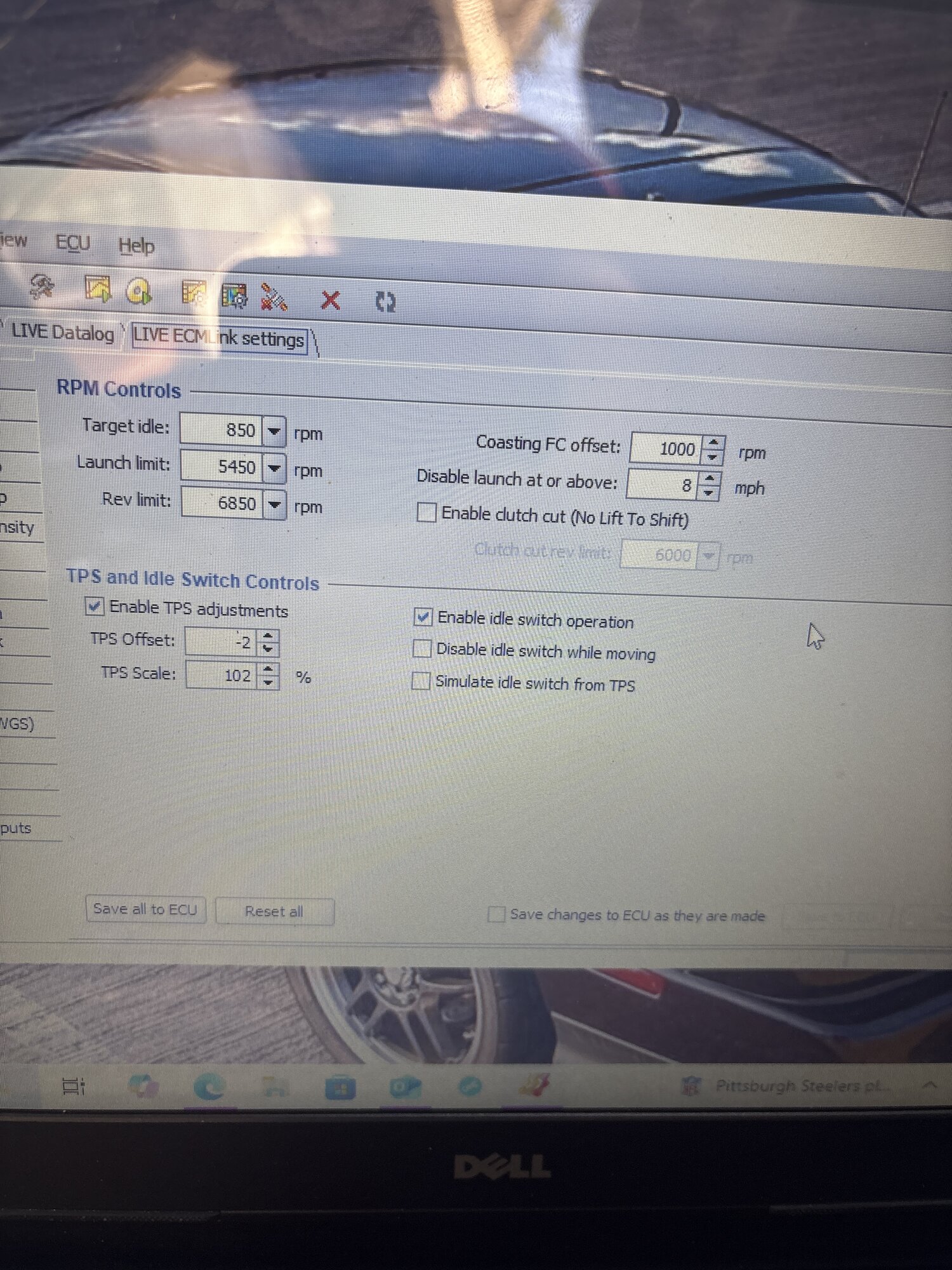

Before I forget, I noticed going back through your logs that all of a sudden, starting with the 1st drive with the 1000cc's, your idle switch (IdleSw) is not working. It's always 0. It was working before.
So this would effect your idle.
Since your TPS is scaled correctly now (I think) you can "fix" that easily.
Just check the box for "Simulate idle switch from TPS" and Save to ECU.
That will take care of it and you should notice a difference. Because the ecu doesn't know you are intending to idle unless that switch is working.
What's really happening though is that the idle switch pin is not working (IdleSwPin).
When you are simulating this thing, you should occasionally check a parameter called RawThrotPos. Displaying a raw value is a few steps, we can go through that sometime.
But the thing to check occasionally is to make sure RawThrotPos is 34 or less whenever your foot is completely off the gas. Yours is 34 now in this latest log, so it will work.
Even though your ThrotPos is 1% with foot off, the Raw is 34 so that will give you the simulated idle switch.

Simulated idle switch is working, good.
