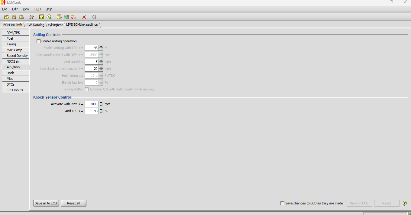

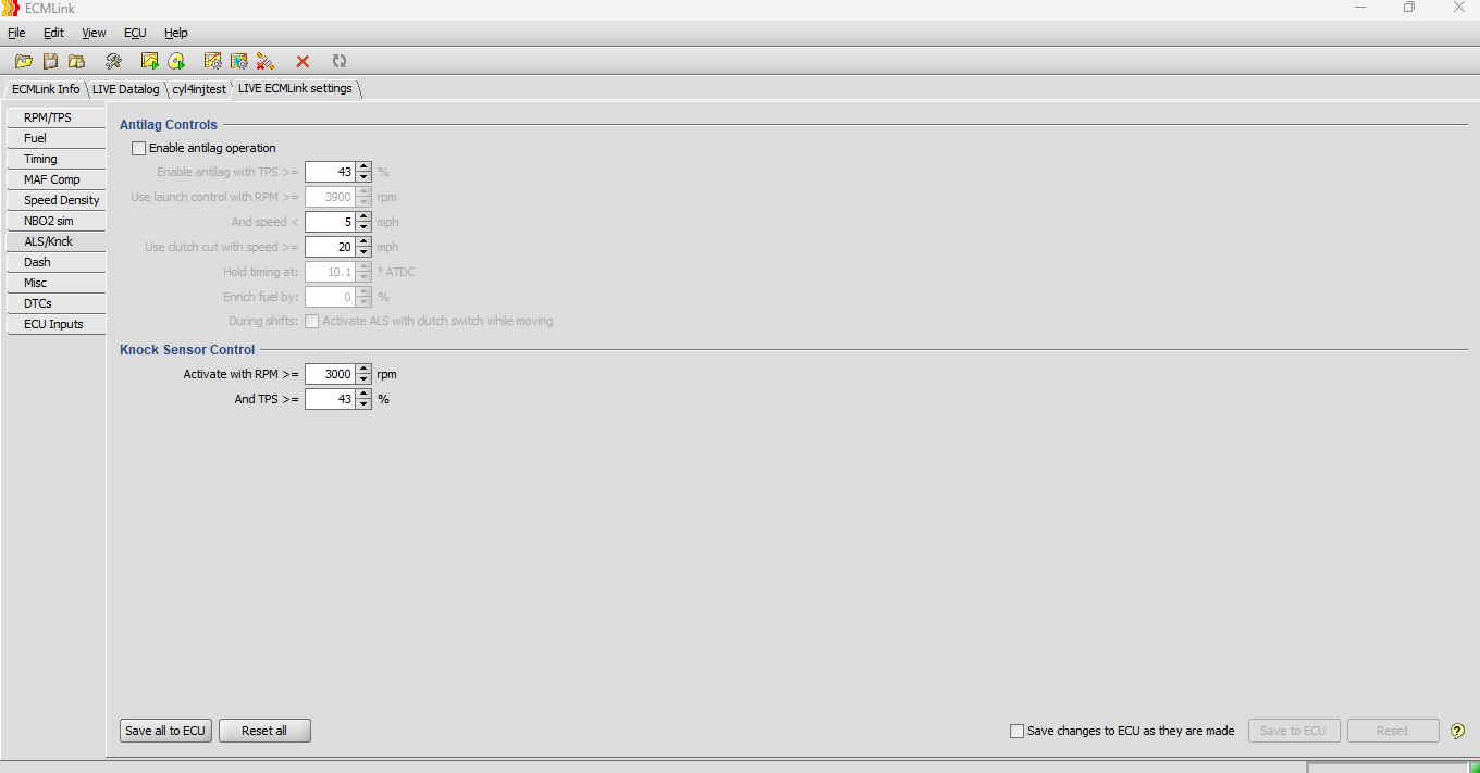

I see it was in there ever since Nick started posting and I didn't think it would activate. So turn it off and see if it changes how it runs in a pull. Hope it's better!
BTW is the boost gauge still in the car? Nick had one in there at one time as I remember.
Yes I have a boost gauge and Oil currently, and I’ll go turn that off now! What about the timing situation though?
Maybe you can explain though why it is coming on during a pull, with the parameters as they are, which has "and speed" set to less than 5mph.
To be fair it's not a pull, but if you look at the parameters vs the time in the log he says it occurs, it's enabling - albeit barely.

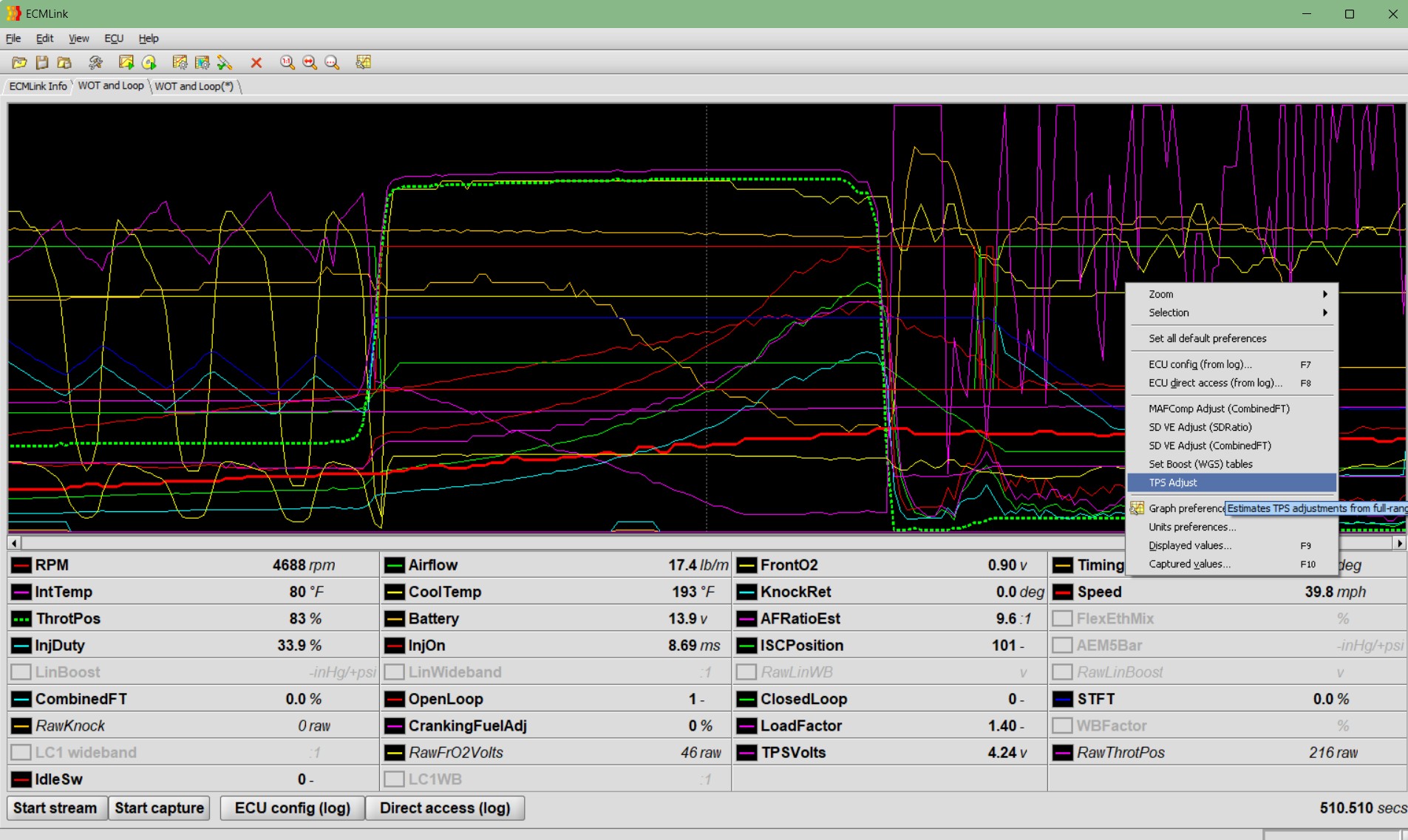

I did notice, I had the gas pressed all the way but the log said 83% which is interesting

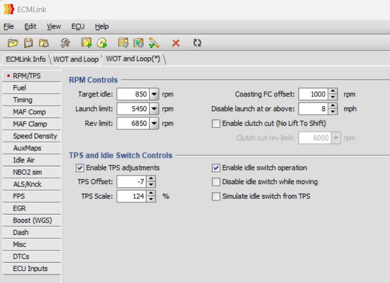

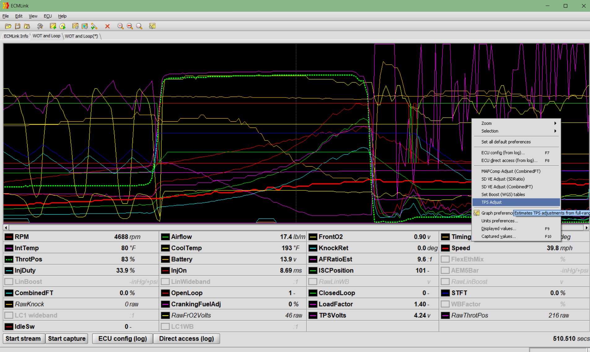

Right, with a right click on a live log screen, you can run the thing called TPS Adjust.
It gives you suggested values for the TPS offset and scaling.
Right click gives you this ( you pick TPS Adjust):
Then pick "Continue"

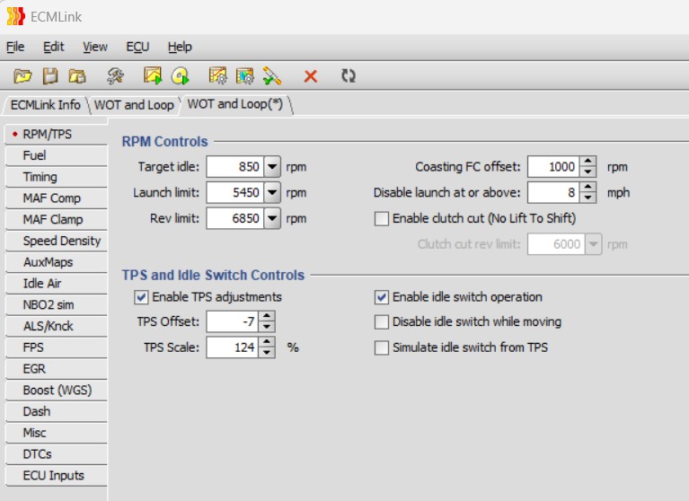

Then you'll see the suggested values like this :
Then you pick "Save to ECU"
Okay and to clarify it has to be a live log car running?
