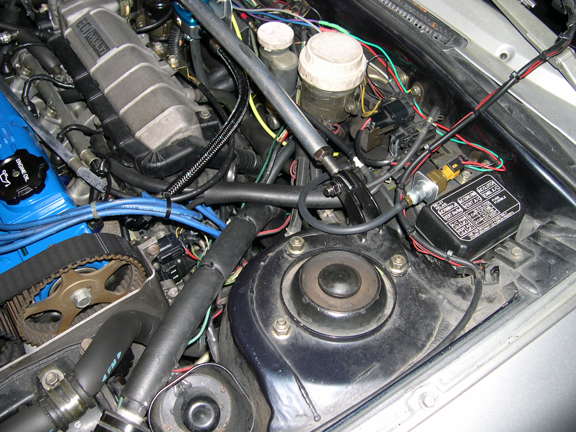

I did a whole bunch of looking into this tonight, and I don’t think you should buy a sensor type gauge. Just get a MAP sensor and connect it to the ecu for logging. So then you’d be using the Mechanical boost gauge you already have as your real-time gauge, and the MAP sensor wouldn’t run any gauge at all, it would just go to the ecu for logging.
The reason I say don’t buy a sensor type gauge is because the ones I have looked at don't come with sensors that are good enough to use later in life as a MAP sensor to run speed density with. They are only good enough to run a gauge. So if you did switch to speed density at some point, you'd need to start all over again with a new MAP sensor.
I only looked at AEM and Autometer gauge kits though. So maybe it's not the end of that story. But it seems over the last few years that the AEM Stainless MAP sensors are the most reliable ones for running speed density. Unfortunately, the AEM boost/vacuum gauge comes with the brass MAP sensor which even AEM itself says is not good enough to run speed density. And people in here generally aren't using the AEM Brass ones to run speed density. They are using the stainless ones.
Autometer, their sensor type gauge uses their part # 2249 for the sensor. That sensor looks exactly like the omni-power sensors that have been getting a bad rep in here lately for too many failures. And whaddya know, the top customer comment on their own page for the # 2249 sensor says he has had 3 of these fail in 2 years and he is going to go back to a mechanical gauge. That's about like what we've heard from a few people in here about the omni-power sensors. So I wouldn't go that way.
Ok the other thing is, the AEM stainless MAP sensors cost around $165 right now and that's from Amazon. They don't even give you a wired connector with pigtails to go with it. They give you a connector kit which has the metal pins, the plastic parts, no wire, and some instructions, and you put it together. It would be easy for a first-time doer to trash one of these expensive sensors just by wiring it wrong or some other mistake. You have to find a 5 volt source on the car to run it with - which, people in here can help you with. I've forgotten it's been so long.
So one way to avoid that expense and risk - I could send you the AEM sensor that was on my car for a few years, which I had wired into my logger just for logging. I didn't even have a gauge on it. I mean free, sort of, just the cost of shipping. It's the 3.5 bar brass one. The same exact sensor that you would get if you bought the AEM boost gauge. I could test it at home before sending it. That would be just hooking it up to 5 volts and ground and measuring the signal voltage which should be about 1.67 volts or a hair less at my altitude which is 500 feet.
So that is a sensor that you wouldn't want to use someday for speed density (because it's the brass one), but it would be an inexpensive way to go in the meantime and if you blow it up LOL it didn't cost much. It uses exactly the same wiring, connector, and mounting style that the stainless one uses, so making a swap to the stainless sensor would be pretty easy.
I have a couple of the AEM plug-and-pin kits so I could send you one of those, but I'd advise buying one that's all put together with pigtails, from a place like Casper's Electronics which has been around for a long time, and I've gotten one or 2 connectors from them before. I think it's this one. I have a product inquiry in to them about it. Maybe there are other places too.
No matter which way you go - sensor type gauge kit or just a sensor - you have to look for a place to put it in the car and mount it and do some wiring and some hose running.
When I had the brass 3.5 bar AEM in my car it looked like this - this is the sensor I would send you. It's near the right edge of the pic, it has "50 psia" stamped onto the brass wrench flats:
DSCN1736  can see the 3.5 bar brass MAP sensor, fuel rail outlet fitting and hose and Fuelab A...JPG
