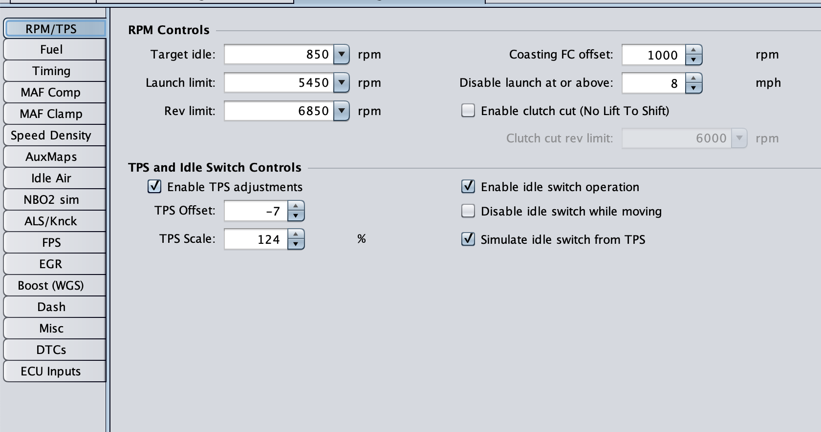

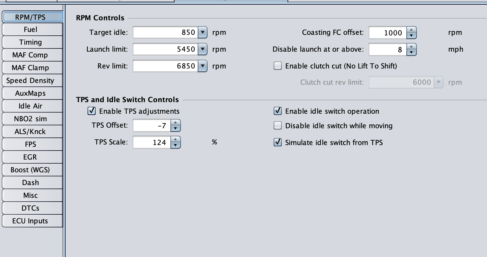

Sure. Its in the first tab under RPM/TPS, at the bottom where it says TPS and Idle switch controls. IVe never used it myself as ive always just loosened the bolts and physically turned i til i got to 0.63. So i cant tell you exactly what to set it too, but im almost sure that you can move that -7 for the offset in one direction or the other and then record a log to see where your at what it is now set to. But hopefully someone else can chime in and be more specific.

So I tried this morning doing the TPSAdjusment on ECMLink with a log like we did and it keeps showing the same numbers that are currently their so not sure what to do for that LOL, I was about to go back out and try the BISS method and see if I can get the throttle to 0

The IdleSwPin did work at one time, because I'm looking at an old log right now and it goes to 1 like it should.
But you could also just do what you suggested when you said to manually change the number for TPS Offset (the number that is -7 now). Move it just the minimum one way or the other, whichever way gets ThrottlePos to 0. Then check RawThrotPos to make sure it is 34 or less. I like to have that Raw number be 33 or 32 so there's a little wiggle room there in case things move around a bit. Actually my Raw number right now is 31 and my ThrotPos is still 0.
Then you could just use the BISS to make the actual idle speed whatever you want and to get ISCposition to come out right.
Then you would have to keep an eye on it as time goes by, because if it drifts, that means that whatever is going on with it mechanically is getting worse and won't stay stable until it's cleaned up / fixed.
I think what OhhShmit did in post #608 was he tried running the automatic scaler again and it just gave him the same numbers that were already in there. So that's when you manually twiddle with the TPS offset until you get the 0 end good. Then you would check to see if you still get 100% at the other end and if you don't, you would manually twiddle the other number, the "TPS Scale" number.

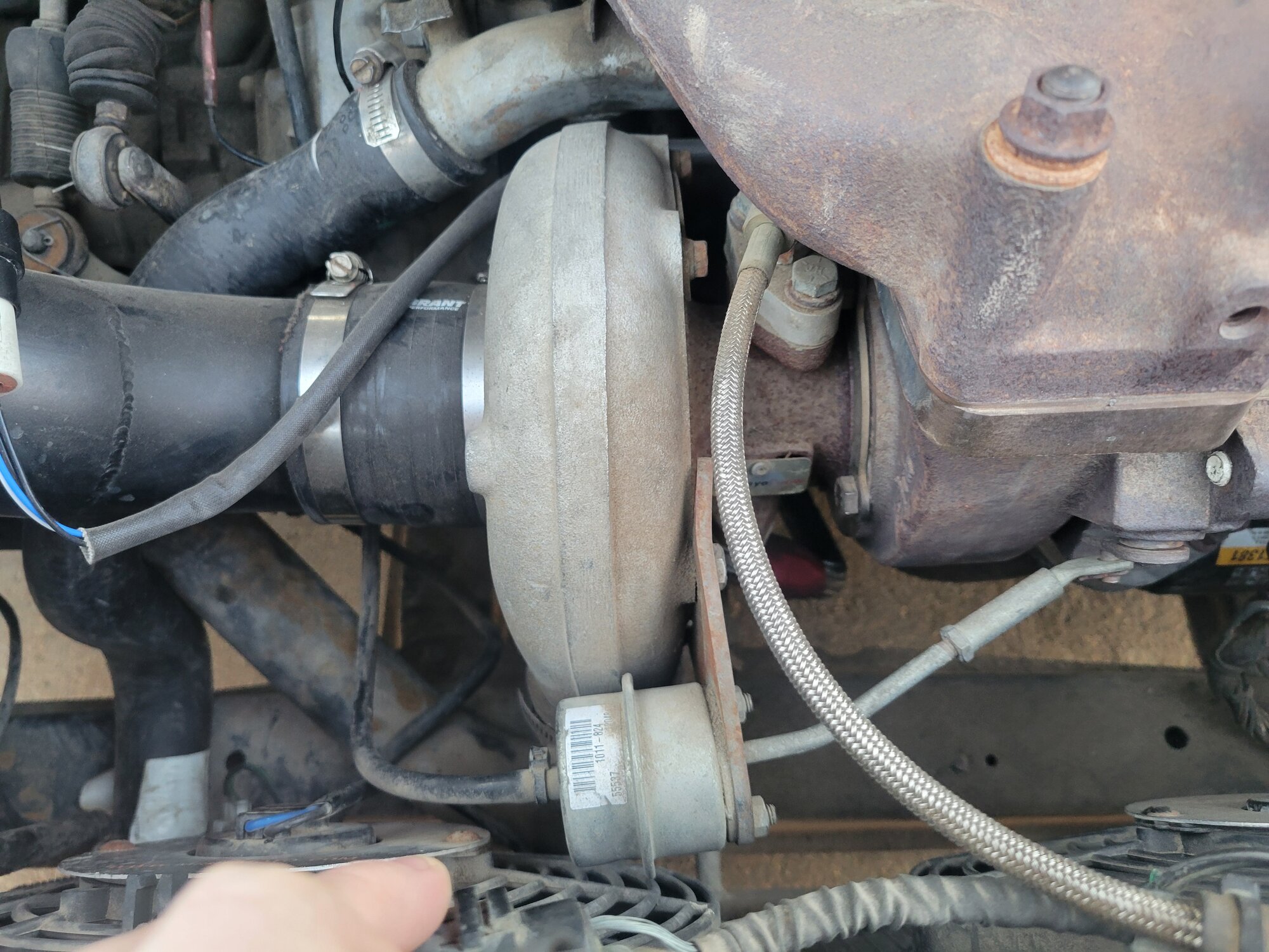

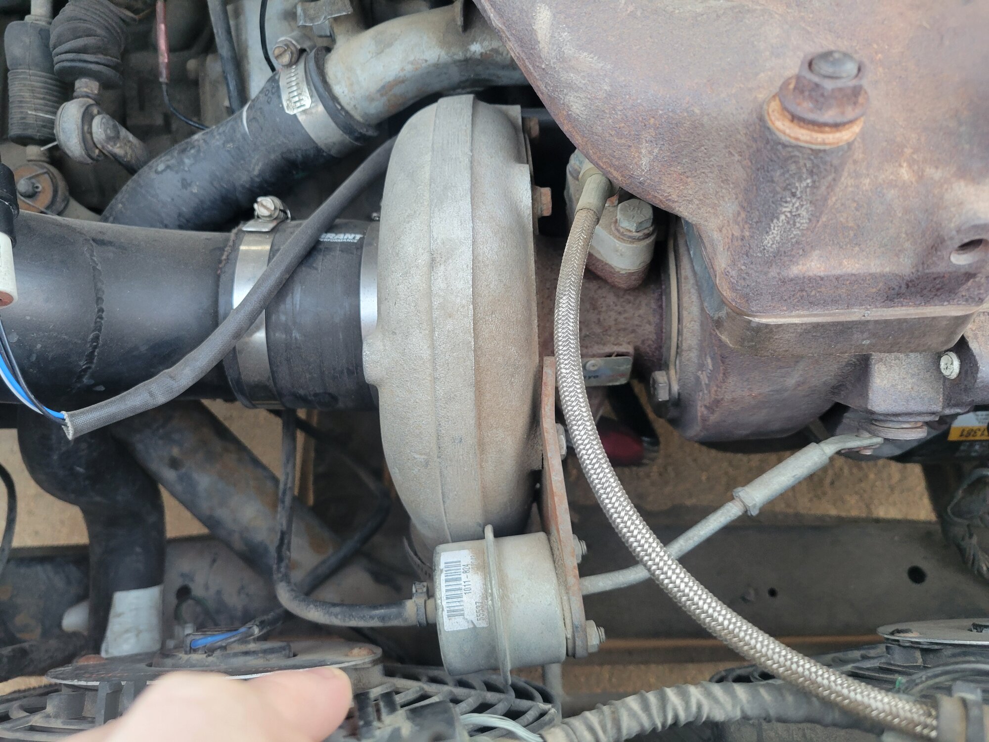

So, there’s a test we should do now. You should take the wastegate hose off of the wastegate and log 1 drive like that. When the wastegate hose is disconnected, that is maximum boost configuration. If you disconnect the wastegate hose and all of a sudden it is boosting strong and early like it was before, that’s good.
As for whether to plug the end of the hose or leave it open – it would be much better to plug it in some secure way where the plug can’t possibly get sucked up the hose and maybe into the engine during vacuum, or get blown out during boost. Should probably be something with a large enough head that it can’t get sucked in, and tied on with a zip tie or hose clamp so it doesn’t blow out.
With the hose end plugged, your BOV will still work.
If you don’t plug the hose end, I think the BOV will be a big boost leak.
It’s possible that the BOV is even a boost leak as it is already. I guess that’s why you were asking about putting an 18 pound spring in there. So that’s something to keep in mind.
Also if you don’t plug it, you would have a vacuum leak which would make the idle worse.
The boost gauge might still work. That depends on where the hose for it goes to.
You’ll have to be careful to back out of it if the boost goes really high.

And to clarify on the waste gate hose being unplugged and blocked, Only do 1 pull in the log or multiple?
You could do a few pulls. Enough to get a solid feel whether it makes the boost more or not.

Okay Gary here is the log from just now taking off that line and blocking it off, I tried to pay attention to the boost gauge at the very last 2 pulls and both times they almost hit 20psi if that helps any! I tried to be careful and mindful so sorry if I didn't get on it enough or to much LOL.
Well darn, that's a little worse if anything than the WOT pulls in the 2025.10.19-01 log.
Might as well put the hose back the way it was and we'll have to figure this out later.
