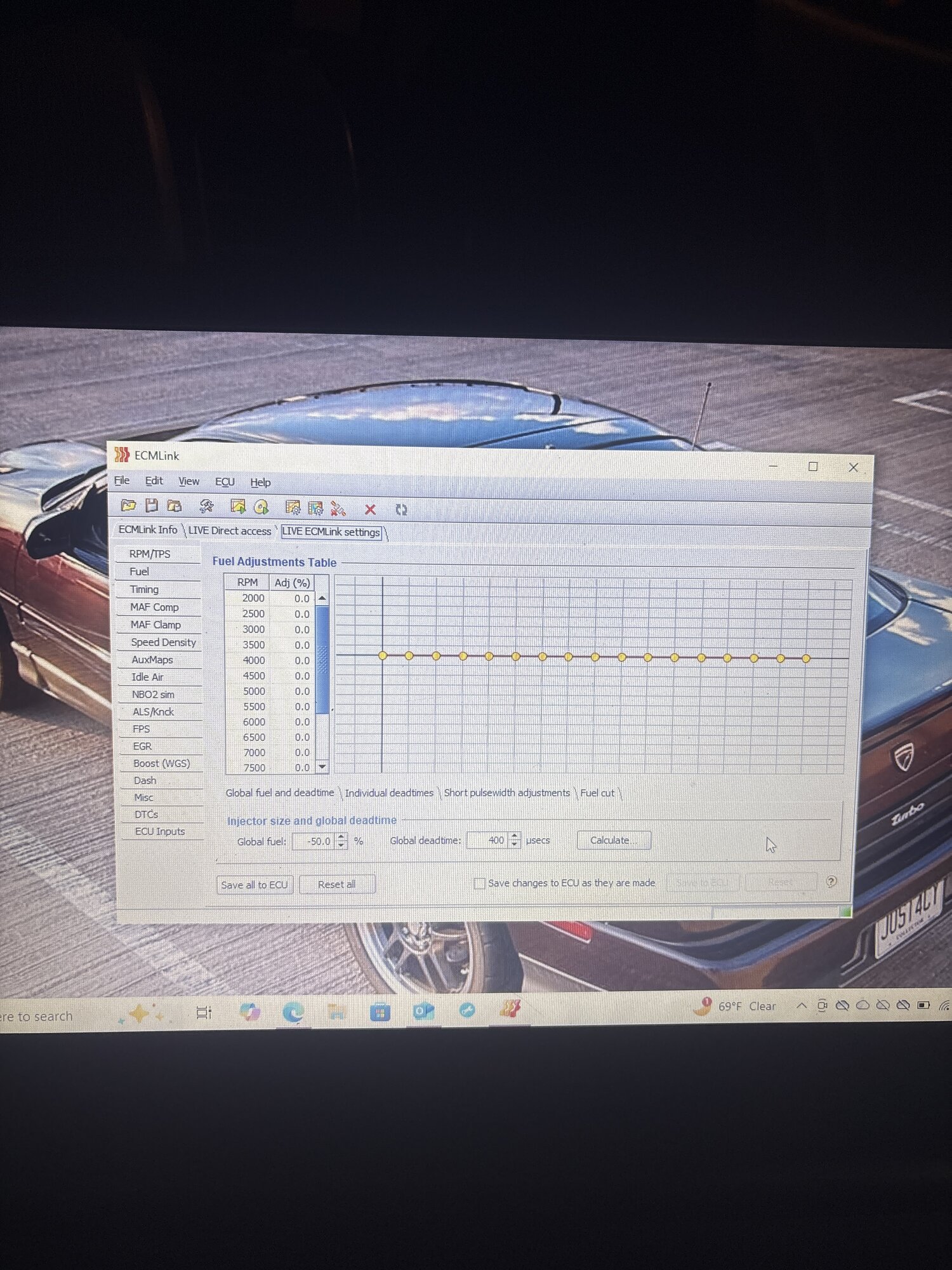

No don't hit calculate.
Did you already save the Global deadtime separately?
If you are still in it Live, I'd say just pick the box that says "save changes to ecu as they are made" since "save to ecu" isn't lit up.
No I ended up chicken out until you said something LOL I was really nervous as you can tell I refuse to make impulse decisions Lol I’ve learned to many times from that. So as of now it’s still 0 because once again I didn’t want to screw anything up
If you want to know whether you have saved the display of ISCPostion and CrankingFuelAdj, just make a short log with the engine not even running, and save that log, then open it up and look at it to make sure you can display it.
I did this exactly and they are there and showing now boss!
Oh ok, so with it Connected, go there to put 400 into the Global deadtime field again, and then, doesn't it give you a "Save to ECU" button? That would be the way to save it.
Okay I put 400 and hit the “Save to ECU” and I think it’s good and on their now
