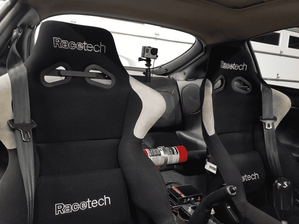

Very nice - I've got a suction cup mounted to the sunroof glass, but I would like to move it towards the back a little more to get the other side mirror into the view. Your setup could work. I've also got RaceCapture starting and stopping the video capture via Lua script WiFi remote emulator. I'm running a GoPro4, and will also hard wire the power.
I'm not sure how the 4 is, but the hardest part on the 3 was getting the camera to power on (not record) with the car. I used a little script on a GPIO on PiLink to activate the ON pin on the GoPro's connector. You have PiLink, right? It would probably be better to just get John's camera, much less fuss that way. You lose the feature of RC starting/stopping recording, but for track use I always have to sync up the data and video anyway since they don't perfectly line up.
My Pilink is already maxed out for connected features. - The GoPro4 is working well. Even when the camera is "Off" the WiFi in the camera still active (blue blinking light), so the WiFi remote emulator script powers on the camera and starts the recording (red blinking light) no issue. The only setup I have left to do for the in-car forward view is power. I think I can tap a 12v source for the sunroof, and connect a 12v to 5vUSB converter, and then connect the USB power supply to the camera. This way even if the camera battery is dead, the power to the camera will keep the WiFi on, waiting for a remote on signal from RC.

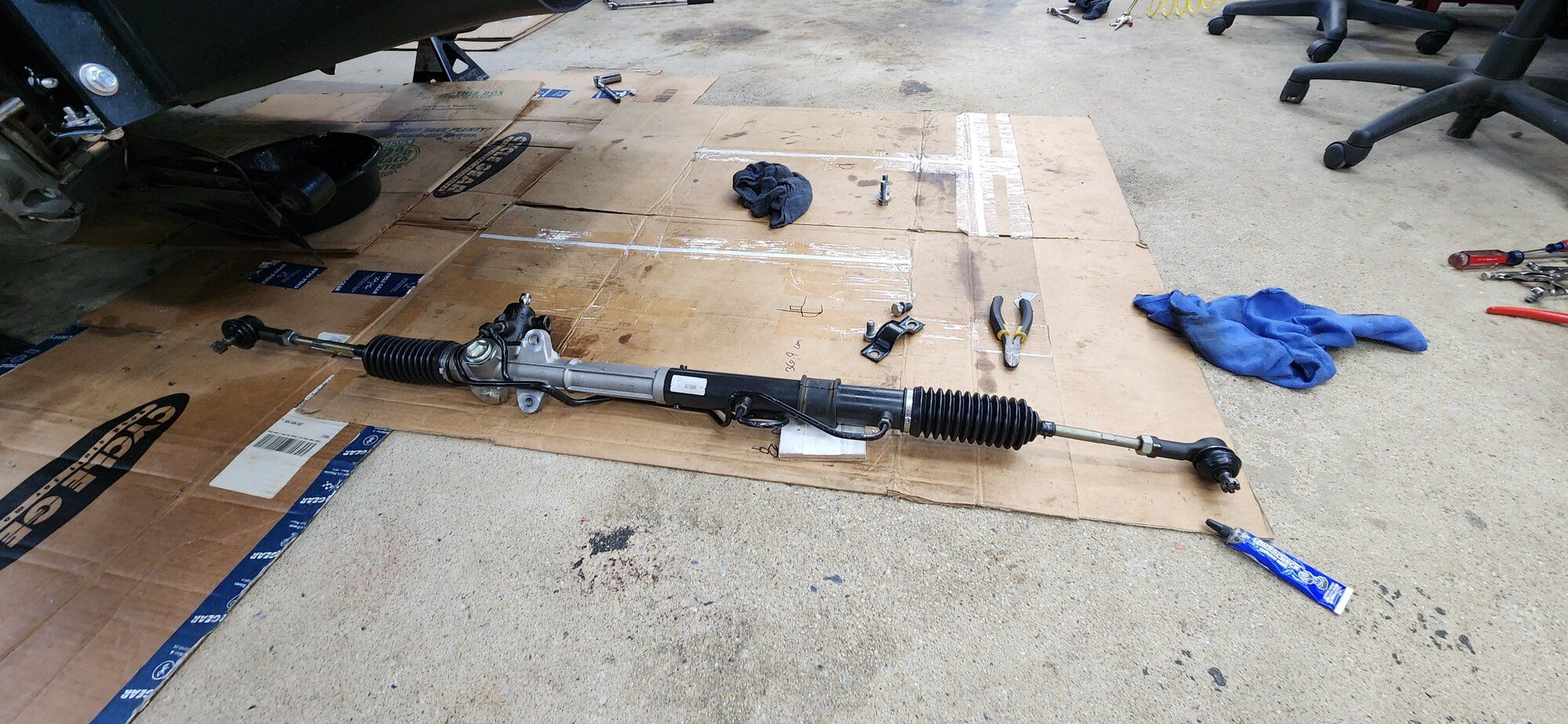

I finally had some time this week to start digging into the problems with the car starting with the power steering leaks. I knew pretty much everything in the system has been discontined by Mitsubishi, but luckily JNZ @DSSA was able to find one MB501603 left in the US so I snagged that. That allowed me to change from a 2gb style return hose to a 2ga style hose along with some Gates 350010 soft hose.
2gb style:
2ga style:

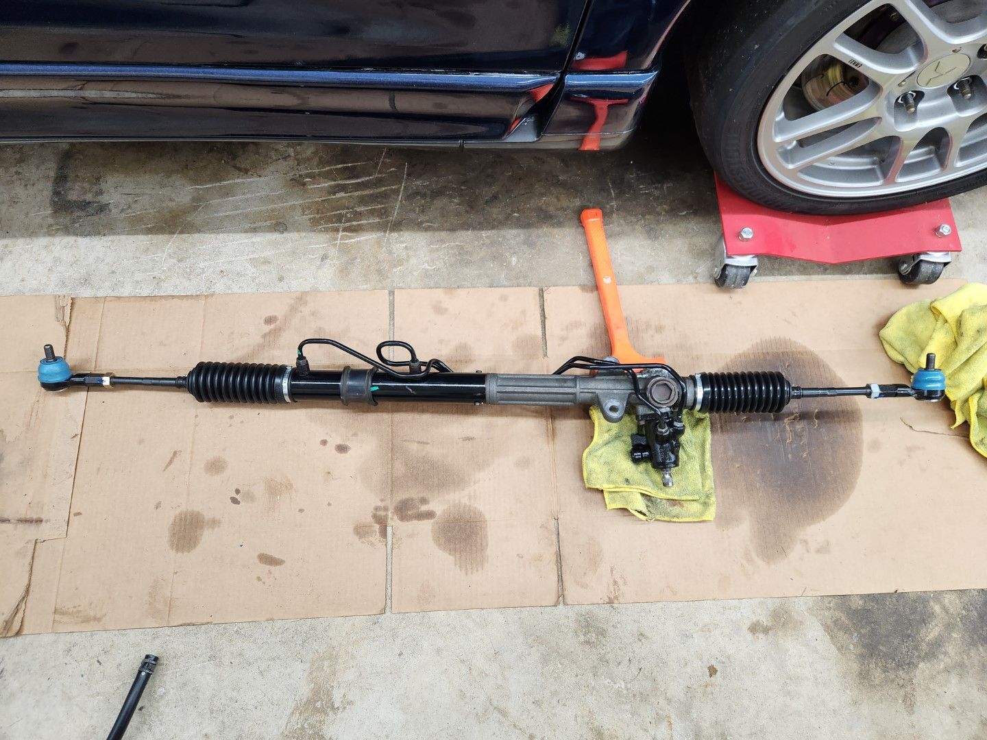

So I got that replaced, started to bleed the system, and noticed a huge leak at the bottom of the rack. That confirmed my fears, one of the lines at the bottom was leaking...again! I pulled the rack and removed the lines and didn't find any damage to the oring, rack, or line. I'm truly stumped. But I figured I'd take one last crack at this and replace the orings. They're discontinued (although oddly look identical to MB192717) so I got some Viton 9263K292 orings from McMaster. Got the rack installed again and still leaking! I give up and have a reman BBB rack on the way from RockAuto. I avoided this for as long as I could since I've read some bad reviews about reman units online, but I'm running out of options and just can't figure this leak out.

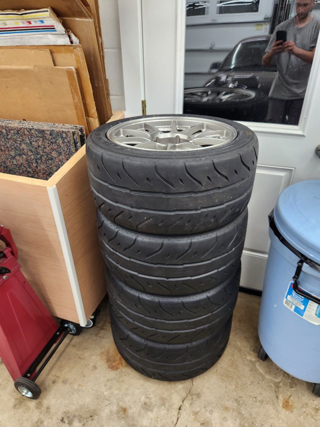

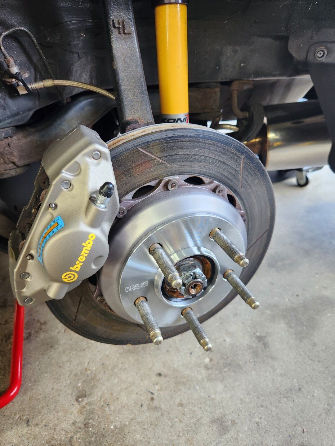

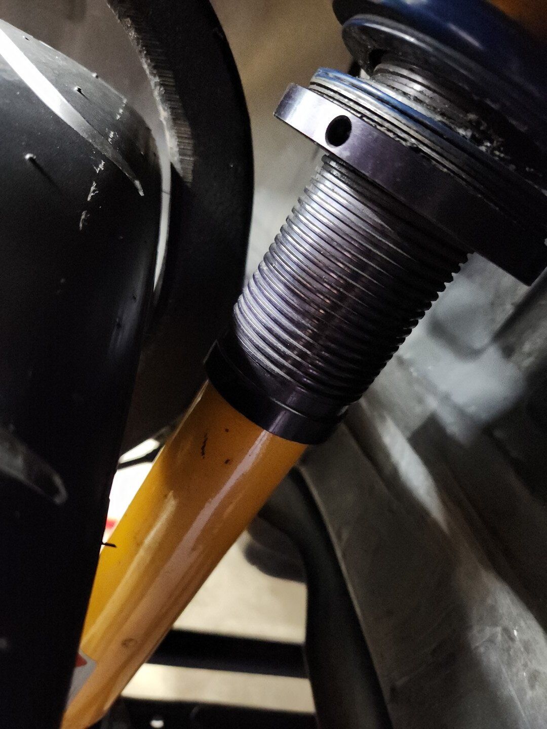

I also picked up some new to me Falken AZENIS RT660. They're used with a couple hundred highway miles and the owner decided they weren't going to work on his car. He had these on a Miata!! They weren't my first choice but the price was decent so I figured we'll give them a shot.
Unfortunately, the section width on these is wider than my AR-1's so my clearance to the rear knuckle is down to about 3mm. A little close for comfort, so I ordered some 5mm spacers.

I managed (with a bunch of outside help) to get a solution in place for the leaking power steering lines on the bottom of the rack. More on that in a future post.

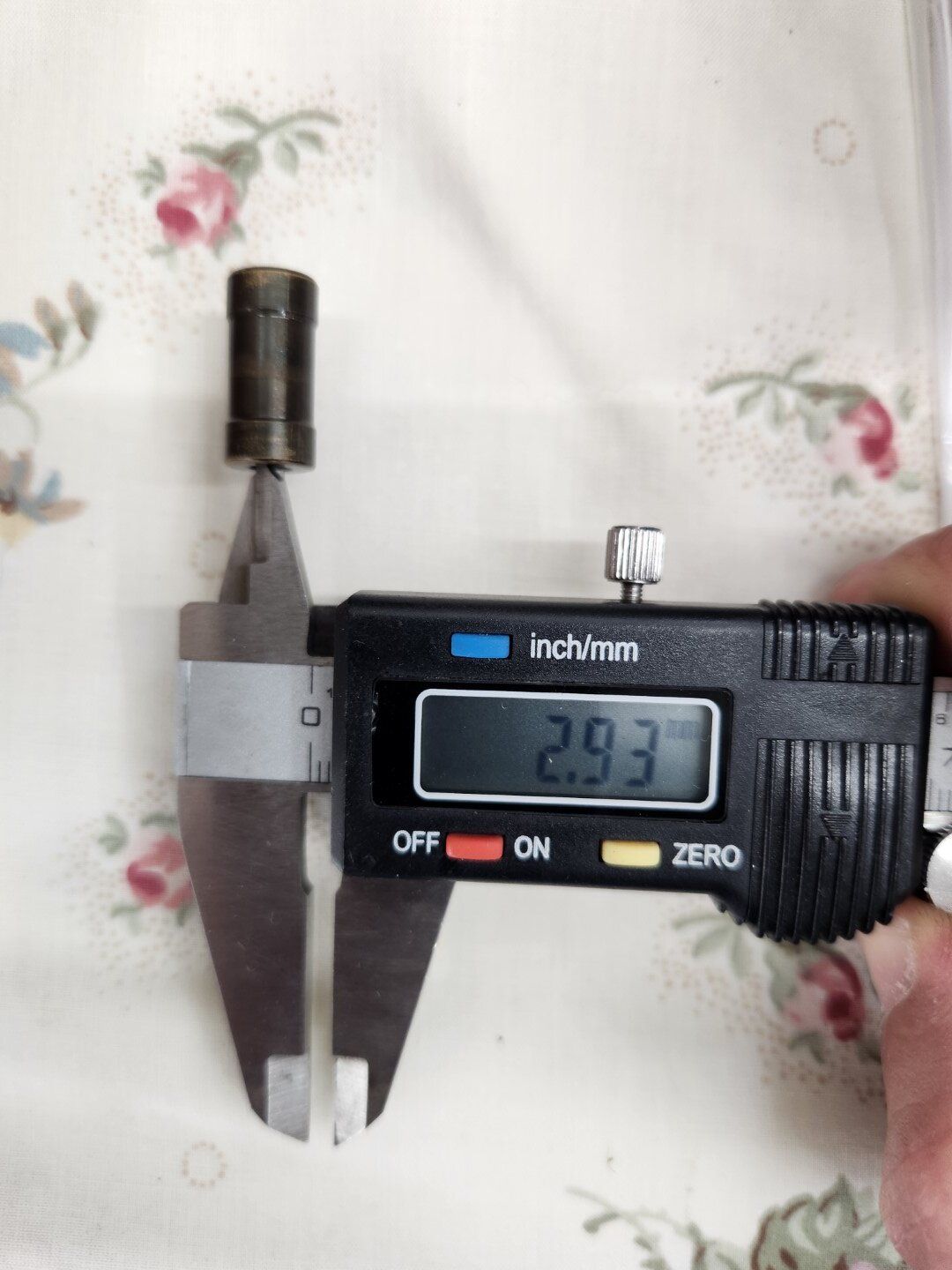

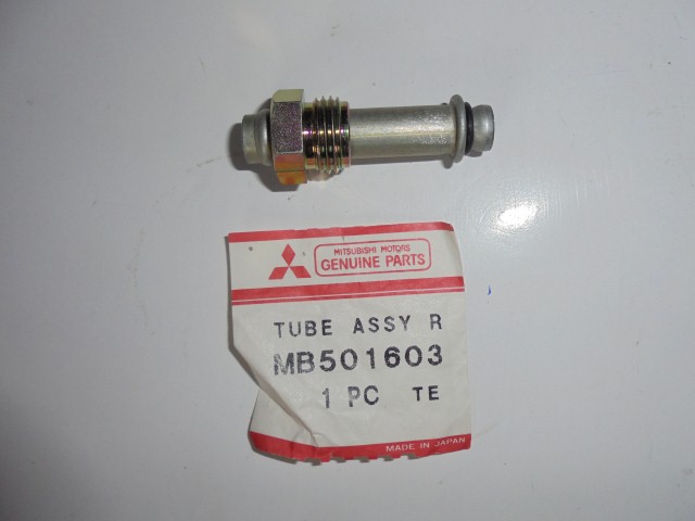

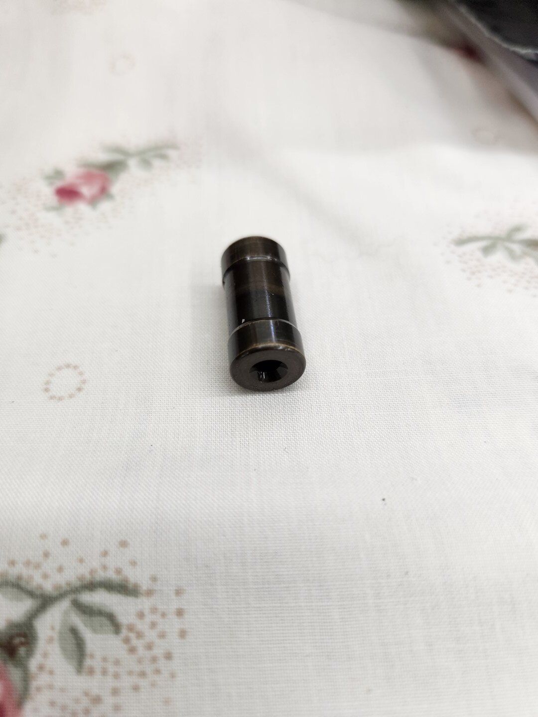

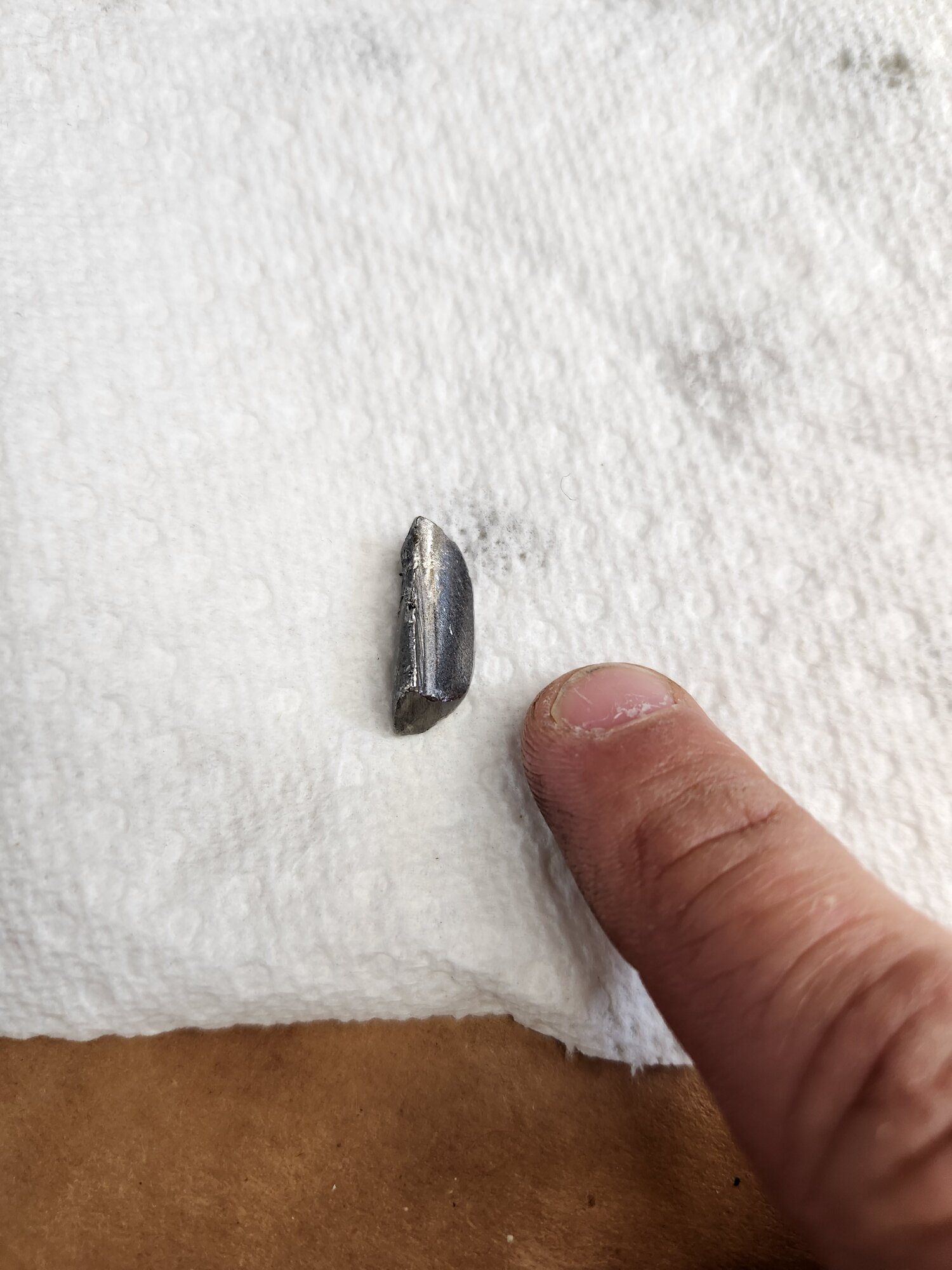

In the process, I accidentally found out that there was a restrictor in the soft low pressure hose that attaches to the top of the rack. I was blowing out my original one with air to clean it to put it in storage, and this flew out.
I had already buttoned up and bled the system at that point, so I took it on a test drive anyway. The steering felt terrible. It was loose and sluggish while centered but if you turned too quickly it would feel like you hit a brick wall with the steering wheel. Probably OK for driving on the street if you were always driving normal, but if you tried to autox it like this it would be impossible. I wasn't sure at this point if it was the lack of restrictor or my new bottom rack lines causing this, so I put the factory restrictor in my new soft hose and the problem mostly disappeared. The remaining weird feeling I thought could be attributed to the alignment being a little off so I didn't think too much of it. The township decided to tar and chip our road the day before we needed to load up so I just put an alignment on the car and loaded it in the trailer without test driving again. I'm still curious if factory 2ga lines have this restrictor. I can't tell from Brian's car without yanking the hose, and I asked on Facebook but nobody replied with any useful info.
Oh, and the wheel spacer solved the clearance issue. What a nice feeling to have a part just "install" properly with no fuss or modifications :)

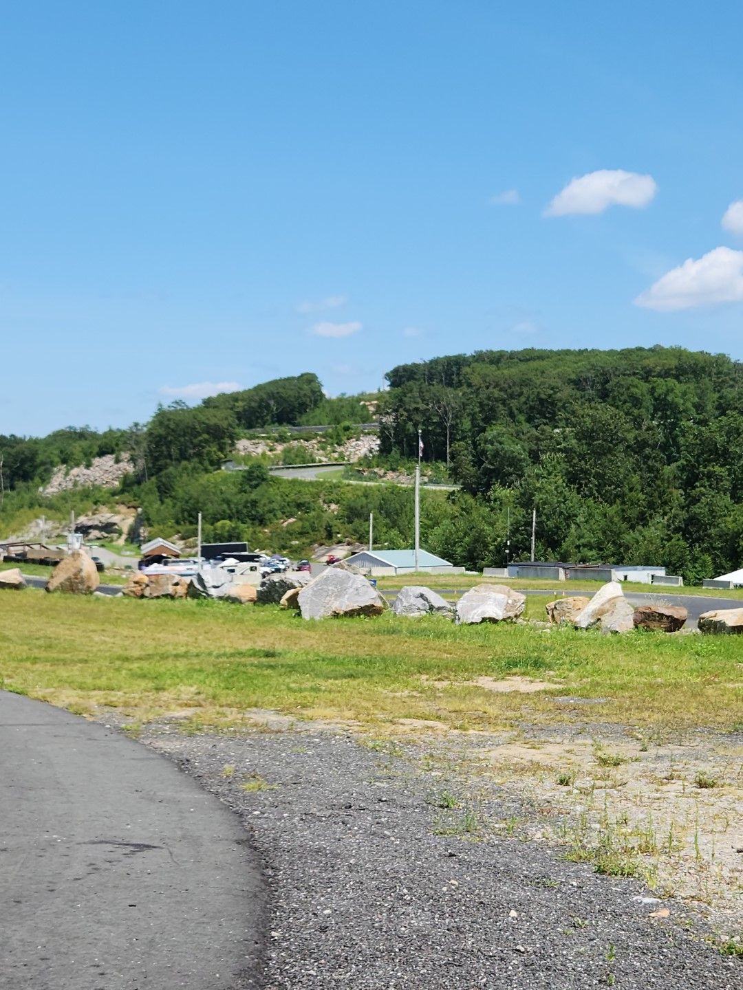

The track was super pretty with all the rock and TONS of elevation as you'll see in the video below.

Thanks! I might still be interested in those in the future if you're willing to part with them. Would you mind looking in the 2ga hose to see if there is a restrictor? I'm still curious about that.

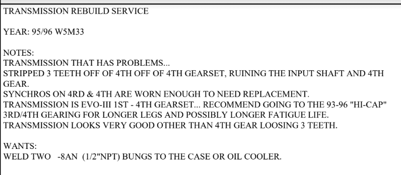

Not much of an update but my transmission has been at TRE since I got it out and Jon just got back to me with the damage report:

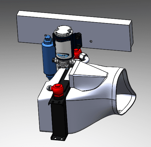

I gave him the approval so he's going to get it all fixed up. In the meantime, I started to collect some parts and design a transmission cooler to hopefully get a better service life on this rebuild.

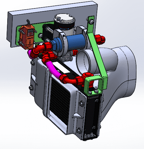

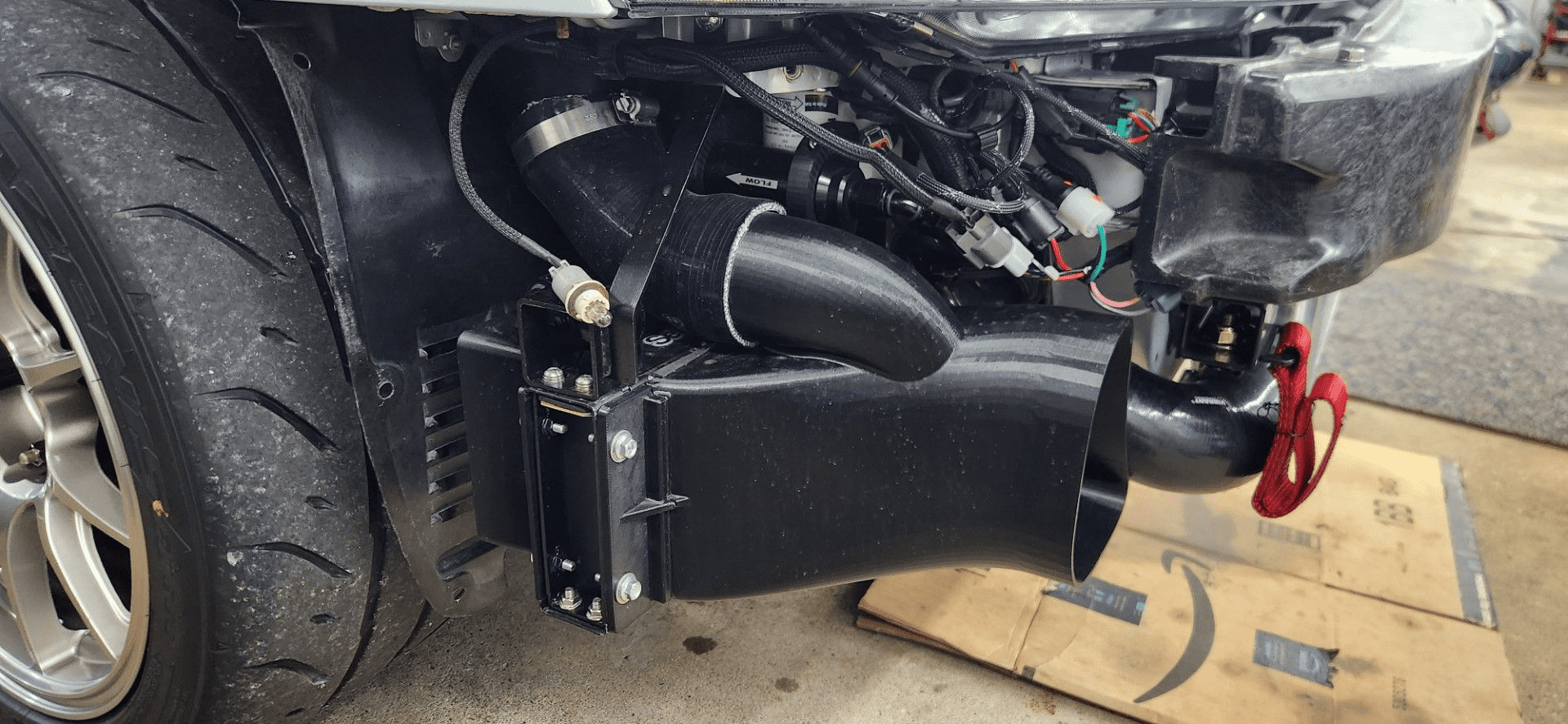

Here's a detailed post on the trans cooler setup:
The inlet duct also feeds the air intake box. Instead of the tubing I previously had, I switched to a silicone coupler like I used on the power steering cooler. And I also integrated a transponder into the pump mount so I can run more timed EMRA events.
I also got my hands on a NOS power steering rack and full line hard/soft line set so I installed those - apparently they were from the old Archer Racing stash! Since they're 2ga parts, I checked the soft line at the rack before installing and there was no restrictor like my 2gb had. I installed everything without it and had some similar problems like I had before of a hard feeling on quick movement, but it went away after a bit. I put the restrictor in my track spares box just in case it ever has to go back in.

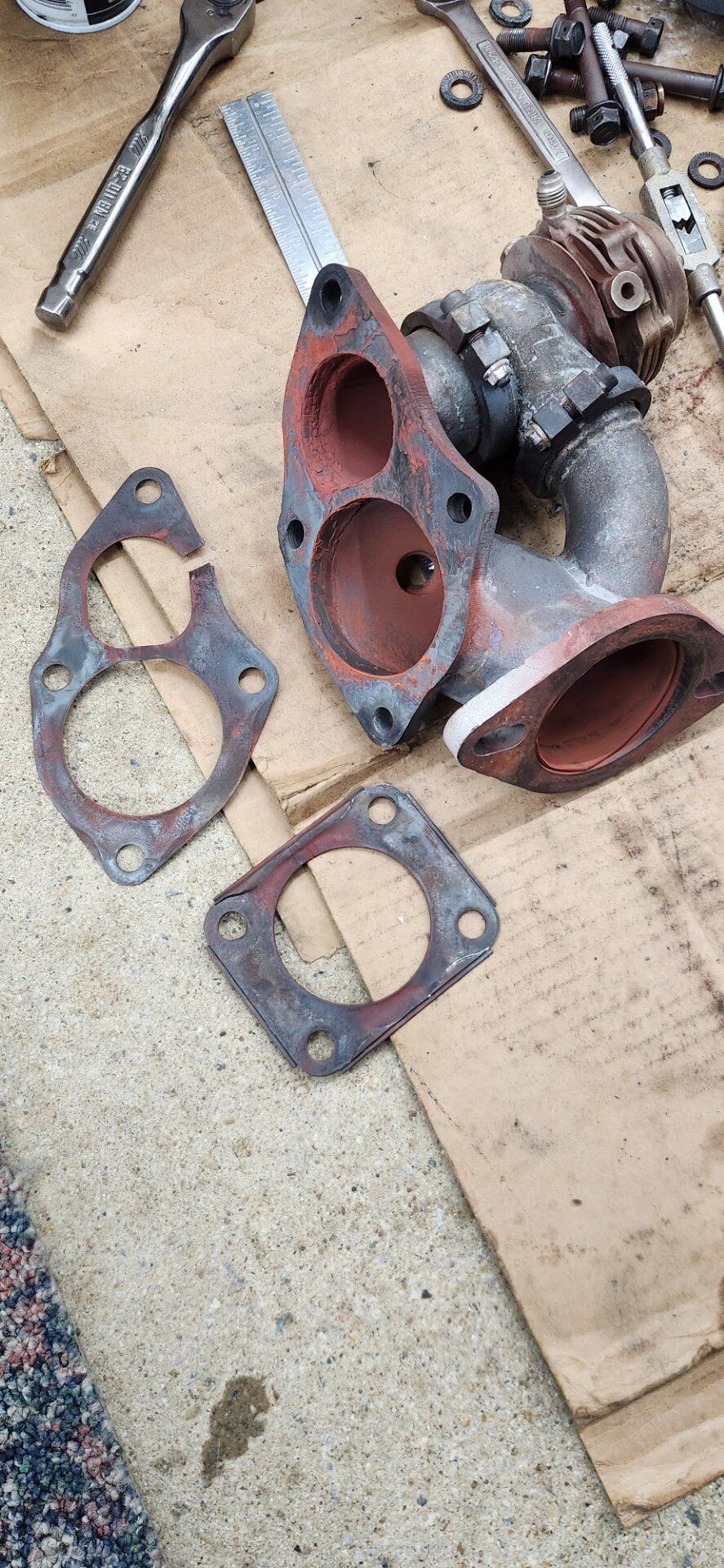

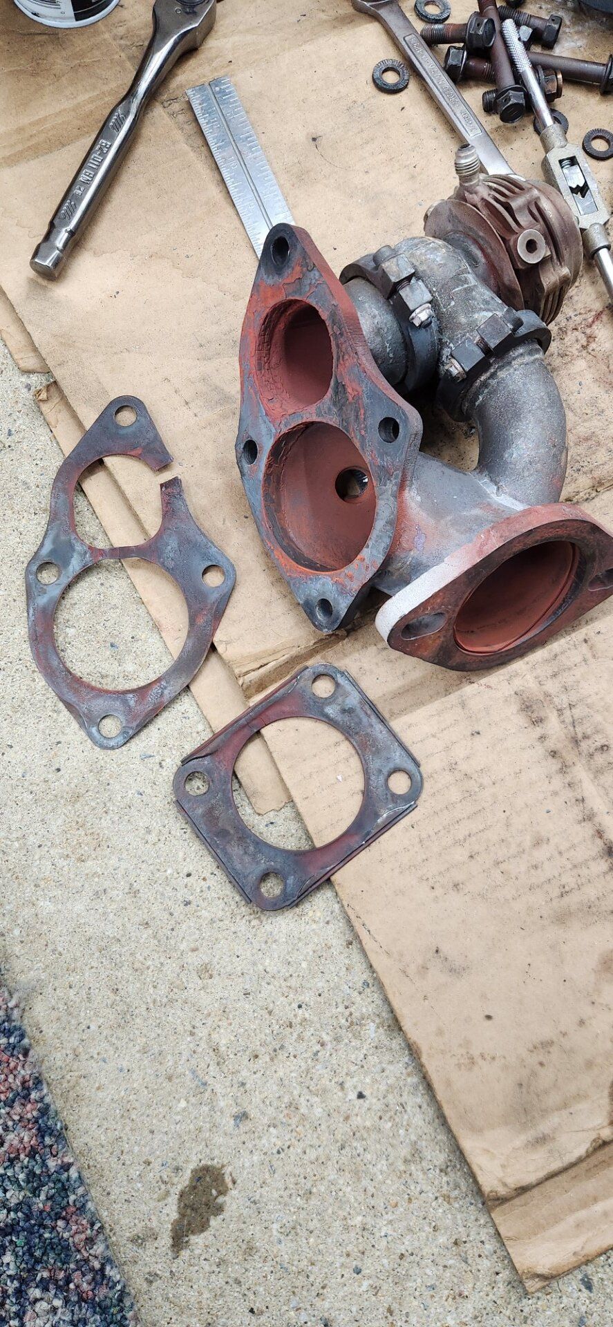

And at the end of the day Saturday I started to notice what sounded like a very slight exhaust leak but it wasn't too bad yet. It got worse and worse on Sunday so I eventually called it quits to avoid toasting anything too bad. I ripped it apart today and it was the o2 housing gasket that gave out. The turbo gasket was looking OK but wasn't too far behind. I looked and it's been about 8ish track days since the last time I did these gaskets. At this point the blankets aren't looking quite as good anymore and the flanges need to be resurfaced like I always do. The material on the o2 housing is getting a bit thin, this might be the last resurface it has left in it. A new v-band turbo/manifold is looking better every day but they price is still shying me off.

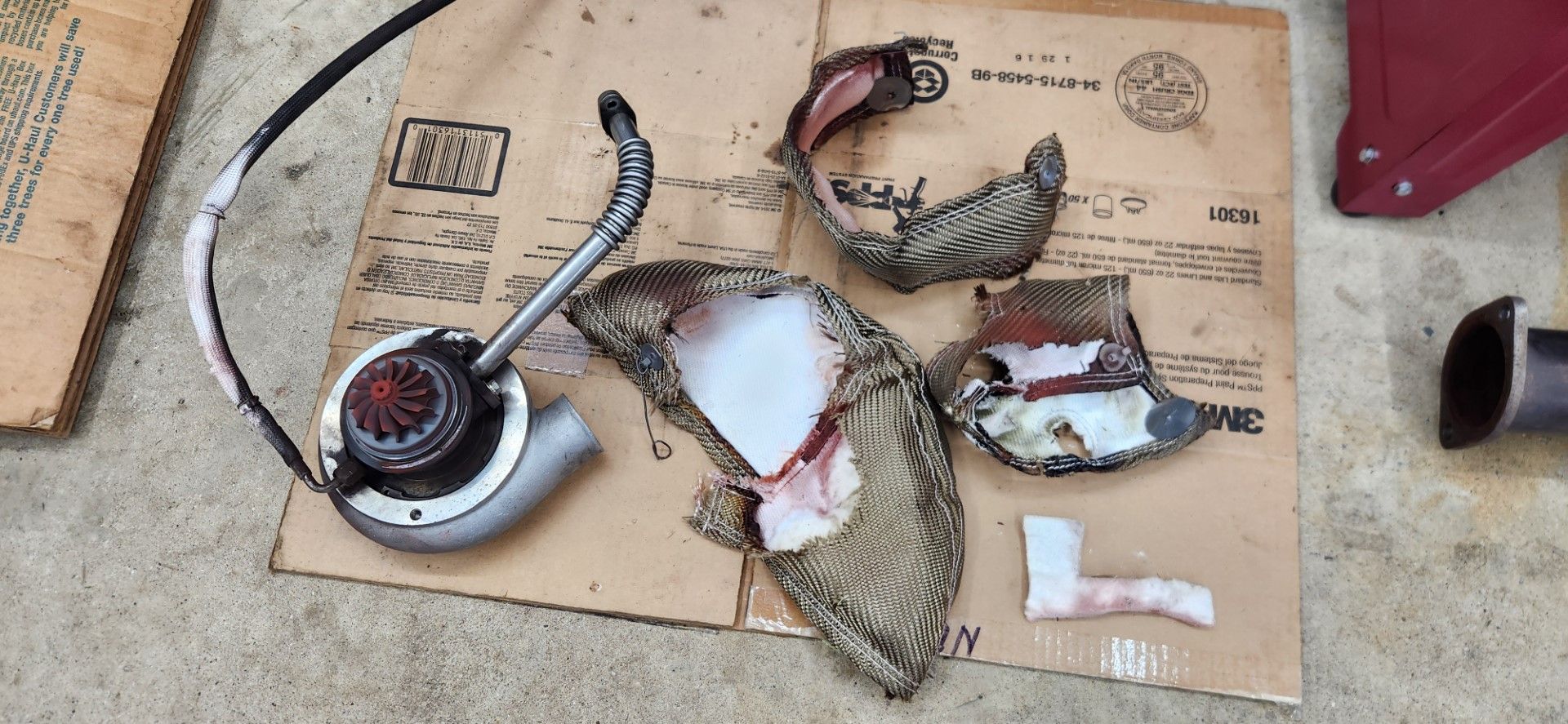

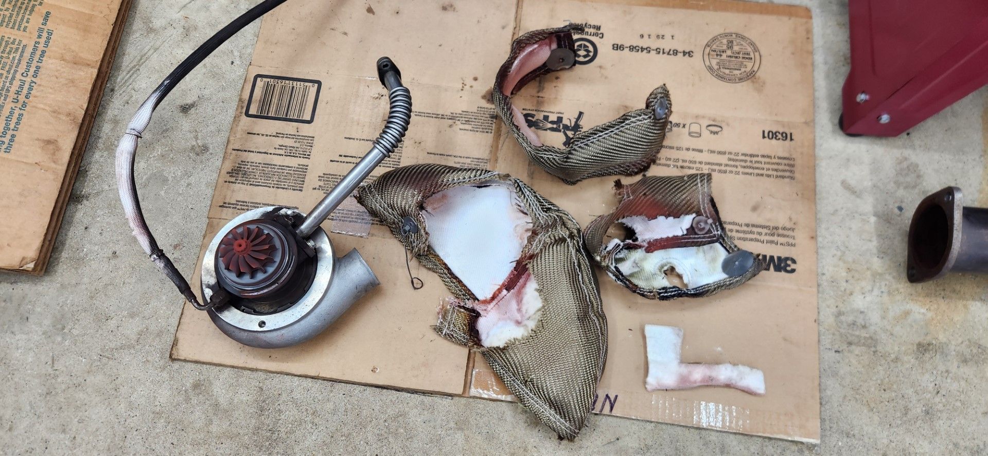

Honestly I've always wondered the same thing haha. And I just got back from dropping the hot parts at the machine shop and they asked the same thing. The red color starts about 2" into the exhaust manifold (none in the head) and continues on all the way back to the muffler. I only use Sheetz E85 and put in Lucas Ethanol Stabilizer so I've always guessed it's something from that combo but don't have any proof.
Ooof, well it would be interesting to know if there is metal degradation under it.
Many questions:
Does it come off easily?
Is just iron reacting this way or is it all exposed surfaces?
I'll bet your WB02 gets some residue - do they last long?
I'm guessing your fuel setup is way reactive - like corrosive - at high temps on iron.
