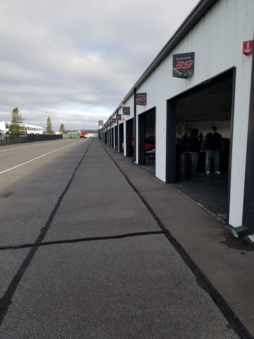

Pocono track weekend recap! We had the usual crew minus Brian (myself, Camaro, GT4, Evo, and C7). This was an event hosted by the Cumberland Valley Corvette Club. So it was mostly Corvettes although we had some other cars mixed in as well. This was my first time ever going to Pocono Raceway.
I live a little over two hours away from Pocono Raceway so it's not a bad drive, but to add some excitement to the trip there was a high wind advisory on Friday evening. And it sure was windy; 25-35mph sustained wind with gusts up to 60mph. Not the most fun trip with an F-150 and a 24' enclosed trailer. We debated for a while on going up Saturday morning instead, but decided to just take our time going up on Friday after work. It took a lot longer than it should have but we made it safely.
To add a little more excitement to the trip, it snowed on Friday night. Just a tiny bit, but enough that there was still a very slight dusting on the cars Saturday morning. It stayed COLD all day Saturday. We were a little worried about the low track temps with aggressive tires, but everything was fine. We started out slow to get used to the track and be cautious with the low temps. Being with a bunch of Corvettes was a little worrying too. We kind of expected that we would get drag raced down the straight and then held up in the infield, but the Intermediate group I was in was actually a great group. There were a couple of people that were stingy on point-bys, but most people gave them quickly and didn't try to outrace you while passing.
On the first session out on Saturday I noticed I was running pretty lean, so I added a bunch of fuel in with the sliders after that. I had to bump it up again after the second session and got it close enough. I think it was probably a combination of the cold weather and CAI and potentially the new turbine wheel. I'll have to retune the car again later to get it better dialed in.
Other than that, Saturday went without a hitch. Sunday morning I got the car out of the trailer and had it warming up for the first session. A couple of guys came over to chat about the car and one of them commented about getting a faint whiff of coolant. I jokingly said that it could be my car. And.....it was. (I have distilled water in the system but there is some residual coolant.) The water fittings on the wastegate had loosened up just enough that they weren't sealing well. I took one off, put a new crush washer on it, and red-Loctited it in. Started up the car and found the other was loose too so I just cranked it down. And literally the minute before I went on track for the first session, I put a little dab of JB Kwik on each fitting for good measure, fully expecting it to do nothing and burn off.

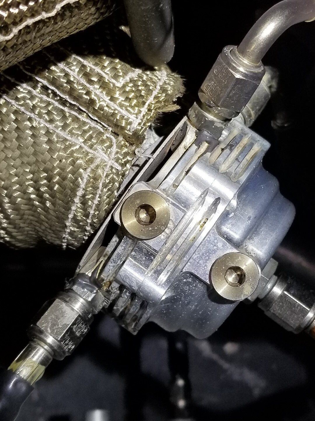

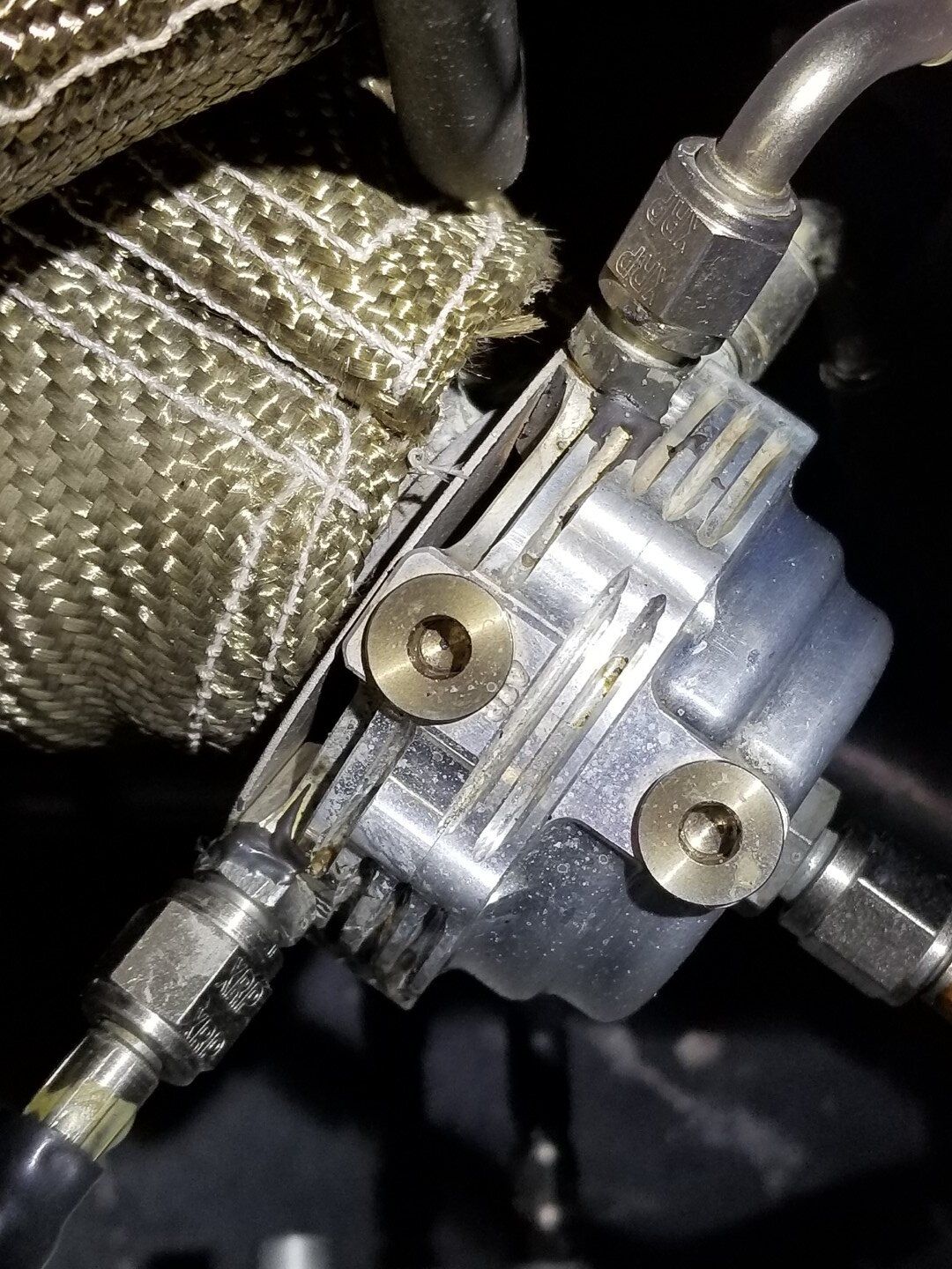

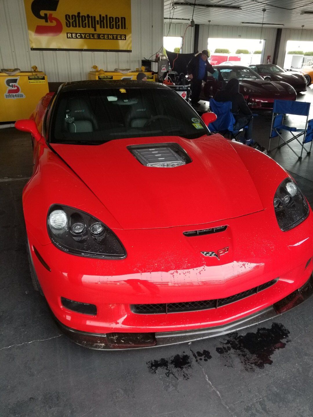

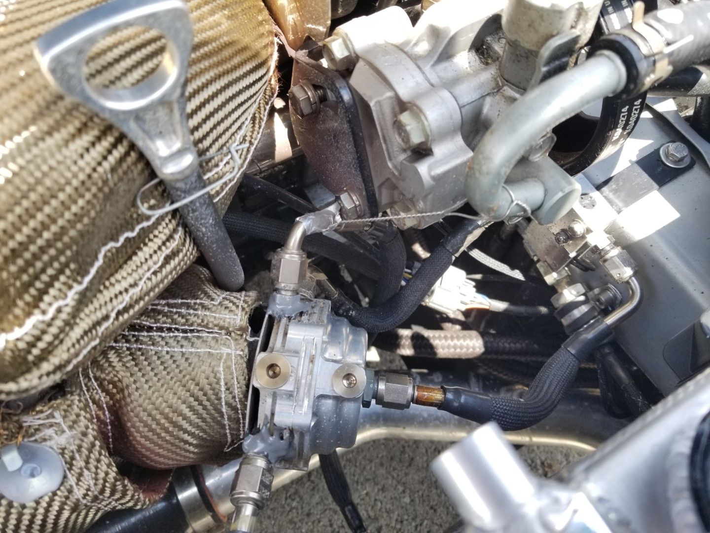

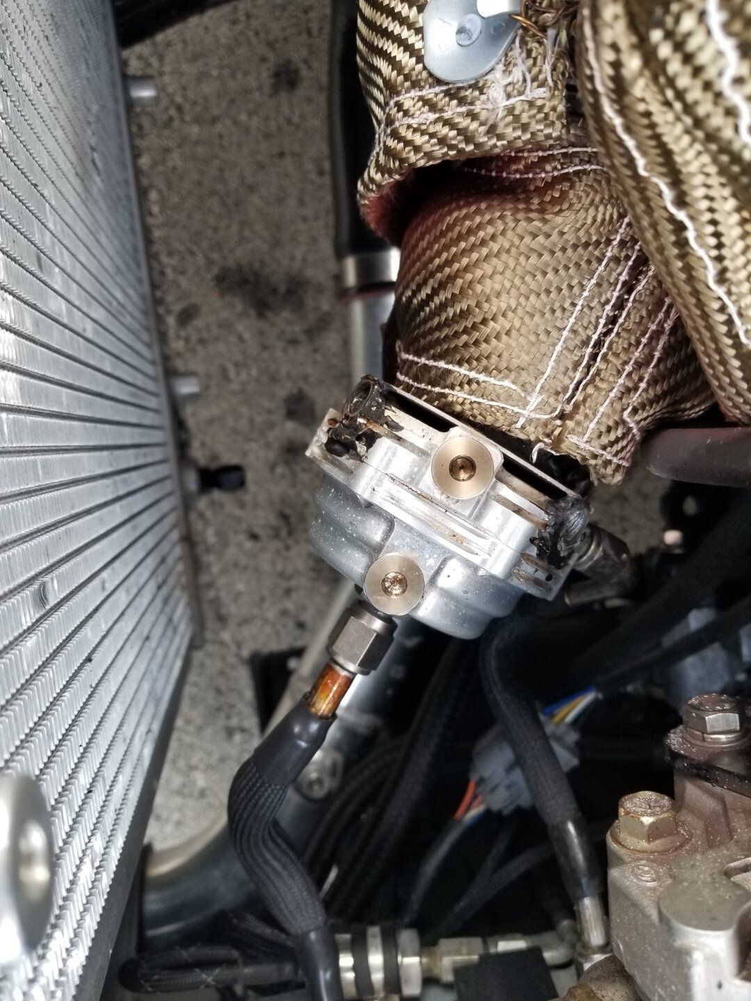

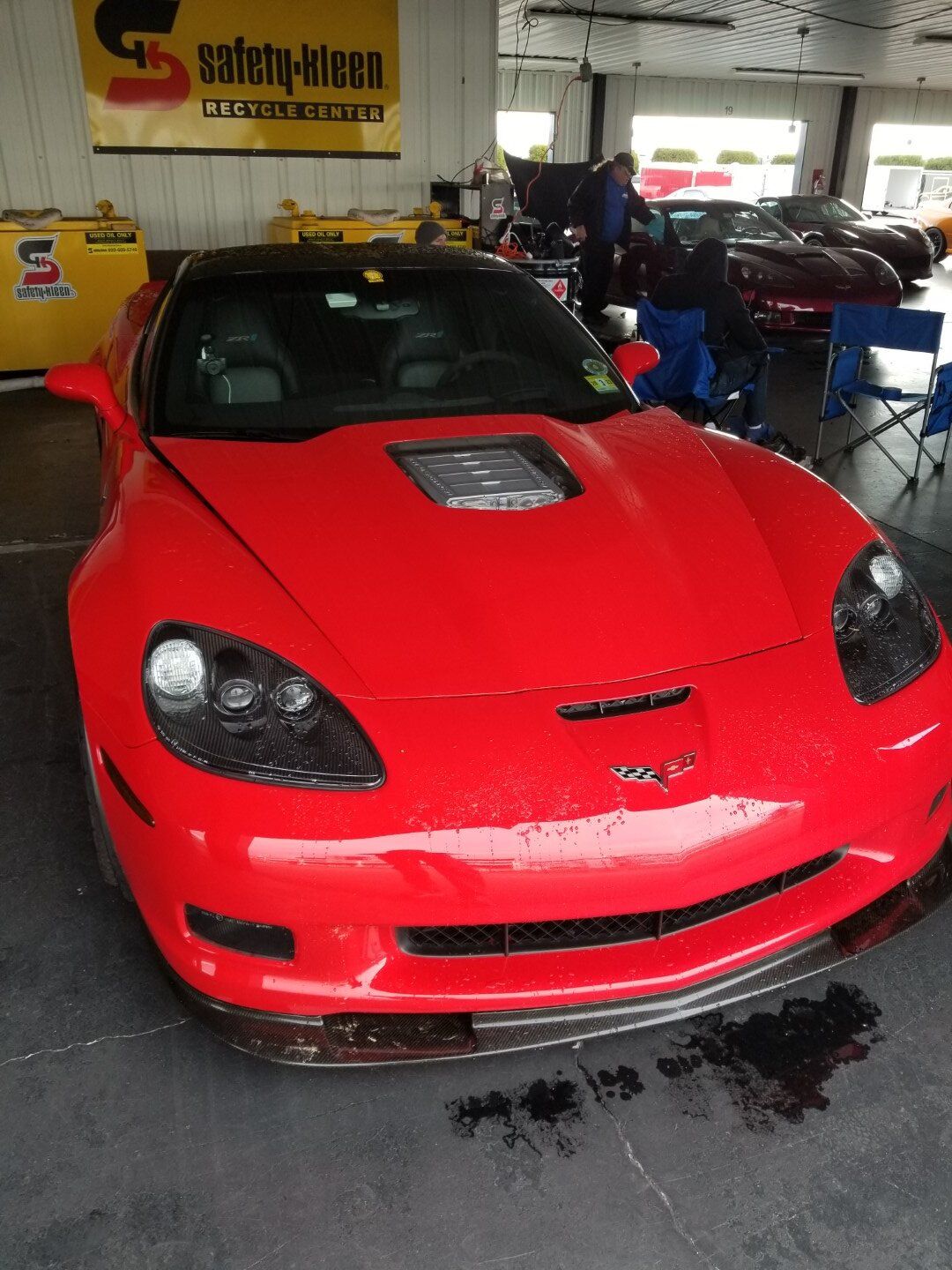

So we go out on the track and I'm getting a little spray on the windshield through the hood vents and the smell of the water/coolant burning off. I couldn't clean it all off the hose jackets so I wasn't too surprised. Then I start seeing bigger drops. And more drops, and bigger drops, but the smell is going away. I was relieved to realize it was just rain :p So after fumbling around trying to figure out how to use my wipers we finish the session in a slight rain. The second session also had rain too but the grip was 90% there so it wasn't bad. And that JB Kwik held up the rest of the day much to my surprise!

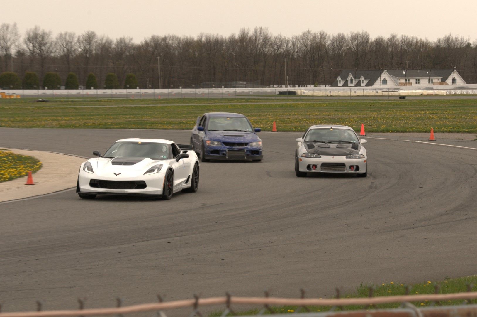

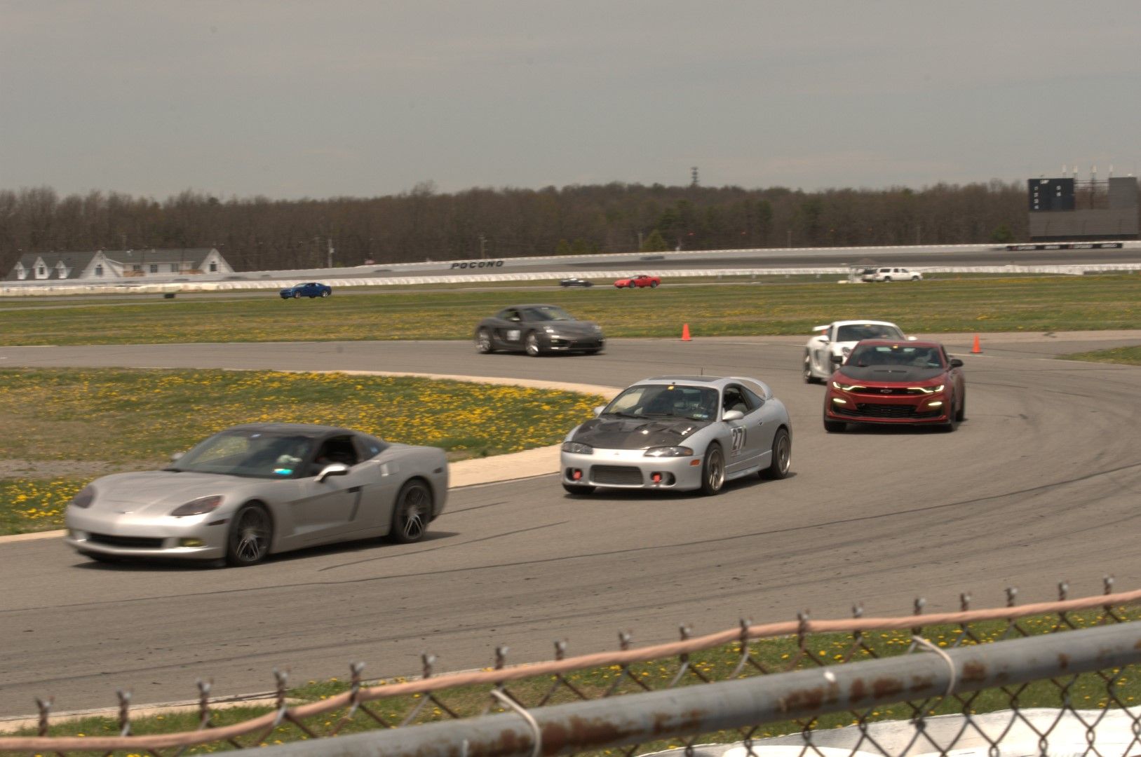

Big thanks to @snowborder714 for these pictures. There was really only one spot to shoot from.

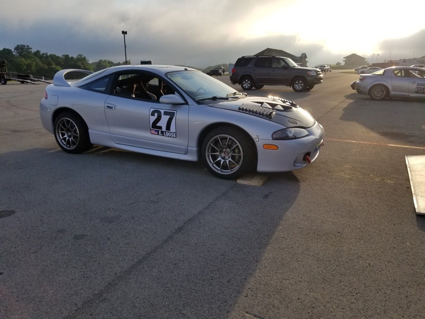

This thing was pretty cool. Just an HPDE car but it looked FAST. Zoom in on the license plate/holder ROFL
And some of my favorites.

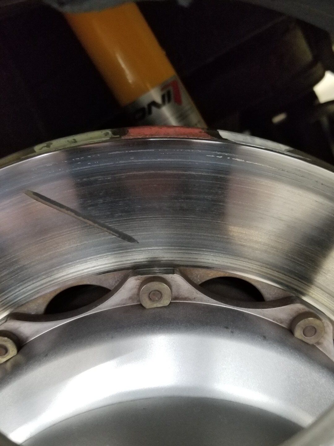

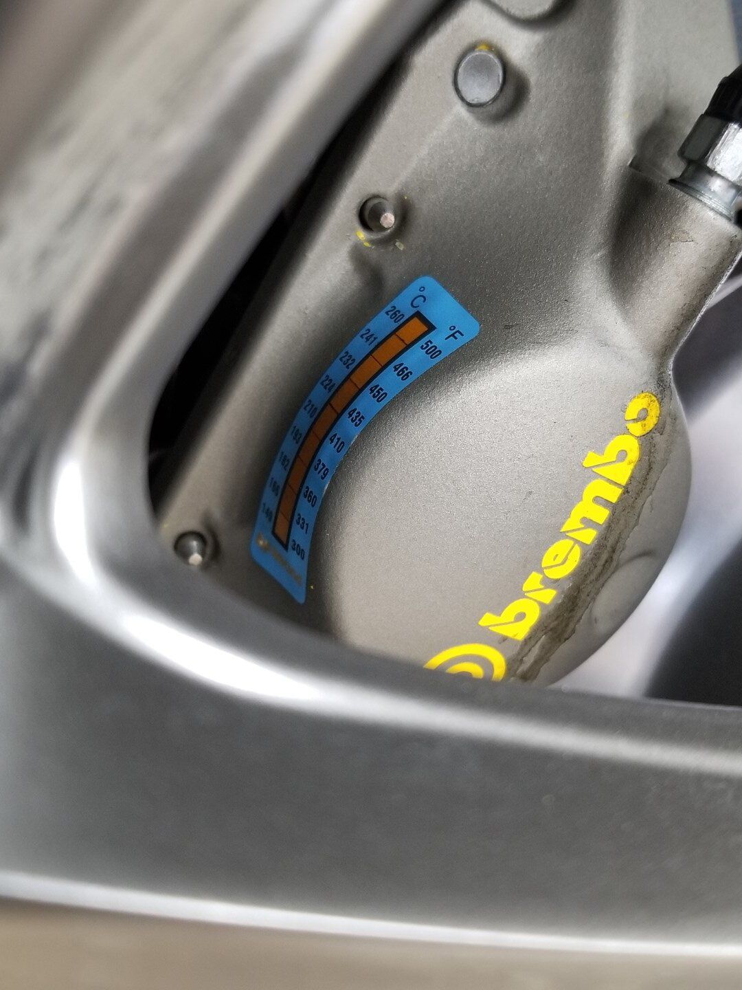

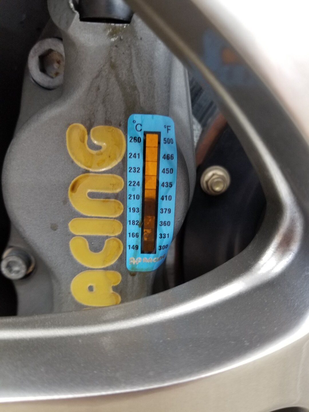

As for the brake temp data, the front caliper got to 379F, the front rotor got to at least 1000F (I checked at one point and the 1200F rotor paint didn't melt, but I forgot to check again), the rear caliper didn't even register on the strip, and the rear rotor didn't melt the 800F paint. AP Racing states:
  • Calipers that regularly run at up to 200°C - Re-seal every other event.
  • Calipers that run intermittently from 200°C to 220°C - Re-seal as soon as possible.
So I'm not particularly worried at this point, but I should probably consider having these resealed at the end of the season since I've never serviced them.

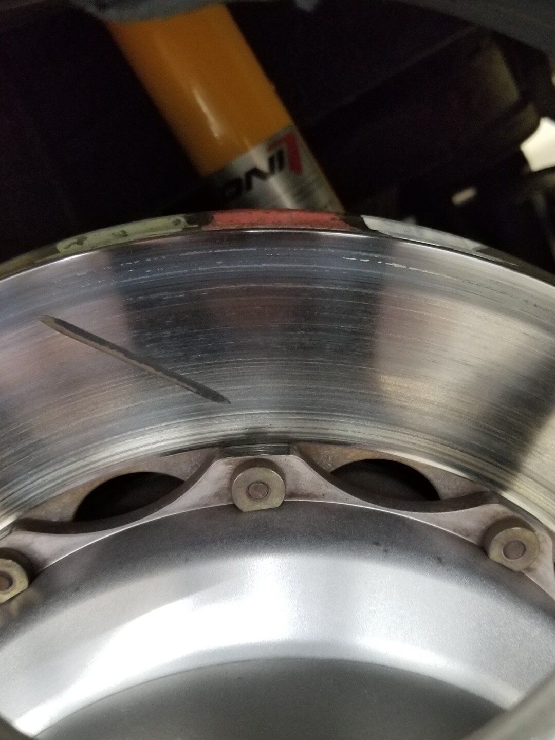

We were at Pitt Race this weekend for the Star Spangled HPDE. My front brake pads were pretty low since the last track day, so I put on a fresh set of G-Loc R16s (same as before). I put some fresh JB Weld on the wastegate water fittings to make sure they didn't come loose. I only drove the car one day I think since the last track day, so I took the car for a quick spin on Friday before loading it in the trailer just to make sure the brakes felt OK. They felt fine, but the car was very lean - running about 13:1. And this was even with the fuel sliders still bumped up from Pocono. I ended up having to move the fuel sliders up about 7-8% more to get it in check. I'm honestly not sure why the change. I also noticed when prepping the car there was some oil on the fan and shifter cable area, right where my BOV vents to. I thought about emptying the catch can (it takes some effort) but ended up not doing so since I've had very little oil in there in the past. Stay tuned for more on that.

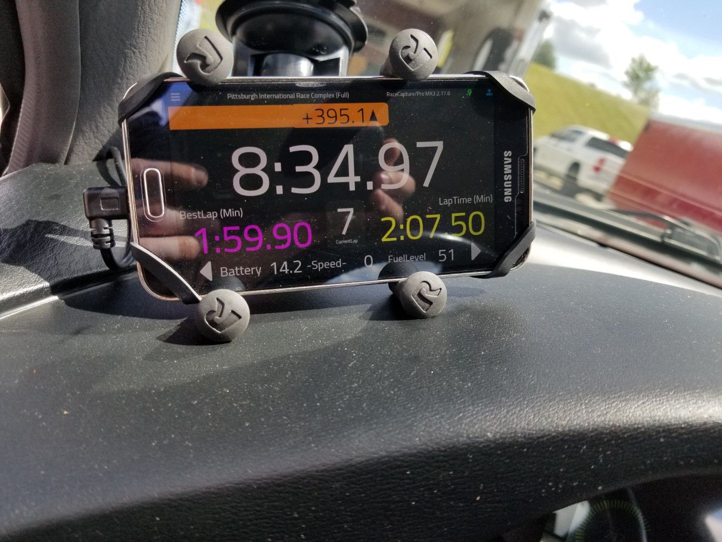

My main goal for the weekend was to get a sub 2 minute lap. I've been shooting for one for at least the past three years and was hopeful I could get it in the Advanced group since it's a quicker pace in general and less traffic to deal with. My best lap times are typically in the second session of the day since I've knocked the cobwebs off but before the track starts getting too hot. But the first few sessions I was noticing the track felt more "slippery" than usual. I thought it might be my tires starting to lose pace, but I talked to a handful of other people throughout the weekend that noticed the same and were running up to three seconds off their normal pace. Turns 10 and 14 were particularly greasy and I almost lost it a few times in the early sessions and had to adjust my approach to them. Again, I thought I was going crazy but other people confirmed similar experiences on those specific turns.
Despite the abnormal track conditions, I managed to knock out a 1:59.90 in the afternoon Saturday :) So stoked!! I didn't have my lap timer screen up in the morning so I could focus on driving without paying attention to the clock, but I turned it on for the afternoon. I was on a good hot lap with the predictive timer bouncing between 1:59 to 2:00 and I came in a little too hot on turn 17 and scrubbed off too much speed resulting in a 2:00.20. I took a slower lap to cool the brakes and tires then went for another hot lap. The lap timer was bouncing again but mostly on 2:00 so I didn't think I was going to get it, but I just barely got the 1:59! That ended up being the best lap of the whole weekend, I wasn't able to improve it Sunday.
I noticed a little bit of water spray on my windshield Saturday morning. Sure enough, the wastegate water fittings started backing out and leaking a little. I JB welded them again - didn't help. Safety wired the hose to prevent it from moving with the fitting - still moved. I tried fixing it again Saturday night after it cooled down and when I tried to snug up the fitting it kept spinning - the threads in the wastegate stripped out. At that point I removed the lines and decided to run Sunday without water cooling. The worst that would happen is I would cook the diaphragm.

Another strange thing I noticed is that my front calipers got very hot (at least 466F) and the pads were wearing much quicker than usual. The yellow AP Racing logo actually started turning brownish on the front left caliper. I'm solidly in the "rebuild now!" temperature range, so I really should have them serviced over the winter. The rotors are nearly done for too but haven't quite cracked through all the way to the edges. The pads wore from 20mm to probably 7mm over the weekend. The only thing I can think is I was running many more consistent fast laps (2:00-2:03) due to the lack of traffic and quicker point bys. In Intermediate, I would often have sections where I got slowed down and the brakes would cool some and I wouldn't brake as much.
So Sunday I was keeping a very close eye on the brakes and tires all day along with the oil spewing situation. There was less oil coming out of the BOV each session so that was good. After the first three sessions, I contemplated calling it a day and skipping the afternoon to conserve the brakes. I have two more track days this year and don't really want to spend the money on new pads at the moment. I decided to go out one more session and started overboosting so I called it a day.

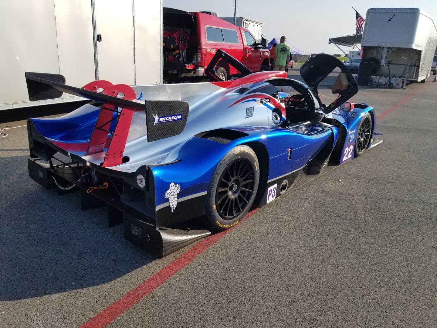

This car was in my group too. A retired Ligier LMP3. I talked to the owner briefly and he said he had bought and tried to track all of the street cars possible, then finally just decided to buy a real race car. He just does track days with it, no racing. Someone else I talked to said he's over $400k into the car and it was shipped from Europe. I strongly suspect he wasn't driving it anywhere near its limits, but even still, when you saw it in the rearview mirror you got your arm out the window for the point by fast!

  • Fix wastegate water fittings, identify cause of overboost
    • I was planning to just weld the water fittings but just now realized they're stainless and the wg hats are aluminum. So either I get aluminum fittings which may not be a great idea or get a new lower hat since it's damaged and figure out another plan. Open to ideas!
    • The diaphragm is also showing wear so I'll either get a new one or replace it with my good spare.

The fittings on the WG if it keeps happening is it because the threads are shot or something? Im assuming here so might be wrong but they npt threads?? You could always braize them onto the housing as that will hold and you can do SS to Al then as temps wont become much on an issue and melt it off like the JB weld might.
Other then that i say change the WG as thats likely your other issue as you mention this and overboost so im starting to think its your WG as a cause and the new turbosmarts are ment to be super awesome from the few i know that run them. Plus they are still tiny.
Brakes could be the fluid as the issue. The strips im assuming you swap each race as they only do 1 use before being useless. What type of ducting you got on the brakes as i dont remember and im on my phone right now so not as easy to go check bacm right now to see. I dont remember if you got the porsche ducts as a few done that and cannot remember who.

I believe the wastegate fittings are loosening due to heat cycles. The threads in the wg were fine up until I tried to fix it again Saturday evening and now one of them is stripped out. They're metric threads with a crush washer for sealing. I'll have to look into the brazing, thanks for the tip. I'm not really looking to change the whole wg at this point since that would likely mean replacing the O2 housing as well. At that point, I might us well just go big and get an EFR turbo with v-band everything and stop dealing with this nonsense.
I didn't replace the temp strip since the last session since I figured the temps would go higher at Pitt Race than Pocono. I don't have any ducting on the brakes right now but if this trend continues I will have to consider it.

on those fittings, anyway to make a lock on them both to keep them from coming loose? or better still convert them from your current lines to banjos where they will be alot less likely to loosen off (well in theory they wont) if you can find the right WG it might not be that big of a swap. but i do feel as if this WG is becoming the problem and not apart of something else myself and needs to be replaced. but as you say if you do that the turbo would likely be done but then the issues should be resolved and fun will be better!
due to reusing the temp strips i would not take that as any indication of temps as a precise reading since they have to be new to be accurate, they are a one use sticker for the most part and while they may still do something likely thing is they not working well. I kept being told when i put brembos on and the XP10 pads if i do check always replace the strips after one use or consider your dada invalid, this was from the shop down the road that build race cars for a living and they win loads of stuff so i trust them on this. they got fancy setup tools for everything you can imagine and im going to borrow a few of their tools for myself once final setup is in sight.
if you got no ducting you might consider something small anyway. i think your pads and calipers can handle alot more so i more feel as if the fluid might be an issue. how long ago did you replace it for new? also do you test it with the suction tool to check how hydroscopic its become? might be worth a cheap tool to keep an eye on it more often

I can't think of any way to make the fittings lock besides welding or what I tried already. I did send TiAL a message today to see if they have any thoughts. Why would banjos be less likely to loosen than regular fittings?

The brake pad wear will be due to heat so maybe that alone is telling you brake ducts are required at some events or hot days.
I suggest banjos since they on the turbos and brakes and i have never once had them loosen and i dont think many others have too. So banjos seem to hold better from that thinking point of view. While im not massively clued up on what clamps better just thinking about it tells me its a long lasting way to secure something over heat cycles. Mainly the turbo that uses banjos and thats alot of hest in the CHRA for it never to back out. I dont know why the threads are not staying in but maybe due to being a straight thread its part of the issue? If you dont fancy braizing them then consider drilling and tapping for NPT or any taper thread to help but see what tial say and go from there. They might not have any problems or even want to say they do as i get things often said (oh i dont know this as its never been mentioned to us before) LOL so im the first one to always have issues it seems haha.

Are you running a stock ride height? - From the Pic's, it looks like you have a lot of fender clearance.
I'm not sure what stock ride height is to even compare. I'm sure it's lower but not by a lot. The SPC UCA's in the front prevent from going too low anyway. But the general guideline which I followed is to not go so low to make the front lateral arms go past parallel to the ground.
Interesting - I'll take a look at where I'm at. Do you have camber numbers you can share?
Last I checked, it's -2.6f and -1.6r. I do not have provisions to change the rear camber on my car since I was happy where it ended up after the ride height adjustments.
