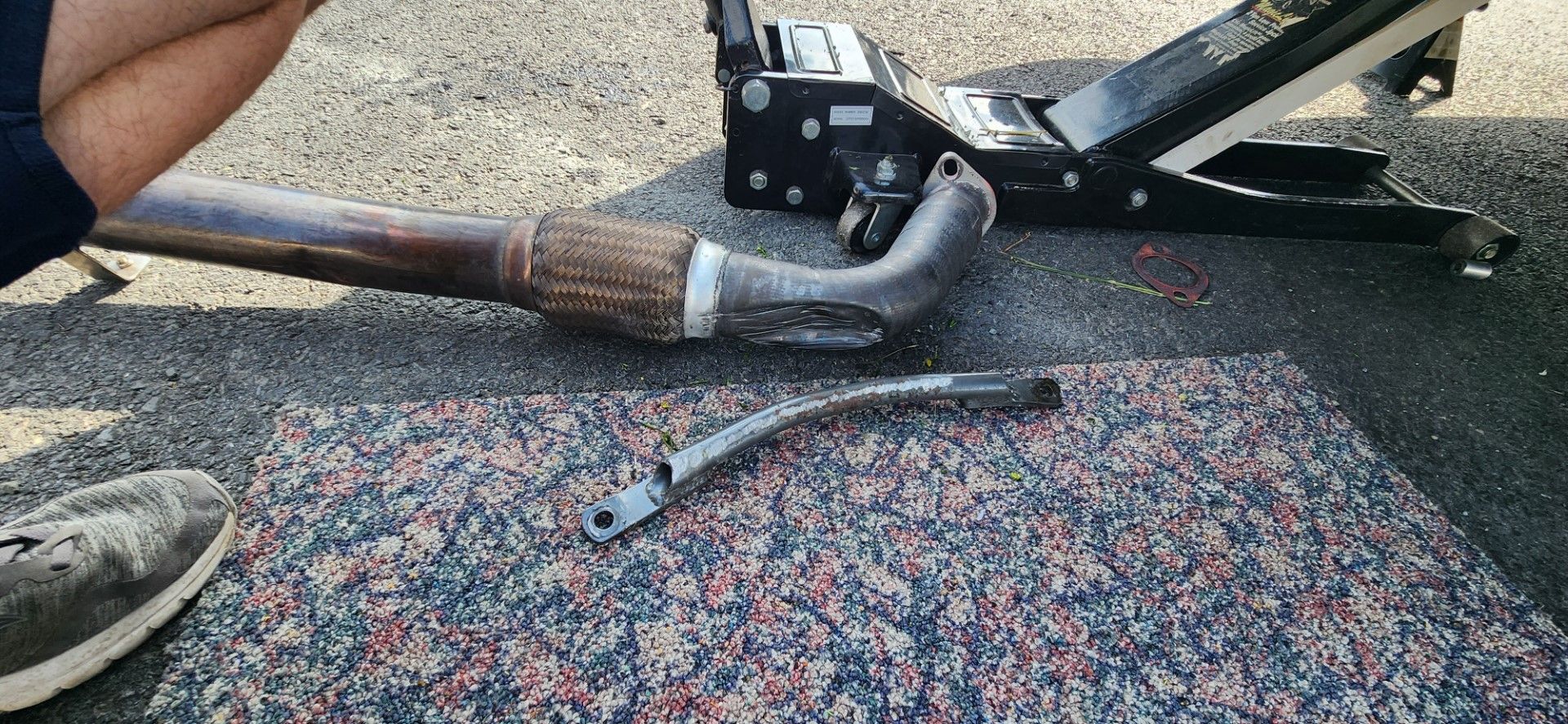

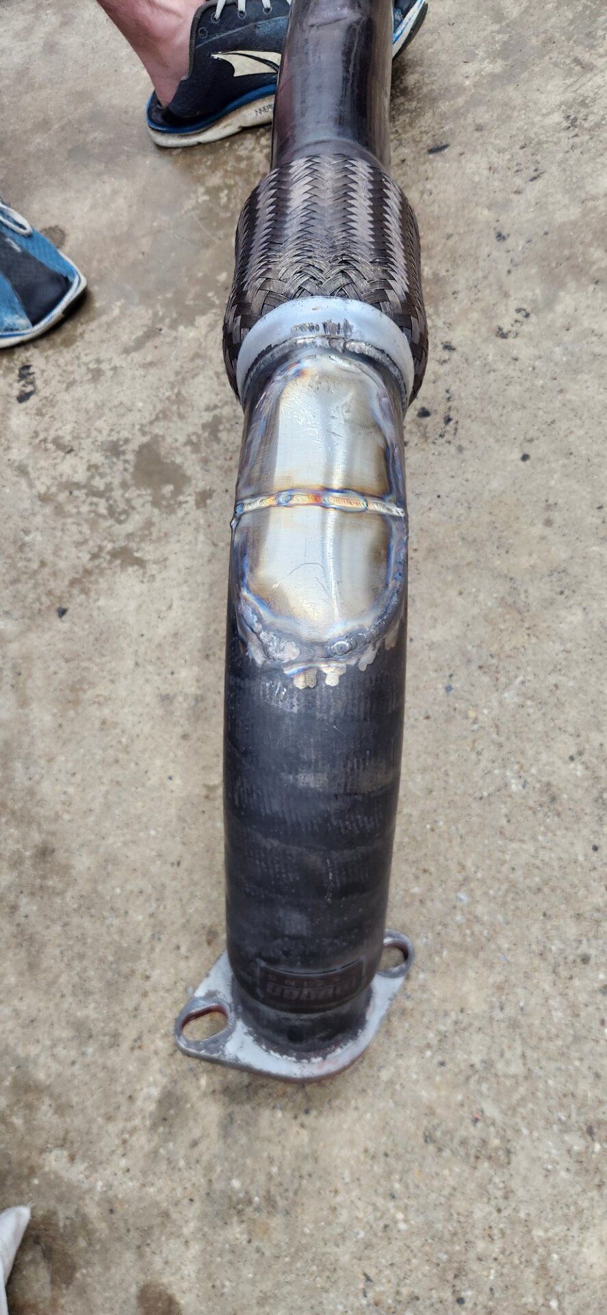

During the third session on Saturday, I guess I didn't brake quite enough going into T10 and couldn't quite get the car composed enough. I intentionally kept the car straight and went two-off left rather than trying to muscle it to keep on track and risk spinning. Unfortunately...the way I ended up straddling the curbing with my left wheels in the grass and right wheels on the track did some damage. A lot of the grass dips down pretty good from the pavement and the high grass didn't help with being able to visually see obstacles off track. At first I was OK in the grass then all of a sudden I felt/heard a big bang and knew I hit something. We later saw on the Camaro's camera footage that it was the start of the curbing that got me. I got back to the pits and saw that I had just barely grazed the bumper cover, dented the FMIC up just a slight bit (I don't think it damaged the rows), barely grazed the oil pan, but my downpipe and RRE under brace took the brunt of the damage. All in all I guess I got lucky?
I took the downpipe off and tried bashing out the dent unsuccessfully but this made me sit out the last session. One of our little brothers and his family showed up for the last session so I was really bummed I wasn't able to take them out for a ride, but at least he and his wife both got a ride in Brian's Miata. The transmission continued to leak from the top all weekend, so I kept putting RTV strategically. I'm fairly confident it's the backup light switch (even though I just put a new crush washer on it), so I picked up some Dowty seals to try instead of the crush washer. I did find some fluid even made it to the backside of my brake caliper so yeah, I definitely want it fixed.
After deliberating on it, I slapped the downpipe back on as it was, left the brace off, and ran the two sessions on Sunday I was able to make between instructing and classroom sessions. The car ran fine, everything felt good, but it sounds like it has an exhaust leak. I kind of think it just sounds different due to the dent and isn't actually leaking, but I have yet to work on the car since we got back. I couldn't see any obvious damage to the subframe or surrounding parts but I need to check closer. Anyone have a cheap Megan Racing downpipe for sale?
On Sunday, a GT3 cup car was bumped out of race group and into the ST-GT class due to not enough cars in the race class. So he ended up in second place and dropped me to fourth.

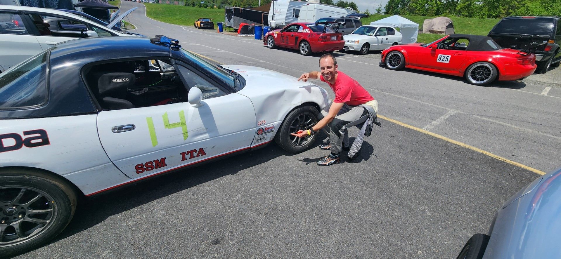

Brian had his own off-track excursions Saturday and Sunday as well LOL. A tire wall did the fender damage which was easily remedied with a dead-blow hammer over lunch.

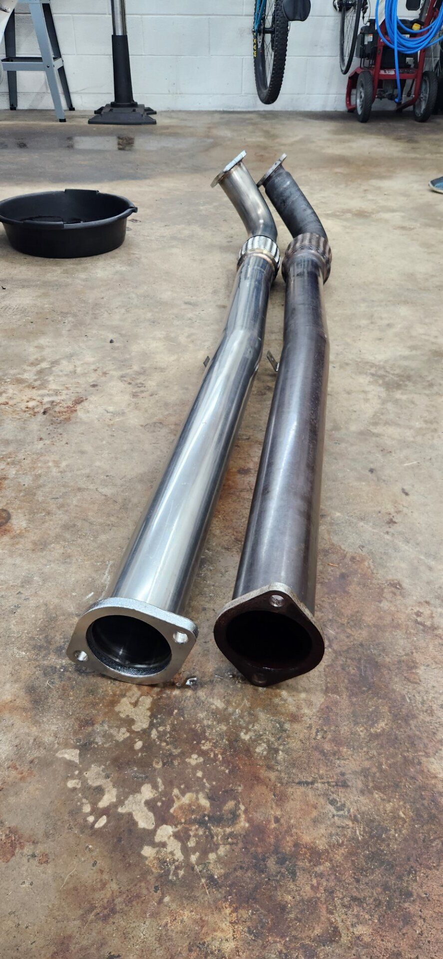

The downpipe is Megan Racing and they since changed up the design, but it looks like they're discontinued anyway. I did find that CXRacing might have the same one I have now but I'm not positive.
I doubt the RRE bar is still available so I'll probably just make my own at some point. And yeah, reallly glad it didn't take out the pan!
Bummer dude. Glad it wasn't worse. I have a RRE lower brace I don't need if you don't feel like fabricating one.
These are two 'companies' that live in China and wouldn't know what a DSM was if you ran them over with one. They seriously have probably never seen a DSM in person.

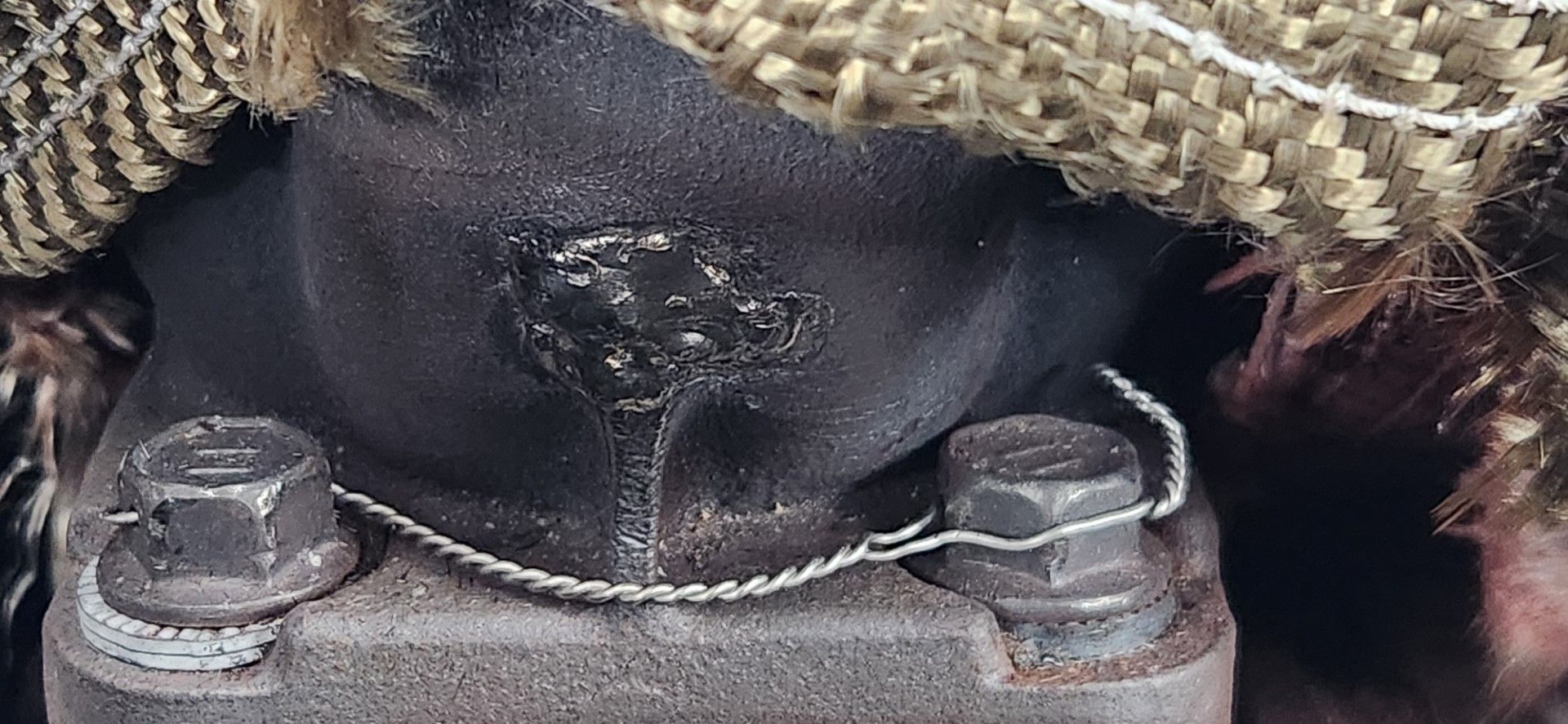

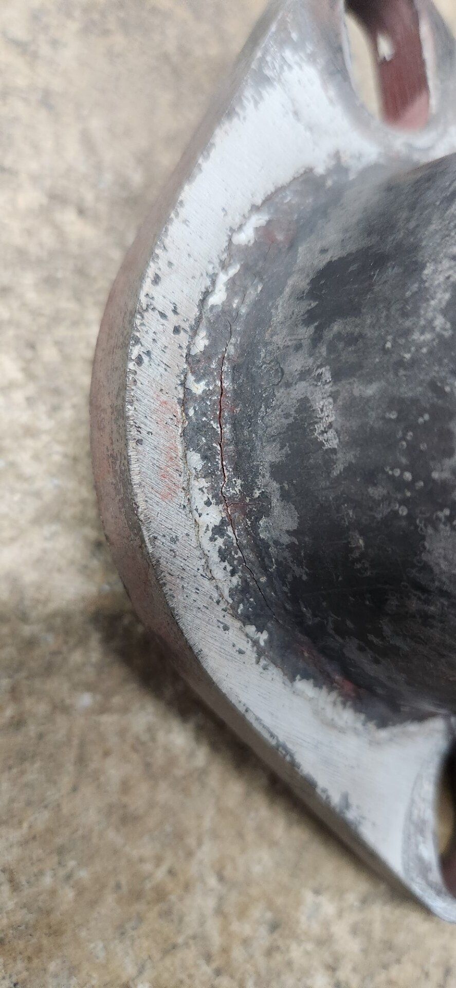

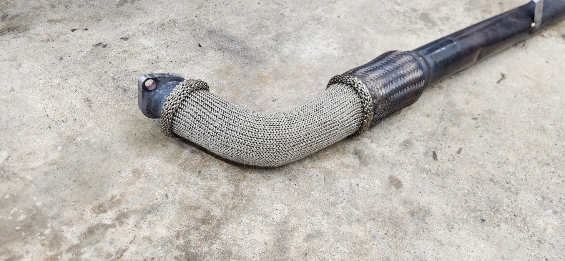

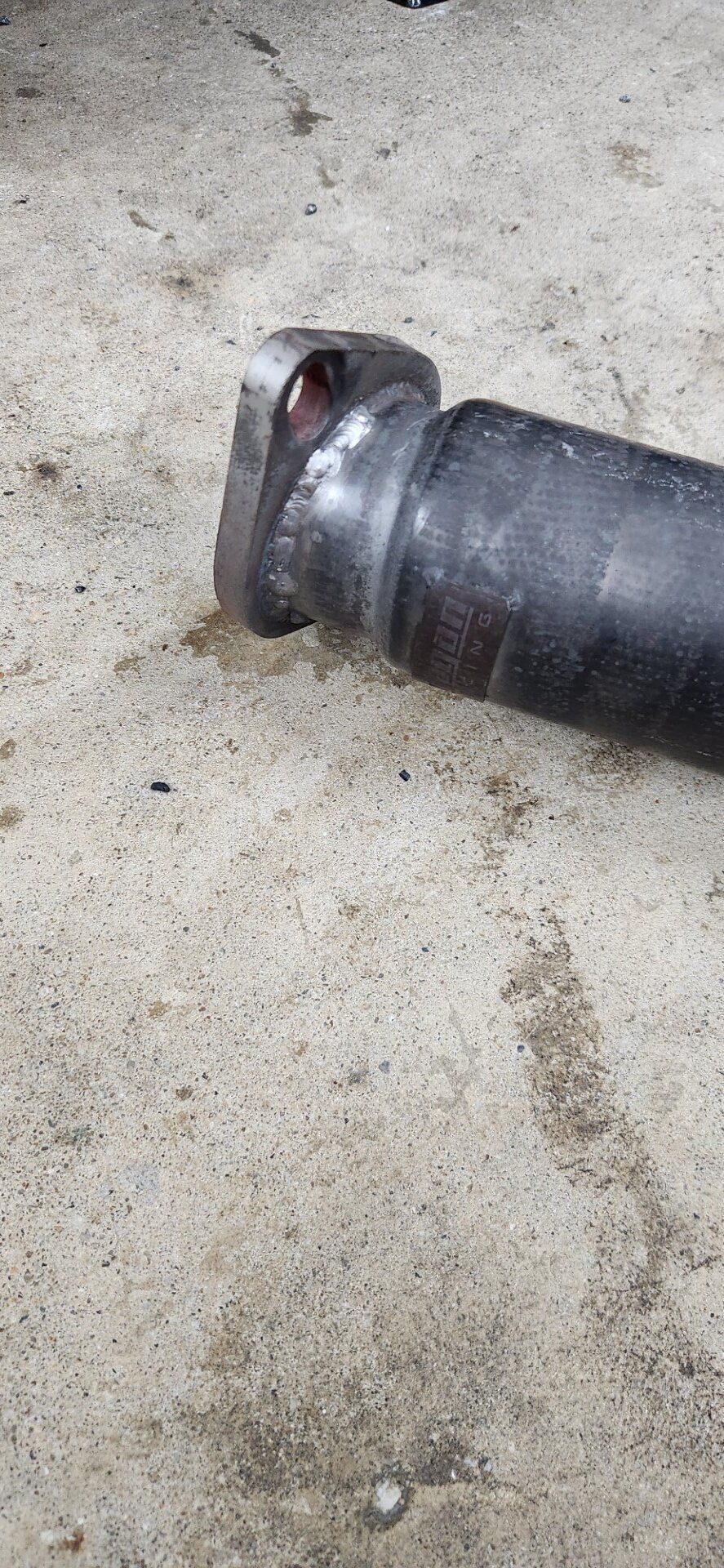

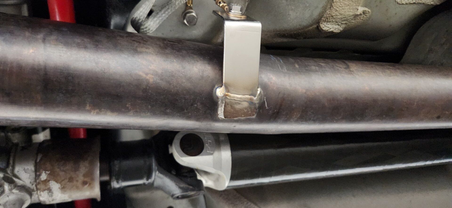

I thoroughly inspected my subframe and compared measurements to Brian's. We couldn't find any damage to it so I got lucky there. I didn't bother making a new underbrace, I'll get to that later. But I decided I didn't want a crunchy downpipe so I ordered one from CXRacing. Well...I remember from wayyyy back in the day that some Megan Racing downpipes/exhausts had flanges that didn't line up (I might have even had one at one point?), but I think I got a weird setup. The CXRacing flange didn't line up at all with mine.
And I didn't realize it was meant for a 3" o2 housing flange. So I just decided to fix mine. I cut out the damaged part, made a homemade backpurge setup since I don't have a dual regulator, and welded in a patch and fixed the bracket that cracked. I used DEI Titanium Knit Exhaust Sleeve this time instead of regular header wrap - this stuff is nicer IMO and doesn't fall apart as easily.
Bolted it back on the car just to find a crack at the flange.
Welded that up. Back in again just to find the flange was warped (maybe from welding, maybe from before?) Resurfaced that. Back in again just to find these cracks on the exhaust manifold that were leaking way more than what they look. At this point I'm definitely questioning why I decided to fix this downpipe instead of modifying the new one.
Welded those up with 308L since I didn't have 309L. This is all the day before leaving for NJMP, mind you, since I procrastinated.
And finally, found the turbo gasket leaking on the passenger side. I was tired of fixing stuff so I just shoved a spare piece of turbo blanket next to it LOL.

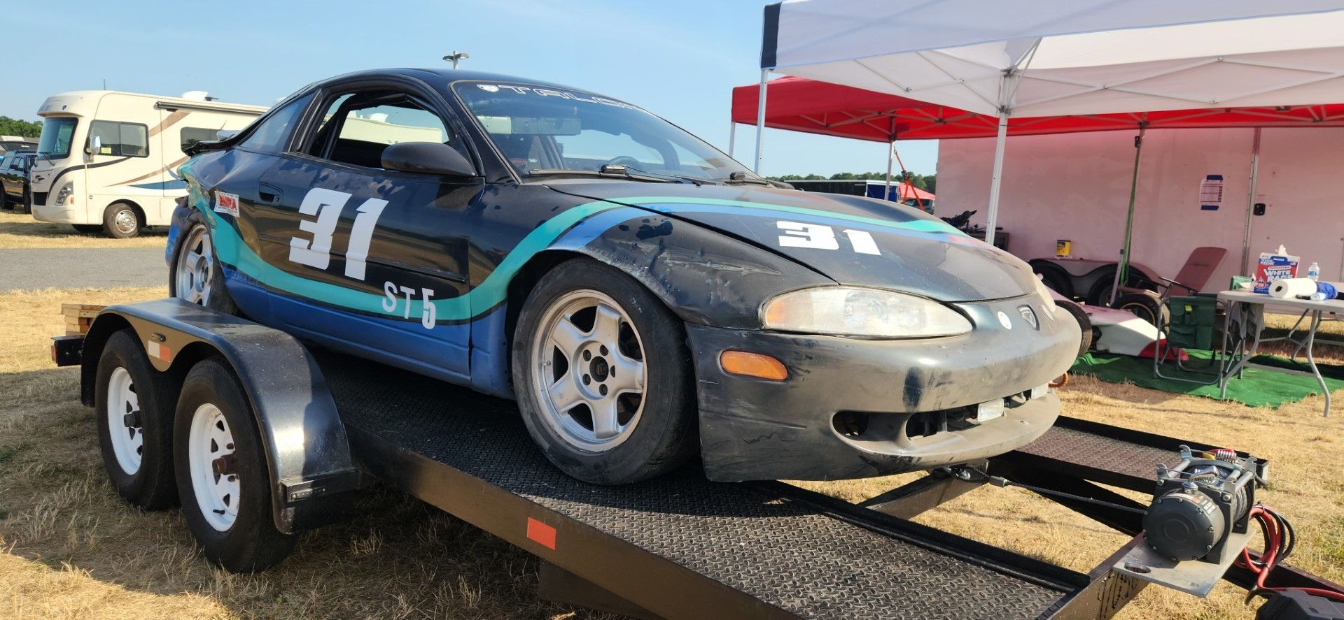

Another DSM (non-turbo)! Unfortunately...there was an Audi that dumped p/s fluid on the bowl towards the end of Saturday that they suspect the Talon got into and put him into a wall. The gentleman was physically ok but they took him to the hospital in the ambulance and he didn't return until Sunday. I'm told that he didn't remember the incident or much from Saturday at all so it was a hard hit. Once the ambulance left they had to shut down the track for the day since they weren't allowed to run without one there.

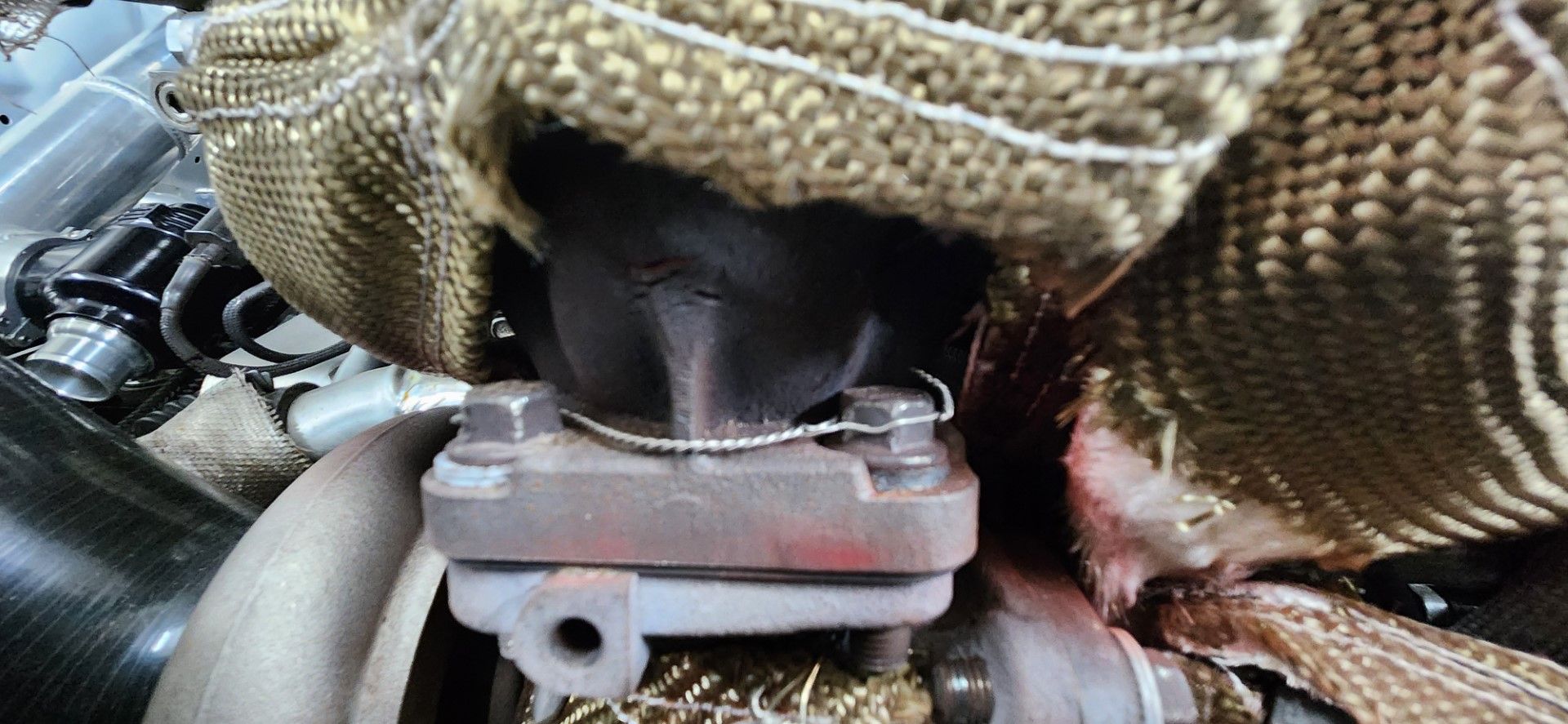

Since the last event, I replaced the turbo gasket since it was leaking badly. It mostly fixed the leak but there was still a small one that I had to live with for now. The exhaust manifold had another crack at the same spot so I welded it up some more. I also slapped a bunch of RTV around the backup sensor to try to prevent that from leaking when the trans pump kicks on. And I got rid of the Mausberry on the RaceCapture RPi and just wired it to a hard-wired cigarette lighter USB power source instead. A fresh set of G-loc R16 pads were installed in front since they were getting low. Maybe a couple of other small things but that was basically it. And my vanity antique plate finally came in. Brian has "GST" on his plate so I tried to get "GSX" to match but somebody already has that and I had to settle for "2GSX". We're only allowed four characters on antique plates in PA.
