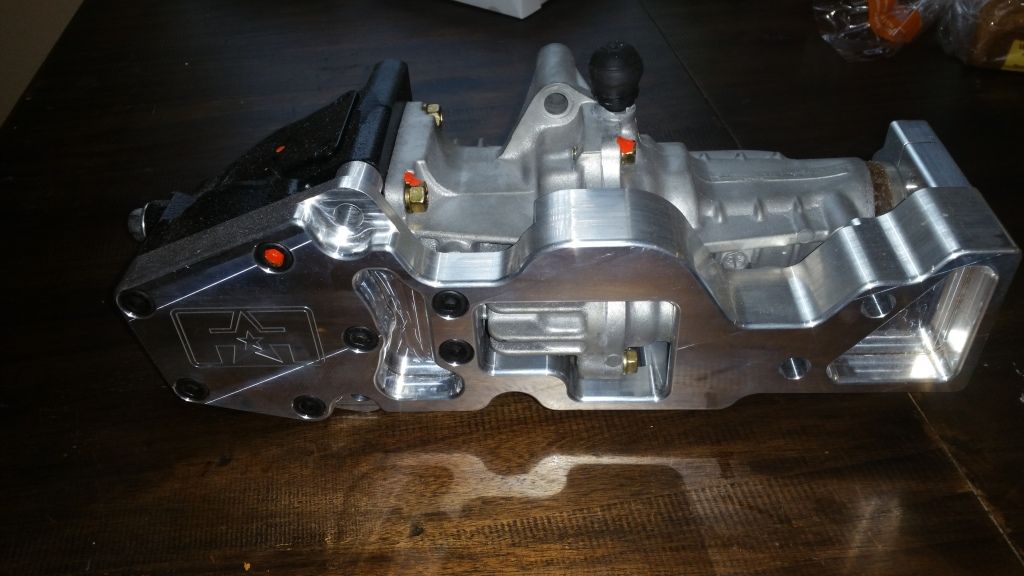

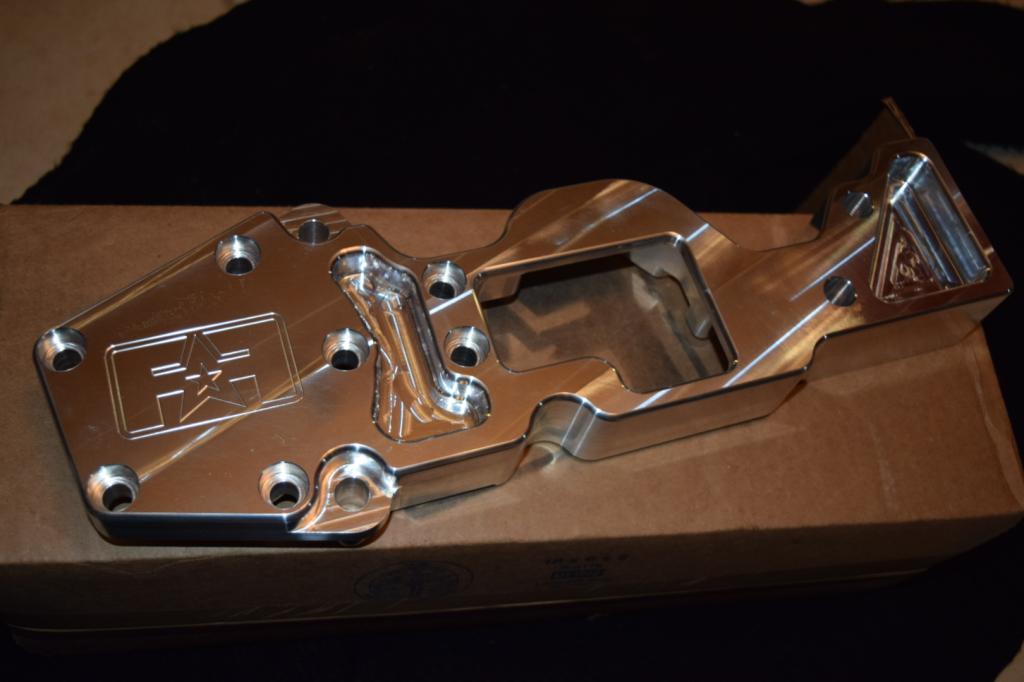

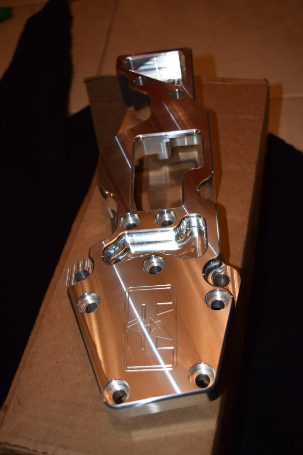

Got my FF Transfer case brace

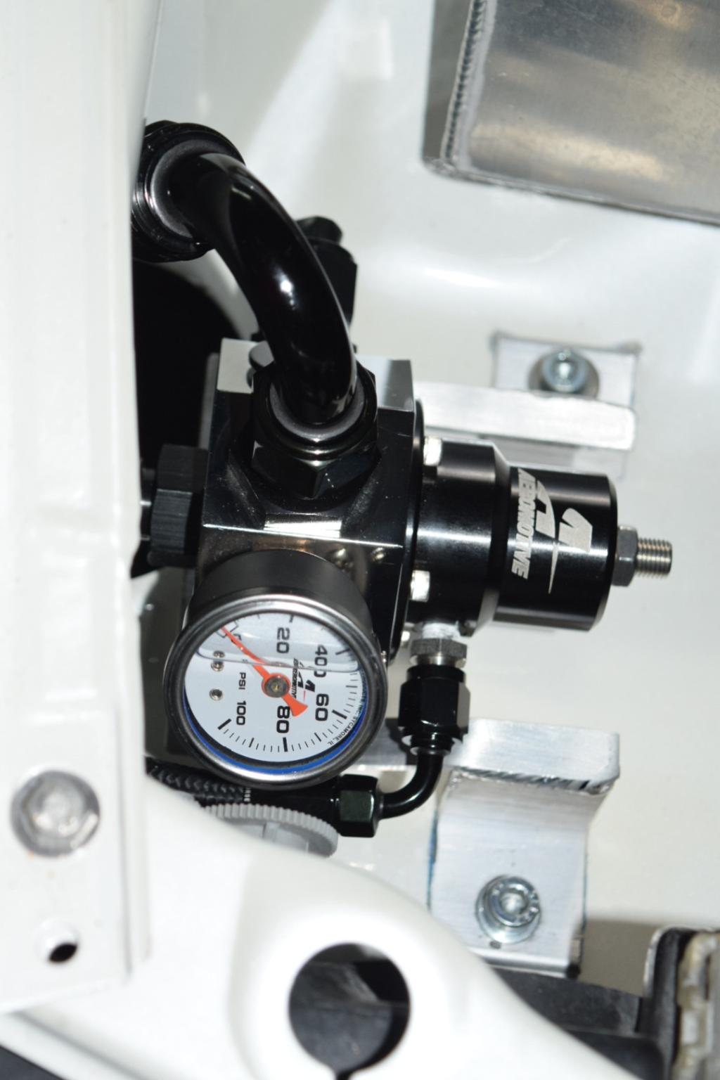

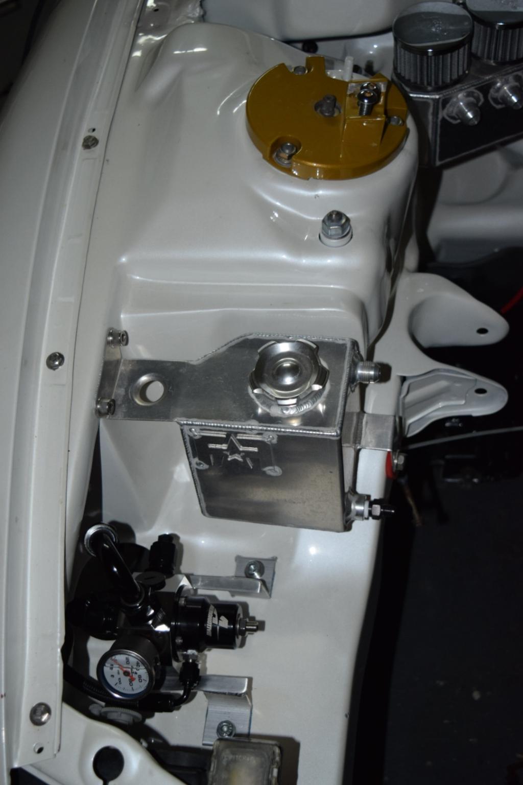

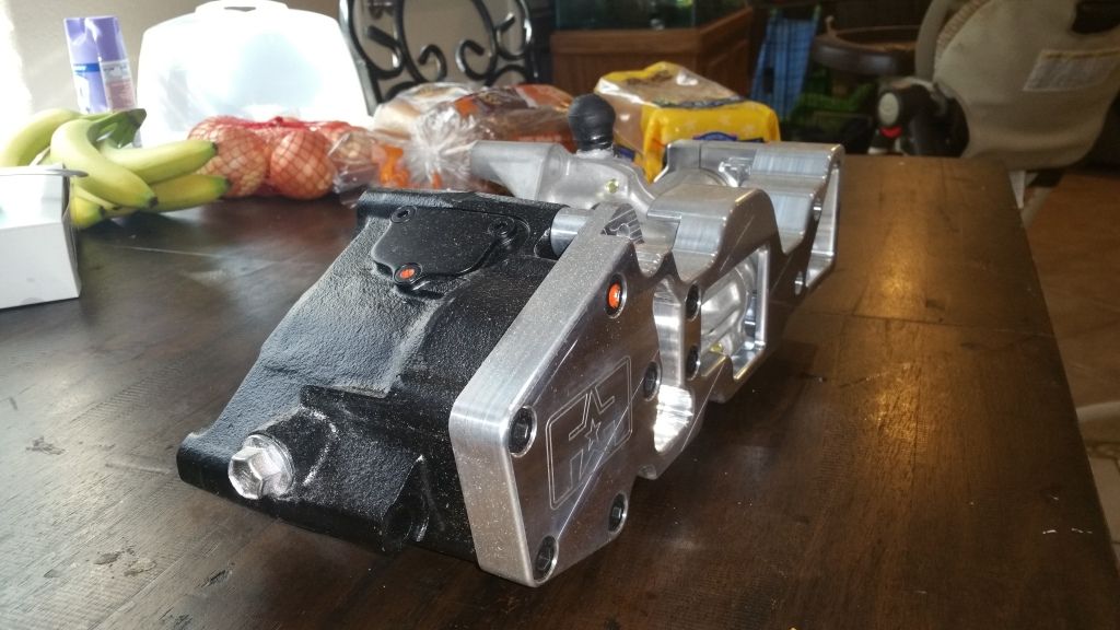

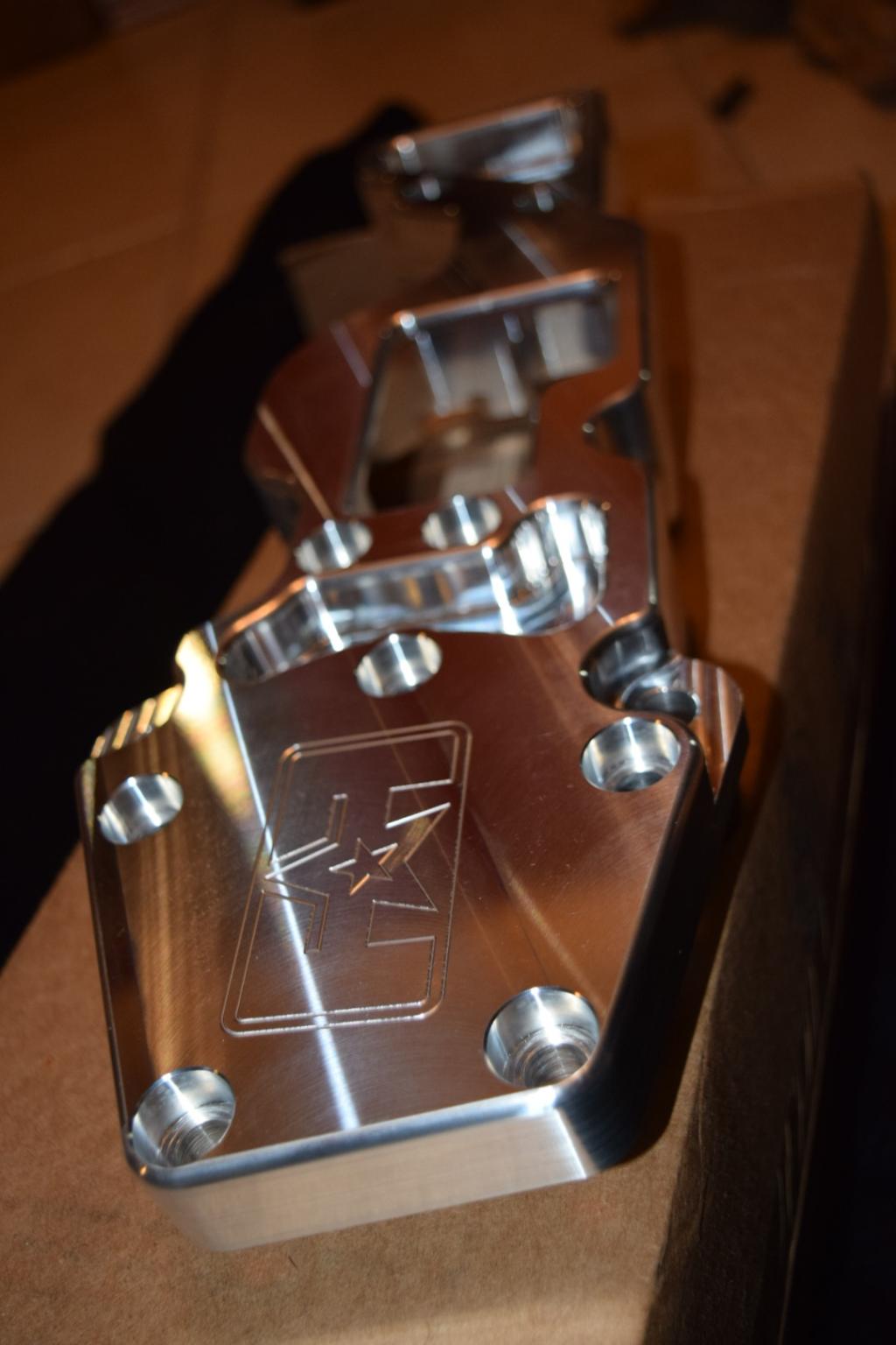

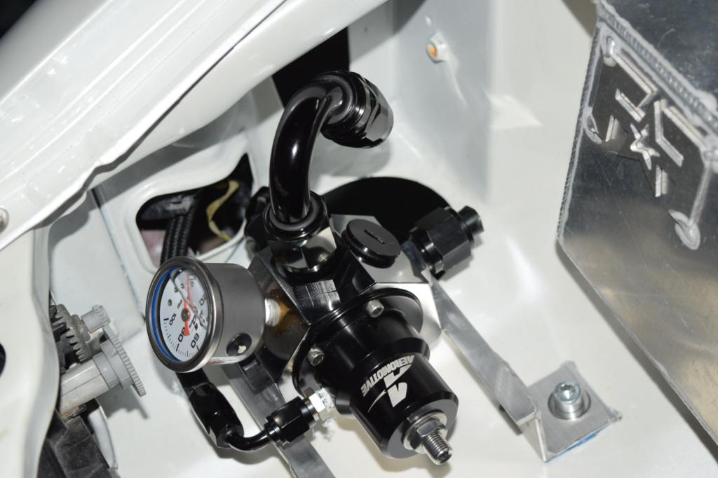

I relocated my FPR, With the DVDTFab, there is not much room left for it in itd traditional place.
I have not ran the line to the fuel rail yet, Ill get that done this week, waiting on the line.

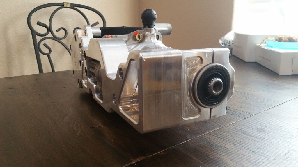

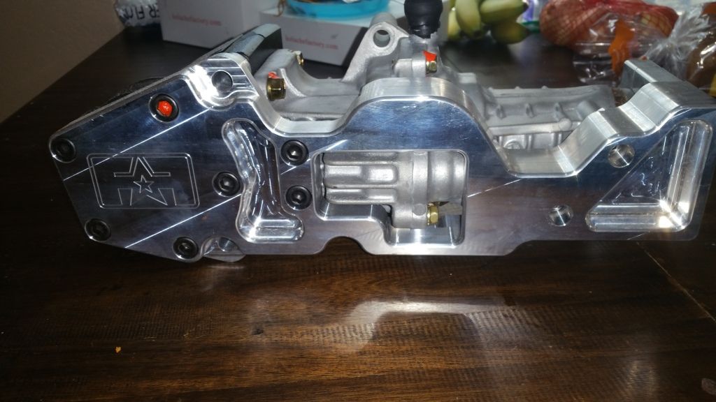

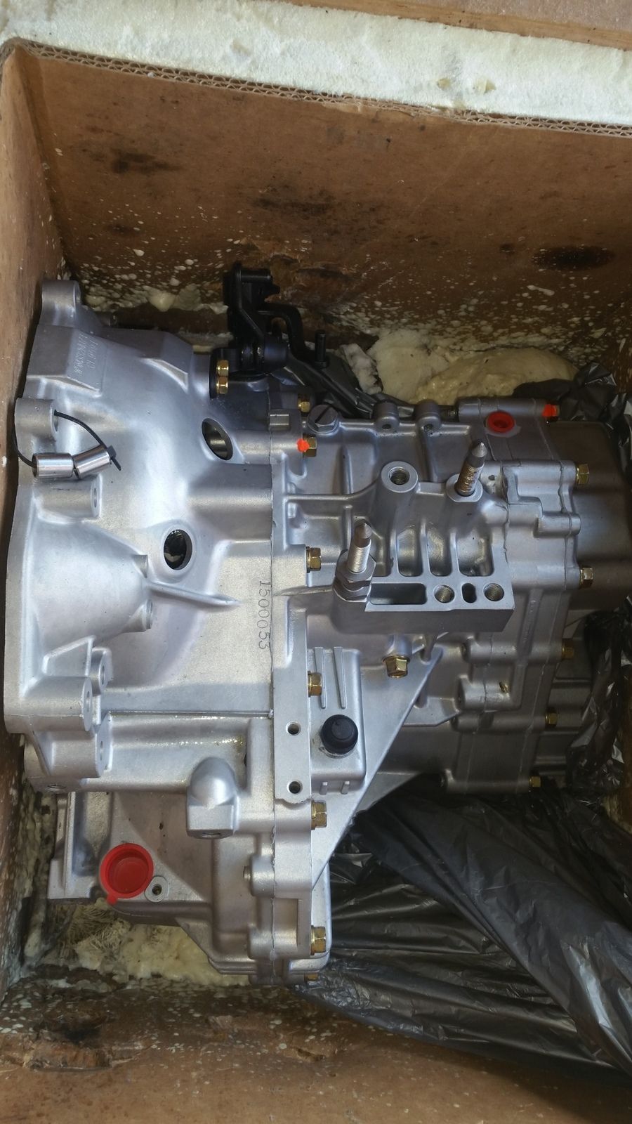

Trans will be here soon.

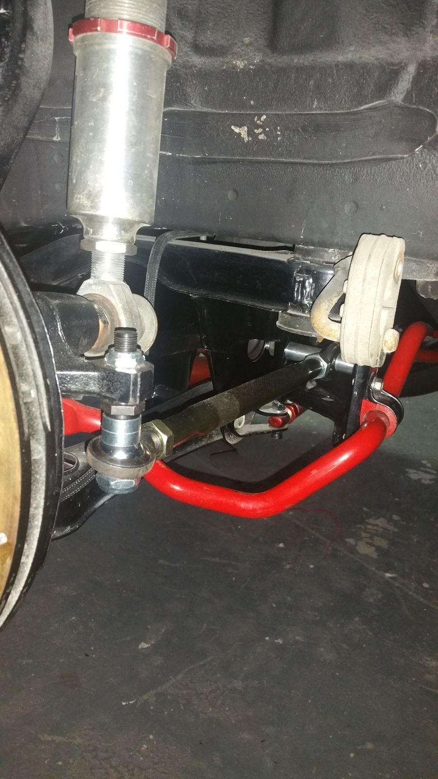

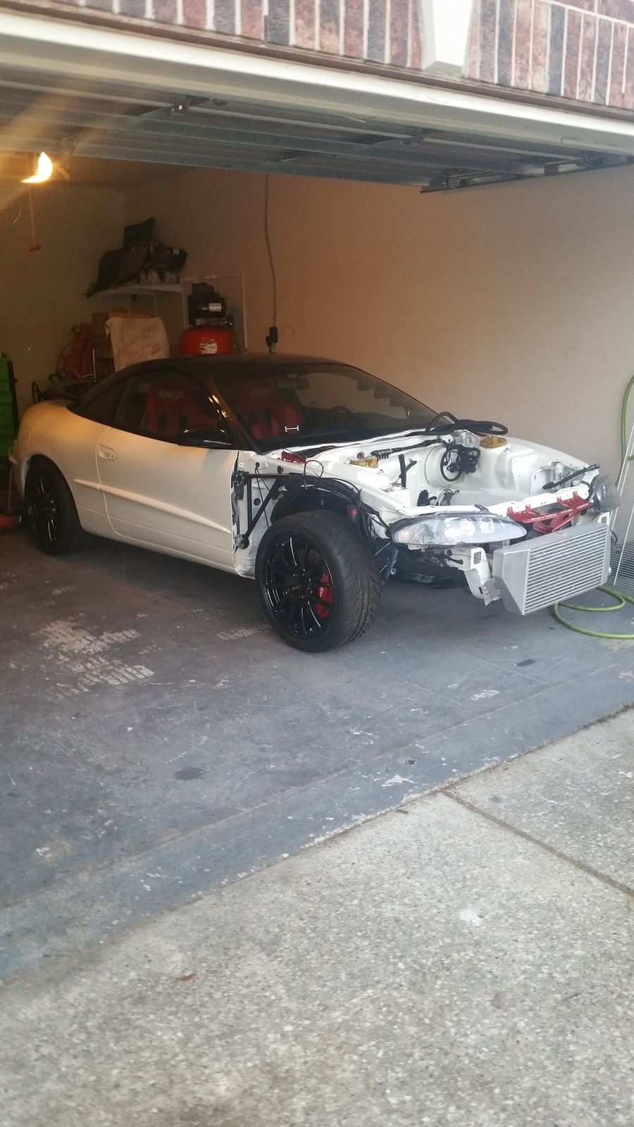

So today I am quite proud of myself. I got the rear axles installed as well as the lower control arms. I got all of the rear-end suspension tightened up. I know many of you have been waiting for a part-out, LOL, but its not going to happen. The car will be going to get the motor put in within the next few weeks. Just waiting on the Jm Fabrications top-mount v-band manifold. I'm so excited its been a loooooooong time.

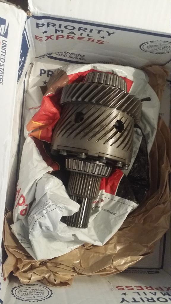

So i was told a while back by John at TRE, that this was not a Quaife, but a Kaaz. So I meant to change this and forgot, until another awesome member, pksystems brought it to my attention. It is installed now and I hope I will enjoy it.

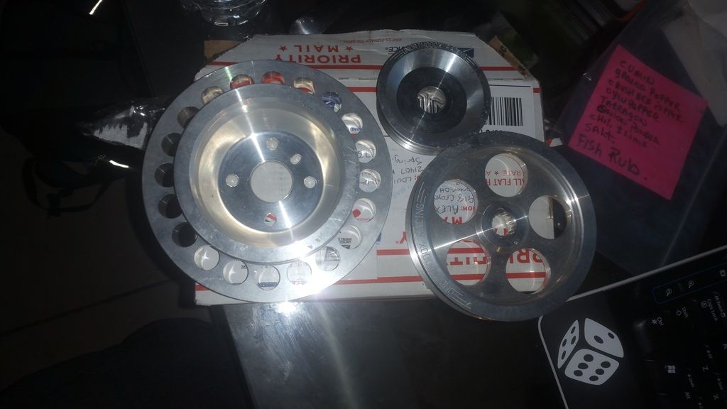

I picked these up to match the cam pulleys.

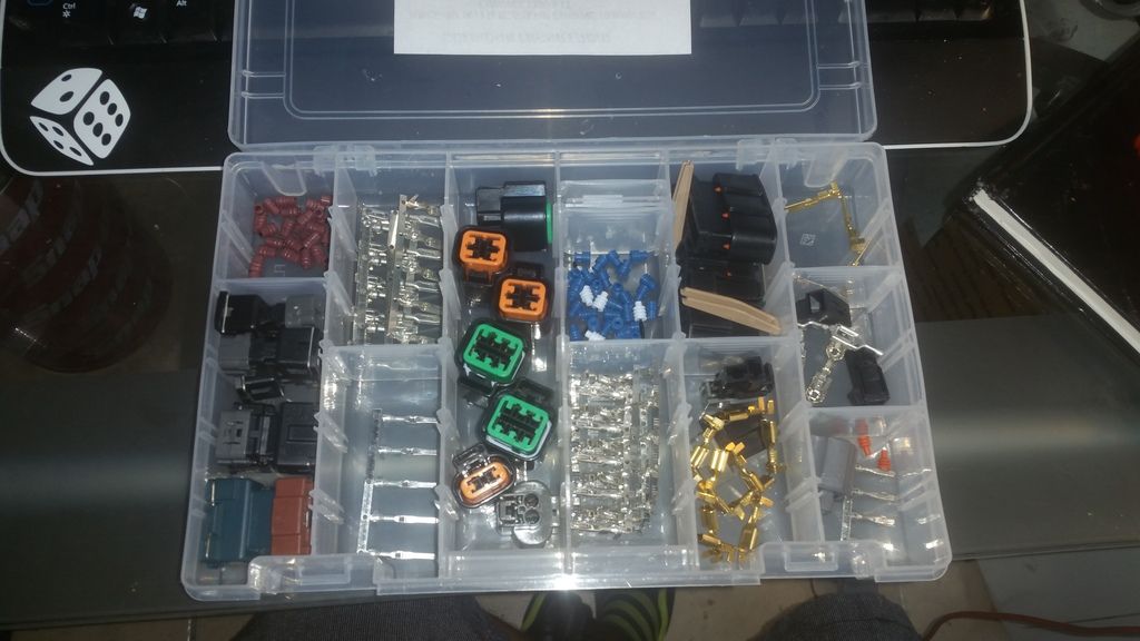

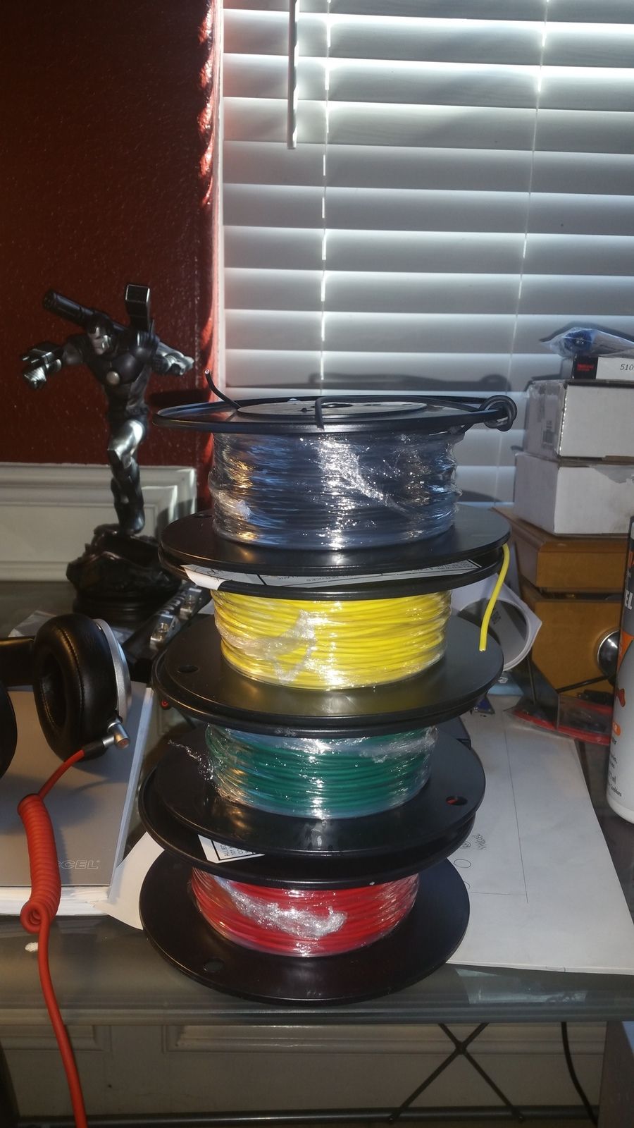

I also decided while doing the tuck to replace all of the wire and connectors under the hood. I can not wait to see this car finished.

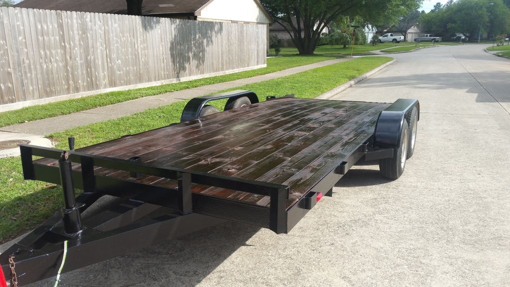

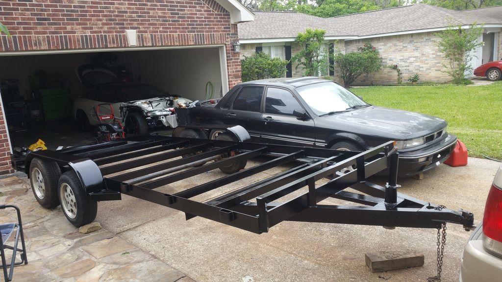

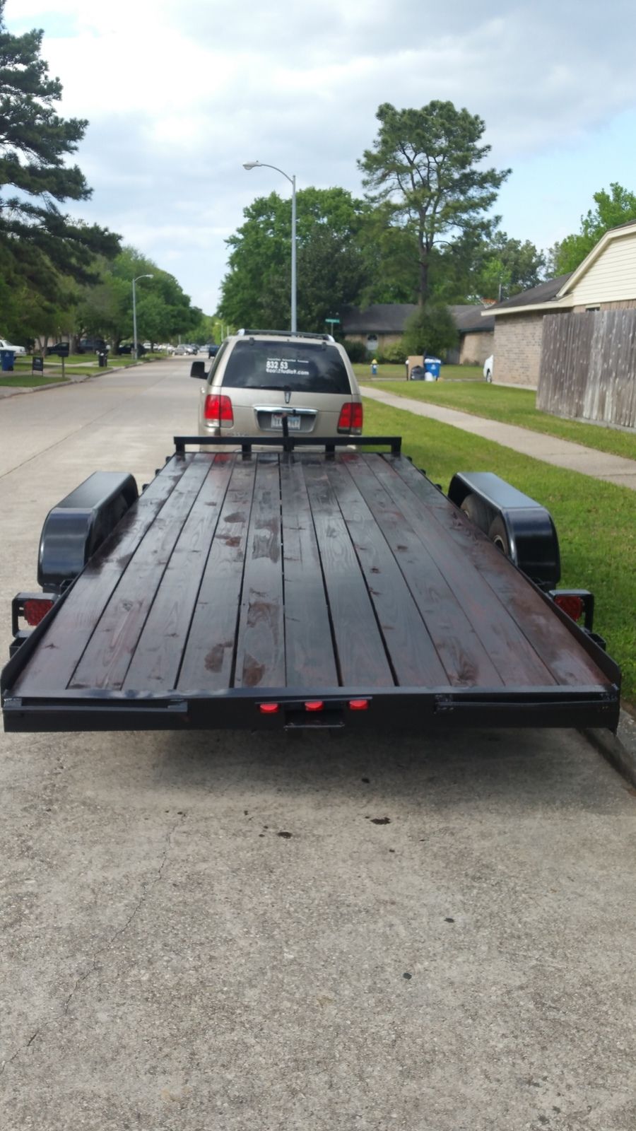

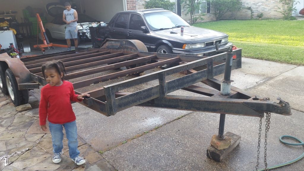

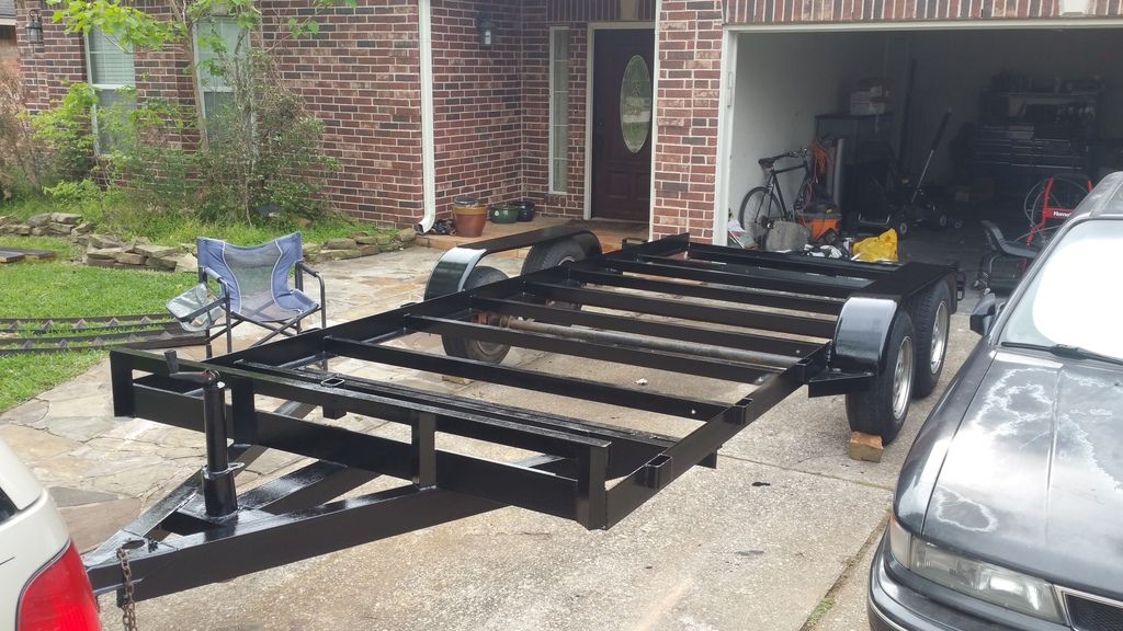

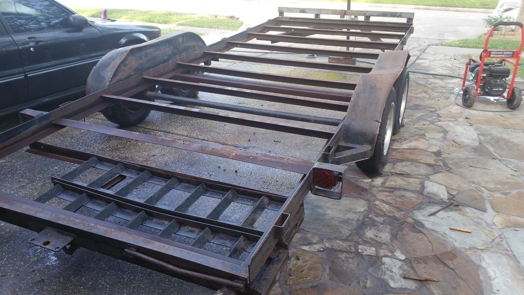

So I was so blessed to come across this trailer a while ago. The guy did not want to sell it. It belonged to his son and he had asked him for a couple of years to come and pick it up. I made him an offer and he finally excepted after a year. While it may not seem like much, the style of trailers are sought after here. So here is the before and after. This is what Gracey will ride on when needed.
