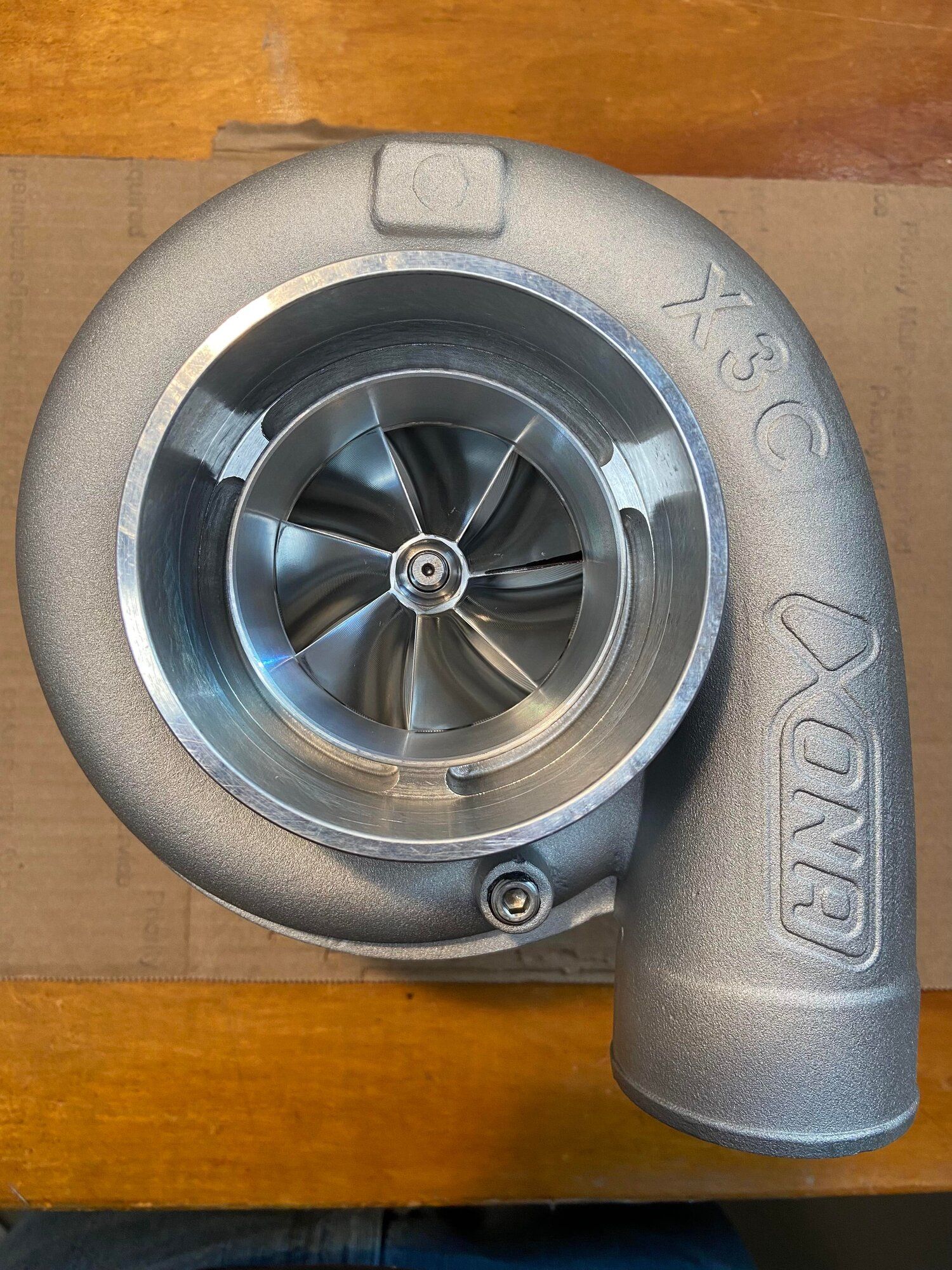

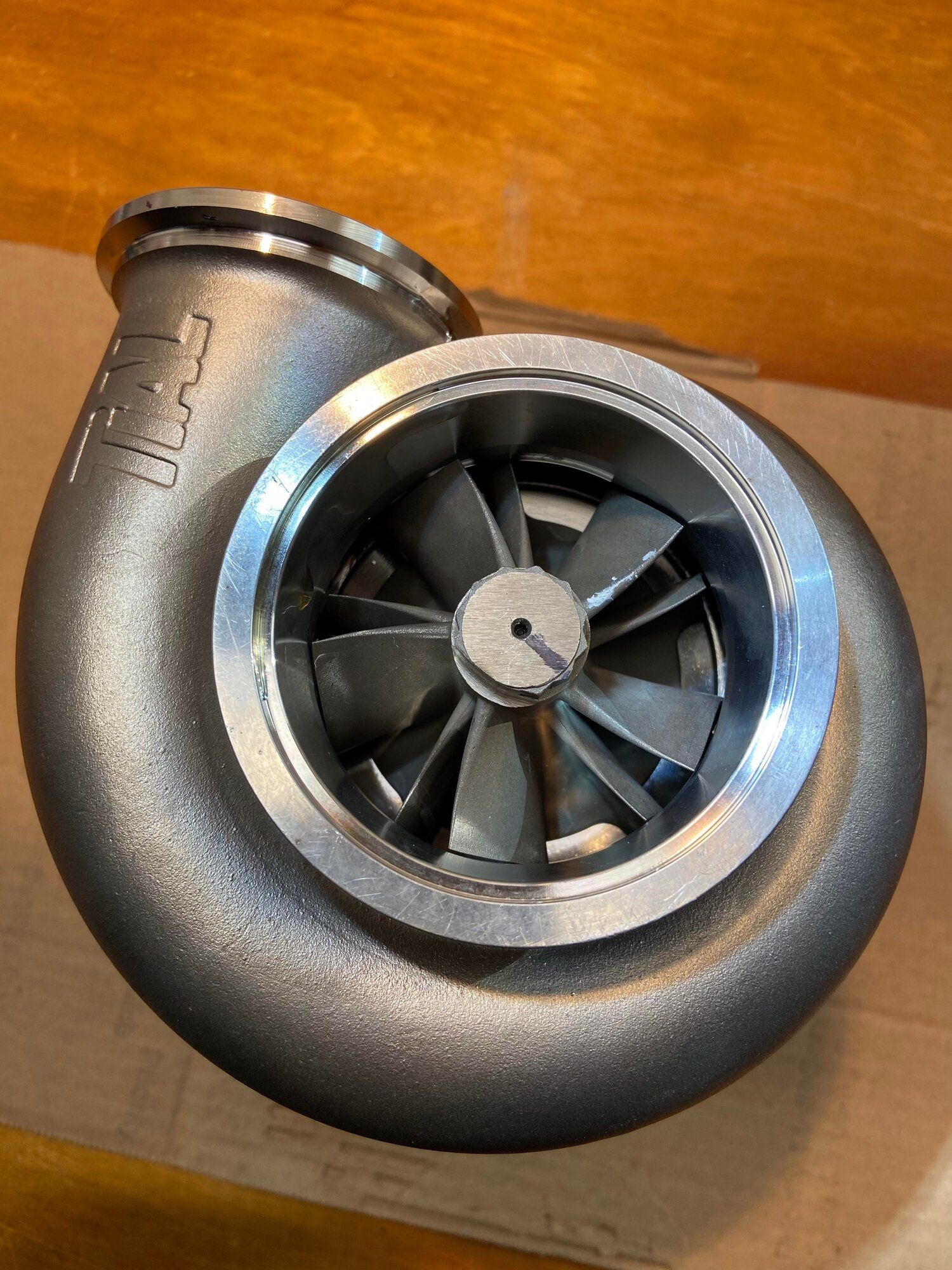

Well I finally have something very PRETTY to look at! The turbo showed up the other week, and this thing is a beaut. I'm not going to disclose all the sizes due to the type of racing I'm in, but it'll be a nice power upgrade which I need since I'm moving away from using any nitrous down the track. Next to show up should be the @MorrisonFab work of art exhaust manifold! I'm thinking maybe another month or so on that piece, but it should pair with this Xona rotor turbo perfectly.

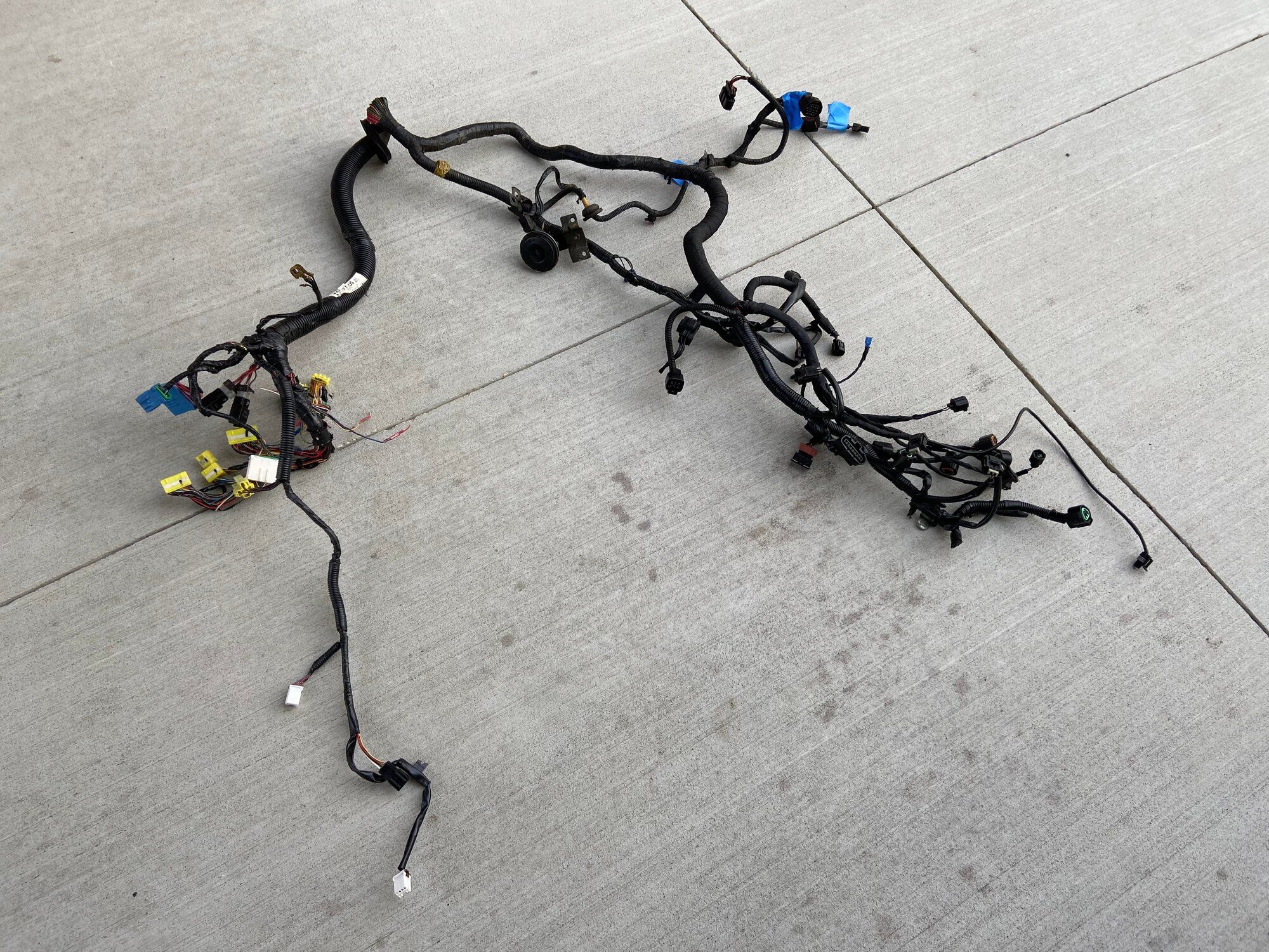

I also wanted to go ahead and take a look at the engine harness and re-loom it with some fresh TESA tape, well I fund the wires were a bit of a mess, and a bunch of cracks on the wire insulation. I decided to add a OHM Racing engine harness to the list of mods for the winter! I can't wait to see a fresh brand new engine harness in the car! Since they do not accommodate anything for the auto trans connections, I will be making my own small shiftbox/trans harness and will post that up also. I'll go more in depth with that once the engine harness shows up (ETA of end of March/start of April).

OHM Racing did a great job on the new engine harness! I just need to make a shift box harness myself, and rewire a handful of things, and that should do it for electrical. I plan to pull the dash out and take out as much as I possibly can, then install the harness and get the dash back in.

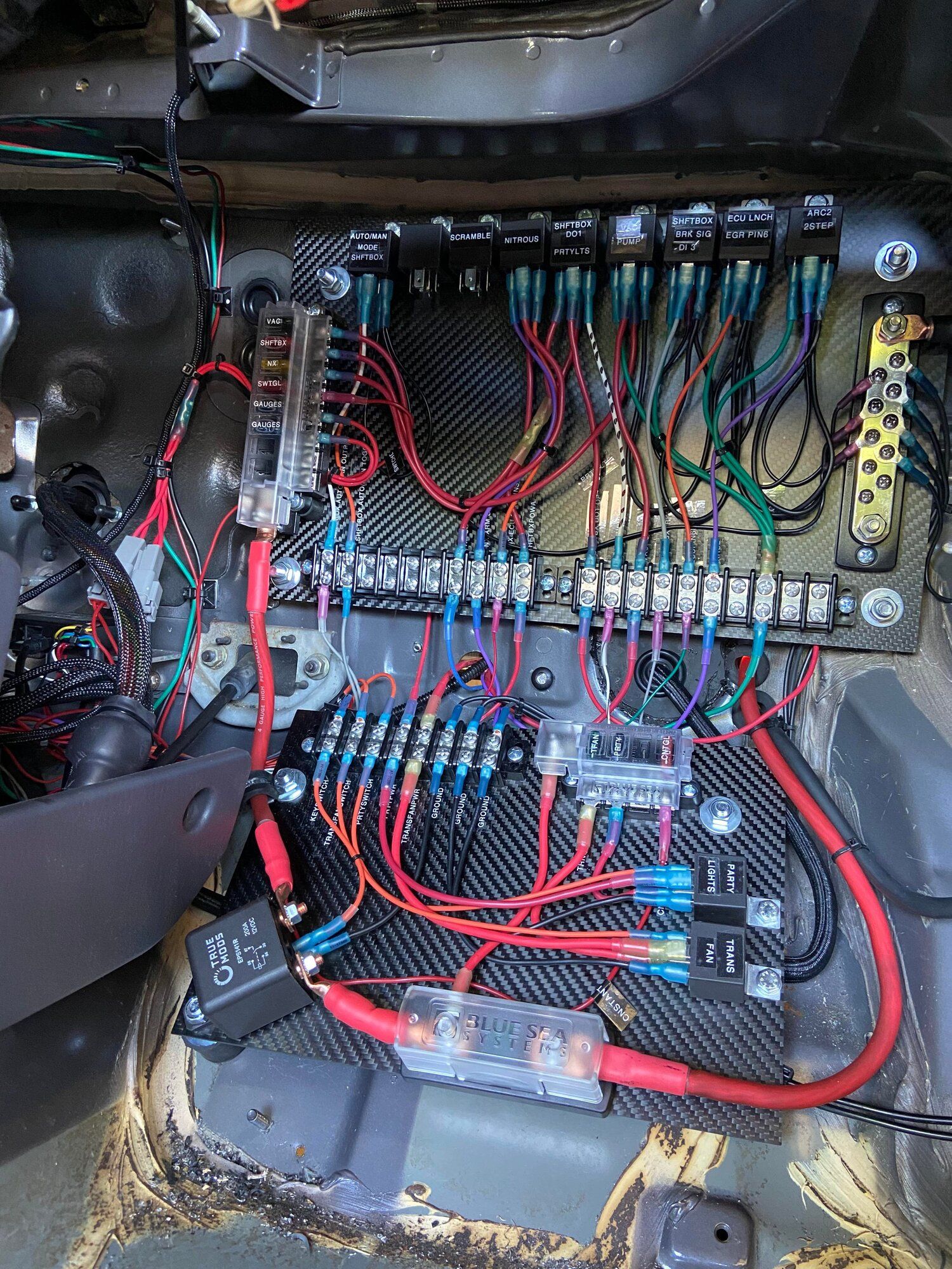

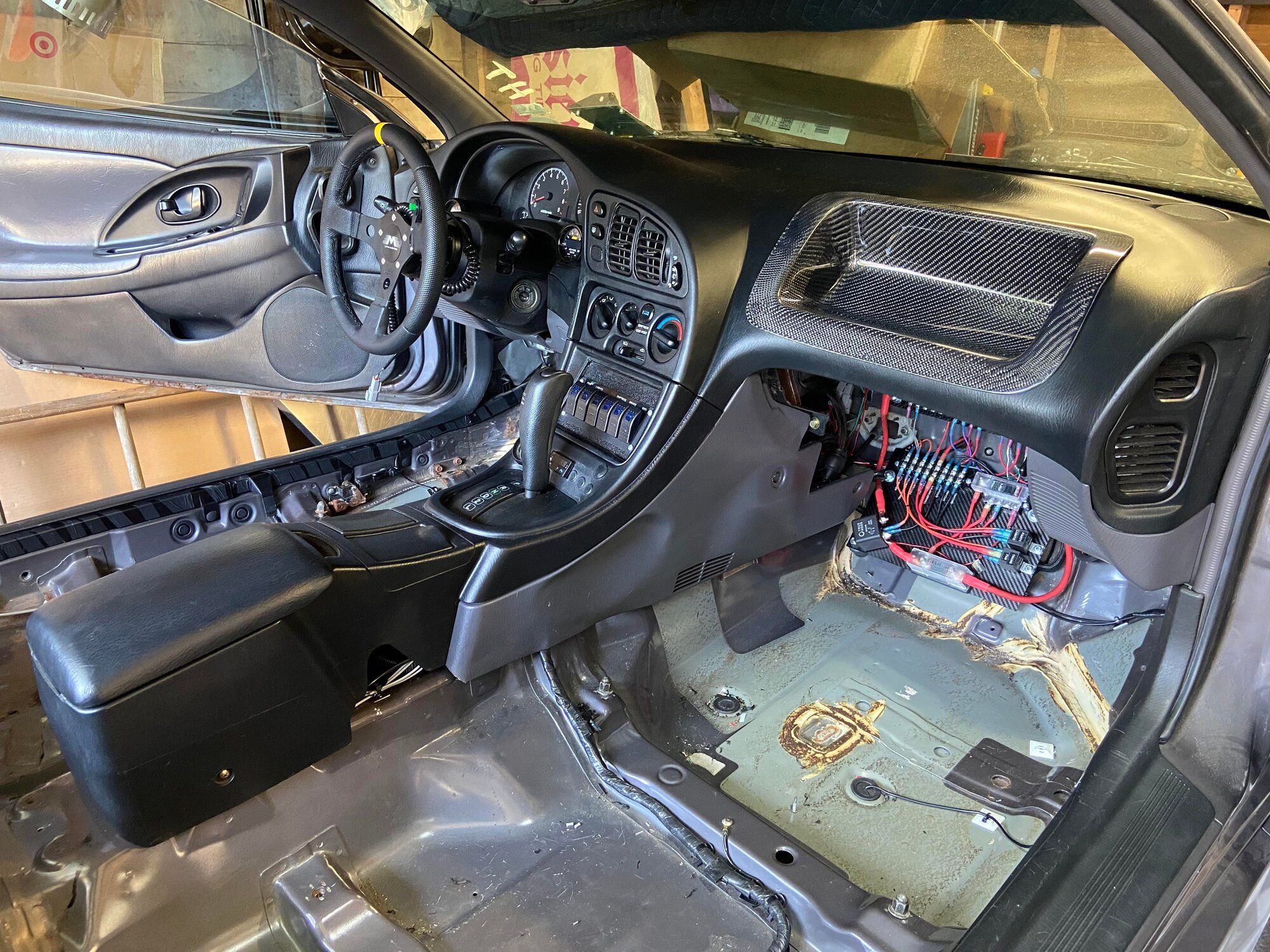

It was time to redo all the wiring I had previously done for the relays and what not. I ended up making two separate relay boards. The main board which has 9 relays, mostly for the launching tricks that are needed for these auto cars. The second board consists of 2 30/40amp relays that will have constant 12V, and a switched 200amp relay that will feed the main board. This secondary board also has a 125amp inline fuse between the battery and 200amp relay. All in all, I'm happy with how it has turned out, it was literally a mess of wires before.
Before: Yeahhh, I definitely didn't care about presentation, I just installed as I went, covered up with the carpet LOL, and it all worked so I didn't bother cleaning this up till now. Believe it or not, it was actually way worse than this photo too when the OEM harness and the mess of wires used to install the shift box's harness was still in there LOL.
And some of relay board progress and where I stand as of now:
Also, as you can see I have gotten the OHM racing harness installed, and made the shift box harness. It was really nice they made this harness with pigtails I requested for the VSS, TPS and RPM so I was able to feed the shift box those signals that way.

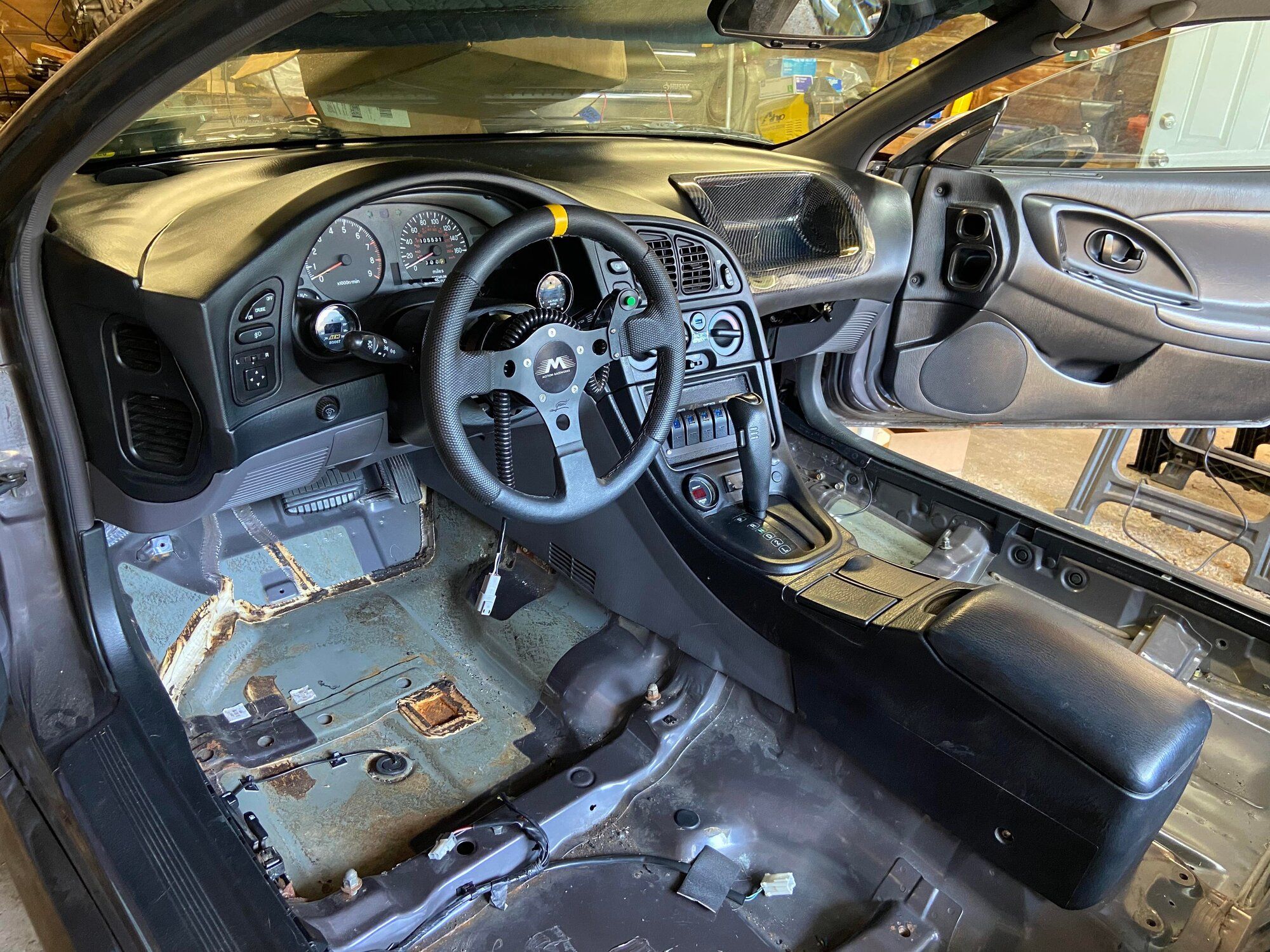

Just tossed the dash back in!
All in all it was a great project for me. I came away with a WAY better understanding of the different ways relays can be used, and how everything communicates to each other as a whole.

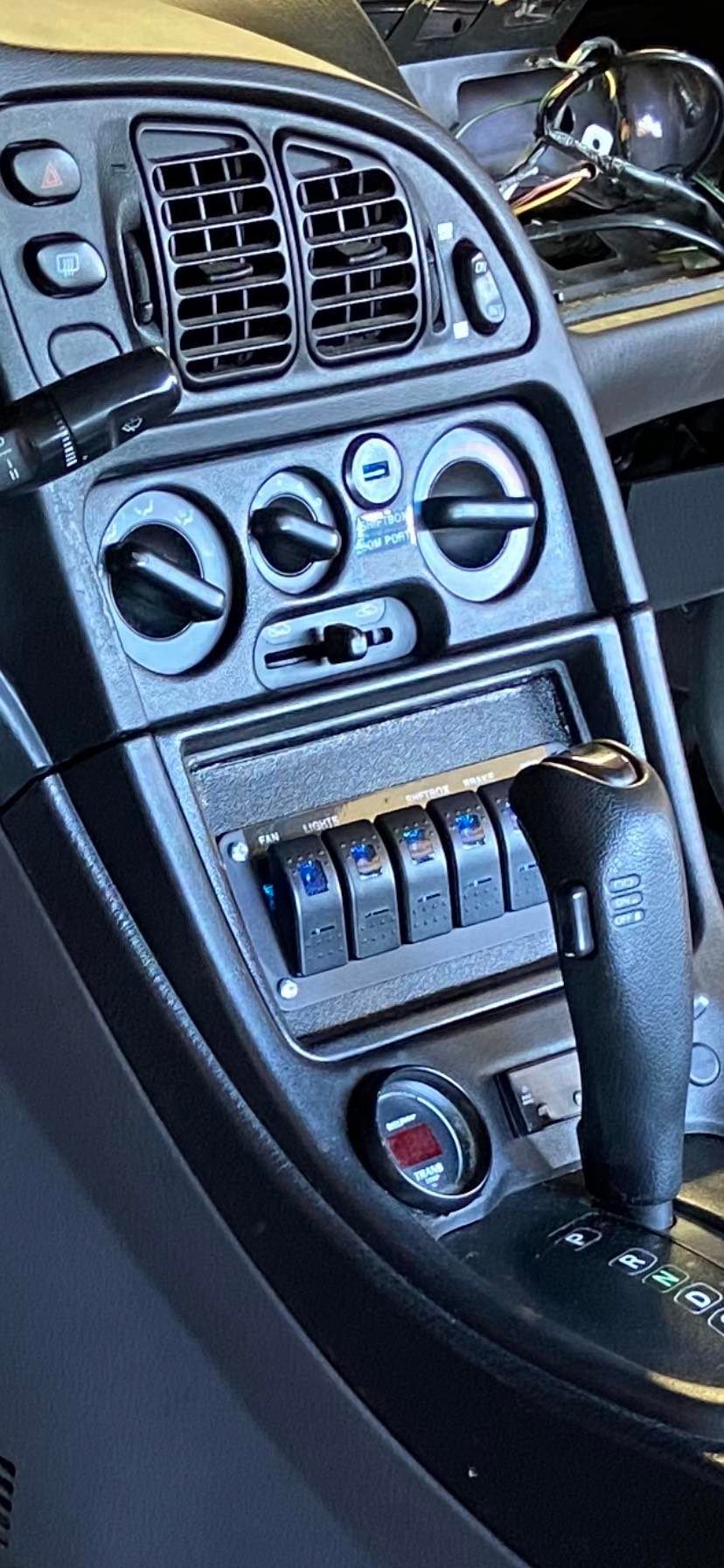

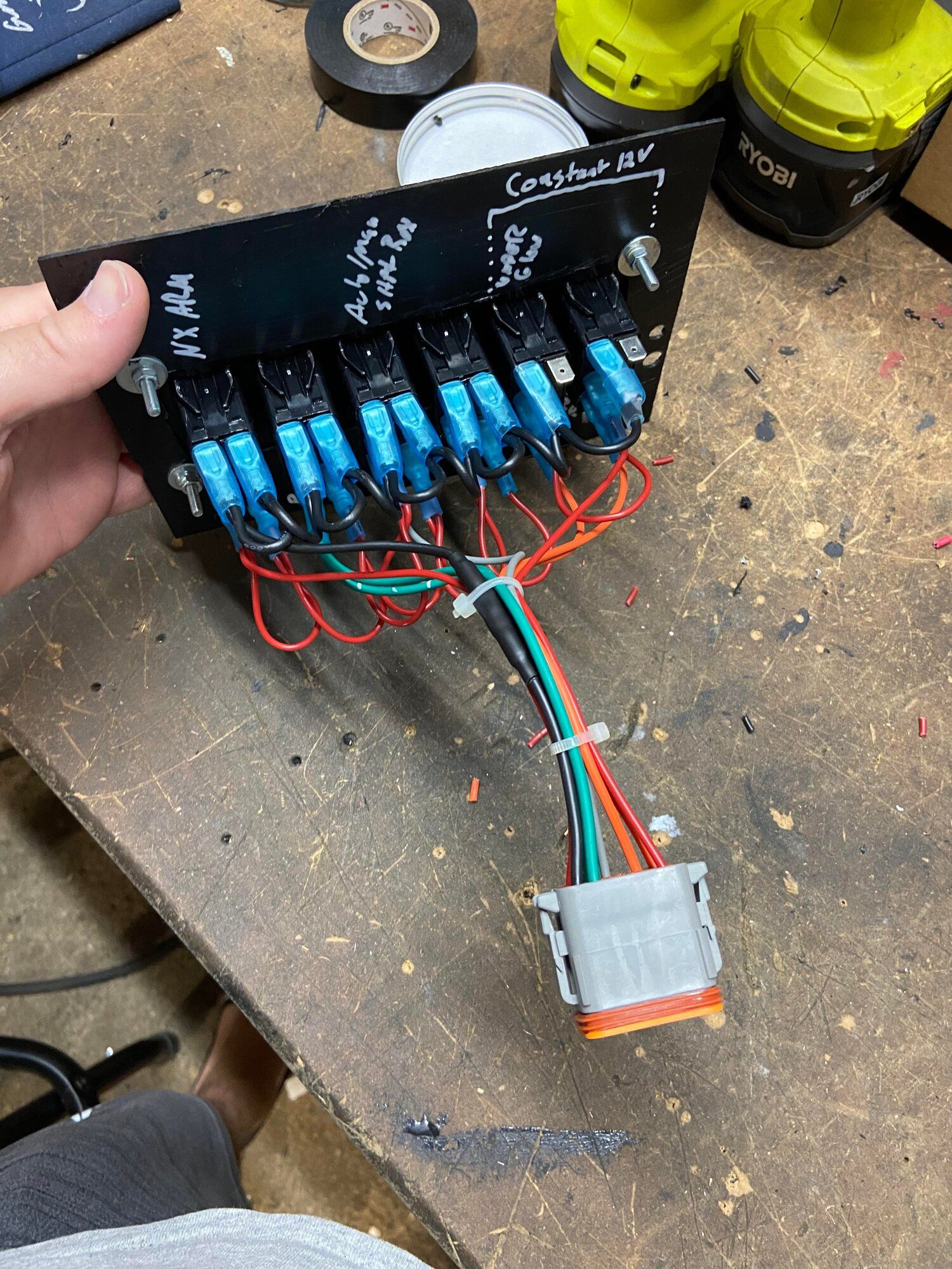

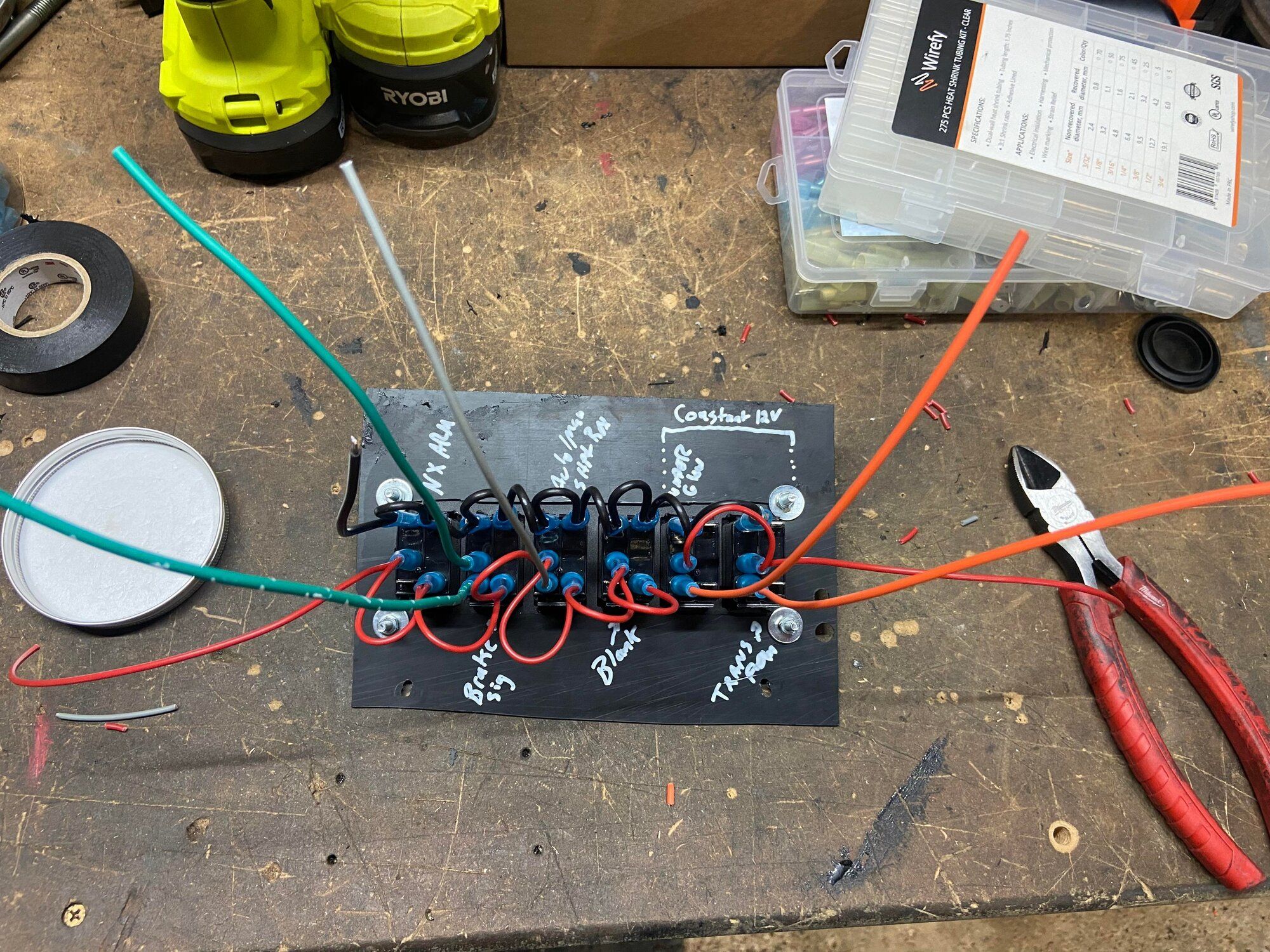

Just a little fun update I have for today. I have installed a switch panel in the location of where a radio deck would go, and have deleted most of the car's speakers. I didn't want to totally lose the ability to listen to music though, because this is still a car I plan on driving around and enjoying. Originally I was looking for some kind of solution, like a single AUX input or something that I could just plug my phone into, and get audio through two door speakers. I'm not very knowledgeable with car audio, or the different options out there to be honest, but I managed to stumble across these cool little mini wireless, bluetooth sterio/AMP on Amazon.
It was cheap enough, so I decided to order it, and see if I could make something work. Super glad I decided to just tackle this little project now, as I have already ripped into the interior pretty good! I paired this amp with a custom harness I made that plugs right into the car's oem radio harness, and just used wires to send audio to the door speakers, worked like a charm! I found my old speakers were completely toast, and the passenger side speaker just wasn't working anymore, so I went back to my trusty Amazon account, and ordered up some super cheap 6.5" JVC speakers to toss in the doors.

I also have completely wrapped up (till I need to add something) the relay board and switch panel. This project was fun, I will post up photos of that once my Carbonetics airbag delete tray comes in (should be either today or tomorrow according to the tracking number) to give the interior a more finished look. I just need to now finish up interior stuff from the rear seats back, and find a solution for some carpeting, and I can start to think about moving forward to the front suspension and power train stuff!

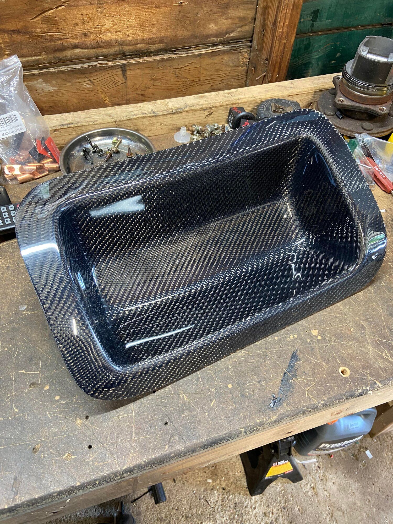

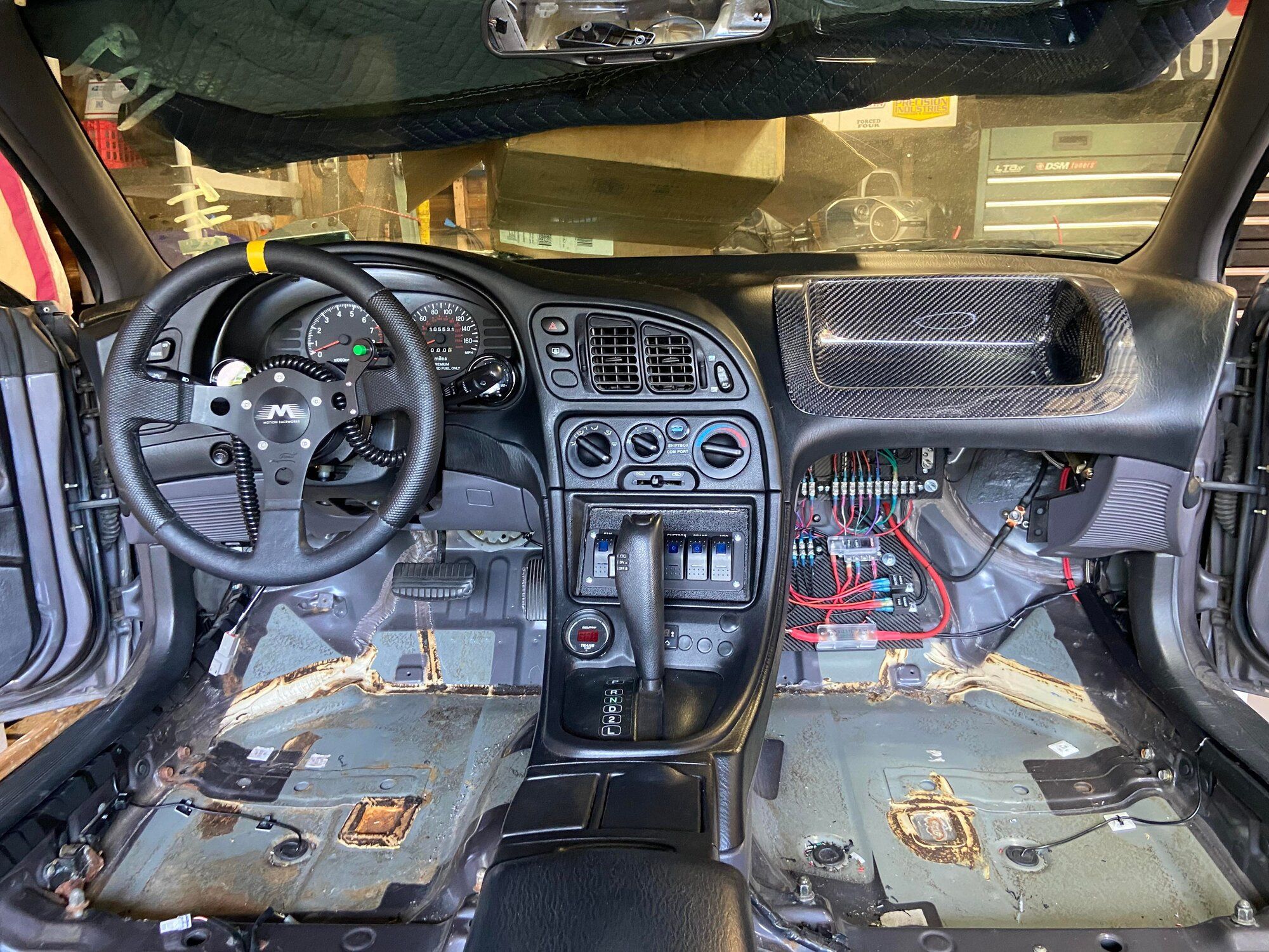

Got the air bag delete from Carbonetics, it's a pretty nice piece! Much better than just having an open hole in that location imo. I believe I ordered it in December, so honestly it came at the perfect time for me. I tried to order as soon as I made my mind up on it.
Anyway! Here's what the final product looks like for the relay boards. I'm happy with how it turned out, my fingers will 100% be crossed when I put some power to it and test out all the communications. Crazy to see just how many things are integrated together when it's all arranged on a board! I still have two more relays in the rear of the car for the fuel pump!
Also here's a photo of the switch panel. It's a pretty "budget friendly" solution, I spent all my money on relays LOL. Everything has since been labeled, and it's a lot nicer looking than the 4 or 5 different style toggle switches I had somehow crammed all in the bottom right side of the center counsel. Those holes have been plugged up with grommets, and that usb port where the ac switch use to be is the communications port for the shift box.
Just some pictures of the air bag delete mocked up and where I'm currently at with the interior project. I believe I have an idea for some carpeting, so in the next couple days I may take some measurements and get something ordered to work on that.
I still have to mount the Kirkeys, and maybe just a harness bar for now so I can at least drive the car around a bit once it's running. At the moment, a cage is in the plans, but I'm not sure when I will get to it just yet due to a lot going on in life. This car will never see full 1/4 mile hits without a cage so I def will try and start to budget for one.
Anyway, I'm looking forward to possibly starting powertrain stuff soon here. As always, thanks for lookin!
View attachment 665893View attachment 665894View attachment 665897
View attachment 665898View attachment 665899View attachment 665900

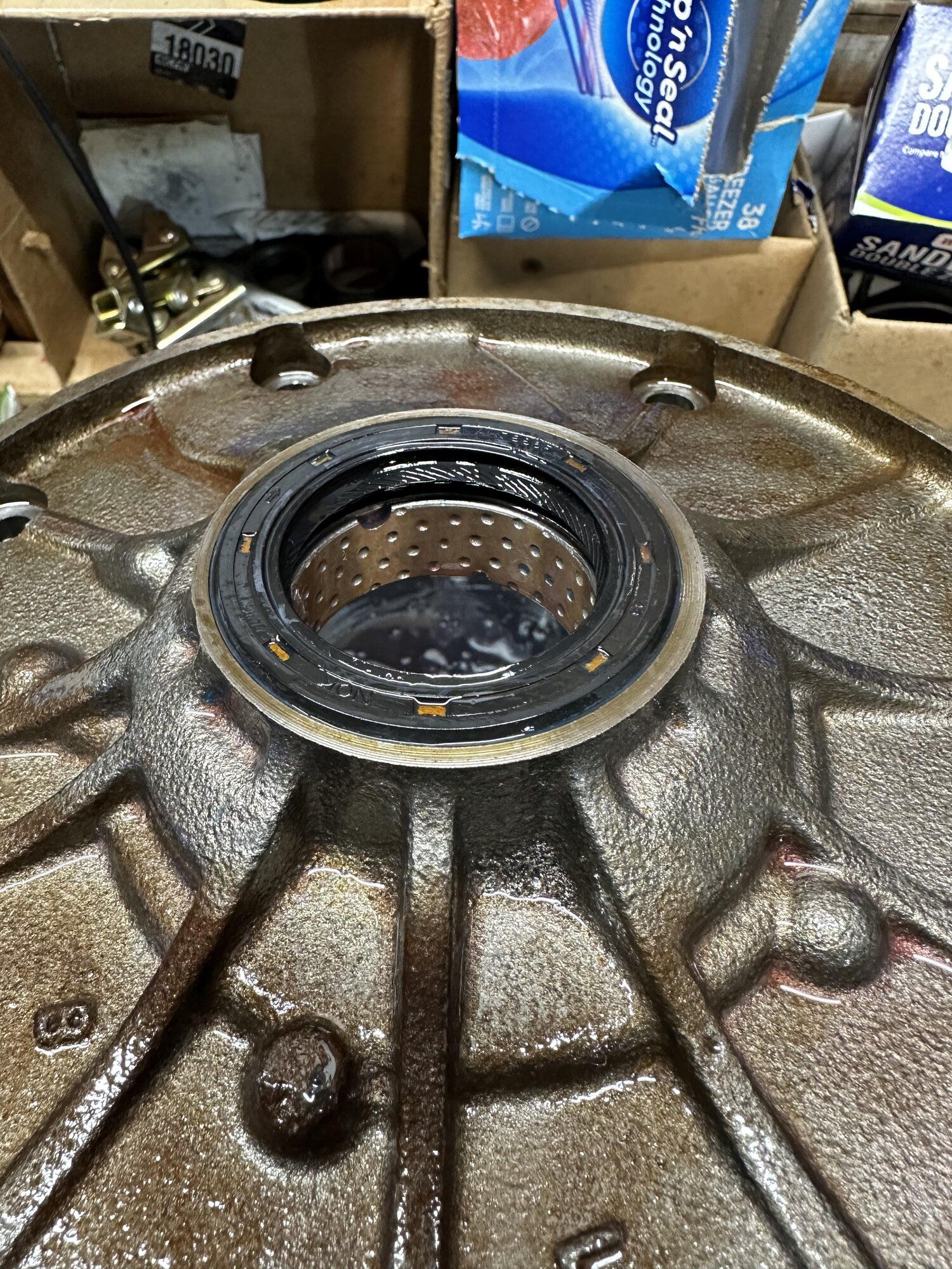

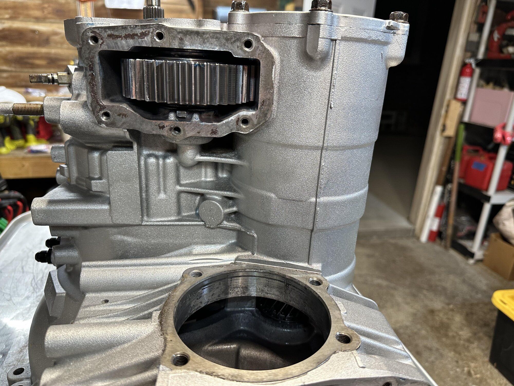

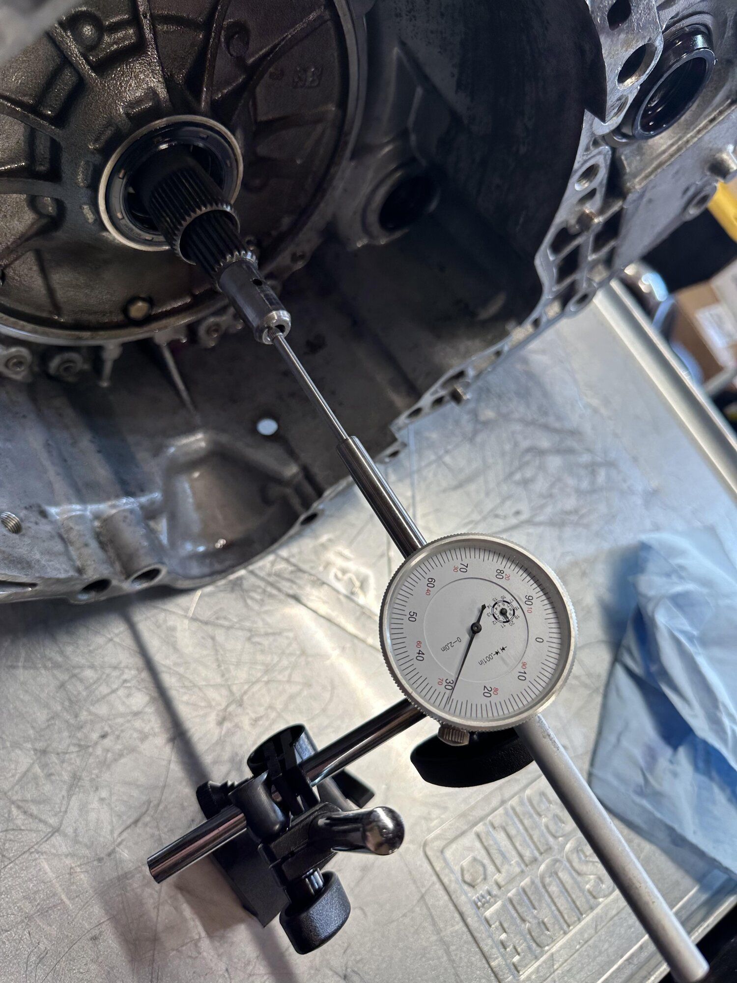

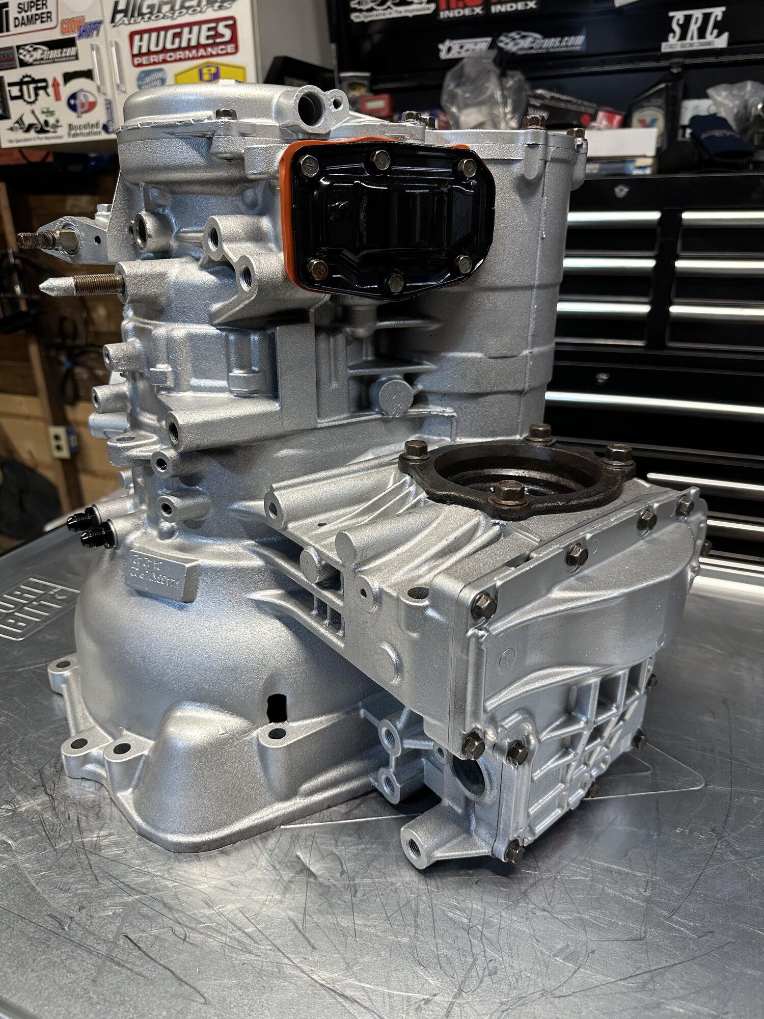

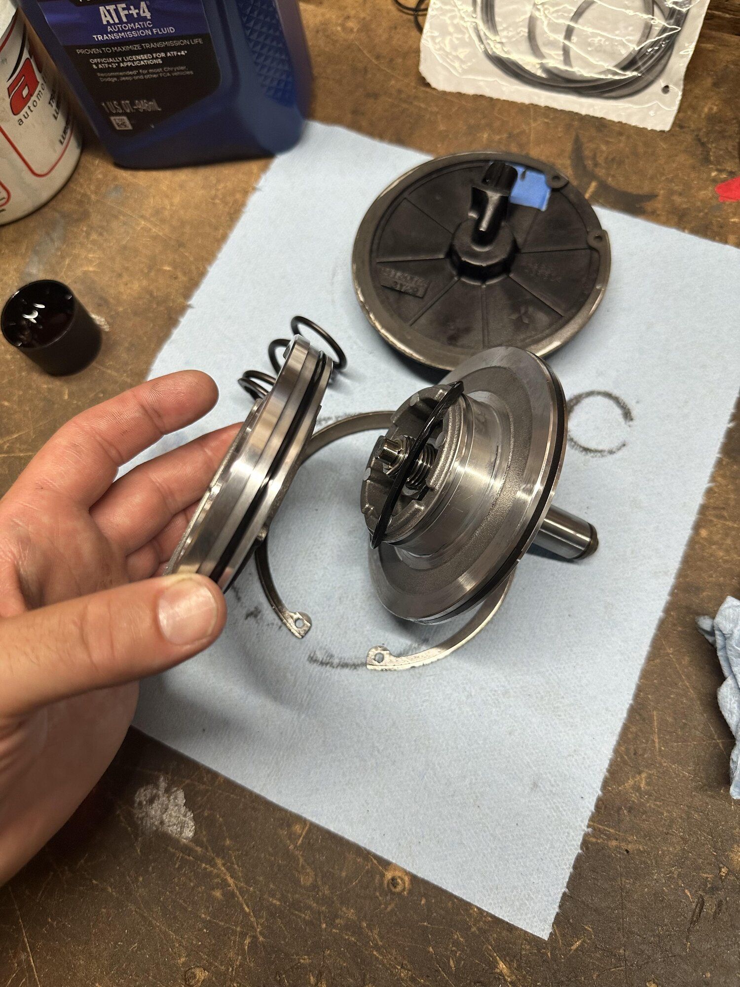

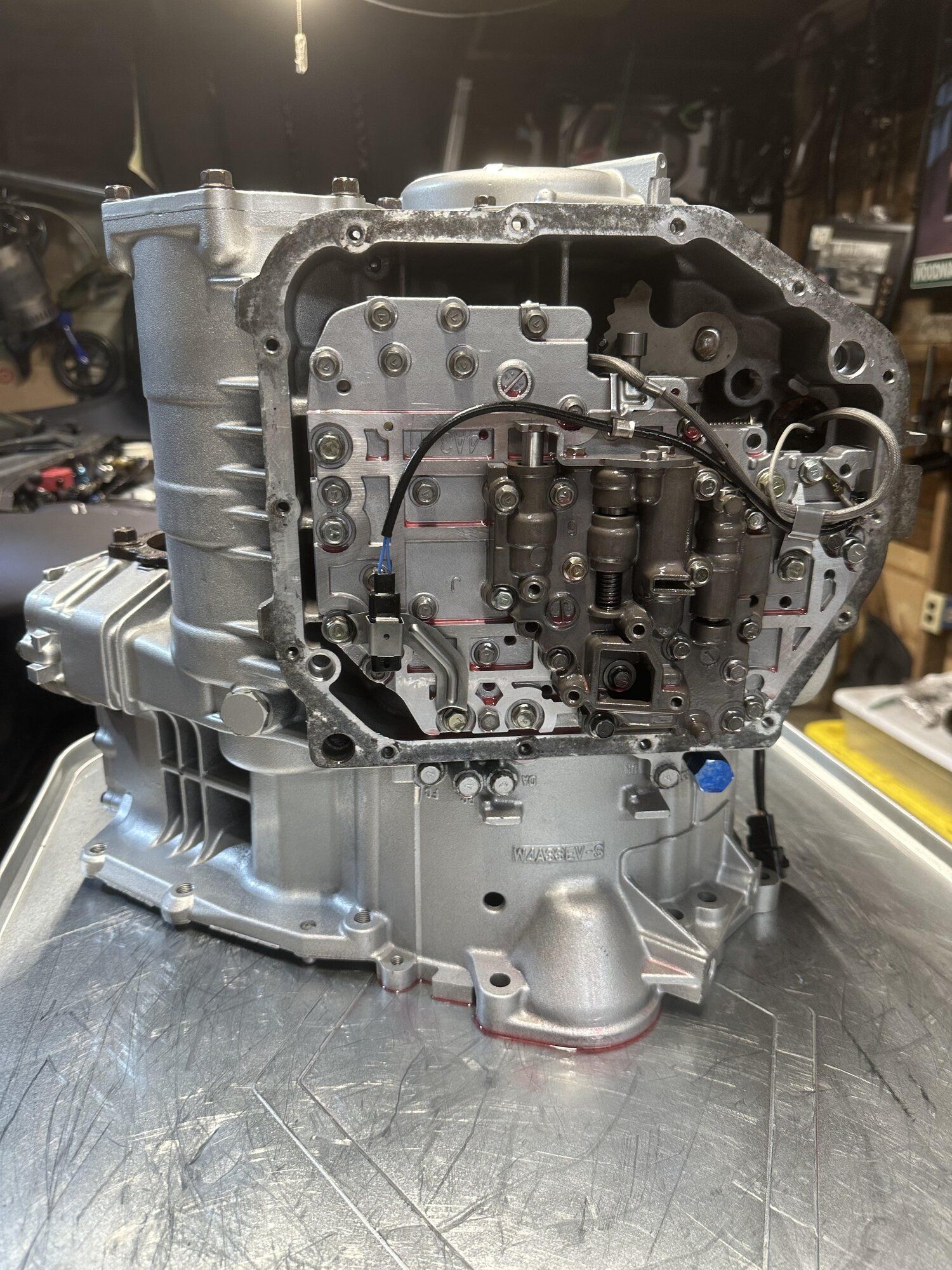

Hey all, a little update on this thing. I have the trans about 95% wrapped up. I just need to bolt on some miscellaneous accessories, the ATF filter, and then get the trans in the car to mark where I want to weld the ATF return fitting on.
I replaced the planetary gear set, annulus gear and flange, new Kiggly 5 friction front clutch pack for the direct drum, new rear clutch pack for the forward drum (even though my old clutch pack came out looking perfect still), new low/reverse frictions, new OD clutch pack, and a new kickdown band. All drums were cleaned and rebuilt with all new seals, O-ring, D-rings, and any damaged bushings I came across were also replaced. I believe I replaced a bushing on the center support, the larger bushing on the direct (front) drum, and also replaced the pump bushing. I also used a minty trans case I found, just needed some cleaning up and tossed some paint on it, came out really nice imo.
I had Aaron Gregory service the valve body, as I don't feel ready to tackle that part yet. He modded the unit in a way to run the RD port oiling mod. This mod will rework the ATF routing, and can be found in one of Joe Bucci's YouTube videos. This is supposed to supply the planetary gears with cooler oil, and more volume from what I understand. I do believe this also increases oil supply to the planetary gears when the transmission is in neutral. Should be much safer to throw the trans in N at the end of the run.
Precision also cleaned and gave my converter a clean bill of health.
Hopefully all seems right once we shake this new trans down! Really trying to get this thing to the Shootout again this year.
Below are just some pictures I captured during the process.

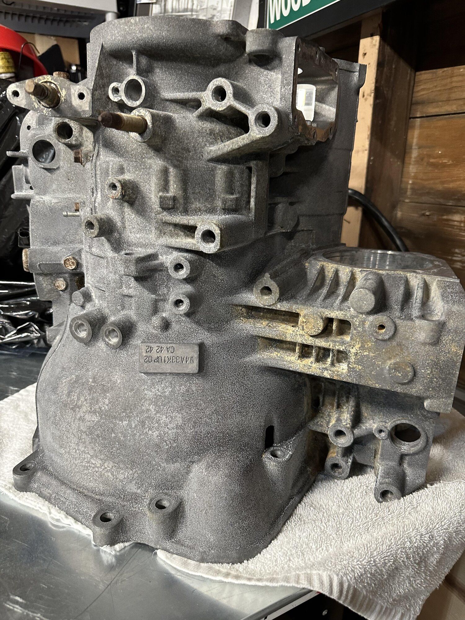

Case used this time around. The before and after paint!
363720089_662307775447143_7785441364154177504_n.jpg 364538380_804328561195579_4281389700256594092_n.jpg
New pump bushing, kick down servo apart, and measuring input shaft end play.

I also got my new exhaust manifold from @MorrisonFab, and what a gem! I've said it a millions time, they put out the best parts! I went with their consolidated divided T4 top mount manifold, and couldn't be happier with fitment and of course the looks. The manifold is flanged for 2x TiAL 38mm MVS wastegates, so I ordered a pair from Extremepsi.
As for the turbo, I am going with a PTE Next Gen R unit. It'll be my first time with PTE, and I'm looking forward to seeing the results this mamoth thing has to offer LOL. It's one bad looking mf, that's for sure.
I will be going with a different radiator set up to open up room to fit the new turbski. Currently, the sportsman cover of this turbo doesn't come close to fitting, which I was almost certain I was going to need to make a change here, I just wanted to confirm after a VERY bried test fit/mock up. I'll be going with a MK3 VW Golf radiator to tuck into the core support, and it should open up a ton of room, and maybe even cool better than the current cheap small radiator I've been using (which has been working just fine).
I should be taking to car in for the cage work either end of March or sometime in April. Once I get it back, I will work on getting the front subframe out to finally install the solid K member bushings and also the NDD manual steering rack. I'll have more updates on that once I tackle it of course. I will have to change the accessory belt set up a little bit to make everything work once again.
Okay enough of all this, on to the good stuff, the photos!
HAD to edit and add a couple more photos after a mock up with the turbo on the manifold! man...
I can't wait to get the turbo and manifold installed fully. This thing has been really turning into something I would always dream about years ago. I would love to see what 20 year old me would be thinking and saying right now.
