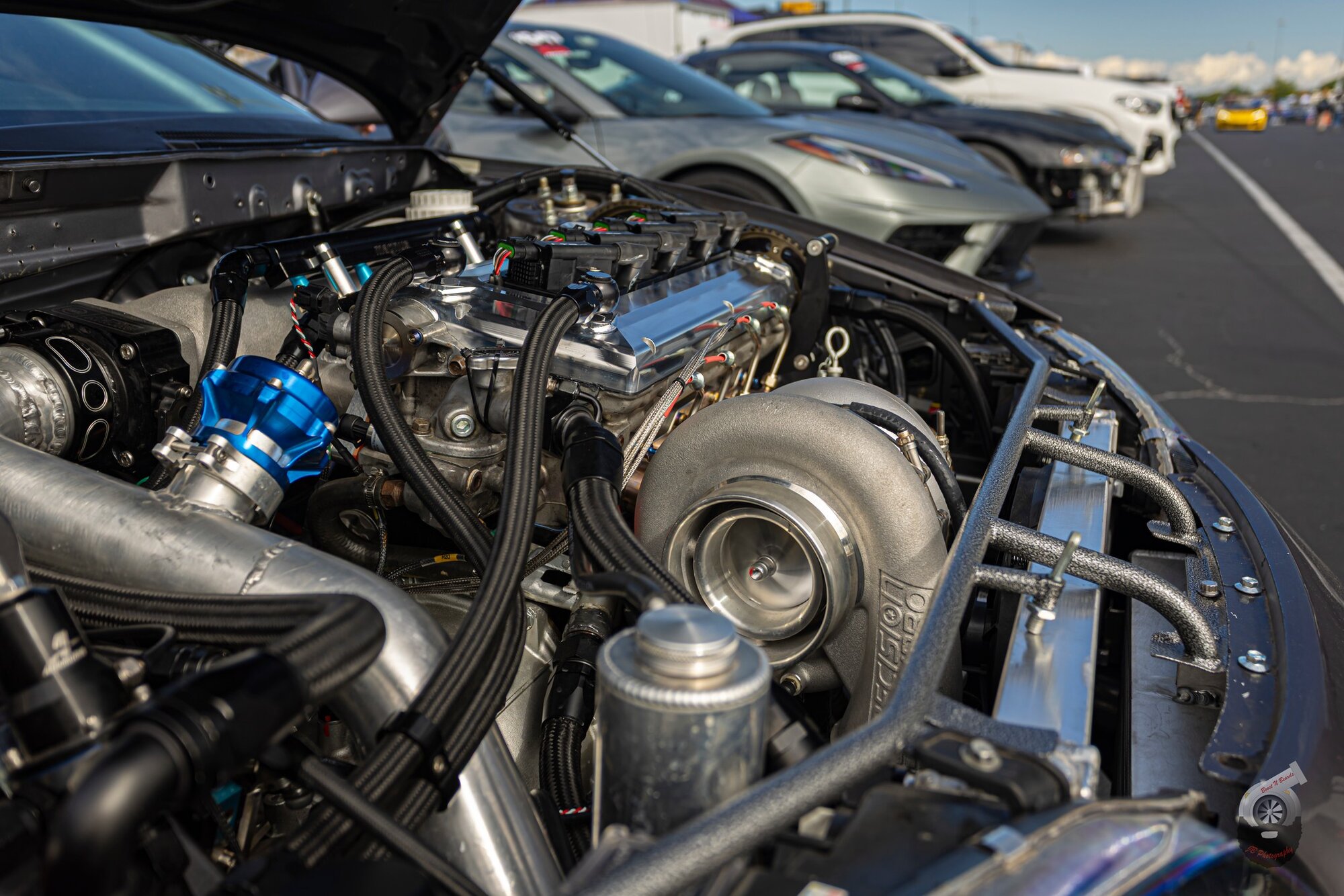

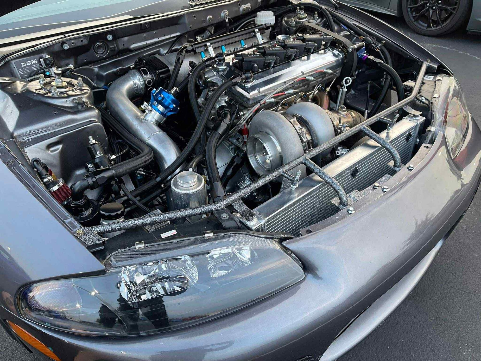

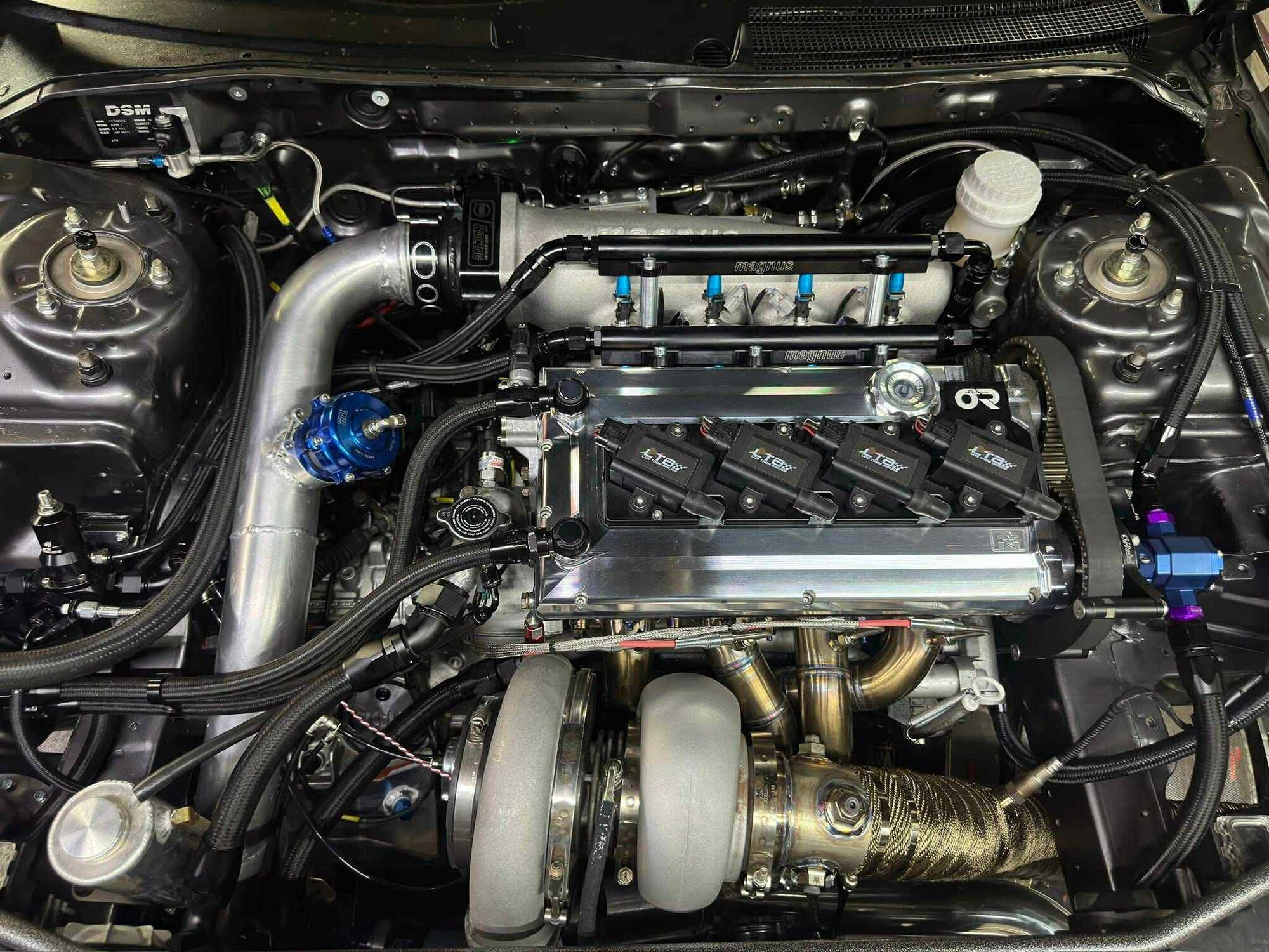

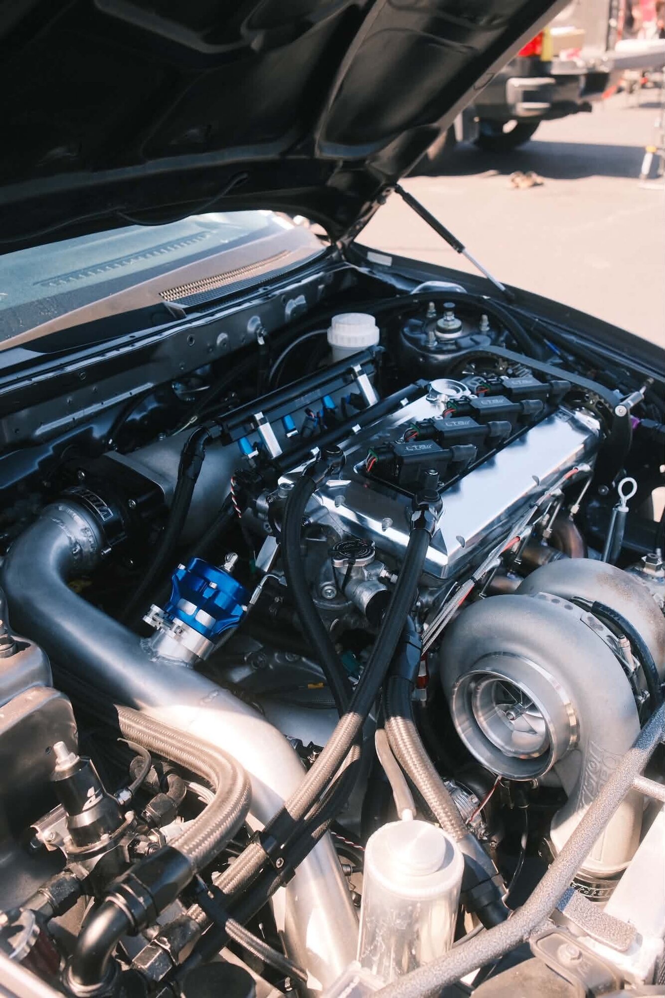

What exhaust manifold to head stud kit is that? I like the blue hue tying into the rest of the bay. That's an impressive manifold and turbo combo you have!
Thanks! I got a titanium exhaust manifold stud kit from JD Customs in the burnt finish.

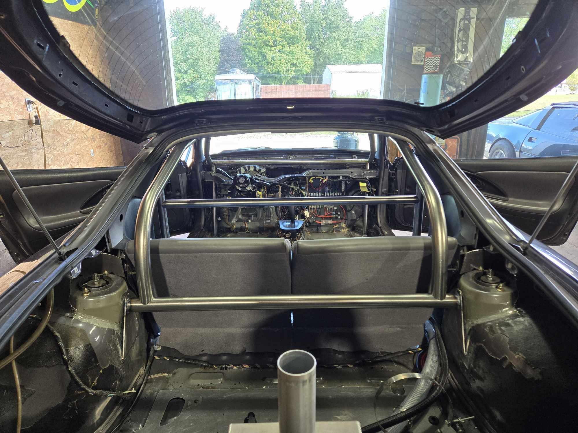

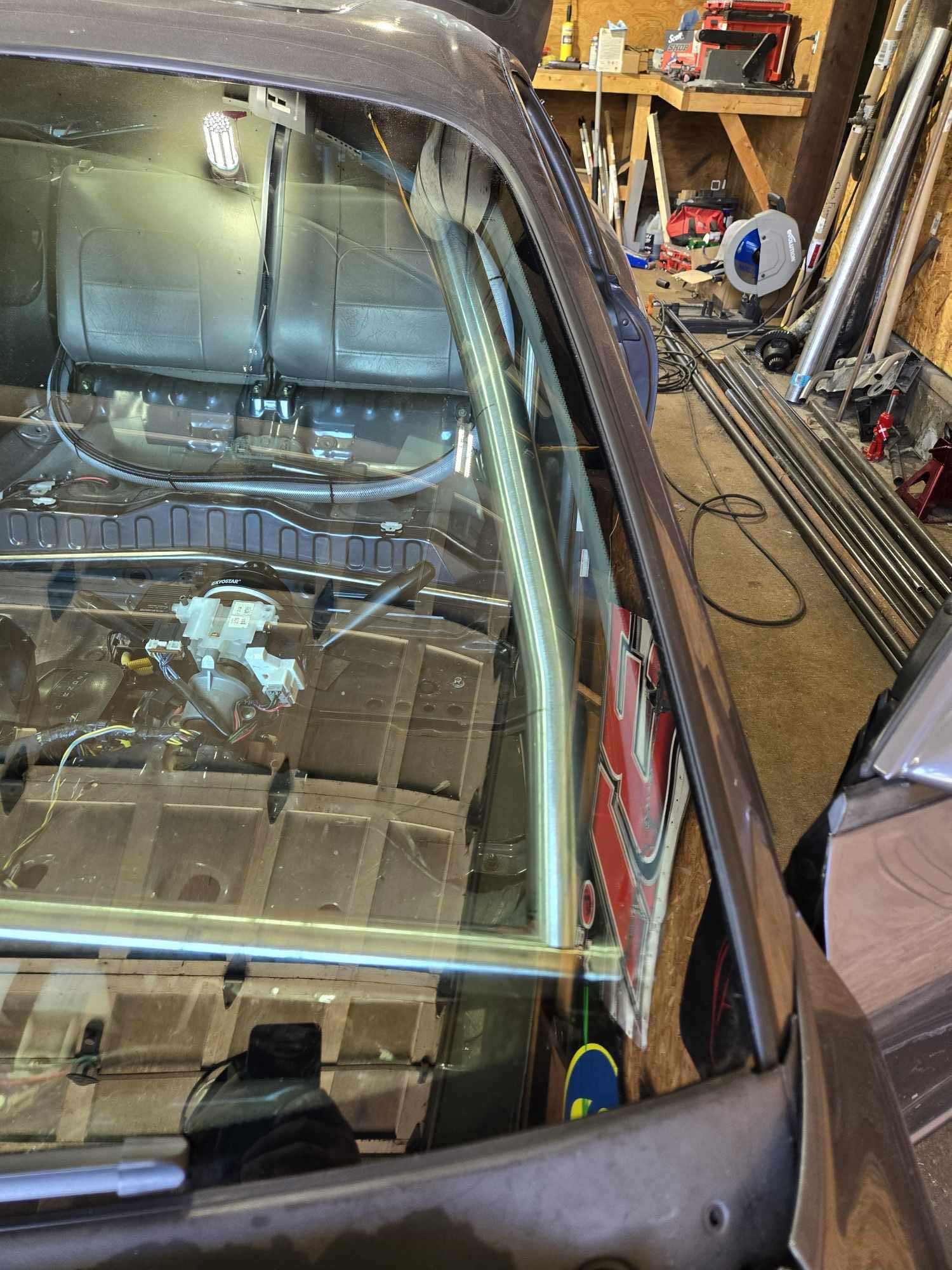

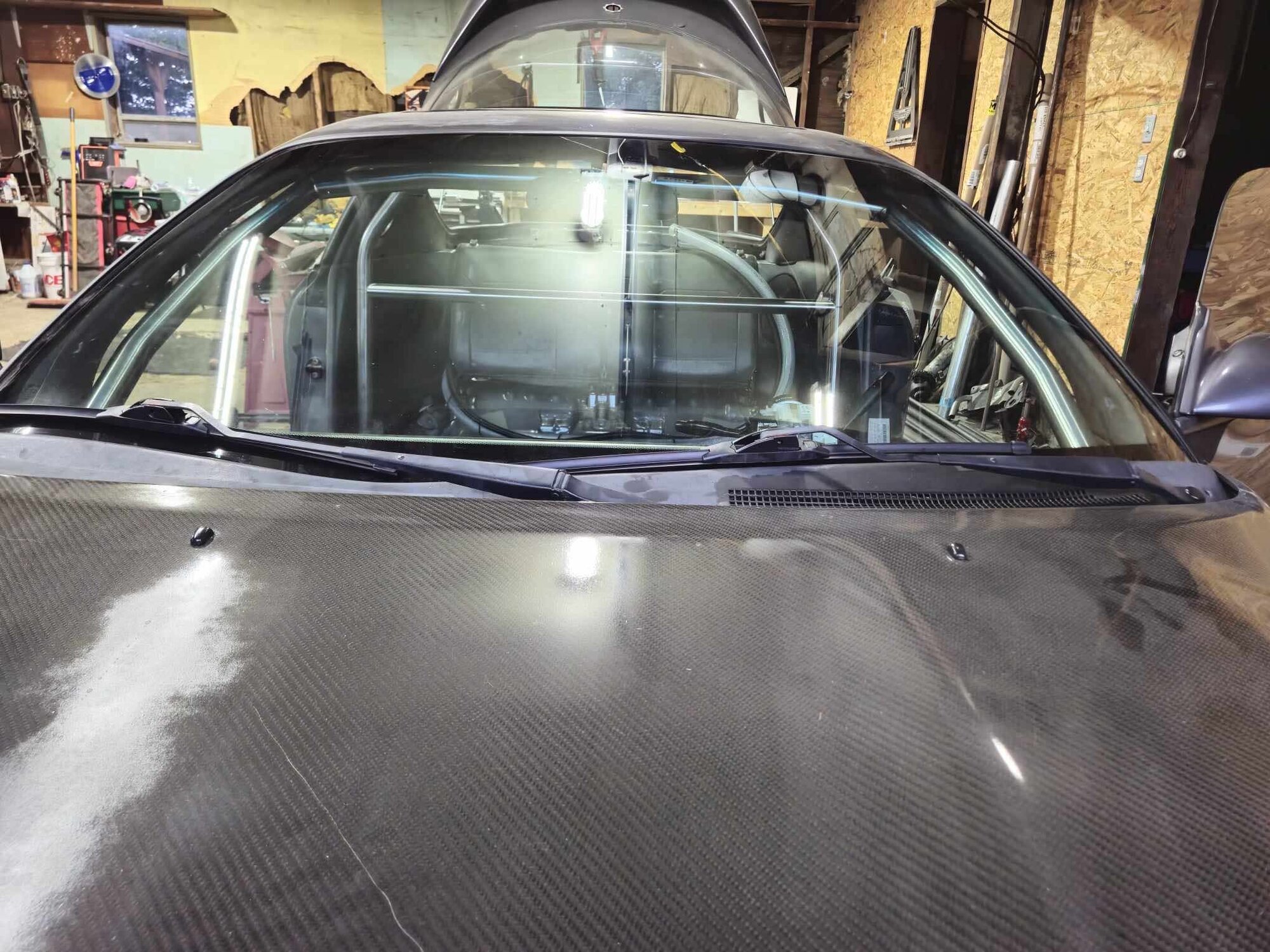

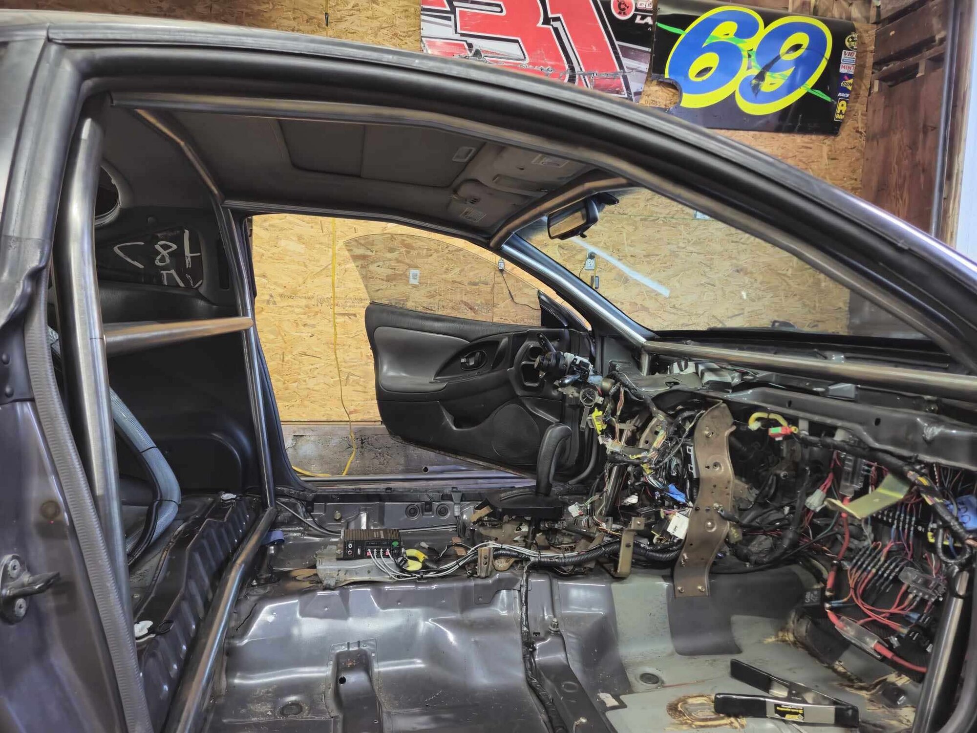

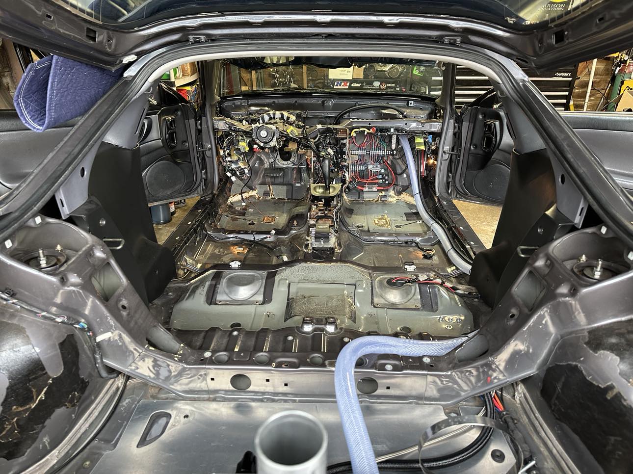

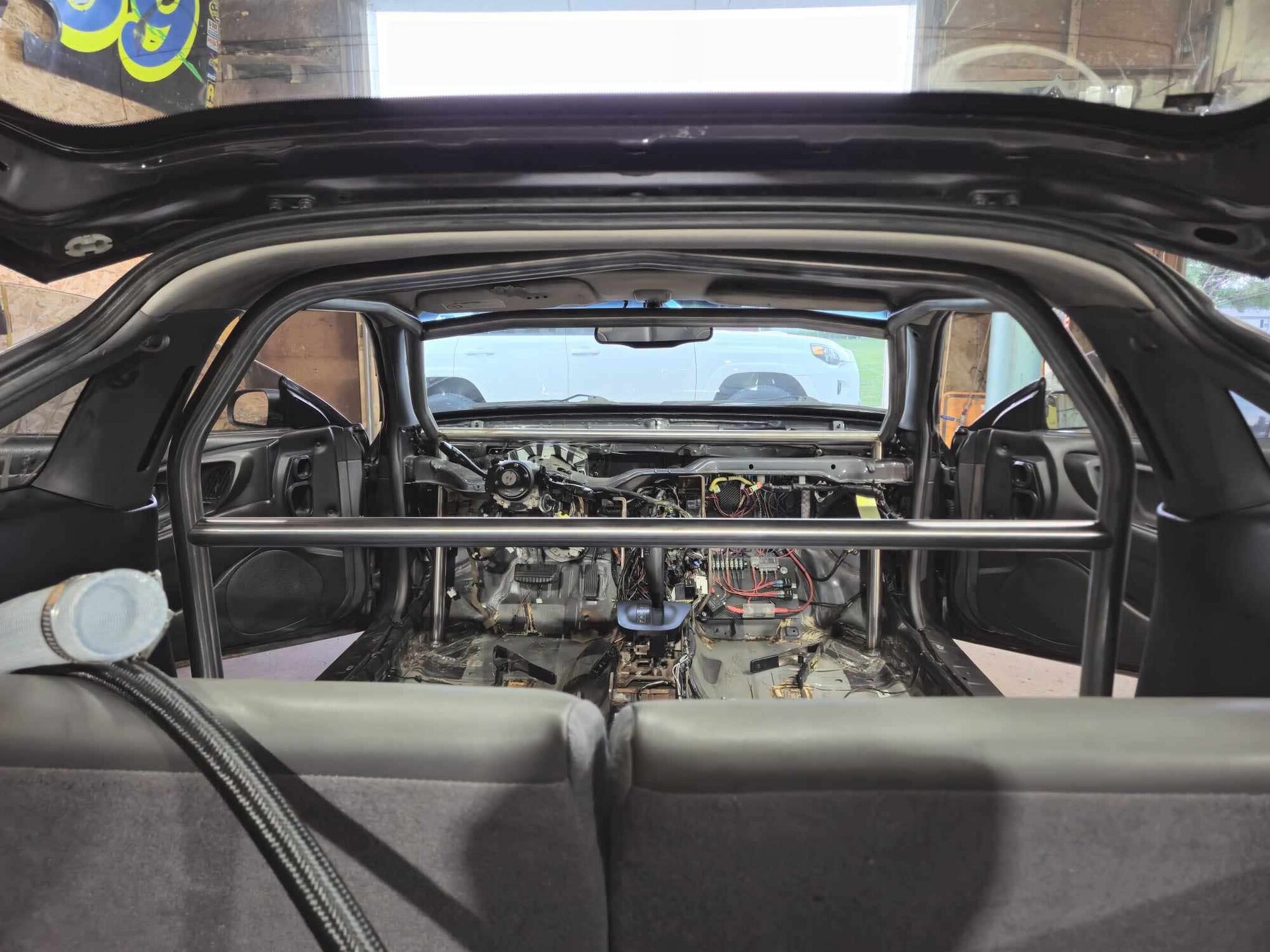

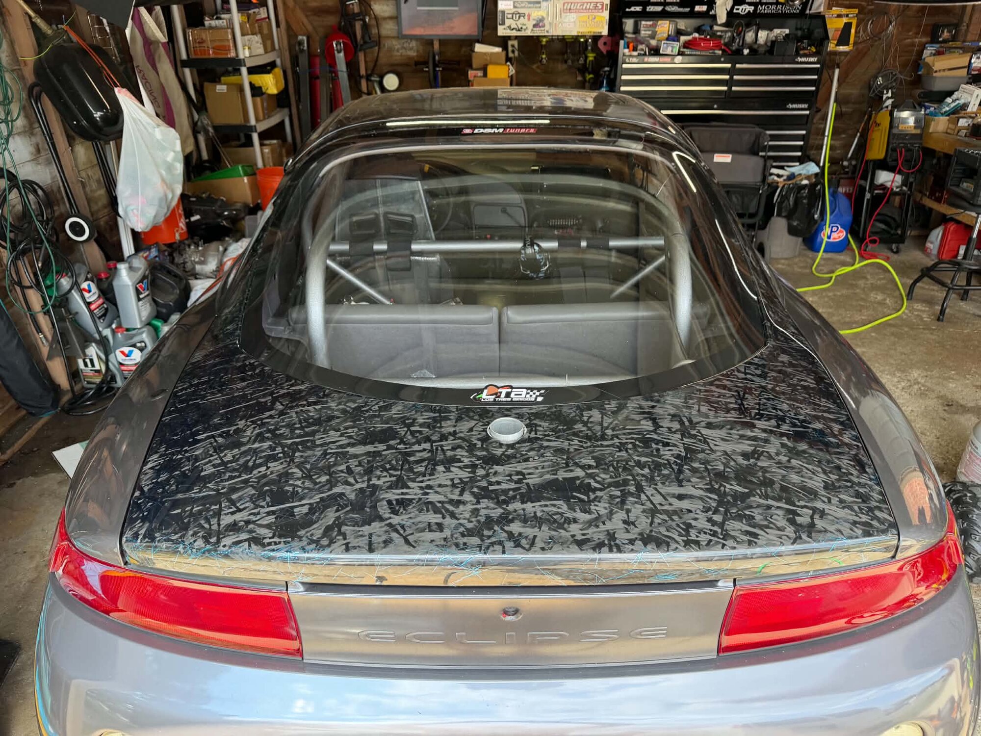

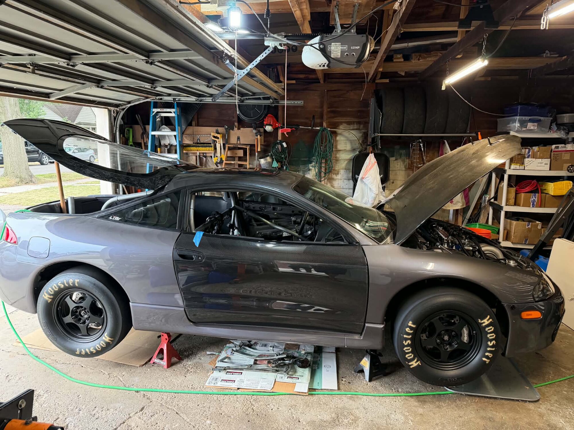

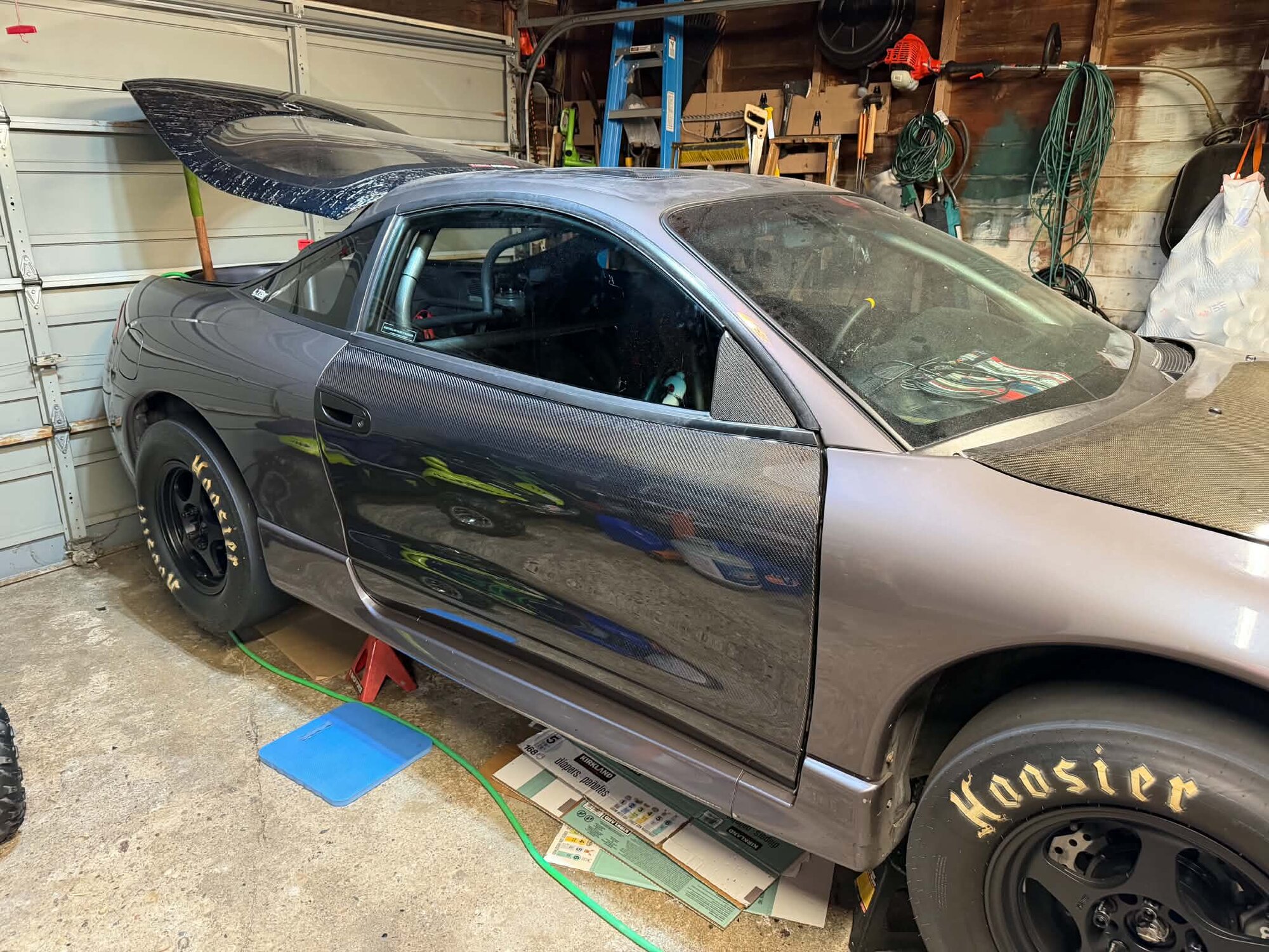

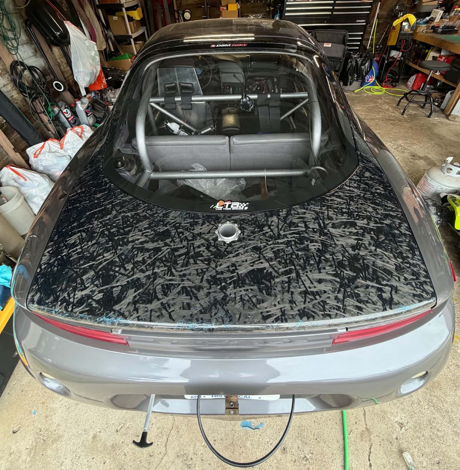

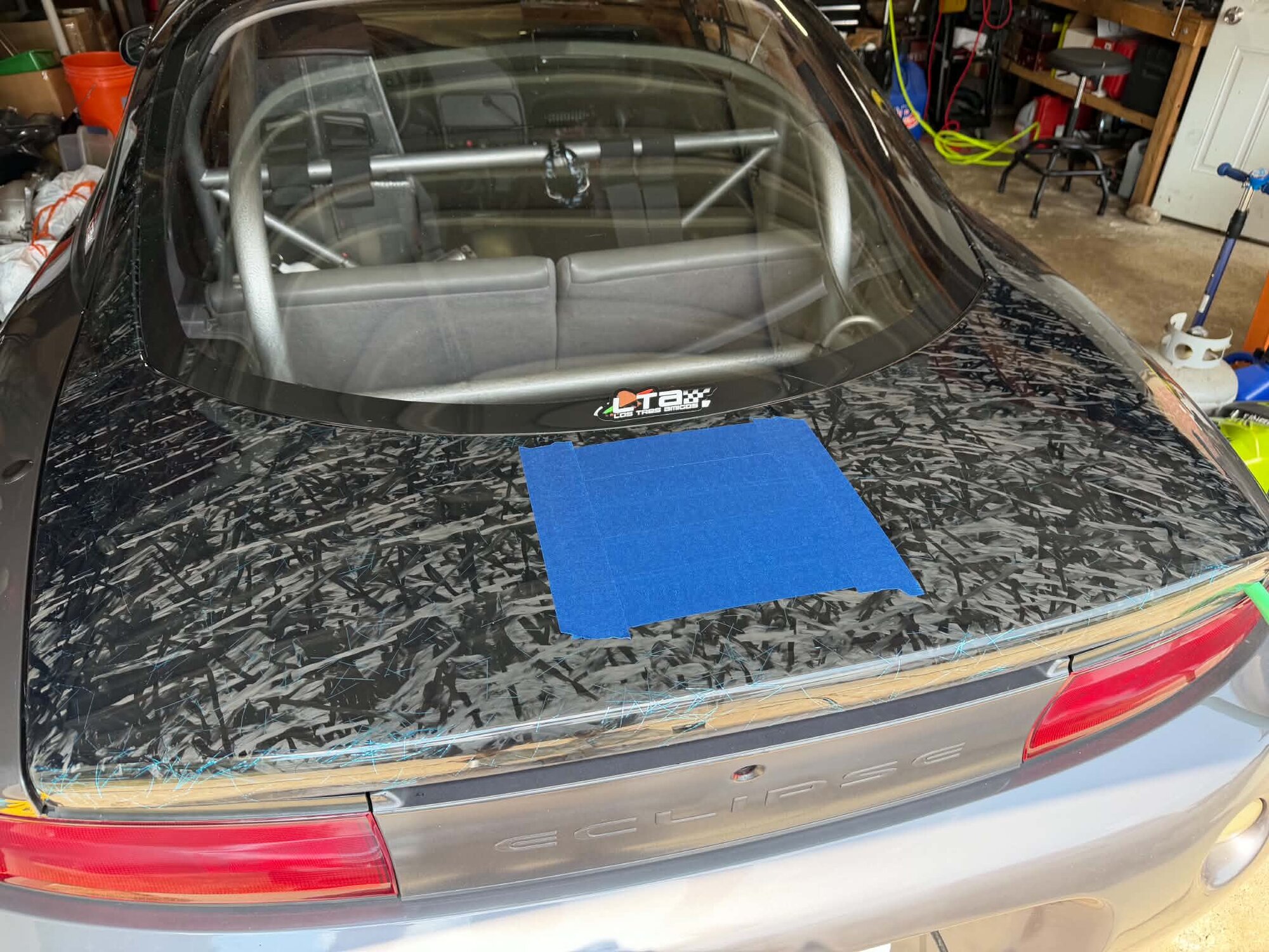

So the car is currently with Chris at Red Rocket Racing in Syracuse Indiana for an 8.50 cage, chute mount, and also having Chris do up a more tubular upper core/radiator support in an attempt to open up some more room in the engine bay. As of now, not totally sure when the car will be finished up, but this is giving me time to do some other things around the house and also clean out that damn garage.
Here's the car pretty much done with prepping it for the cage:

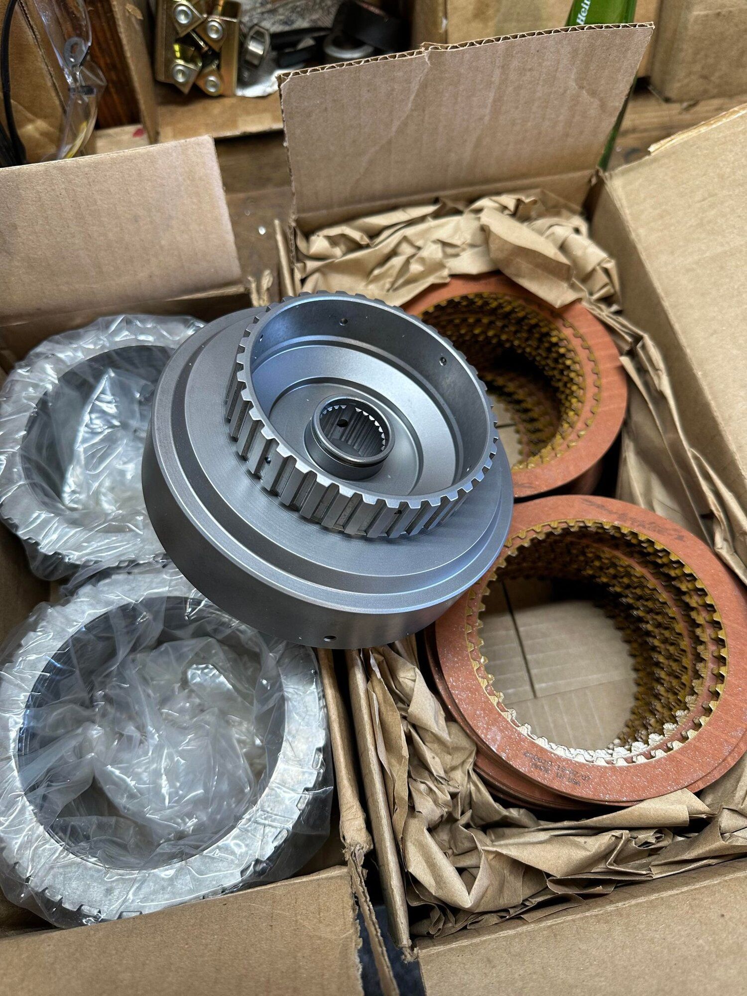

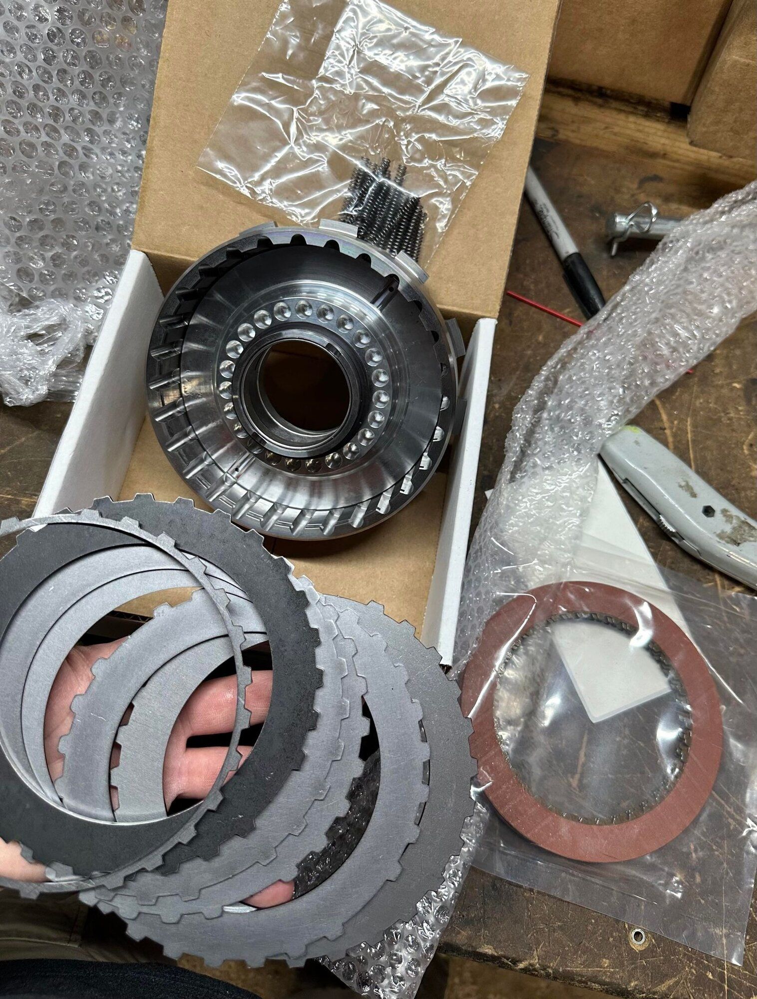

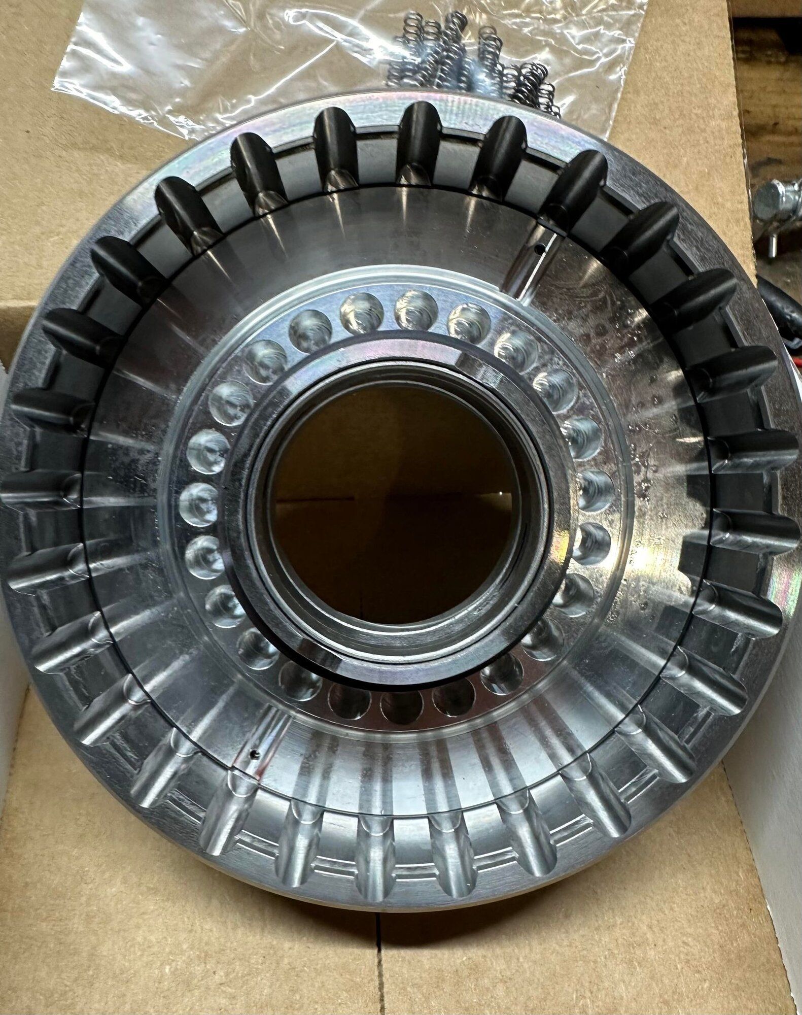

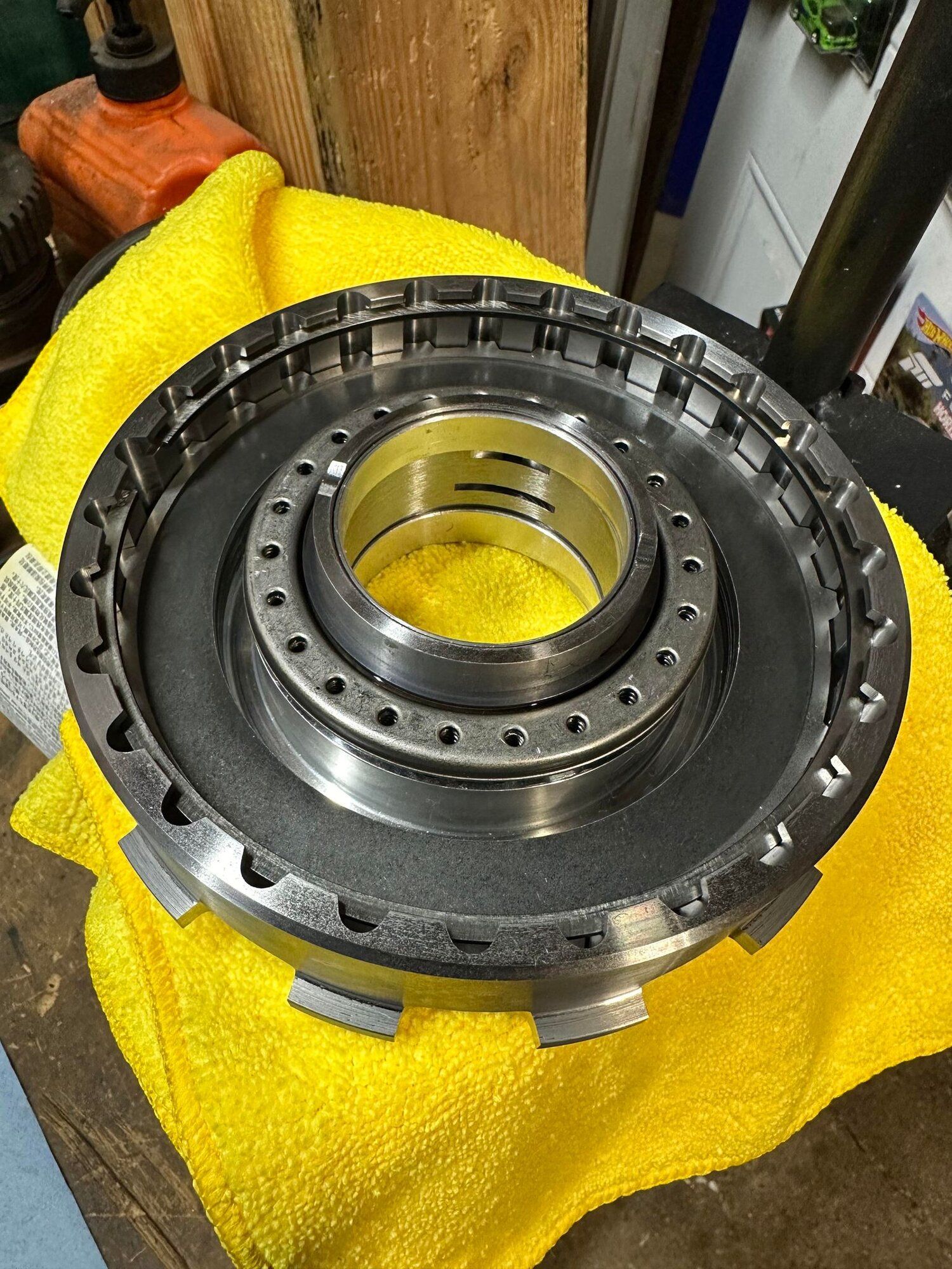

I have been collecting some odds and ends though while the car has been gone. I picked up a Chris Wymer billet forward (rear) drum and also finally pulled the trigger on a billet front clutch drum from @kiggly Racing. Both are beautiful units, and I'm looking forward to tossing them in when the trans is out next. Chris's forward drum should eliminate the issues of cracks forming around the splines on the OEM units. Although I haven't completely failed a 5 friction front clutch pack in the OEM front drum, I usually always saw a decent amount of ware on the fricitons. I'm not sure if they will be enough for the new poower that the next gen turbo will provide. So, it made sense to finally go with the stronger front clutch set up.
Anyway, here are some pictures!
Chris's forward (rear) drum: pictured along with a shipment of new Raybestos Stage 1 RED frictions and new steels to assemb rear clutch packs:
And the Kiggly billet front clutch with the 6 friciton clutch pack that goes with it:

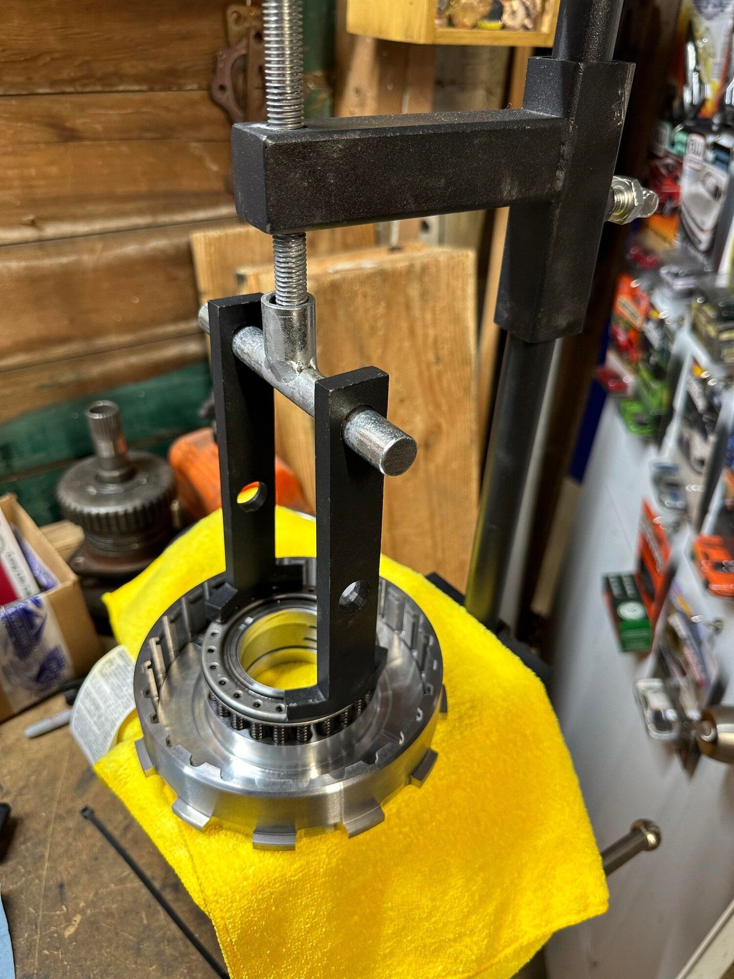

OEM return spring installed and ready to go when the time comes! The small springs that come with the kit (seen in the photo above) are just placed inside the OEM larger springs on the return spring assembly.

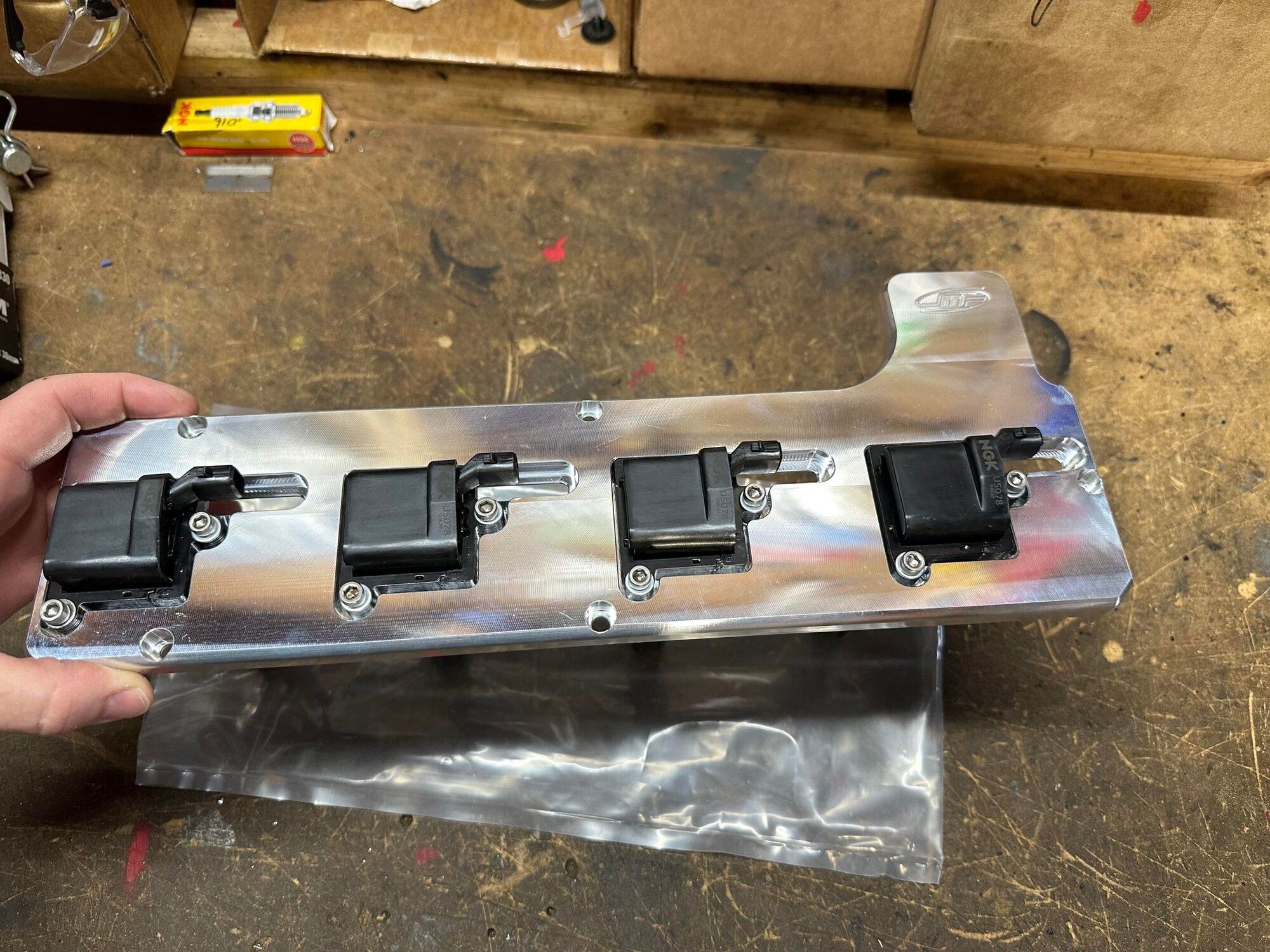

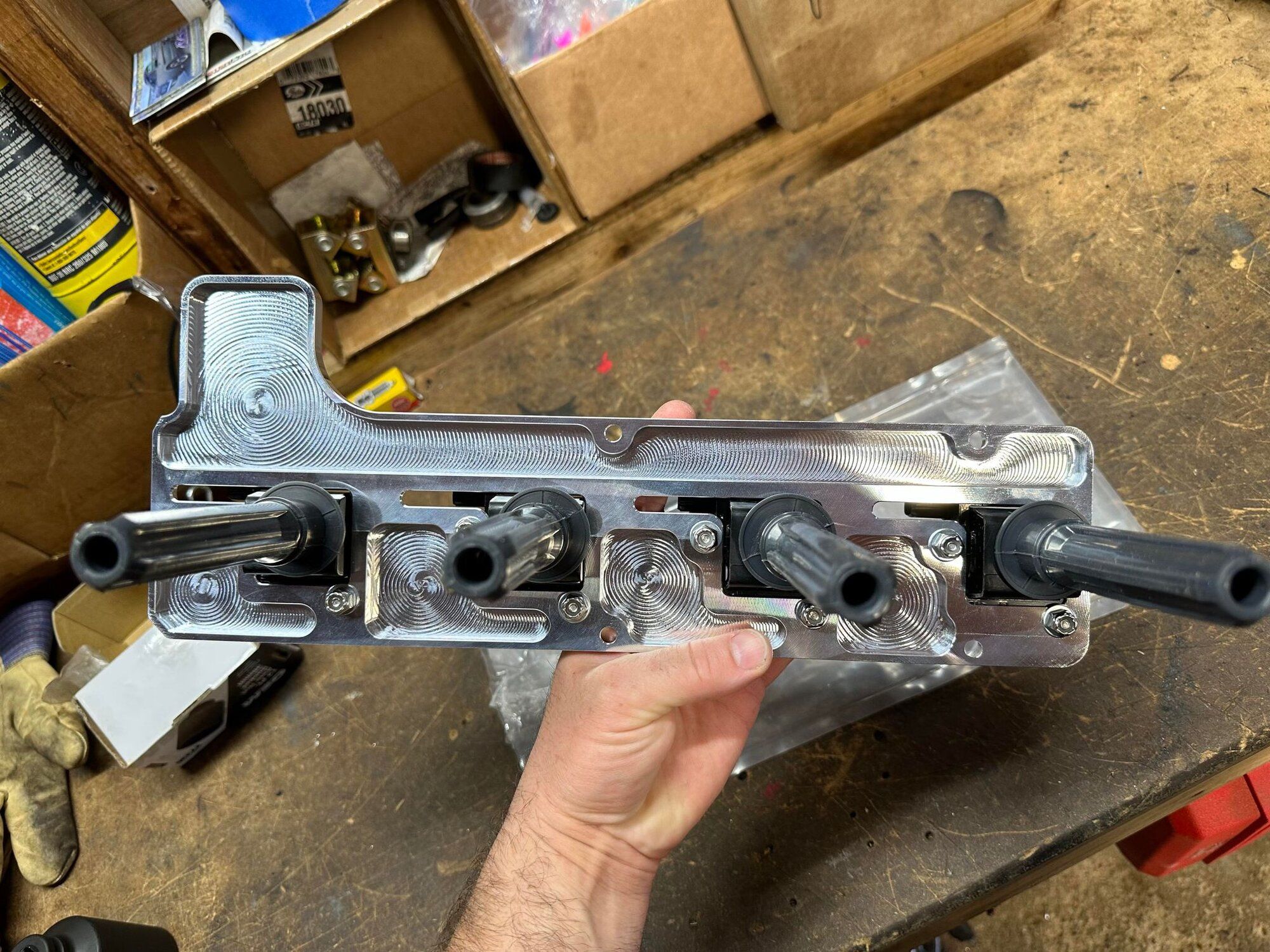

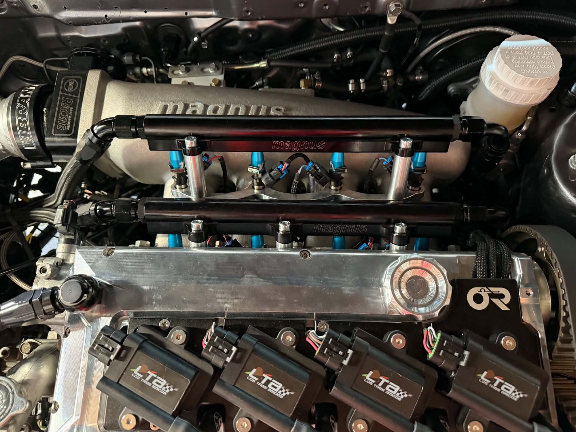

I'm also going to be putting together a coil on plug set up. I'm really just after not having to deal with the coil pack being under the intake manifold anymore. Just need to wire the coils up and trim the boots to length. Hopefully I can get the wiring correct on the first shot! I also think it'll look nice.

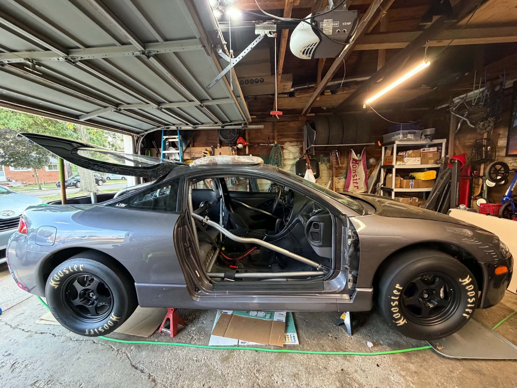

Well I suppose it's time for a little update with the car and plans. I had to take a look back and remind myself where I left off on here. The car is still at the chassis guy, and Chris is doing an outstanding job so far. This cage is looking super tucked in the photos, and I just cannot wait to see the final product. The cage needs to be wrapped up and the chute mount and tubular upper core support need to be fabricated. The car will not be out this year, so I'm looking for more pretty big changes over winter including a major change in the rear drivetrain and suspension ;)
I'll just do my best and list out most of the changes:
-Possibly paint cage, fit dash and other interior components.
-Pull engine: Engine will be getting a mechanical fuel pump set up installed and some other odds and ends sealed up and reworked.
-Pull trans: Install the billet drums and hopefully install the Circle D converter (Will be selling my PI #6 converter)
-Pull front subframe to install NDD manual steering rack and Volk Metal Craft solid front K member bushings
-Pull current fuel system out in favor of a bay mounted fuel cell (2.5 gal) Will be hanging onto the Vamos fuel cell for future use.
-Pull the entire drivetrain and rear subframe in favor of the Volk Metal Craft tubular subframe, R'venge built 3.307 3000gt/stealth rear diff, DSS stage 5 axles, and everything that goes along with the conversion.
-Will be seriously considering a changeover form ECMLink to Fueltech
-Will be looking into smaller drag racing-oriented brake set up.

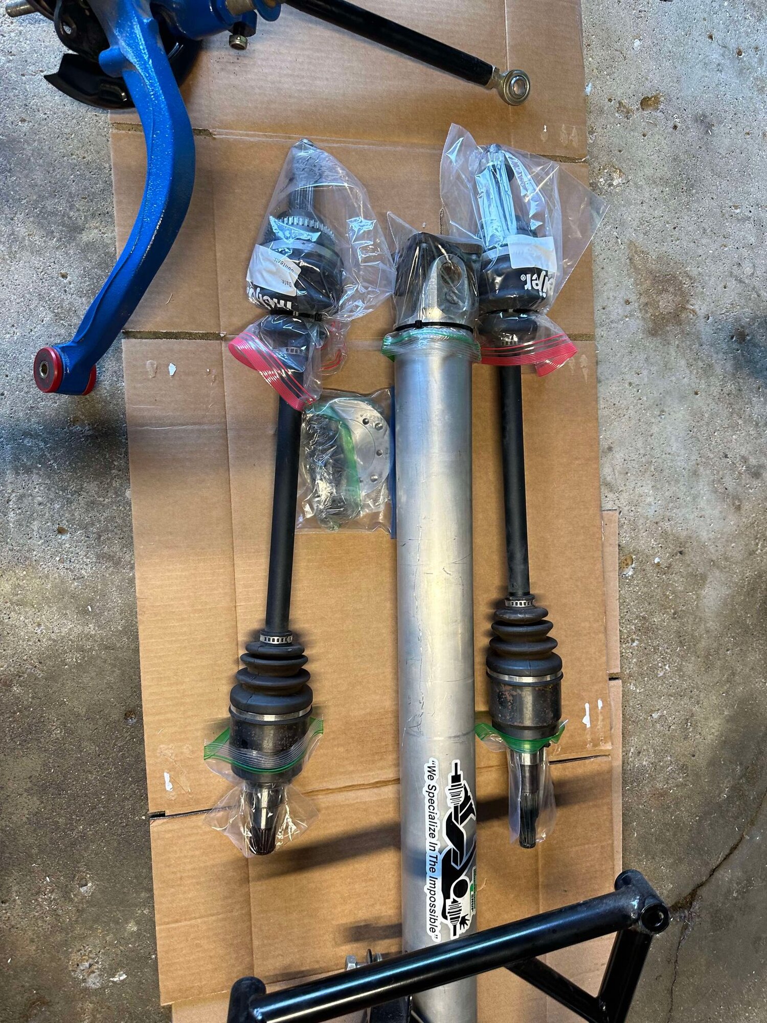

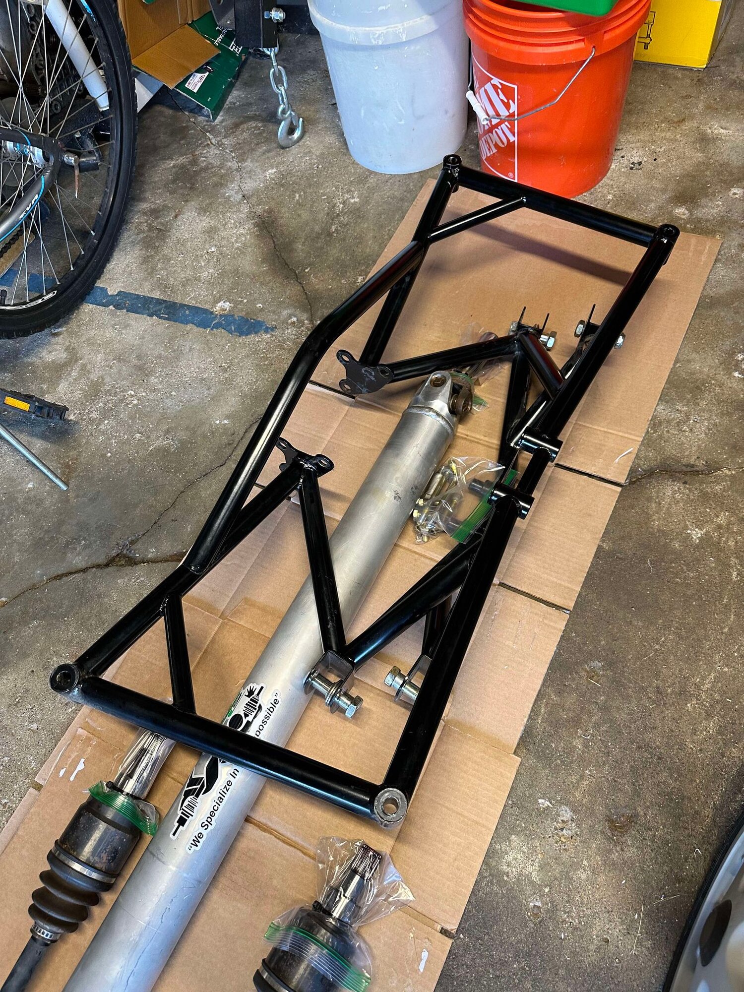

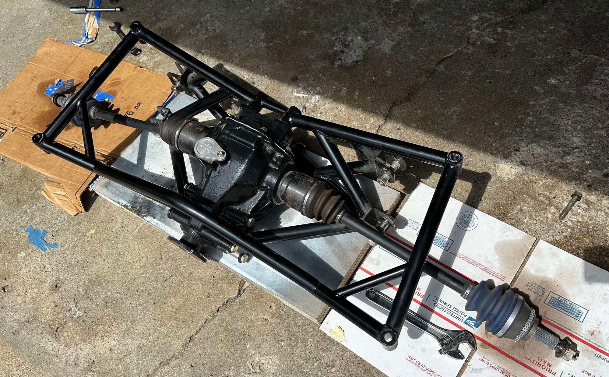

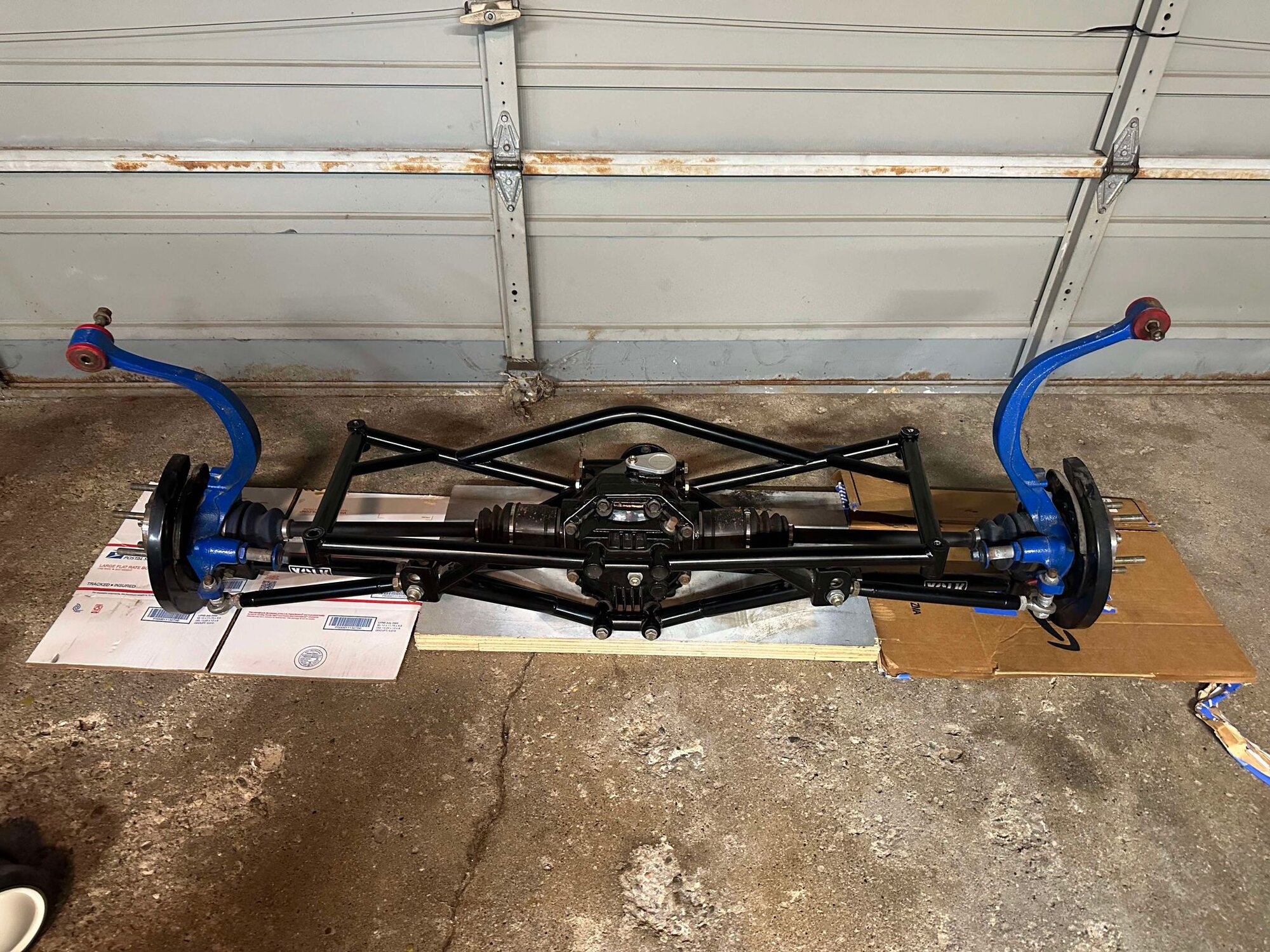

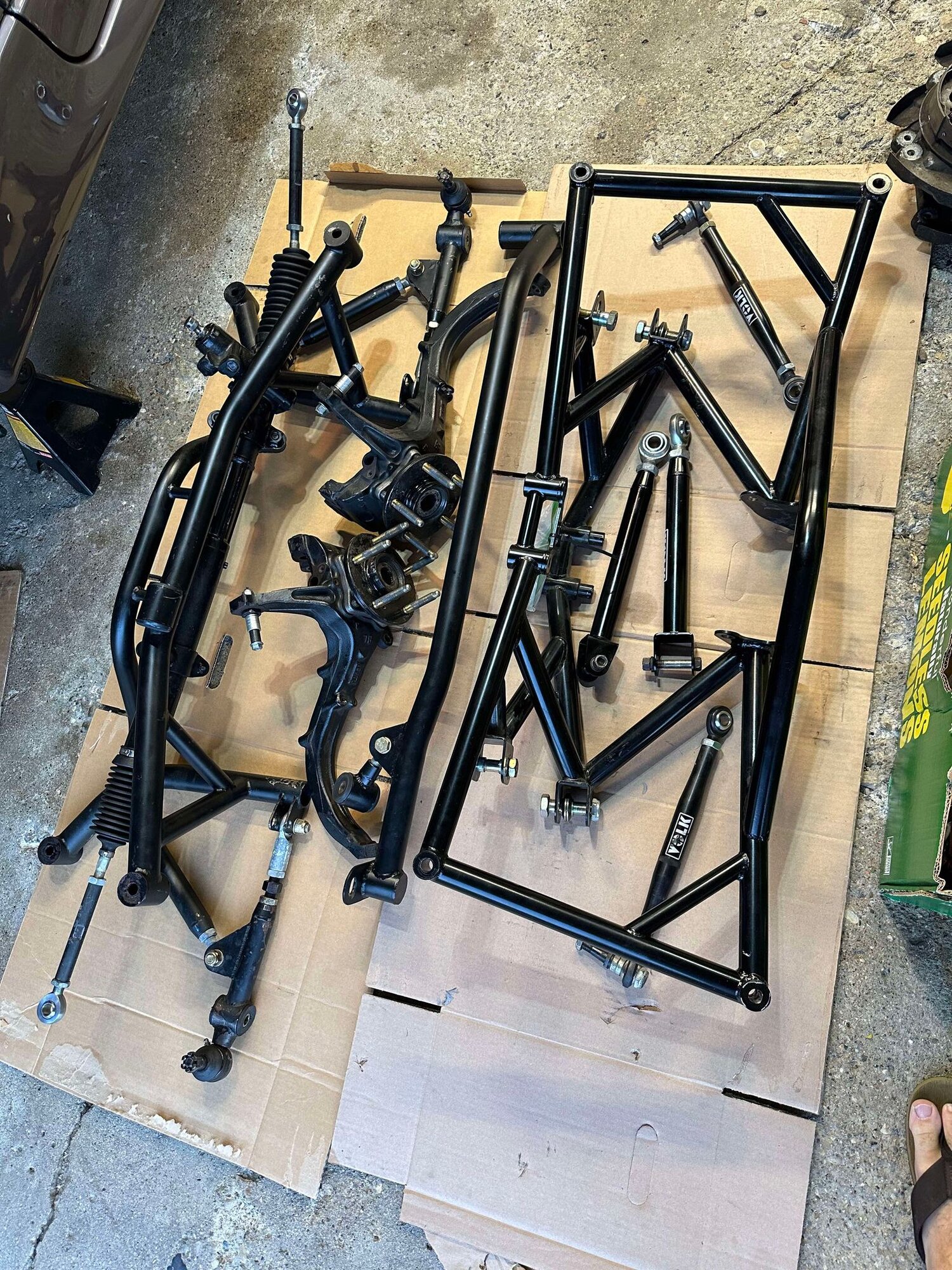

So yes, I came across a good deal on a Volk rear subframe that is make to fit s 3000gt/stealth rear diff! The package came with the rear subframe and components, knuckles, a Boostin Performance rebuilt/service 5 speed 3/s rear diff, Drive shaft shop level 5 rear axles/hubs, and a drviesahft shop 3.5" Al driveshaft with a custom tail shaft portion to fit the rear diff!
Unfortunately the rear diff itself is the wrong ratio for the auto, but that's okay as I was lucky enough to source a core and have it built right from R'venge Performance. If you haven't heard of them, they are doing a ton of great work for the 3/s platform, and Chris over there got me hooked up with a 6 speed 3.307 core and build. Really looking forward to being able to finally rock some of his stuff. I ended up selling the 5 speed rear diff to fund the new diff build, so it all worked out.
I also sold the Al driveshaft that came with this package. I was really only after the custom rear tail shaft portion. The OEM unit needs to be shortened a bit to fit this 3/s rear diff when using a Volk rear subframe. So, I will be hanging onto the custom part, and installing it on my current Al driveshaft.
Times like this I sure wish I had a lift, LOL I will get some photos of everything during installation I'm sure, but here's some cage update photos and also some photos of the rear subframe/diff/axle score!
Although it will be an 8.50 cage, We did agree to having a few extra bars added in case it's decided to build the cage into a quicker cert. The added items will make the process easier from what I understand if we go that route. I'm super pumped with how it's turning out so far, cannot wait to get eyes on the final product! Go check him out on FB at Red Rocket Racing
And here's the rear subframe/diff/axles as I picked it up. Was a little bit of a trip, about 16 hours total in the car to pick this up, but totally worth it! Can't wait to get this all sorted with the new diff and installed in the car!

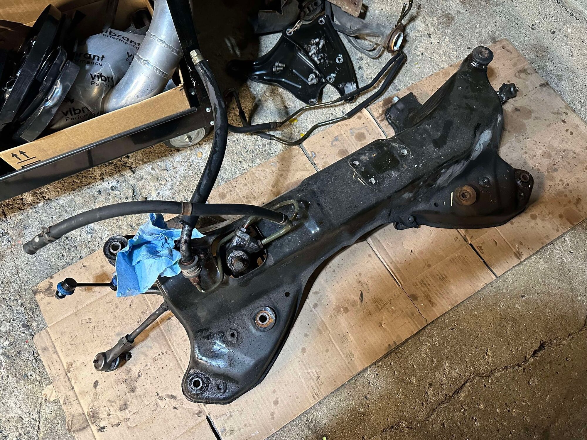

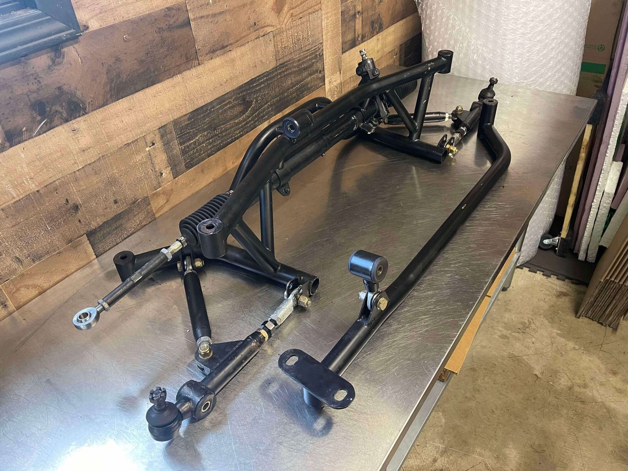

Figured I'd drop a little update. I picked up a NDD front subframe that came with a de-powered OEM rack from Eaton MotorWorks and FIBA's V2 front bump steer kit. I had planned on pulling the OEM front subframe and installing the VMC solid K member bushings. I figured this popped up, and I would jump on it. Looking forward to taking more weight out of the car. I also picked up a carbon fiber CSL hatch and FAL poly rear hatch glass at the shootout, so there's more weight off the car. The hatch is in pretty rough shape, and has cracking going on at the top, We're going to try our best to flatten those spots and then either wrap it or possibly paint it. It's more of a budget CF hatch set up I guess you could say ha. I also picked up a set of BC racing coilovers, so there's a chance I wont have anymore really wild weight transfer photos LOL. We'll see though!
Out with the old:
And the new (to me) front subframe that will be taking its place:
I tried my best to get a total weight loss between the OEM front subframe, lower control arms, and compression arms (without the power steering bracket, pump, and lines) and came to about 120lbs loss between OEM and the new tubular front subframe set up, NOT FRIGGEN BAD!
Here's a quick photo of both front and rear subframes that will be making their way into the car, hopefully the 3s rear diff shows up soon from R'venge Performance:

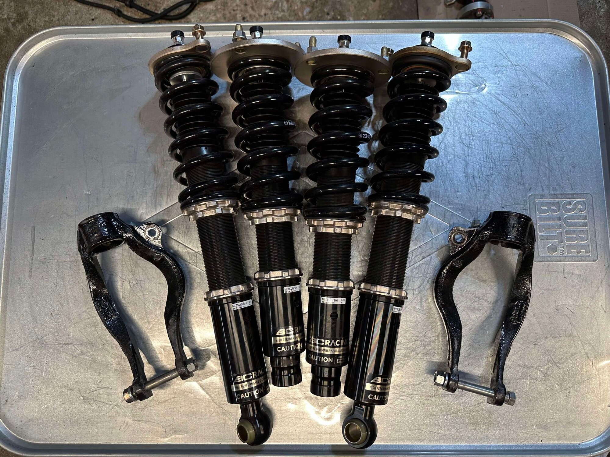

And the new (to me) coilovers that will be making their way into the car:

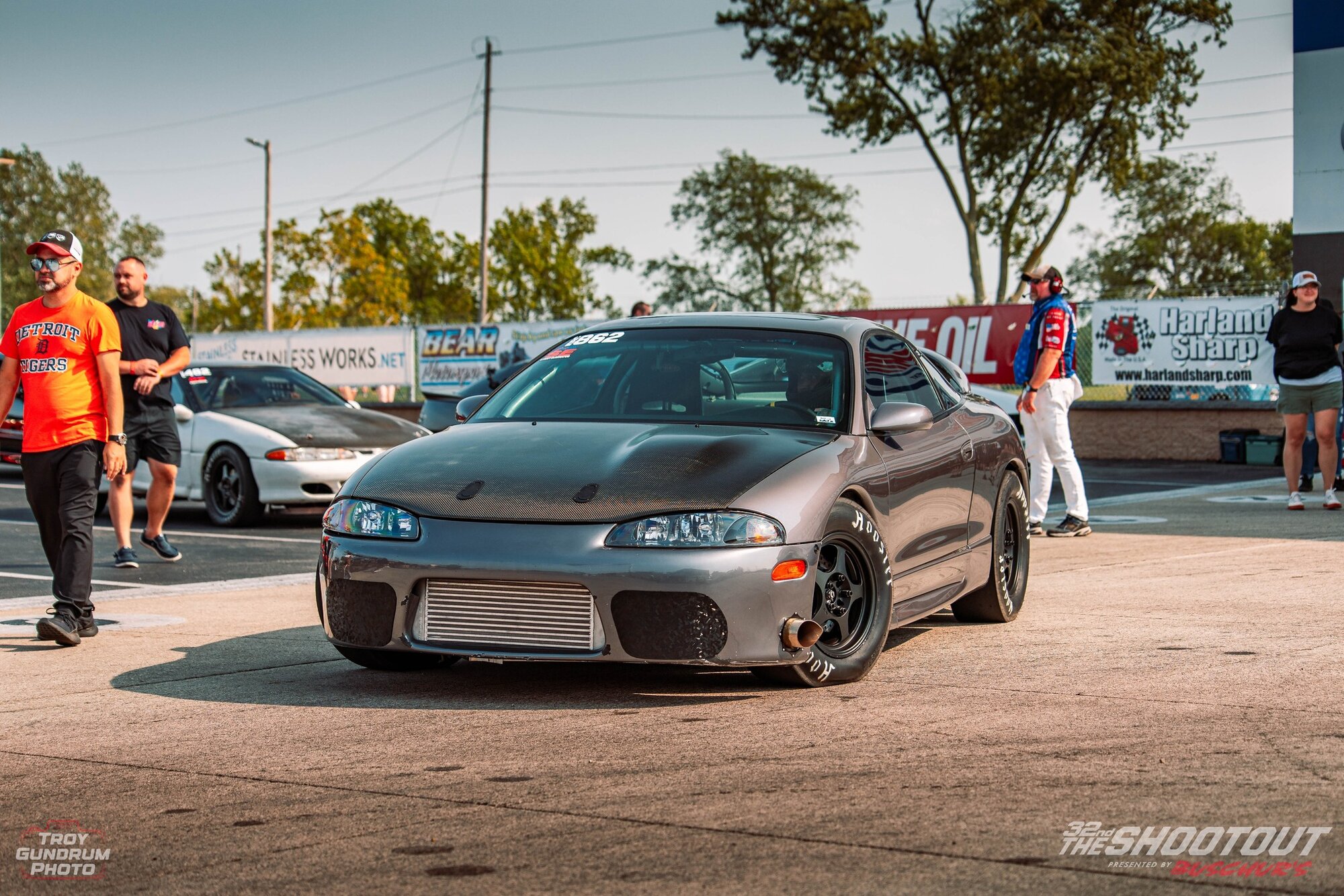

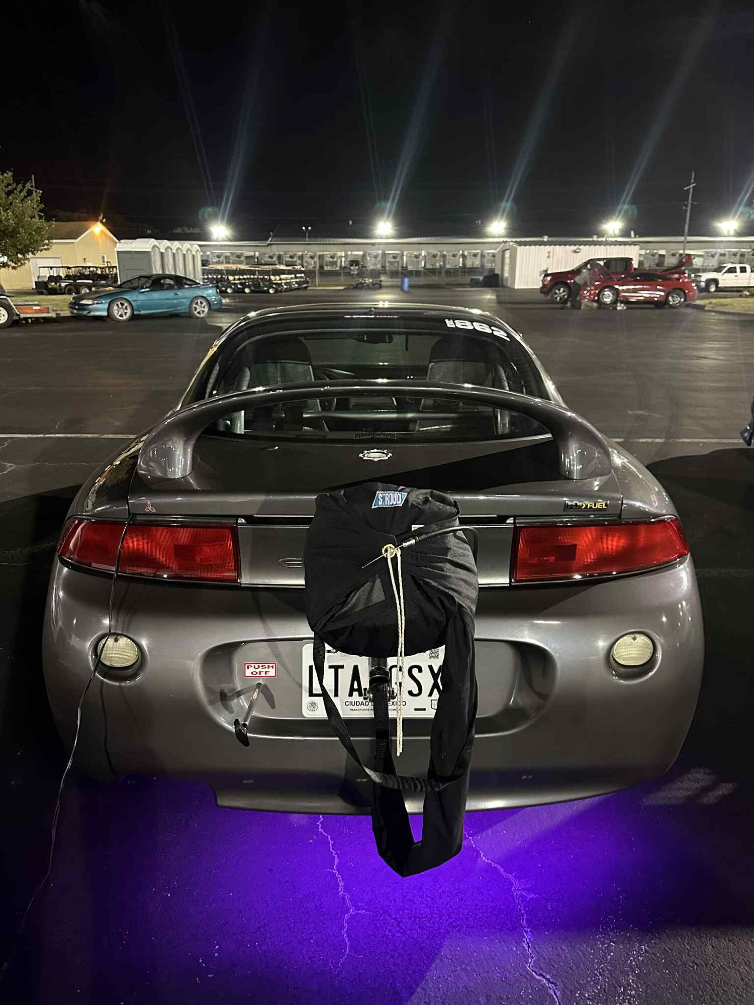

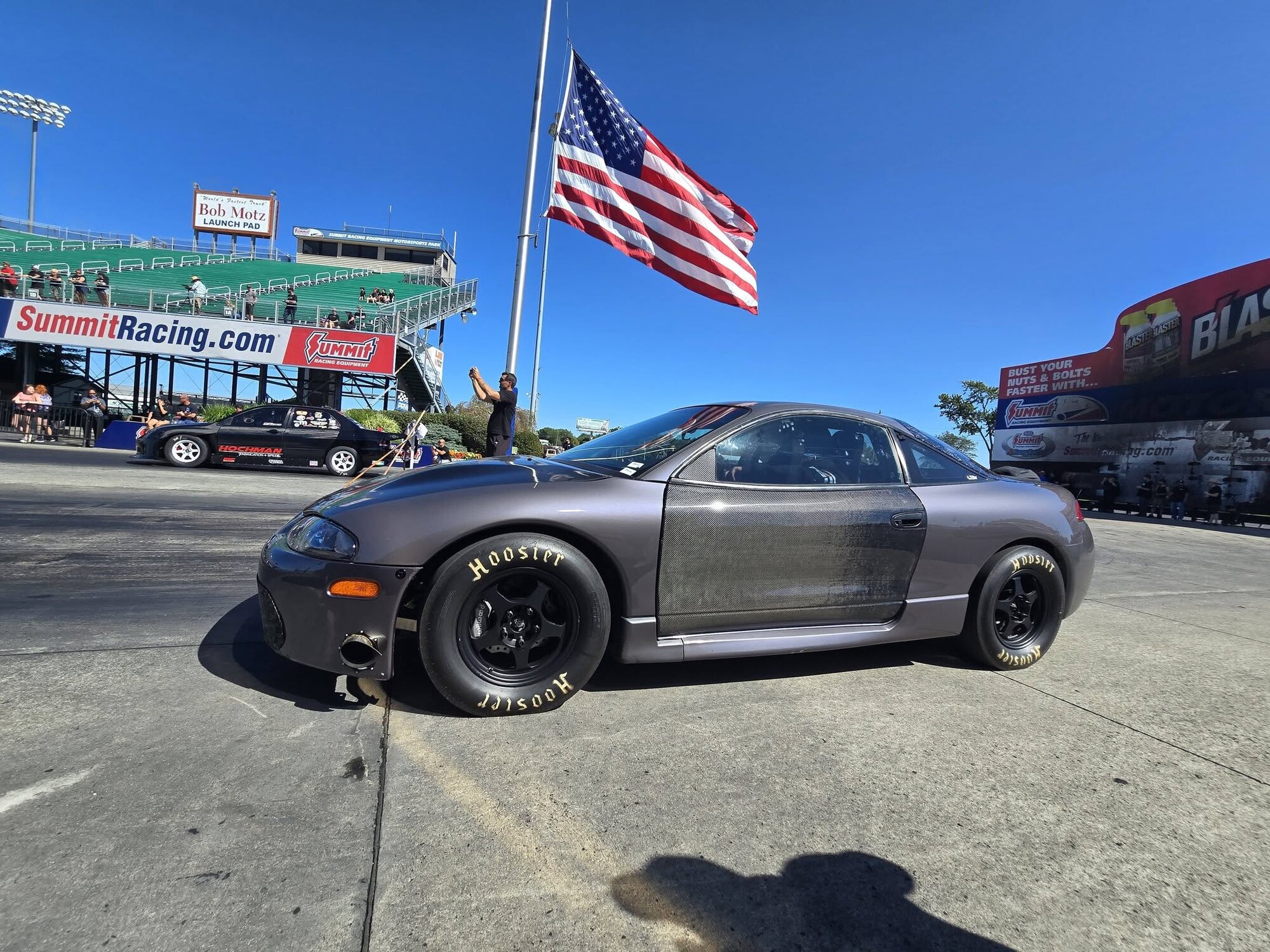

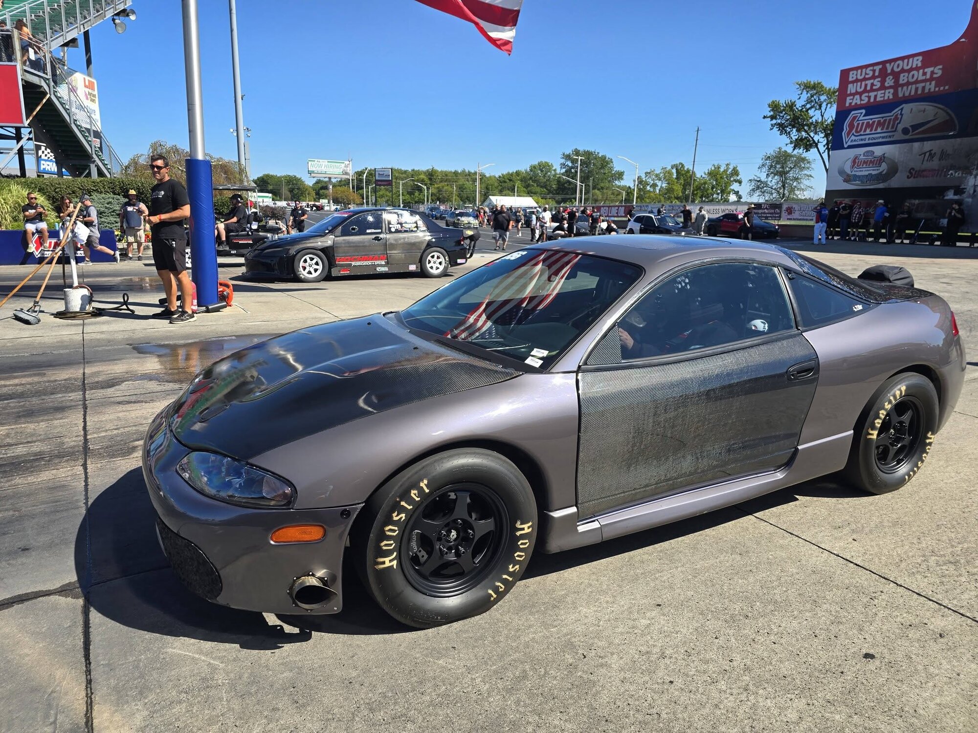

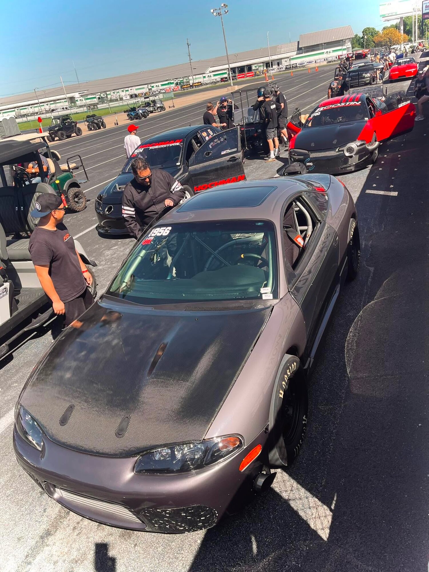

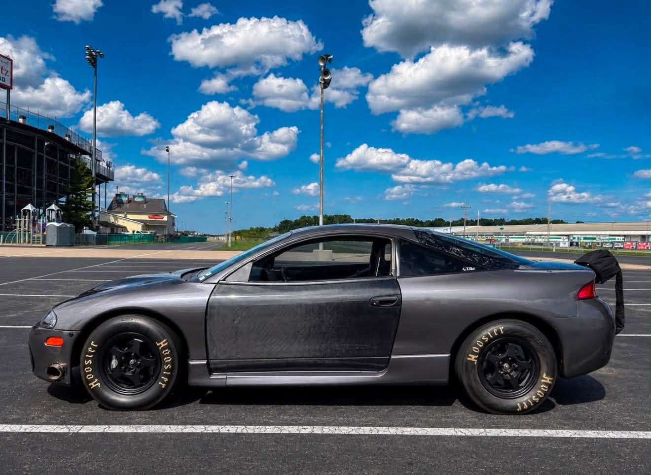

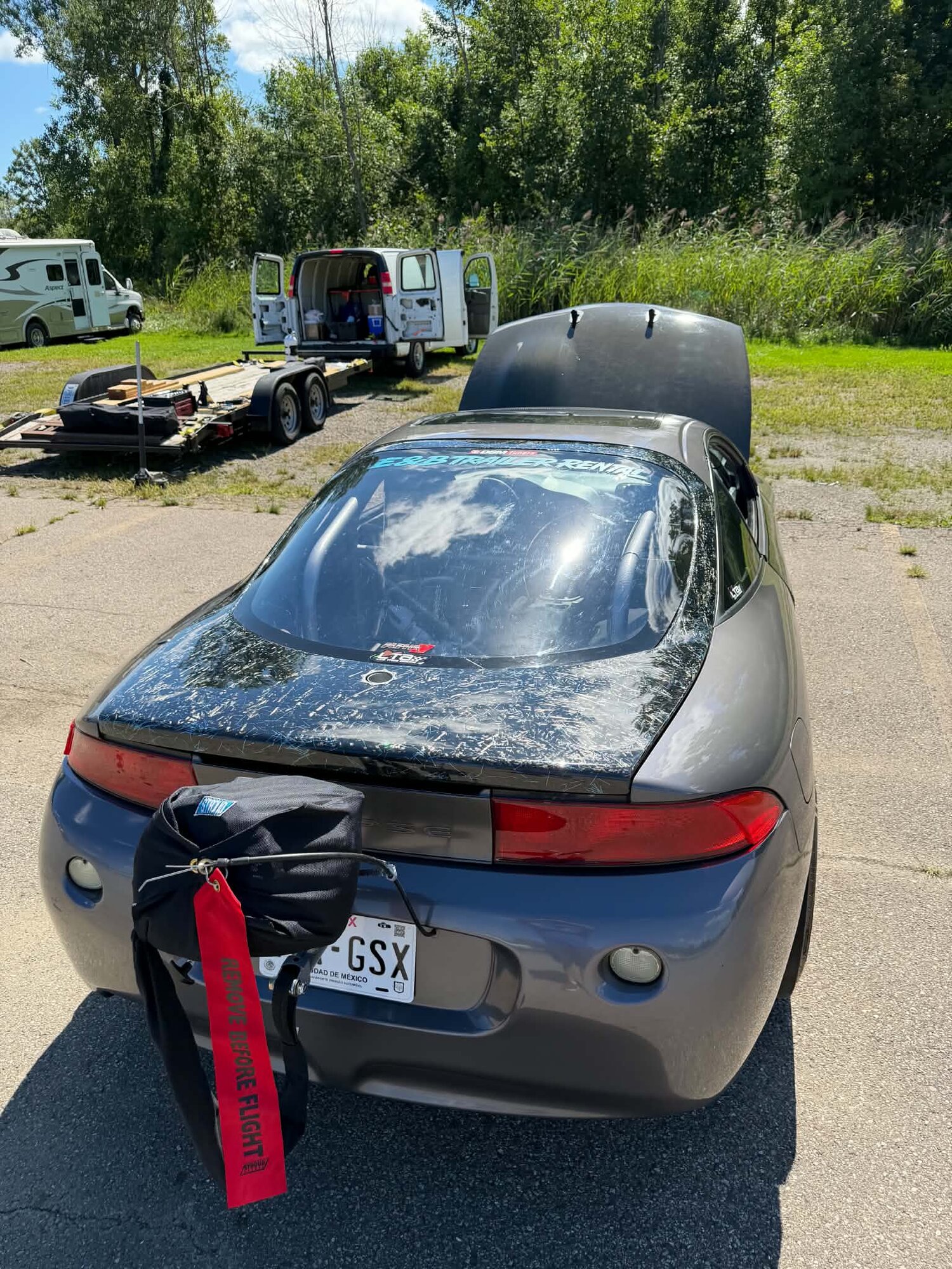

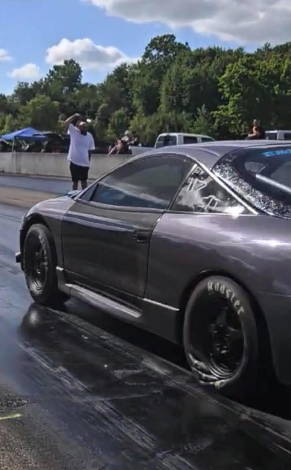

The car survived the dyno, so it was time to get the thing ready for some passes. My only real goal was to get the car to Norwalk this year and get an 8 second slip. We did just that. I had a lot of help with my friends, without them this wasn't going to be happening. So thank you Scott, Paul and everyone else.
Car's first hit off the trailer after a couple years and really no testing went 9.0 at 155. Second hit was our 8.8 sec pass at 159 mph. We pulled the plugs after that run to see what timing looked like (it wanted more!). We added boost, timing, and tried for a better 60'. I feel like the car would have had a 8.50 in it.
First pass 9.0:
Second and last pass of The Shootout, 8.8 at 159 mph:

I believe we hurt something while getting more aggressive with the 2 step after our 8.8 pass. We really need to get this car to 60' better. It happens. We yanked the head over night, and I was expecting to see damage, but there wasn't much. Leak down test before we pulled the head told us exhaust valves were not happy on cylinder 3 I believe it was. Poured some water in the chamber when the head was pulled and it was leaking pretty bad out of those exhaust valves. We called it a weekend.
I've already got the head fixed up and ready to get things back together. I will be making some changes to try and keep valves happy. Unfortunately, I'm not 100% sure what caused the damage. One theory we think is the distribution of nitrous using the single nozzle. I will be changing to a direct port dry nitrous system to make sure distribution is consistent between all cylinders. I've also made a change to Kiggly's race only valve springs, as we are targeting higher boost levels on M1 for next year. I'd really like to get back into the 1/8 mile local no prep stuff again for 2026.
