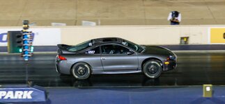

1998 Mitsubishi Eclipse GSX Vehicle Profile & Build Thread
Street Build
98 auto GSX
1998 GSX
