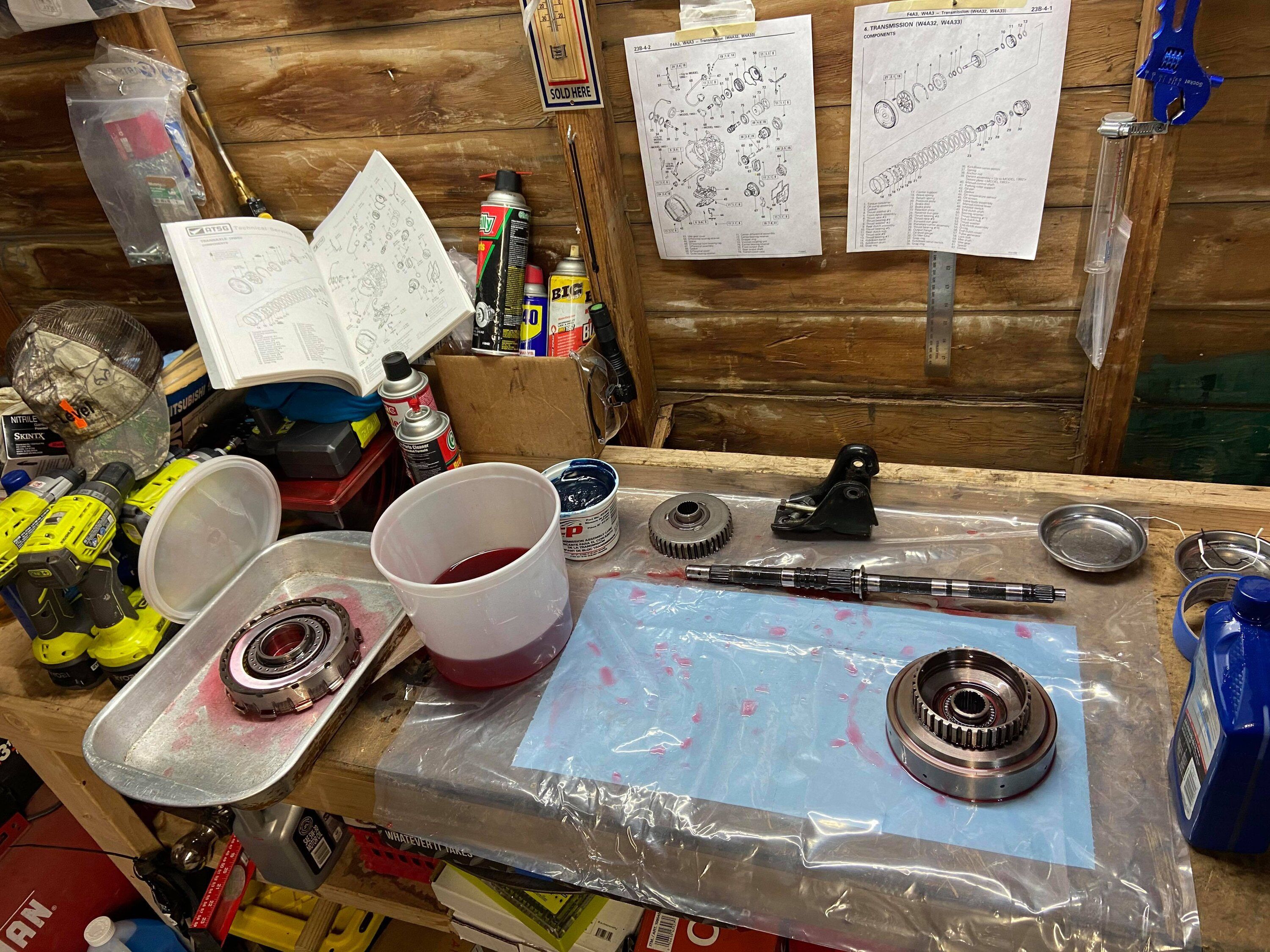

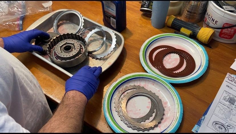

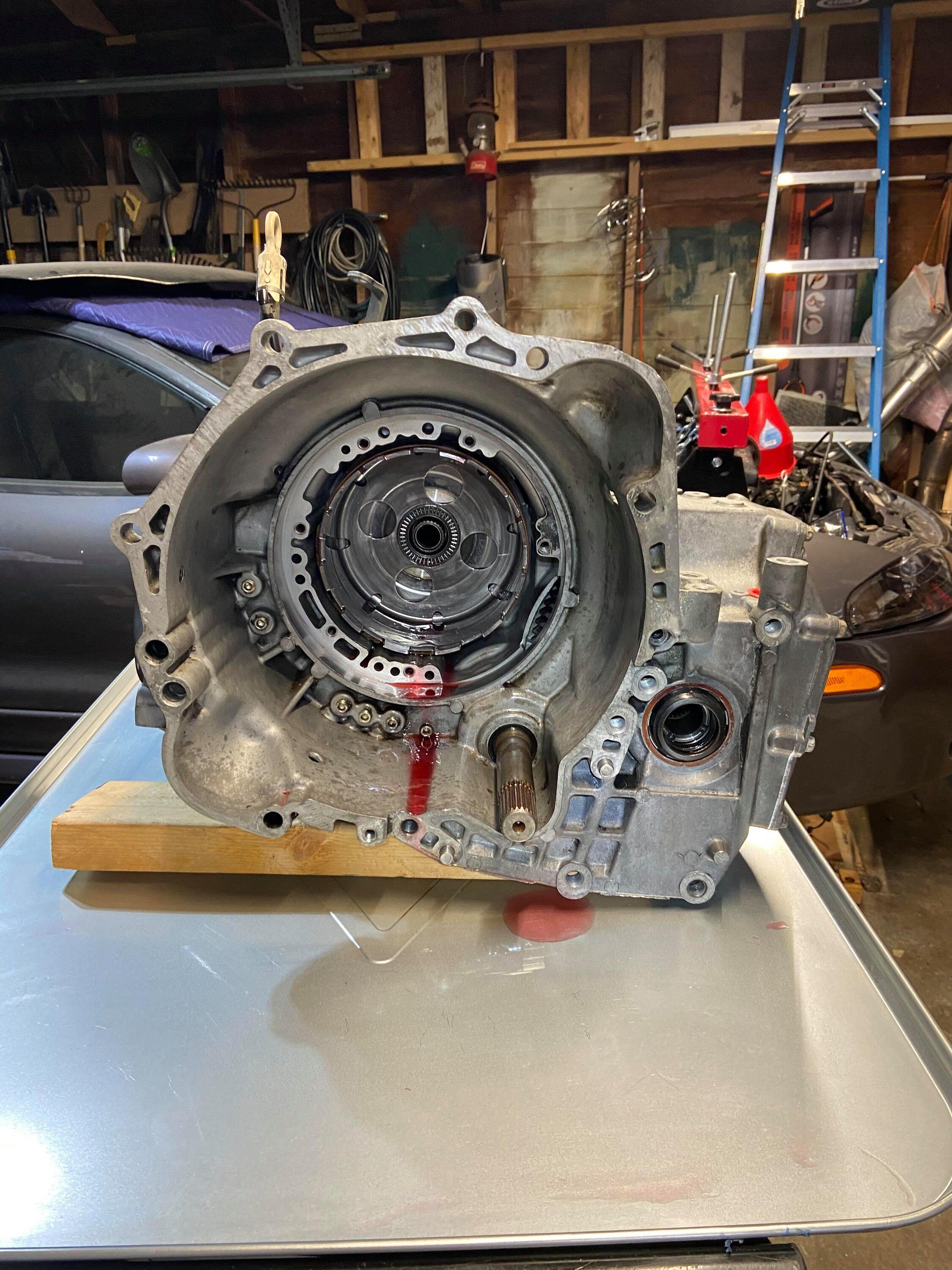

Well, after about two months of searching and waiting, and dealing with A LOT of clowns, I finally got the forward frictions that I wanted to use! They are an upgraded material from Raybestos, the same material used in Kiggly 5 friction front clutch pack. I have a couple rear clutch pack kits on the way.

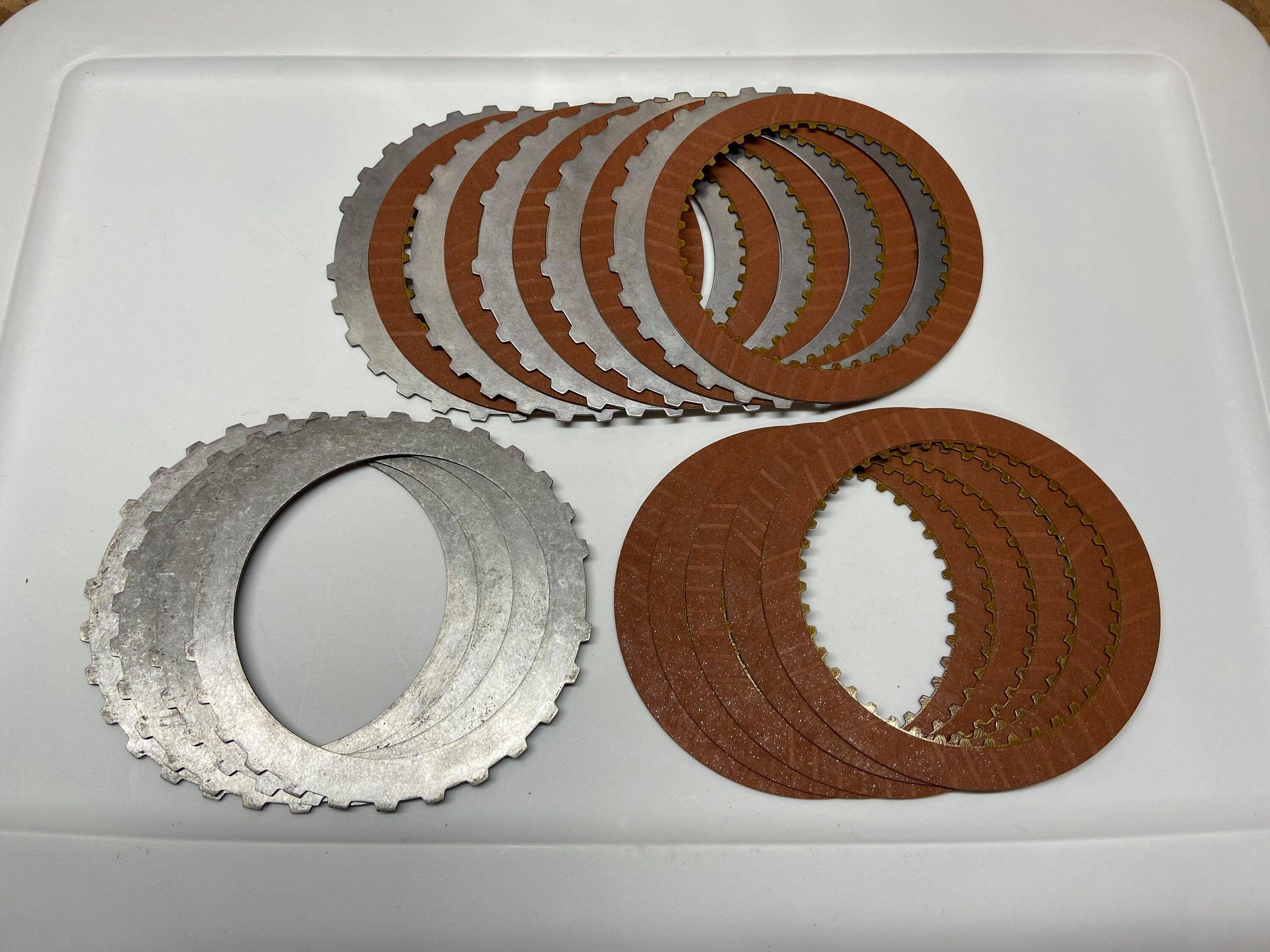

I went this route mainly for a piece of mind, as I do have some generic aftermarket frictions I came close to using, and they just feel too "papery" to me. These Raybestos feel "right" and I'm much more confident using these in the build that's for sure.

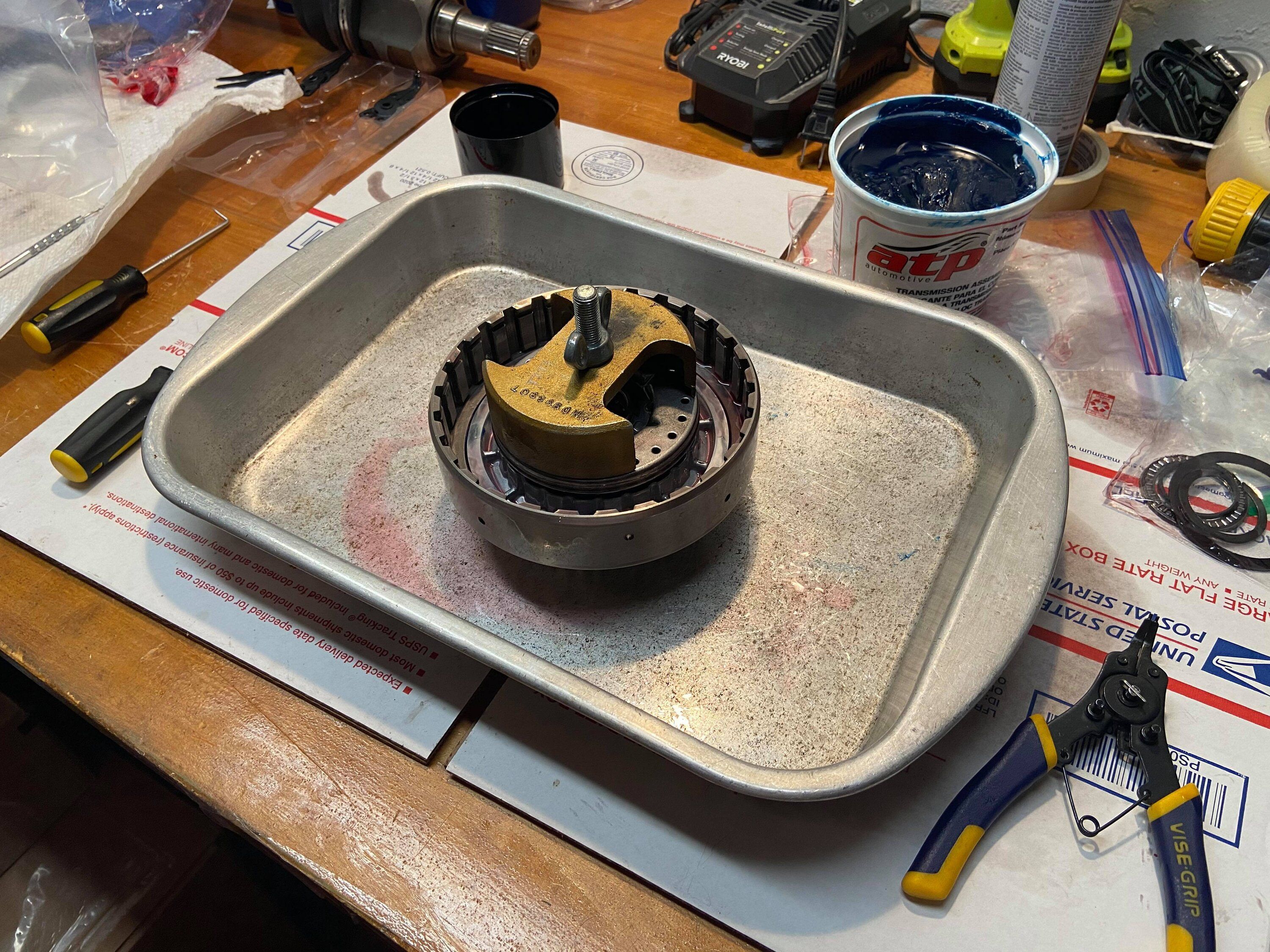

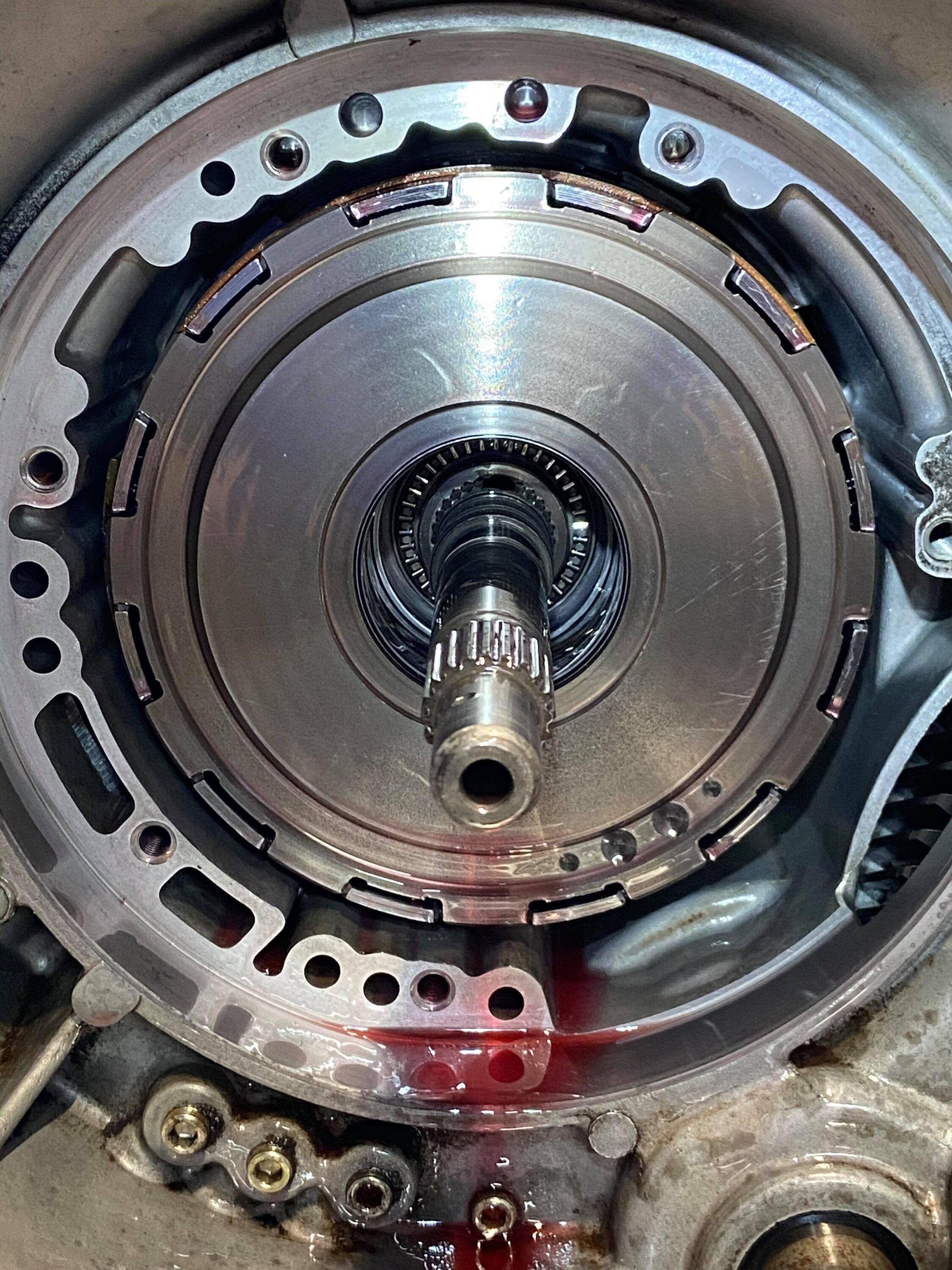

I wanted to rebuild the replacement forward drum that I got too, so I found the special tool used to compress the piston's springs to take it apart and install new piston seals:

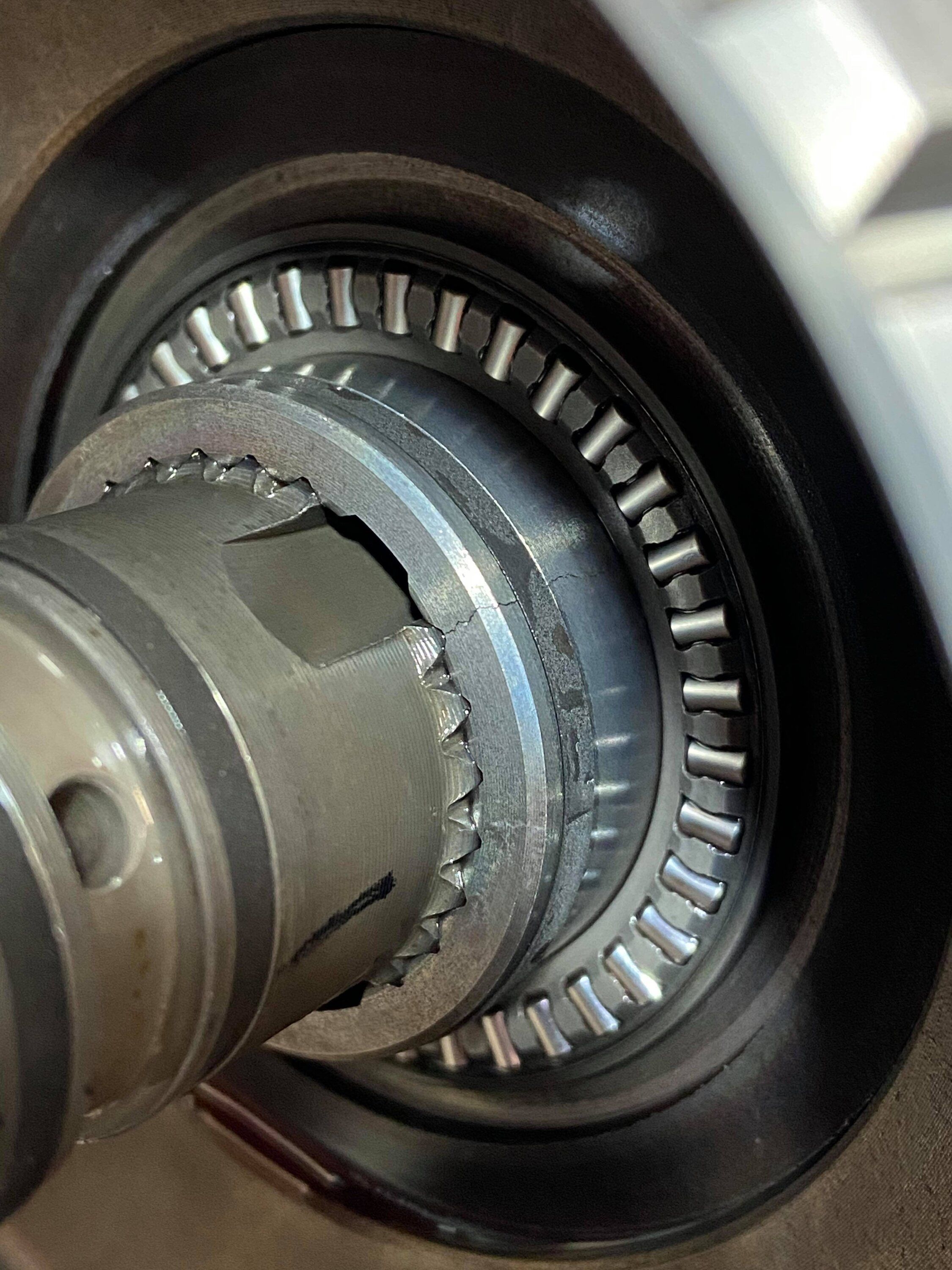

And this is why I wanted to use a different forward drum, I found my original unit it be crack:

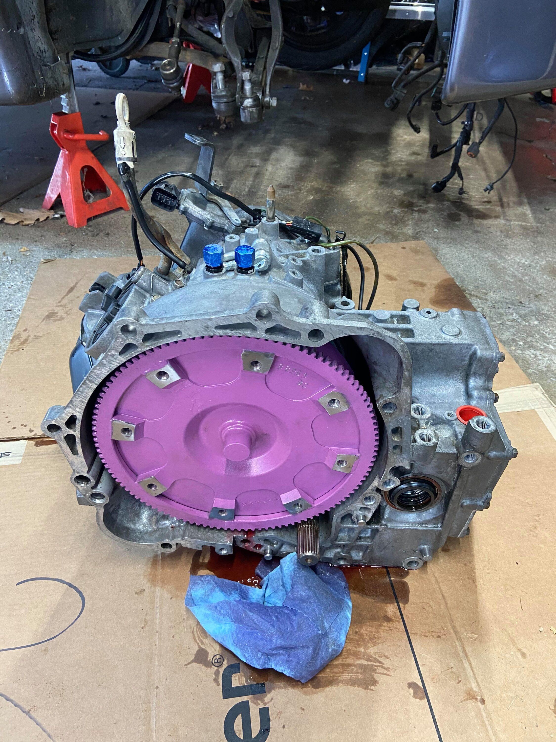

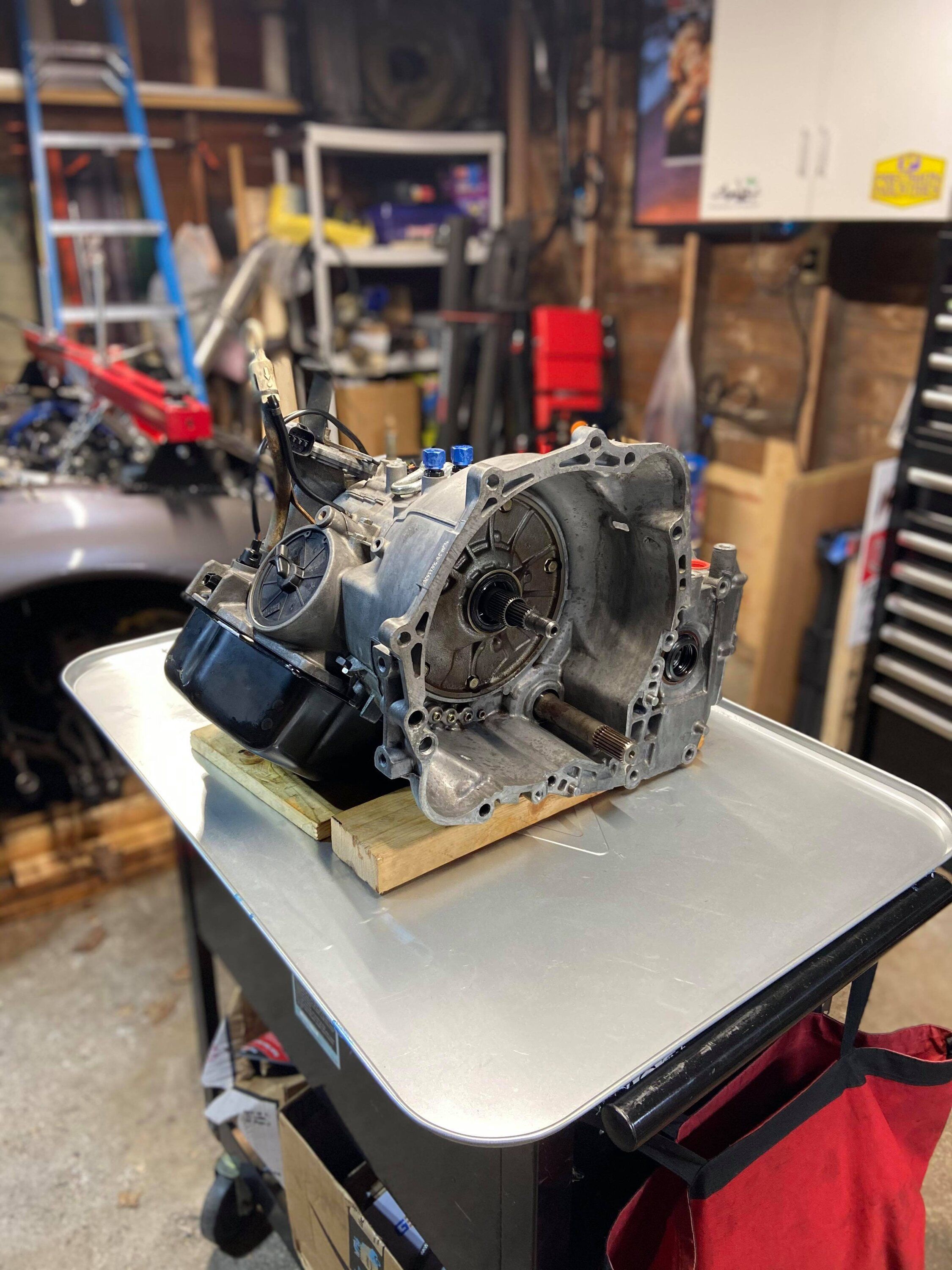

And it was time to get the trans back together and in the car. I just hope I did the trans correctly, fingers crossed big time on that!

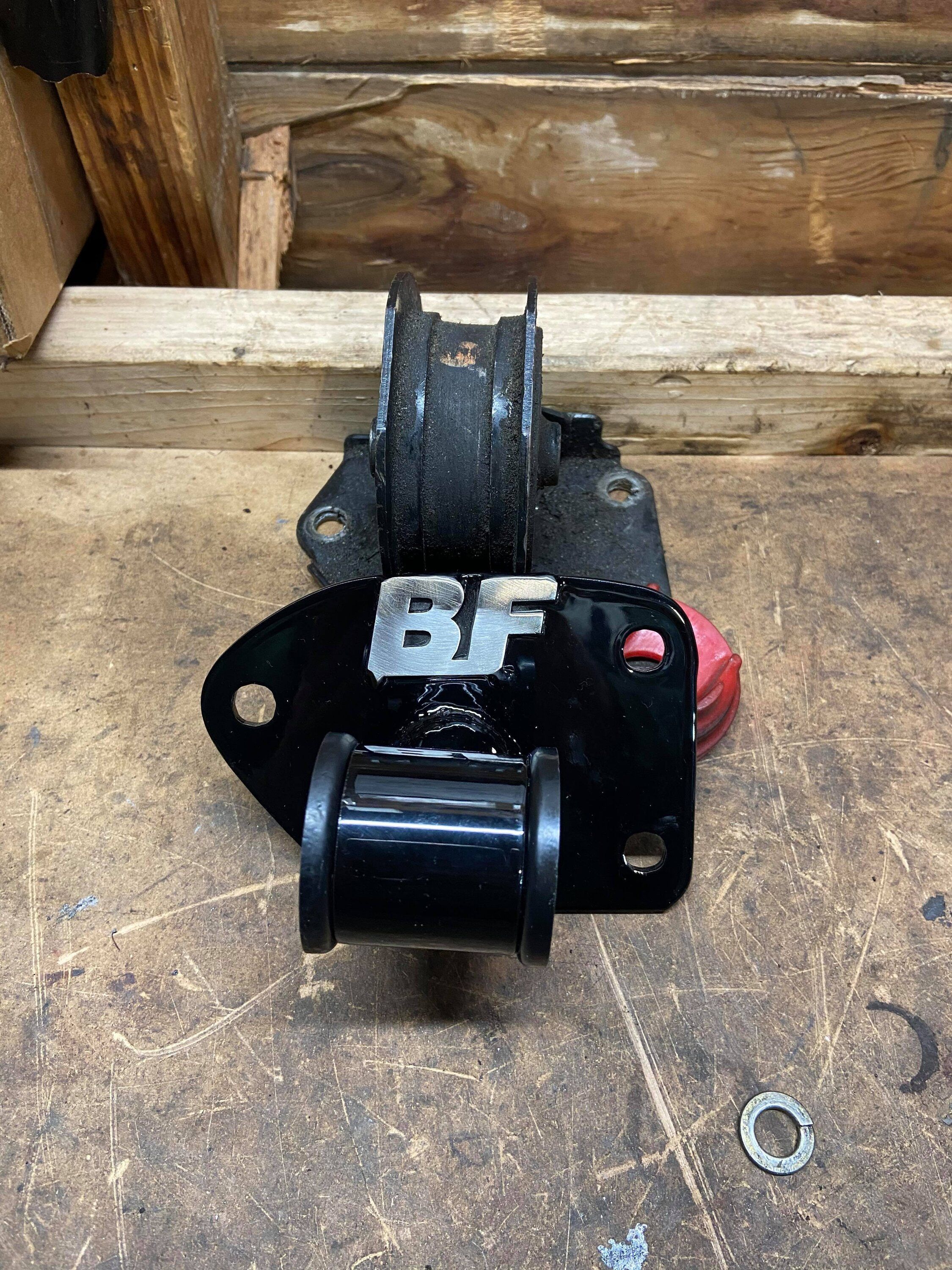

Also it was time to ditch the old OEM rear trans mount/ roll stop with half assed prothane inserts. I went with boosted fab rear trans mount with their poly bushing option:
View attachment 625230 View attachment 625231 View attachment 625229 View attachment 625228 View attachment 625227

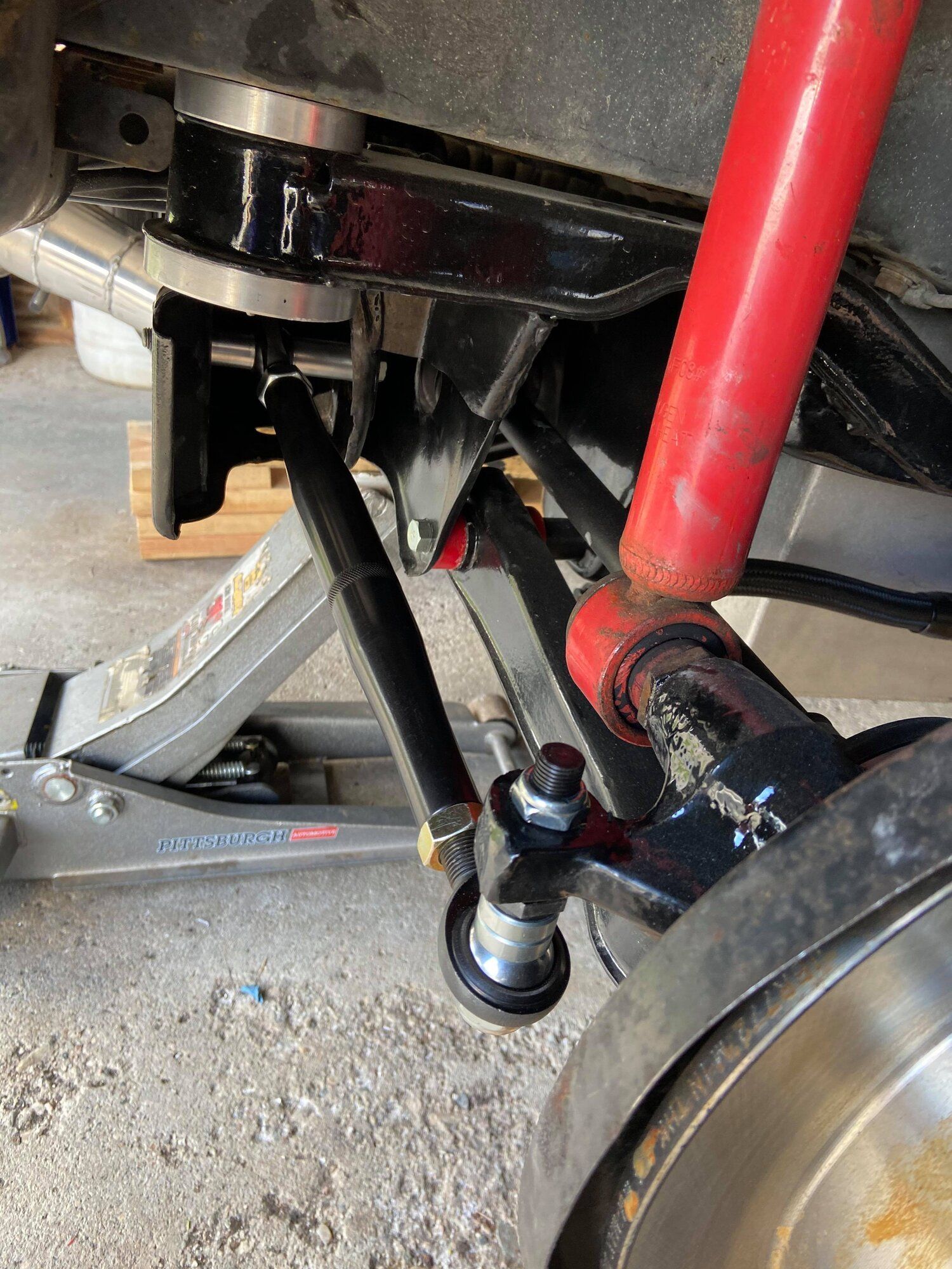

I don't have too much of an update, as I'm stuck in the water with my shift box out for repair. Not sure what's going on with it exactly, but it doesn't seem to be powering up correctly.

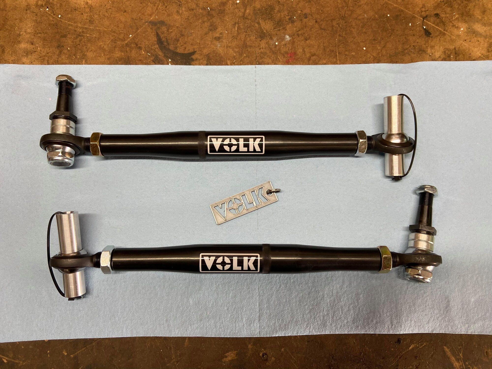

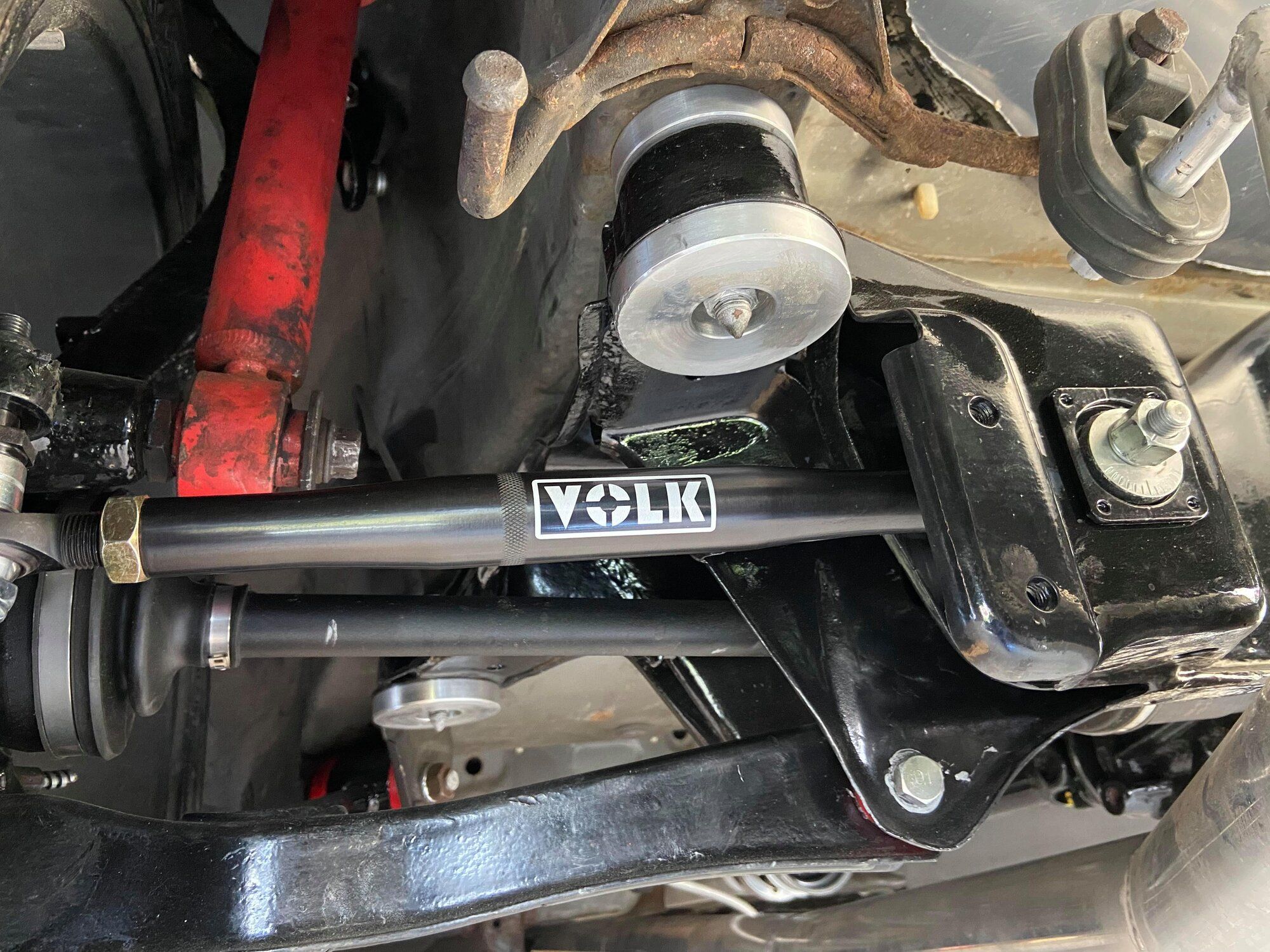

I was able to get to the alignment rack, but found my rear toe was out of adjustment and wasn't able to get any better than -.4 degrees, so I ordered up a set of Volk Metal Craft's (@99gst_racer ) 2g adjustable rear toe arms and installed them. Whenever I get the shift box back I will get the rear alignment sorted out 100%. These rear toe arms are awesome looking and amazing quality!

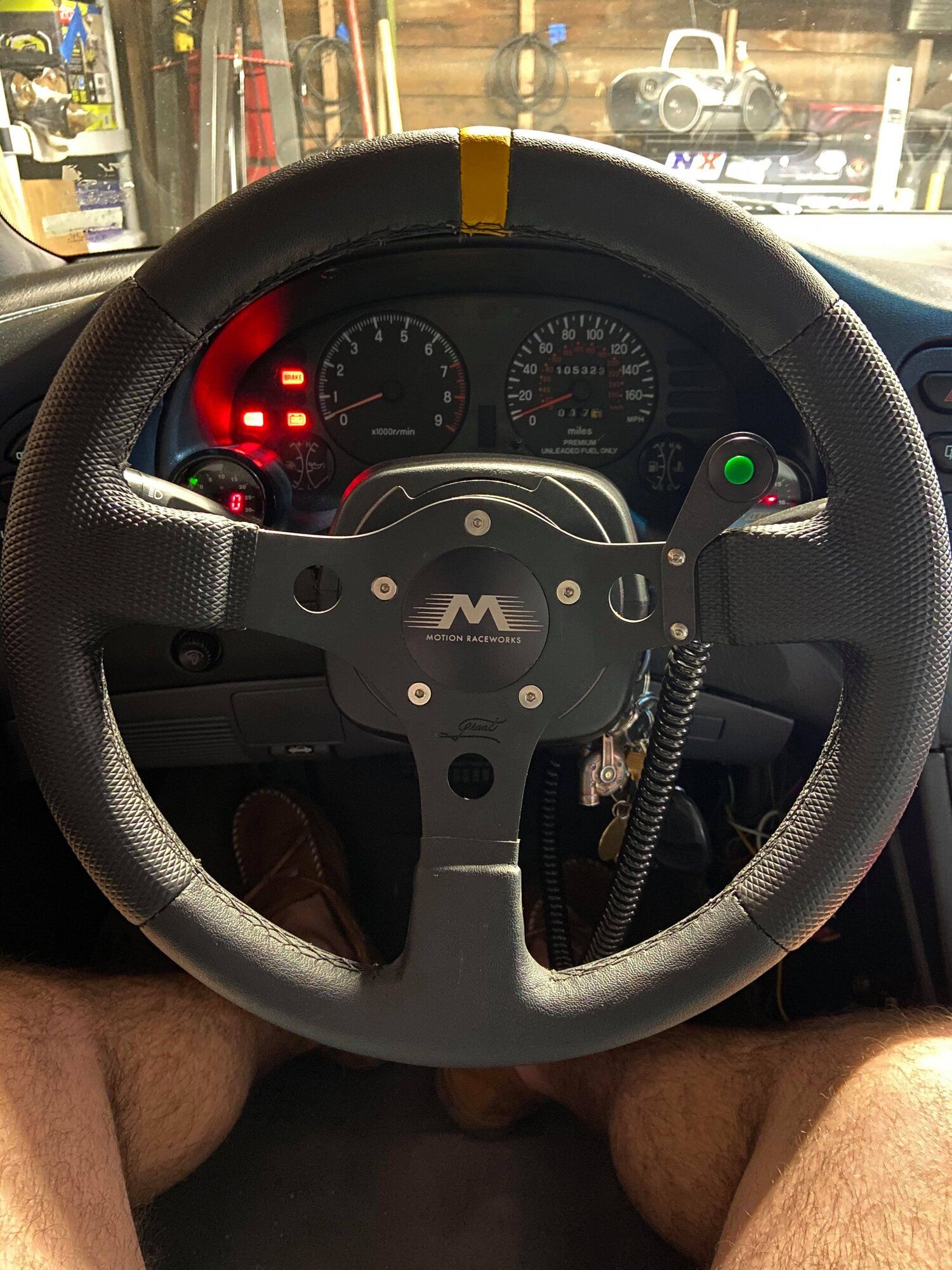

One other small thing I tossed in while waiting for the shift box to get back is a Motion Raceworks horn cover for the steering wheel. Gives it a cleaner look when compared to the grant horn button.
Once I get the shift box back, rear toe dialed in, and a couple other checks I should be ready to hit the dyno and hopefully make it out to a couple races this year!
View attachment 627665View attachment 627664

The clutch packs look stout. What brand are those?
Thanks for posting up on your build. There's always something to be learned from reading through other people's build threads.
Thank you also for sharing the information about the extinguisher. We didn't previously know about those and we were just about to add them to build.
Thanks! Yeah I want to say I originally saw Jason Drew post about the Element fire extinguisher, and it looked like a nice alternative to a typical unit you see.
The rear clutch pack consists of Raybestos Stage-1 RED frictions along with fresh steels.
