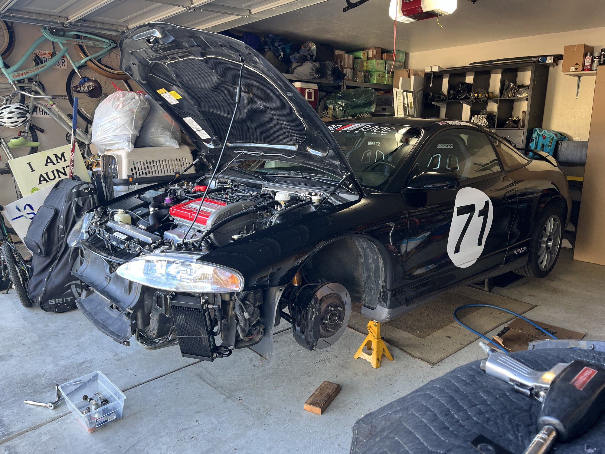

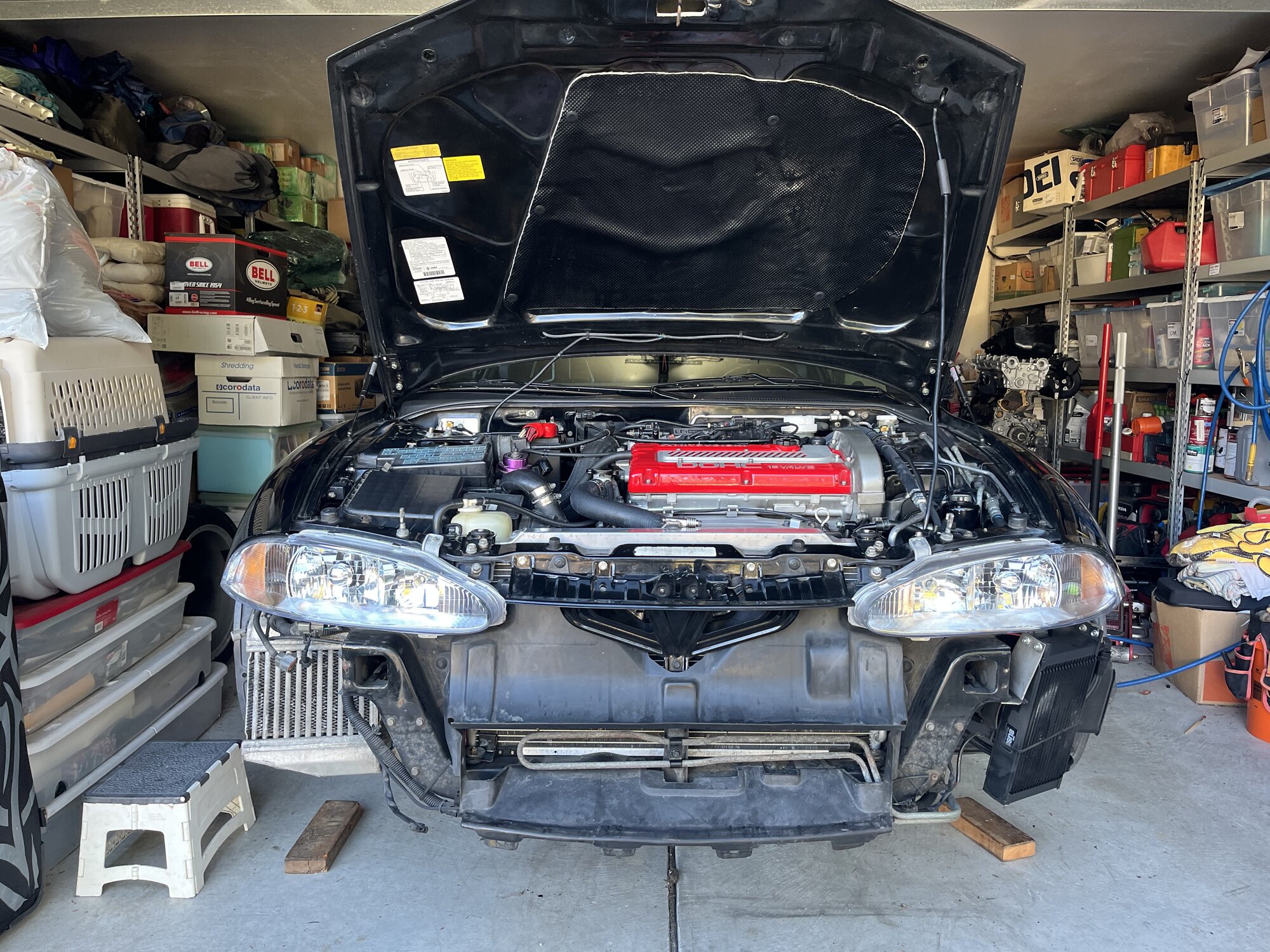

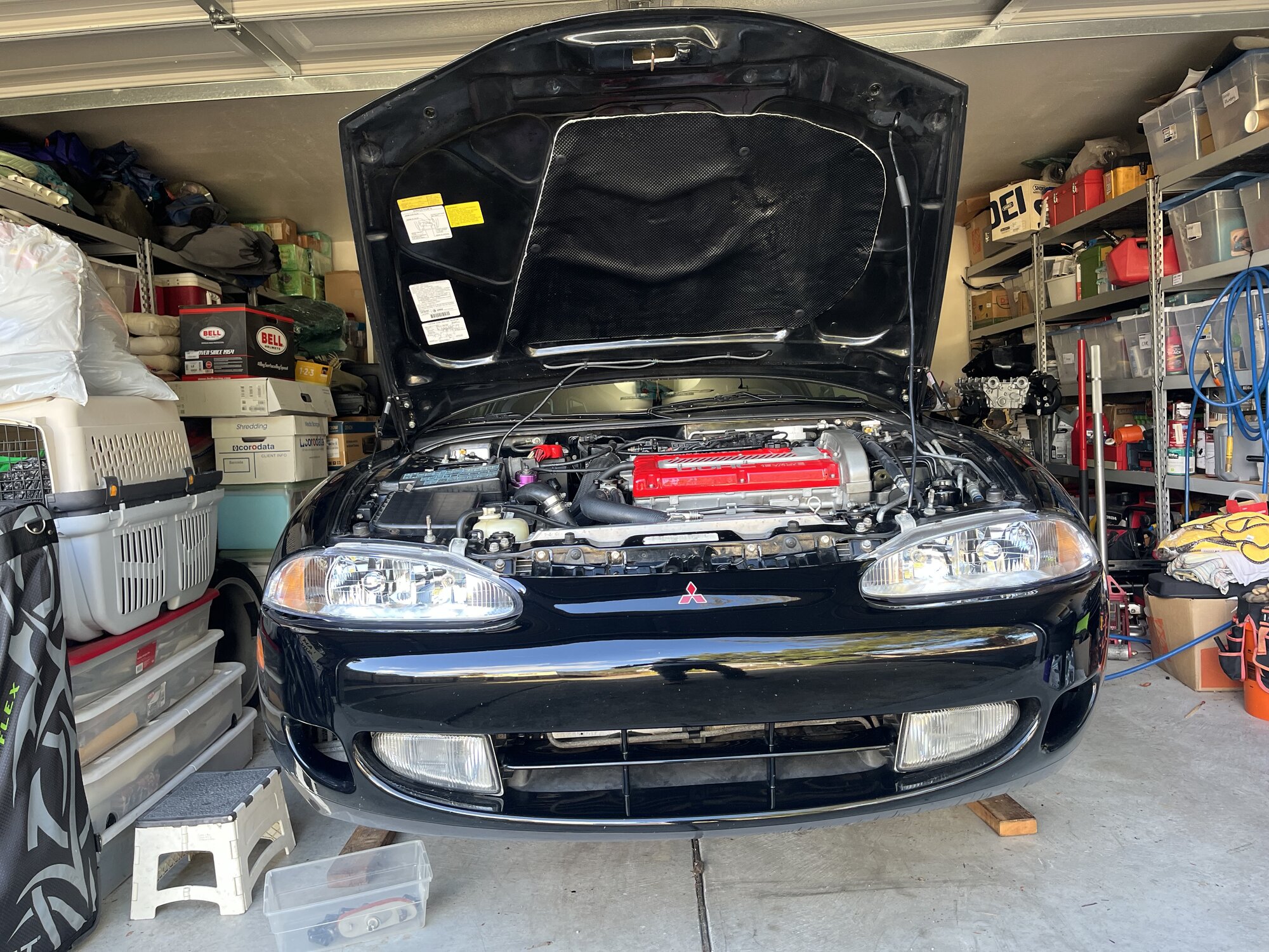

Its been a month of casually looking for a 2Ga bumper cover that can be shipped, and no luck. It's actually been easier to locate and purchase a bunch of the 2Gb parts instead.
This is the list of 2Gb specific items to swap out when converting from a 2Ga front end.

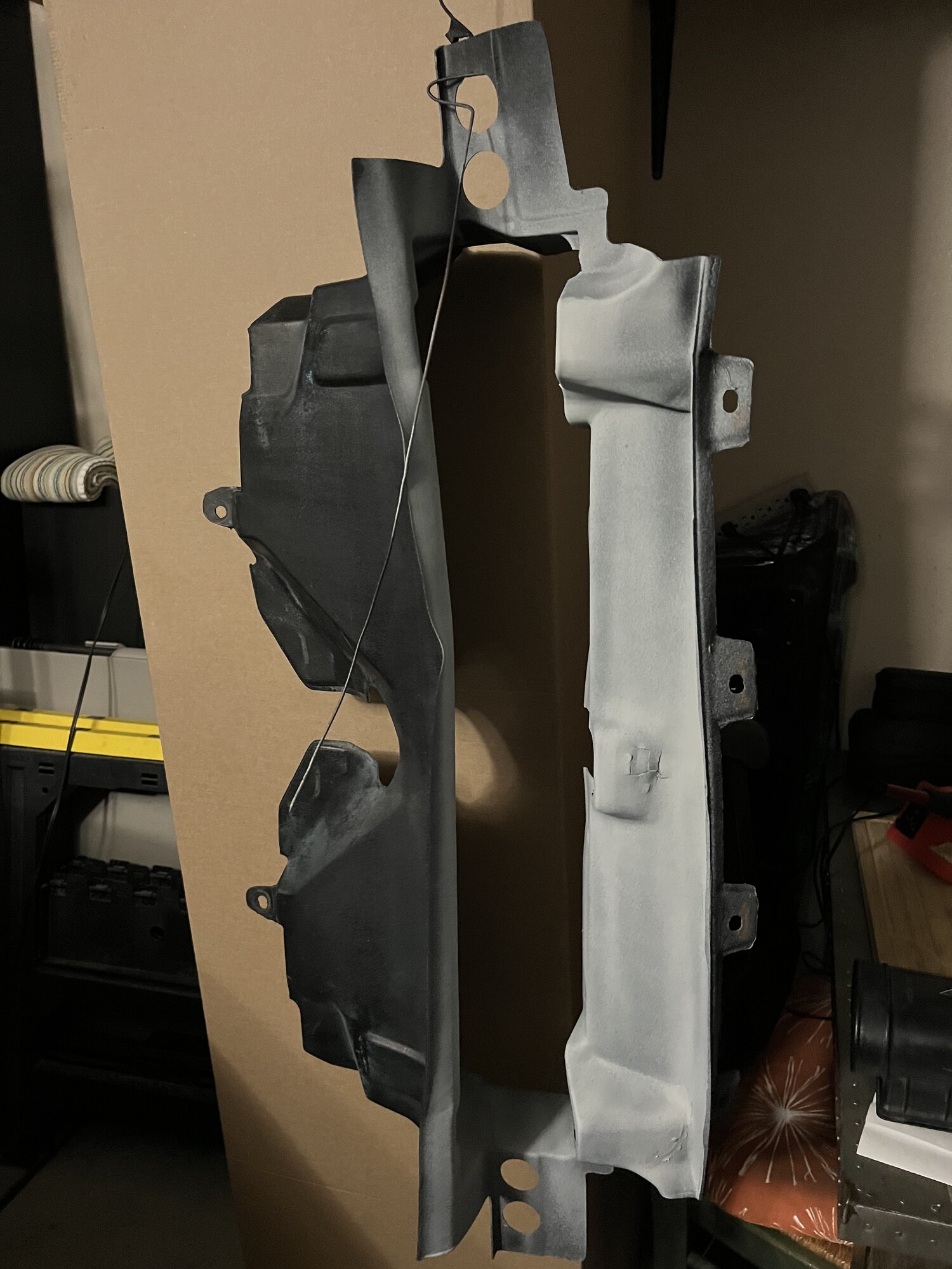

Foam bumper cushion: MR236497

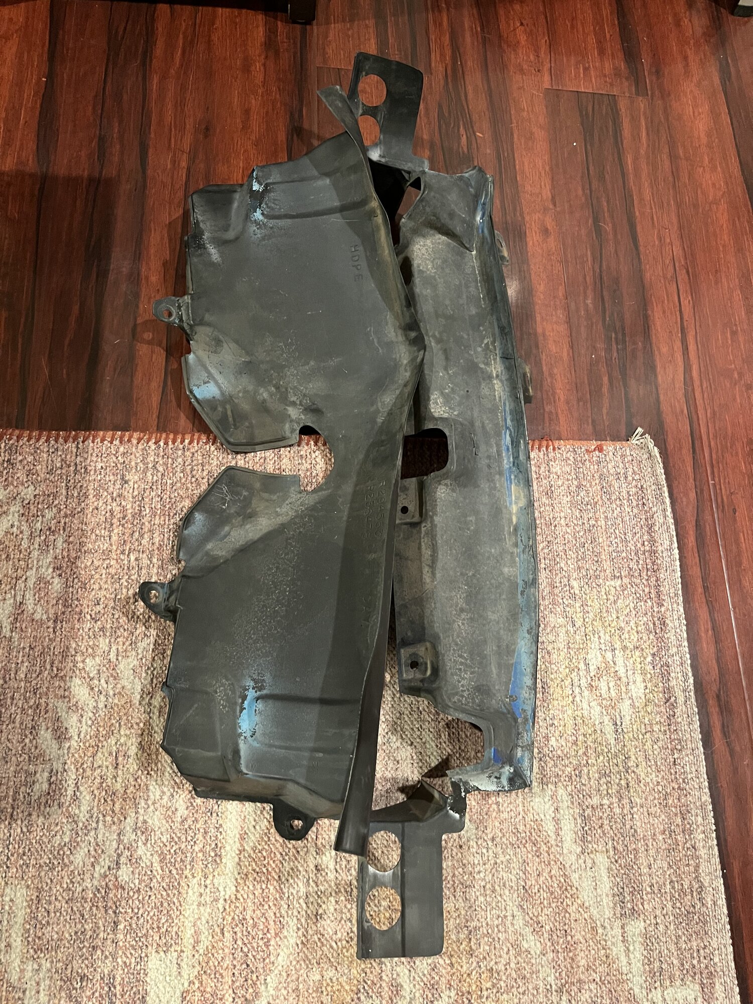

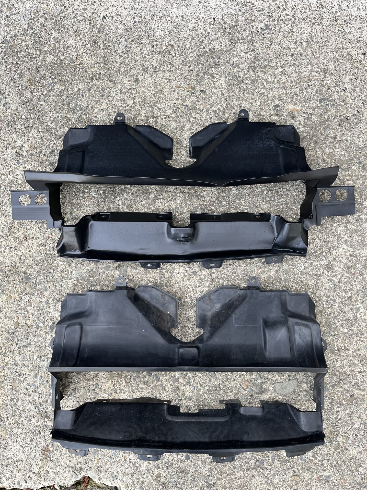

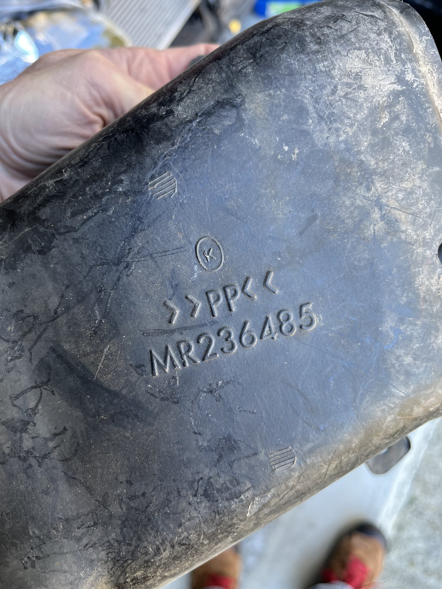

Ducting: ebay
IC - MR236485
Front - MR294553 or MR236478

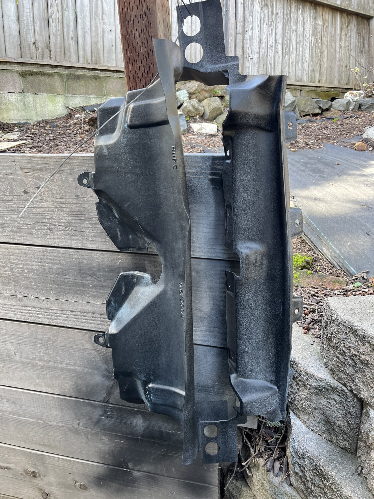

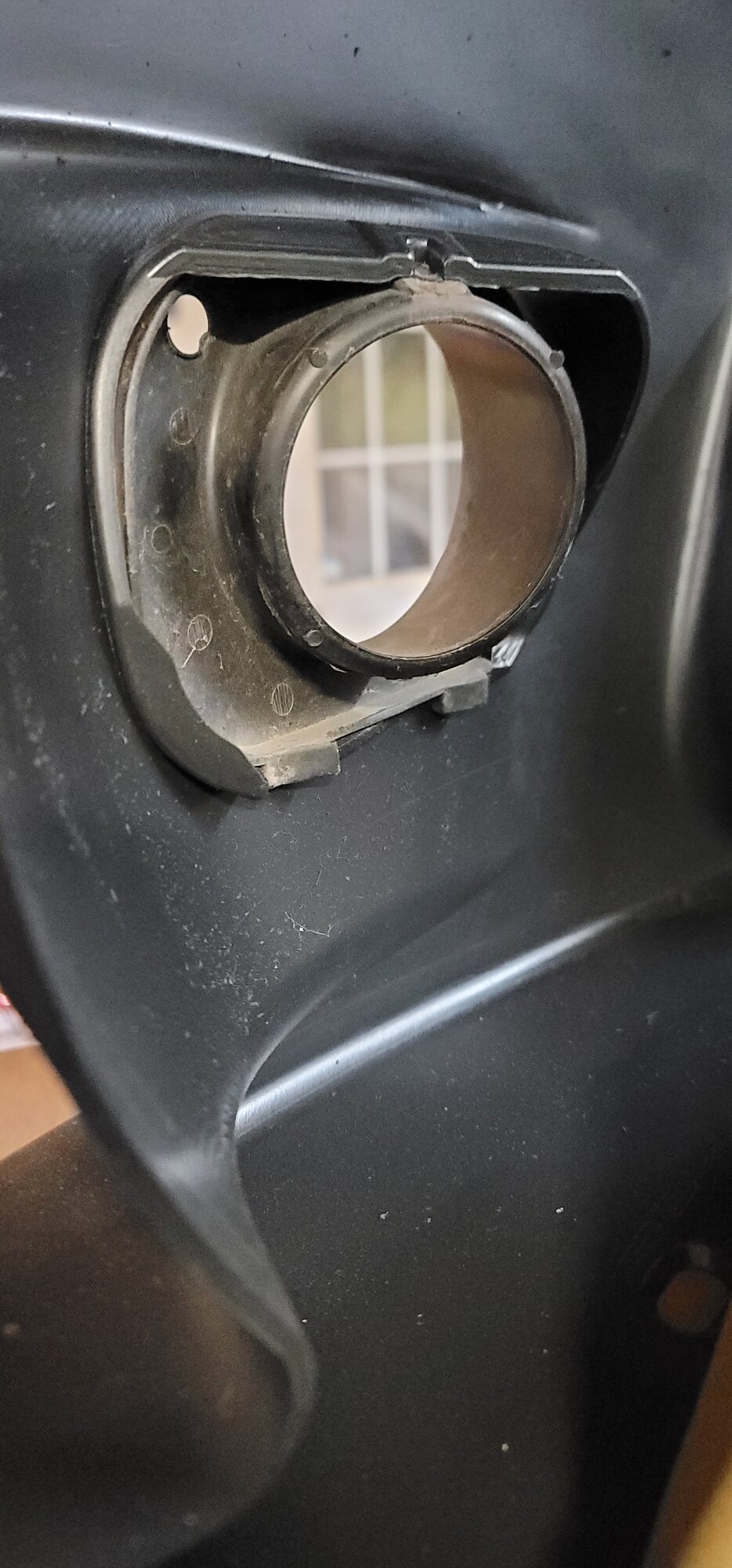

Fender Liners: ebay
Right MR162458
Left MR162457

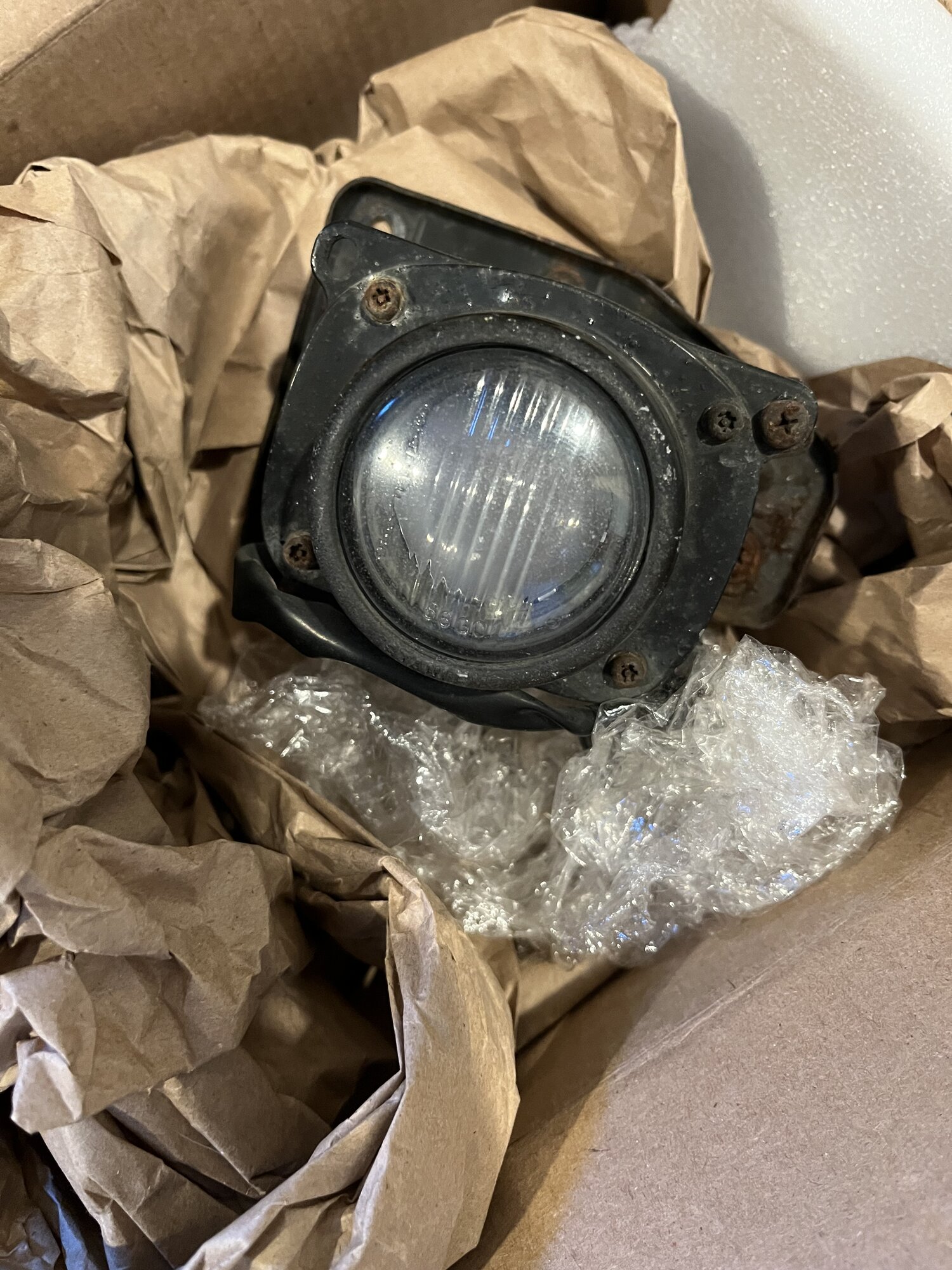

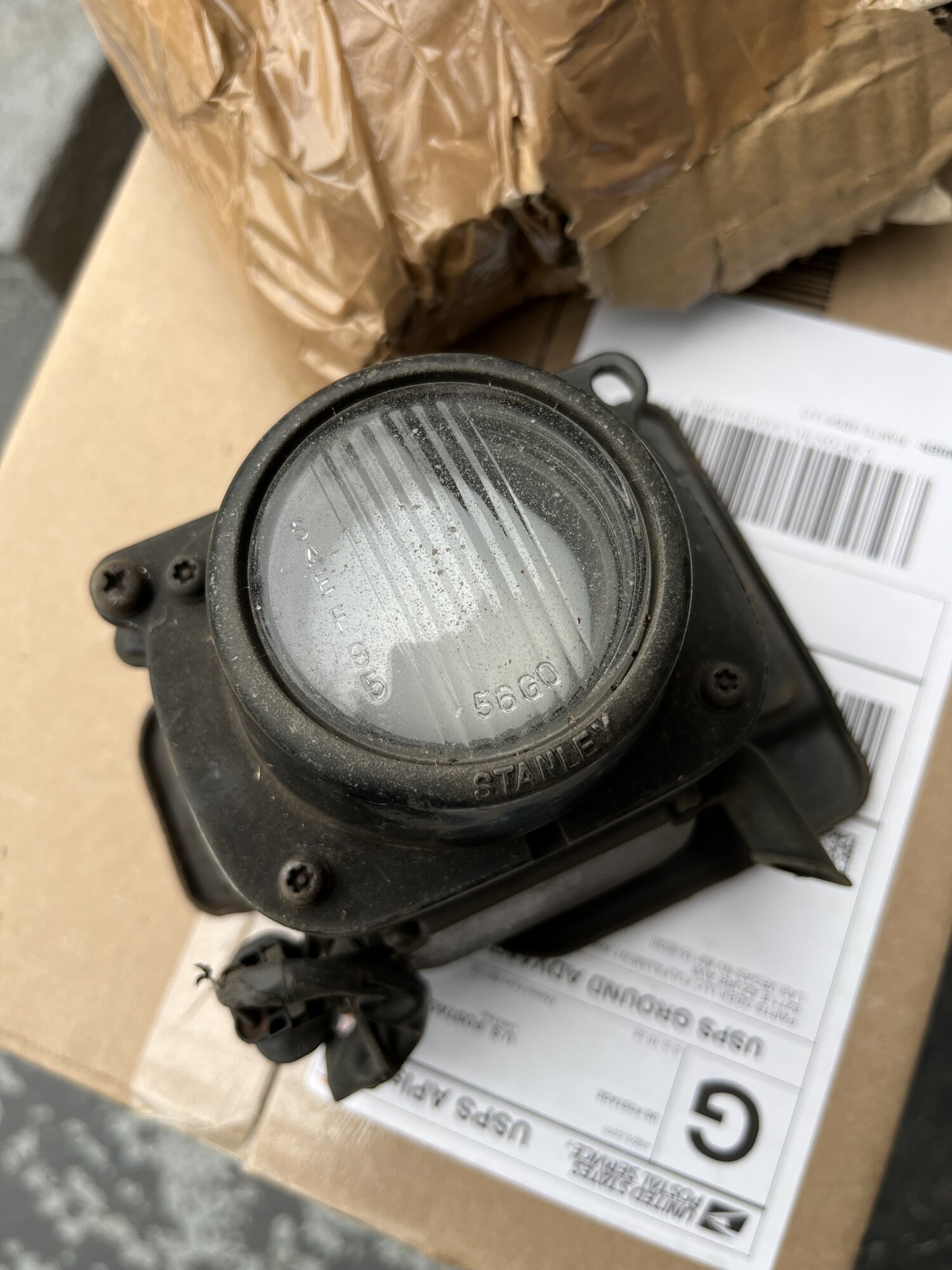

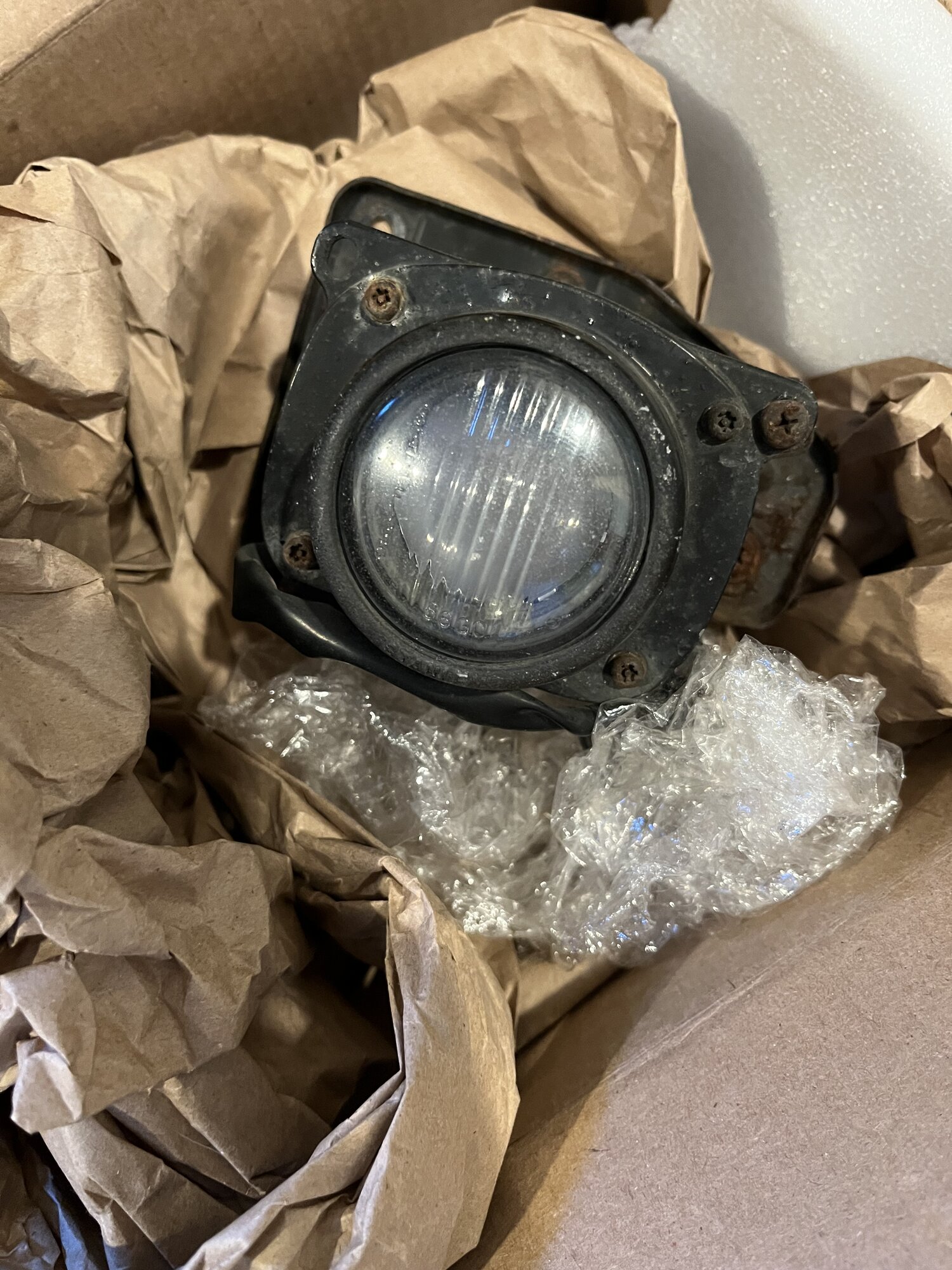

Fog Light assembly: ebay
Left: MR296279
Right: MR296280

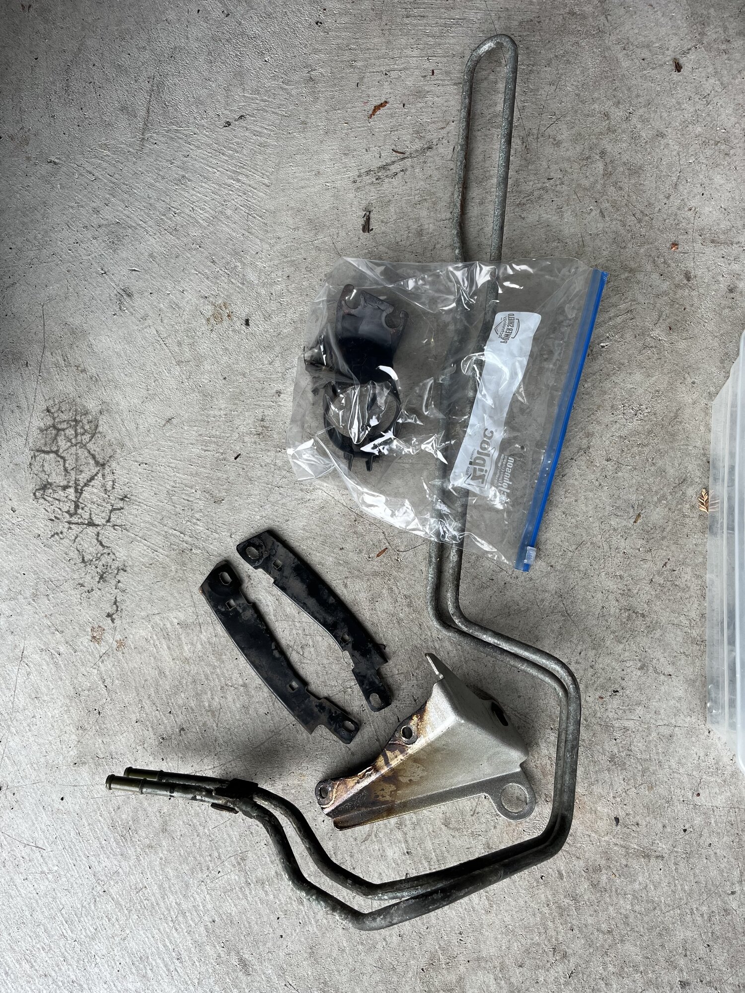

Fog light bracket: ebay or Dudes
https://www.dudes-custom-parts.com/shop/exterior-interior/fog-light-brackets-for-2g-dsm-97-99/
Left: MR221611
Right: MR221612

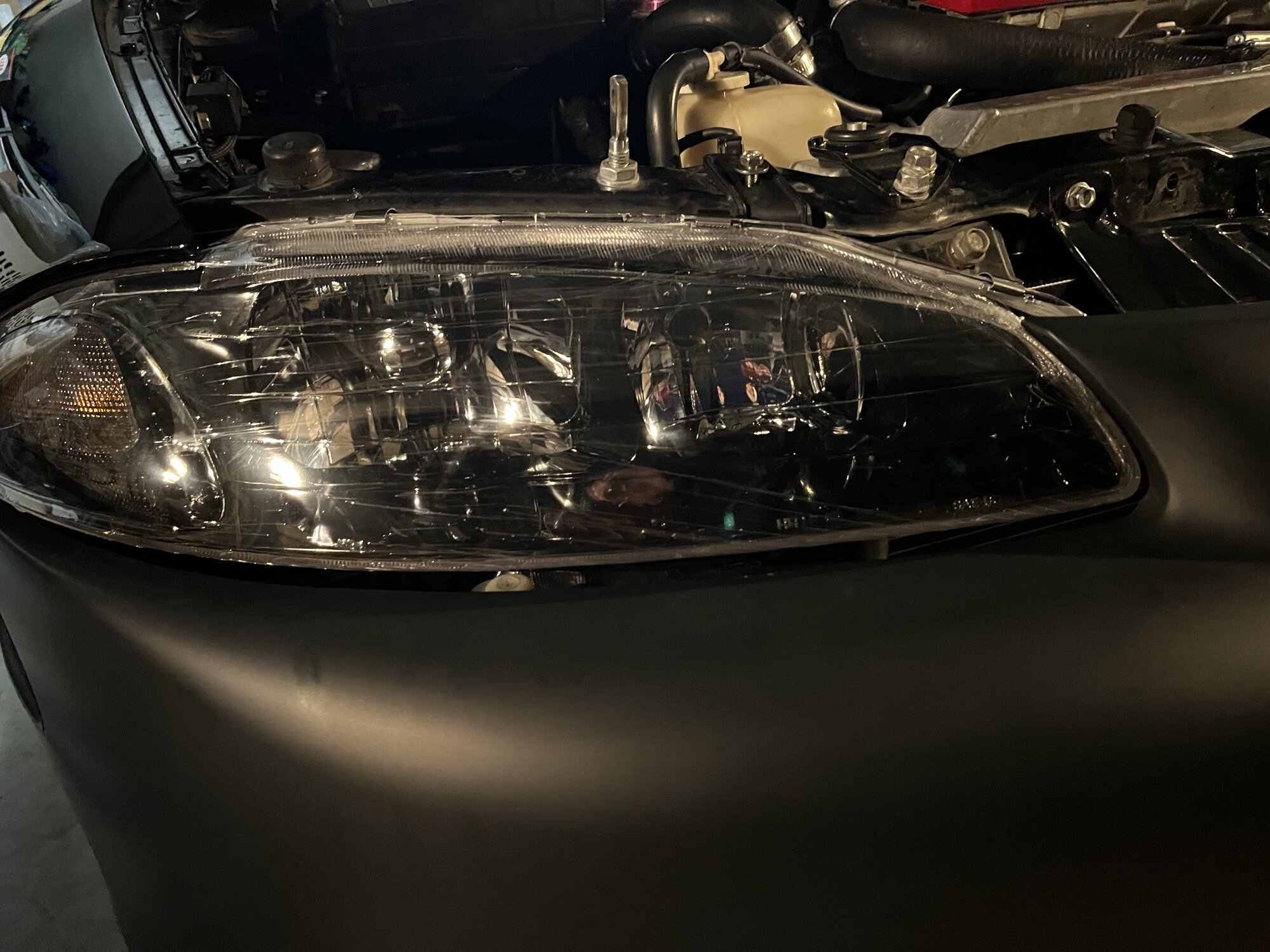

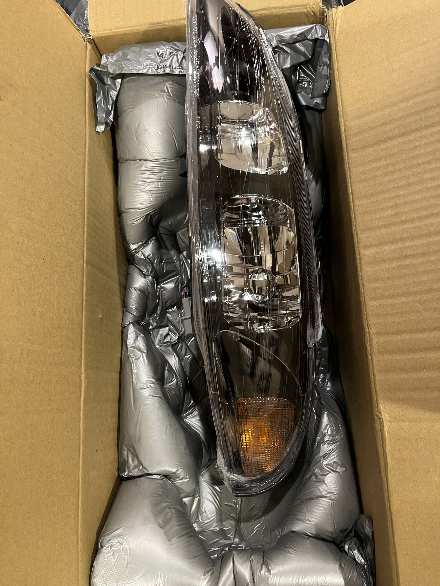

HEADLIGHTS: Amazon
Left: MR296283
Right: MR296284

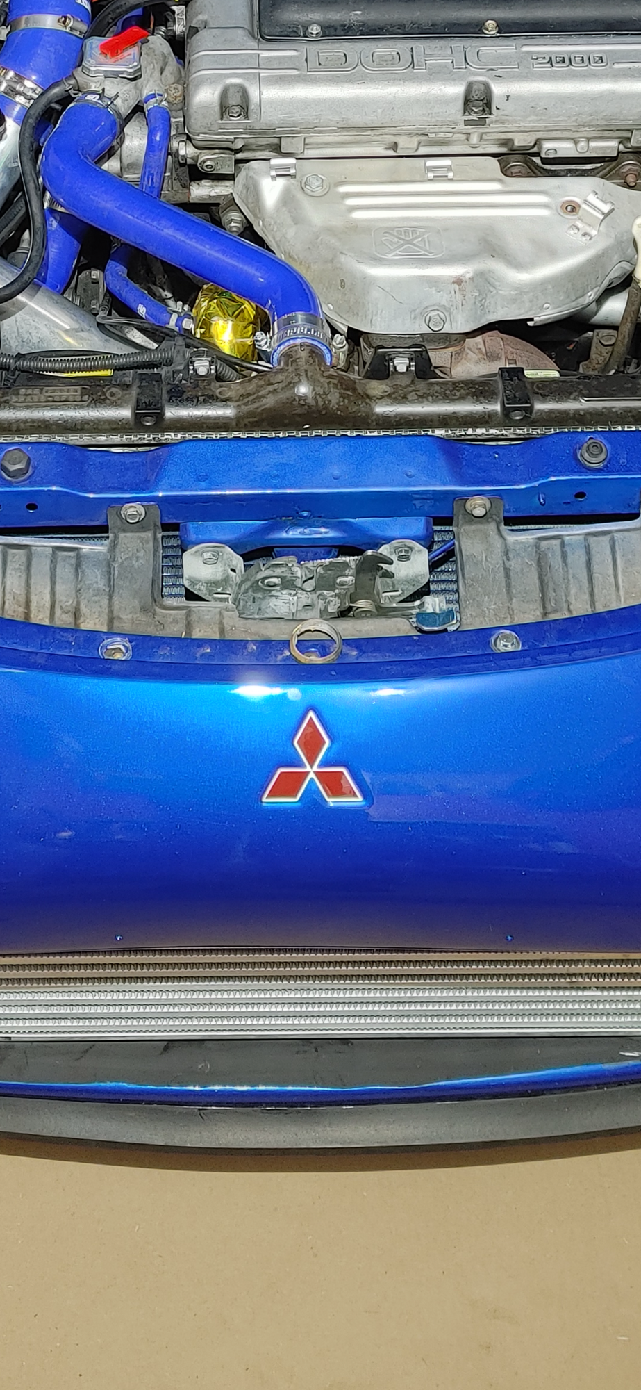

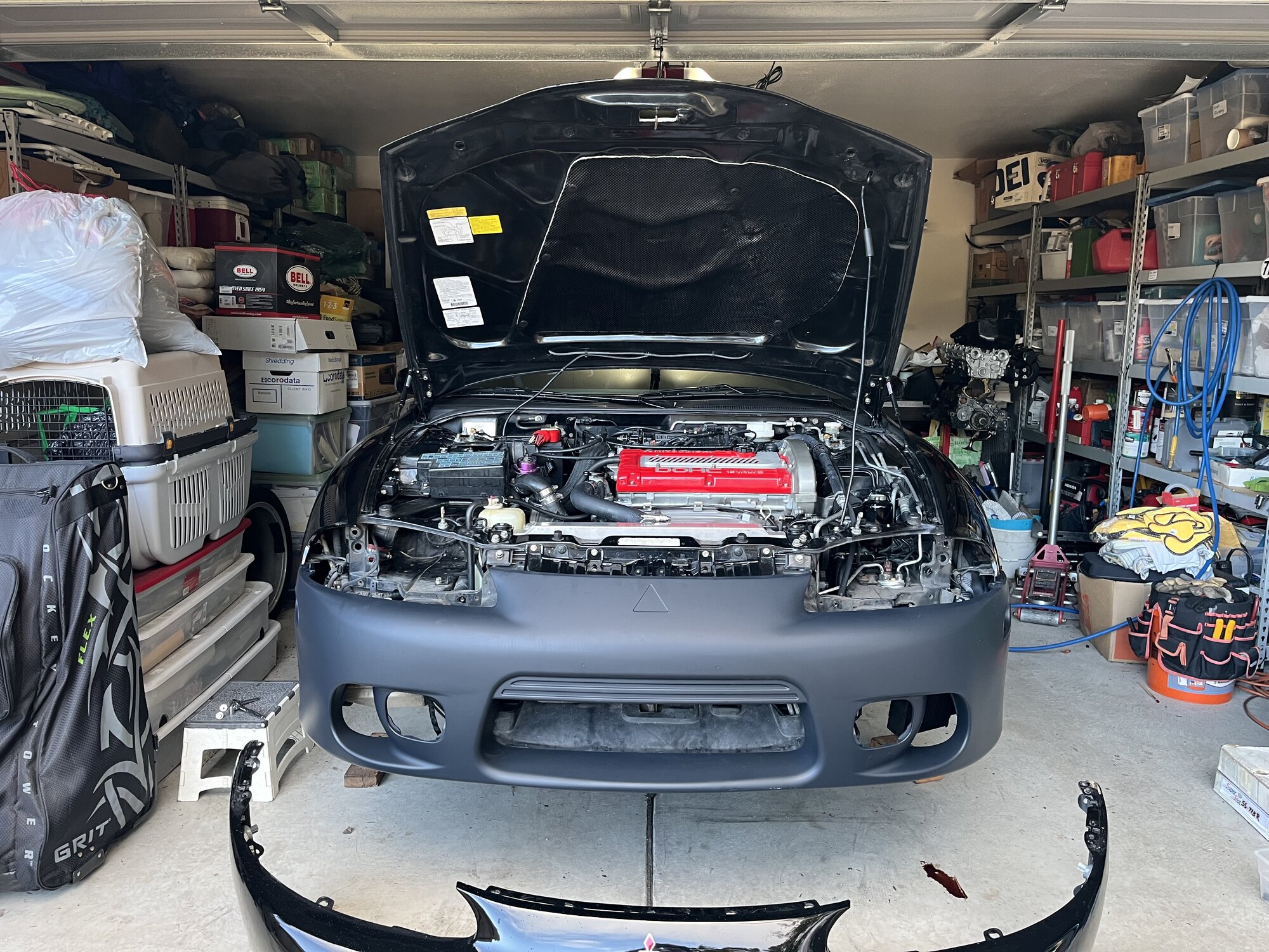

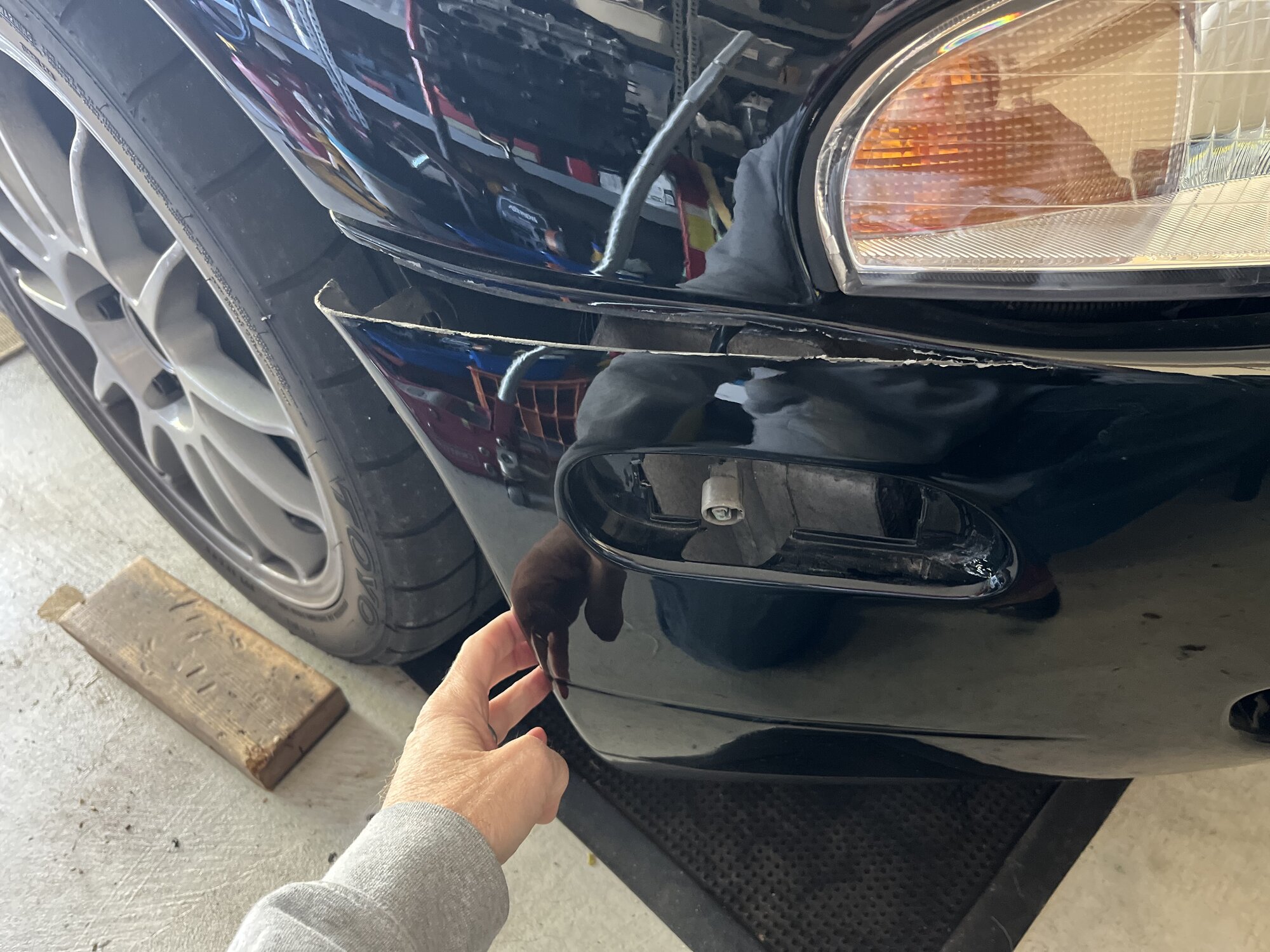

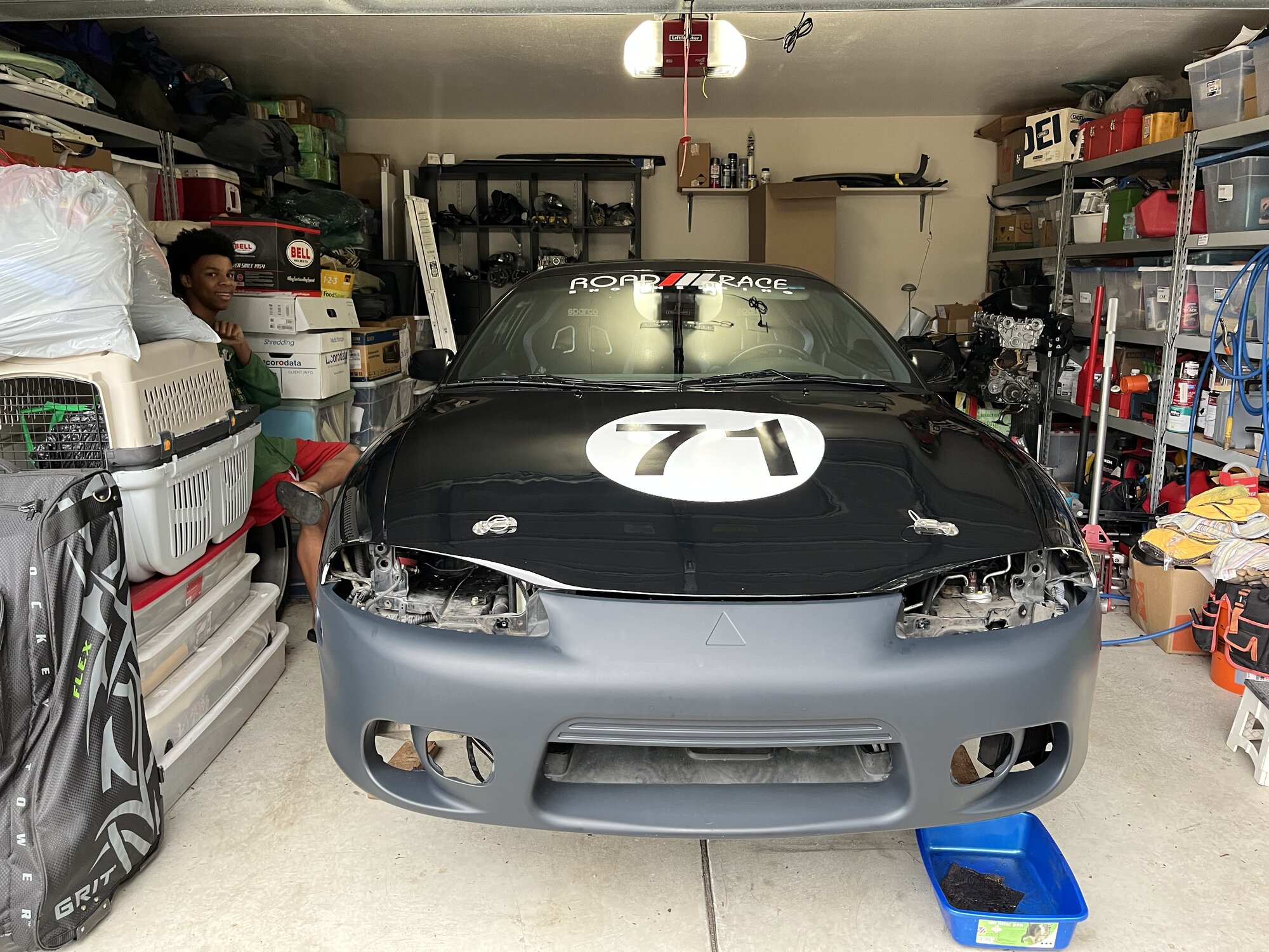

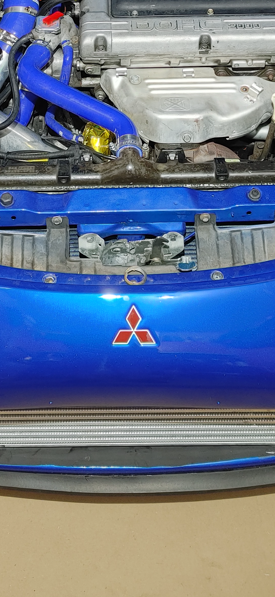

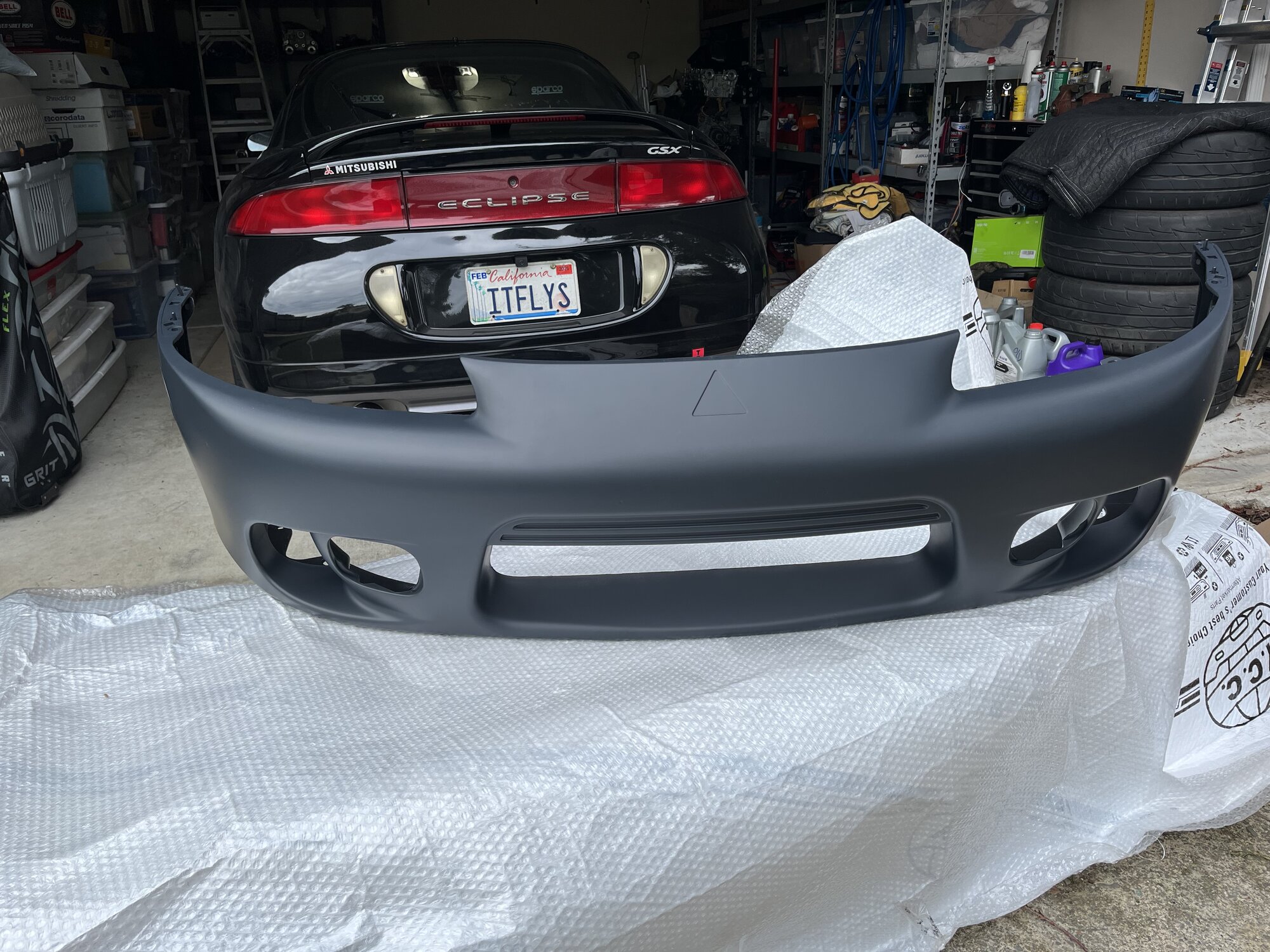

I know you listed the oem front bumper part numbers, but the primer bumper in your pictures is just a generic eBay bumper. I’m pretty sure you’re aware of this but just thought I’d mention it 😂
The oem 97-99 bumper has the diamond logo imprinted in the bumper and the eBay ones just have the blank triangle. It’s a minor detail, but you did ask about it in the 95-96 bumper thread and it’s a minor detail I can notice in the 97-99 bumpers too LOL

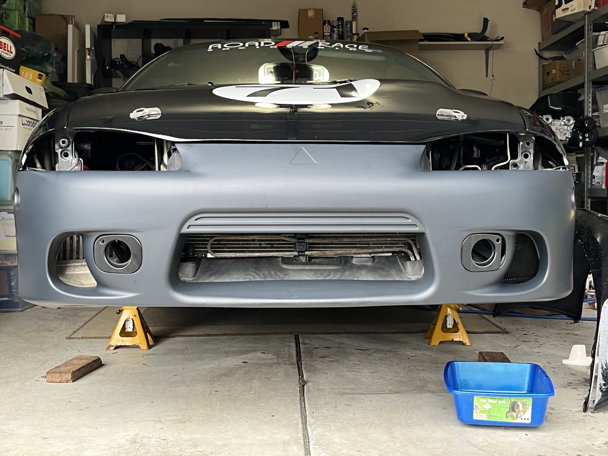

yup, you can't get them this way now.

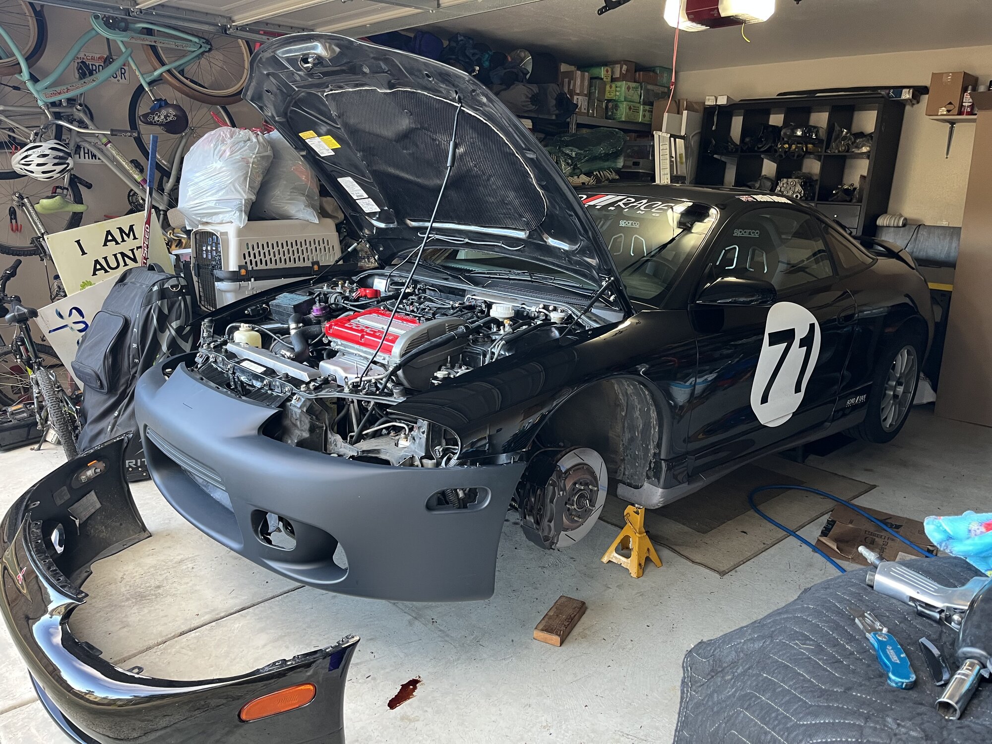

Those aftermarket bumpers really don't fit bad at all. I was impressed with mine for sure.
It's looking good.

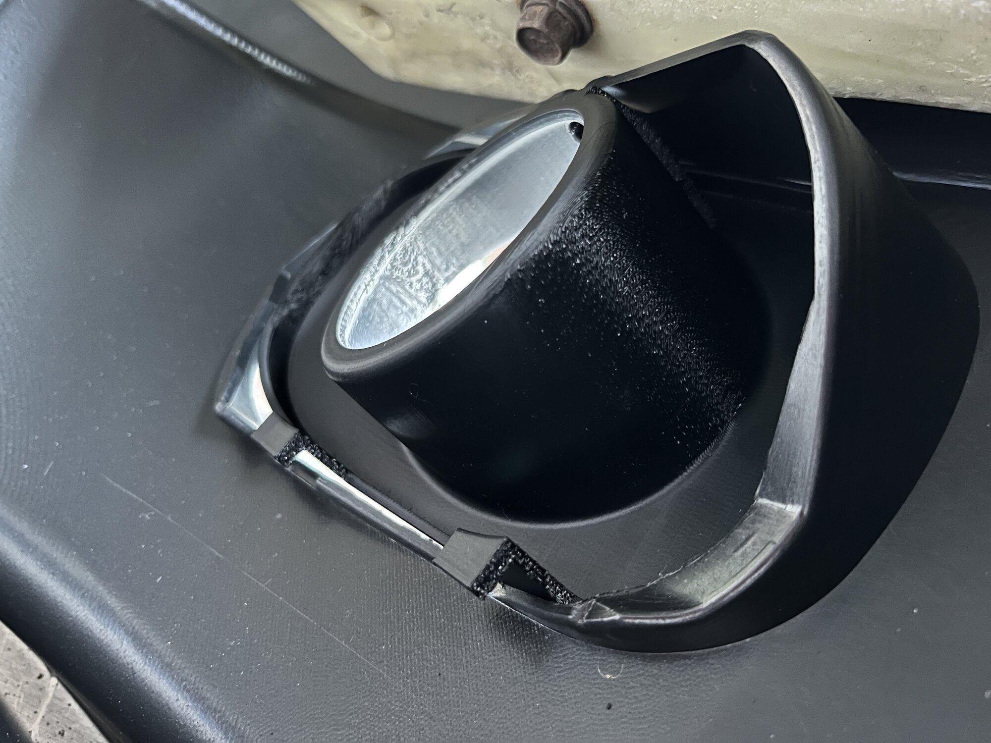

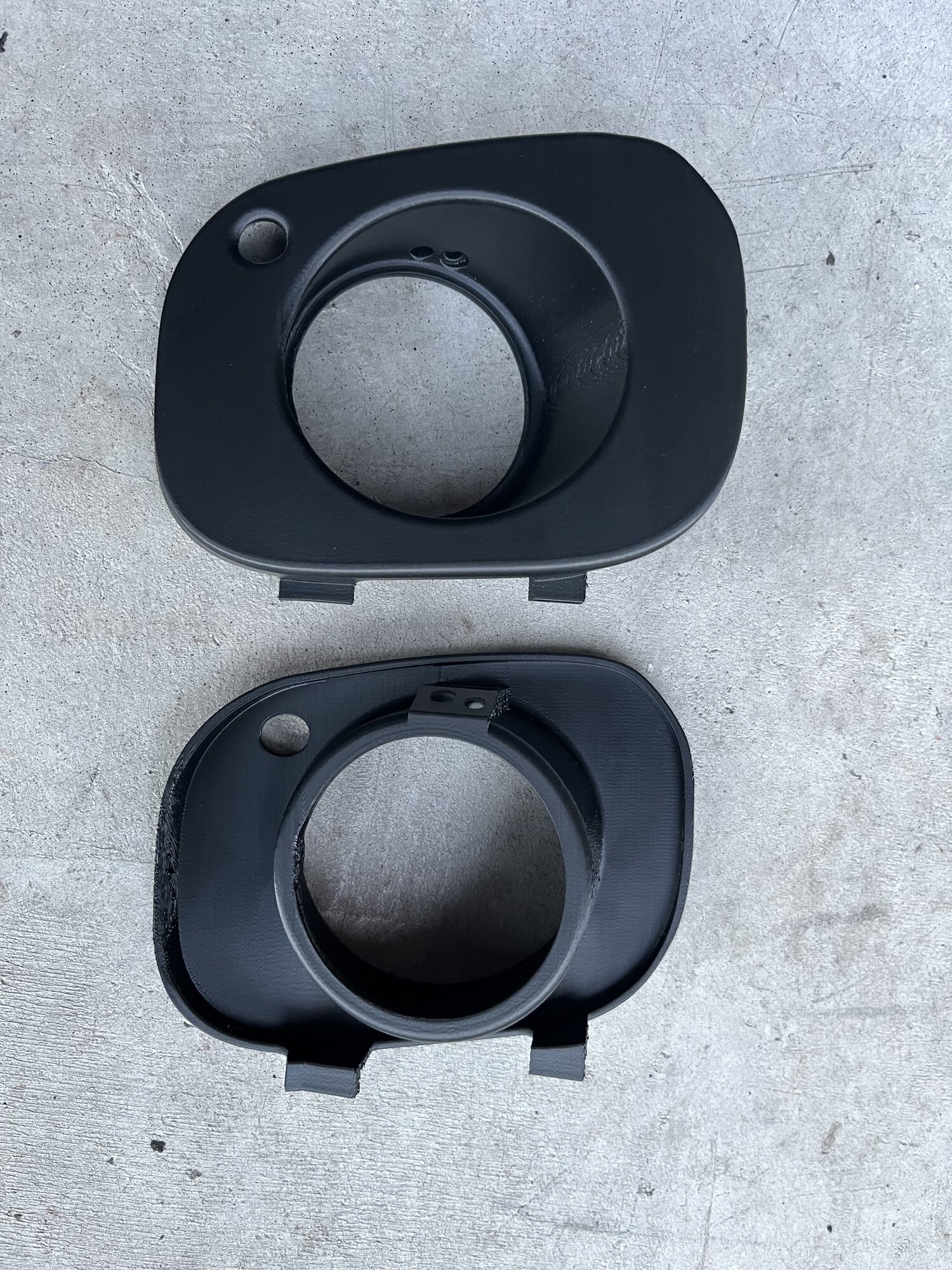

Fit is good, I don’t have to modify the bumper mounting points. The thickness I think is different, because the 3-D printed bezels for the fog lights have some issues with this bumper.
