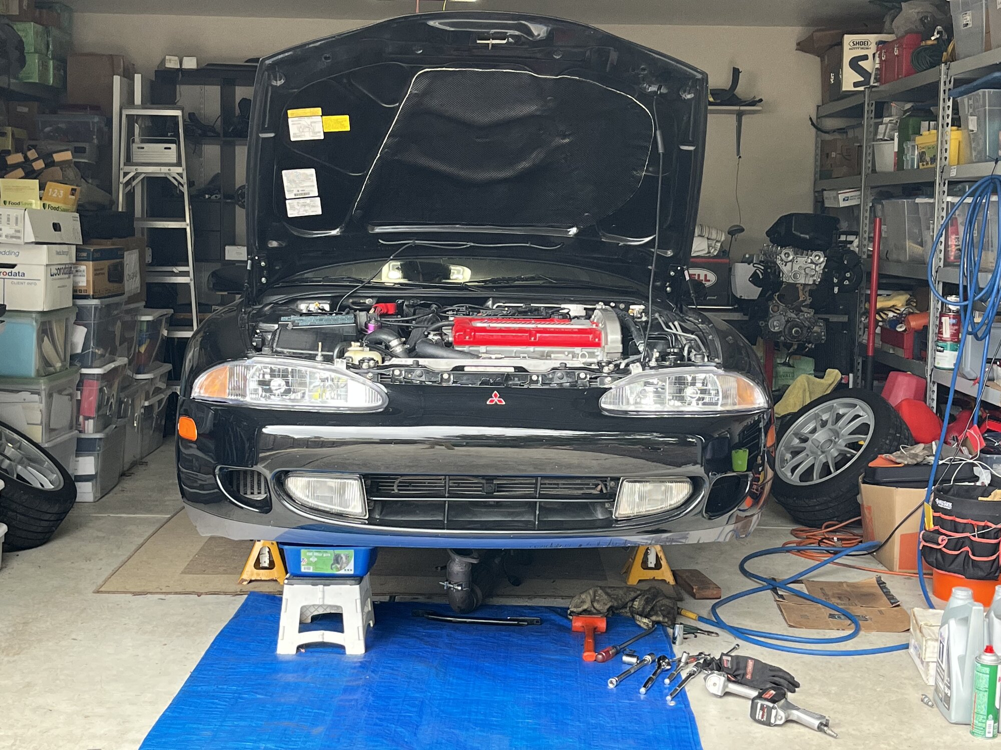

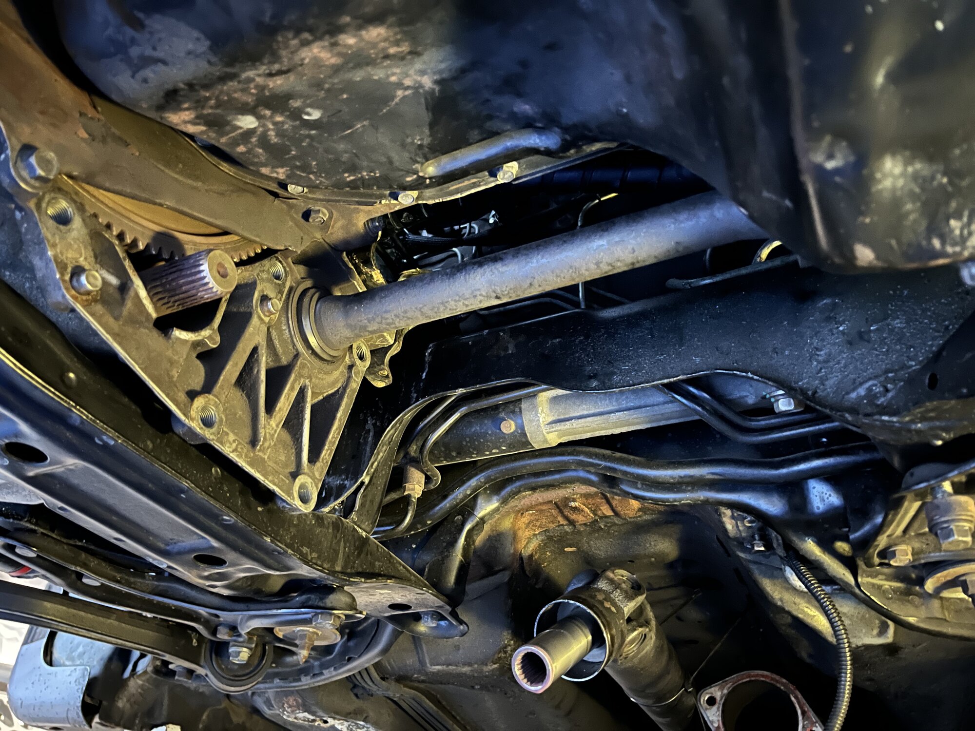

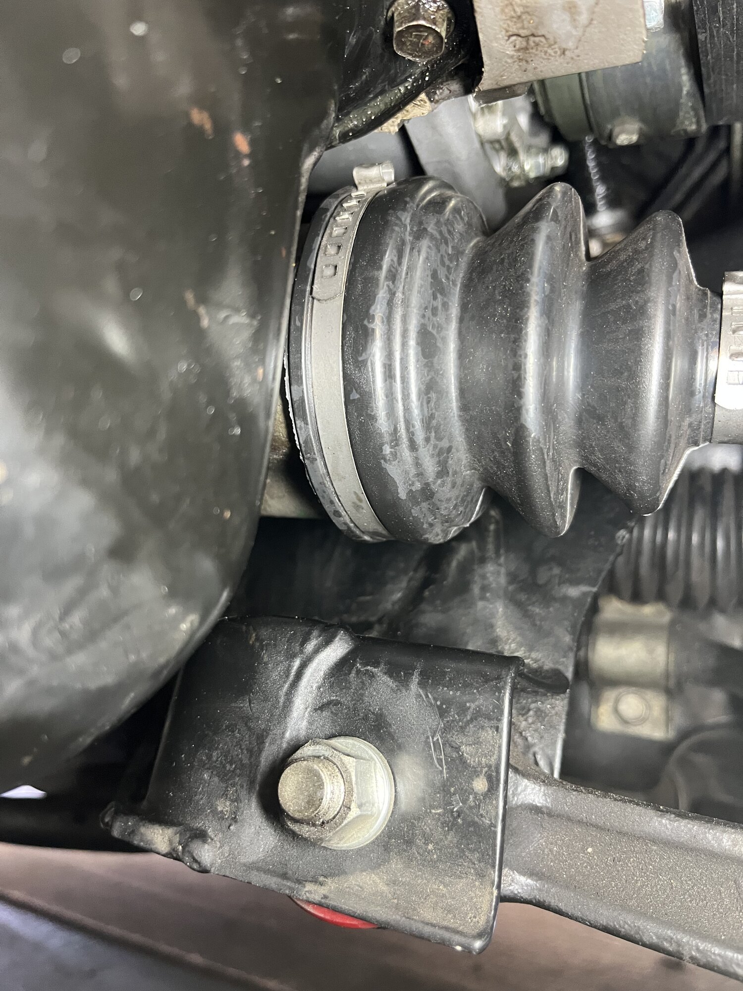

I’m smack in the middle of a drivers front axel CV reboot.

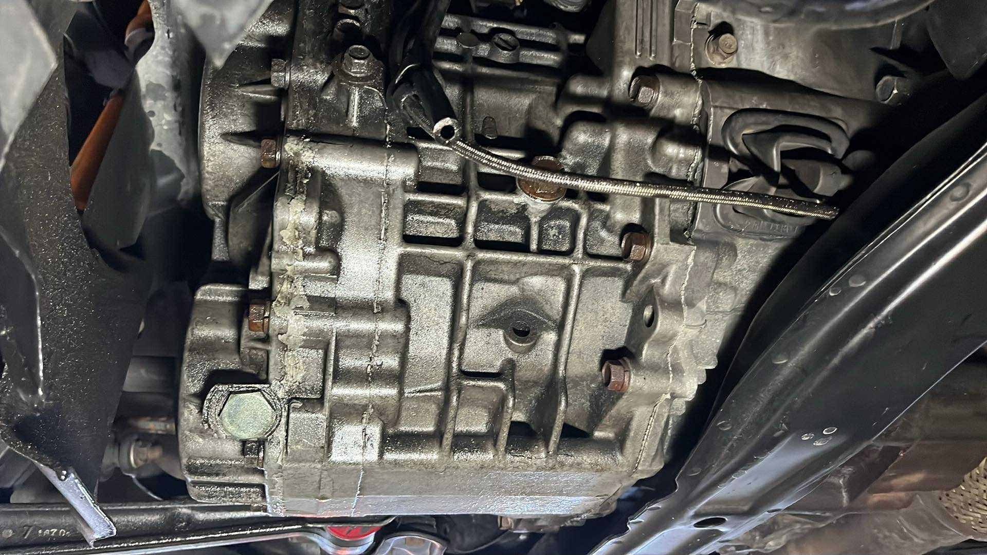

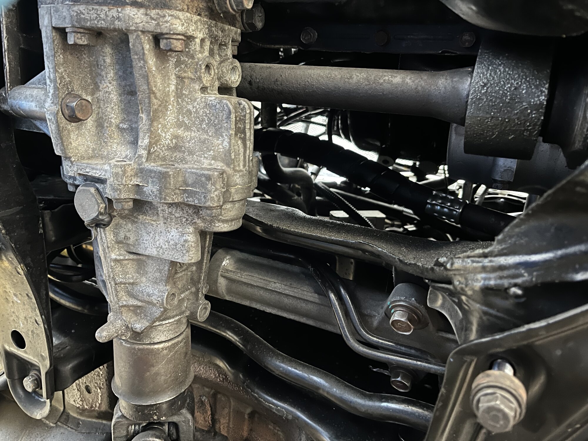

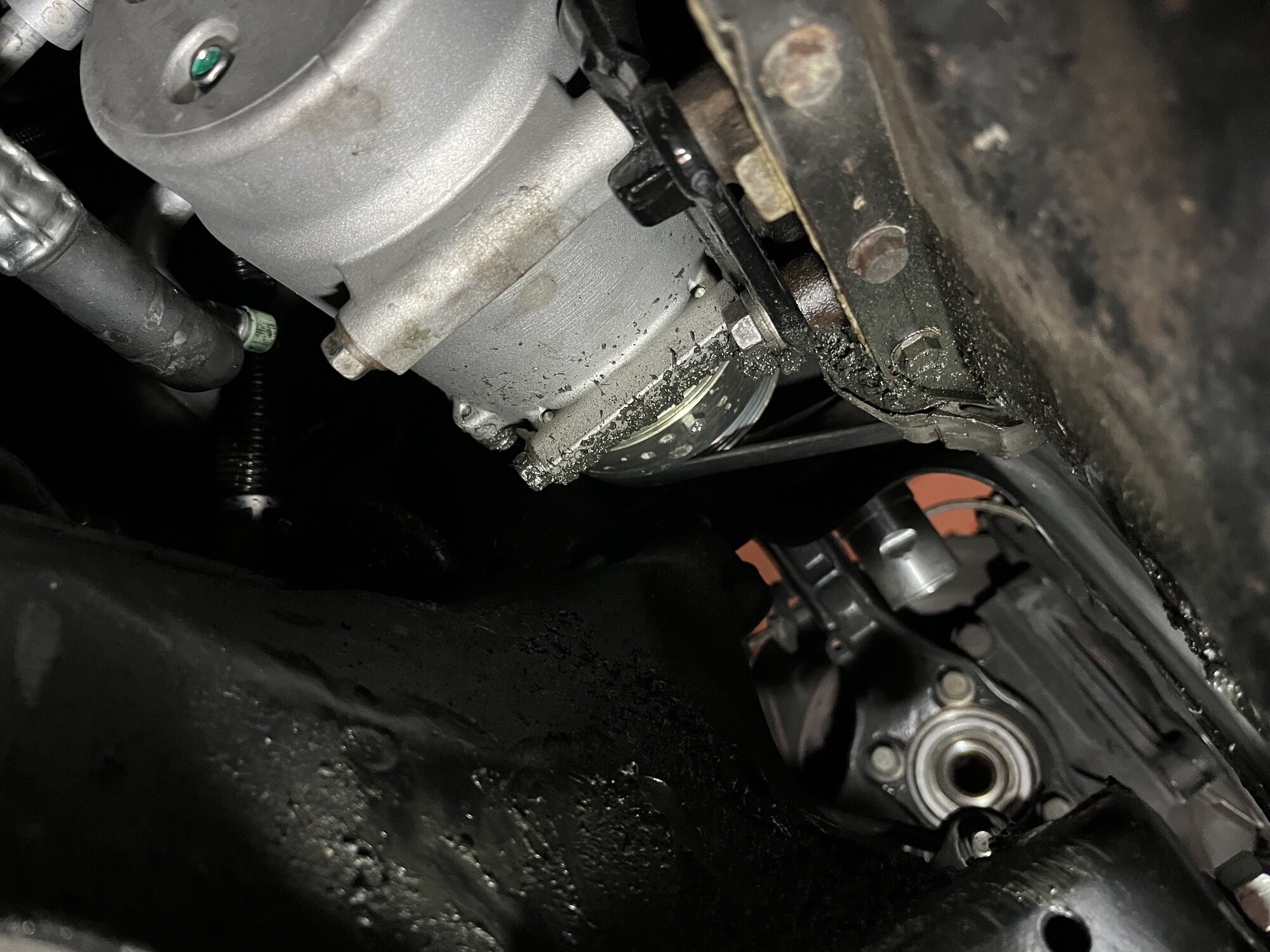

Noticed after the last track outing grease thrown out of the drivers inside cv joint. I waited to address it till now cause now I see gear oil covering gearbox?
Yah, ok maybe that time I went from 2mph - to whatever speed 7800 rpm in first is - might have made an effect - and now I start seeing this.

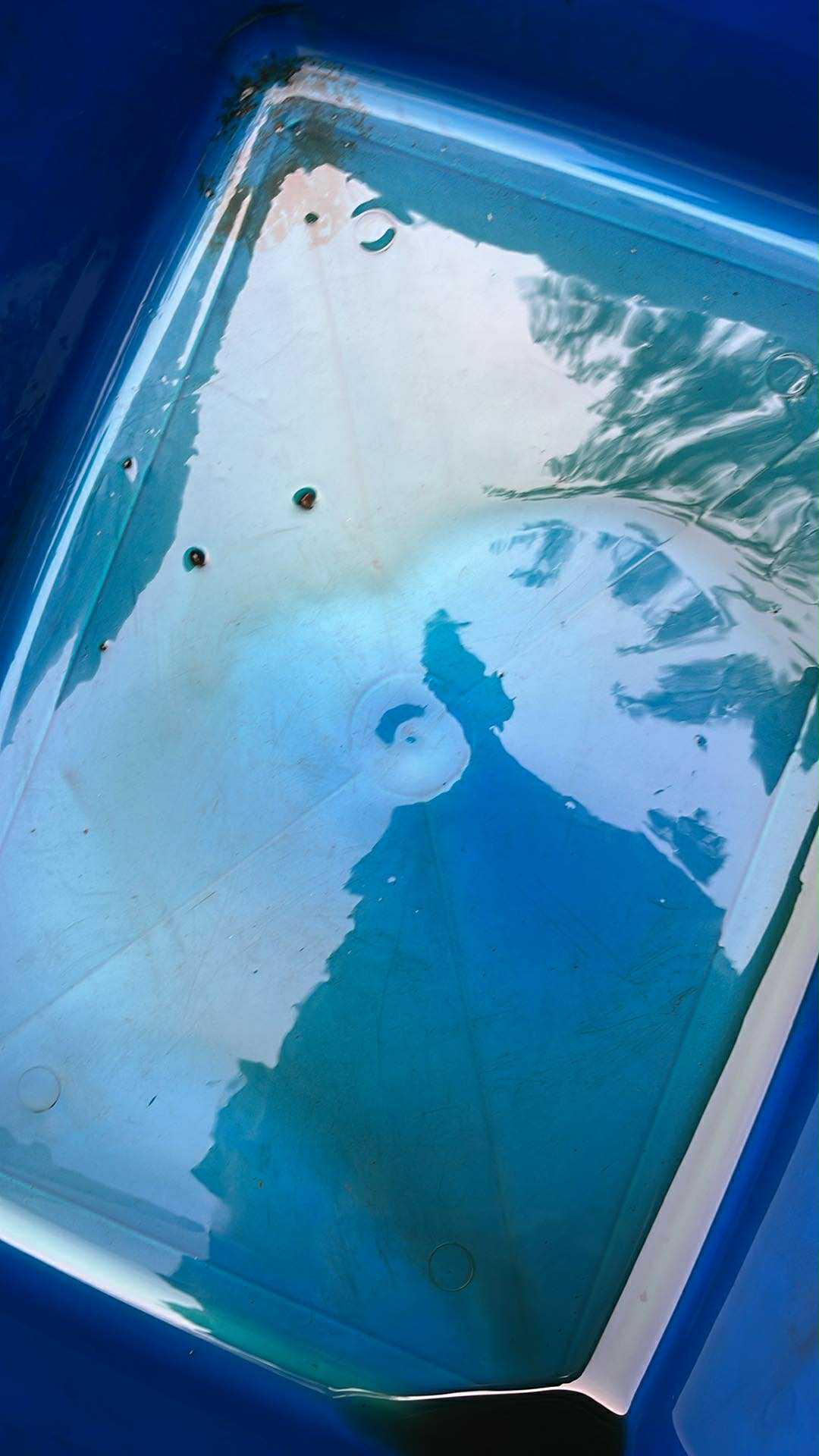

I drain it to see what it looks like:
couple chunks and some flakes in what looks like good oil otherwise. AMSoil 75w90
The film of oil may have come from over crushed washers. So now, is the time, to do the CV boot.

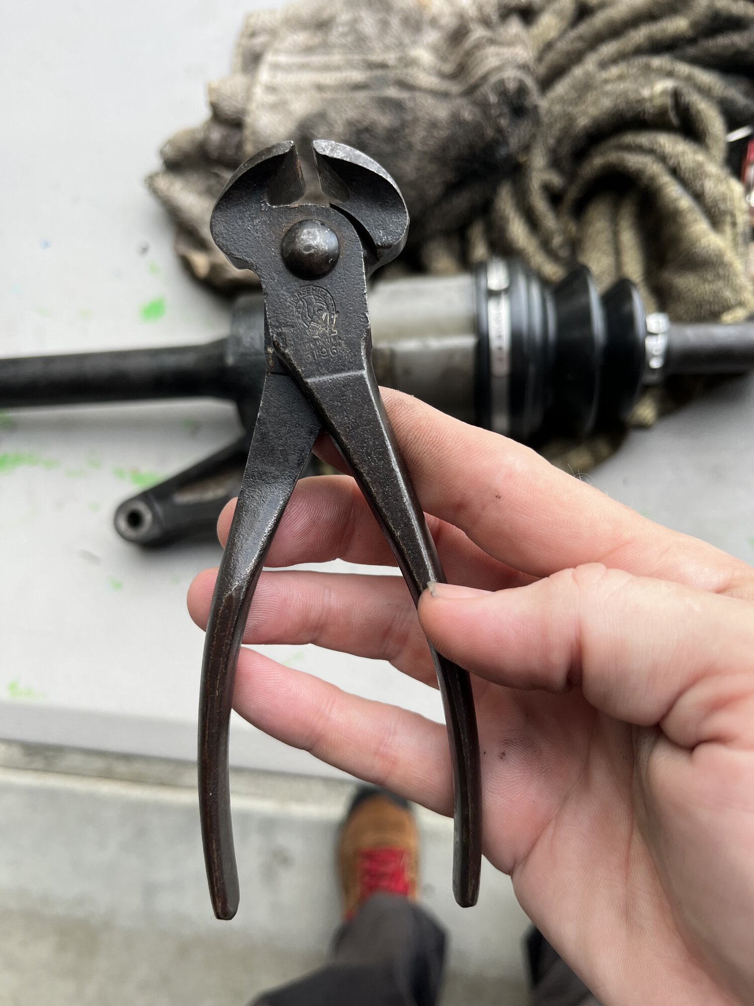

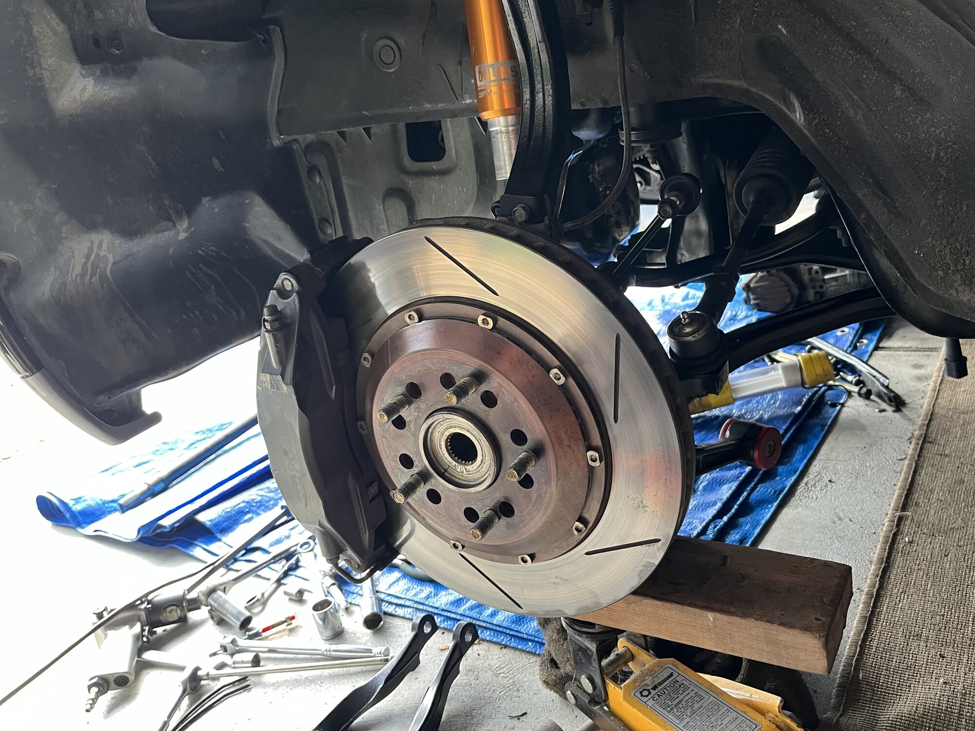

DP off, going for the half shaft.

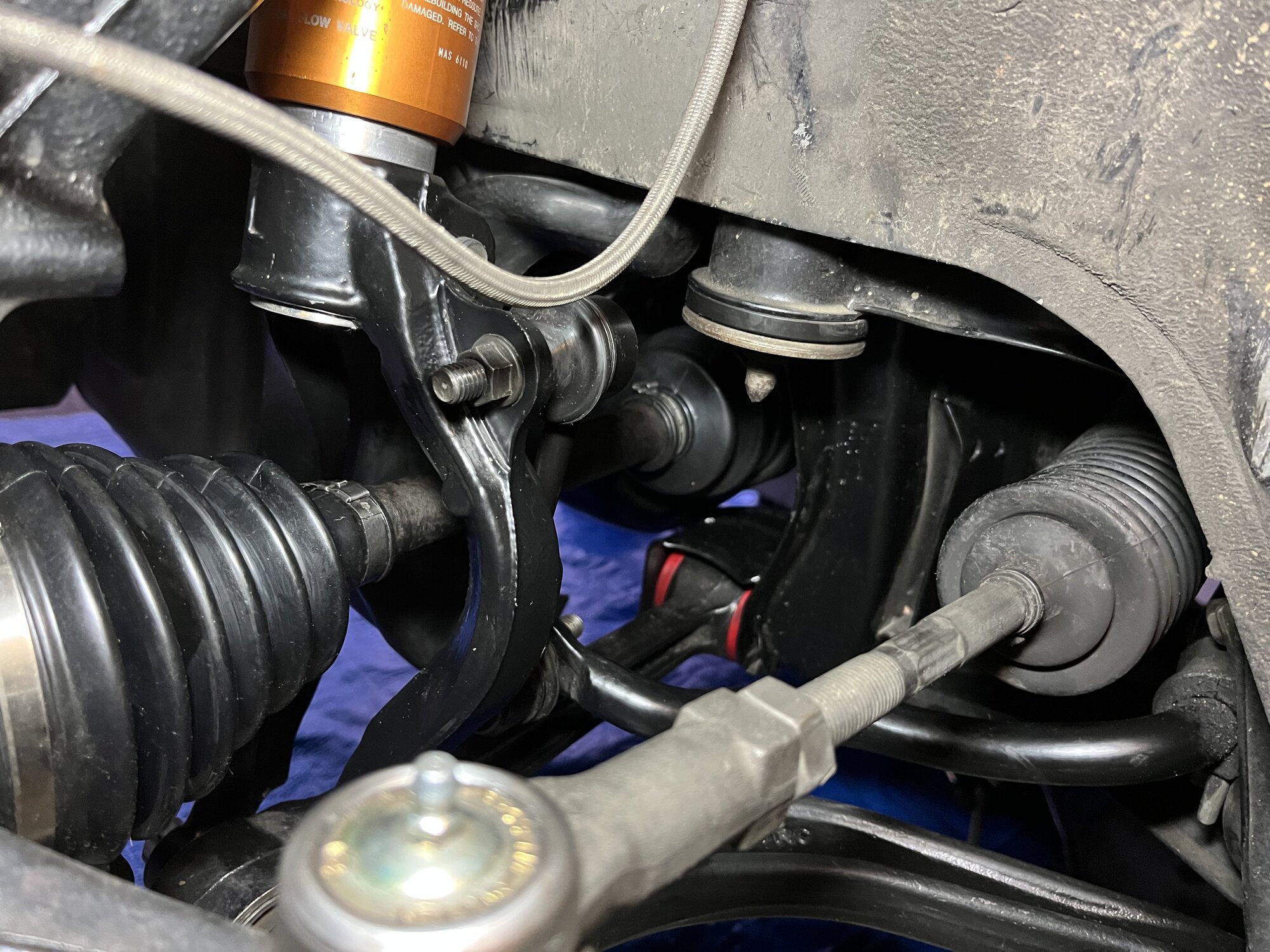

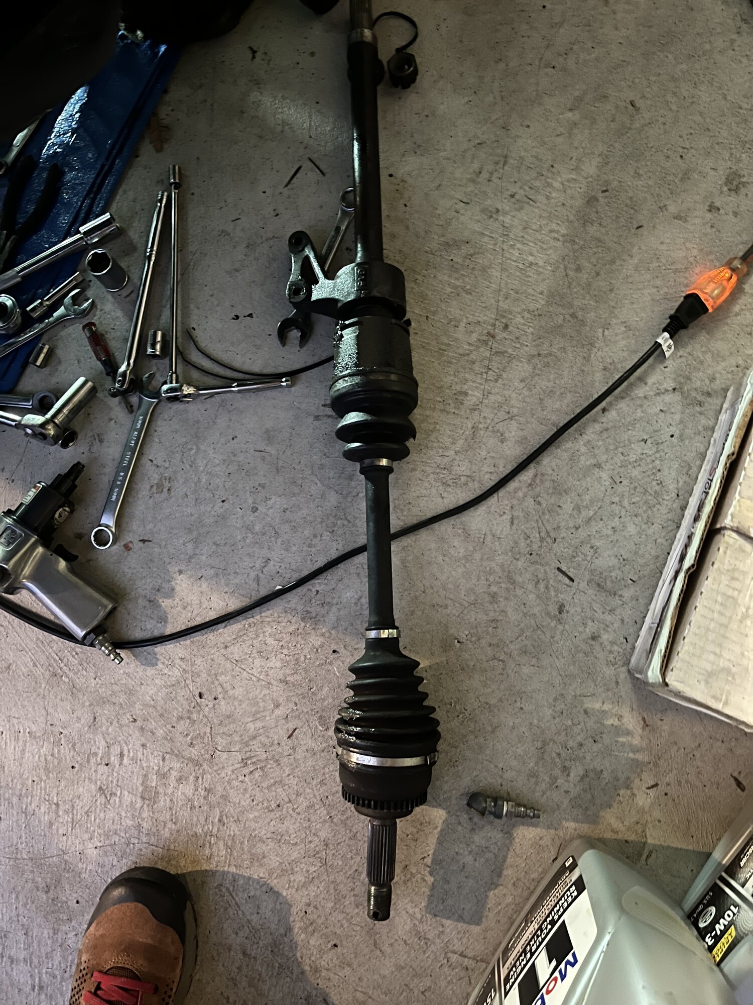

I can make some room to pull the axel out of the transmission by unbolting the lower control arm from the chassis, and by turning the wheel full right to extend the steering control arm. To get the axel down and out, I removed the shock fork, supporting the hub assembly on a small floor jack. Removed the axel nut, and then dropped the transfer case.
Zip tied the drive shaft to the heat shield, and set to work on unbolting the 1/2 shaft.
After pushing the hub assembly far enough away to muscle the axel out if the front diff, I deflected the shaft toward the closest open space so the axel can be pulled out of the hub, and down onto the floor.
yuck

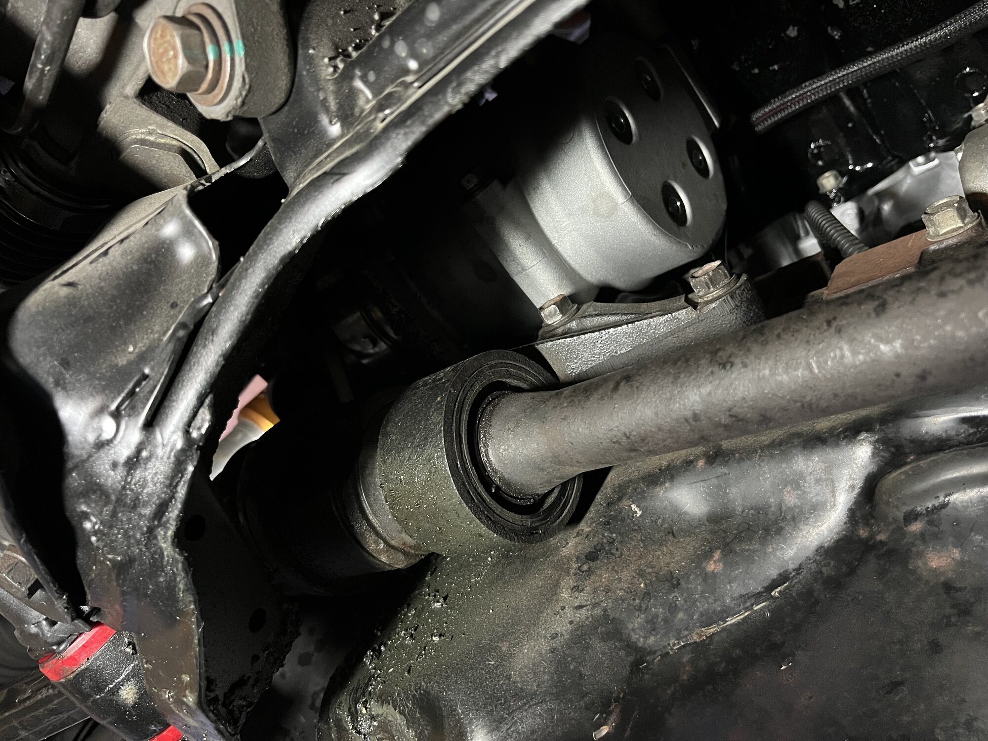

Round the block was good - I need to tweak the exhaust system. I pushed it up against the drive line when I tightened flange from the cat to the down pipe, and now it is too close and I can hear it bumping into the drive shaft carrier bearing mounts. - fixed that - ready for MOD 2025

And after 800mi the inner CV reboot refresh is holding!
