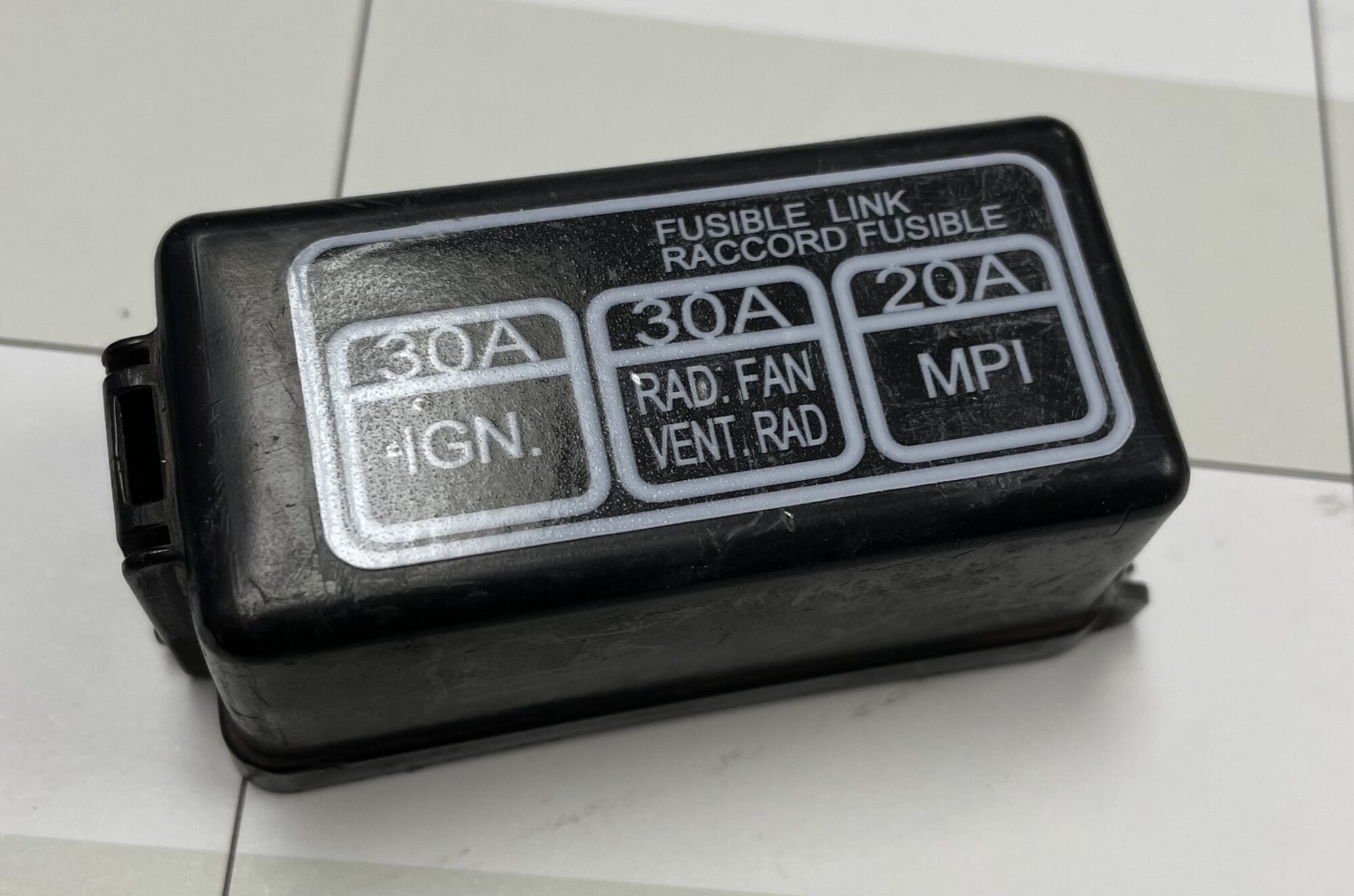

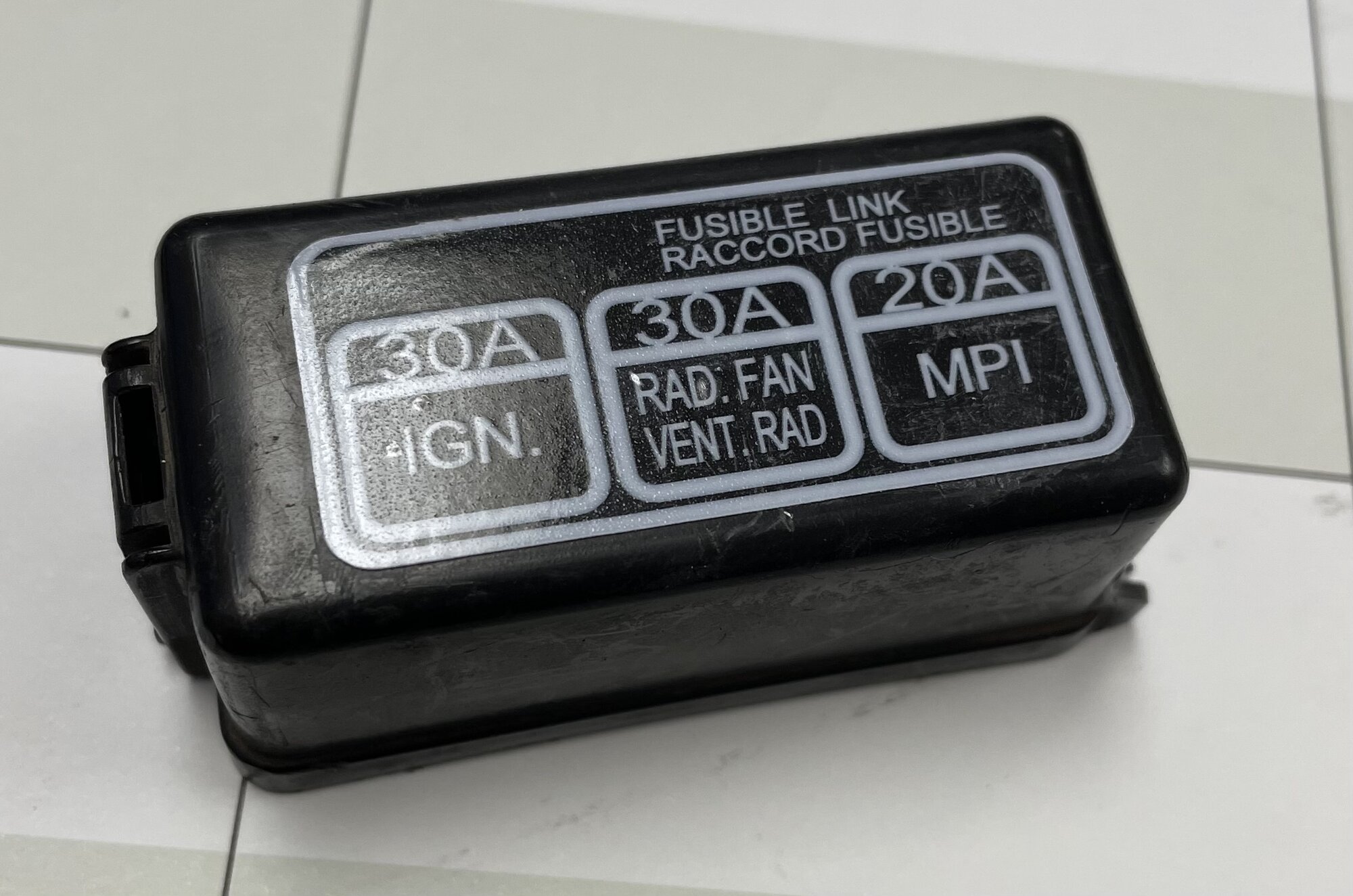

Appreciate the tip! It was a bit of a process but think I finally got there!

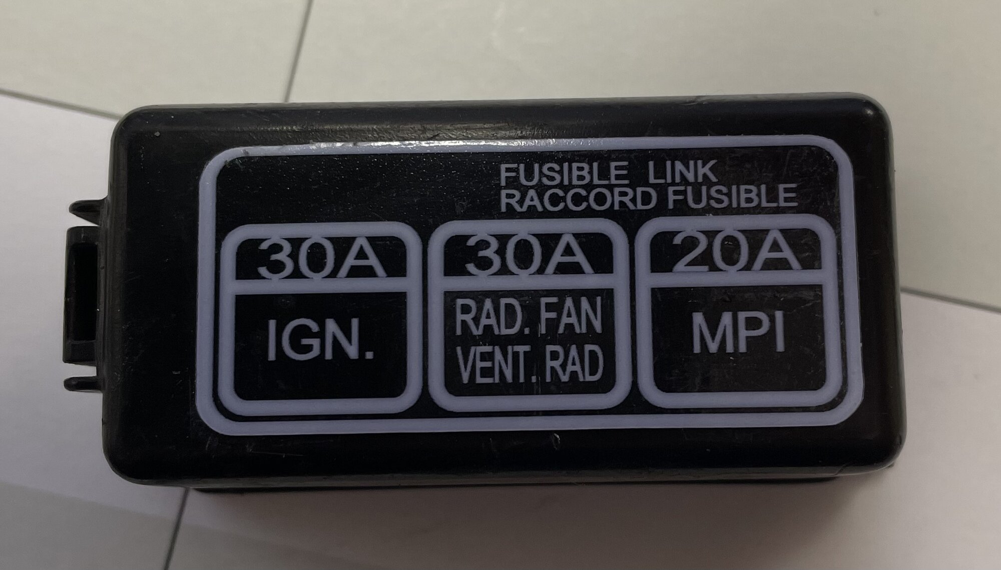

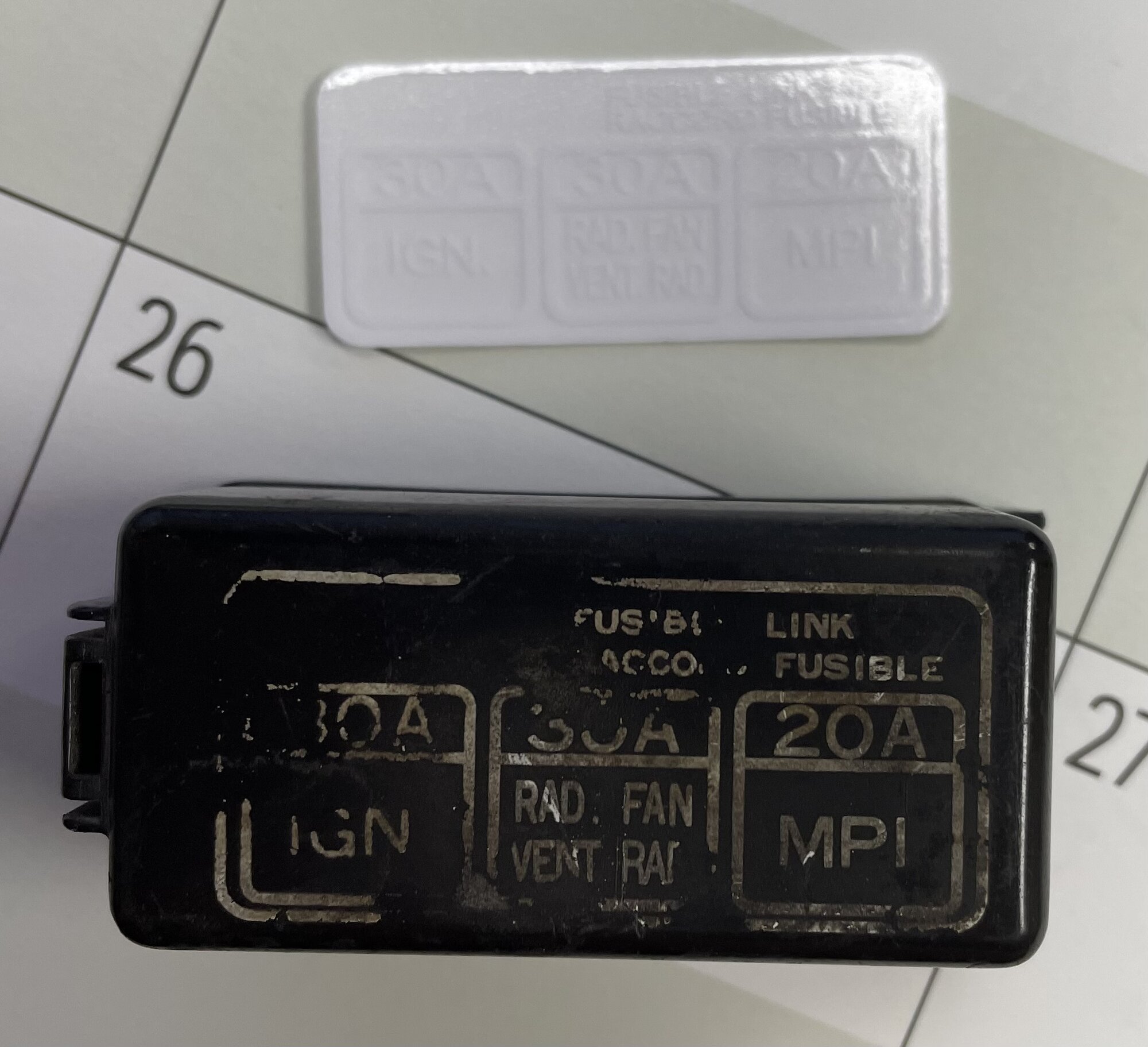

This was an .svg, a Vector format. I looked back at Justin’s post for the under hood stickers and saw he posted .psd files. I can’t seem to post those from my phone, either.
@Justin DuBois - mine was a CAD file saved / exported as a .psd. This is a stock option so I’m pretty confident it “converts” it properly.
@Ludachris - that seemed to work for the .svg! Here it is. Not perfect, but I’ve spent enough money on it to be okay with it not being 100%.
That opened for me - unzipped, and opened in Illustrator

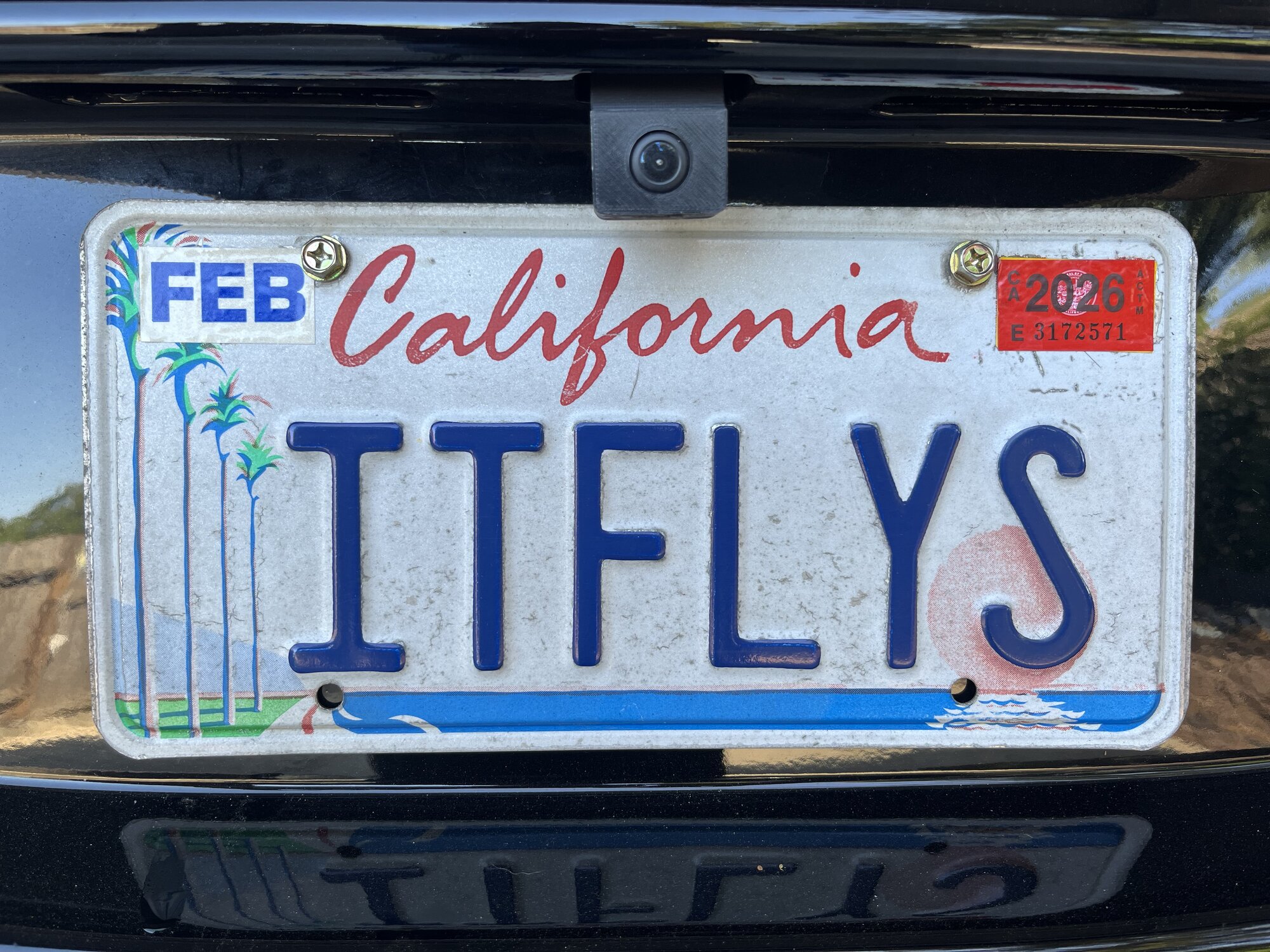

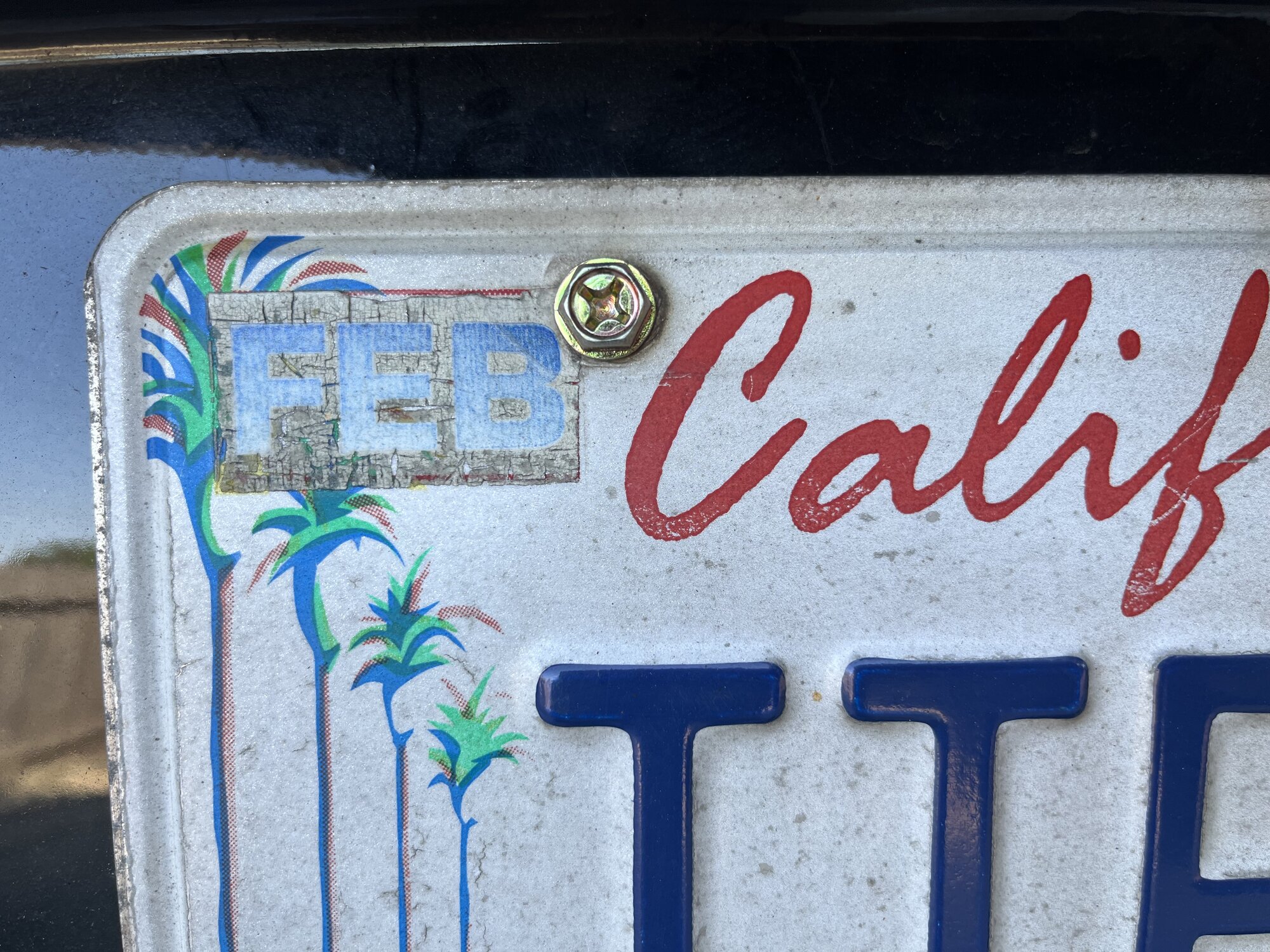

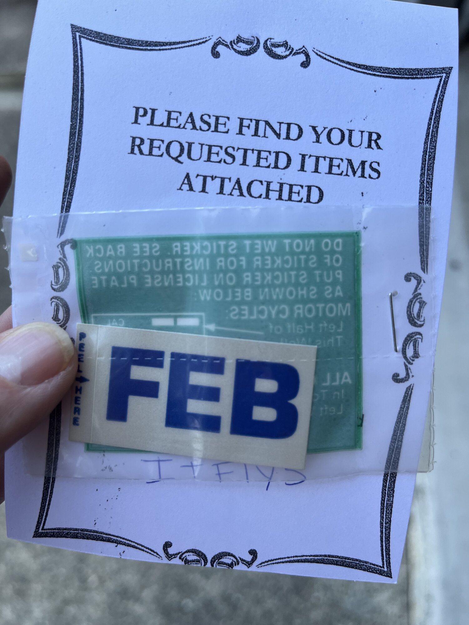

Getting a new month sticker was complex.
You can’t fill out a form online, you can’t use their automated system, you have to speak with somebody, and they have to understand it’s not the registration sticker, but the month sticker.
Free for the asking. I guess it’s unusual for someone to hold onto a license plate long enough to need a new sticker.

We’ll, it is California after all. 😆

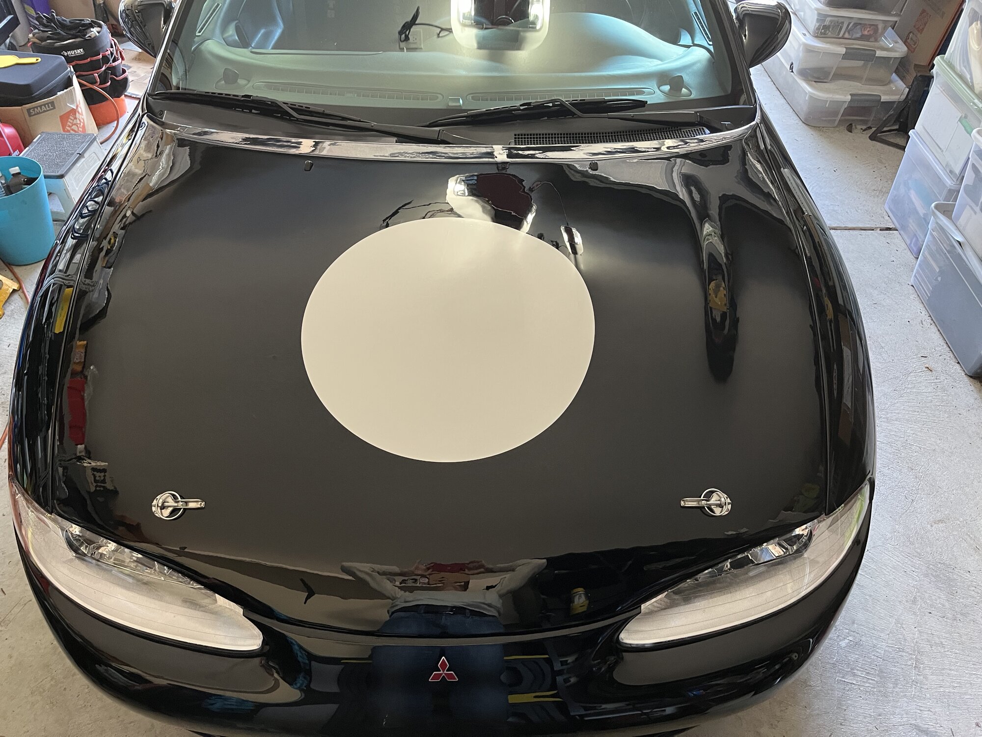

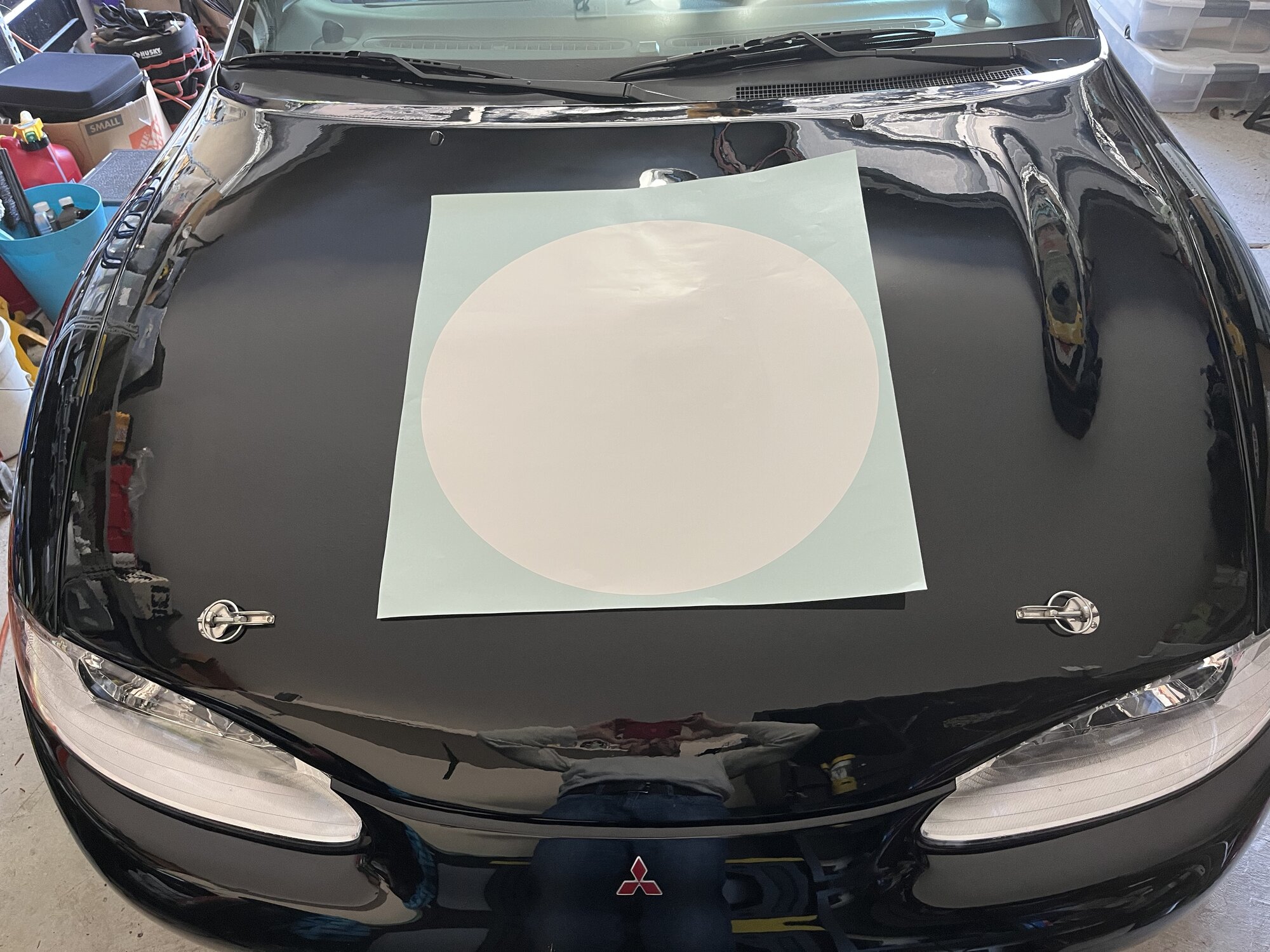

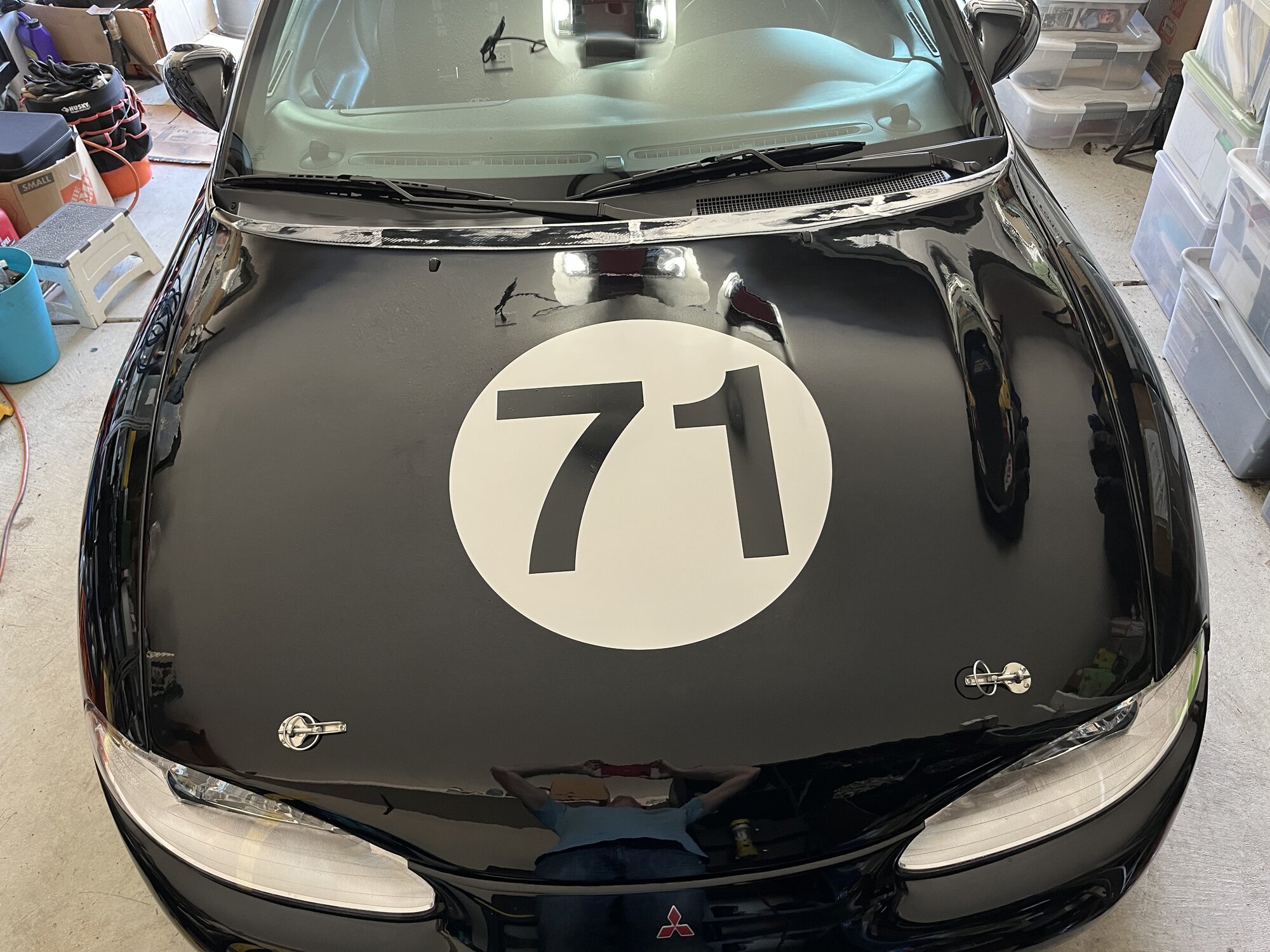

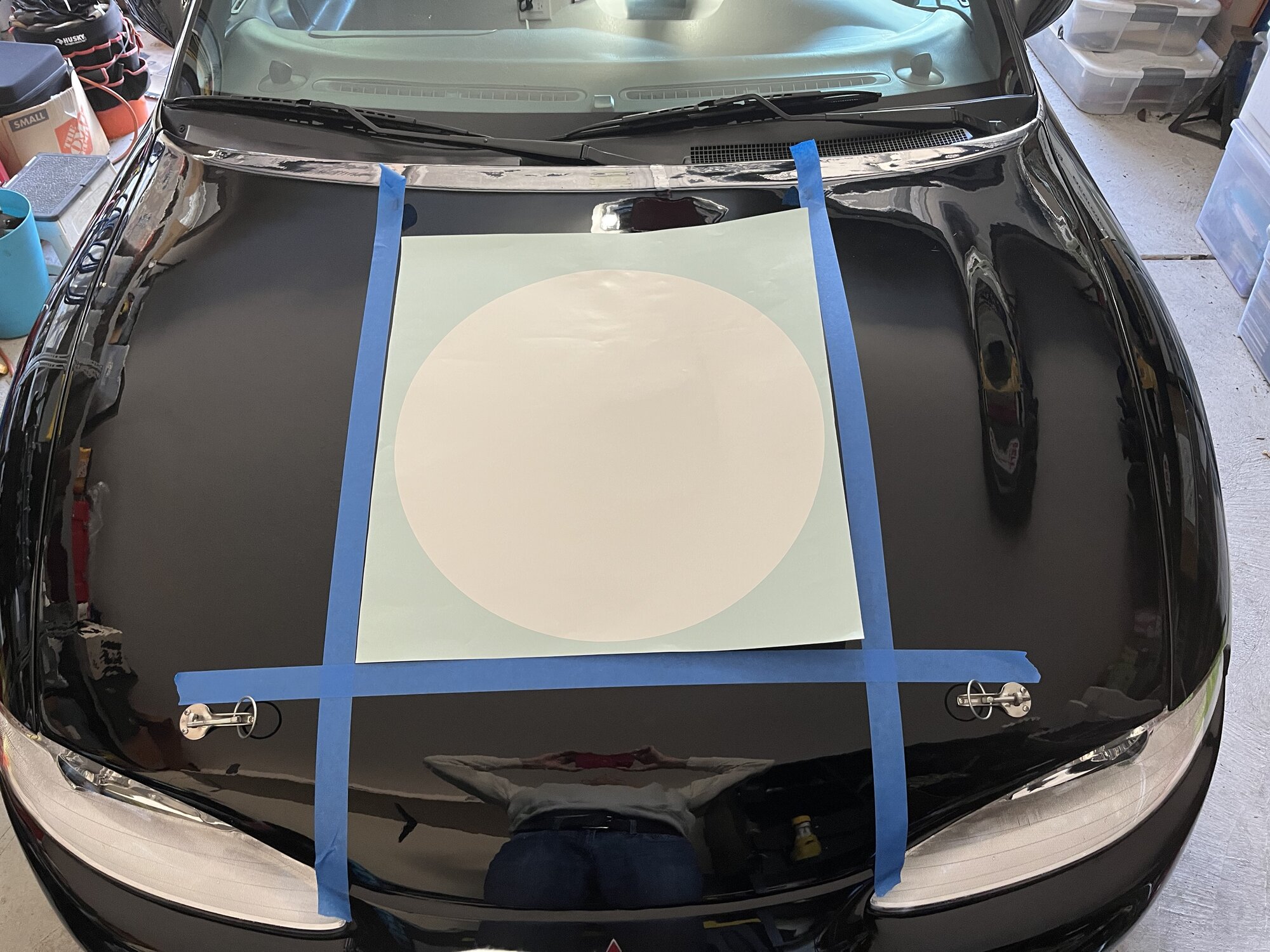

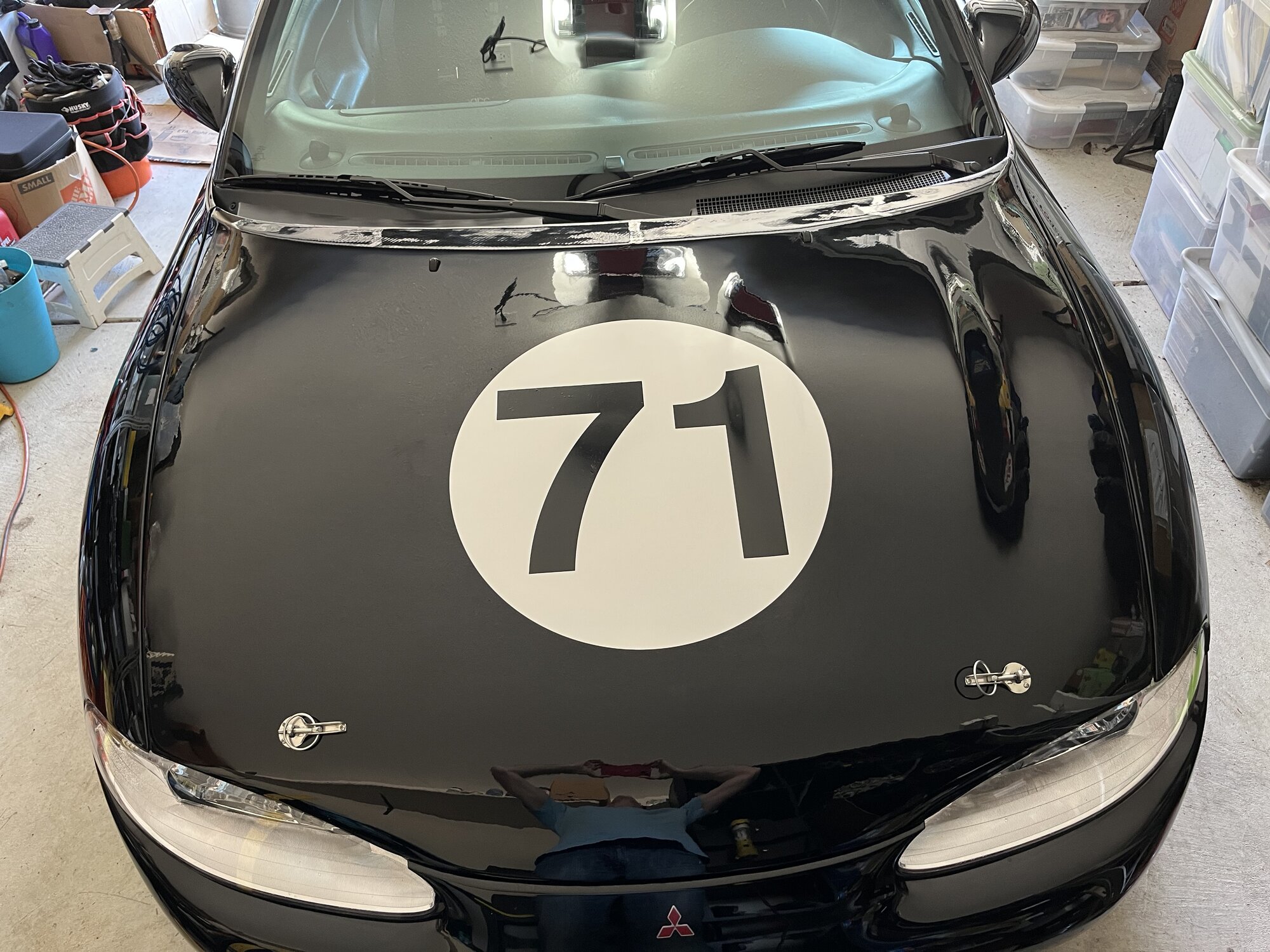

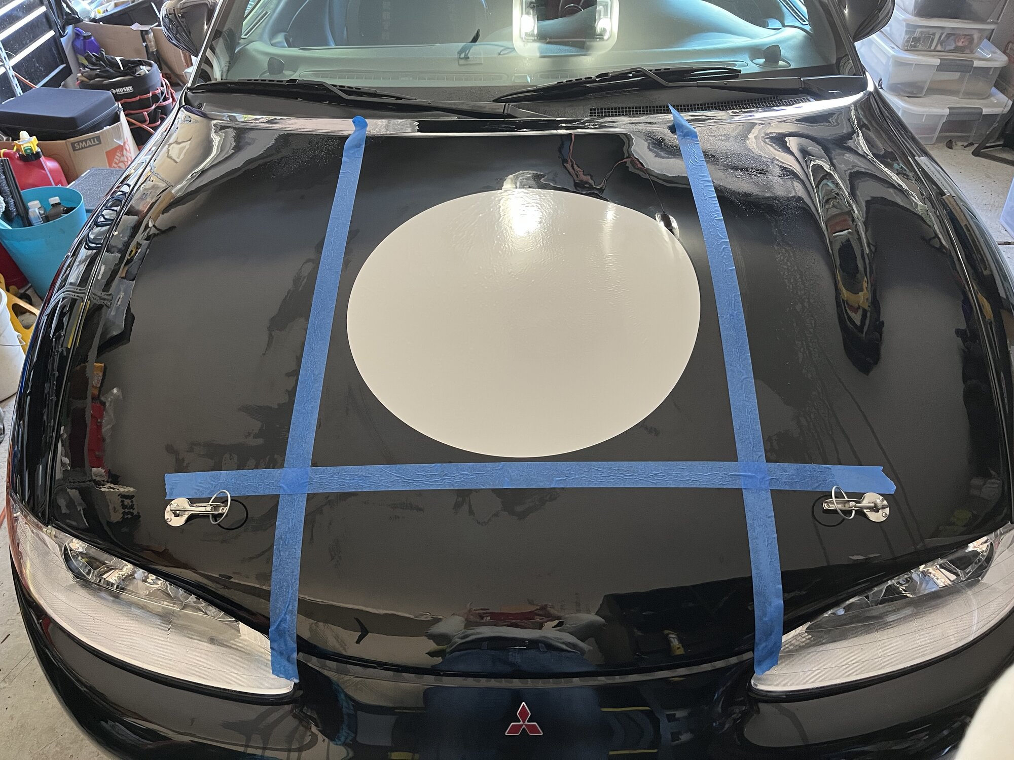

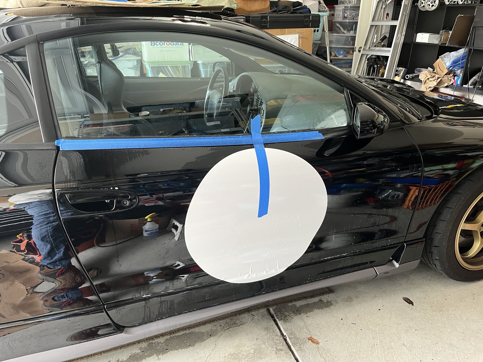

These went on MUCH better than the first attempt.
Worried the bump would cause issues
but it laid down without drama. The secret is to wet both the car and the exposed adhesive side with a mist of water with a touch of dawn soap added. You literally float the entire item on the surface, and then smooth out the film center out with a lint free detail towel wrapped around a plastic spackling blade.

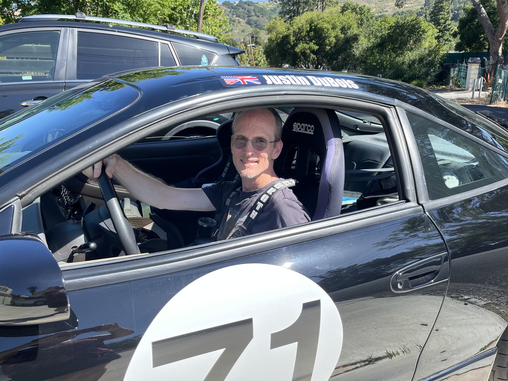

Numbers on
Time to hit the road

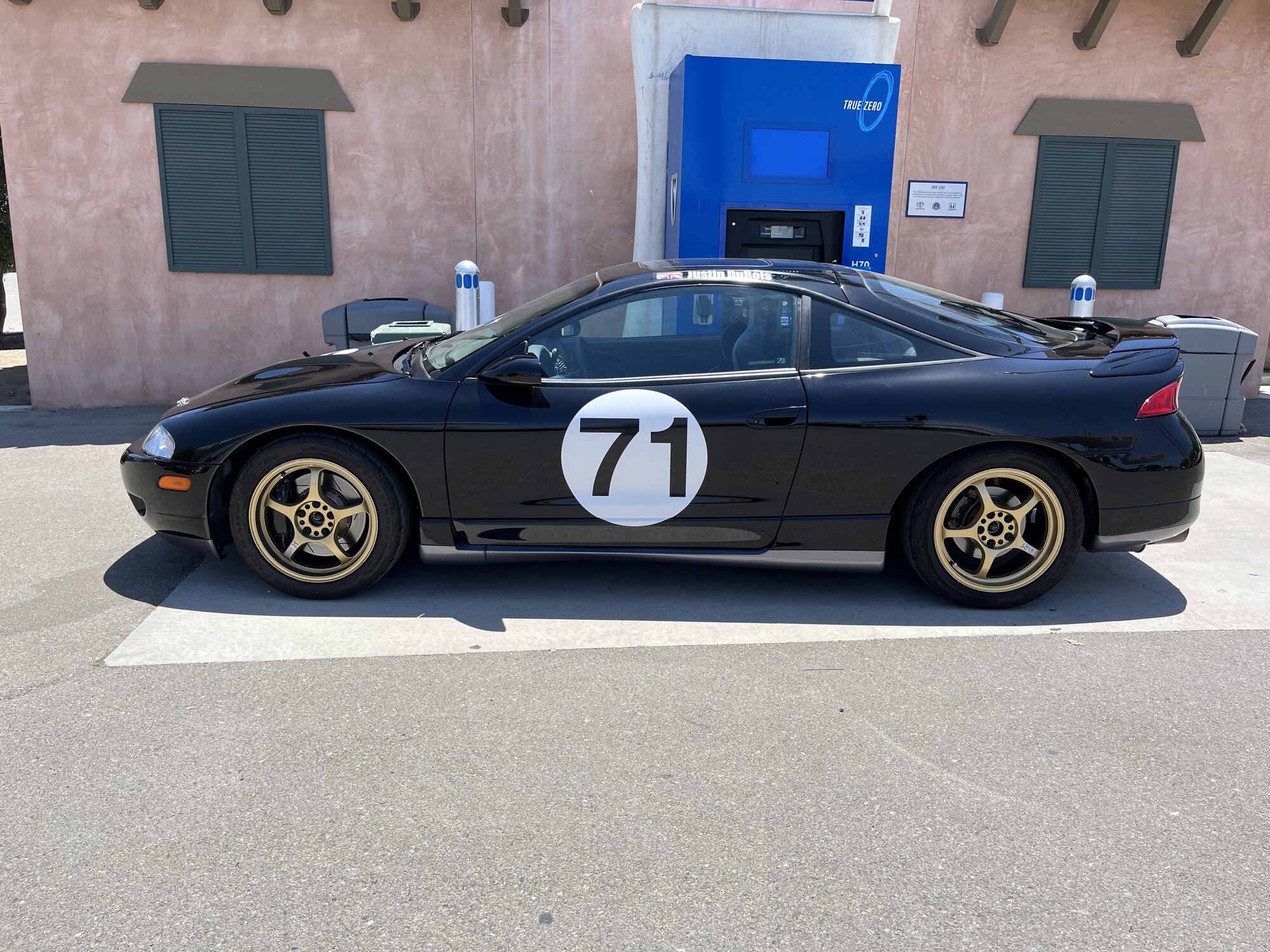

Searching for E85 - H70 not gonna work!

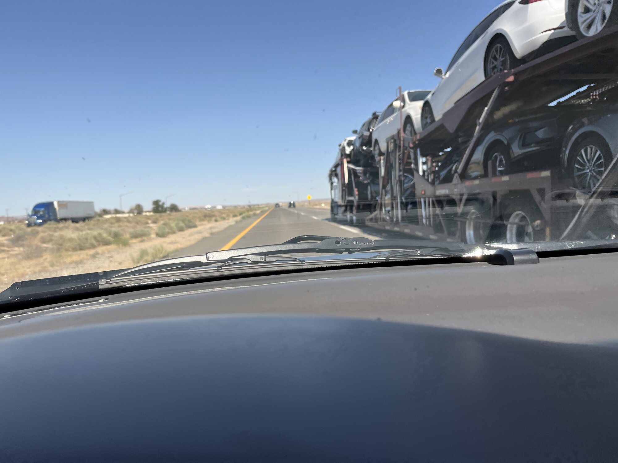

Back on the road. - Its Hot!
Here’s the E85

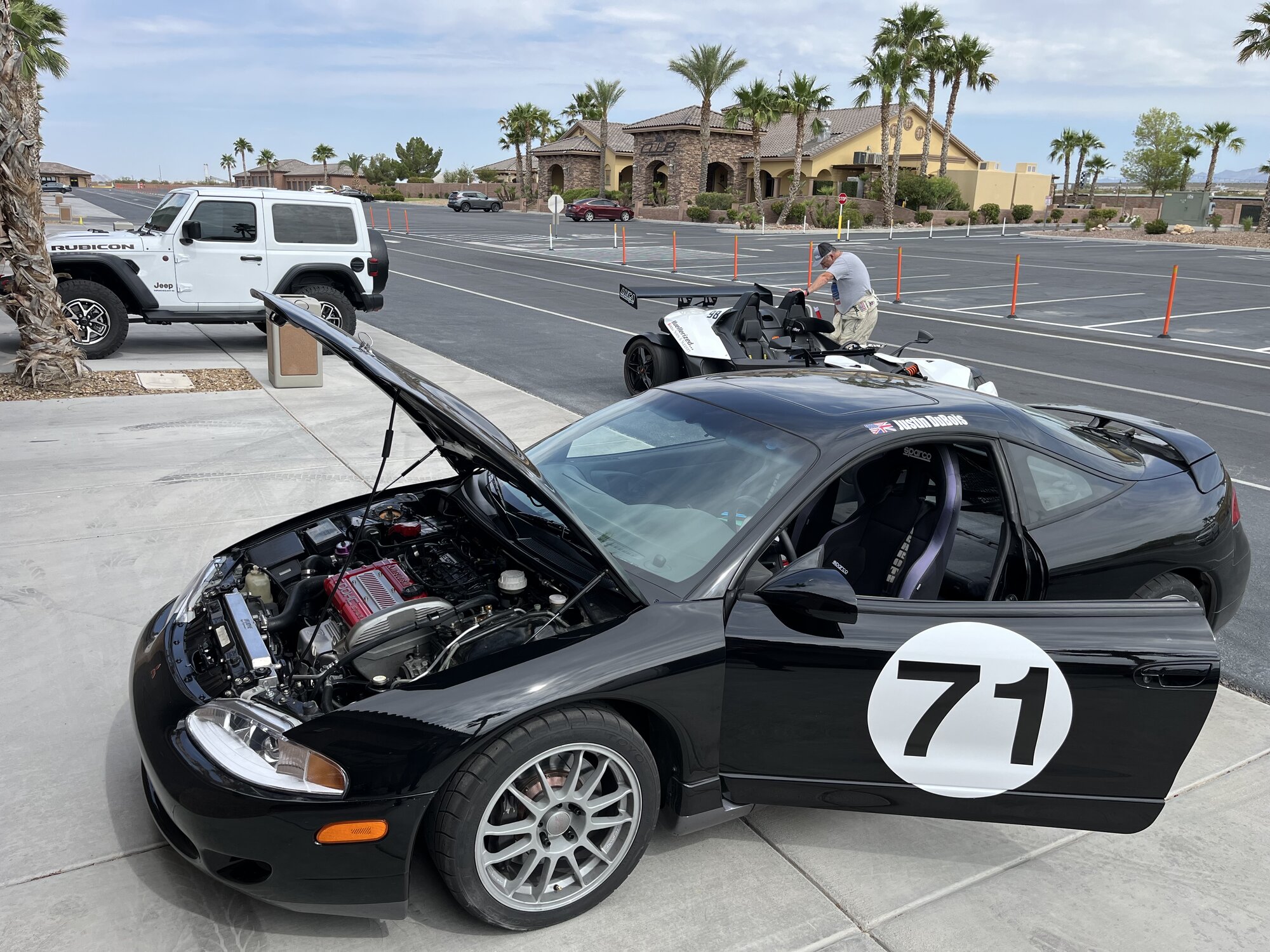

Made it!
We scoped out the situation - John grabbed some laps in the evo.

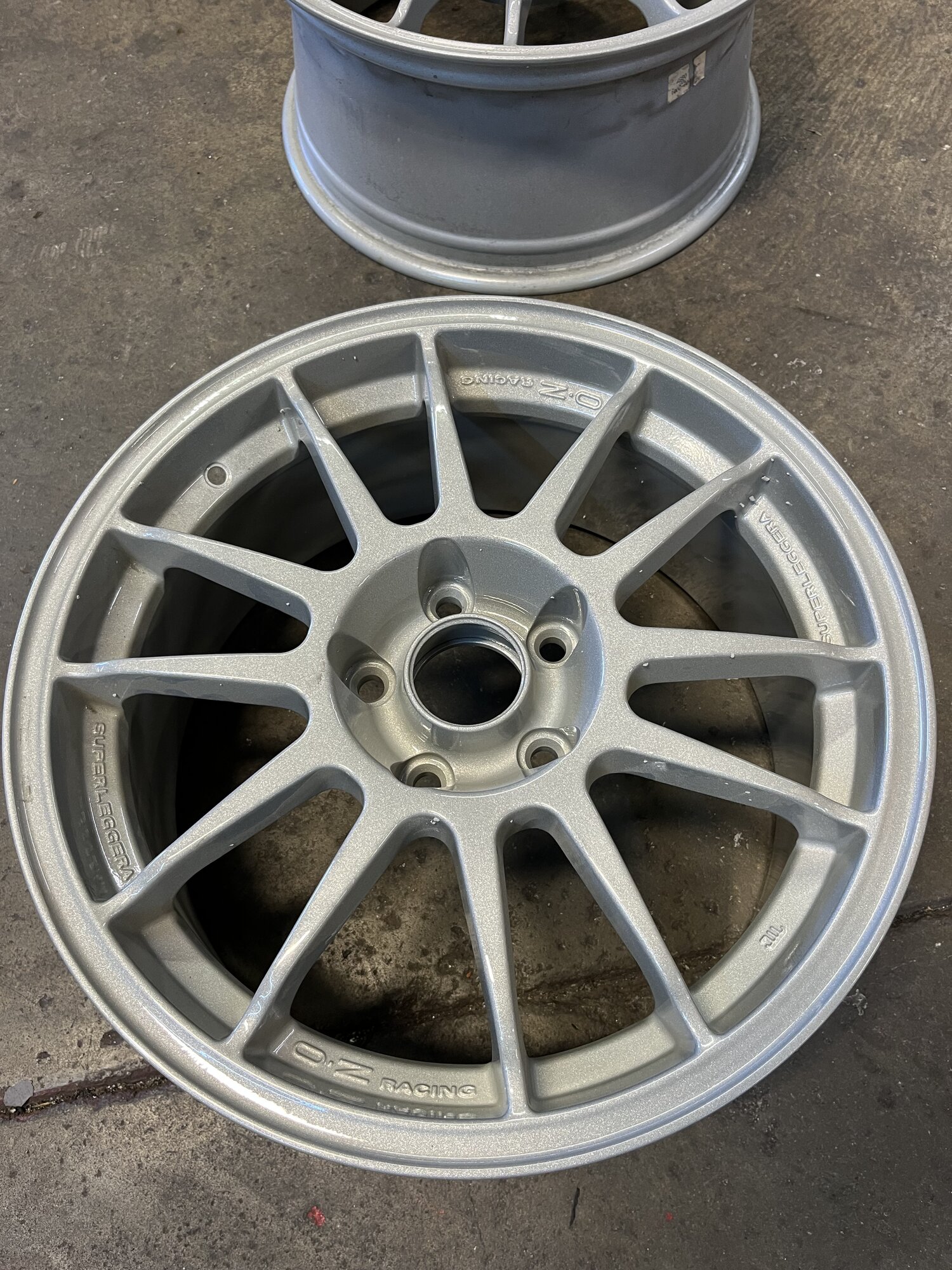

Tires are being mounted on wheels

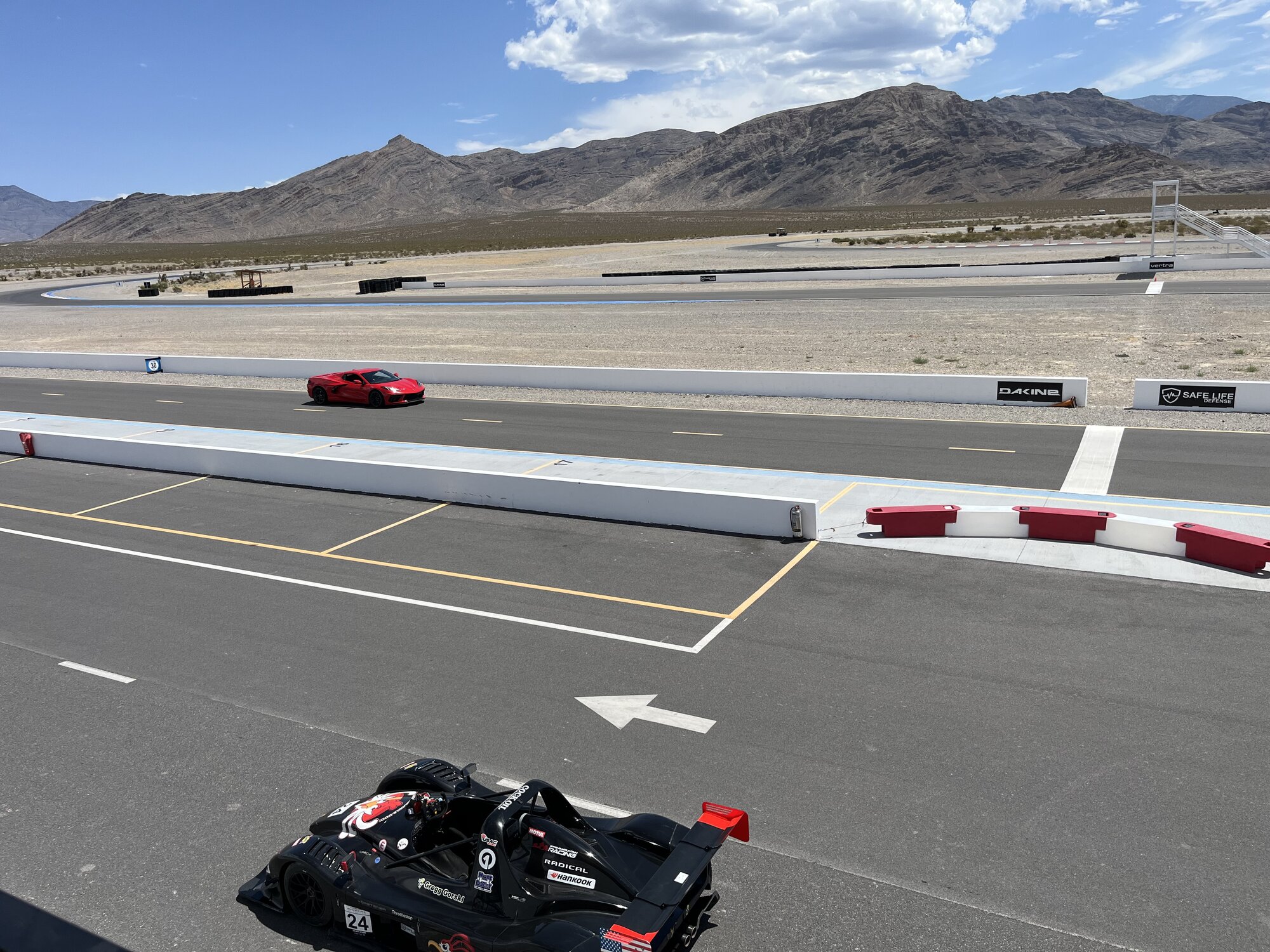

Made it!
