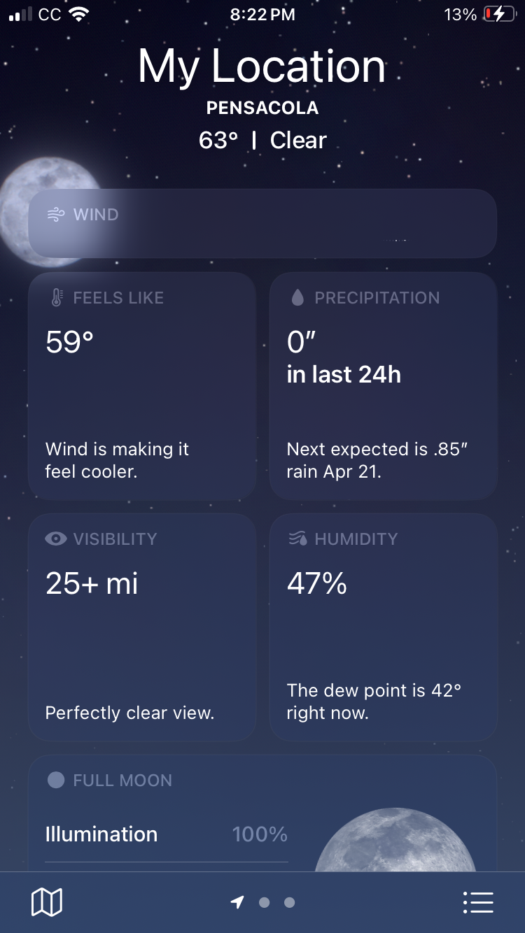

How cold is cold? Mine doesn't crank that long on full E85 but I'm in Florida. Not sure if that effects it or not.
Can it get cold enough that it'll never start until its warmer or will it always eventually start, but just way more cranking?
NorCal, Isn’t that cold - 60’s, but yeah - 40’s track side in the morning is more challenging.

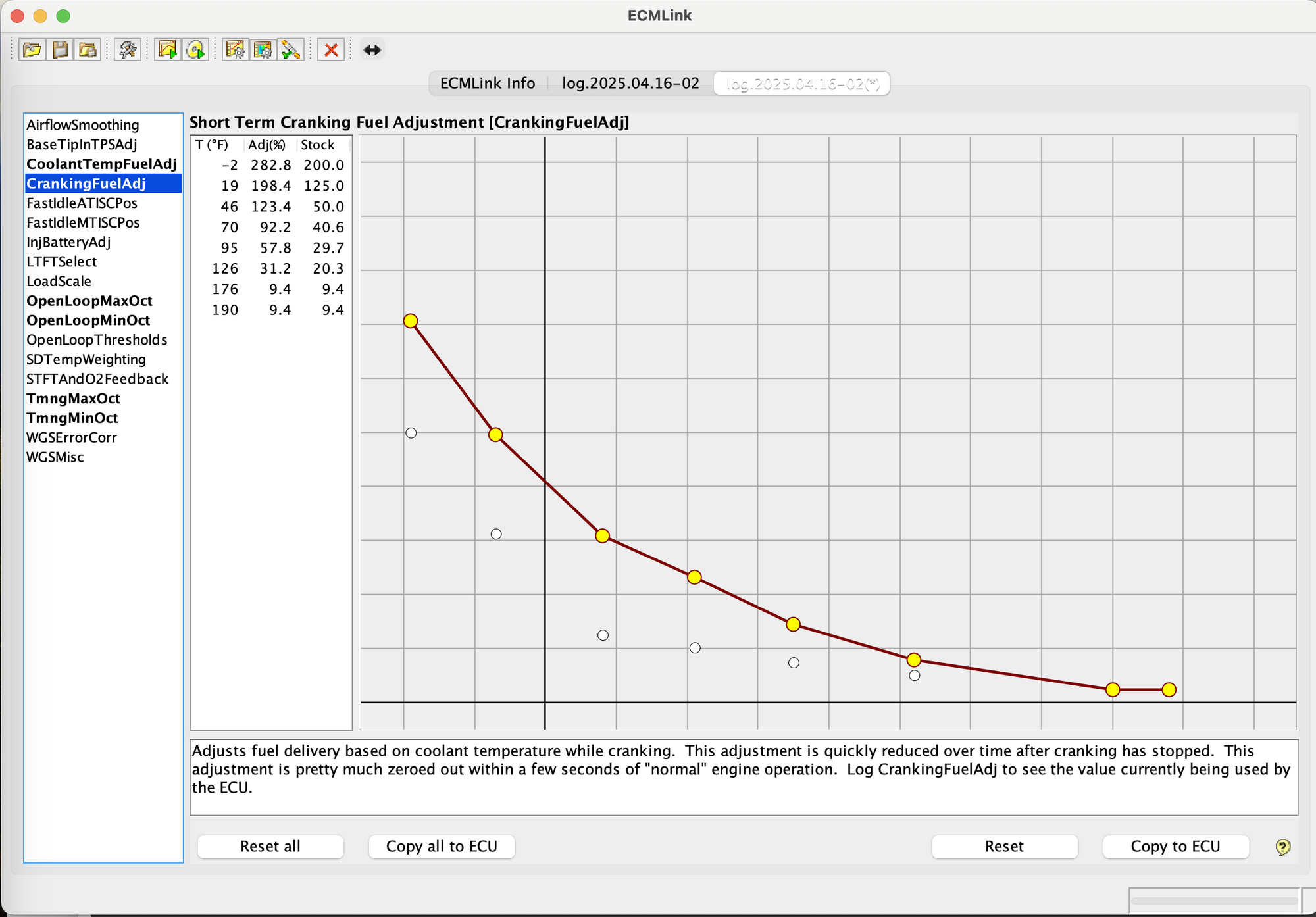

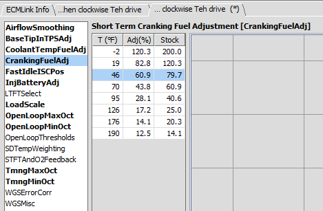

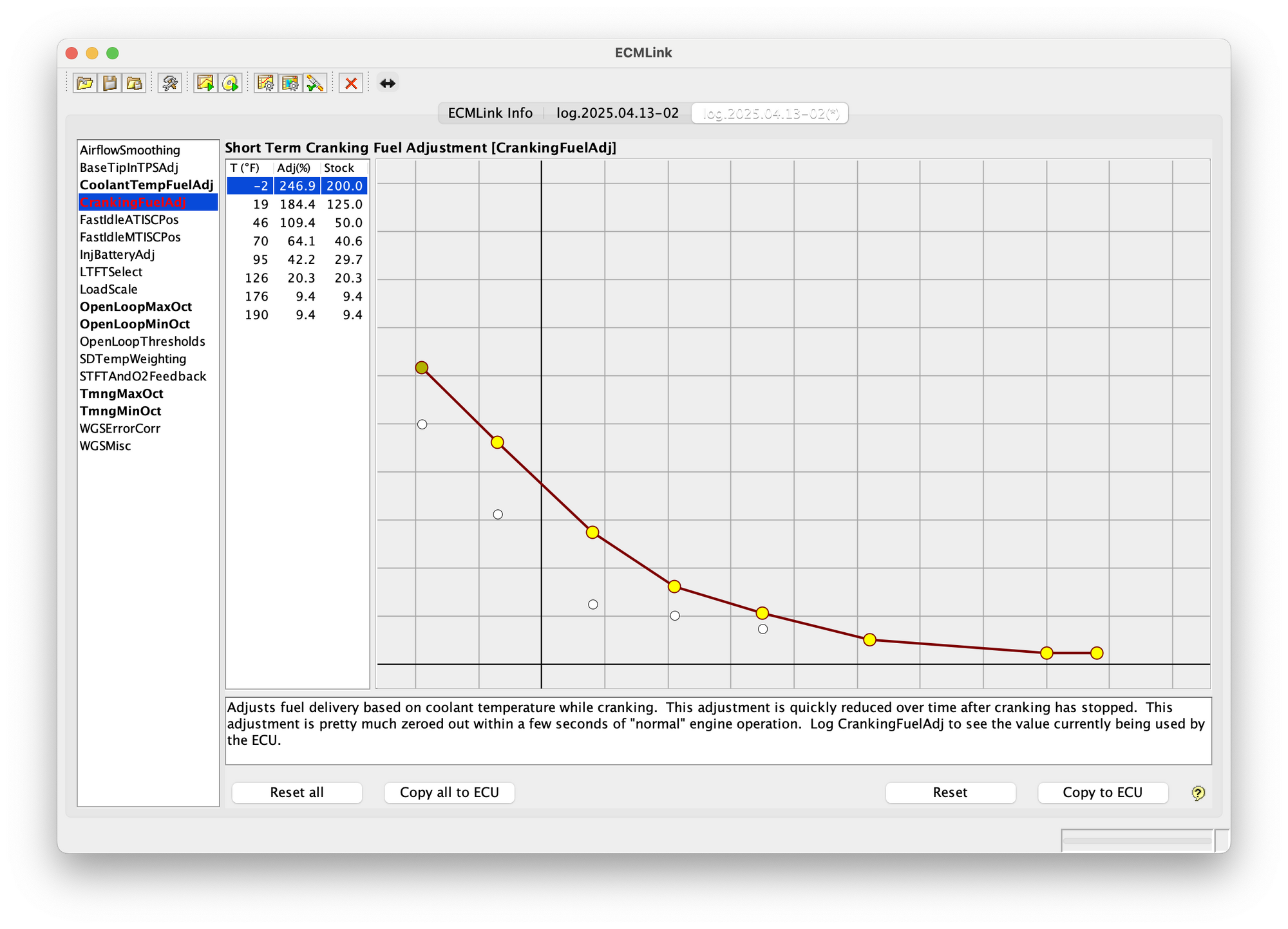

Your CrankingFuelAdj is set almost identically to mine. Unless you have changed it since March 21.
This was just now, at these temps.
Yours, if it continues to run rough like that for about the next 10 seconds, it probably has CrankingFuelAdj too rich.
I'm just going by that's how mine sounded for about the first 15 seconds when my CFA was at the default settings.
The initial running smoothed out some when I brought those sliders down a ways.
It sure starts up quick though (yours does).
The whole map is rough AF. Lol. That's next on the list now that it's on full E85. It's essentially untuned everywhere but WOT and some of cruise.

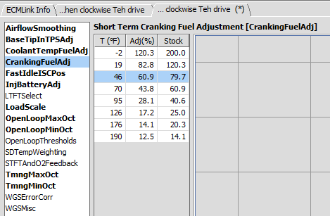

Justin I notice that the 2g Stock values are a lot lower (leaner) than the 1g Stock values, for Cranking Fuel Adjust.
I wonder why that is?
You can see the 1g Stock values in my table here:

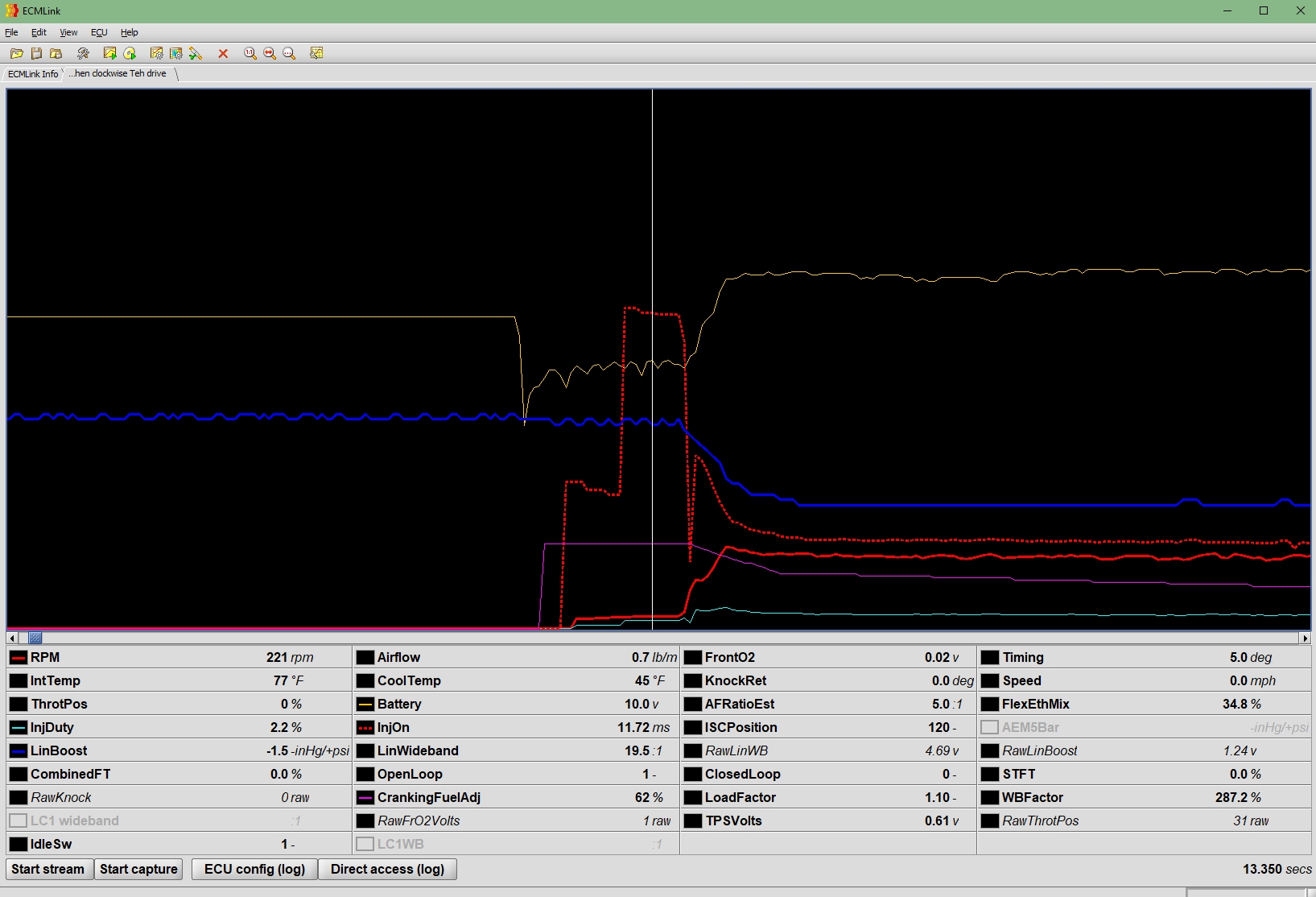

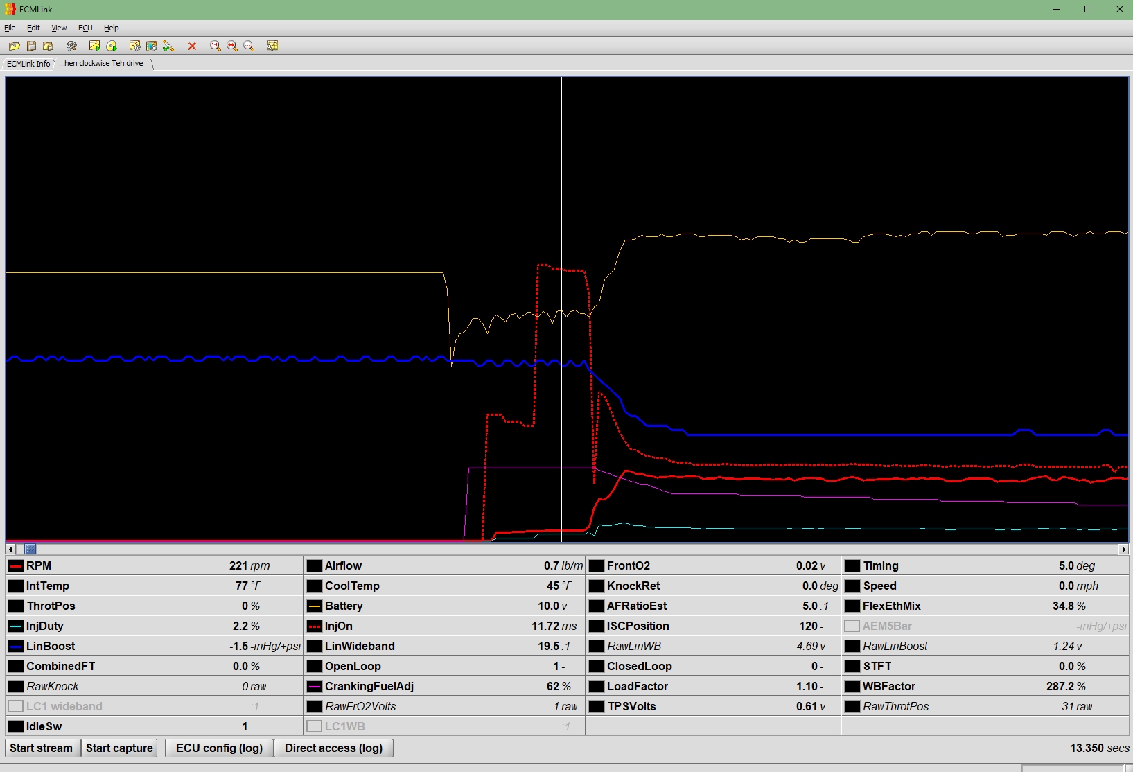

And, it might be irrelevant for you running full blast E85, but here I show my InjOn time highlighted in thick dashed red lines, along with a few other things in my cold start log from April 13, 2025. That huge bump to 11.72 ms in this case, wow, you don't get that at all if CrankingFuelAdjust isn't working. Which it wasn't on my car for a while in 2022 when "KeyStart" wasn't working.
This was 1.4 seconds of cranking:
