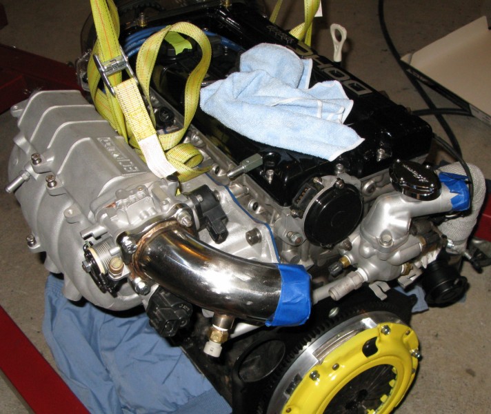

Here's a few pictures of a 2gb (non-adjustable) CAS.
http://www.dsmtuners.com/forums/151751965-post348.html
You can see my 1g (adjustable) CAS here.
http://www.dsmtuners.com/gallery/files/7/4/5/6/5/img_7145___copy.jpg
Is this no longer on the bolt-on housing? Was this on the above 8blade hx40?
