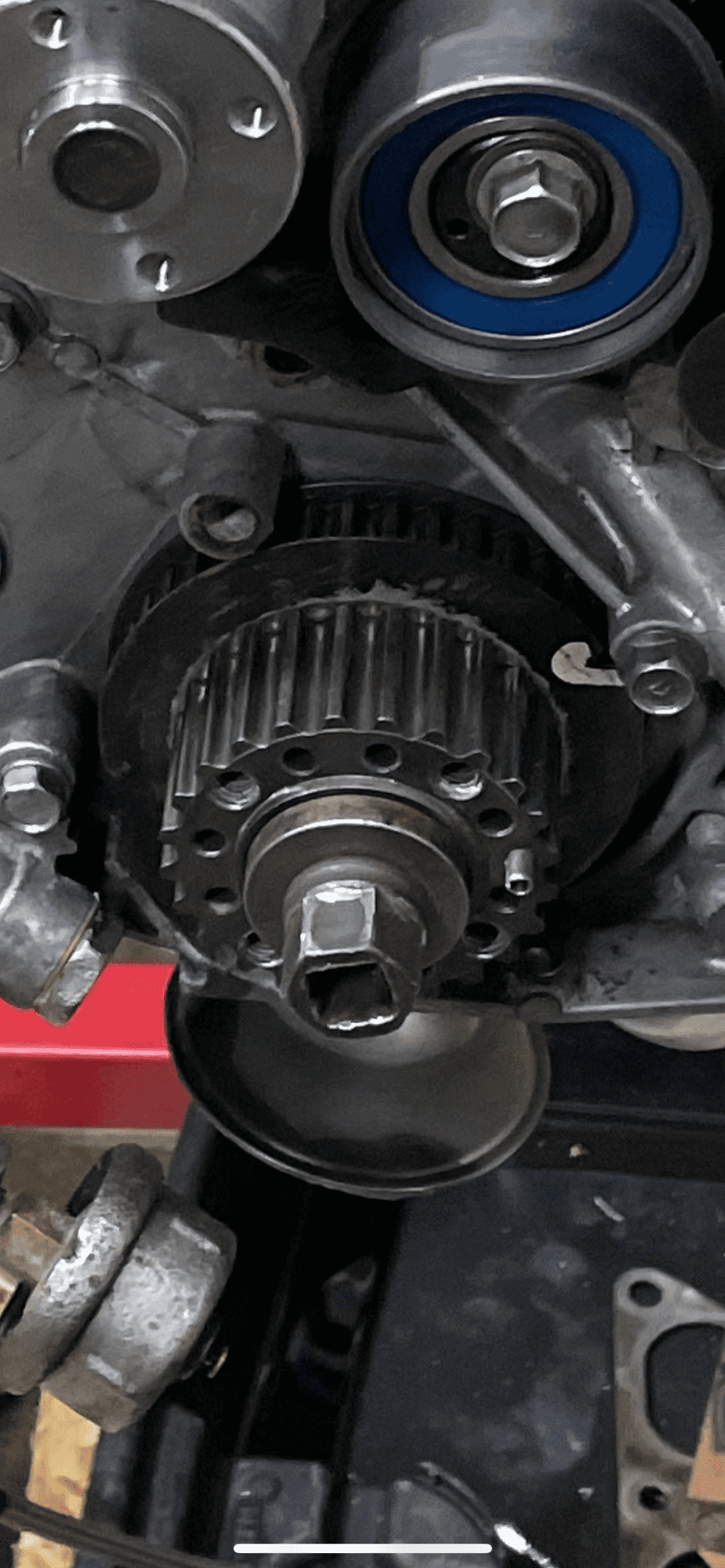

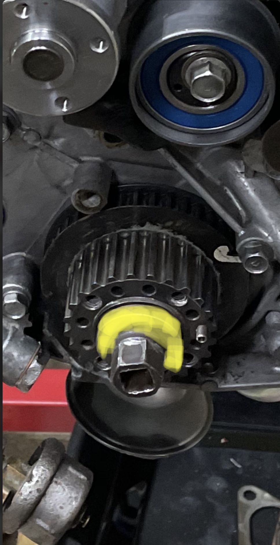

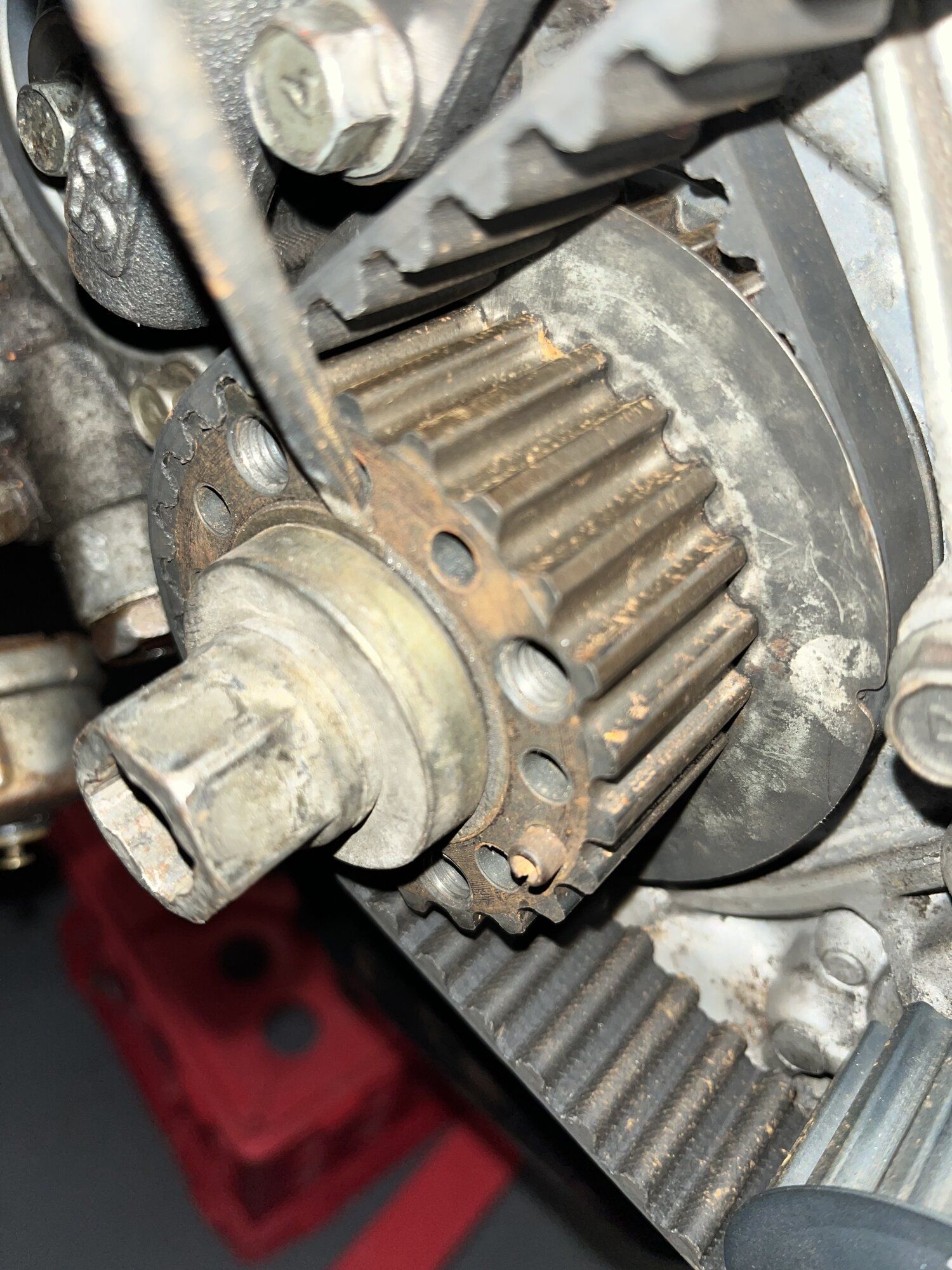

Can y’all see what’s going on here? I ran out of time in the shop today but I was just rechecking the torque on the crank sprocket bolt since I got my torque wrench working. Seems like a piece of the sprocket is breaking off behind the washer? I have another sprocket I can compare looks to when I get back from work tonight.

Hard to see what’s broken on the sprocket. Best to use the spare if it looks compromised

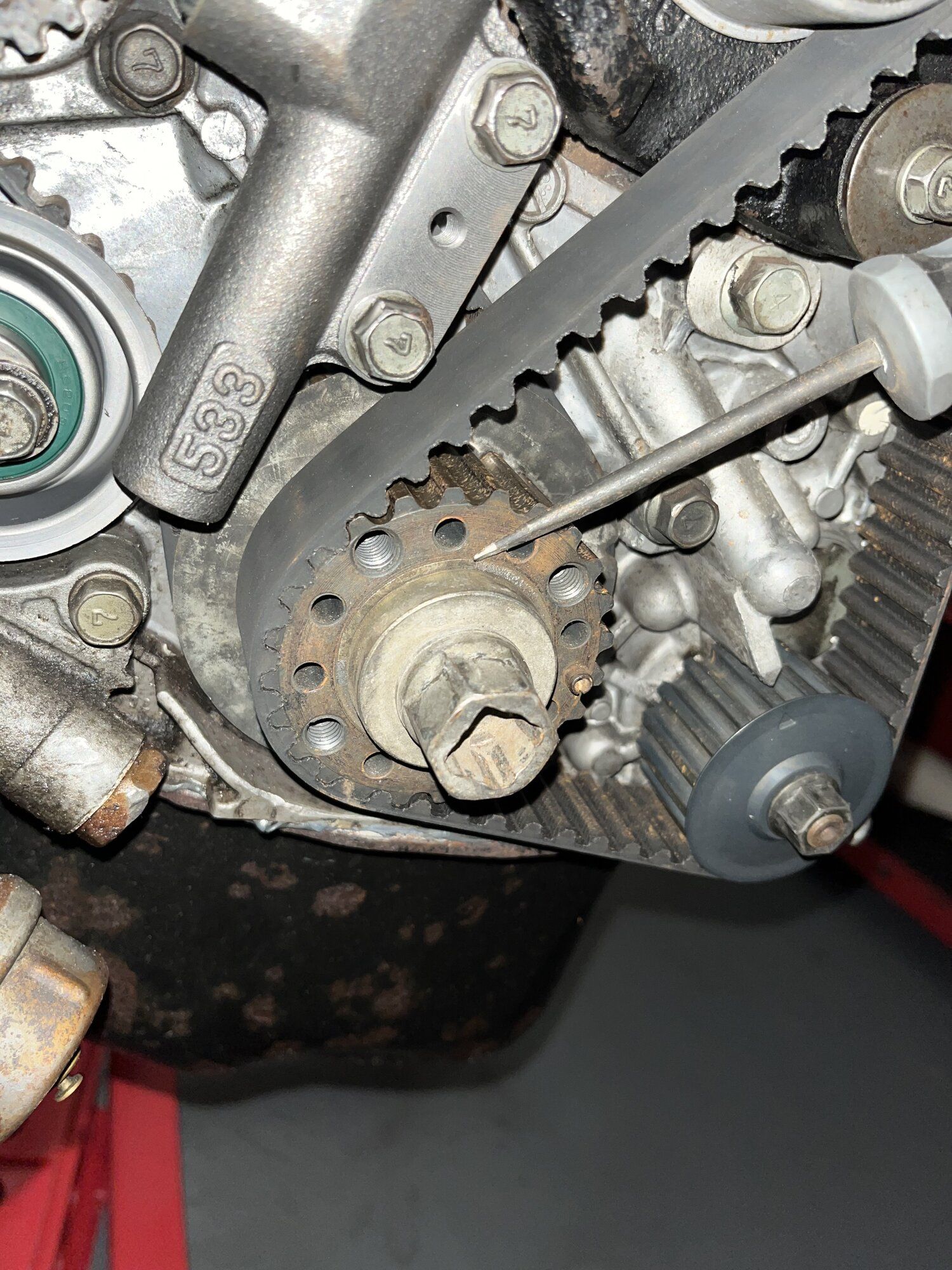

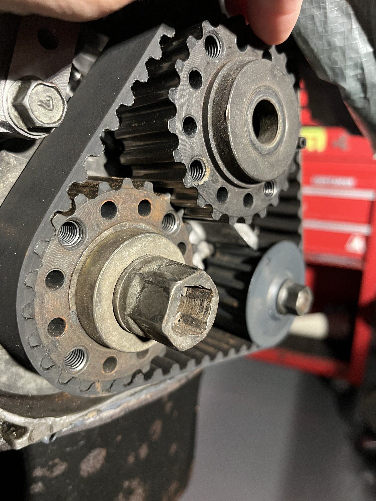

Thanks Tony. Wish I had noticed that earlier, you can see I changed the oil pump sprocket with a new one that I had, it was chipped. The spare crank sprocket that I have is definitely in better shape. Guess I’ll be breaking the timing belt back down. Should be pretty quick and I’ll post a more clear photo of the two compared to each other.
The washer guide is cracked. This sometimes happens when remove/install rusty washer/sprocket/crank pulley.
Thanks, Hiroshi.

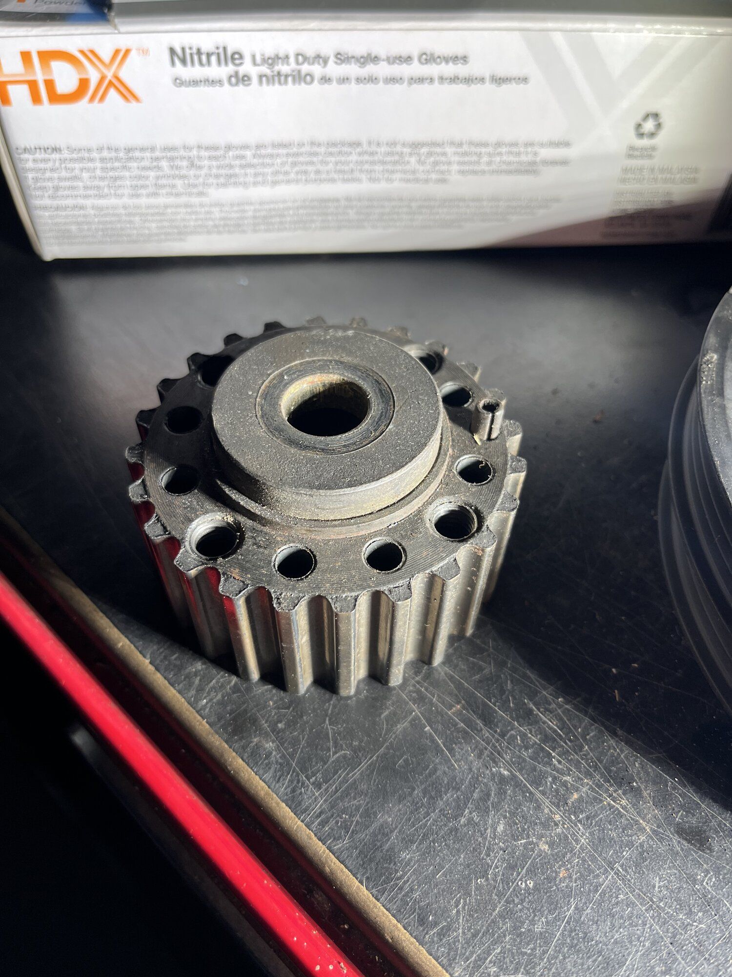

Does that make this sprocket junk? The spare that I have has a much deeper and in tact washer guide, although the old washer is currently stuck inside of it.
Agree with Tony, you have a replacement, so no need to take a risk even if it still works.
Be careful if you remove the washer, the washer guide may be cracked if you force too much.
That ring thing that has cracked and come off of the front of the sprocket, could that be something that happens when the harmonic balancer goes foo foo? The balancer should not be putting a radial load on what it's attached to, only a torsional load. I think. But when a balancer is coming apart, it will throw radial loads back and forth and those radial loads would bear on that ring wouldn't they?
That’s a good theory. When you see the movement it creates when it starts to separate, it’s all over the place. BUT, the movement is from the outer pulley and the center section is stationary secured by the 4 bolts which are further out from where it broke.
Could be too. That part is brittle, several factors would break it. I have seen this many time and I broke it by myself too. Using an impact wrench and a hammer to install/remove is one of the common causes.

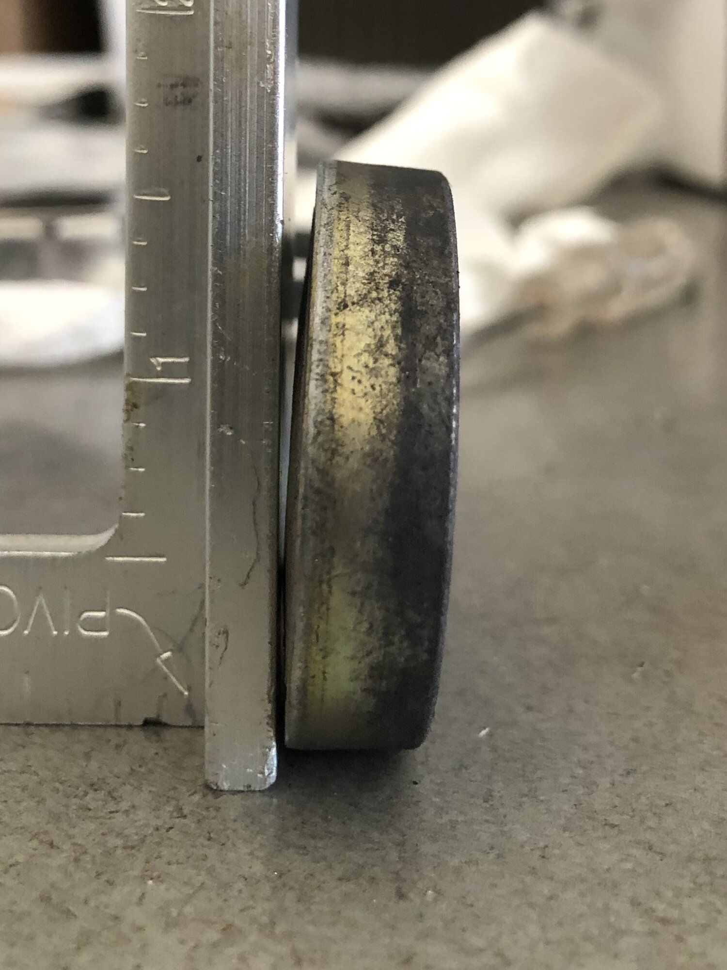

Replacement gear time. This happened to me too. Check to see if you have a taper on the crank pulley washer. I put the narrow edge to the sprocket side on re-assembly just to be conservative.
- One of one
Nice call out, thanks! I remember reading that in your thread now that you mention it. I may end up with new parts here. I’ve been spraying the stuck sprocket/washer assembly with pbblaster every couple days before I try to separate them.
Tony,
This part- I guess they get stuck together often. I’ve seen several threads where the OP can’t find his washer or doesn’t know if it’s there or not. It almost seems like a part of the sprocket if you don’t know any different.

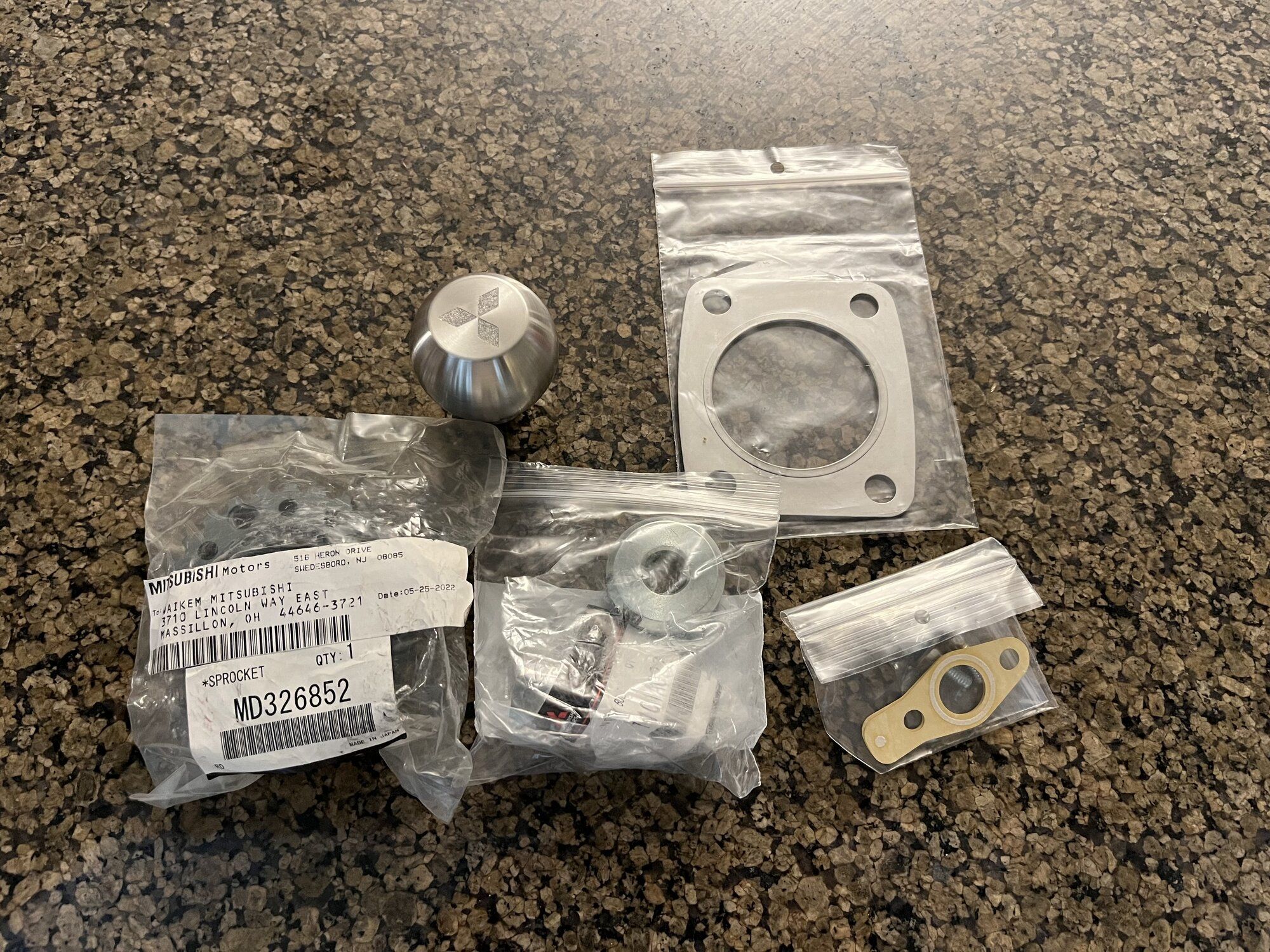

A very unexpected and extremely tragic loss in my family ruined my summer. The only reason I’m making a post here is because I got a box from a supporting vendor today, and I’m really glad to have these pieces.
My little one’s school start date was delayed to next month, but maybe I will get some garage time in then. This order should get me to a point that I can either start a new list or get the engine stabbed in. This weighted shift knob feels super heavy, I love it!
