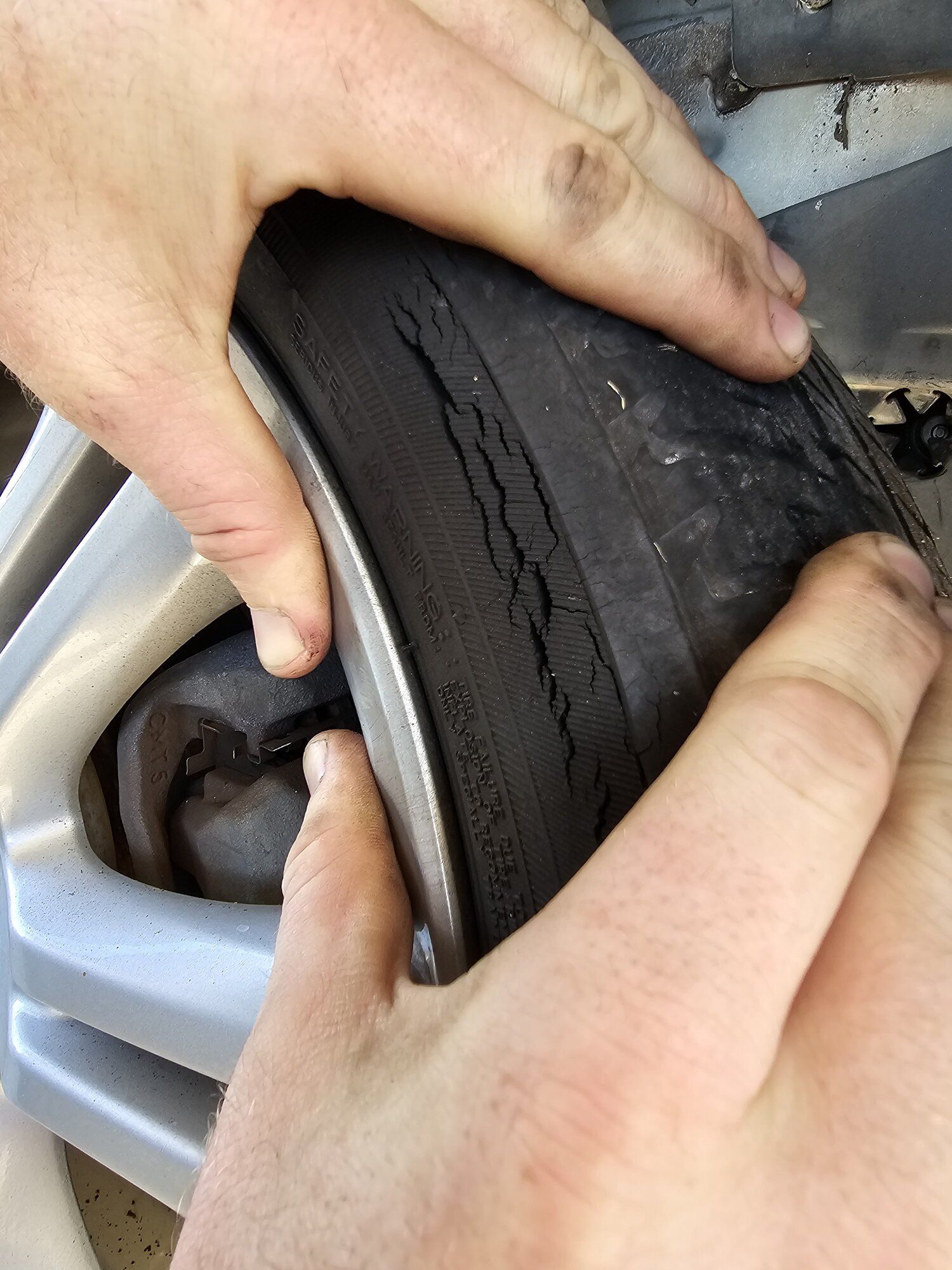

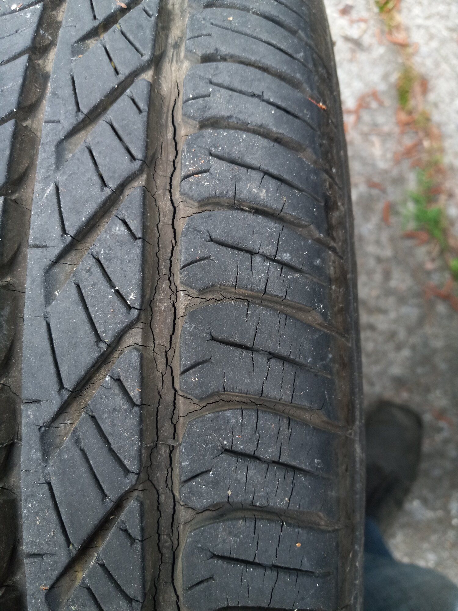

When a car sits up or isn’t used much, please pay attention to the tires when it’s time to drive it again! Just because the tires have tread and look ok, doesn’t mean they are safe! These tires were 9 years old.
4 new Hankook’s and a headlight polish. That’s the end of my Tundra money.
The tires on my Prelude only had ~3000 miles on them when I bought the car. But needed to be replaced because of massive flat spots when the tires lost pressure and dry rotted. The highway vibration was terrifying driving the car home from purchasing. I'm glad they didn't blow out. Tires are usually one of my first inspection items when buying an older project car.
I liked having the Hankook Ventus V2 on my 2g back when I still daily drove it. They're a fair mix of wet weather and dry road traction. Now I have some slicker tires and try not to drive the car in the rain.

The Hankooks are for your Talon? What model of them did you get? I noticed they make about a bajillion tire models a couple weeks ago when I bought new tires for my 1990 Corolla. Anyway the Hankooks I just got for that car are good, I like em.
They are for the Fit, I got the Ventus V2. You’re right there’s tons of options out there. I have a buddy that just opened a tire shop, so between the funky size and what was available to him helped narrow it down.
My DSM will no doubt need tires before it’s back on the road. They were old and sketchy when I drug it home 4 years ago.

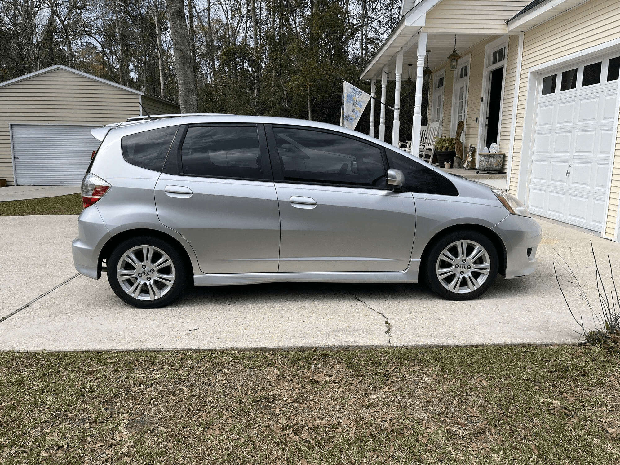

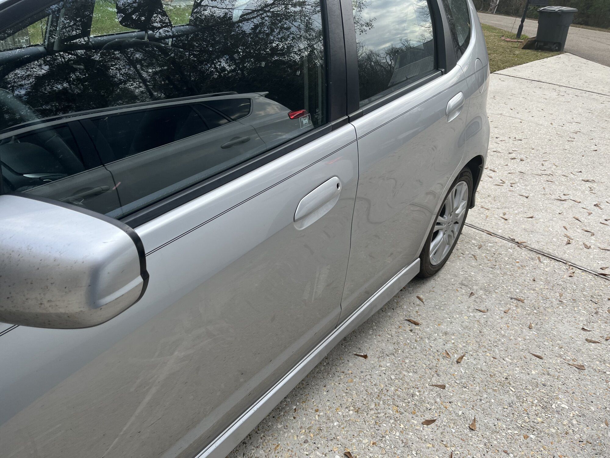

Went ahead and replaced all four belt moldings before they become no longer available. We all know about those struggles. This was actually my first order from Amayama and everything went smooth.

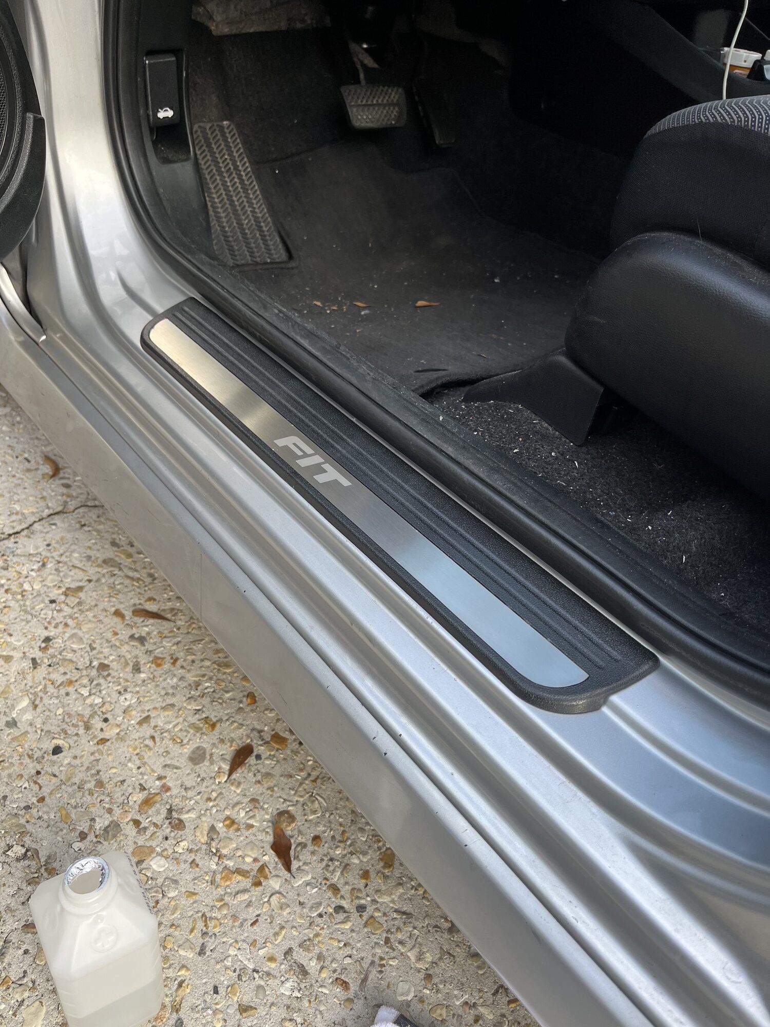

These door sill plates were a Christmas gift from my in laws, they covered up some dents and scratches from the previous owner very nicely.

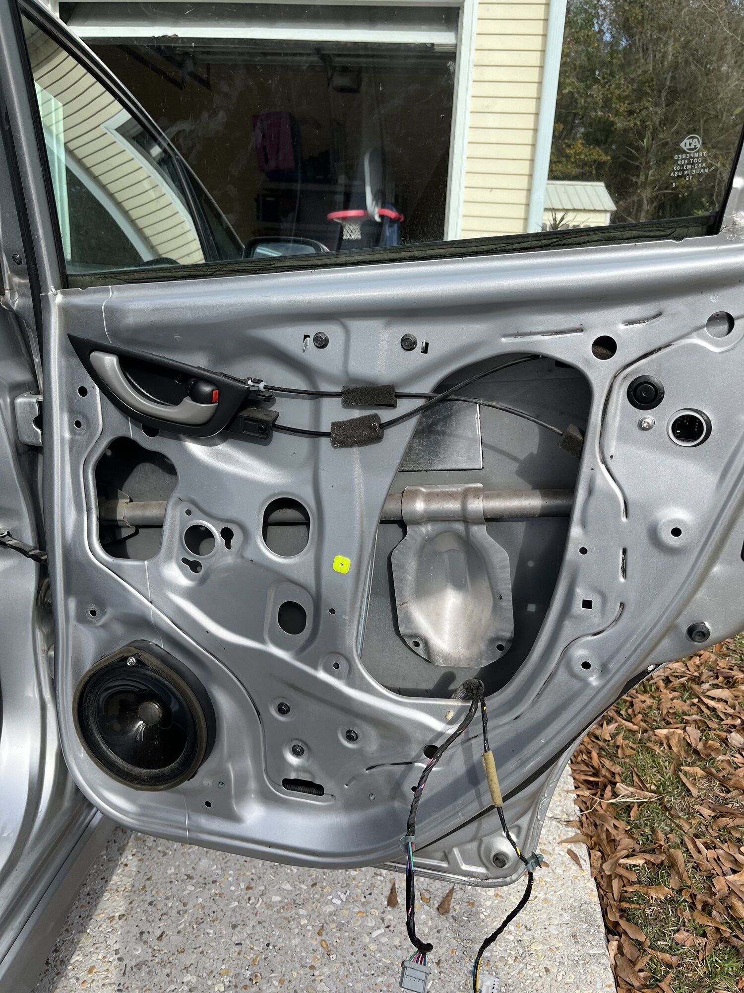

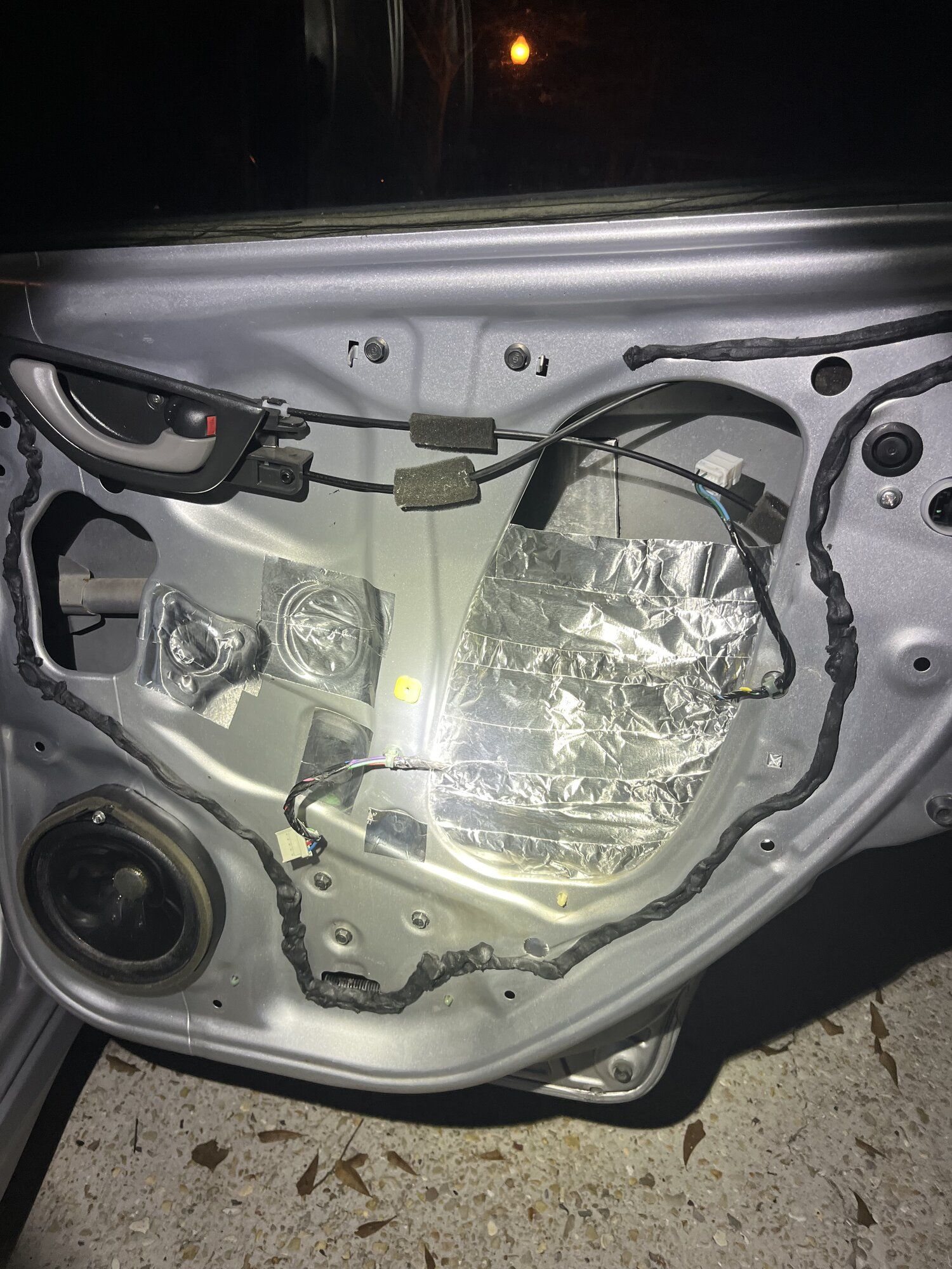

The right rear door vapor barrier was not sealed at all, leaking rain straight onto the rear floorboard. This is a common problem with these cars and I was able to fix it easily with some new strip caulk. I also did an aluminum tape mod that I read about on FitFreak. The idea is to just keep more of the window water off of the vapor barrier and directed to the door drains that are outside of the door open seal.

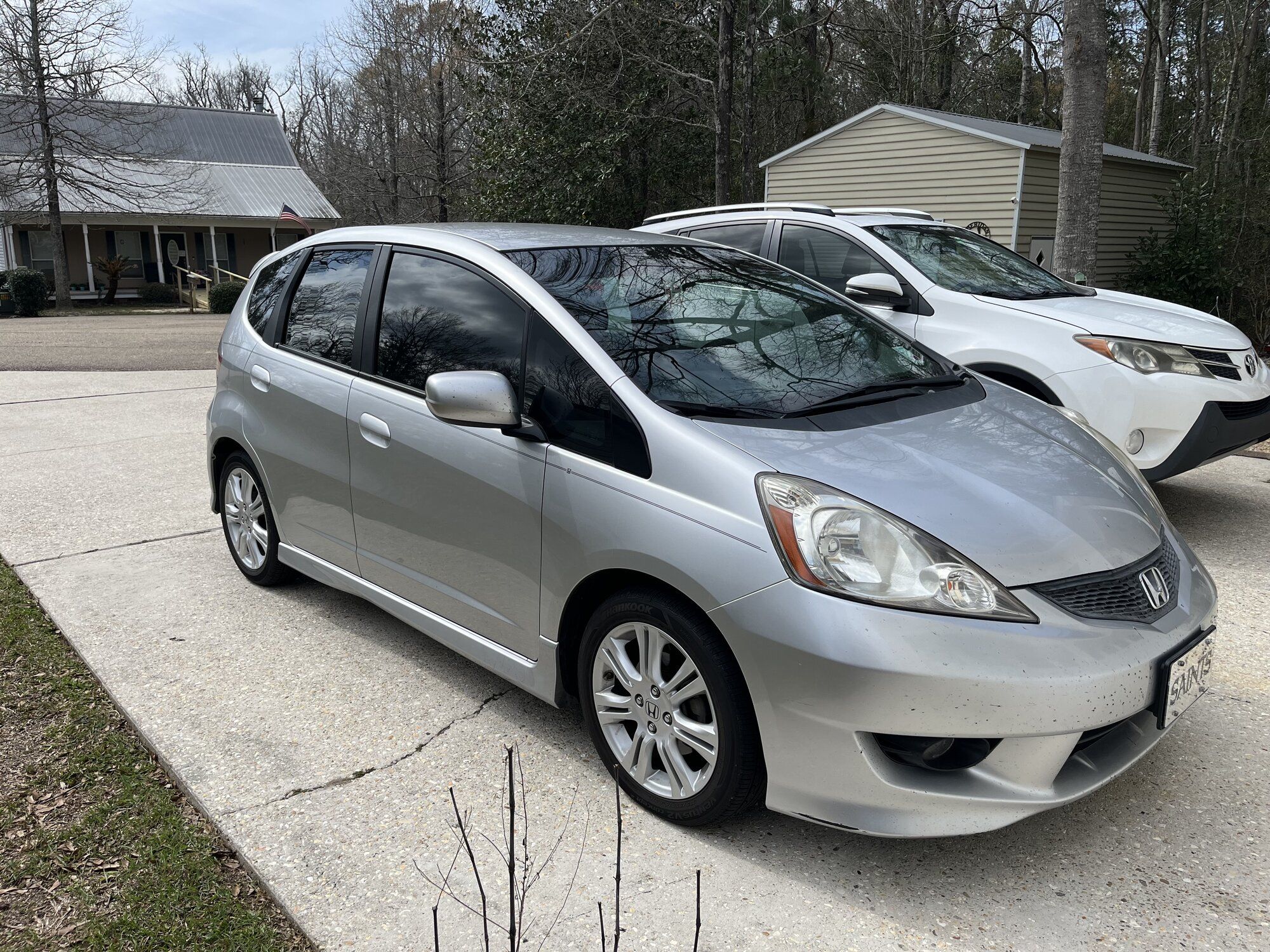

Last set of photos, my wife and kids wanted me to get the windows tinted for an early birthday gift. I haven’t had a vehicle tinted in quite a long time so that was an exciting day. It’s ceramic 25% all around.

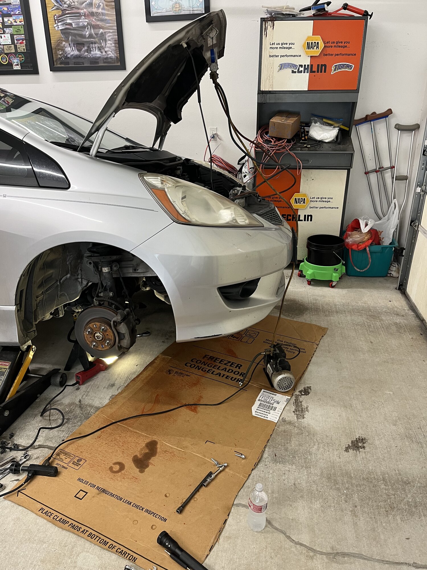

Huge props to my neighbor for letting me use his air conditioned garage to replace my A/C compressor a couple weekends ago.
OEM reman - discontinued
OEM new ~$680 (no clutch kit)
OEM clutch and coil kit ~$330
Chinese aftermarket loaded unit ~$250
No wonder people used to trade these in instead of paying for a simple compressor job.
Trusted local junkyard, 65k mile used oem unit, $130. That’s all me!
Also replaced the rattling Halfshaft heatshield while I was using up all his cold air.
