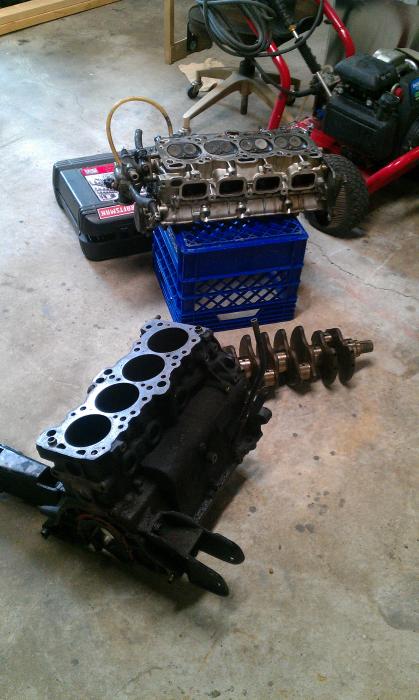

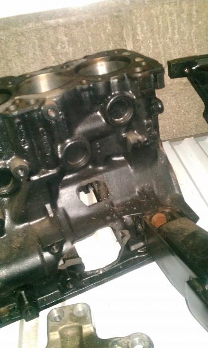

I built the shortblock and head by myself. Which I didn't do a good job documenting. I won't mention what shop did the machining, but luckily I work with a great group of gearheads that informed me what a terrible job they did.

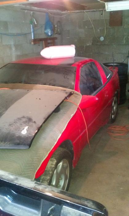

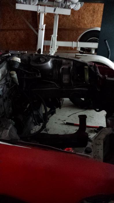

Still working on the teardown process. So far the interior is gutted, which I feel for most of us is fun to rip everything out. It's unreal how big the body-wiring harness is. It's got to weigh ~40lb total of just wires/connectors. FYI it runs from the fuse box behind the pass. headlight, under the radiator, up behind the driver's side headlight, through the fender, and into the dash. I had to hack it into 2 pieces inside the fender for easier removal. I'll be starting new from the megasquirt out. So these are just dead weight. 1 picture of the engine bay I could put up, it was dark where I work so I couldn't get any good ones.
