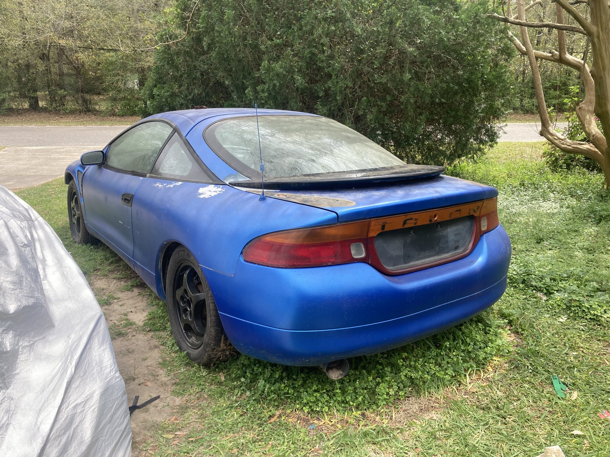

A 1995 Eagle Talon ESI that I bought for damn near free, that I want to fully rebuild/get running again and use it as a super boring, slow daily driver.

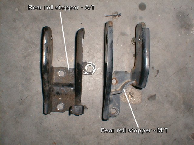

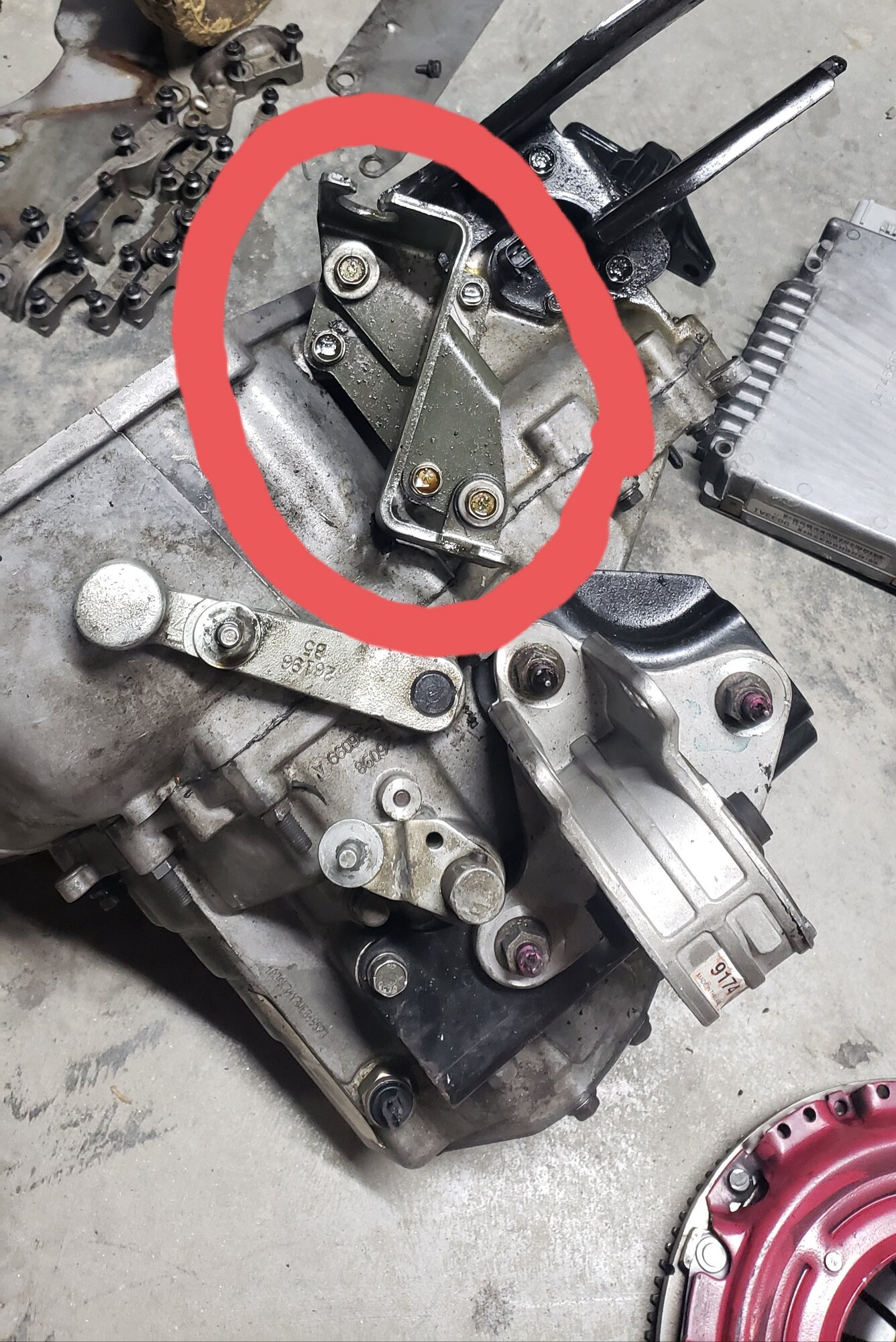

For the rear transmission bracket, the automatic bracket looks SUPER close to the manual one, just modified a bit. I am 100% tempted to buy the automatic rear bracket and cut it. Maybe get a local to tac weld in a brace and to move one of the bolt ears up. It looks legitimately like that's what MOPAR did for the rear transmission bracket for the NVT-350. Just used an automatic rear bracket, cut it, welded in a brace to make up for the cutting, and moved the ear up a bit.
Even with two bolts though, I bet it'd be plenty strong. The 420a isn't exactly a torque monster and powerhouse from the factory.
We'll see! In the meantime, keep your eyes peeled for a 2G 420a M/T rear trans bracket por favor.
Alright, been doing a ton of research and decided to pull the trigger on the automatic rear mount.
What I'm gonna do is just cut and get someone to weld it into a copy of the M/T mount. Probably fill the upper most bolt hole on the left side and drill/tap a new one. Move the ear down so it's equal to the upper most bolt hole. And definitely gonna have to cut and raise the center/through bolt holes because the M/T brackets straight through hole is higher.
You just can't find the M/T bracket anymore and I don't really wanna wait around for one. If someone finds one and wants to sell it to me though, hit me up. In the meantime I'll keep you guys updated with pictures. In all actuality it probably wouldn't be very hard to just custom fab a mount bracket if there was literally ANY market for it. Lol.
I drew on this picture years ago when I was helping another member, and it's kind of in the way. But you can see that the M/T bracket is shaped that way for a reason. To clear the speedometer sensor. So you'd definitely have to cut the A/T bracket for clearance. It's thick steel too so be ready for that.
Yeah I’ve been researching and found why it was cut like that. Looked on my trans as well. Think I’m ready. Lol.

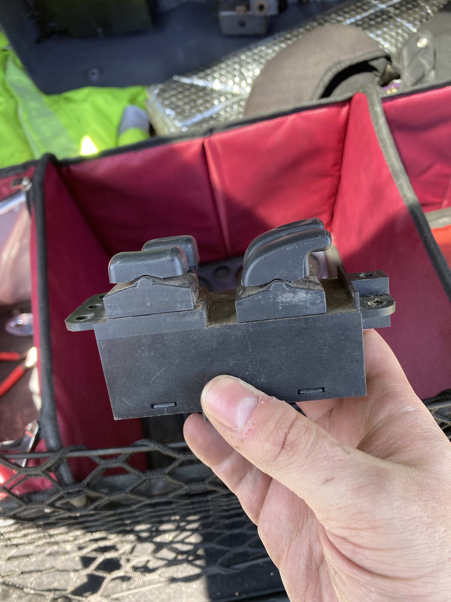

I needed a replacement set of window switches, and really wanted to replace the center console (I'll show you why with pictures) and the car came without wiper arms. So, I got all that and more!

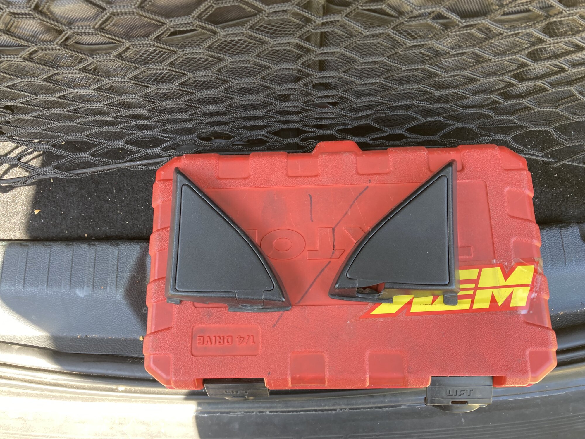

Was stoked to find these. Relatively great condition minus a crack on the inside cover on the right one.

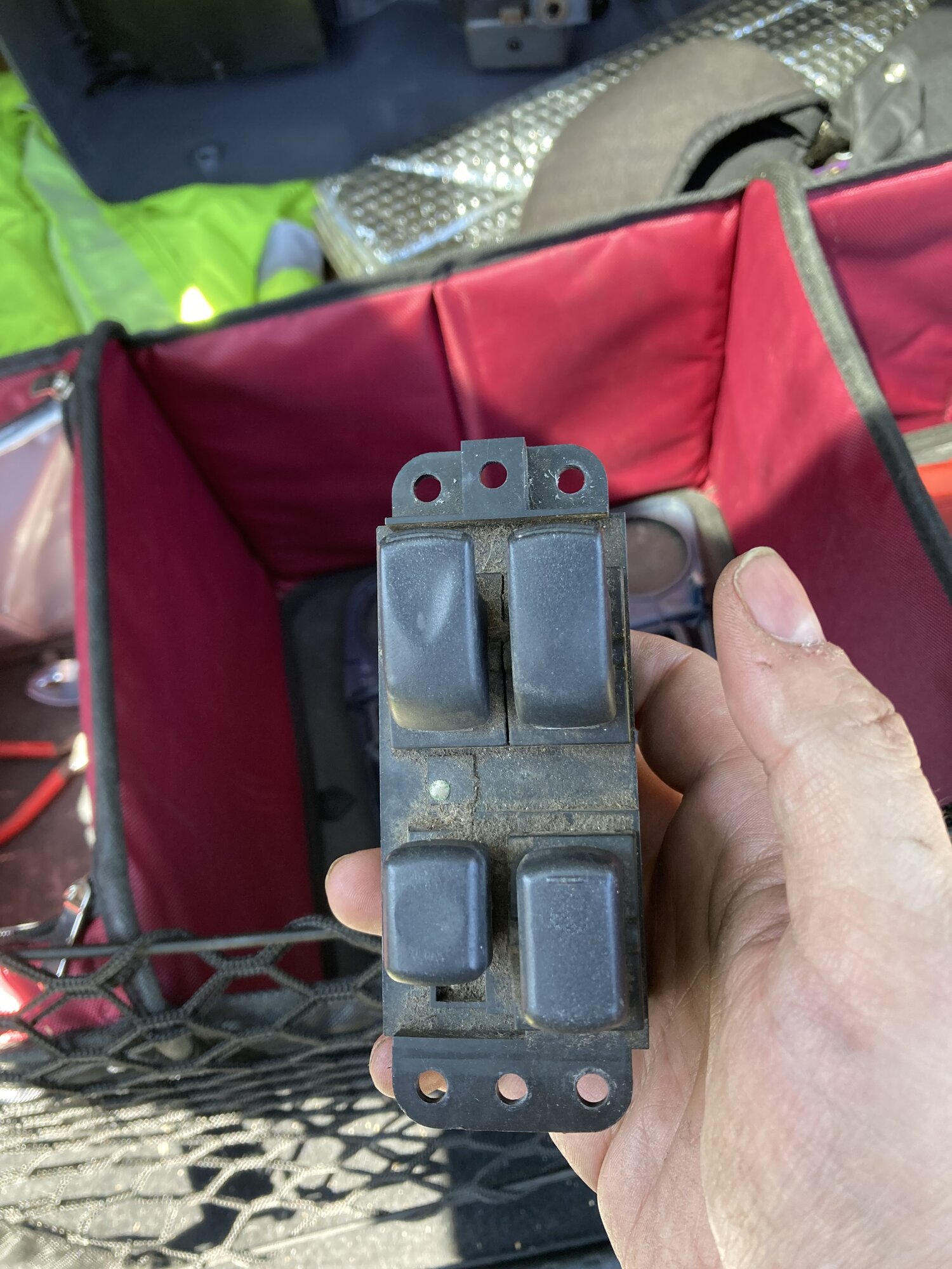

Window switches! They're dirty, but feel phenomenal. They click like new.

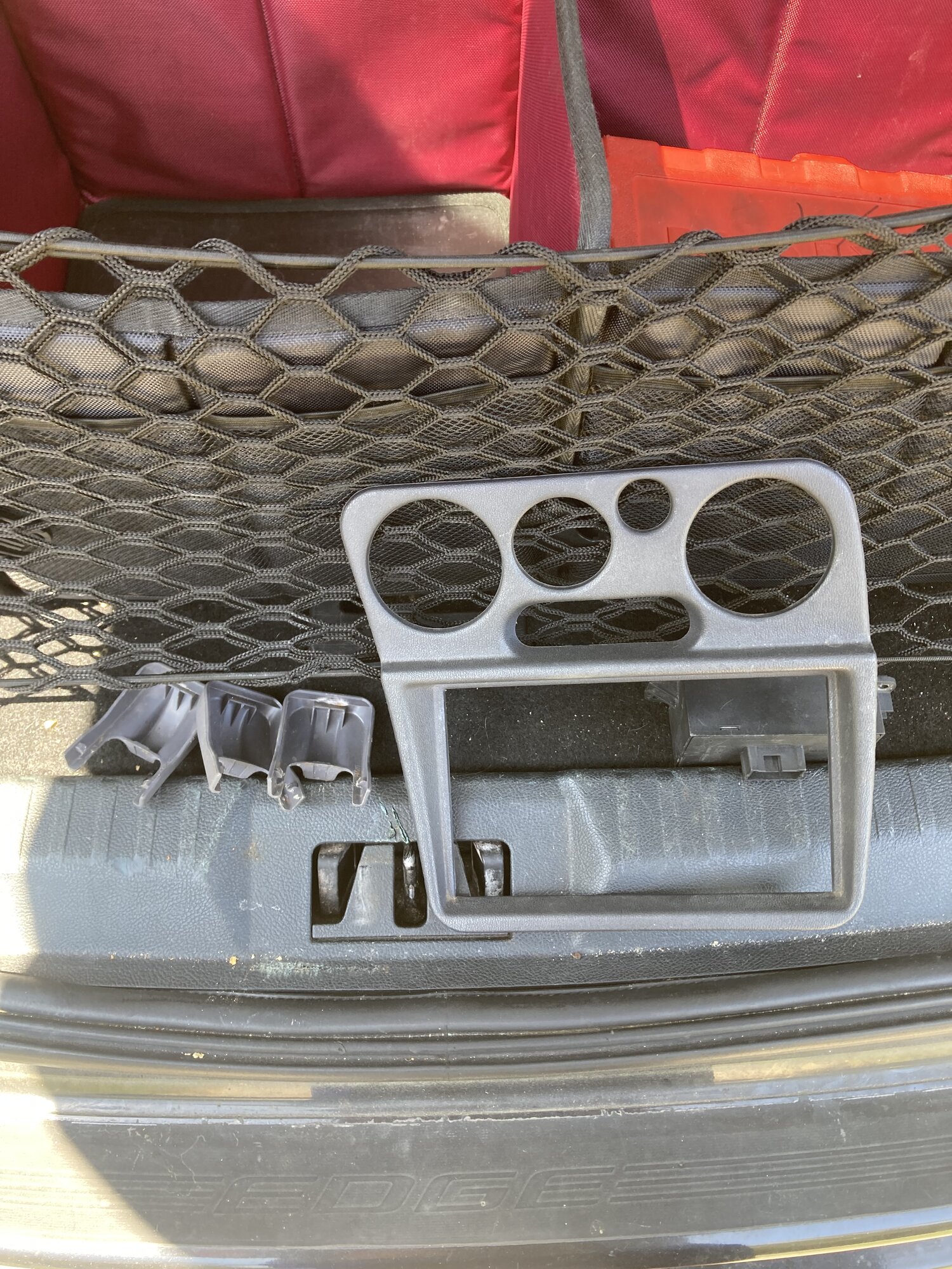

Replacement center bezel and various little interior covers(more not pictured).

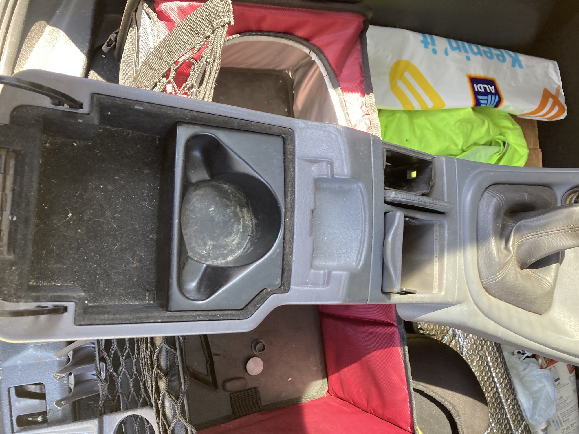

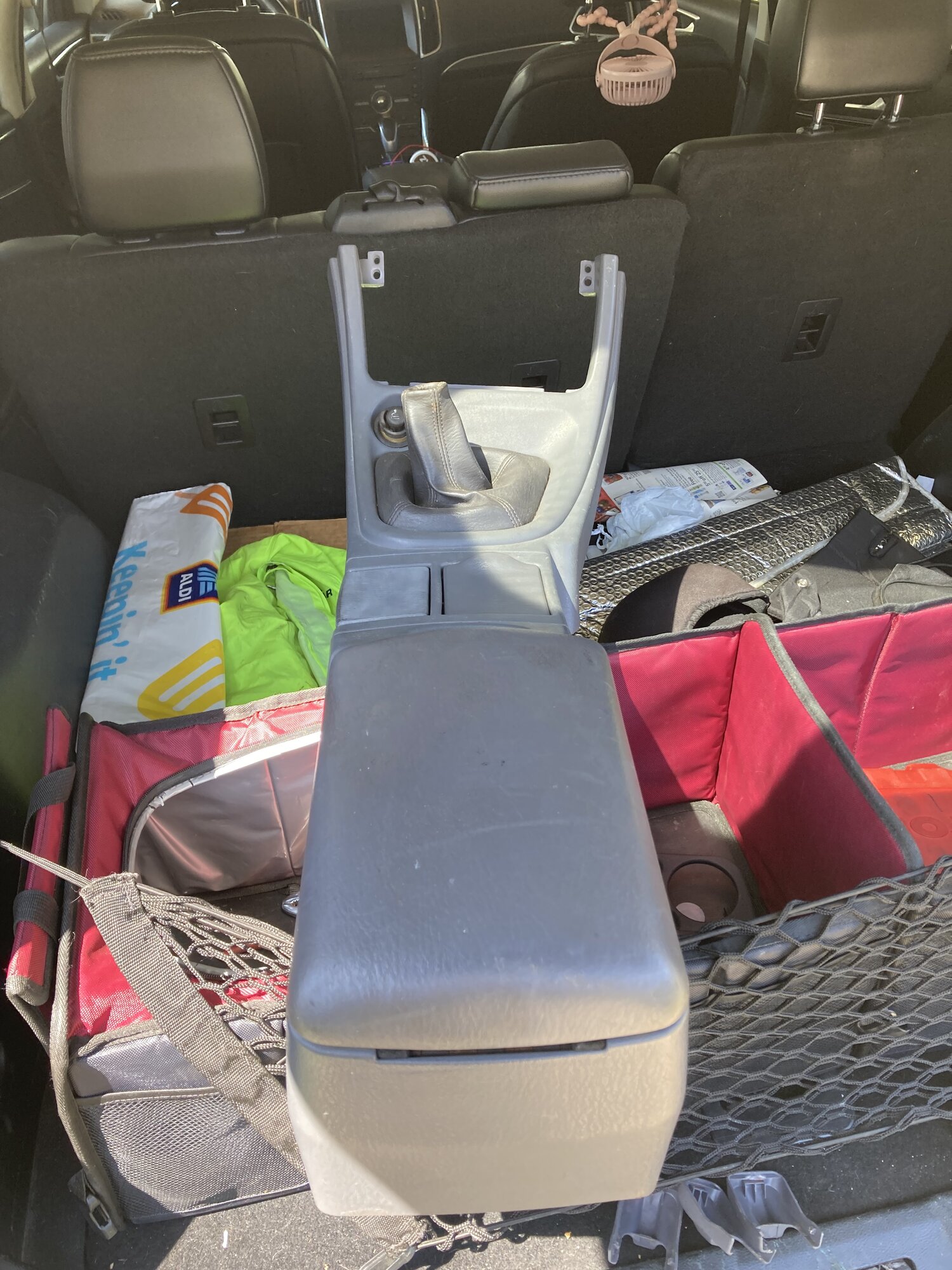

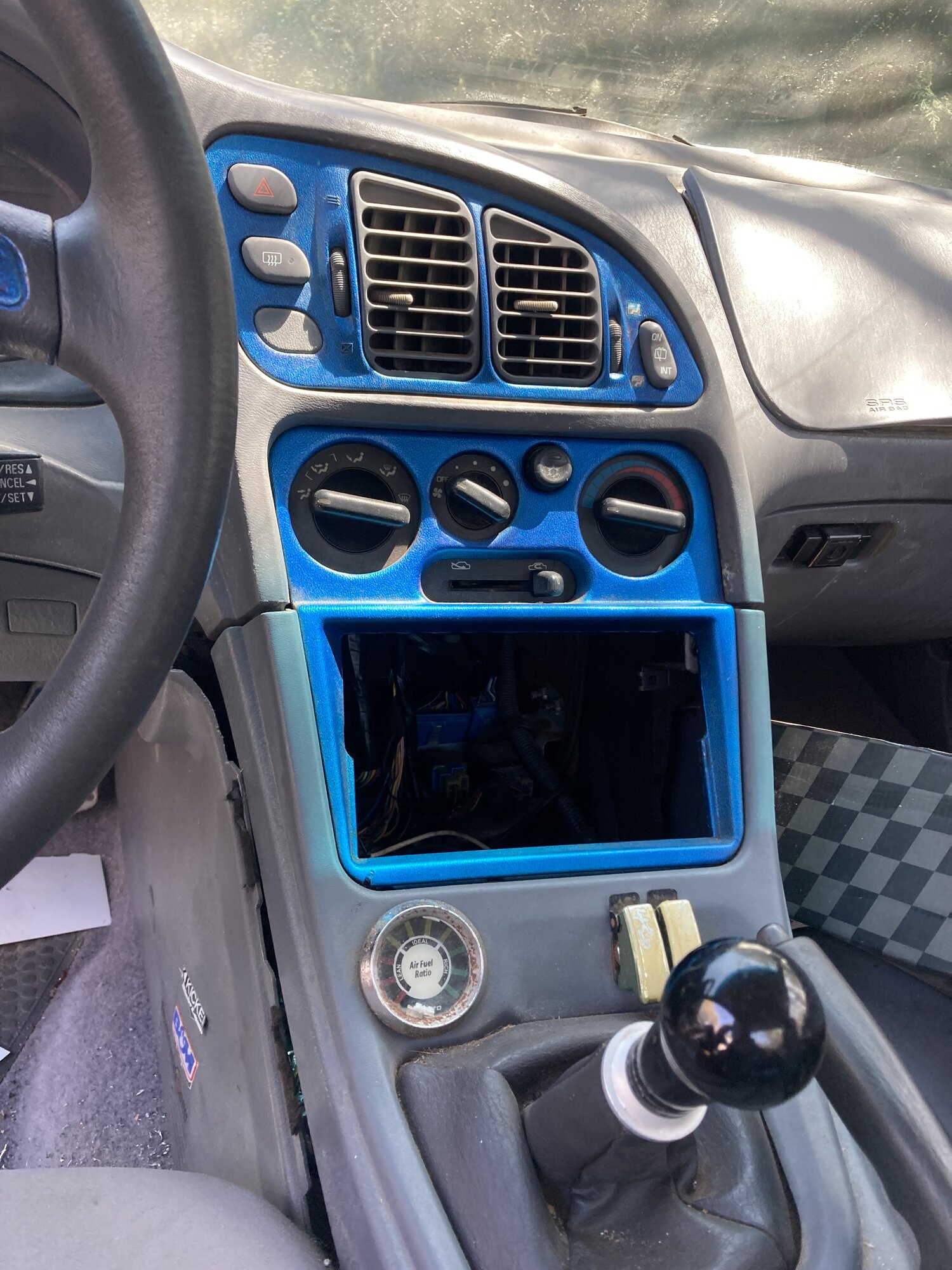

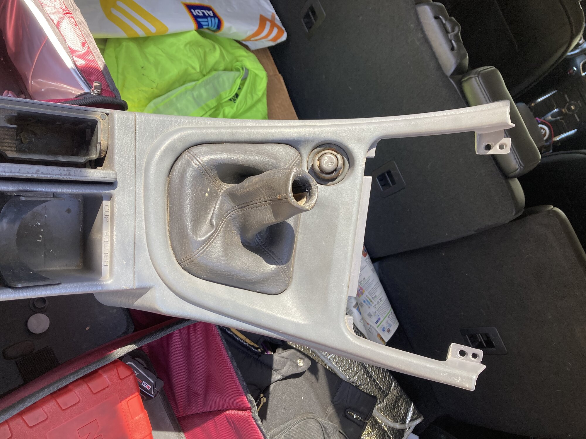

Finally...the center console! First pictures are the new one, and the second set are why I feel like I need to replace it.

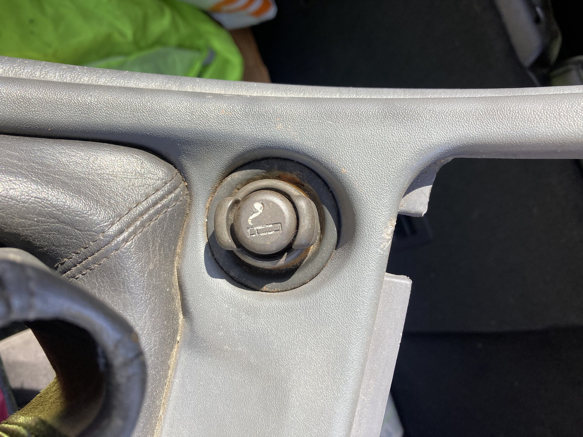

OEM cigarette lighter! yay!

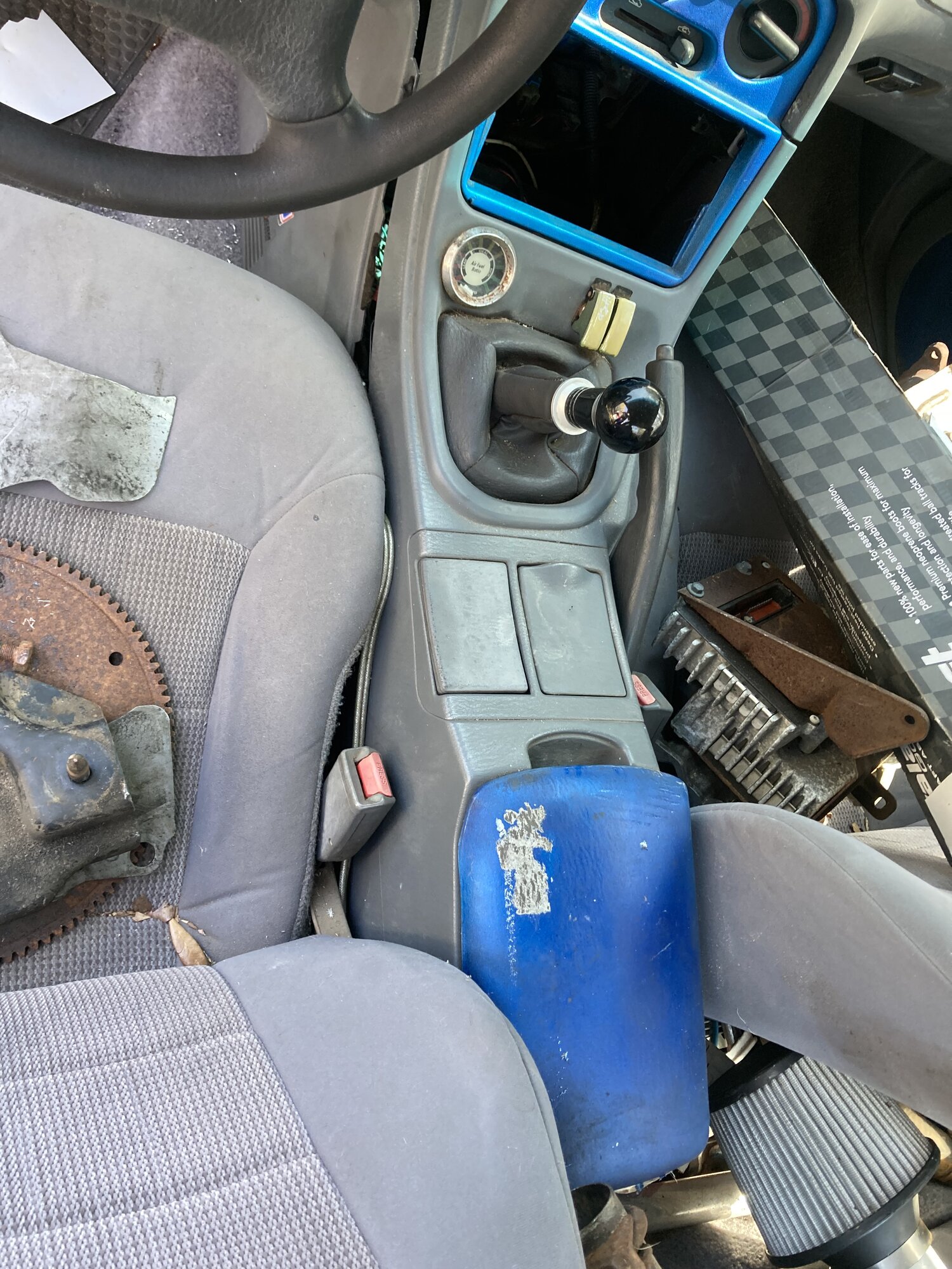

Now what its replacing.
The paint doesn't bother me, the fact that they drilled the 12v socket/lighter socket out to accommodate the useless AFR gauge and drilled holes for random toggle switches made it necessary IMO to replace it. I use the 12v socket for my phone a LOT, and this will be getting a sound system like the Talon so it needs to have that for various chargers or bluetooth adapters.

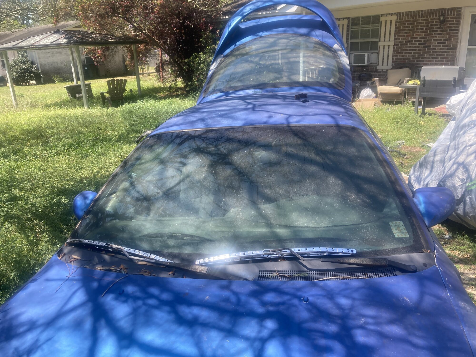

Wiper arms! The wipers were sitting in the back of the car and legit look 15 years old so I threw them on for giggles.

Finally pulled the trigger on a 2GA talon spoiler to get rid of the gsx hoop spoiler. Was a relatively easy install, now I’ve got to fill holes though.
I think this looks so much better. I’d love to have 2Gb eclipse swap it but have no way to weld so that’s out. It’ll stay 2GA talon with a 2GB eclipse front end. :) very pleased.
It's looking great, man! The GSX hoop spoiler doesn't fit the Talon rear well imo. The Talon spoiler looks right at home! :D
