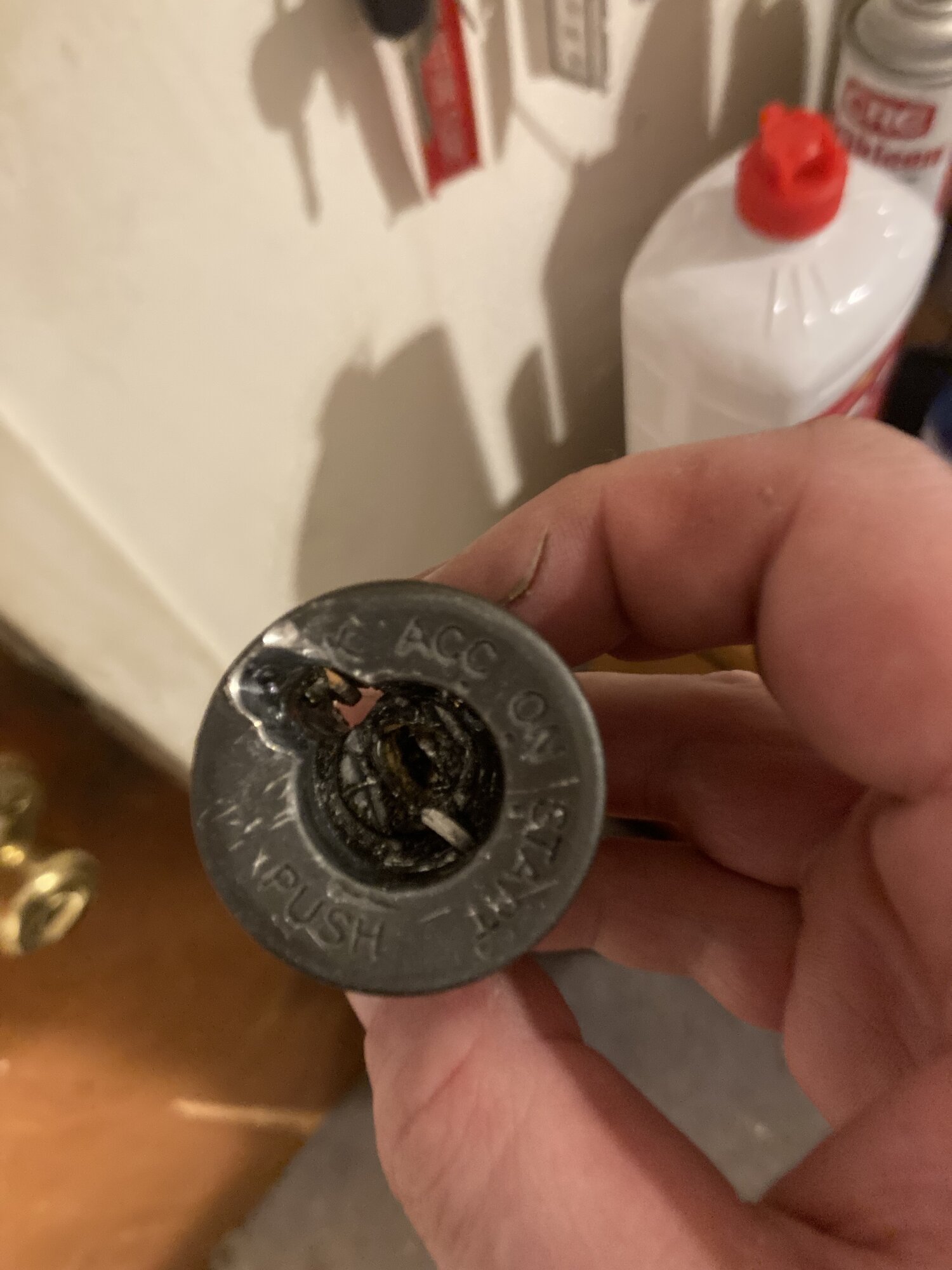

Alright, second fix to the car is in the books and boy...did this one absolutely whip my ass. It put up a great fight, but I won in the end.
Backstory: The car came with no key. The seller couldn't find it, the previous owner who sold the car to this guy I bought it from said they put the key in the trunk...it's gone. Vanished. I waited a few days, and considered a locksmith, but I need to car registered to me first before they'll do it. And I can't register it without insurance, and I'm not tagging/insuring a vehicle that's just gonna sit here.
So, enter John Hanlon/Performance Partout. I wanted to buy a complete key set, but they only had the ignition, which is better than nothing. So I bought that, and had it shipped to me. I started researching on how to remove the lock cylinder without a key, and found a promising youtube video where an indian dude was saying some models it just needs to be in "lock" and not "accessories". I hoped...against hope that might would be that way.
It wasn't. It needs to be in accessories mode. Before I even touched the car, Solomon/ @BLACK'98DSM told me just to use a punch and unscrew the bolts and pull the whole housing off. I should've listened to him, but I didn't.
First I tried punching the little button on the bottom because maybe I could do that...hahahahahahaha, no. That thing is ridiculously hardened and laughed off my attempts.

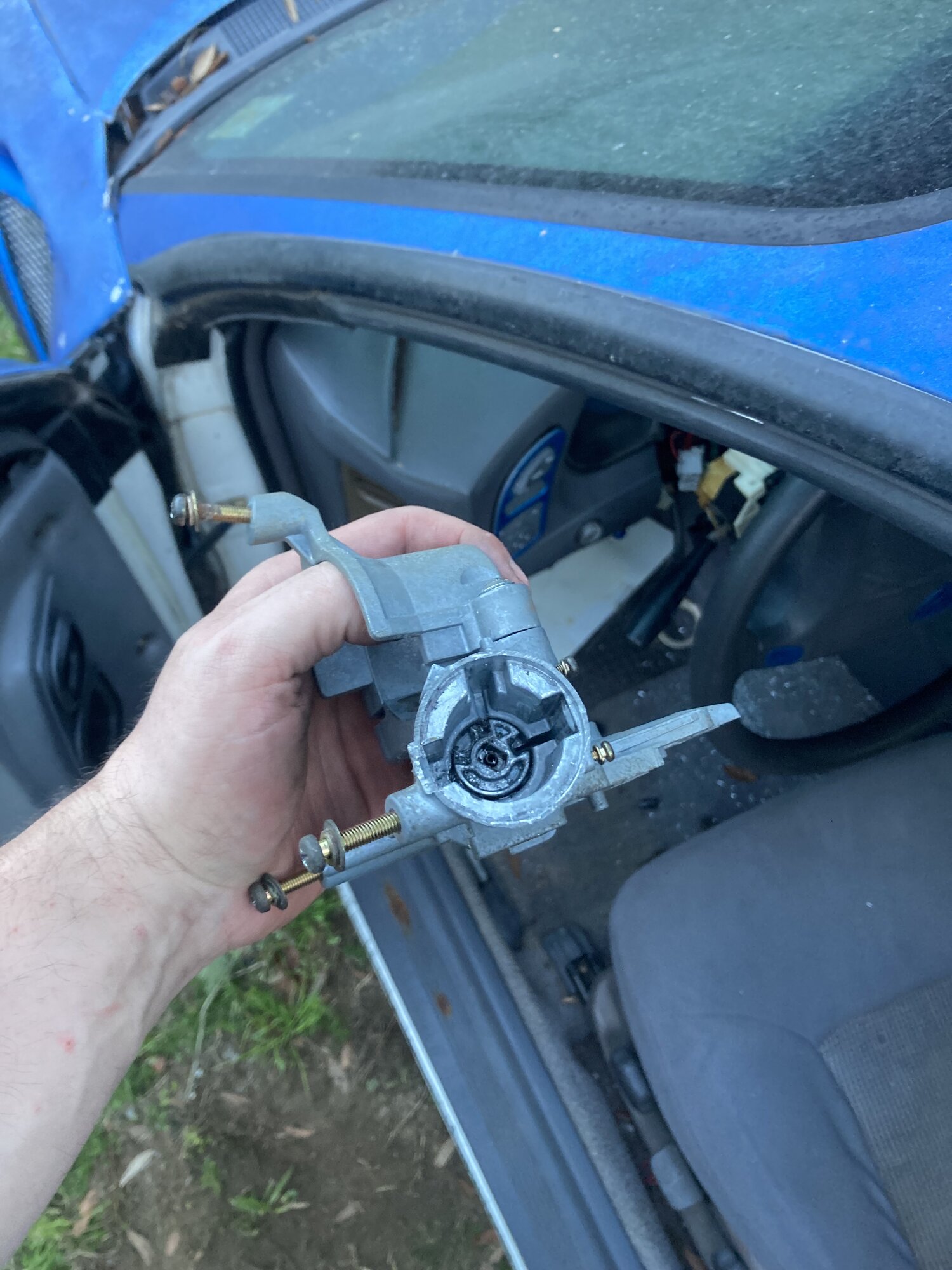

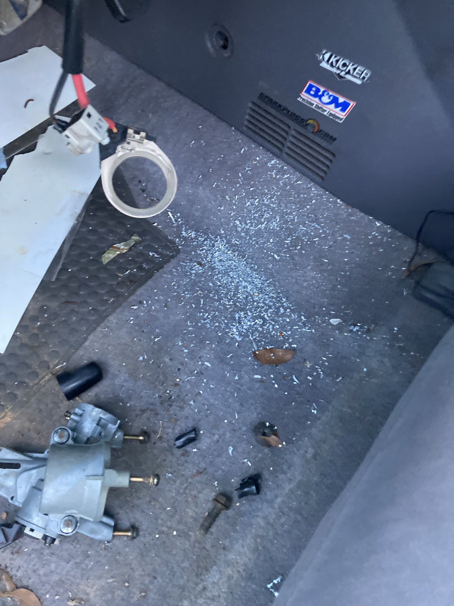

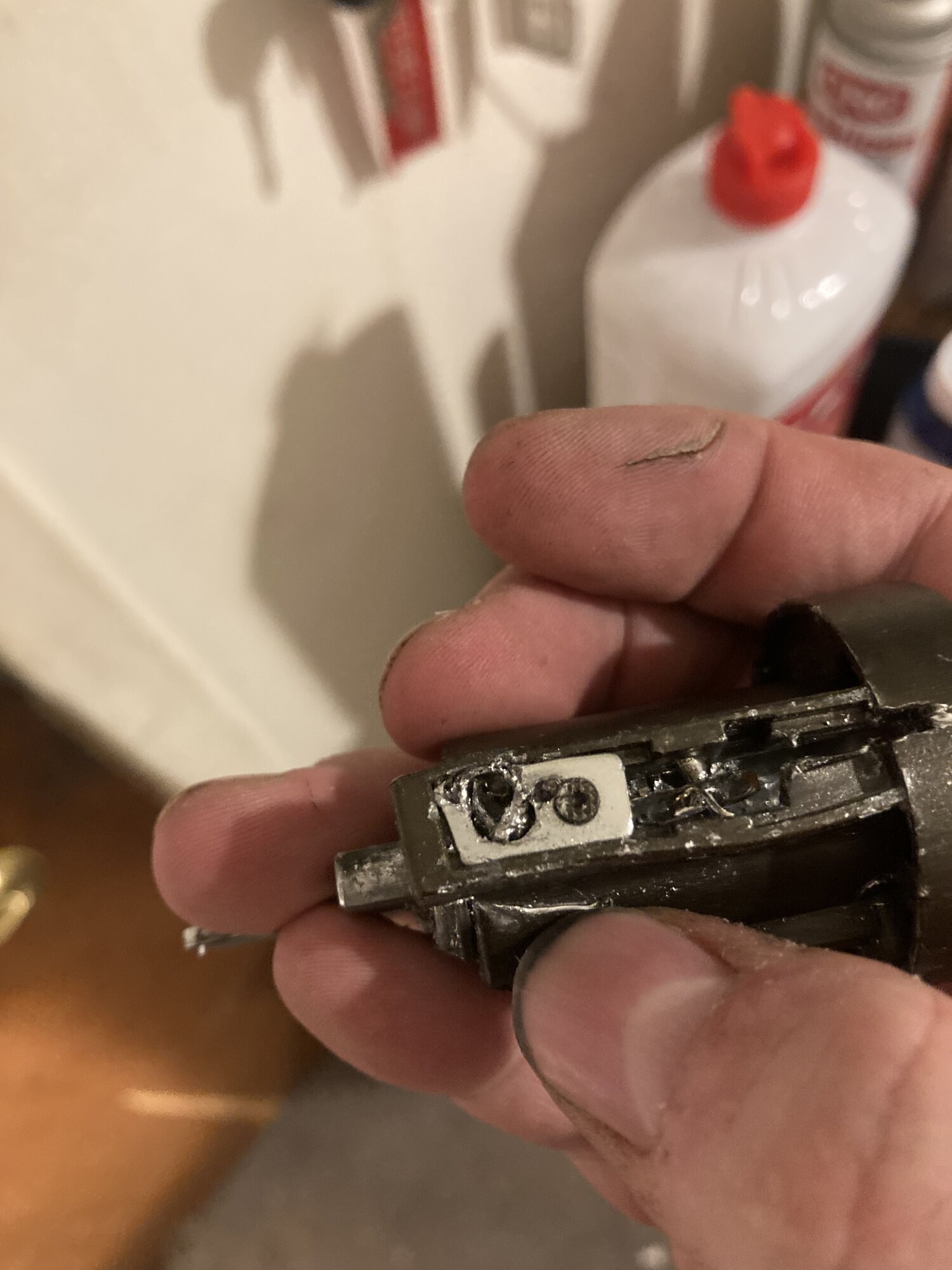

Secondly...I tried the drill. Google said drill it, so did a few people here when I searched so I tried...again, it laughed off my attempts. WTF, is this thing made of? Is it indestructible? Finally after almost giving up, I dropped the housing like Solomon said...this made the job an absolute breeze. It still resisted me, but eventually it popped out and now I have an undamaged housing that's ready for a new lock cylinder and key. This is what was left behind...
This was the lock cylinder. I am tempted to frame it out of respect for it's wherewithal.
Honestly, this is the second time I have had to do this. I think if I ever am cursed with doing this a third time, I'm immediately dropping the housing and just either buying a bare one on the webs, or do what I did in the beginning. Punching the little button out is the play, the problem is my punch was too small and kept mushrooming the button. On a bench, in a vise, with a perfect punch I could have it out without a key in probably 15 mins, including removing the housing from the steering column. But regardless, here's victory! Still need to clean it a bit.
God these cars are fighters, man. But, yeah.

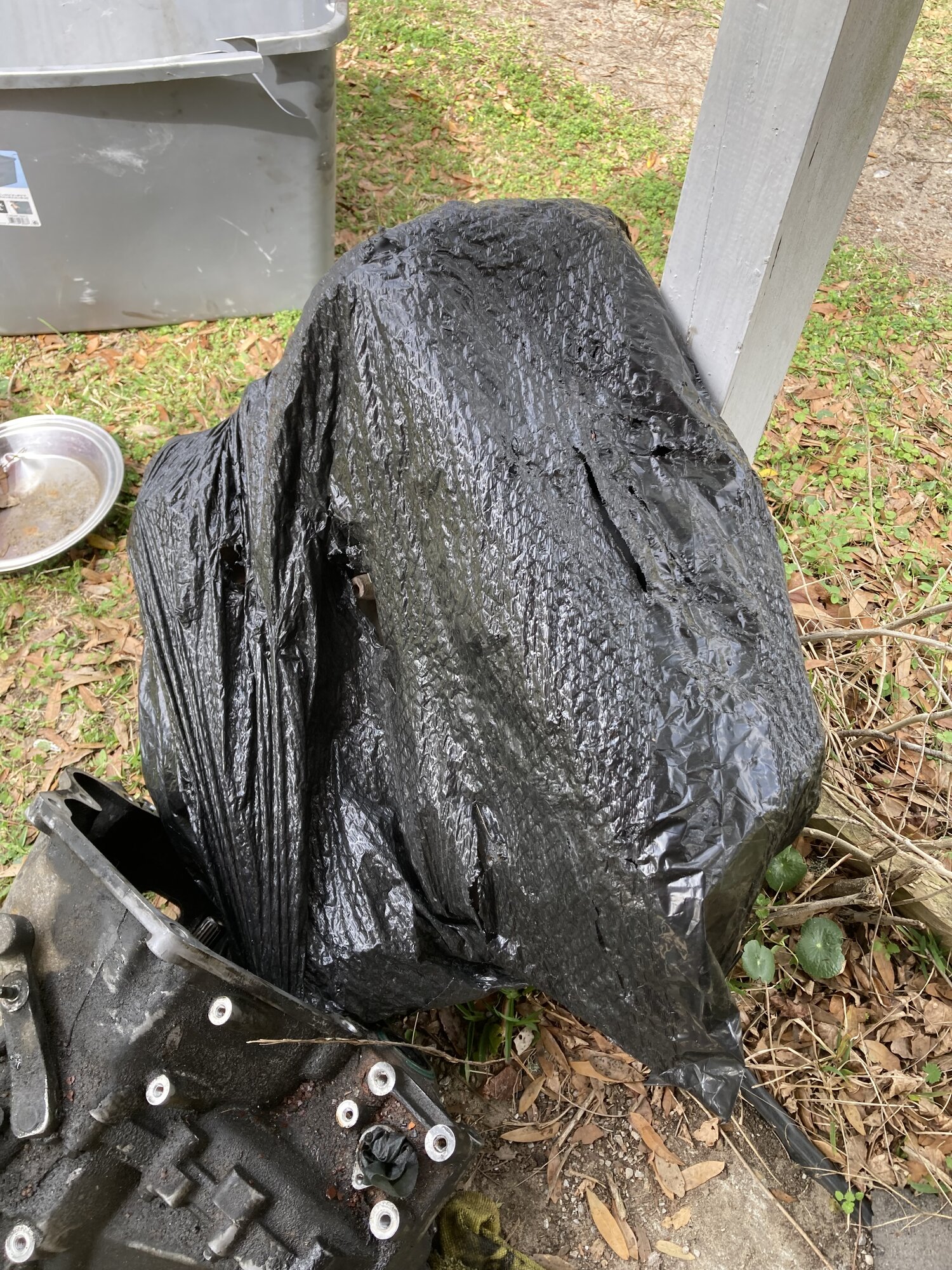

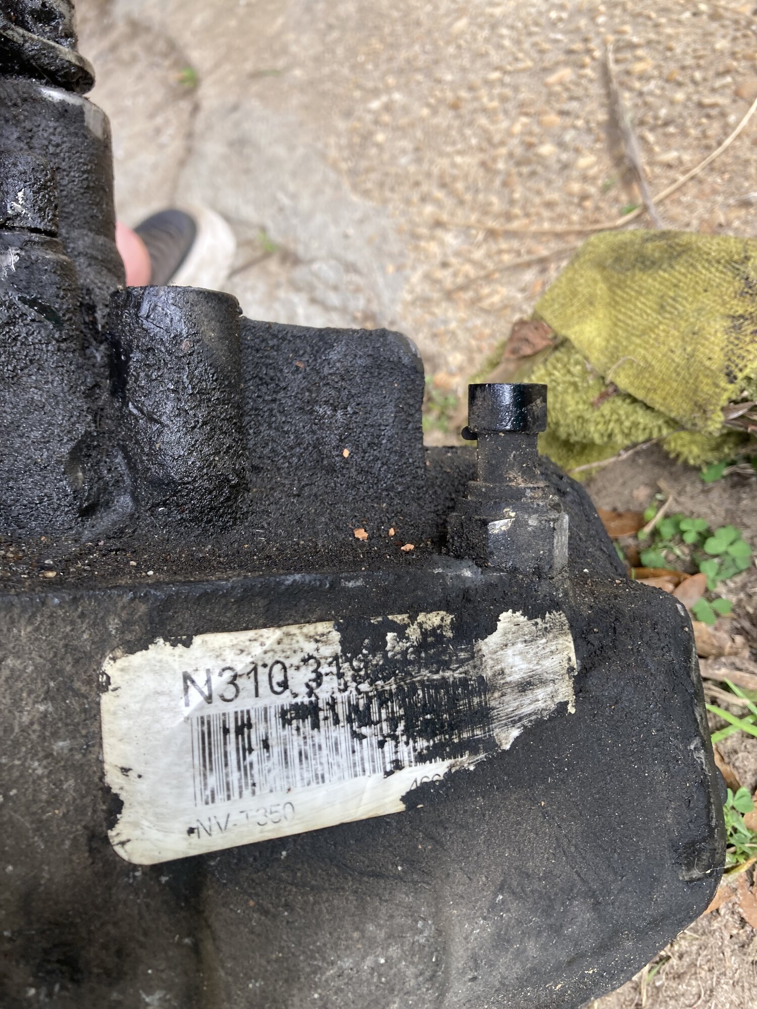

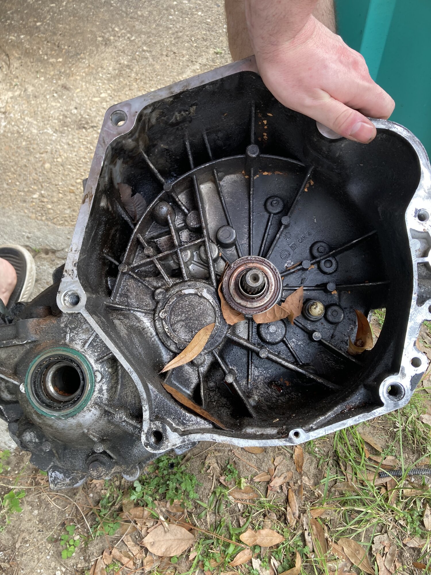

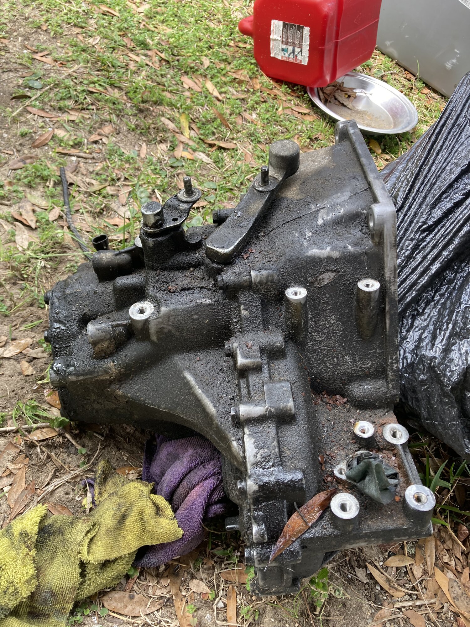

Also: I have confirmed it's the transmission I need and the proper engine. The engine picture is lame because I bagged it up immediately...but behold the dirtiness!
The transmission is dirty because the OG owner threw two rods through the bolt on a big turbo setup. So I plan to clean it up, paint it, and reseal everything that has a seal on it. Make it shiny new.
Here's the bag of 420a. :p
Stay tuned fellas. Hopefully it'll start coming along soon now. Can I just say, god the 420a is a heavy engine to move and lift by yourself.

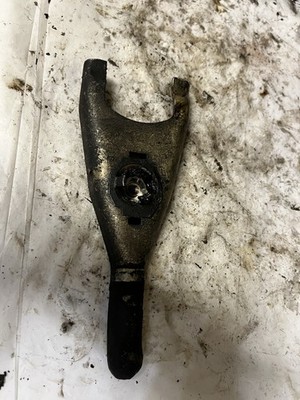

If anyone has a line on a used clutch fork for the 2G 420a please send it my way. I just can't swallow dishing out $75 for a new one.
How about this?
My issue with that seller is he's shady AF with his prices. Look at some of the "shipping costs" on some of his items. He has a PS pump for $29 but shipping for $70 extra. Even at 35% off current sale price with that shift fork, it ends up being like $65 after taxes and etc for a used fork. I can get a brand new MOPAR fork for $75 shipped/taxes included.

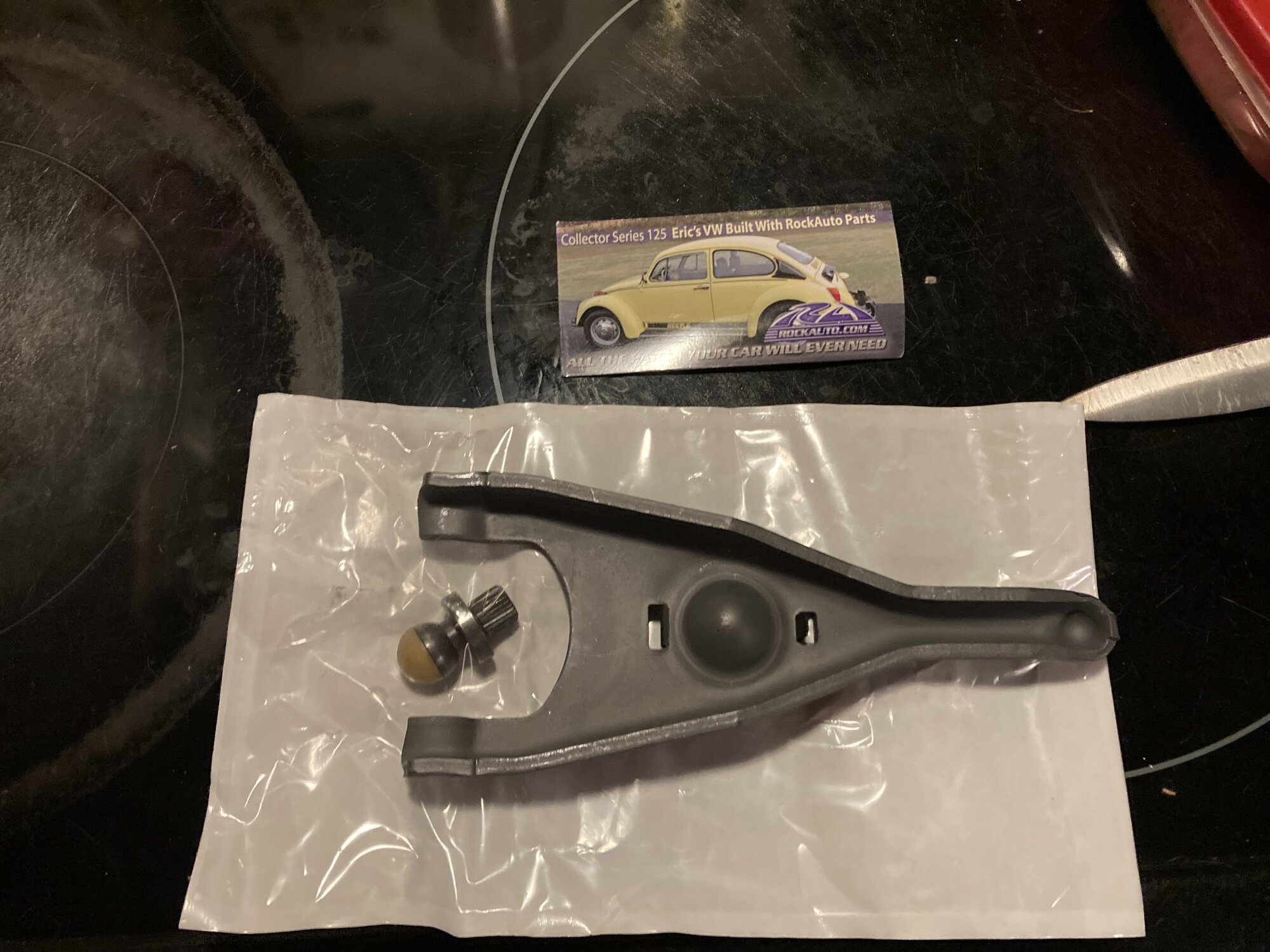

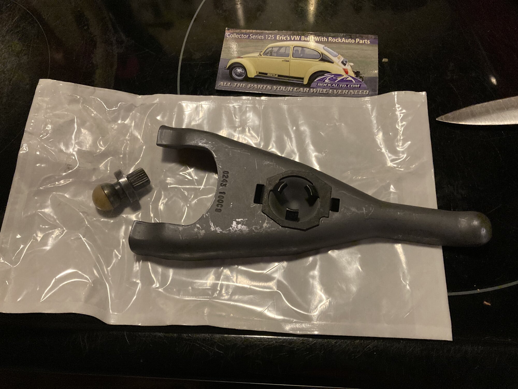

Got an email from RockAuto that they restocked the MOPAR clutch fork for the PT Cruiser. Ordered it and got it basically for the same price as what the guy wanted for a used fork. Comes with new pivot ball too. Score.

Ridiculous how much I had to pay for this $20 piece of metal. LOL.
But it’s OEM mopar so that’s cool. Clutch should be in soon, and I’ve got the axle seals brand new that I need.
