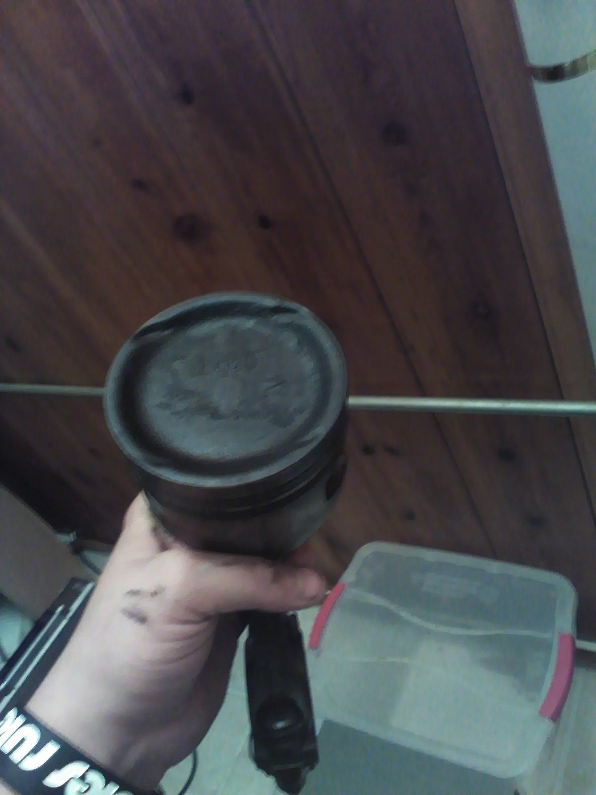

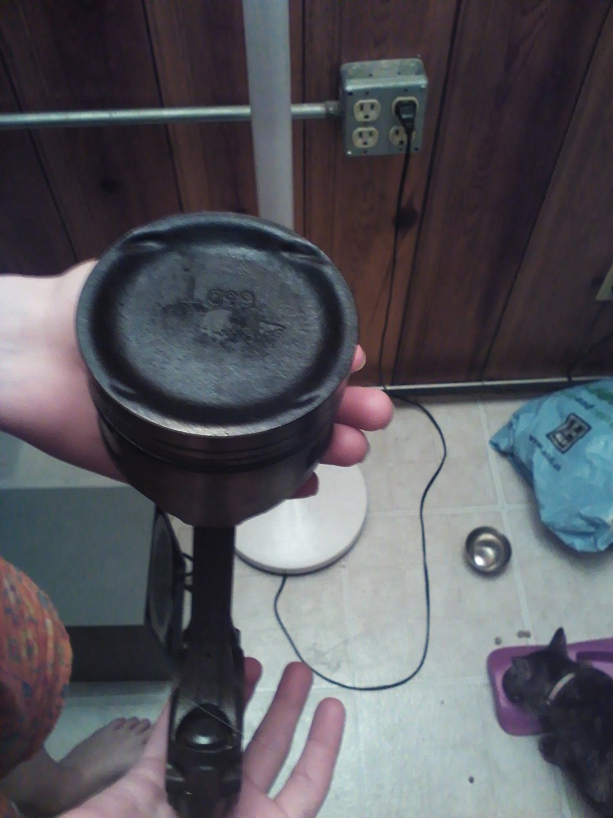

So are gears sorter on the pt cruiser. And I got a question if any of you guys would know I have 4g63 evo4 Pistons and rods I was wondering if you guys would know if they would work or not the evo 4 was 2.0 and do you guys know the ratio of the rods cause if just pistons work for it that would be awesome

4g63 parts won't work in 420a motors. They're completely different. You should start your own thread.
There are some differences for the gears on the transmission. I don't have the exact numbers but I know the casing and gears themselves are stronger and it also puts out roughly 30 more ft/lbs. torque. As for the pistons no it will not work in a 420a(if you can find proof that it can I would love to see it as that would be a new upgrade path for us N/Ts). There are countless threads all over the internet stating this. As for going 2.4 srt vs 2.0 the amount of work you would need to do(mount fabrication etc.) outweighs the cost of building the current motor. Yes you may end up with more power but at the same time its going to cost alot more. Back to pistons, you can see if some companies will custom make you some pistons(I forget which ones but it has been done fore our motor before). http://realstreetperformance.com/Sh...s-Eagle-Rods-Combo-Dodge-Mitsubishi-420A.html that is an example of some pistons you can use(you have 2 options with compression 9.0:1 and 10.5:1)

Haha sweet but ima do some research on them 4g63 pistons cause the ones I pulled from the 92 tallon and they look completely the same as the link u sent me
Theres a chance you may get lucky but use rods from a 420a so you have proper clearence. Definitely get them cleaned and the bore may be incorrect. Let me check the book real quick. The bore i definitely different. the 420a is 87.5mm x 83.0mm
The 4g63 is 85.0mm x 88.0 mm. Im sorry to say there is not proper clearance.
