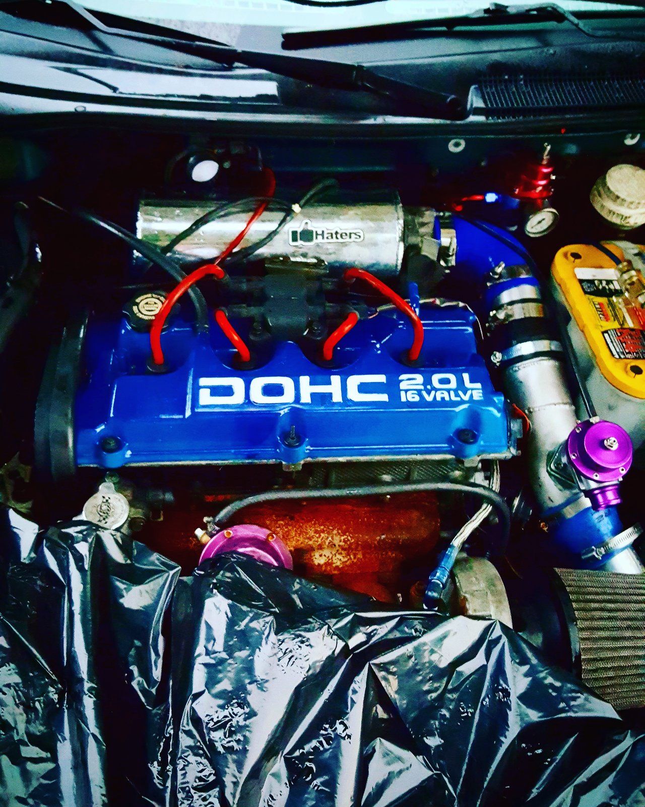

Where are the 420a Tuners at I'm building a 420a yes I know it's pricey but If you got the cash to get it done it will be done I'm trying to Achieve 400-500whp where should I start first on my build I'm thinking about the Status 2.4 block with 420a head

Yrah that's the thing I'm completely building the hole block and head only thing that is staying stock is the crank
