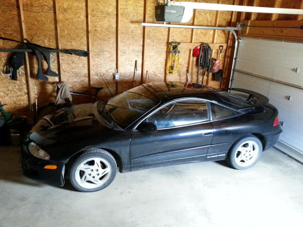

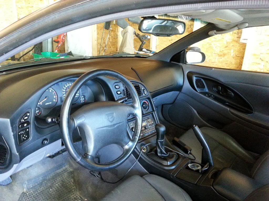

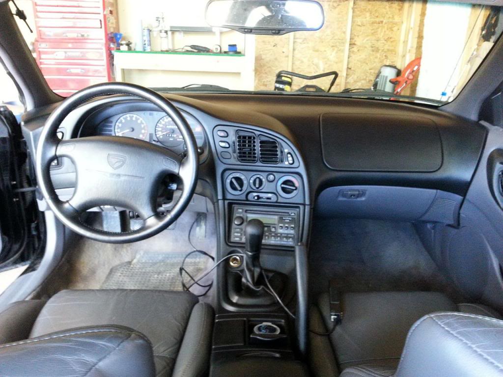

Pictures speak a thousand words! Here is some pics of the interior as I have it not black/grey. Will be black/tan soon. It's pretty much mint minus some dirt on the floor. I've also decided that it will be resprayed Subaru's Plasma Blue Silica Pearl. I've included a photo of an STi painted that color on the bottom.
i was like dafuq subaru? that's a nice dark blue. I want to paint mine the darker blue found on the newer mitsus

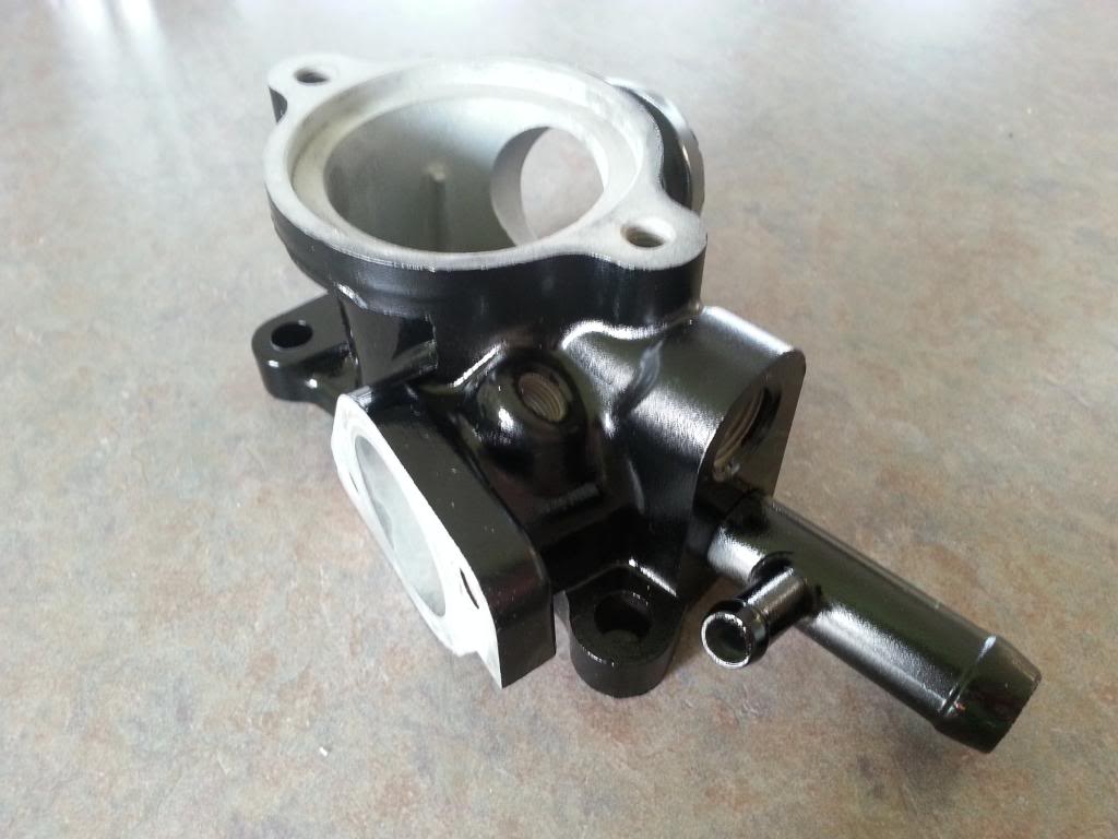

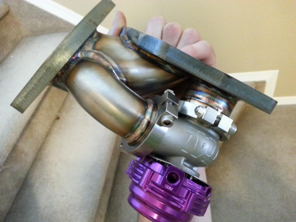

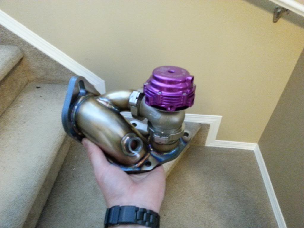

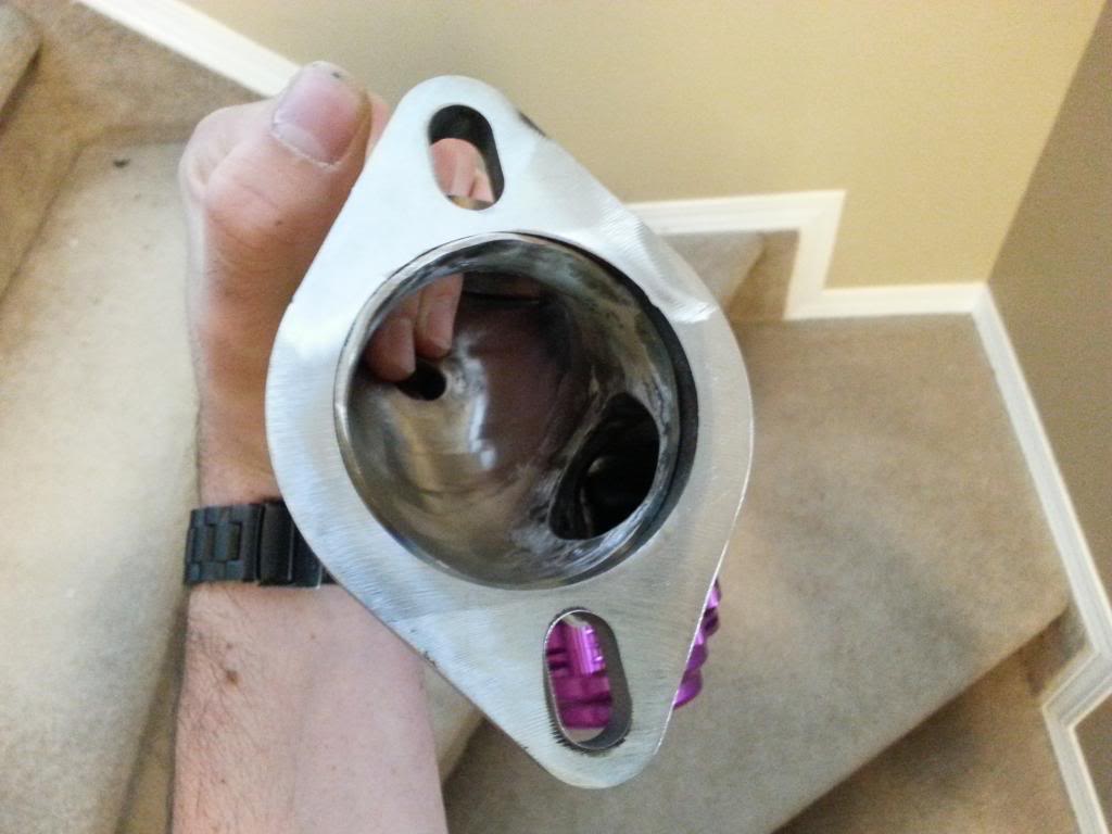

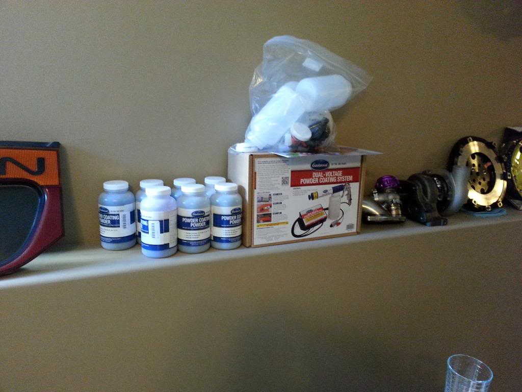

So I purchased a powdercoating setup and am picking up some more parts tommorow! Pictures again soon and I'll also post some pictures of some attempted home powdercoating.
Joel

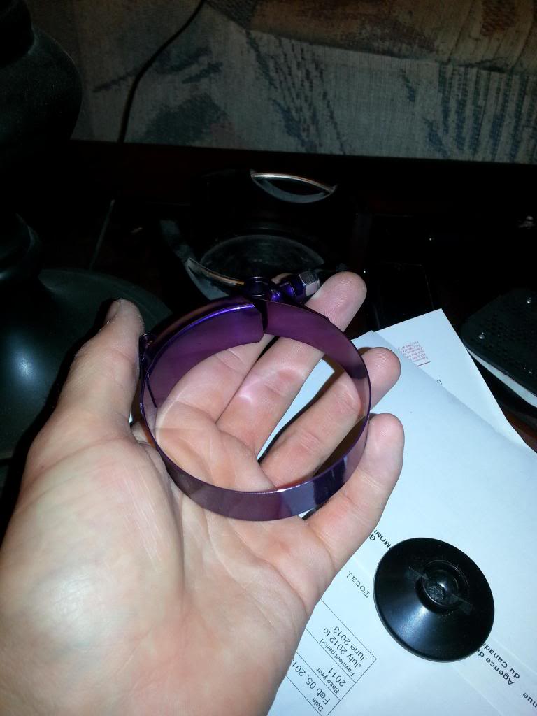

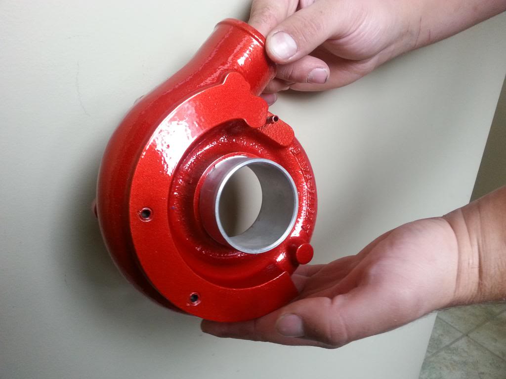

More stuff! Including a test T bolt clamp I powdercoated. Pretty happy with it. Lots of practice ahead :).

I think i can say this for everyone, but i get so excited when i see picture links in my email notifications! great project and powder coating
Thanks Sirbow. I ordered another whack of parts so more photos will be up soon along with photos of the tan stuff I got. Build will commence on my week off coming up here after I finish getting the garage insulated and poly'd.

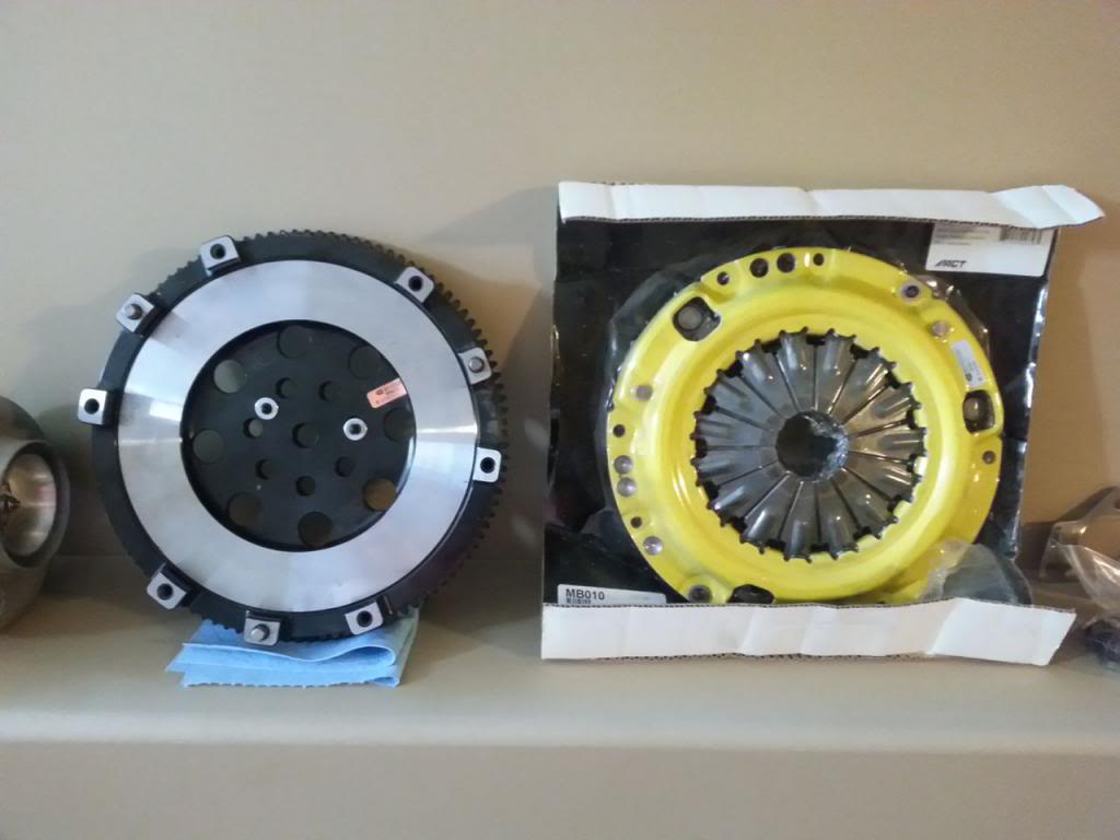

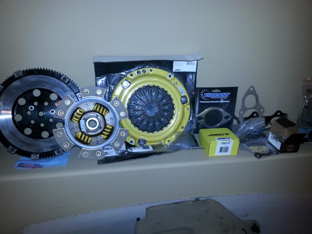

I think for your goals you might want to reconsider that ACT 2100 clutch, to get into 11's you'll be pushing its limits on a full weight car. It'd be a lot easier now to change it than when you find out it slips.
The general consensus is also that the OEM tob is better choice.
Thanks for your input jdnxc, it's definitely been one of the thoughts on my mind of whether or not to go to a 2600 or not but on paper the 2100 with the 6 puck should do what I need.
The car is mainly going to be used for autocross and street, not much drag and I wanted a lighter clutch. The 2100 with a 6 puck is rated to hold 415 tq while having a lighter/easier to work pedal and less stress on the crank (that being said, I have a revised split thrust bearing engine so I'm not that concerned about that in particular). I'll be at the top end of it's rating but like I said on paper it should work.
Who knows though, by the time the engine goes back in I may convince myself otherwise haha.
Joel
Ya if you don't do a lot of launches that config might do alright for you.
I guess I'm a little biased against ACT clutches, I've seen so many locals and elsewhere with issues, broken fingers on the PP's and stripped splines on the puck disks. But then again, some people swear by them.

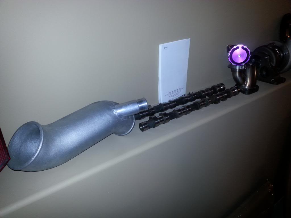

Photos!

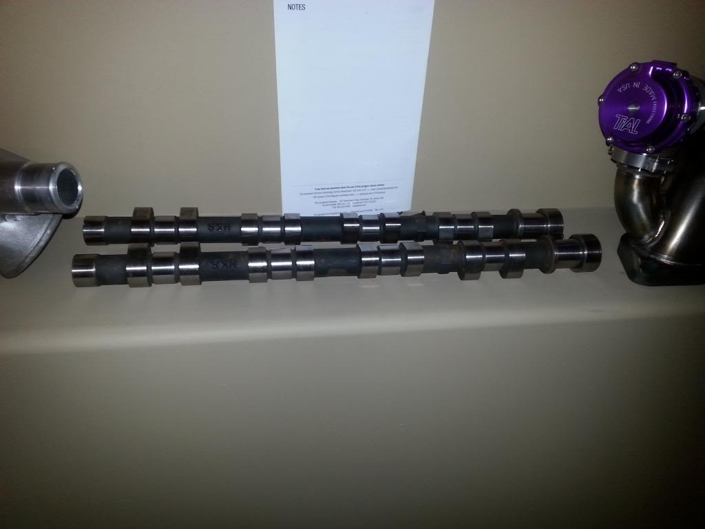

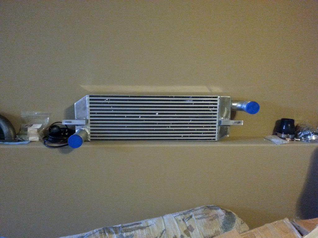

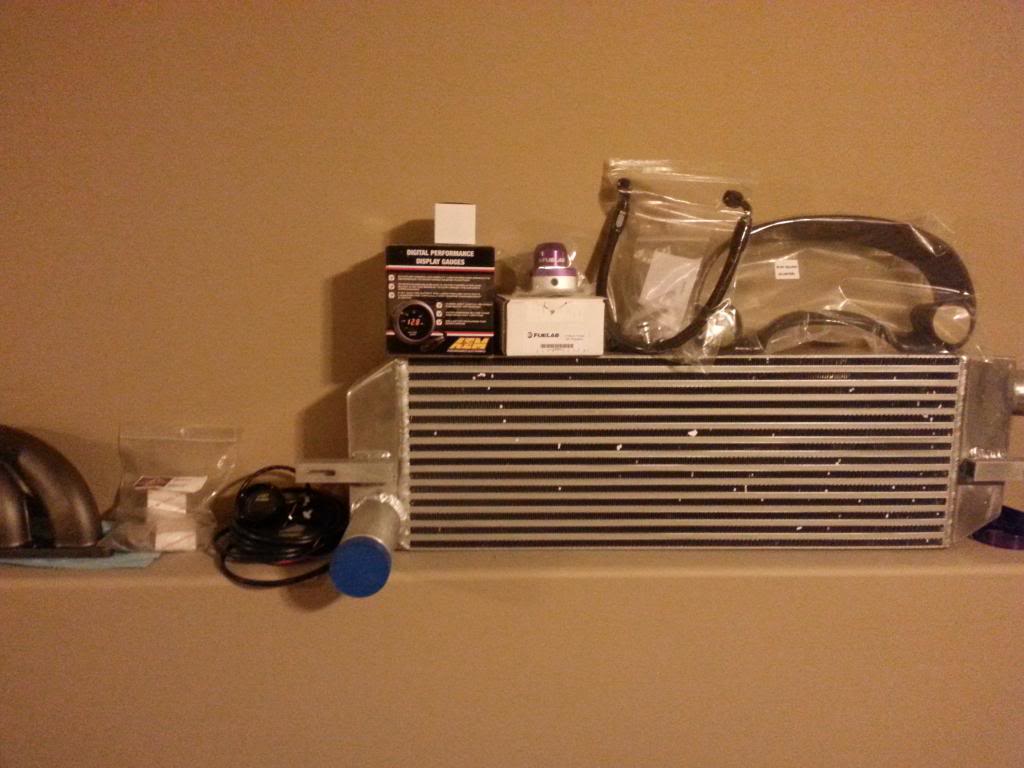

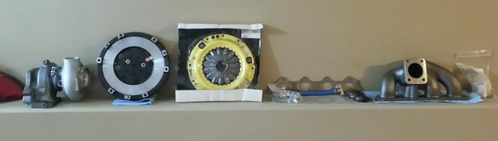

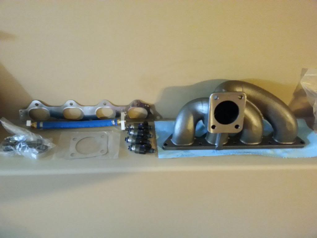

Here are some more parts I've picked up, HKS cams, FP intake and some misc items. Also more pictures of powdercoating. Practice, practice practice!
Engine should be out of the car next week. Still debating on building or sticking with the stock block though.

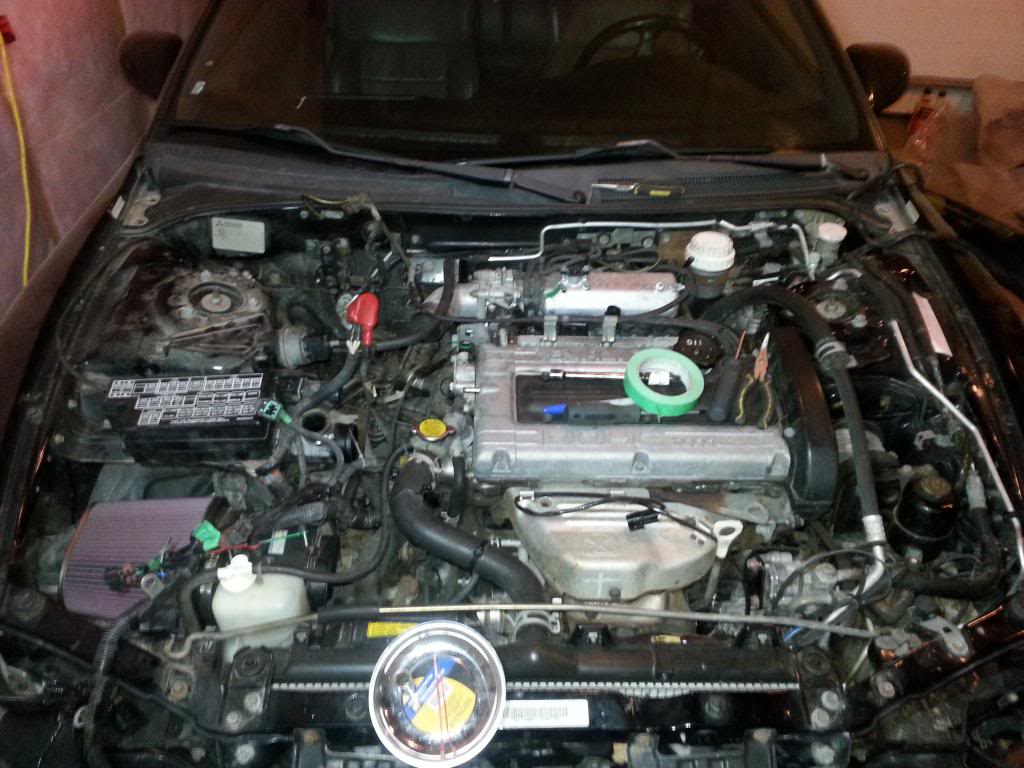

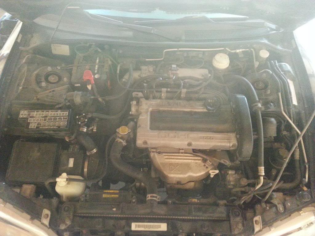

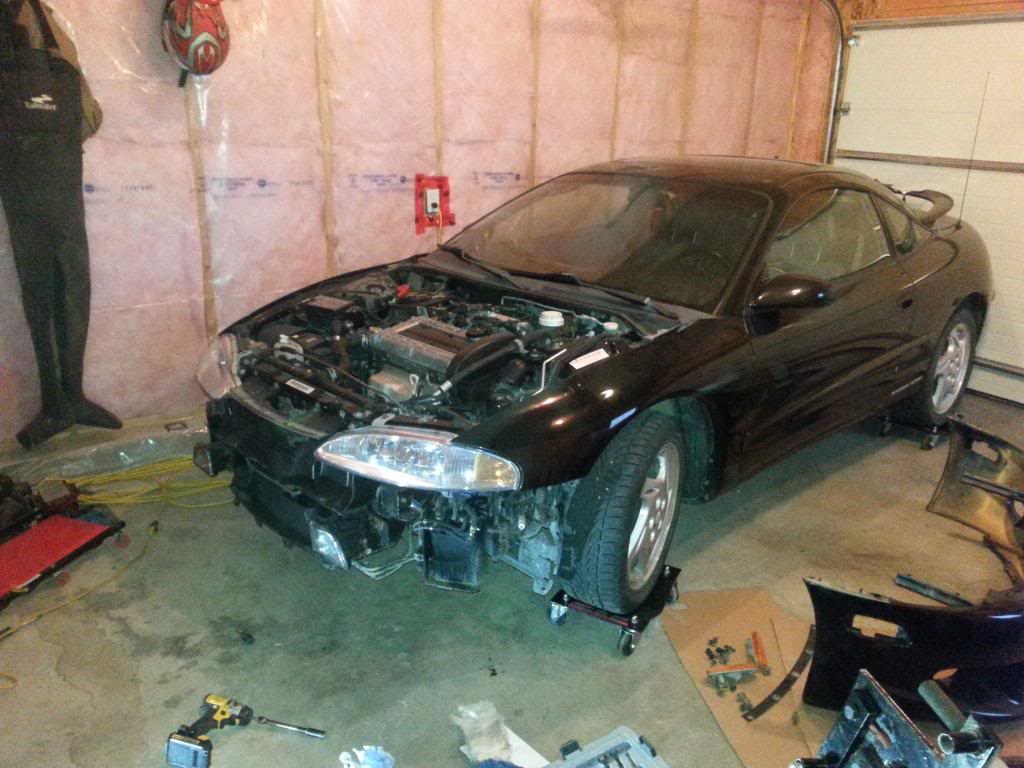

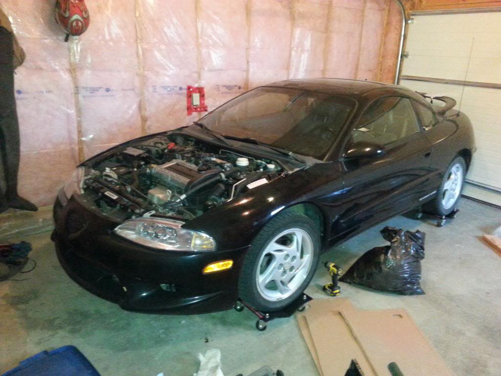

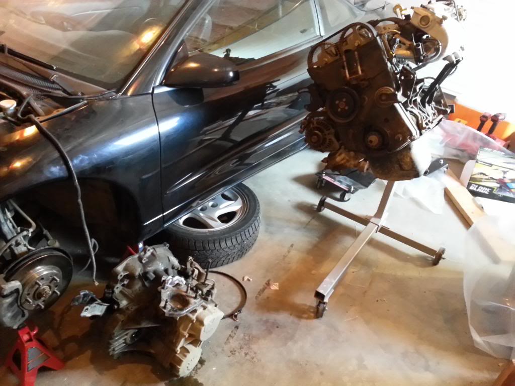

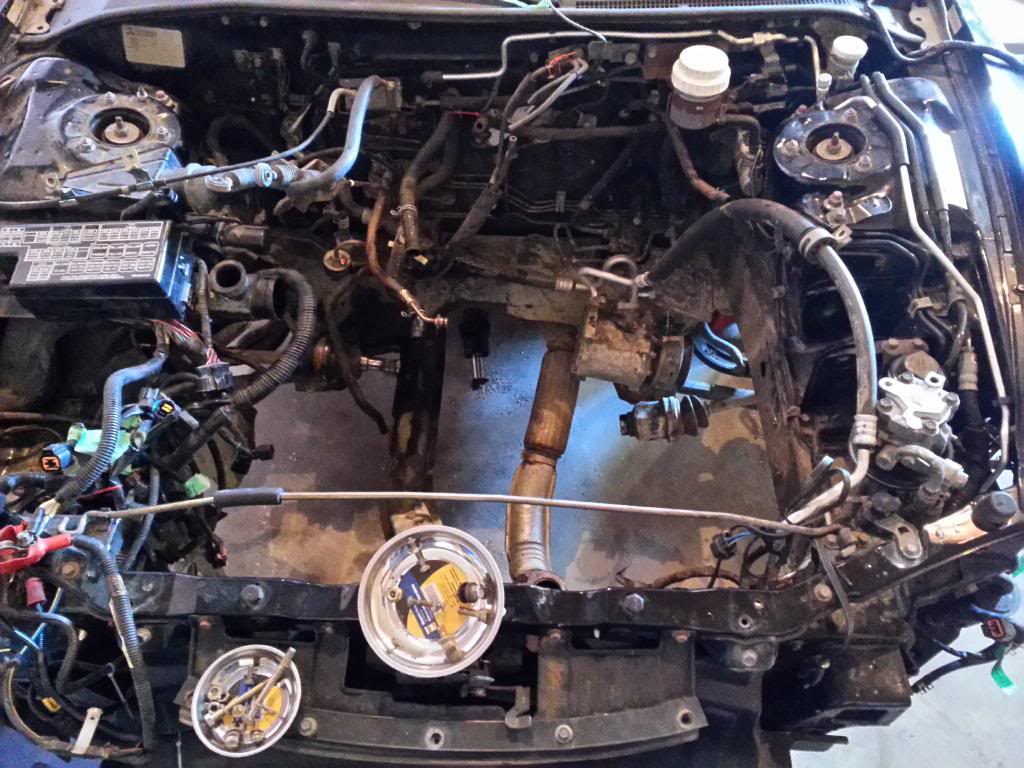

Snow is flying once again and that means one thing! So it begins! :rocks: Got the hood/headlights/bumper wiring harness all disconnected from the engine/trans and started removing the auto starter that was in it :barf:. Man is it nice having a vehicle with such little rust. Bolts come out sooo easy :)
Engine will be on the stand tomorrow.
Pics of course below:

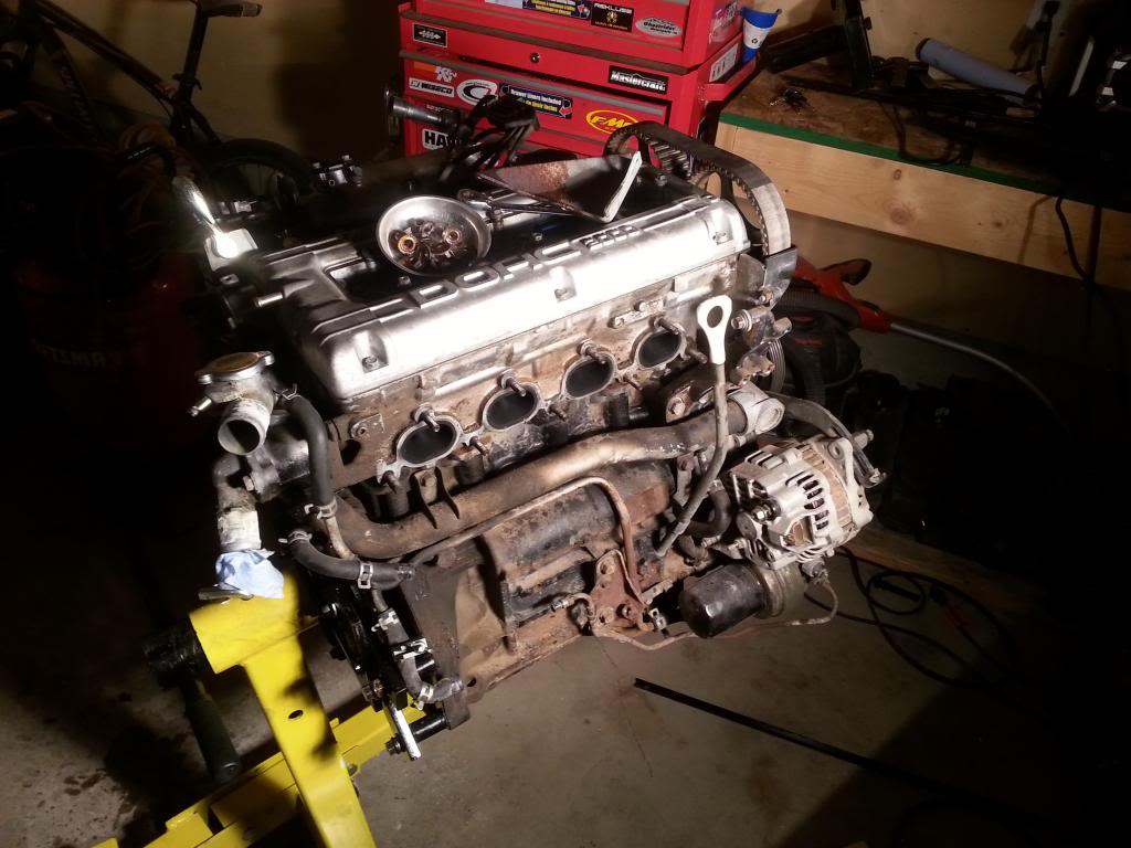

I didn't take as many pictures I anticipated, I kinda just started rolling with it. Engine is out and on the stand now :) Up next is stripping the bay and painting it, then stripping the interior and painting the exterior. Fun fun.
Pictures for your viewing pleasure:

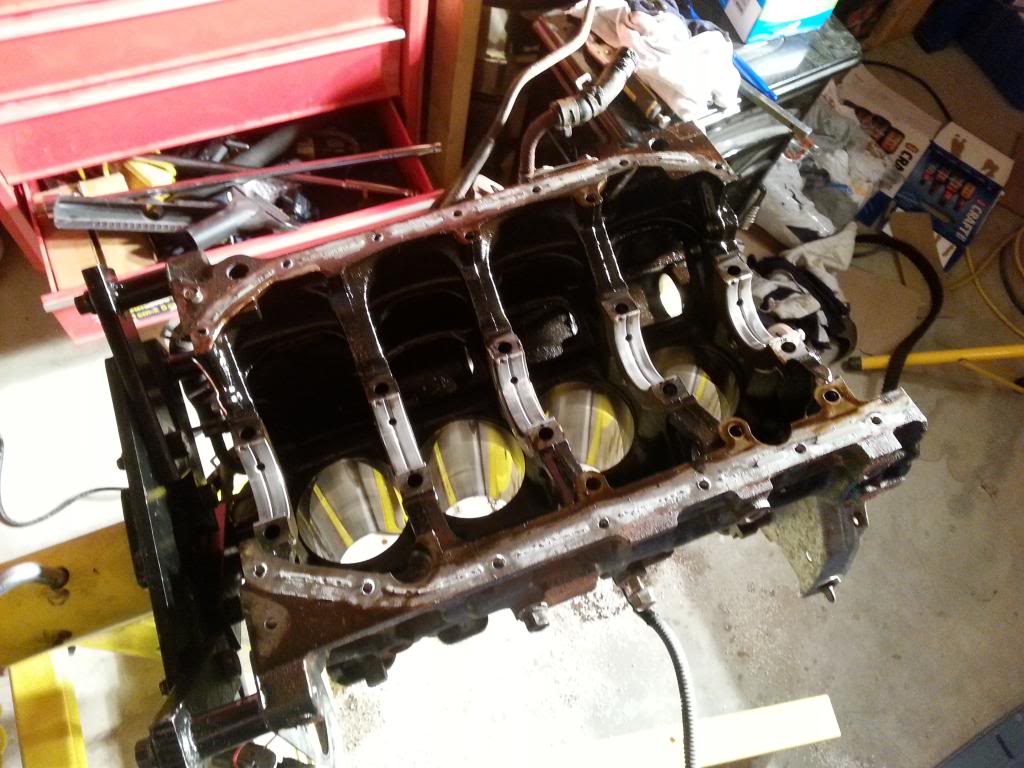

Been a few weeks now, got a bit more done. Extremepsi's black friday sale got me going a bit and I've now decided I'm doing a bit of a build on my engine... :)
Got Weisco pistons, Eagle rods, ACL bearings, ARP head studs and a few other goodies!

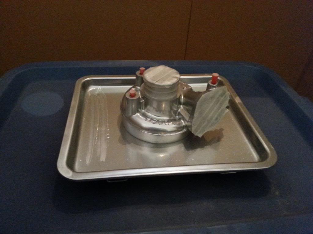

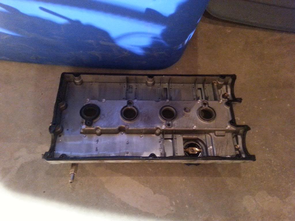

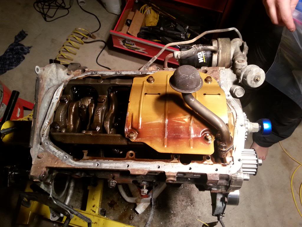

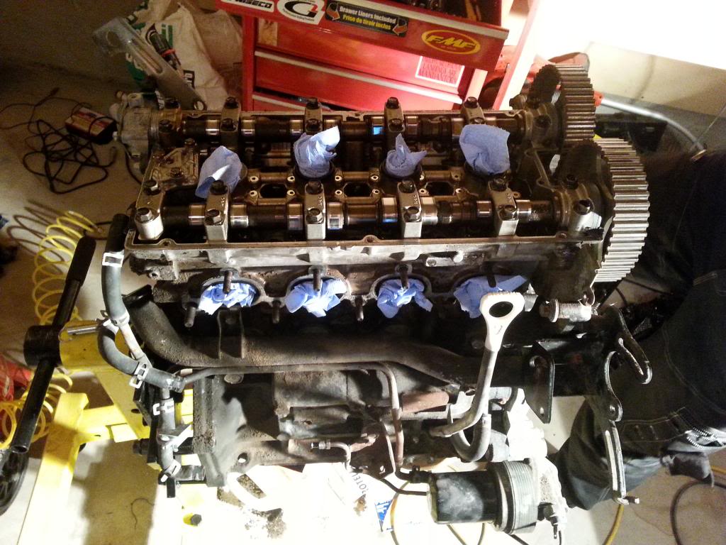

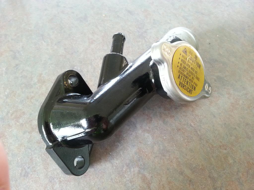

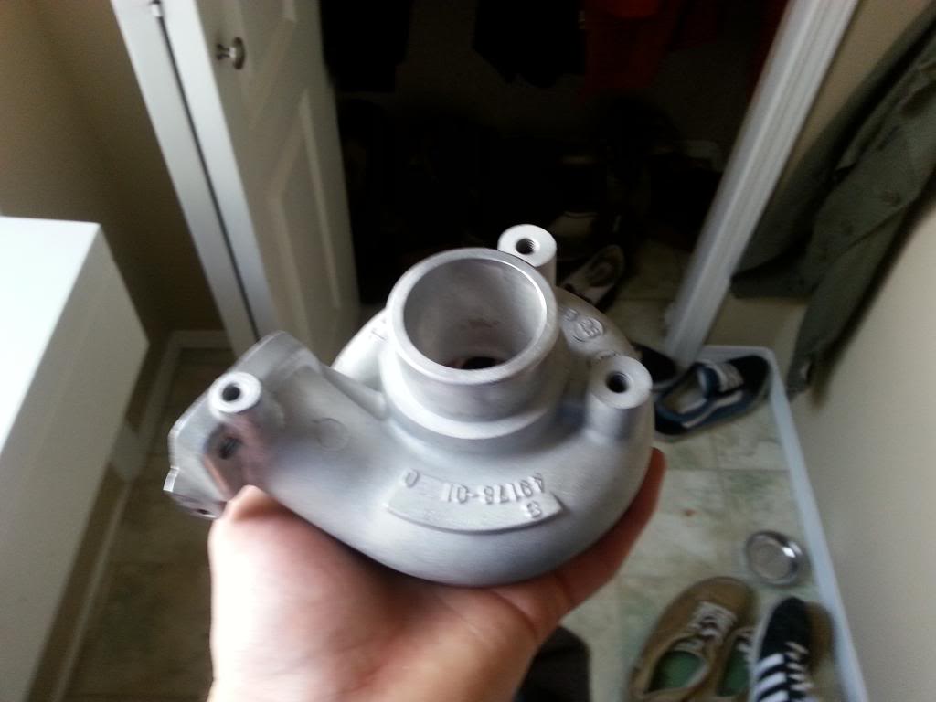

Onto photos! Could not believe how clean the inside of my head/valve cover was. Also since some of my other parts were so dirty, I started sandblasting/powdercoating them.
Also included is a fancy trick on removing your crank pulley without any special tools.

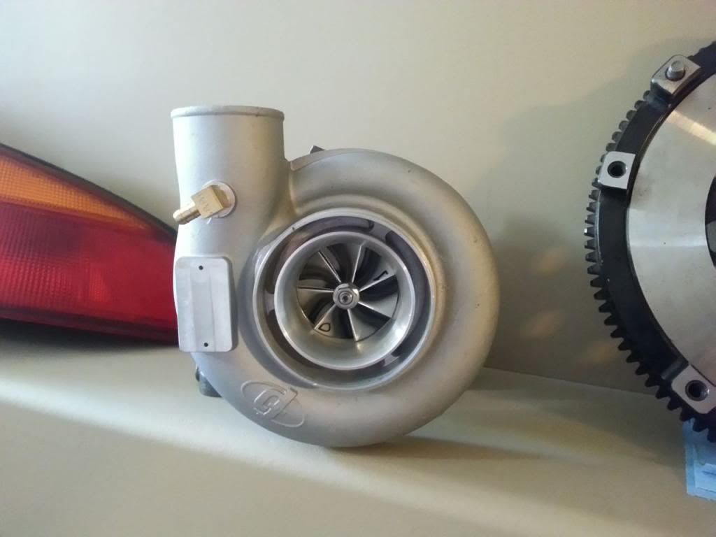

Long time no update,

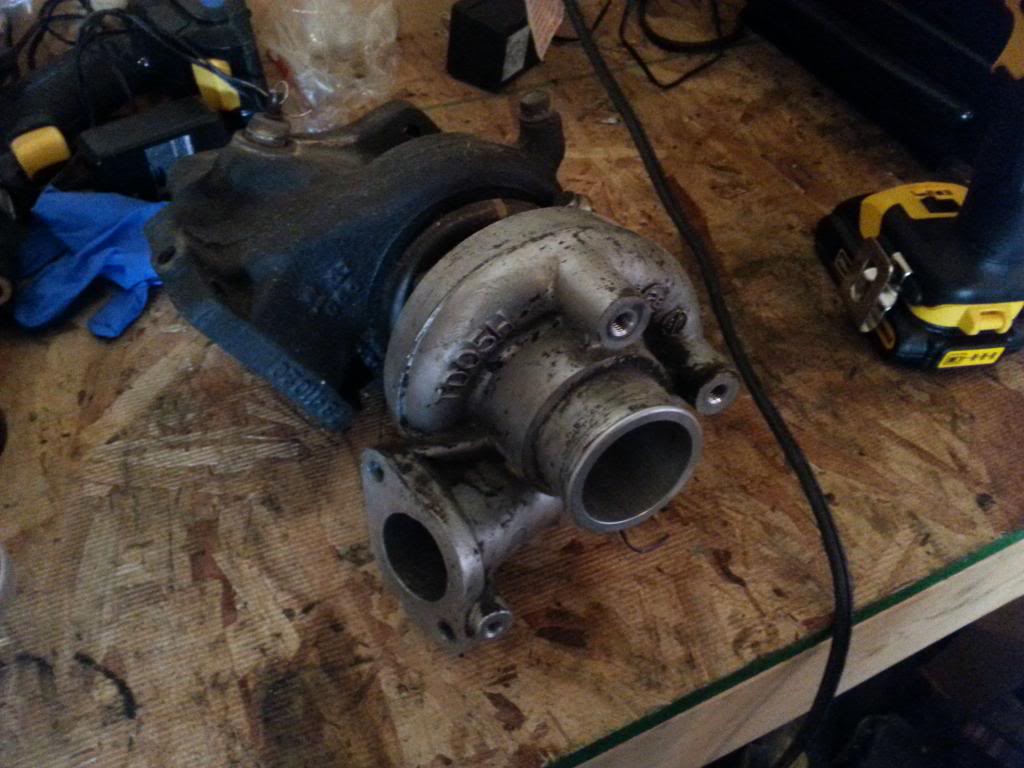

I've been crazy busy with work/school over the last couple months so I have not gotten a whole lot done. I've started to remove the interior, got the engine to the machine shop which I should be picking up tomorrow. Turns out my crank is cracked so I'm on the hunt for a new one now.

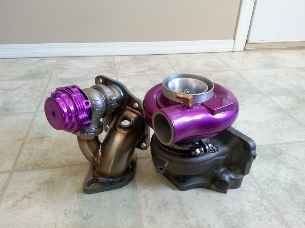

I did get my turbo powder coated though. I really gotta start picking up my socks and getting on this otherwise it won't be ready in time for July.
