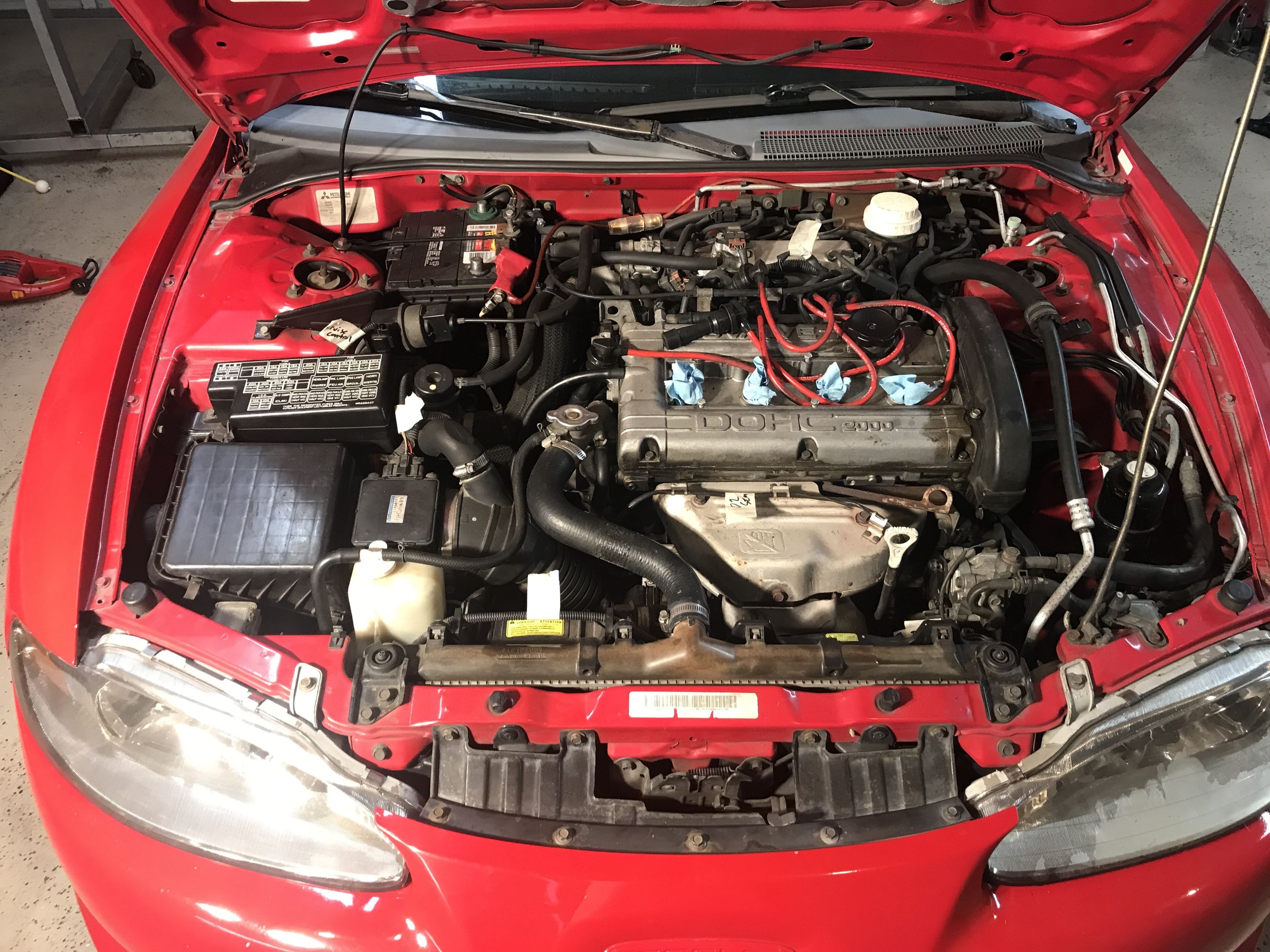

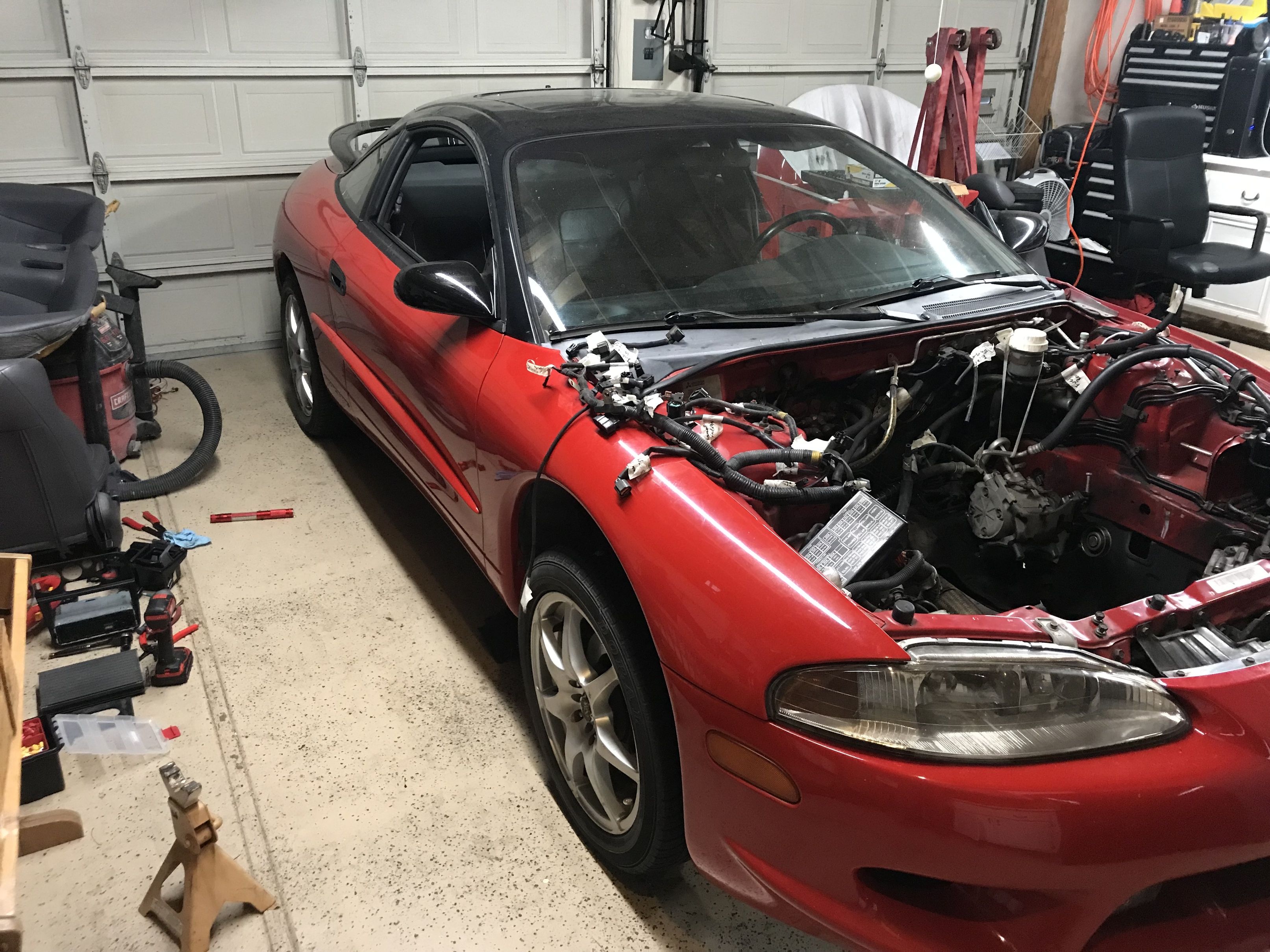

Picked up the Talon mid July as a project to throw some mods on and have fun.

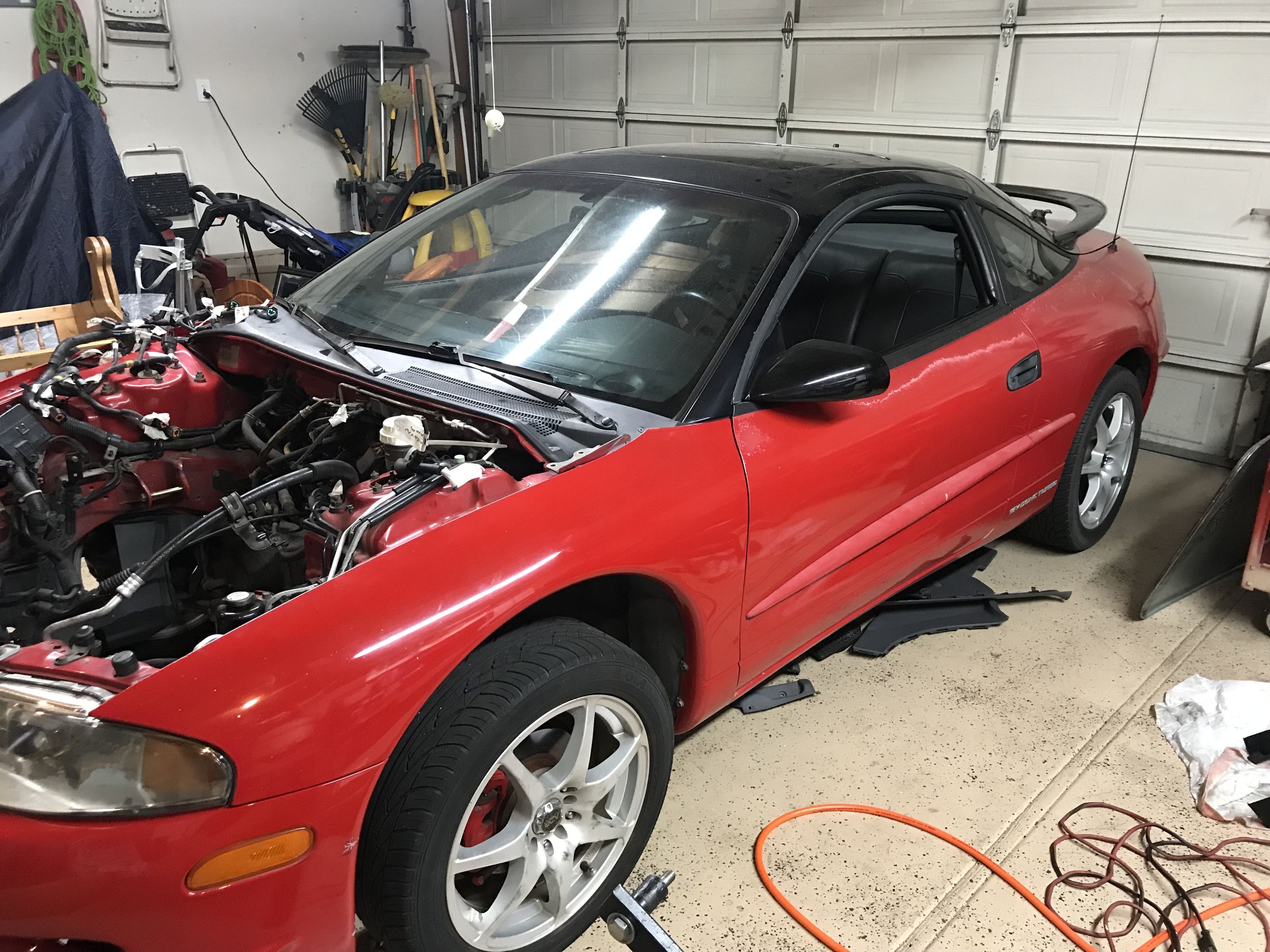

I knew the care didnt pass CA smog, but figured I could take a look and fix this issue, Well when I dove into the paperwork and car noticed it was considered a gross polluter, so I ended up doing a compression test to check the health of the motor. Unfortunately it was reading 70 PSI on cylinder 2 and after performing a wet test and it raised about 50 PSI I figured it was going to be the rings.
I tore into it and pulled the motor, trying to keep track of any missing bolts and parts and to my surprise the car was all stock with very few things missing. Long story short engine and trans are out and the block and head are off to the machine shop to get a look over and hopefully I will be back to reassembling soon.
I am sure I will have a ton of questions (some stupid) while doing this, so I am glad to have this awesome community to go to. Looking forward to chatting!

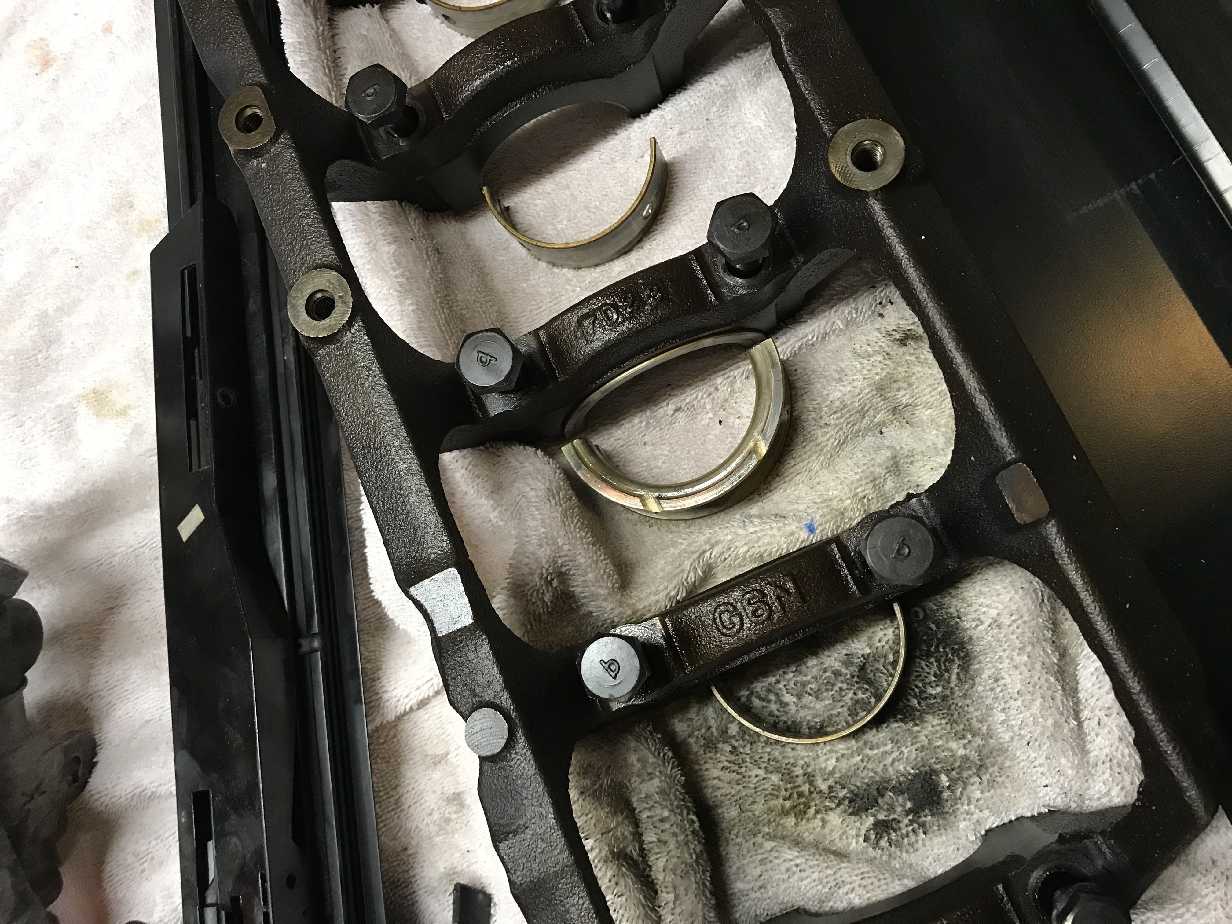

Feeling pretty good just running into a question with the thrust bearing.
My understanding is 97+ came with 3 piece bearings which was basically a main bearing and 2 thrust washers.
However when I pulled everything apart it looks like this is the 1 piece thrust bearing style. I have no evidence to think this motor has ever been torn into and replaced so I guess I’m wondering if the 97-98 years came with either option depending on the build date.

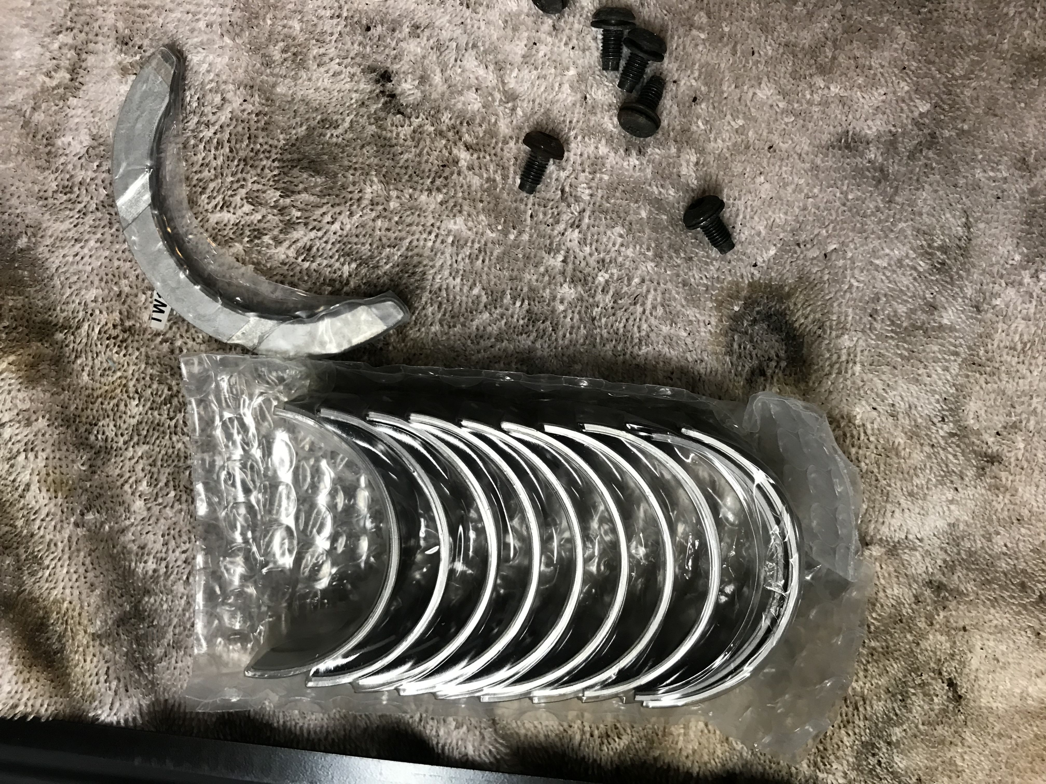

I ordered parts and this is what came which is the 3 piece for 98s. I think I will need to post in the tech forum to get a response.

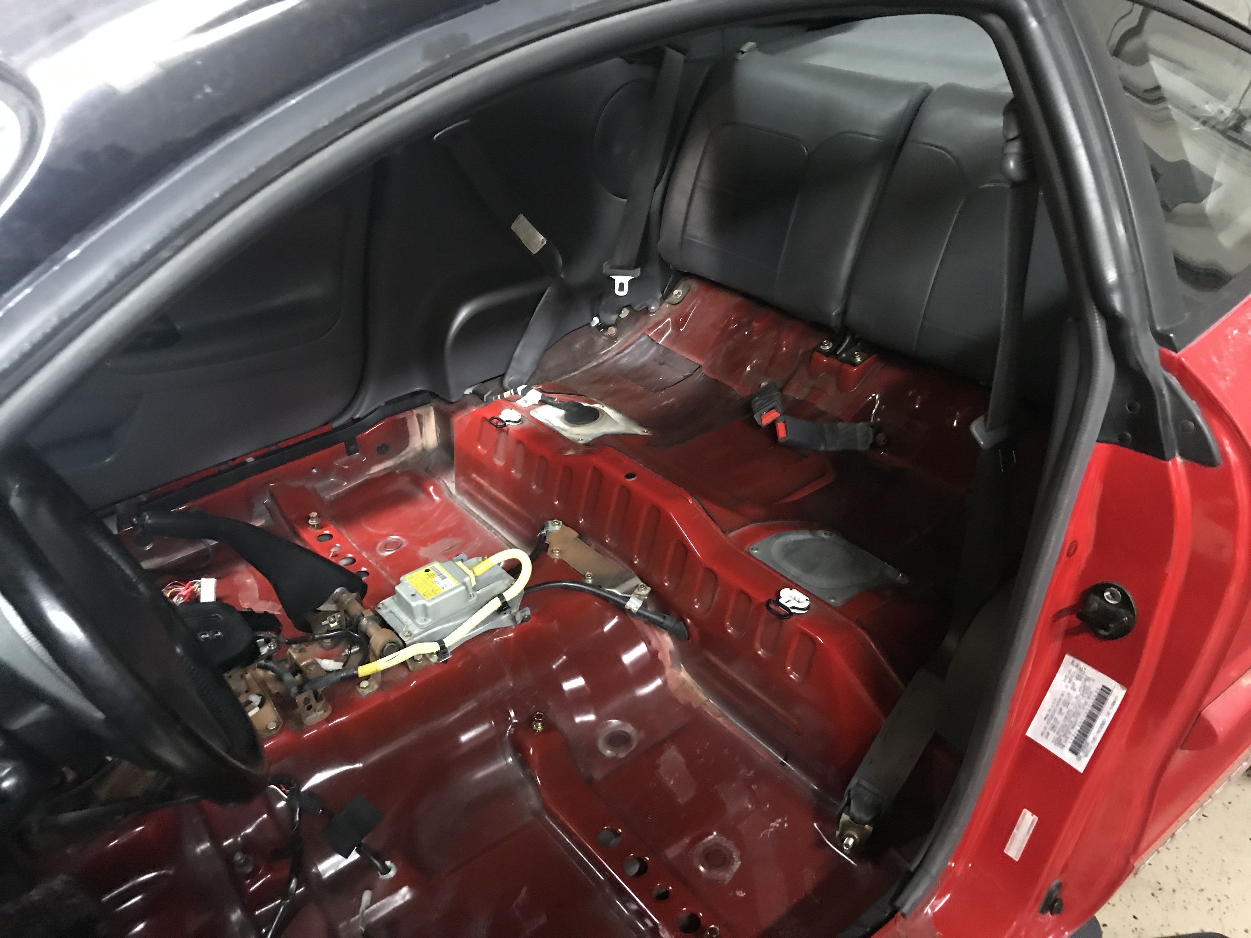

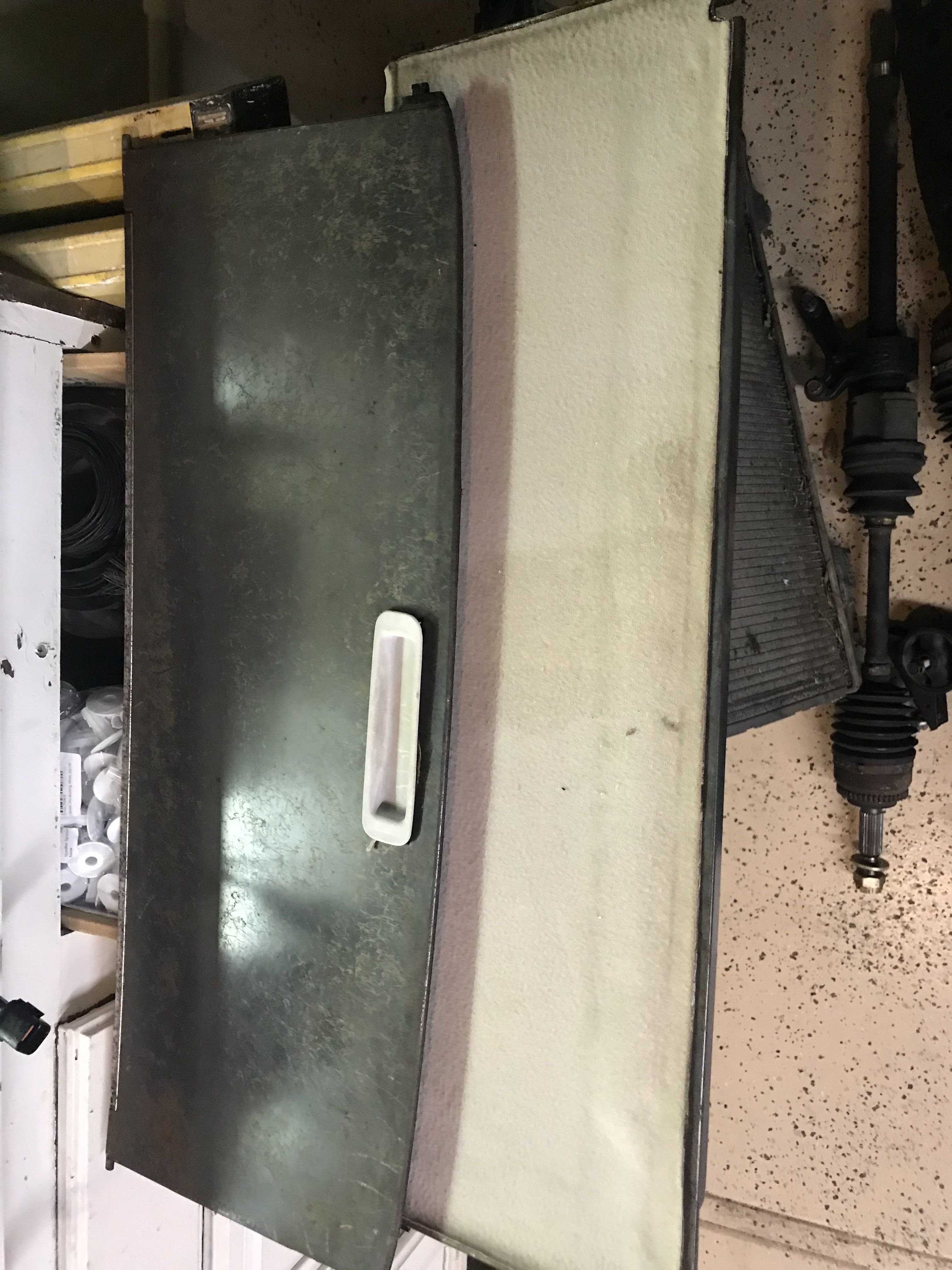

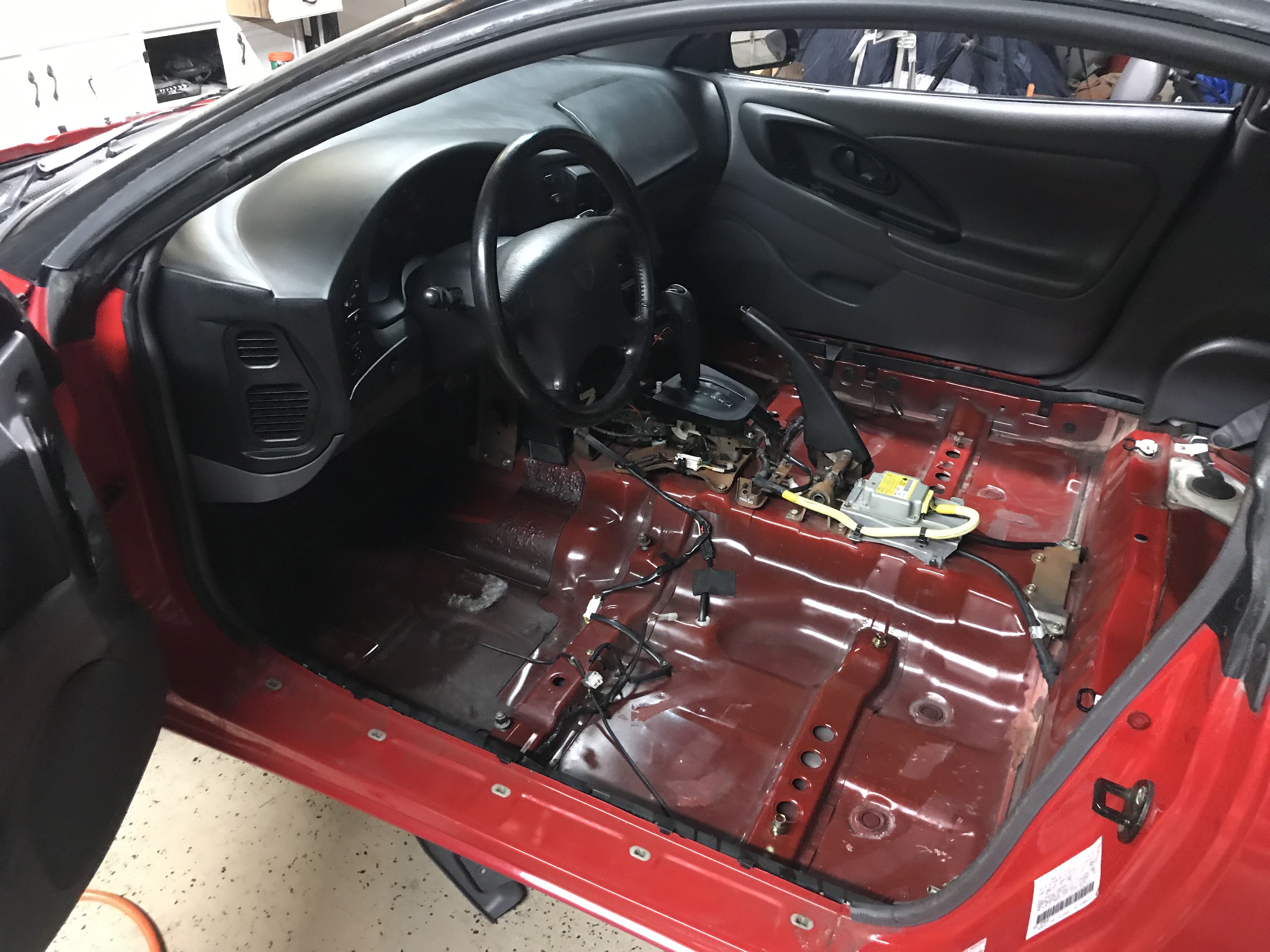

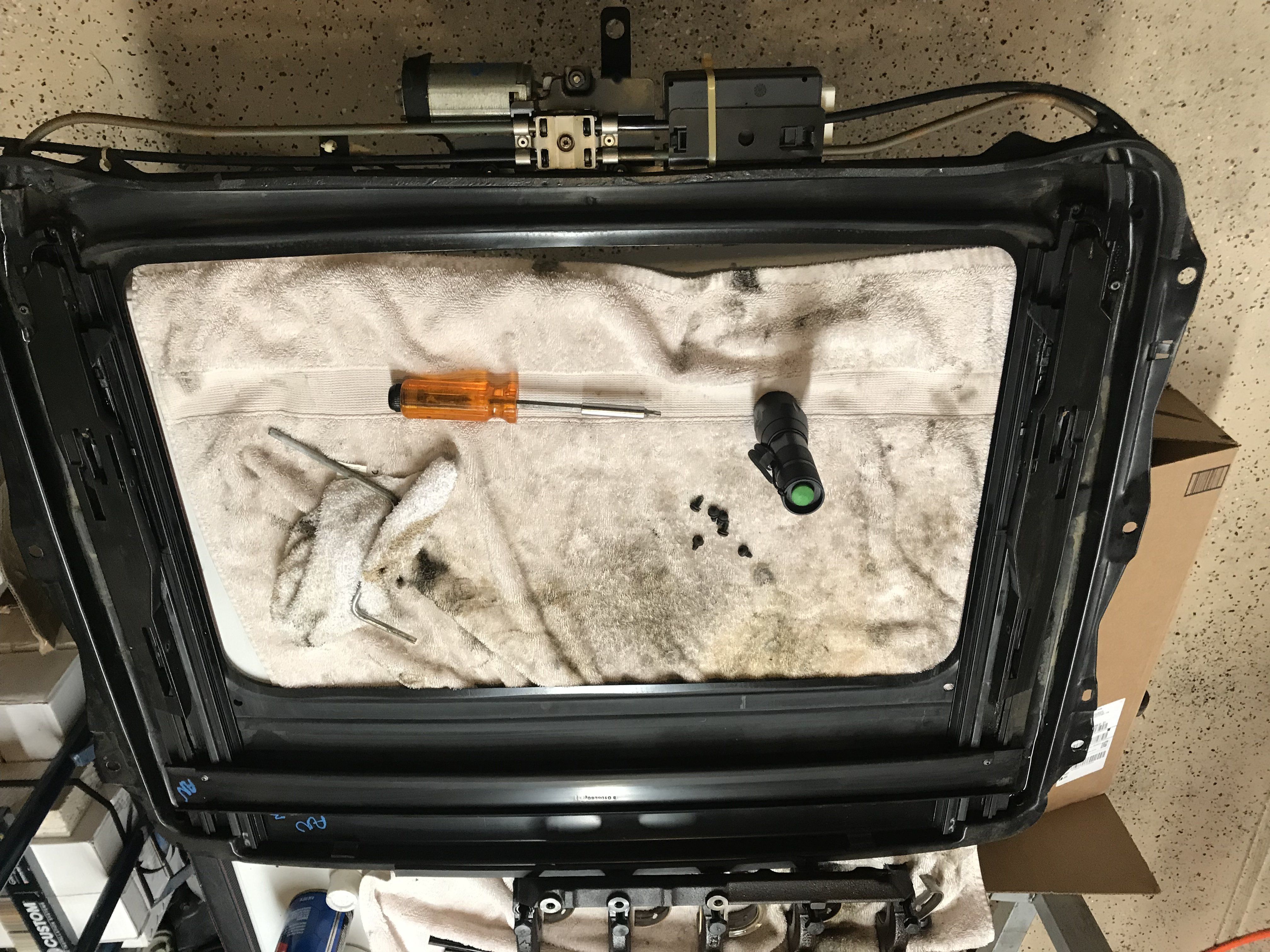

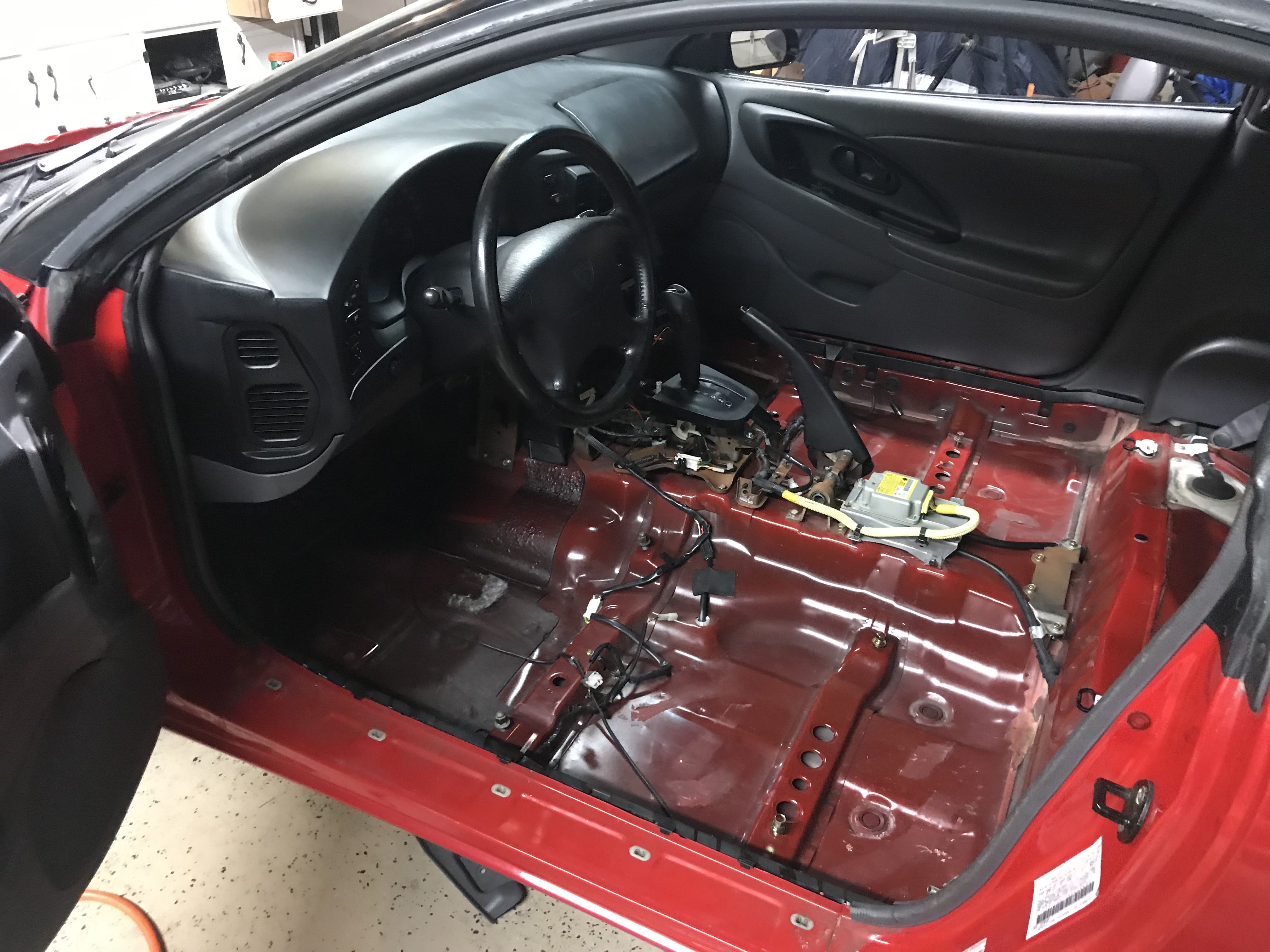

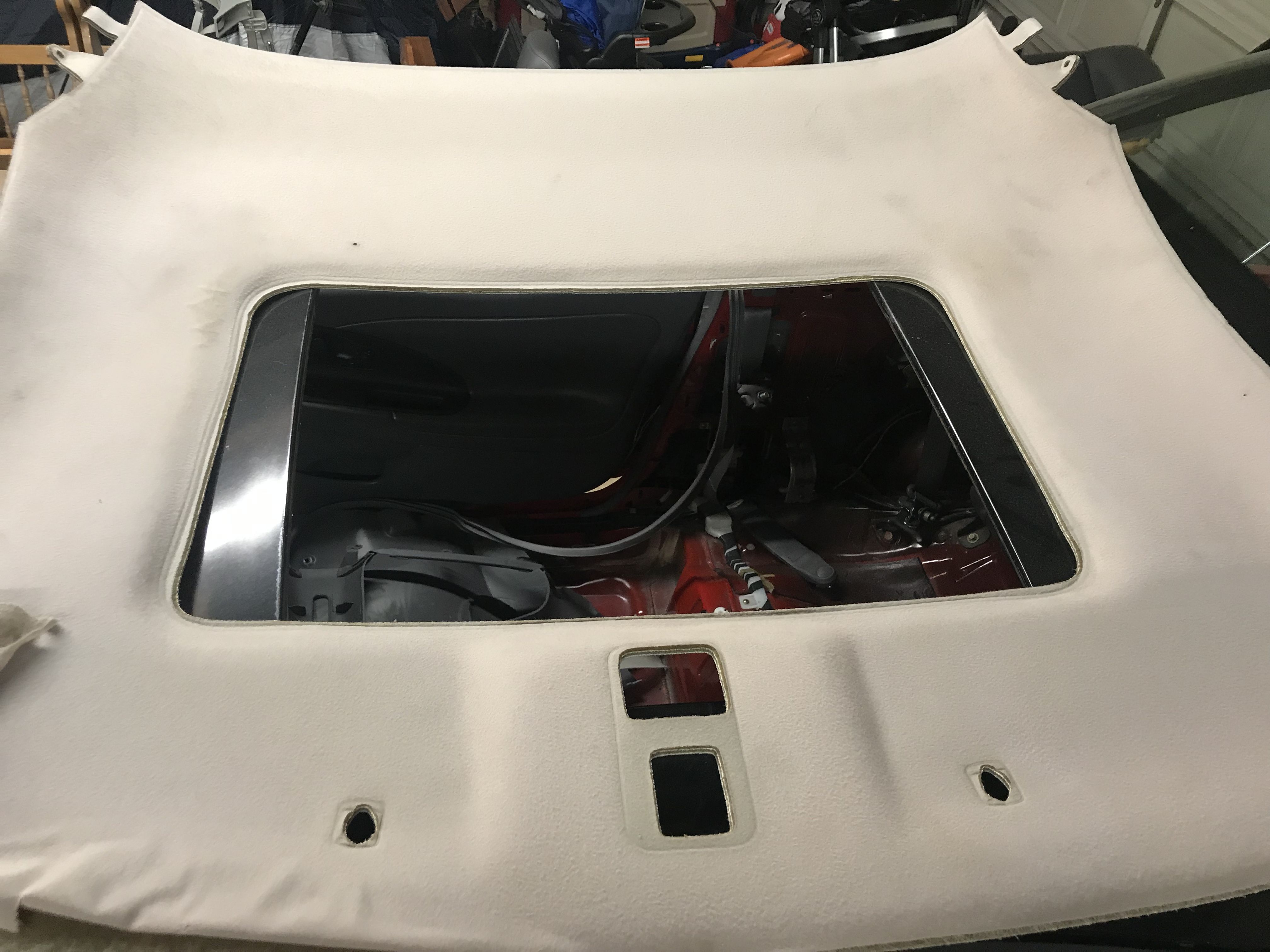

While the block is at the machine shop I figured i would take a look at the interior and fix some issues it currently has as well. Also couldn’t hurt to clean it.

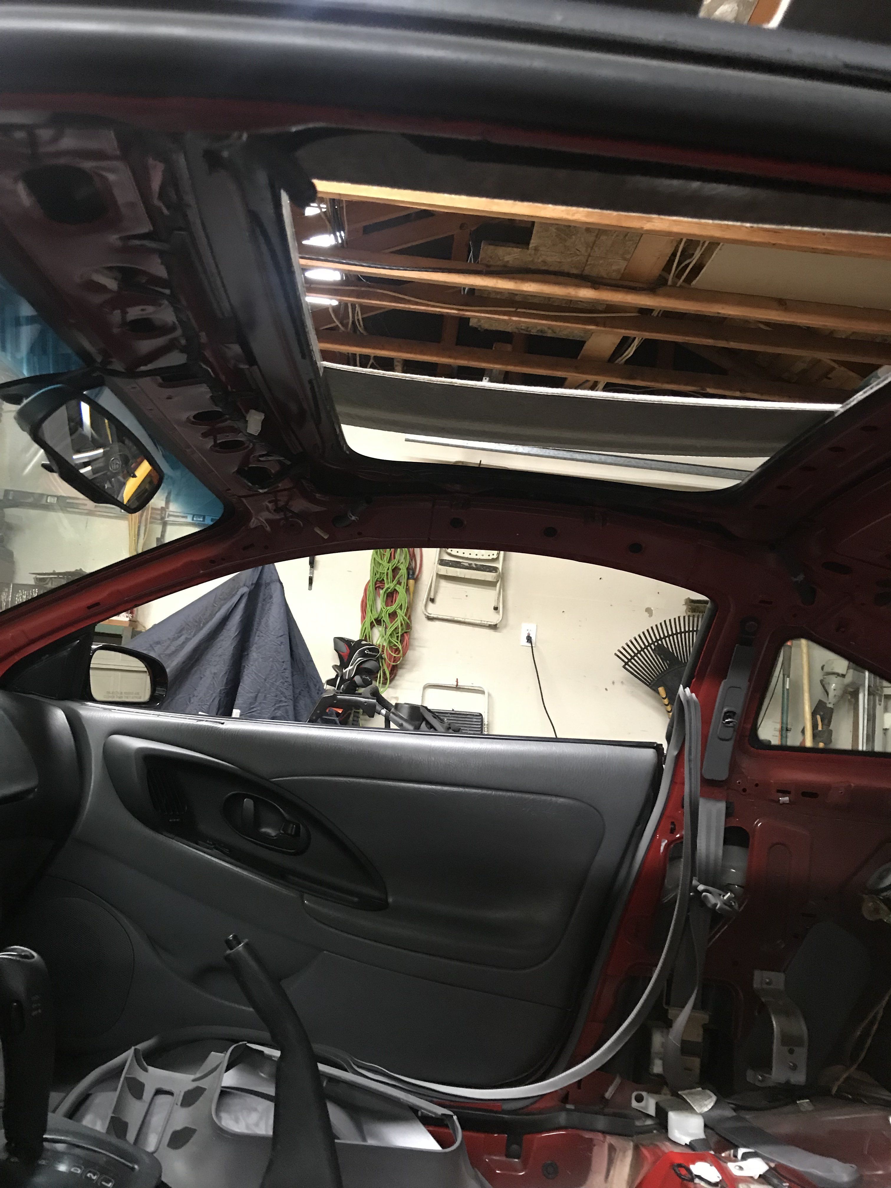

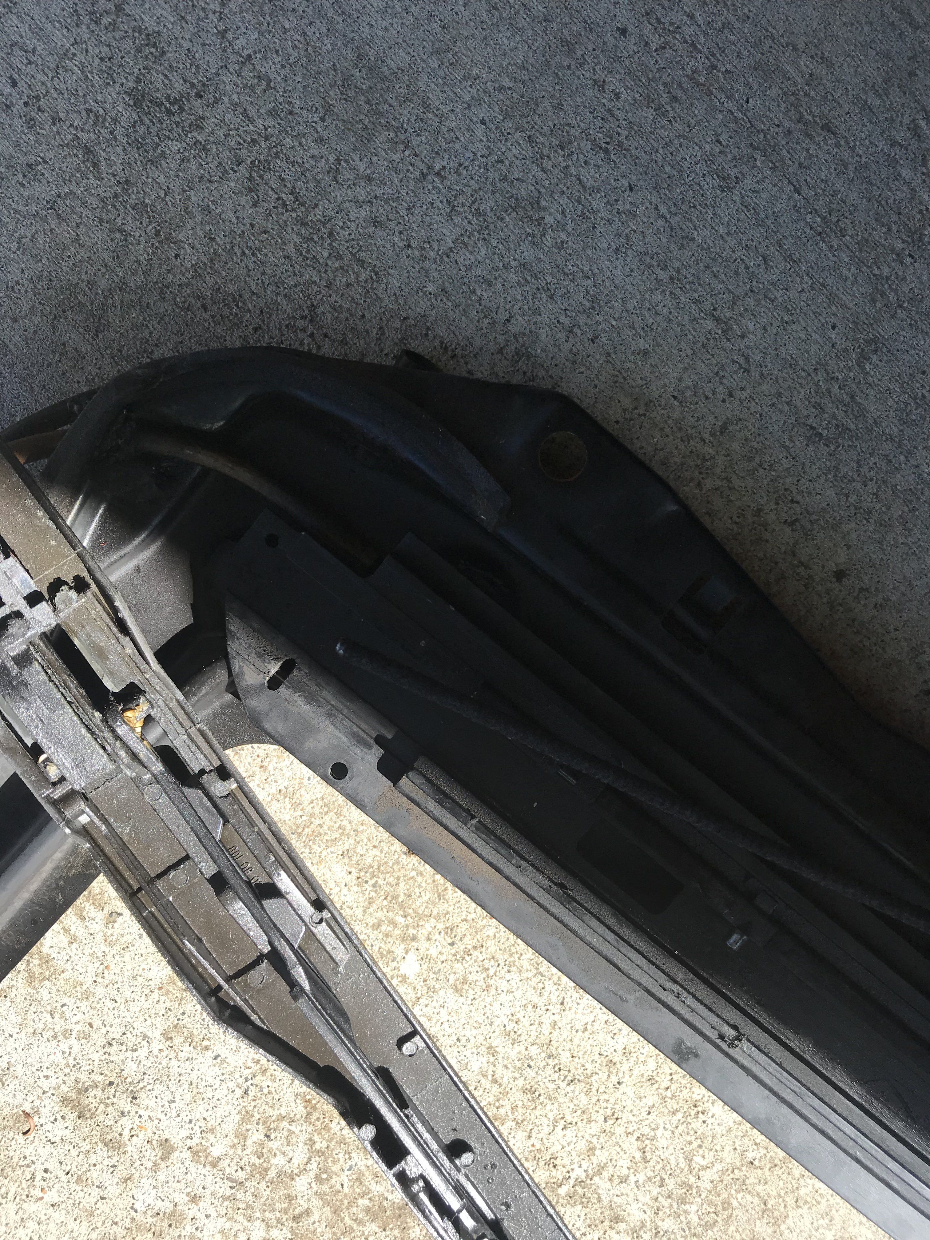

I knew the sunroof was broken so I tore into it to see what was wrong. A cable had broke off, so I went to the local junkyard and yanked an assembly out of a Sebring luckily these parts are cross compatible because I never would of found one from an eclipse or talon.
Also the headliner and sun visors are gonna need to be reupholstered so I’ll purchase some headliner fabric and get that replaced soon.

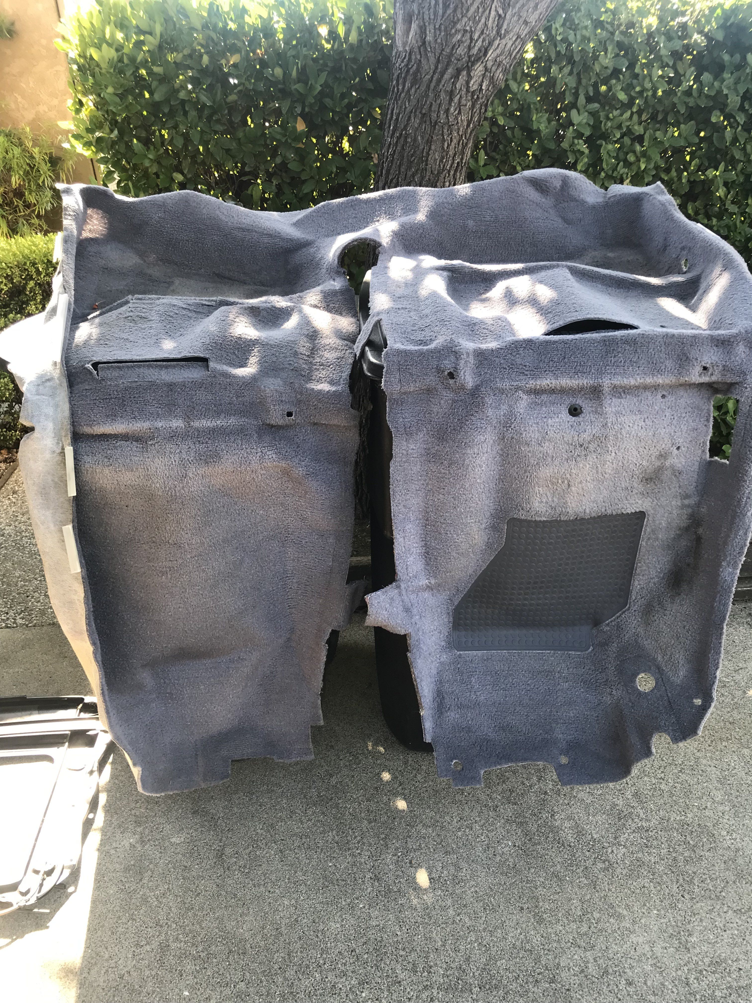

The carpet was a lot worse than what is pictured but for a first pass I’m still not happy so I’ll have to go back again. Any recommendations on solvents or how to clean this would be much appreciated.

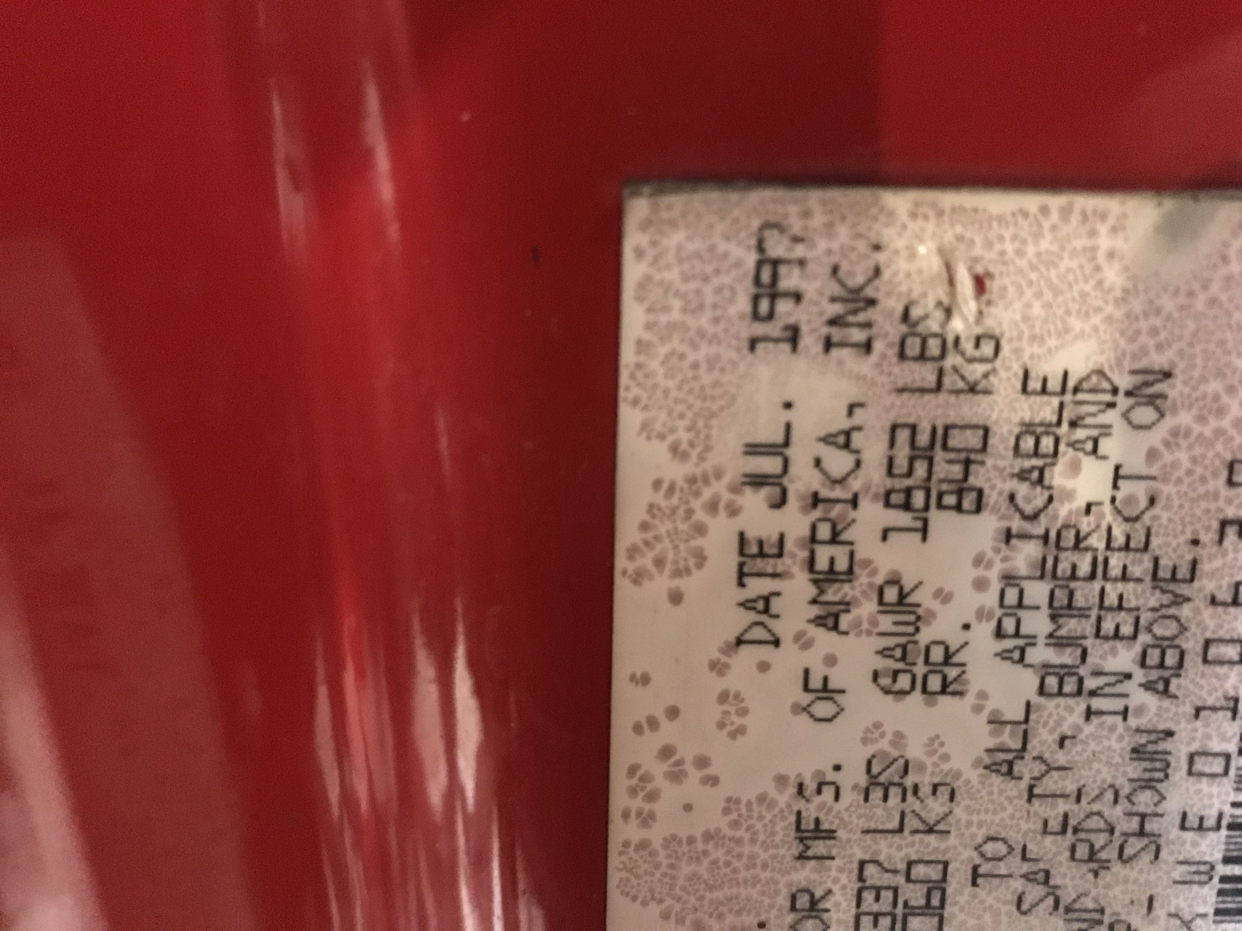

The split thrust bearing blocks were installed in mitsubishi engined cars with a build date after June of 1997. Check your door tag for your build date.
Thanks for the information. Interestingly enough it’s actually July 1997 wonder if someone was in here. Is there a way to check the motor for a revision stamp or something?
Been working through the rebuild and ran into a few interesting things.
Regarding the thrust bearing questions up top, still not sure what to make of it. The block tag vin matches my door and dash vin, so it all seems original. Still not sure why I have single piece thrust bearings, but just went with it and moved on with the rebuild.

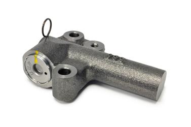

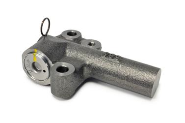

Then I ran into the timing tensioner the one I pulled off the block is very clearly a early 95 7bolt tensioner
so at this point im not quite sure what to make of it. I ordered a late 7bolt tensioner
not sure if I can put this new tensioner on.
I do not understand how this can be a 1998 with a build date of July 97, but seems to be an early 7 bolt and again I know this all came on the car as the block vin matches up.

Considering I am not the first owner I am going with the new tensioner MD308086 and just assuming that someone before me used the wrong tensioner. This paired with the single piece thrust bearings, and this block definitely being original to this 98 I am at a loss. Heres to hoping it all works out.

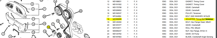

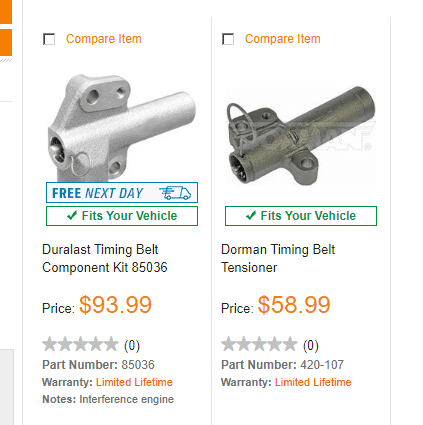

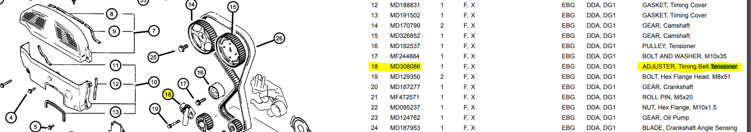

I found this nice little parts guide and it lists MD308086 (even though the image looks like the early 2g tensioner)
Searching my VIN on autozone (last resort) brings up both tensioners and says they both fit
but I am still waiting on parts anyway, so I am going to keep looking and maybe go down the road of installing xp on a VM if possible, to install CAPS and hopefully have some luck there. Also might call around to Dodge jeep chrysler, see if anyone still has access to lookup part numbers for Eagle based on VIN.
With all the VINs matching up, (10th digit is a W so it is 1998) I am thinking I just got an engine that was right at the tail end of the single thrust bearing era and someone used the incorrect tensioner last time they did the belt. Thats the conclusion I have come to after looking over thread after thread and sites regarding the timing components and their different variations.
