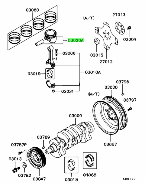

They seem available, at least ordered from Japan. I would often give jnz a call about oem parts before trying to order directly from Japan. Sometimes Amayama would not actually have parts available that they showed were available.
Amayama is notorious for this, and for overcharging on shipping. If anyone can get them in North America, it's JNZ. Also look into Evo 1 or 2 pistons (don't use Evo 3), which are 8.5:1 equivalents.
