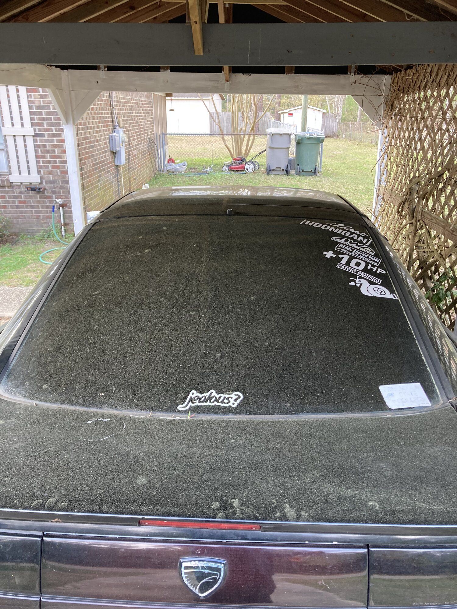

Before...
Jumpin' Jehoshaphat can you guys SEE how much pollen is on this car? This is honestly less than a weeks worth. A F**KING WEEK! And it's not even summer or spring! This is why I am heavily considering painting this car white, or silver. Because pollen is a straight gangster around here...anyway..on to the mod.

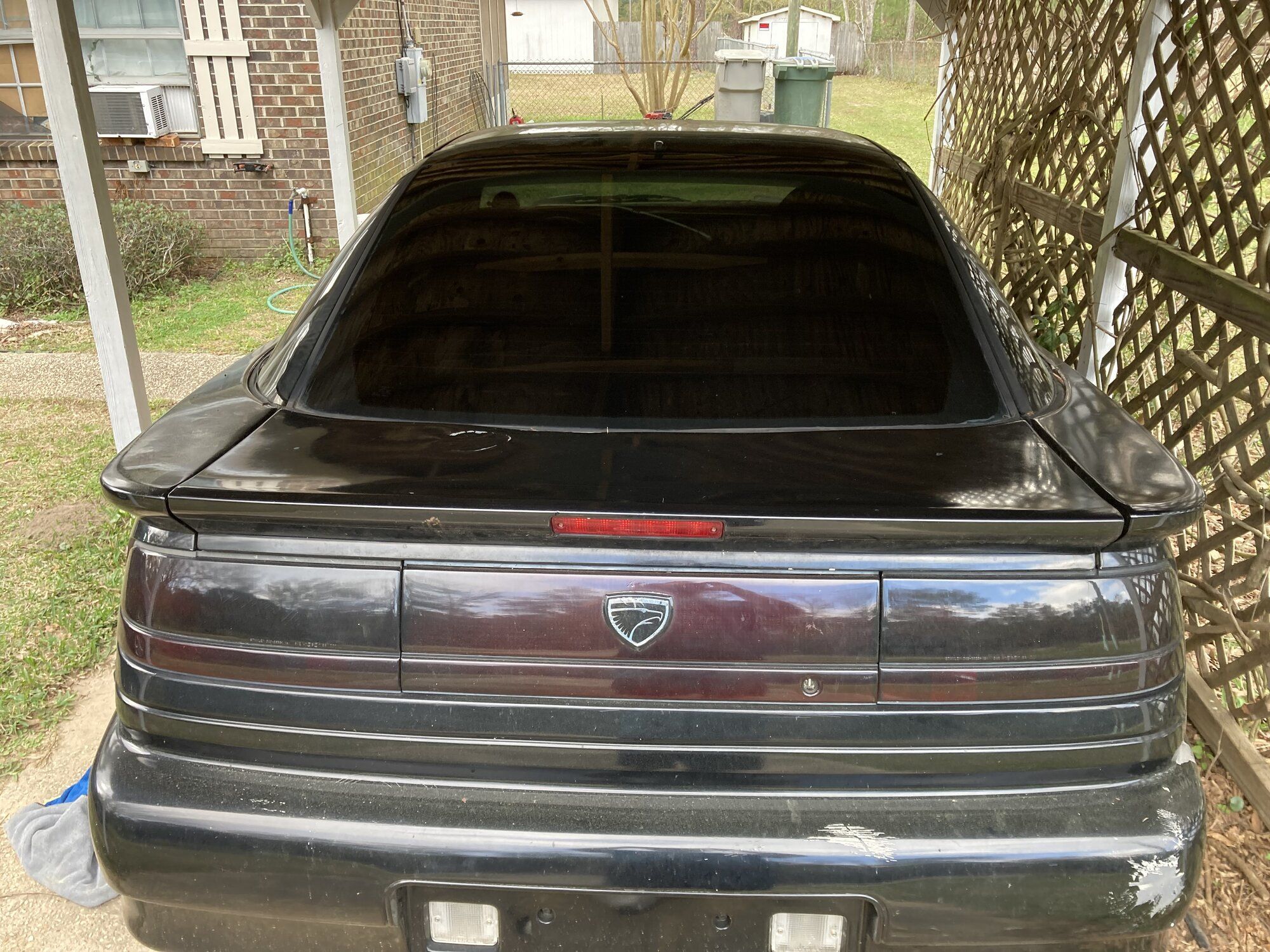

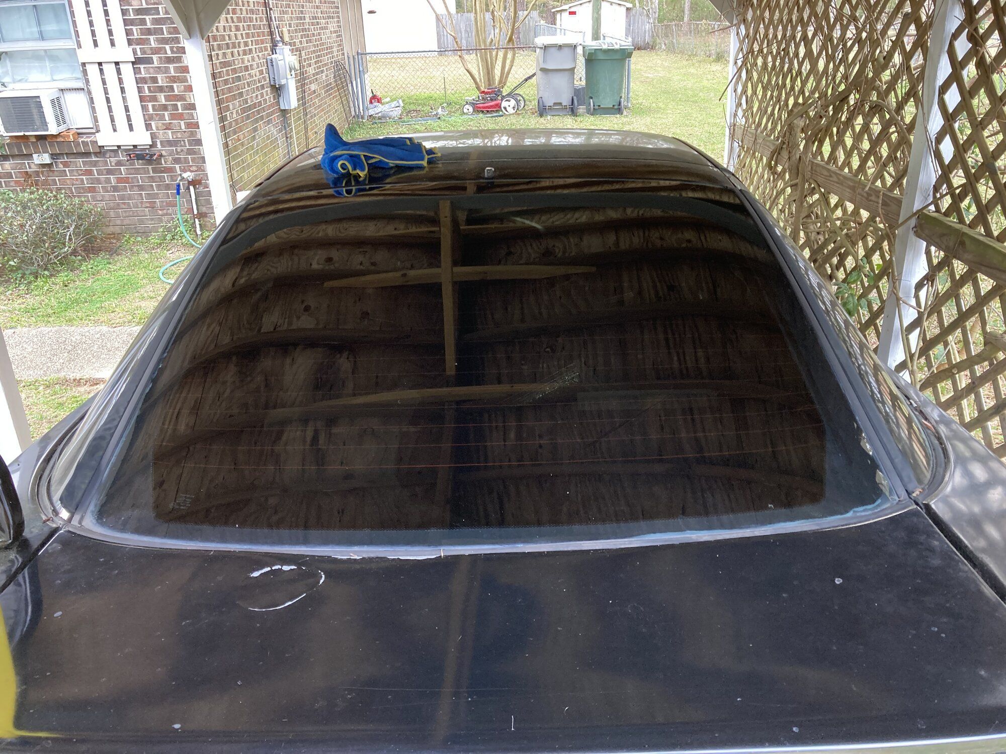

After! Less horsepower never felt so good.
:D Honestly, so much better. The stickers were really clashing with the paint scheme for me, and honestly I'm just not a fan of stickers. The ONLY exception, is the "jealous?" sticker on the bottom in the center. I was really gonna keep it, but it was cracking/fading and starting to come off with just the pressure washer. I'll 100% get another one though, just to troll people. I know this isn't a McLaren or some kind of high dollar supercar, but it'll irritate them just the same. And I am all about that. :p

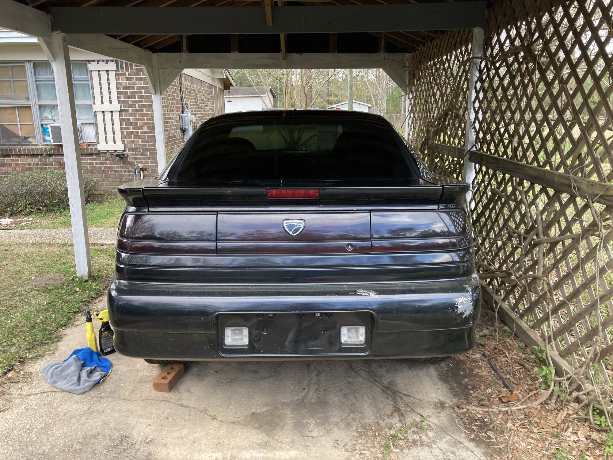

I decided today was a good day to give it a bath with actual soap. I still didn’t scrub it down or put too much elbow grease into it but wow does it look better. It leaks a little on the drivers side which kind of surprised me, so I guess I need to address the weatherstrip situation there.
But yeah. Man this car doesn’t look too bad with a proper bath. Excites me to get it running soon. But I’m gonna have to take the spoiler completely off when I go to actually detail wash it because the amount of dirt that comes out after I stop the water is still too damn high. But, that’s a future me problem.
