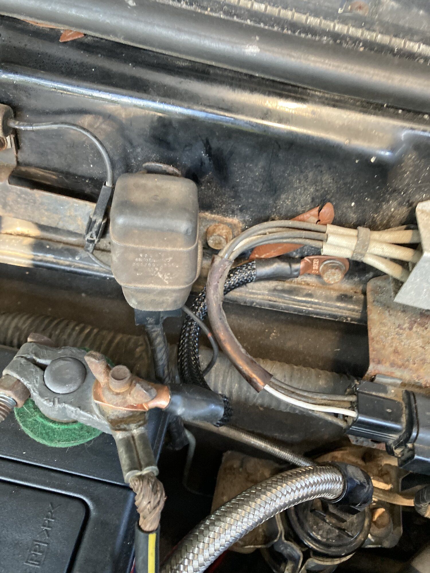

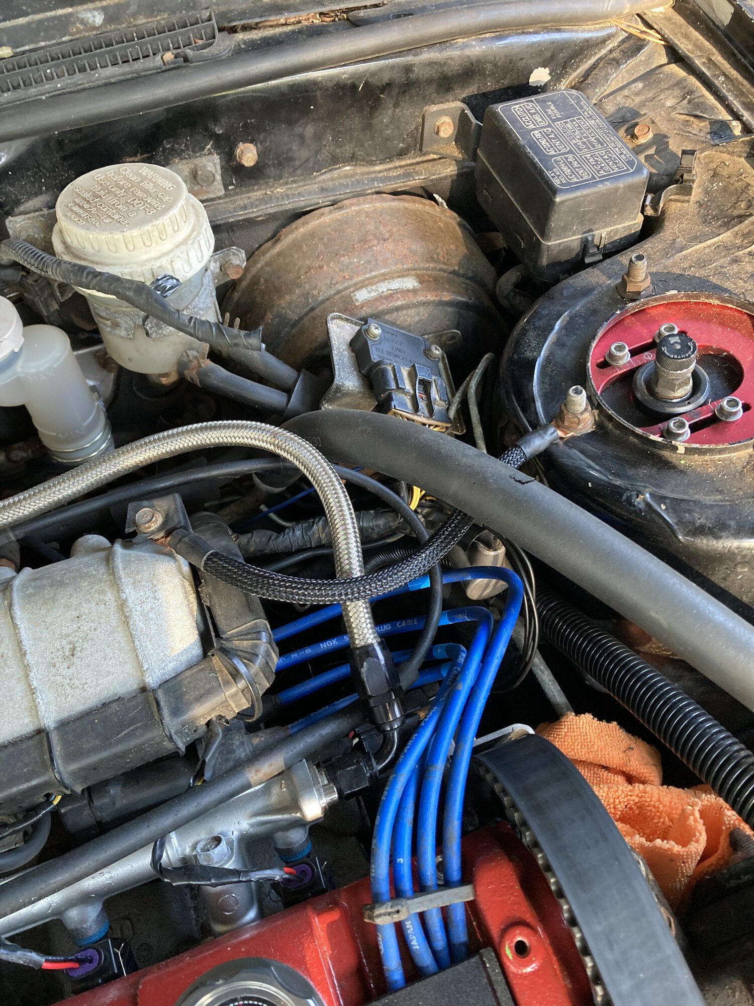

Like, 3 months or more ago I ordered a grounding kit from a private seller/one man business on facebook. I've had it laying around and finally decided to install it as the grounds on this harness/car leave much to be desired. If it's not rusty, they're just outright missing. So I installed four out of the six. The only two I didn't install yet are from alternator to chassis, and throttle body bolt to chassis. Mainly because I don't really know where to hook the cable up on the alternator, and where on the "chassis" it means.
But the ones I did install outright replaced the OEM ones and really seems to help.
Not pictured is the transmission to t-stat housing ground cable I installed.
Batt to Firewall
Intake Manifold to Drivers Side Strut
T-stat housing to Chassis.
On all points I removed paint with a razor blade, and sanded it with a scotchbrite pad. Also cleaned up the underside of the bolt too just in case. Pretty happy.

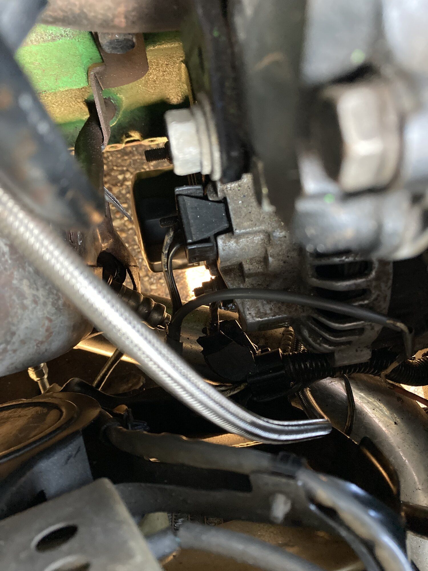

And as a bonus, while I was digging around and looking at the engine bay, I think I discovered something that had to have been affecting alternator performance. The oil feed line from turbo to OFH, was like millimeters away from the positive stud on the alternator. Just touching the line made it touch the terminal and spark everywhere. So I moved it and ziptied it out of the way.
Much better. I really hope this helps but I 100% don't expect any kind of gains from this. Just wanted to add the missing grounding points and help out the existing grounding system because it's old, rusty, and crusty.

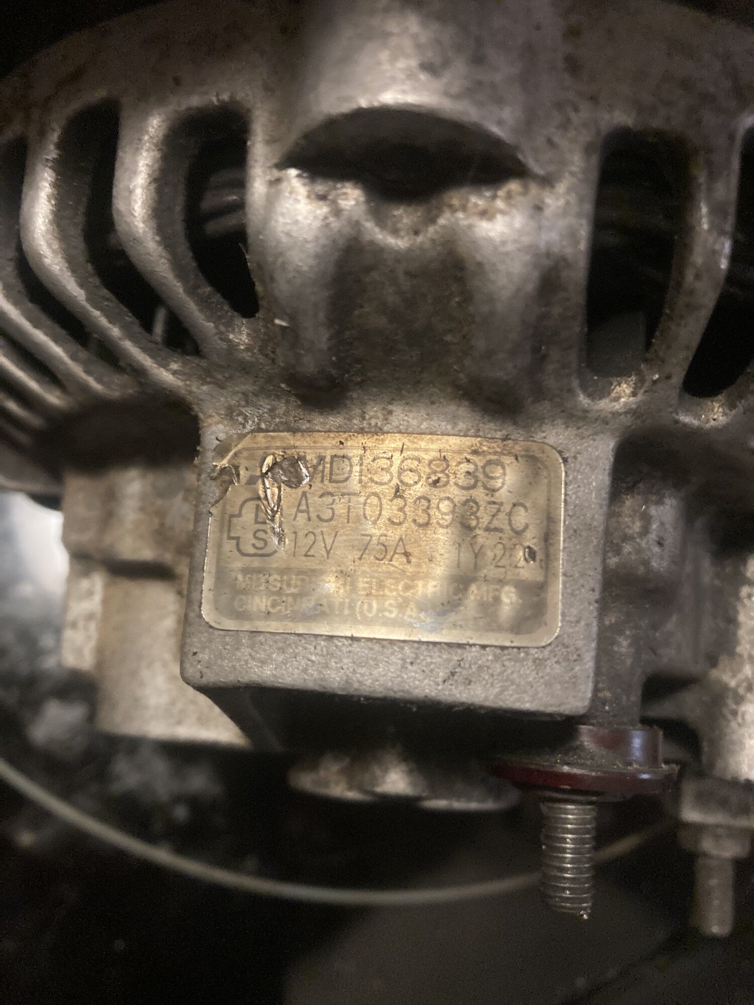

But with that out of the way, I set about to removing the alt. Had to remove the A/C fan, but the rest came out pretty good. Once I got it out, I noticed it was the original mitsubishi alternator, and a 75amp model.
Crazy.

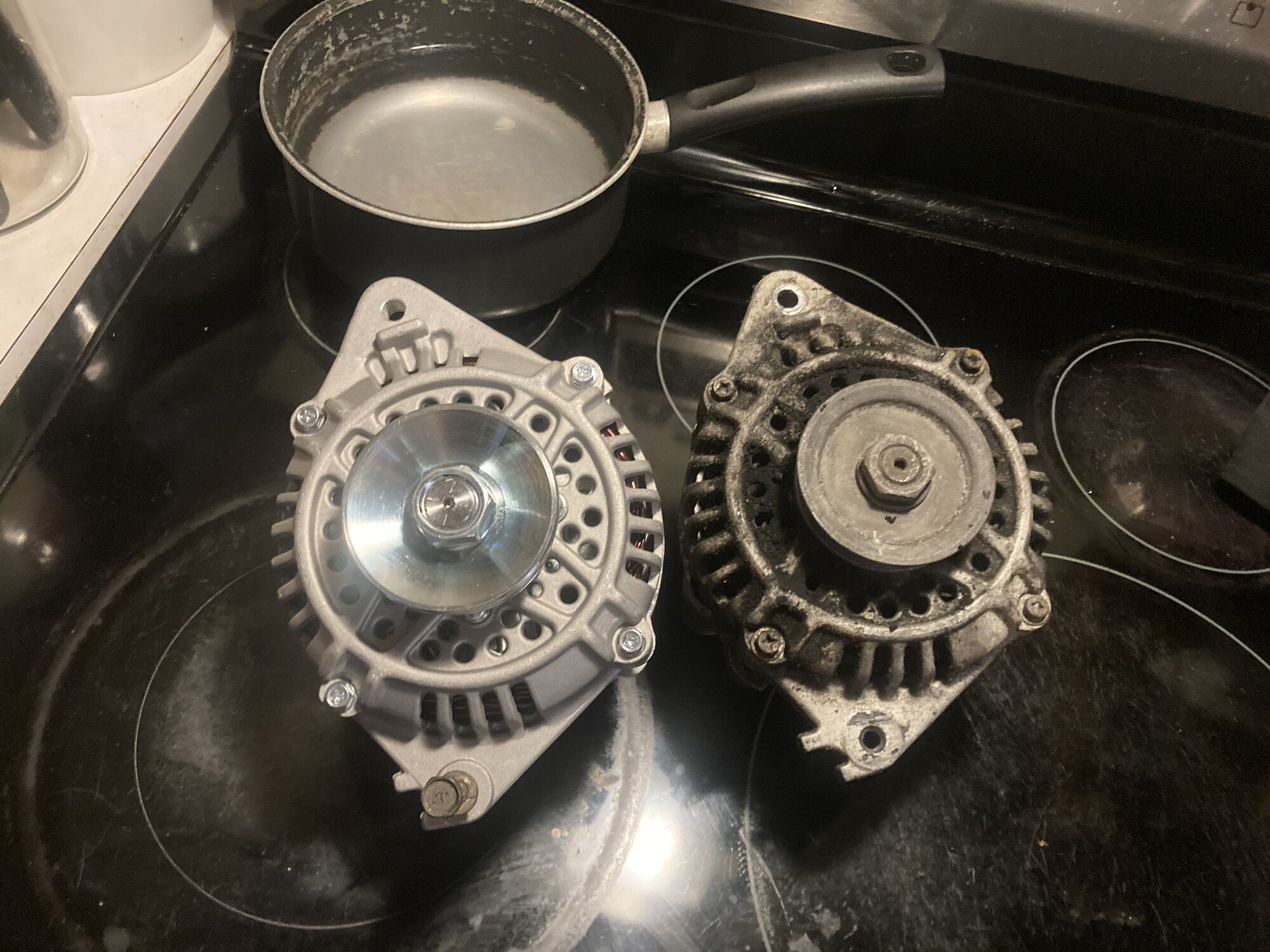

This thing was so dirty. Caked on grease and oil, and this picture is after I wiped it down too. The new alternator looks so good. I really don't expect it to last near as long, which is why I'm keeping the old alternator, but in the meantime it's gonna be great.

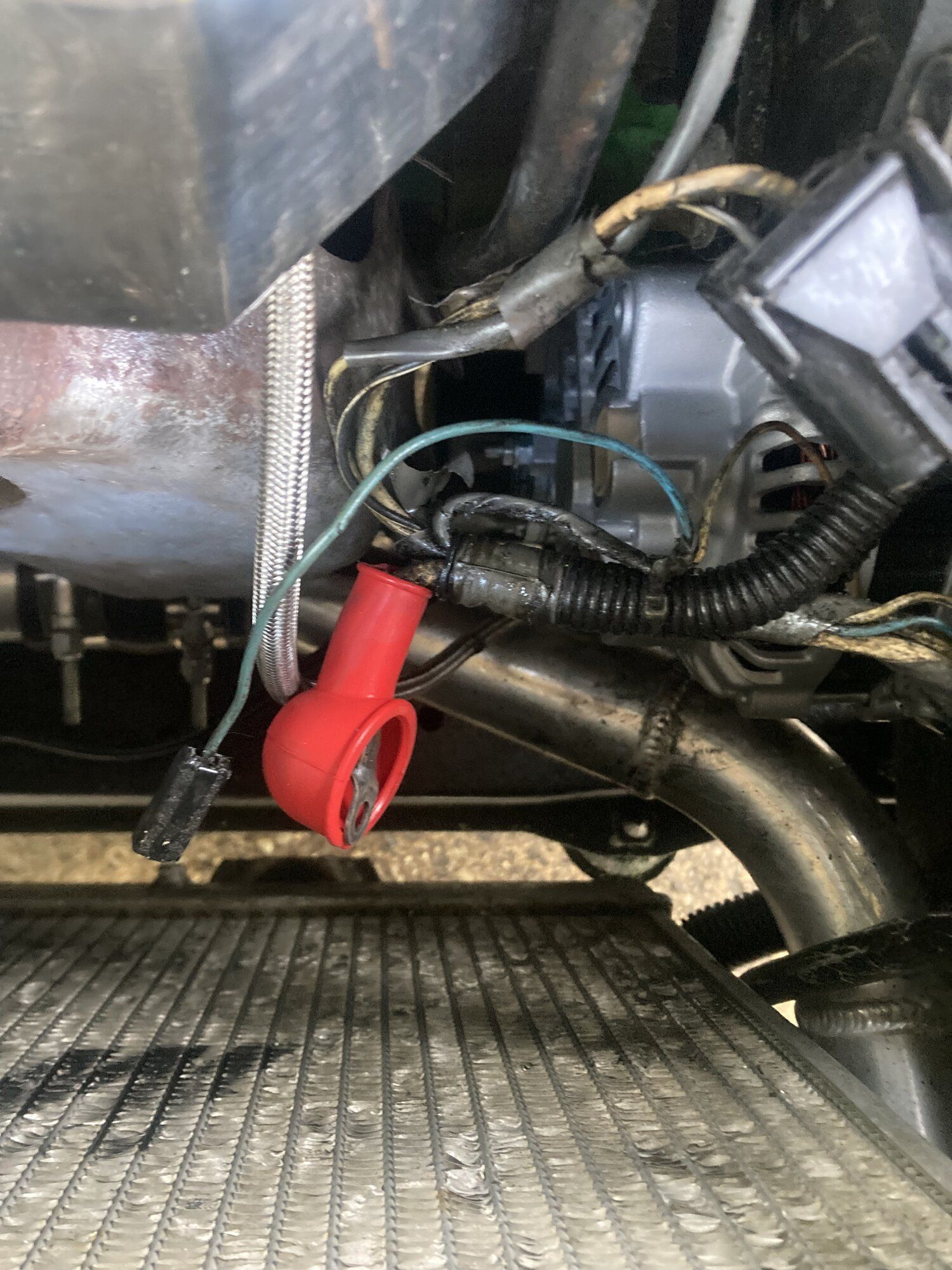

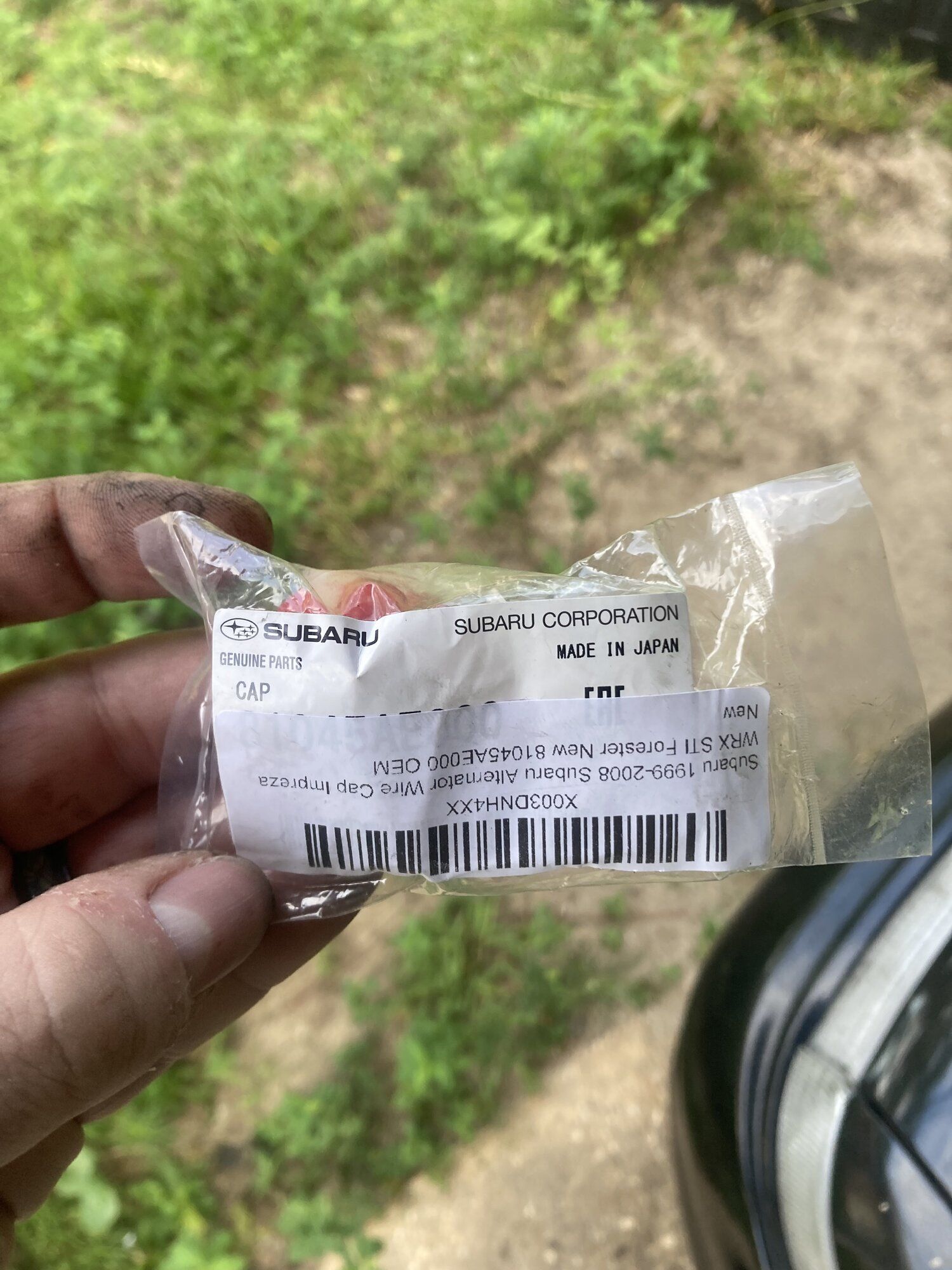

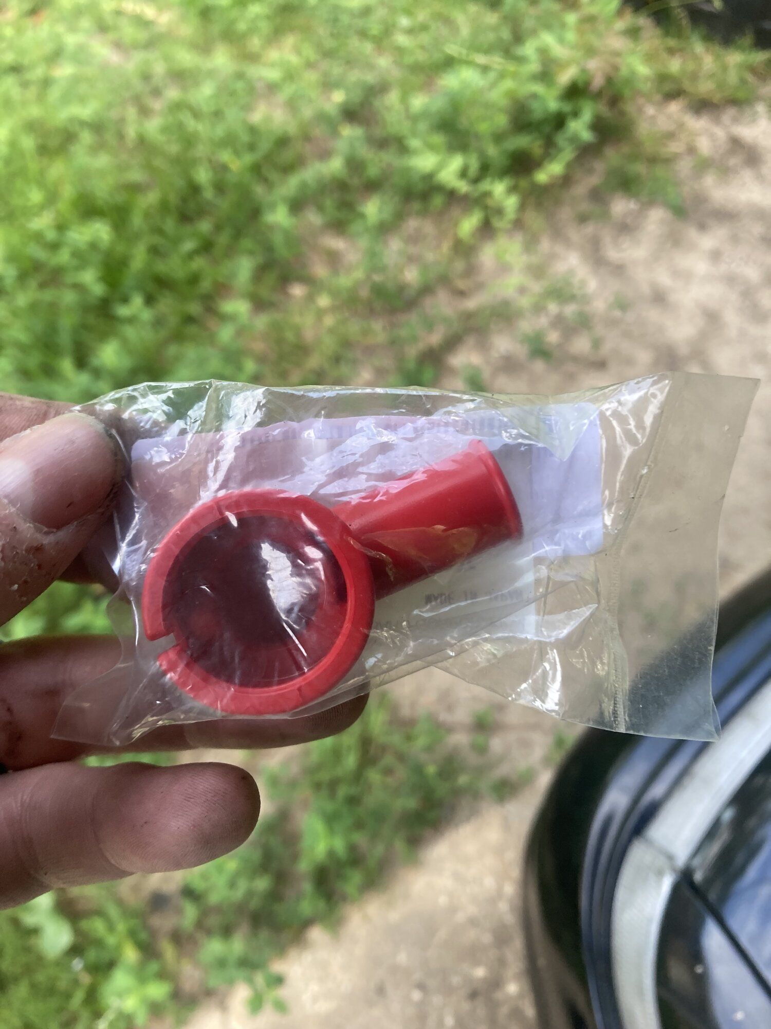

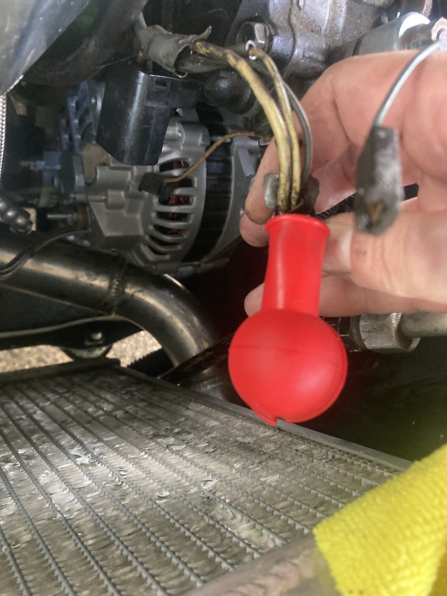

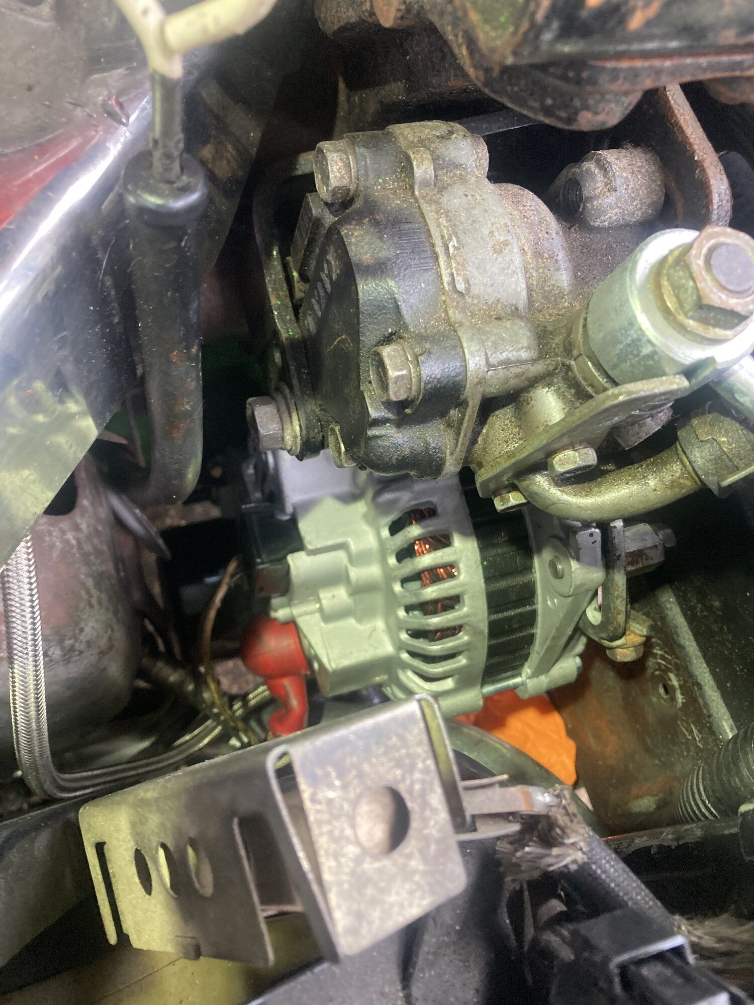

Rewinding back a week or so, I mentioned to you guys how the B+ terminal was touching the oil feed line. The original cover for it has long been broken, so I did some research on the forums and found that someone recommended a subaru part number for a rubber terminal cover, and I can confirm it fits great and functions beautiful. Nice striking red. Was $7 shipped too. Lol.
Aside from the fact that it's a subaru part(yech), I'm very pleased with it. It slipped on no sweat with minimal effort, and looks/functions beautifully.
And there she is. Already dirty, but looking pretty.
Took it for a test drive and right away noticed it idling at 14v where before it was mid 13's. Under WOT and all the way to redline it starts out at almost 14v, and only drops down to mid-high 13's at the lowest point. Super pleased.

I've been using that same Subaru terminal cover for starter wires on the 420A cars for years since the plastic ones have all crumbled to bits. I can tell you it's going to last a long time and retain the bright red color. As opposed to an Autozone part that fades and becomes brittle after 2 years of heat cycles.
Now that I remember it, it was one of your posts that recommended it. Credit to you for sure!
I don't quite remember sharing that info, but you're welcome anyway. :p Must've been a while, but useful info for sure. Those caps will fit most starter and alternator wires for DSM applications.

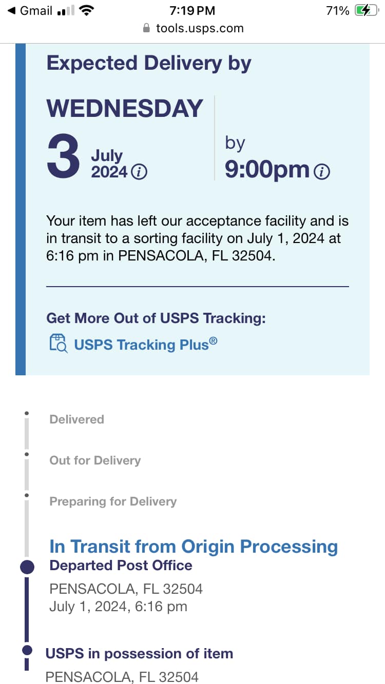

The package was dropped off to the post office Monday morning/July 1st. USPS estimates it'll be delivered in TWO DAYS.
TWO DAYS to go 30 minutes of driving time(accounting for HEAVY traffic, I know where that post office is). Unreal. USPS everybody.
