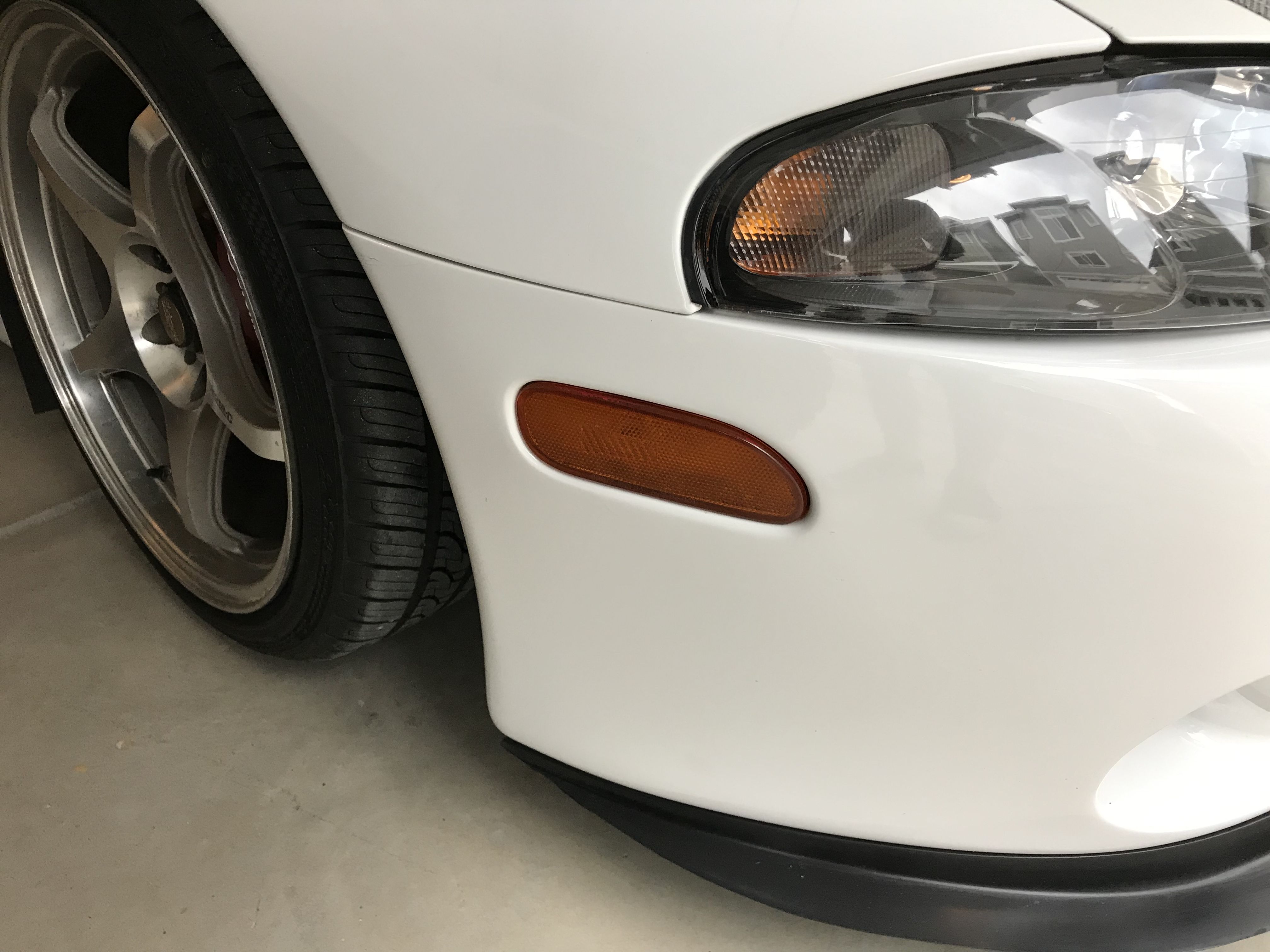

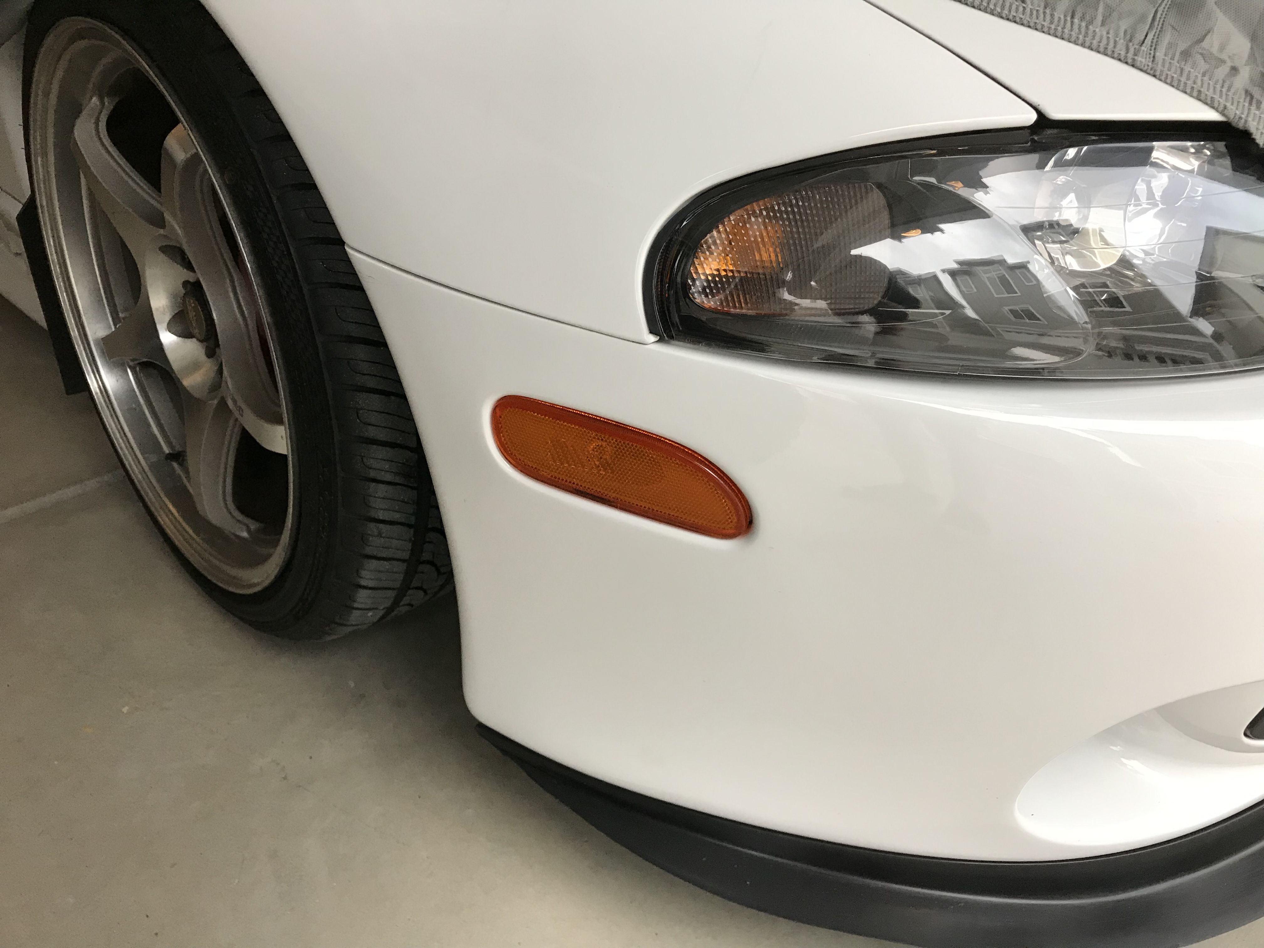

I did swap out these original 99 sidemarkers for some brand new oem ones! Rear lights are up next. The little things are so cheap its hard not to just buy a bunch of small stuff!
Before:
Untitled by Brady Dingeldein, on Flickr
After:

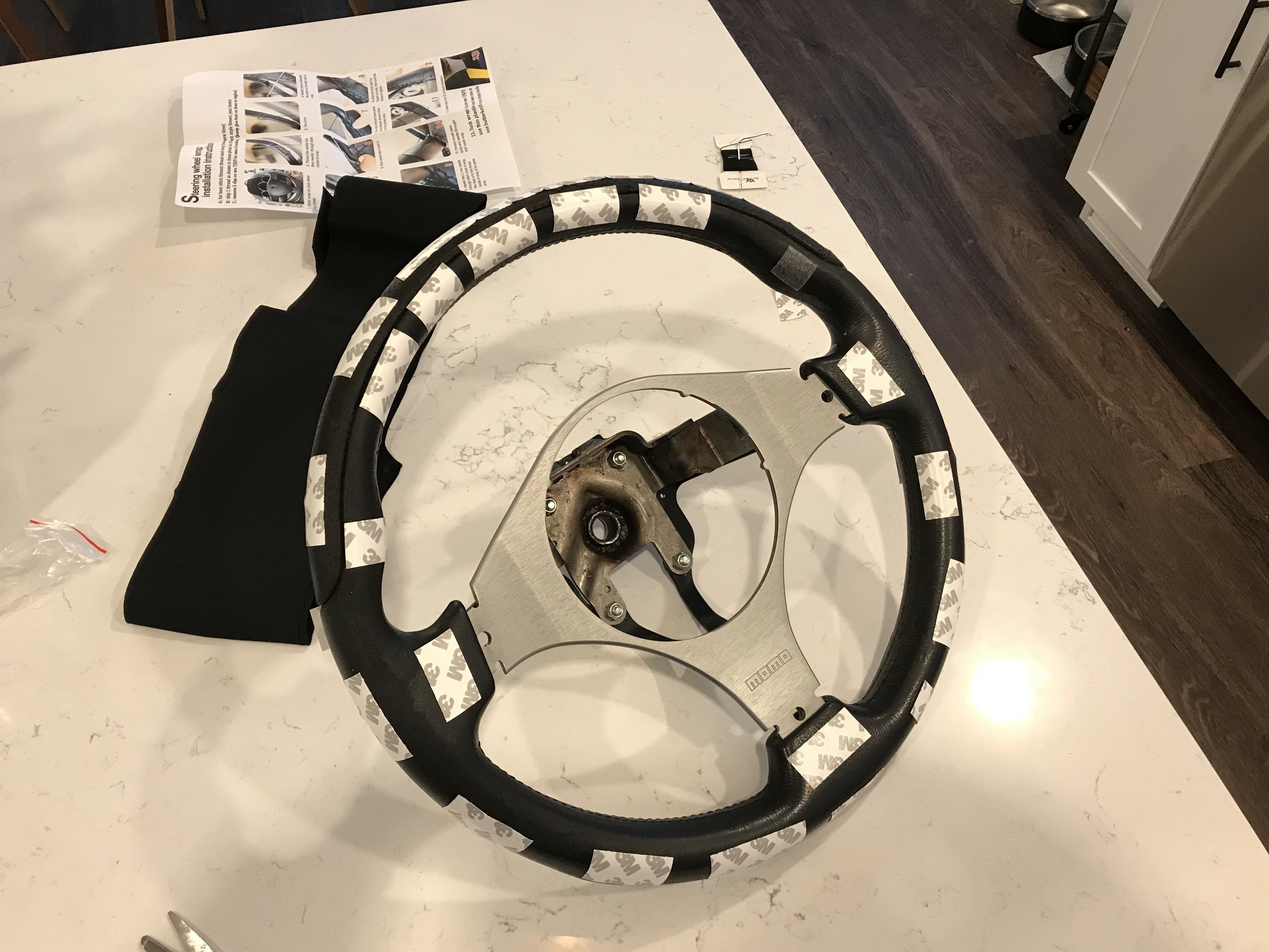

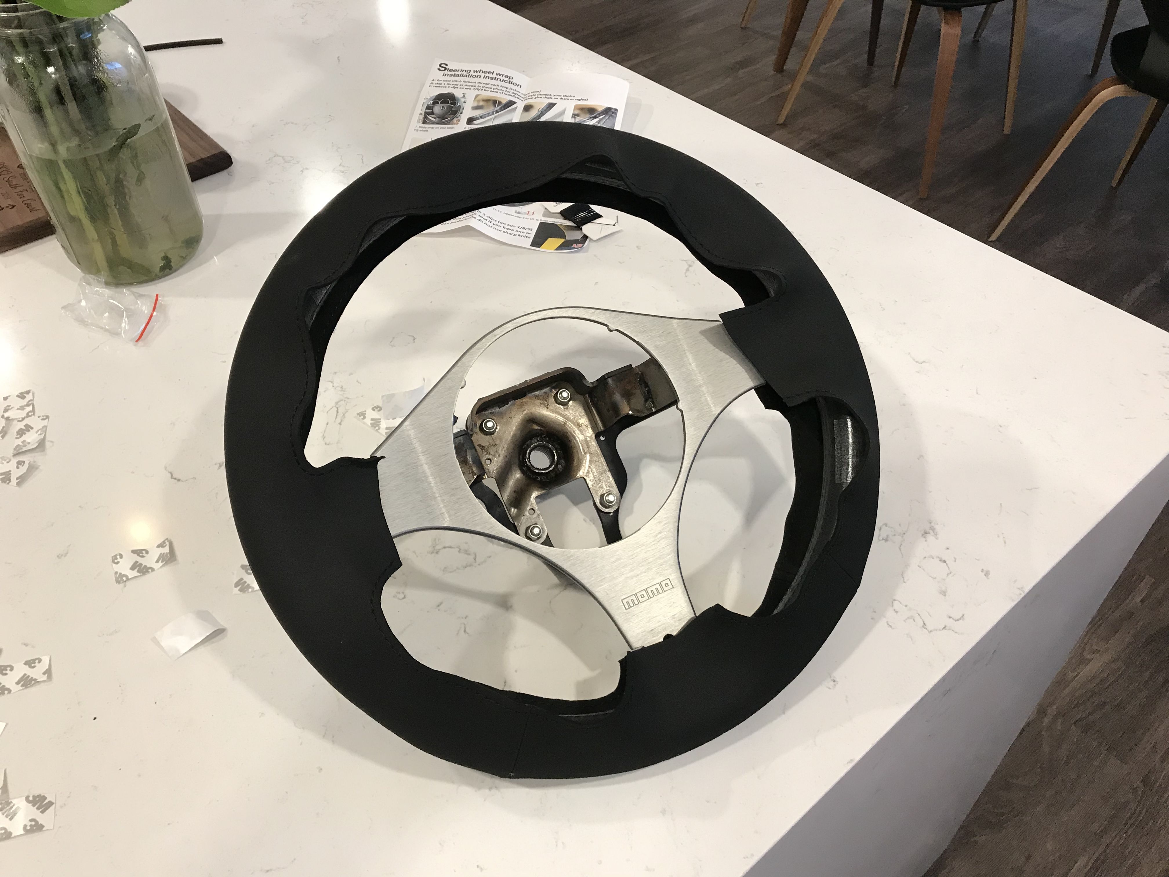

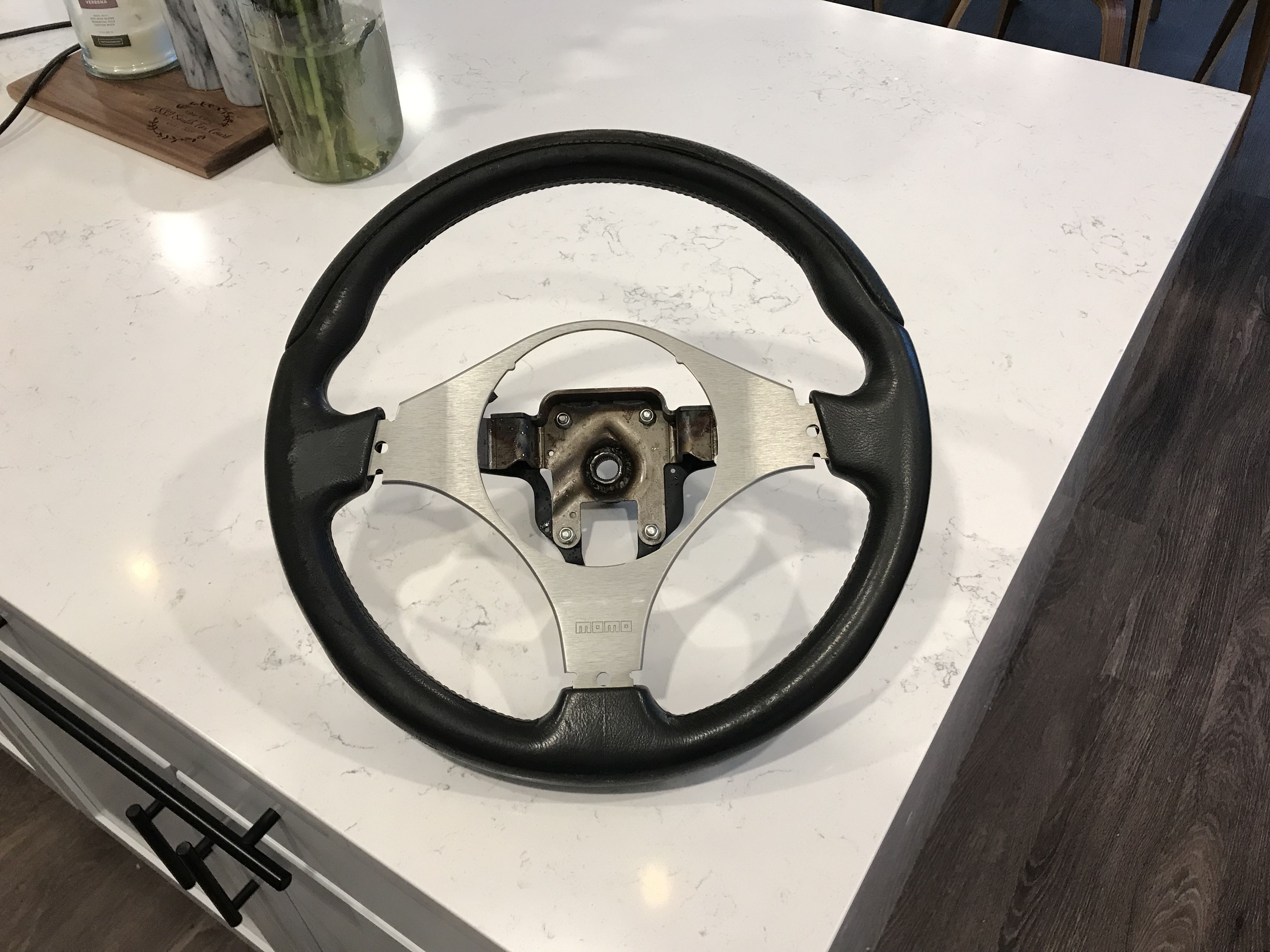

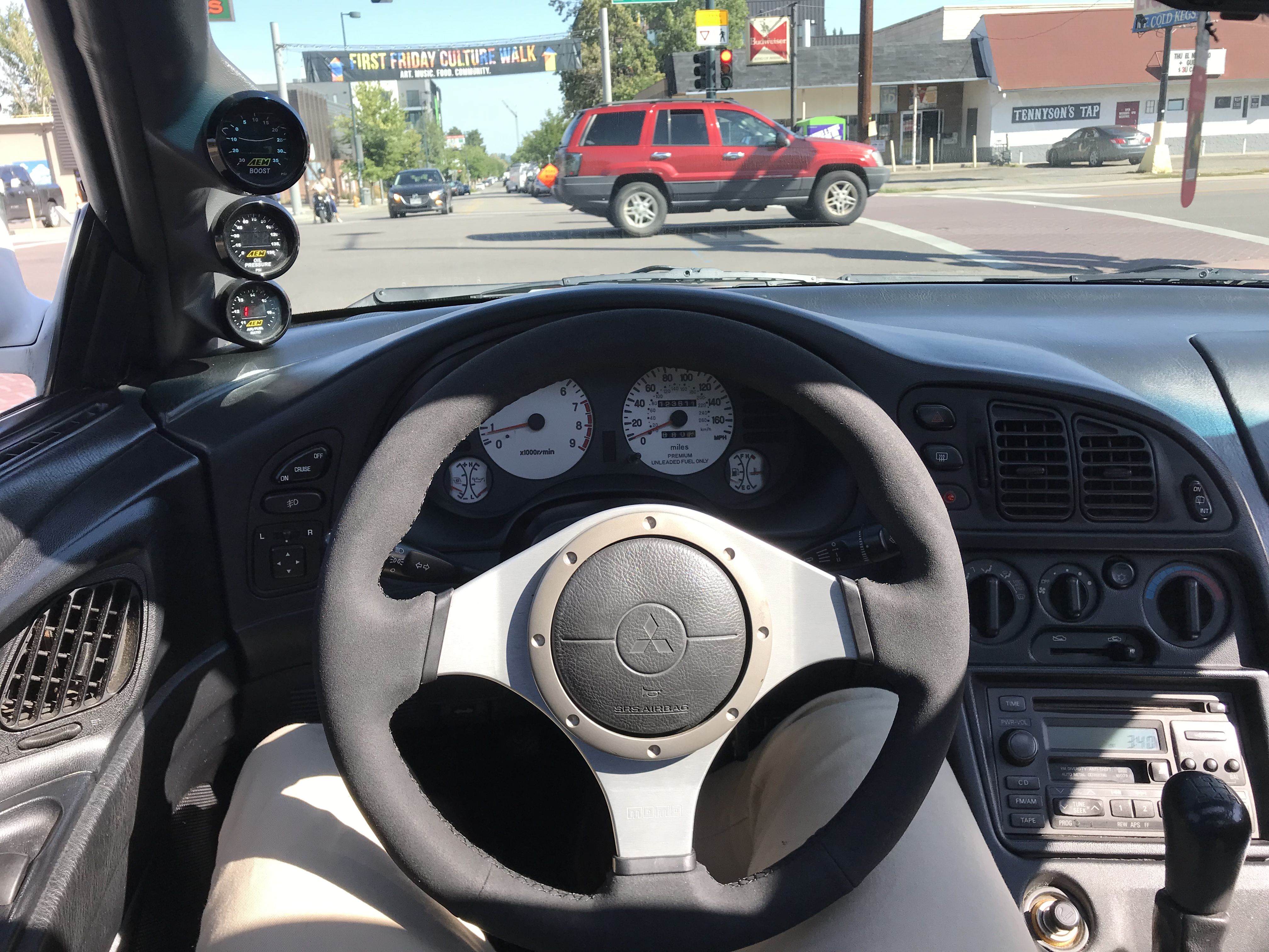

I was super pissed that I sold my Evo 9 steering wheel when I sold my Evo 8, and I was left with the wheel that originally came on my old Evo 8.
The wheel is dirty and is peeling at the top, all in all just not in good shape.
I've been toying the idea of wrapping it, but without power steering, I was worried I would stretch the wrap with how much force it takes to turn while parking.

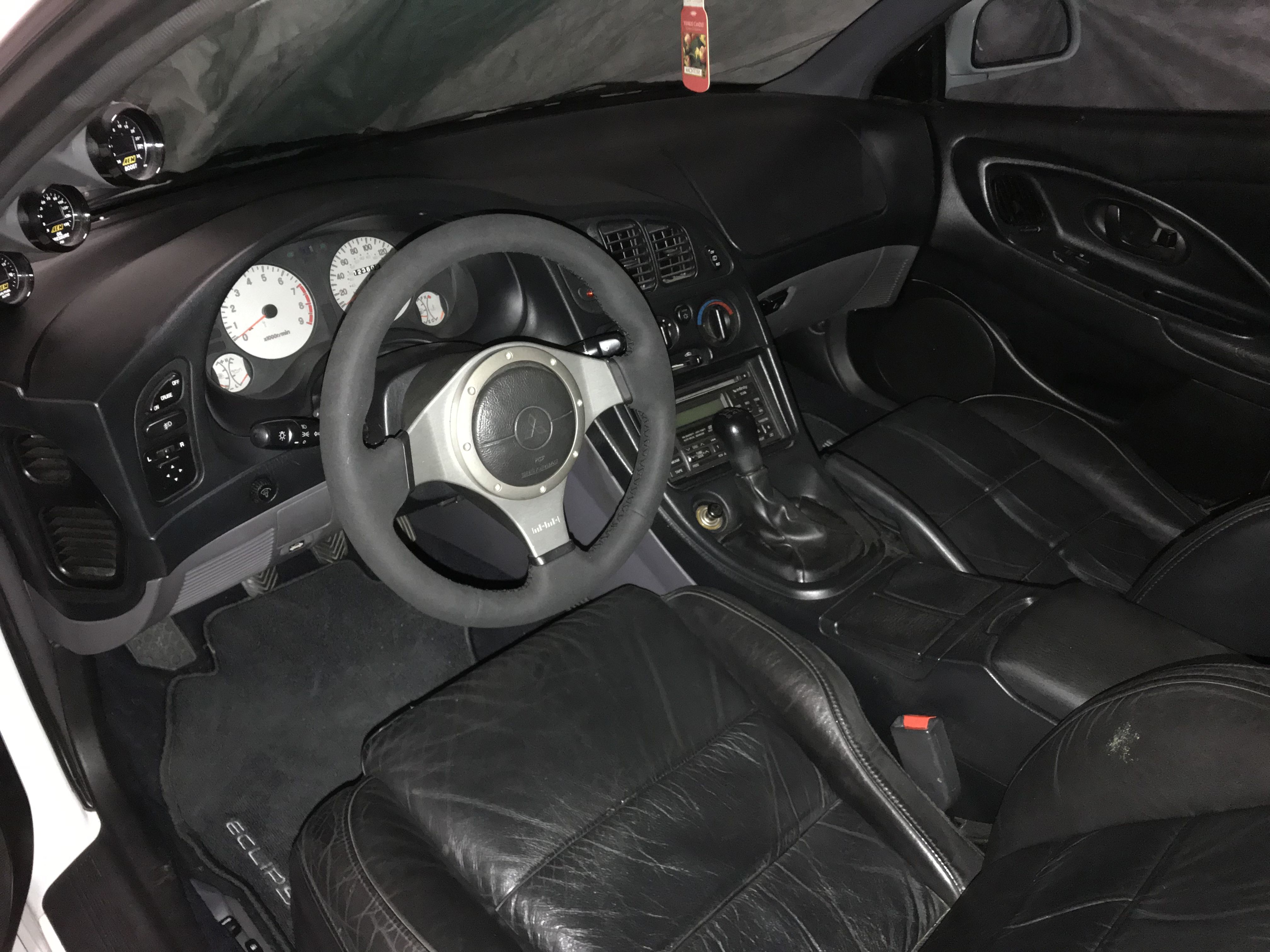

I pulled the trigger on a Nubuck leather wrap with black stitching. I thought about red stitching but wanted it to look classy and clean, so went with black.
All in all the process was super easy and I am SUPER stoked on how it came out!
Here was the wheel disassembled, maybe you can see the deterioration at the top of the wheel. I cleaned the thing up super nice to get ready for the double-sided 3M tape.
I put a ton at the top where I thought it would have the most stress.
Rough fitment of the cover to make sure it was centered.
Final product!!
I LOVE the way it looks and feels. Such a big upgrade for minimal price/effort ($45 on fleabay)

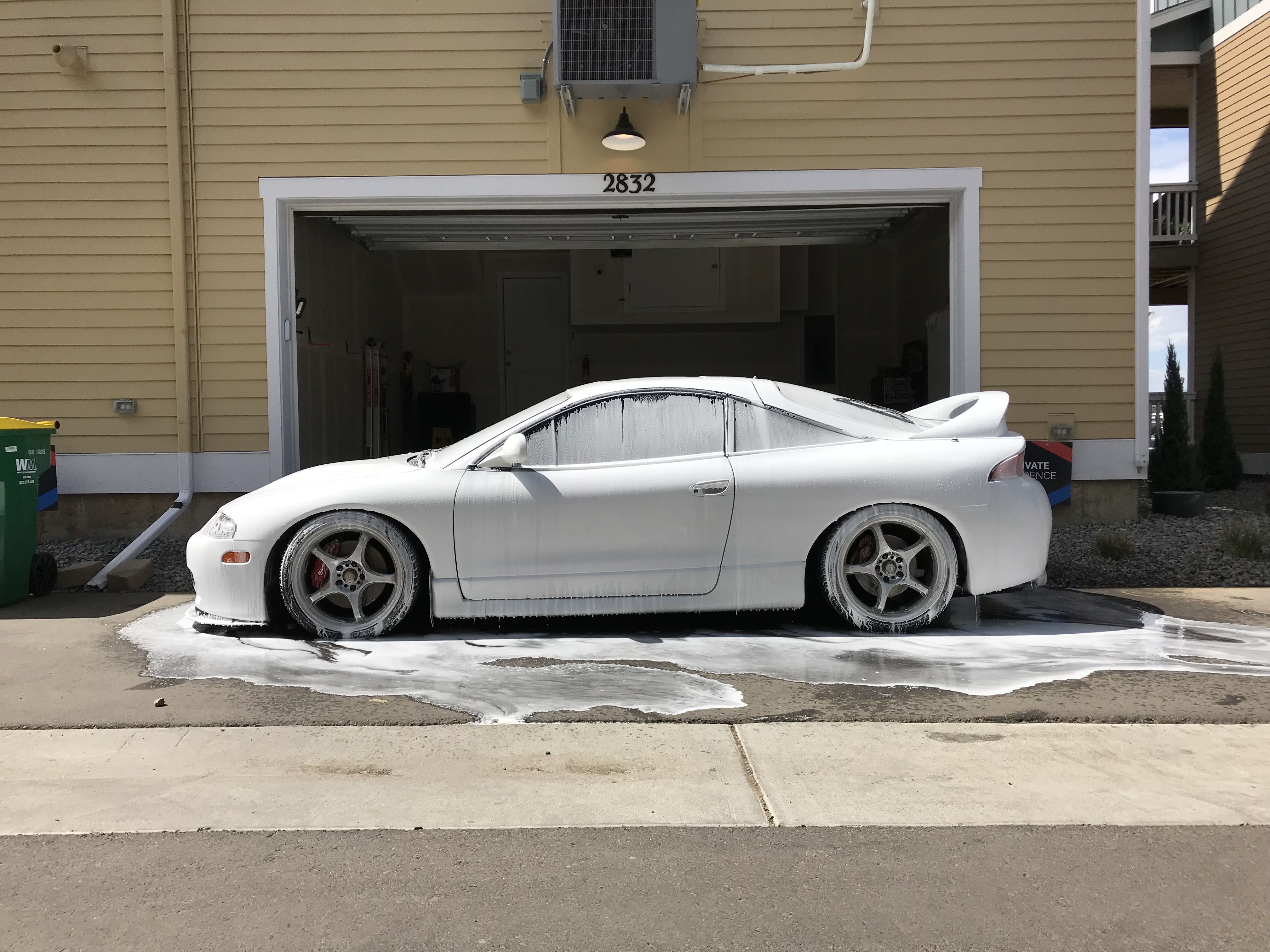

Also got the foam cannon out and gave it a nice bath.

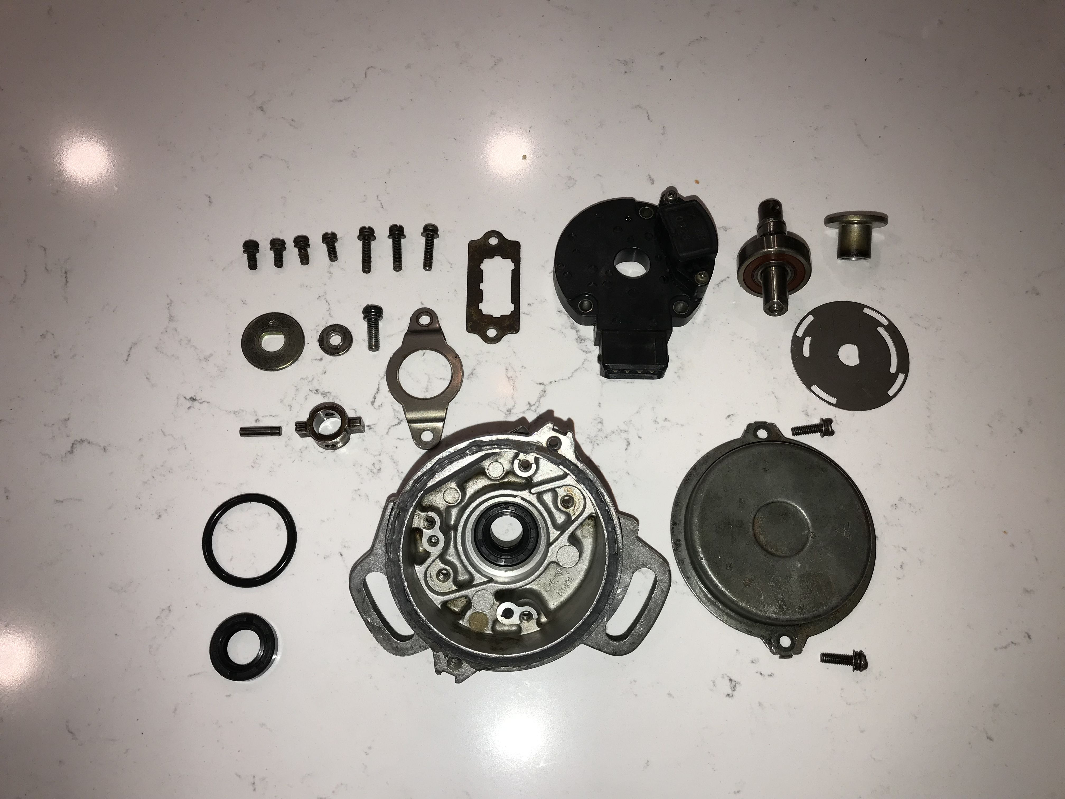

Be careful not to score the bores or bash up the housing, and be VERY CAREFUL with the optical pickup and trigger disc, they are fragile and easy to bend/break, rendering them useless.
Also make sure to use a tight fitting screwdriver for the hardware, it strips easy and is slightly difficult to get to in some spots.
Once you're done just put it back together and it should be completely leak free. May have to polish the shaft slightly to improve the seal, but that's subjective.
Dude... HOW do you get the pin out of the shaft? I'm about to just buy a new CAS. I cannot figure out how to get this out, other than taking it to a machine shop.
You have to use a cotter pin removal punch, straight punch or the like.
Clamp the housing, gently, in a vise, and hammer/punch the pin out. If you can, support the shaft with something, or just set the key section of the shaft cradled between the vice jaws, then punch it out. Two people make this easier, but I did it by myself in a matter of a minute or two. It's not made of glass, but it's still a precision piece, so sensible care is needed.
I'll give it another shot, but my pin is IN THERE LOL. Felt like I was going to bend the shaft with how hard I was hitting the pin.
Well I got the CAS apart and rebuilt! The pin was difficult but I got it after a couple minutes of hitting it with a punch.
Here's a pick of it fully disassembled. I already put the seal in so I laid an extra out just so you can see with all the pieces, so there are (2) seals shown in this pic.
I'm definitely going to take it all apart again and get it soda blasted this winter when I get everything else powdercoated, I think that will look pretty sweet.
I'm going to post an article on rebuilding the CAS just because there were really no pics available online.

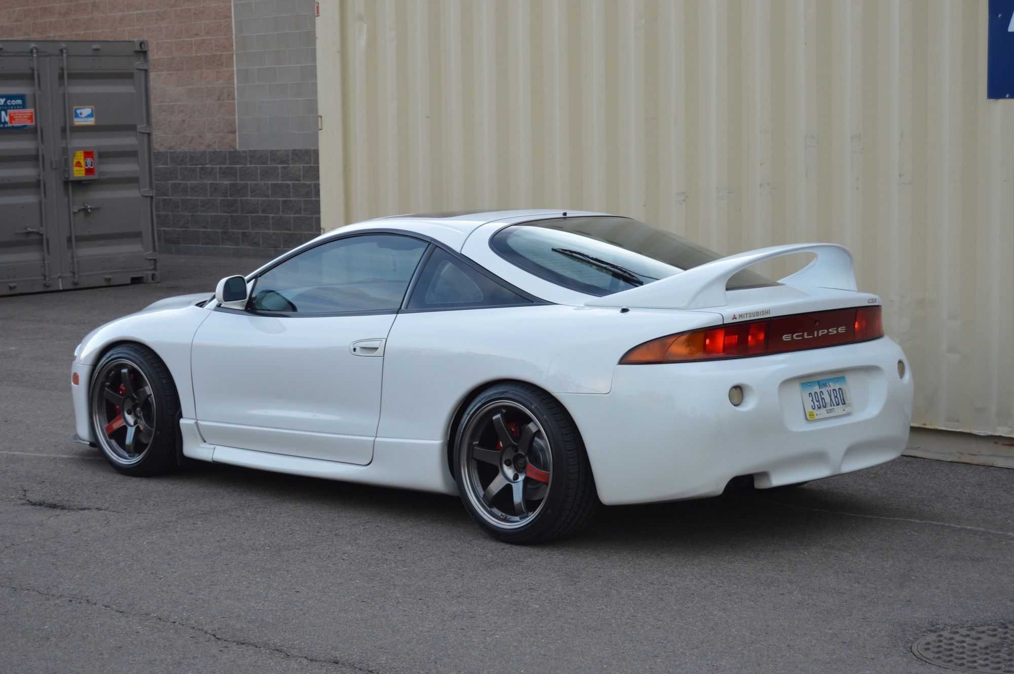

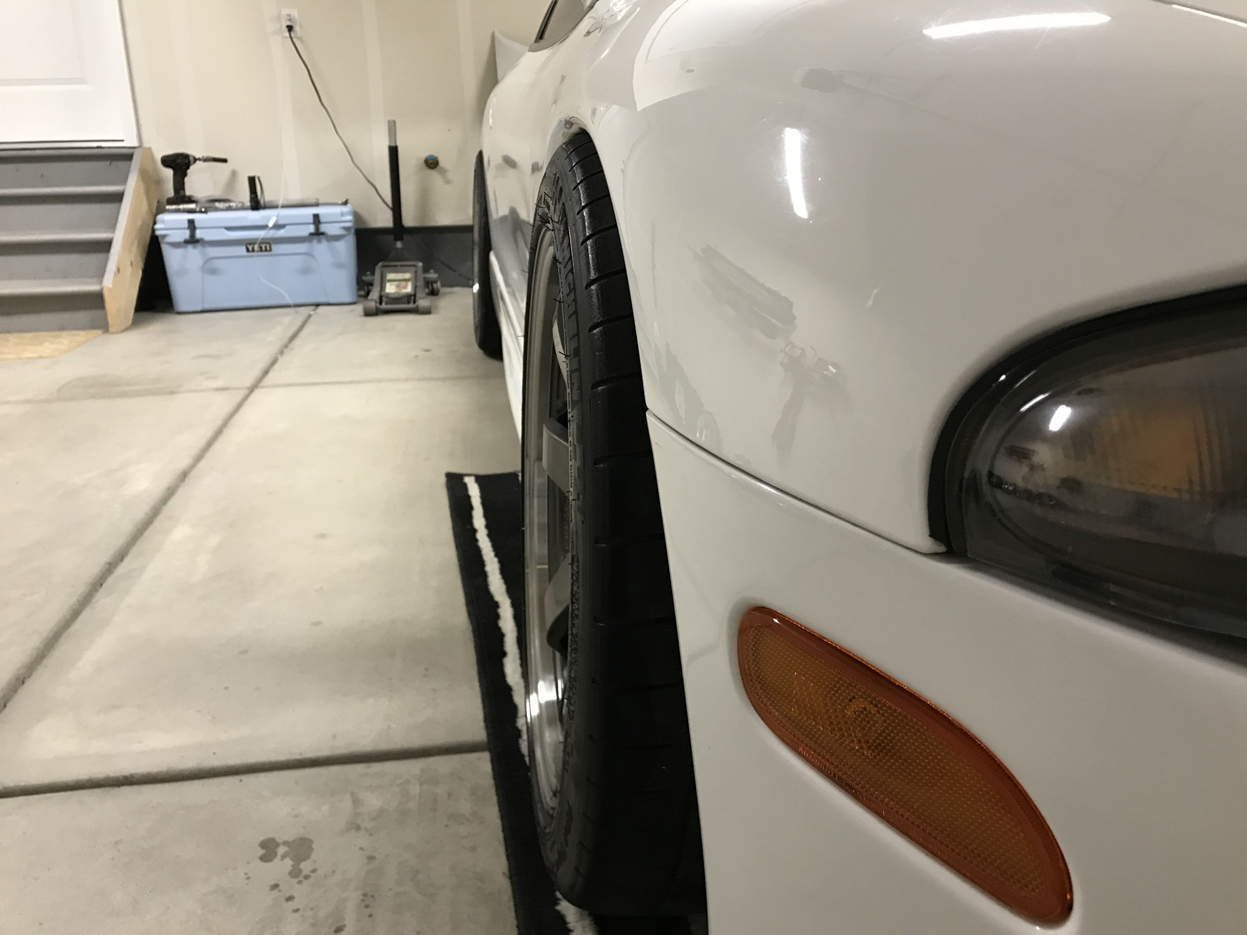

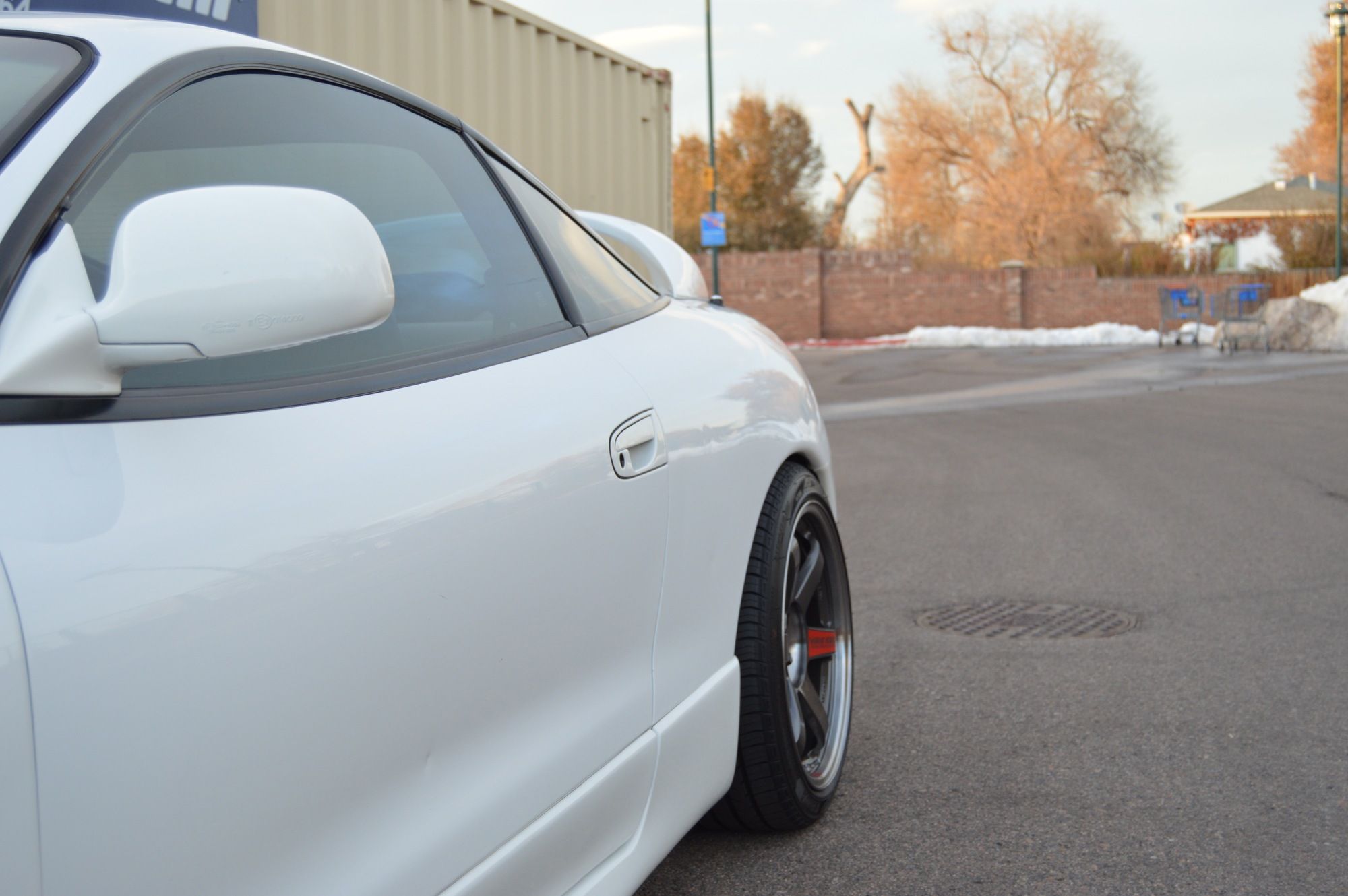

Hey!

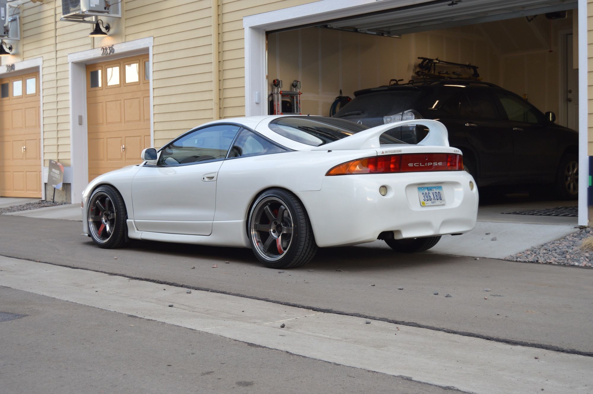

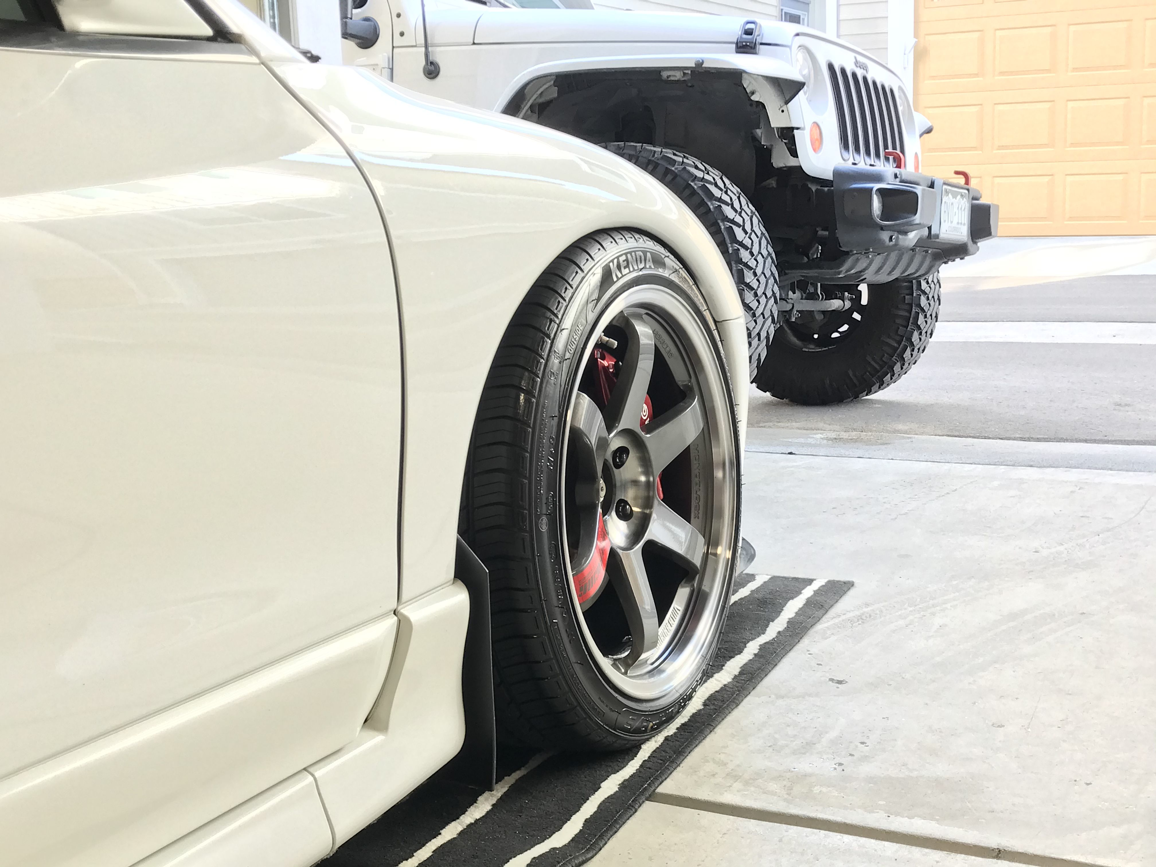

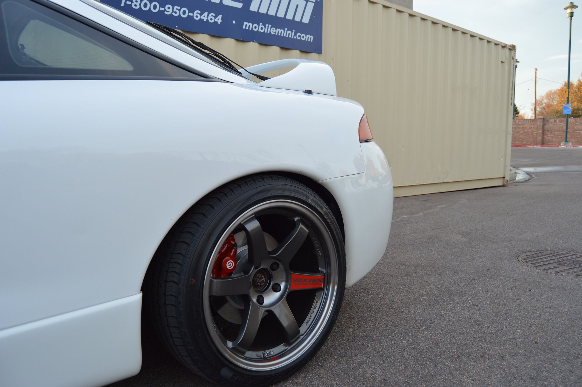

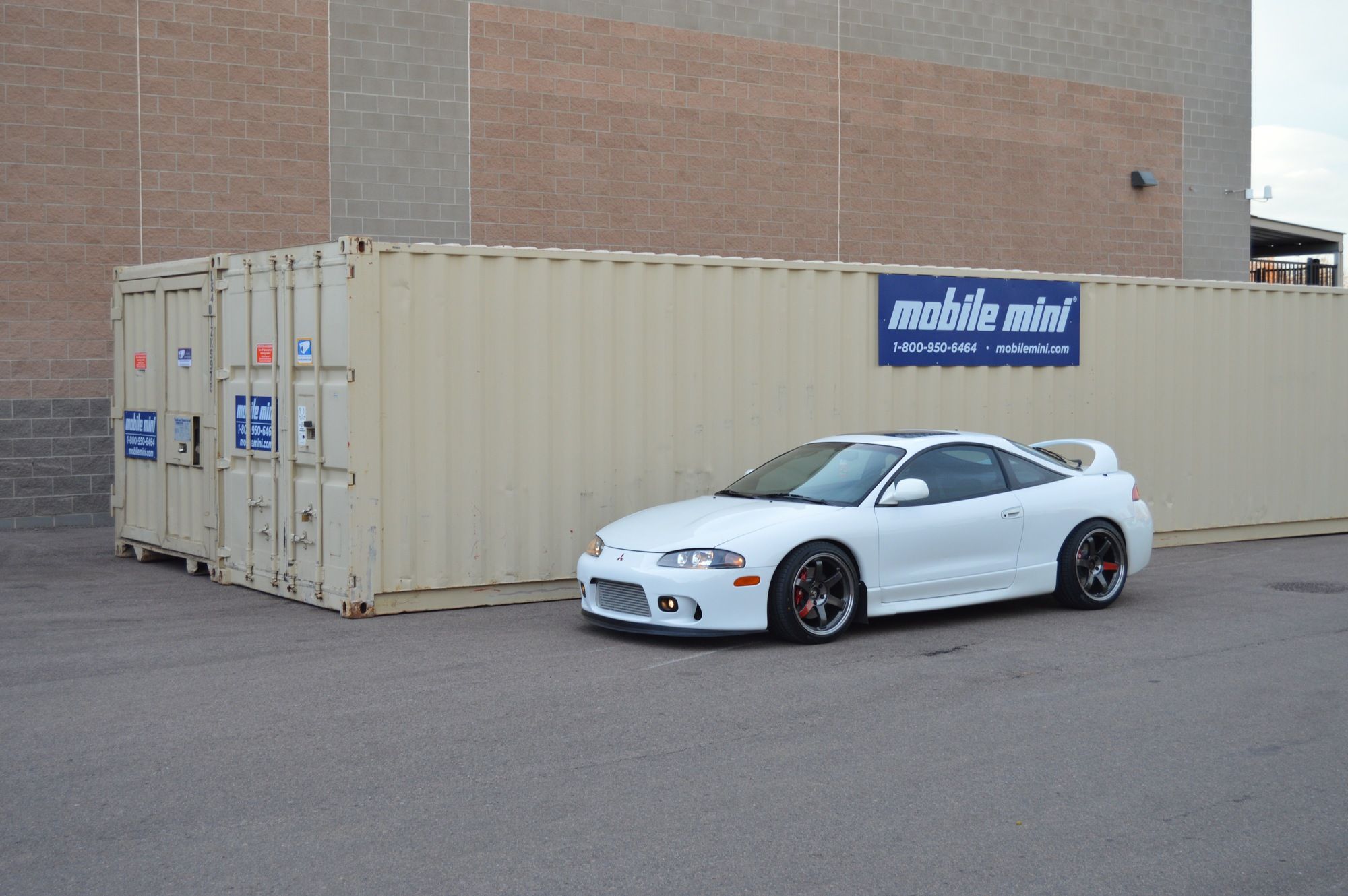

I got some new 235 40 on the wheels to fit a little better, I also raised the car up 1/2" and nothing rubs! Love the way it looks. I want to get a camber kit up front to bring the tops of the tire in but other than that I love the new wheels.

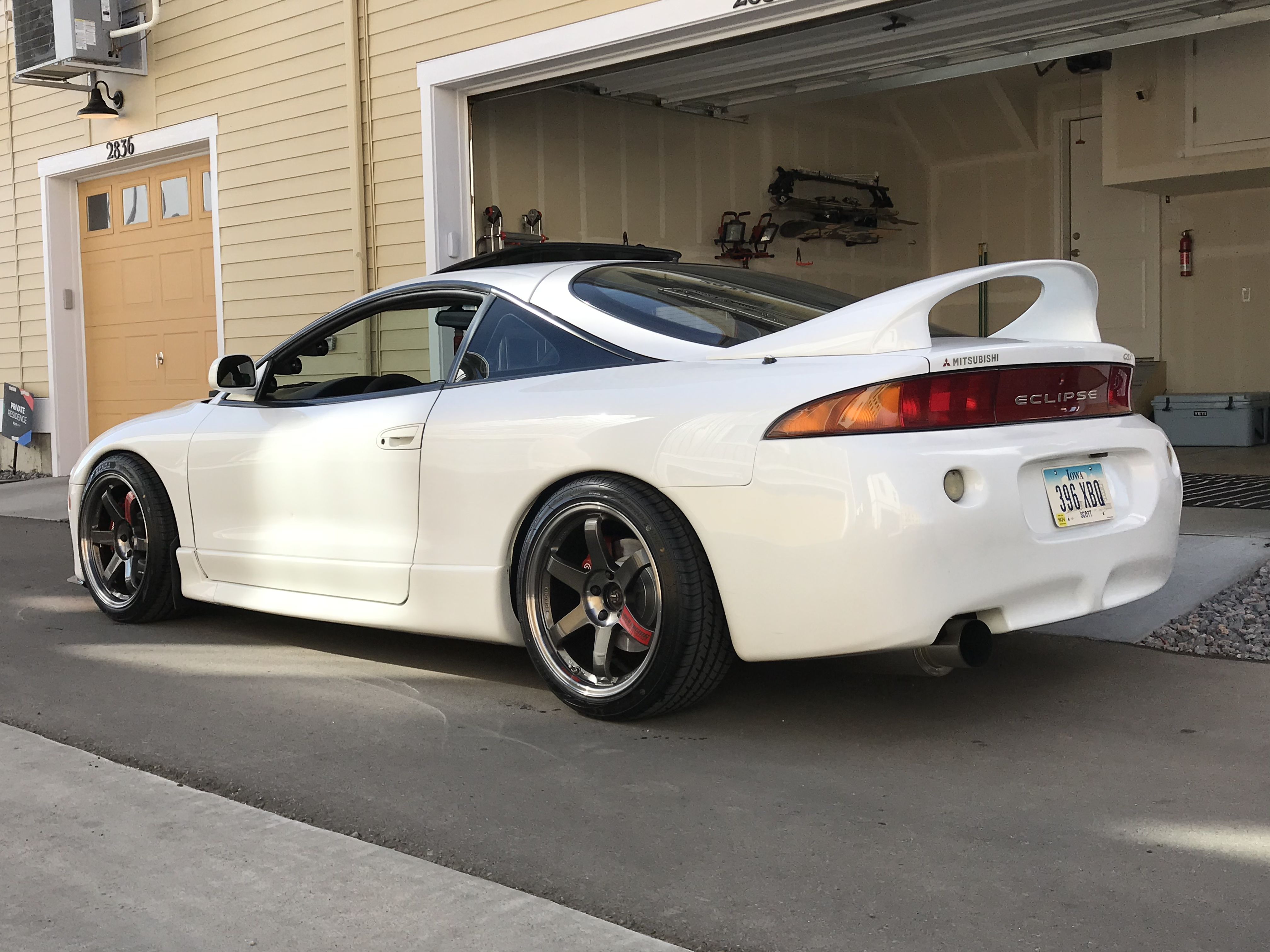

Hey guys,
I got some more pics of the new wheels. The car is put away in the garage for the winter. I'm slowly getting things ready for a drivetrain overhaul. Rear diff refresh, t-case refresh, axle/hubs/bearings, rear suspension etc.
Heres some pics!

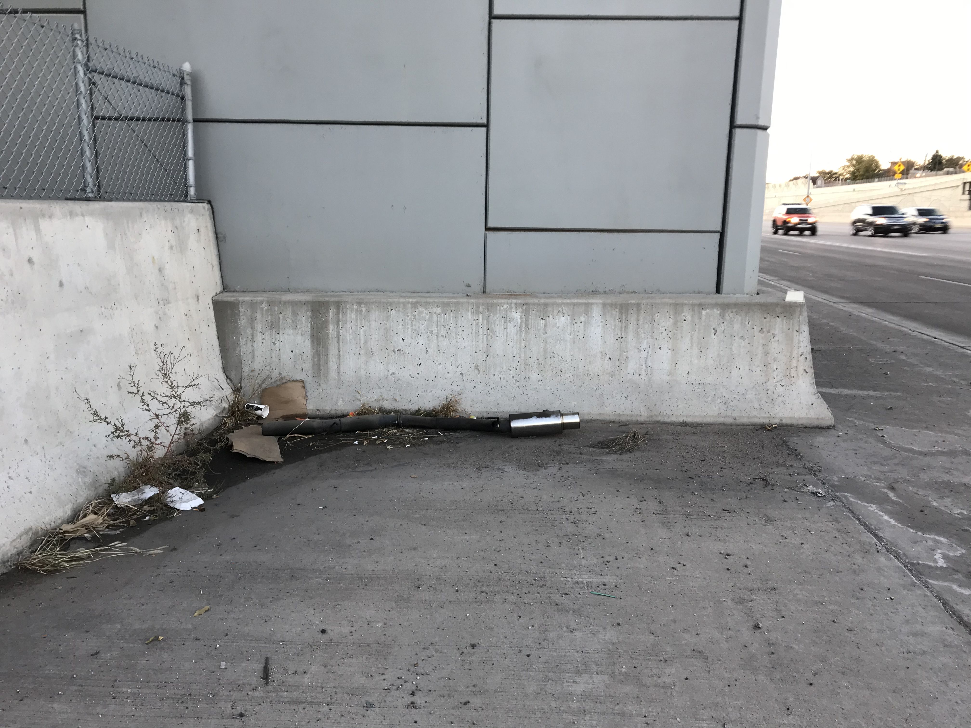

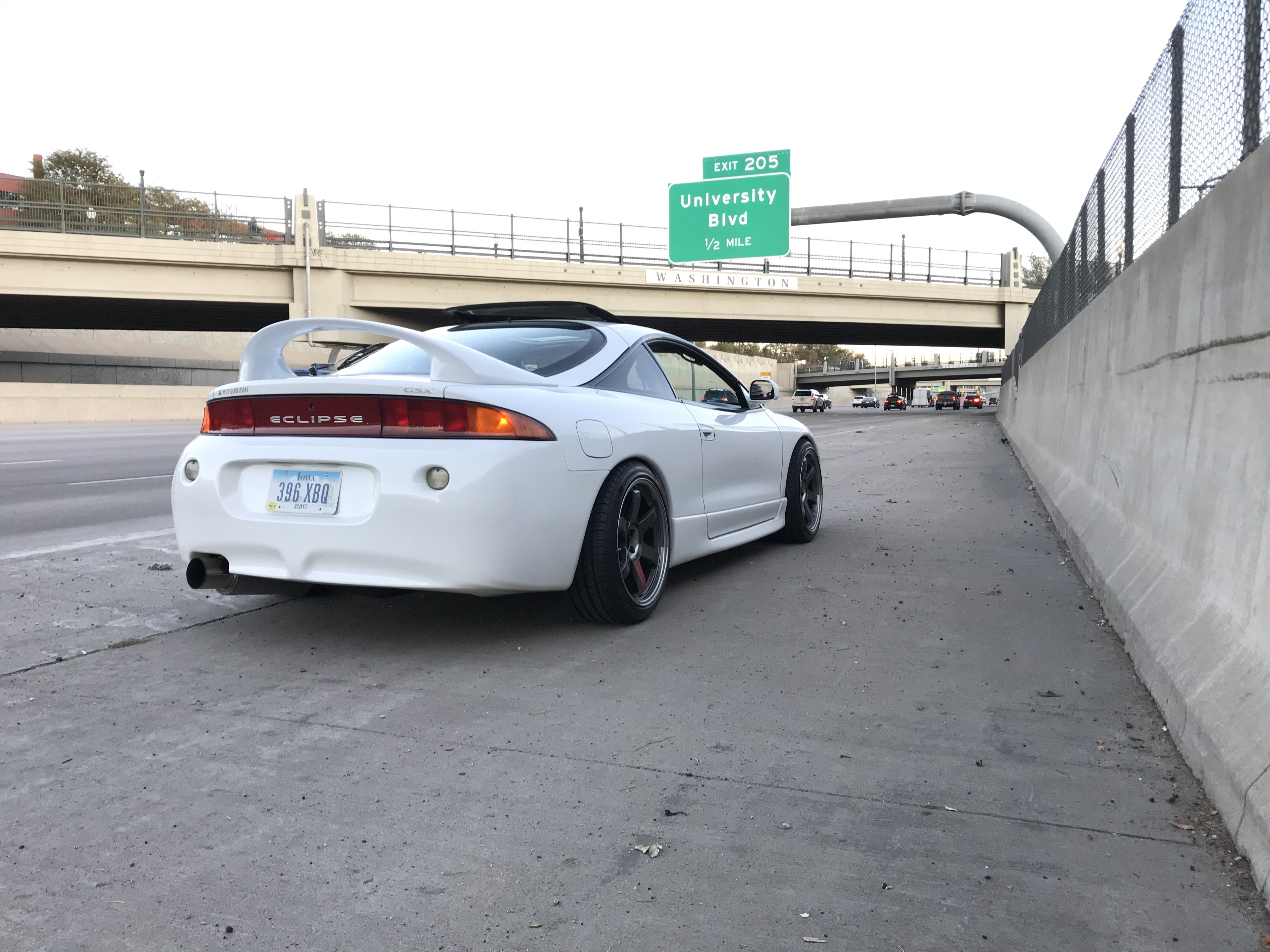

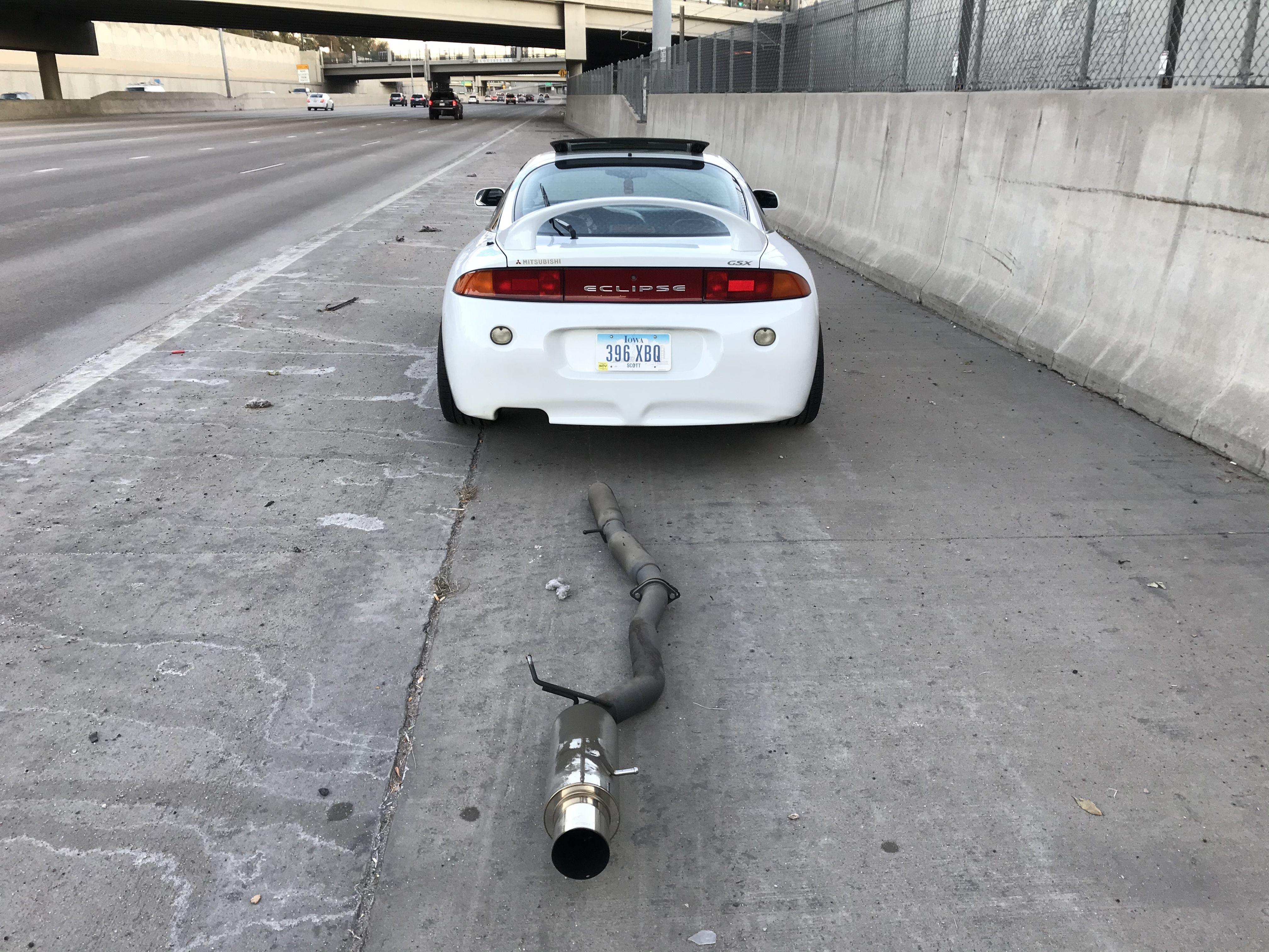

I'm not sure I mentioned it, but my Apexi cat-back basically self destructed on I-25 in Denver. I will say that the exhaust was on its way out. Tons of scrapes and broken hangers, some holes etc. So I really don't care. It broke clean at the welds on the first resonator, so I have like 4 inches where the o2 sensor is, and that's it.
I also am sort of happy because the Apexi N1 has sooo many bends, two small resonators which I hear are 2" internally, so eh whatever. I just ditched exhaust by the median LOL.
I almost pulled the trigger on the HKS Carbon TI, I want to keep some of the "period correct" stuff on the car, so I will most likely go with that one since it looks to be a MUCH better design, and stainless. A custom exhaust by my fabricator who did the downpipe said it would be 1300-1500 for the cat back, which I couldn't justify when the HKS is 600 and fits great.

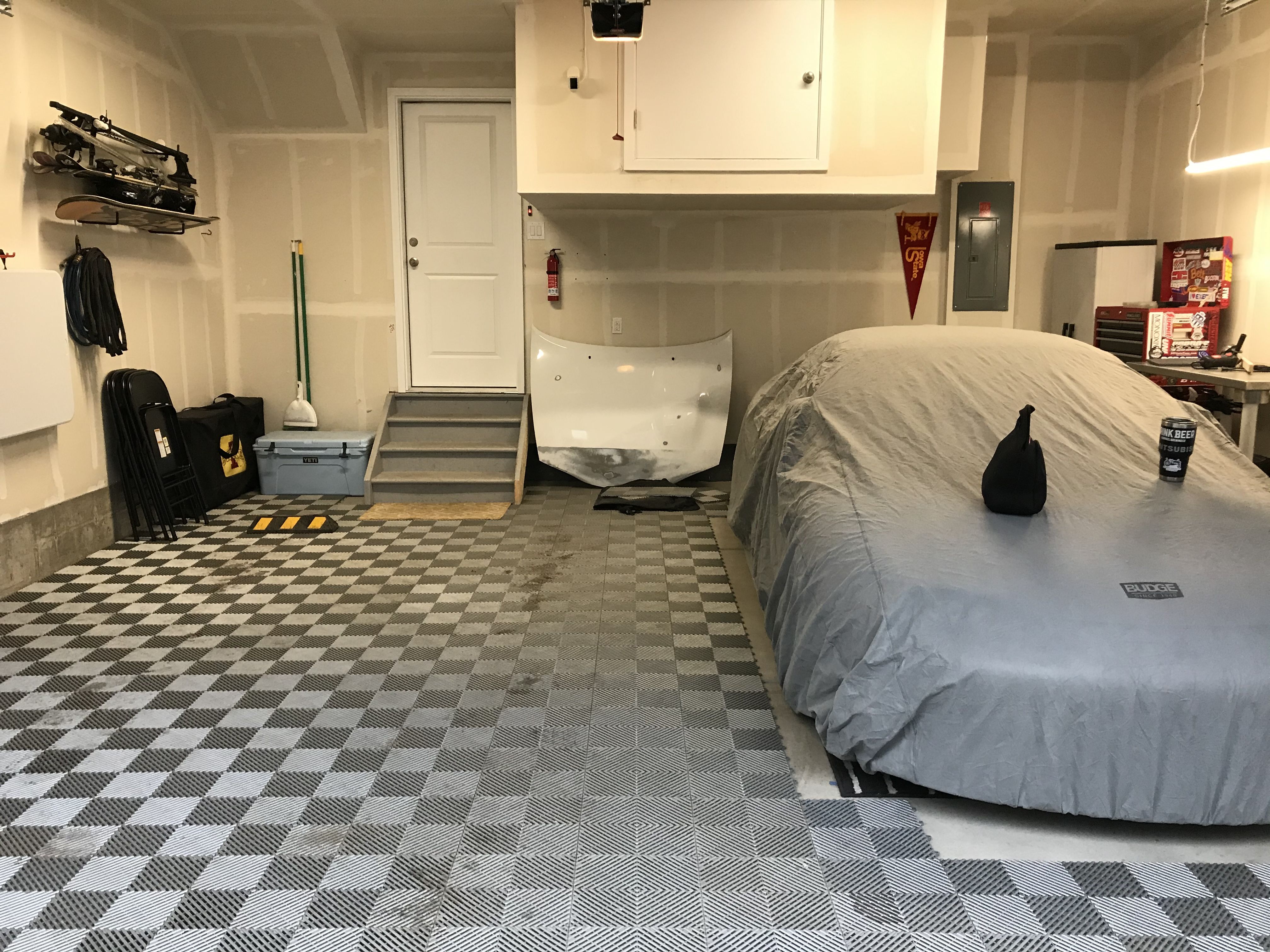

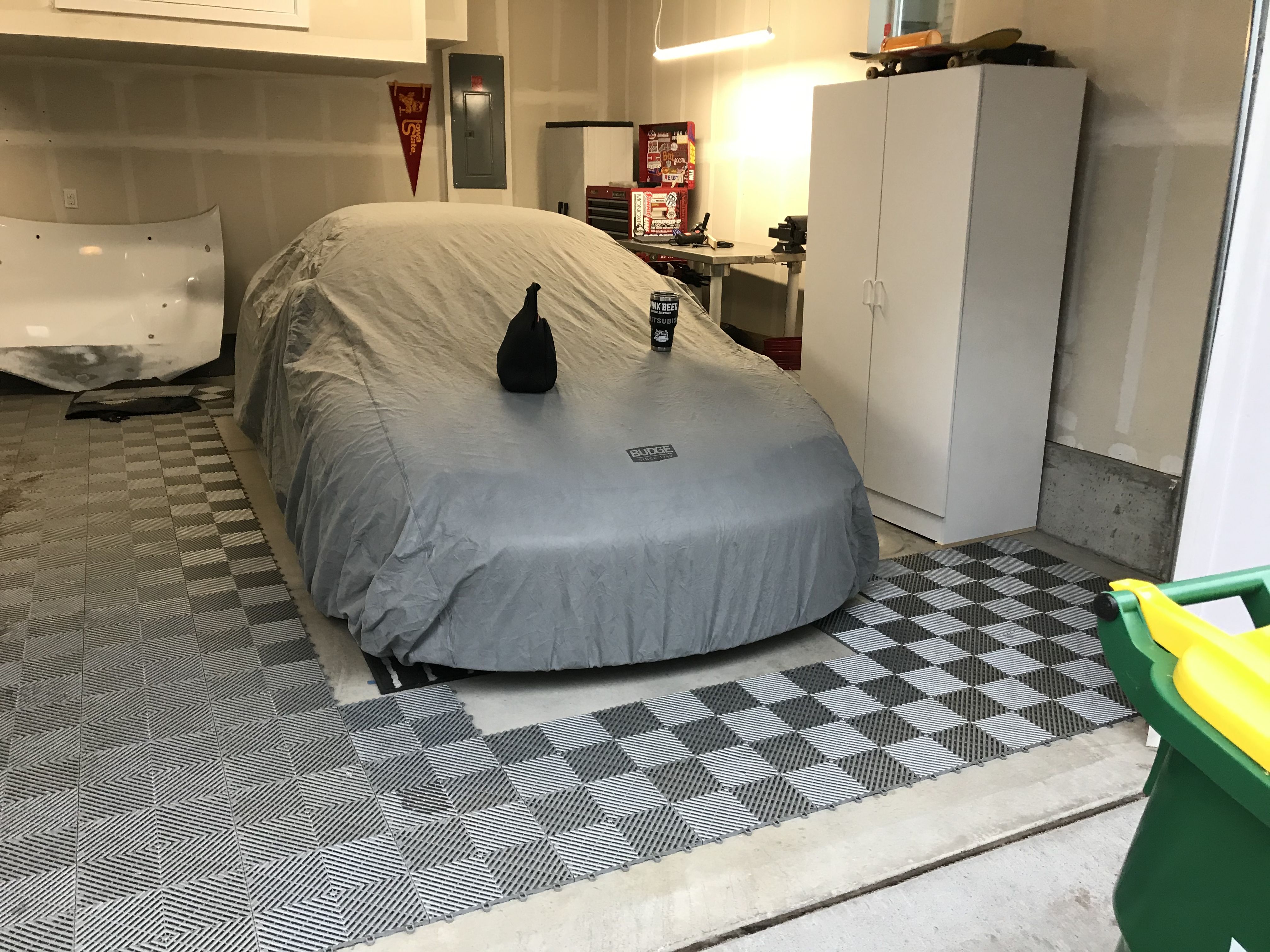

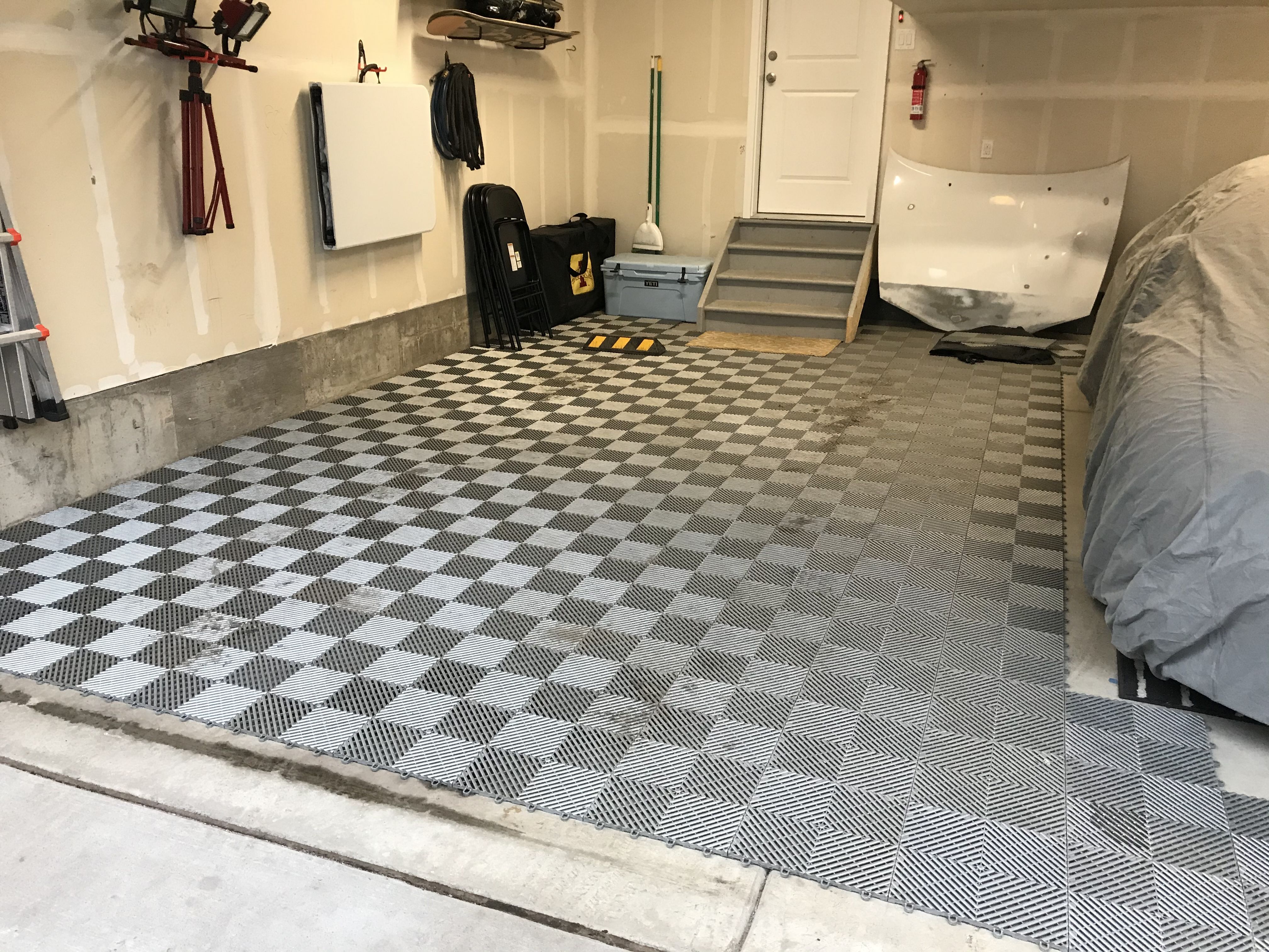

Next, I started buying stuff for my garage. I started with some RaceDeck Free Flow tiles. I got a crazy deal on 240s.f of these for $300 (these are $3.50 a piece) So I started laying them out and am SO pumped. Such a better idea than spending 3200 on epoxy, or spending 1k on DIY kits and hours and hours of labor.

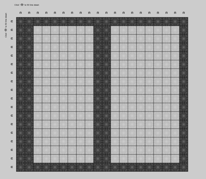

I had to order about 150 more tiles, (black) to acheive the following design, with the wide black area being the workbench area and tool box etc.
So pumped! I then plan to paint the whole garage white, with an accent border stripe around the walls at ~5' or so.
