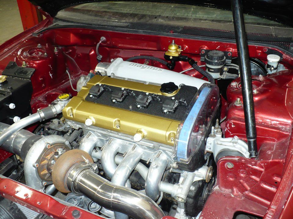

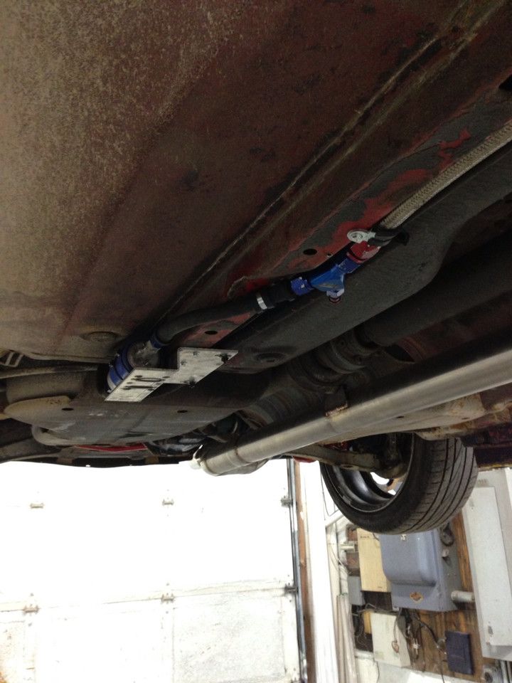

Newly coated parts look even better in an engine bay! Finally getting close to driving this thing. I've got it at a local performance shop getting a few last things done (fuel system, misc AN and vacuum lines, turbo lines) and should be getting it back in a week or so. Then all that's left is wiring up the gauge sensors and firing it up!

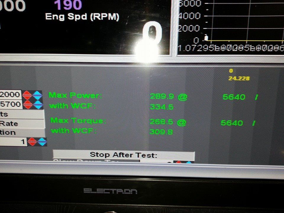

This update has been a long time coming! After a bunch of setbacks over the last few months, the Talon finally lives! Ended up replacing the blackbox ecu with an AEM EMS V2. Right now it's running a very conservative break in tune: 5800rpm rev limit, 18psi boost limit (w/g spring pressure) and it made 290awhp on a mustang dyno.
Put around 500km on it so far and it's running great!
Shout out to Lowell and the rest of the guys at Racing Greed for getting me to the end stage of this build! Can't wait to see how it does when it's broken in!

AWESOME BUILD! One of my new favorites.
Do you have any more pictures of the car being back together and on the road? Love that engine bay set up.
Keep up the great work!
If your vc was cut with a cnc why is it so wavy? Everything looks stellar! Definitely some cash in this build!! I would love to do something like this but I can't stand it when my car is not running. Keep up the good work dude!
I'll try and get some soon once I've given it a good clean! Just got it insured again the other day.
If your vc was cut with a cnc why is it so wavy? Everything looks stellar! Definitely some cash in this build!! I would love to do something like this but I can’t stand it when my car is not running. Keep up the good work dude!
Not sure, I'm thinking maybe it wasn't taken down as far as it could be.
